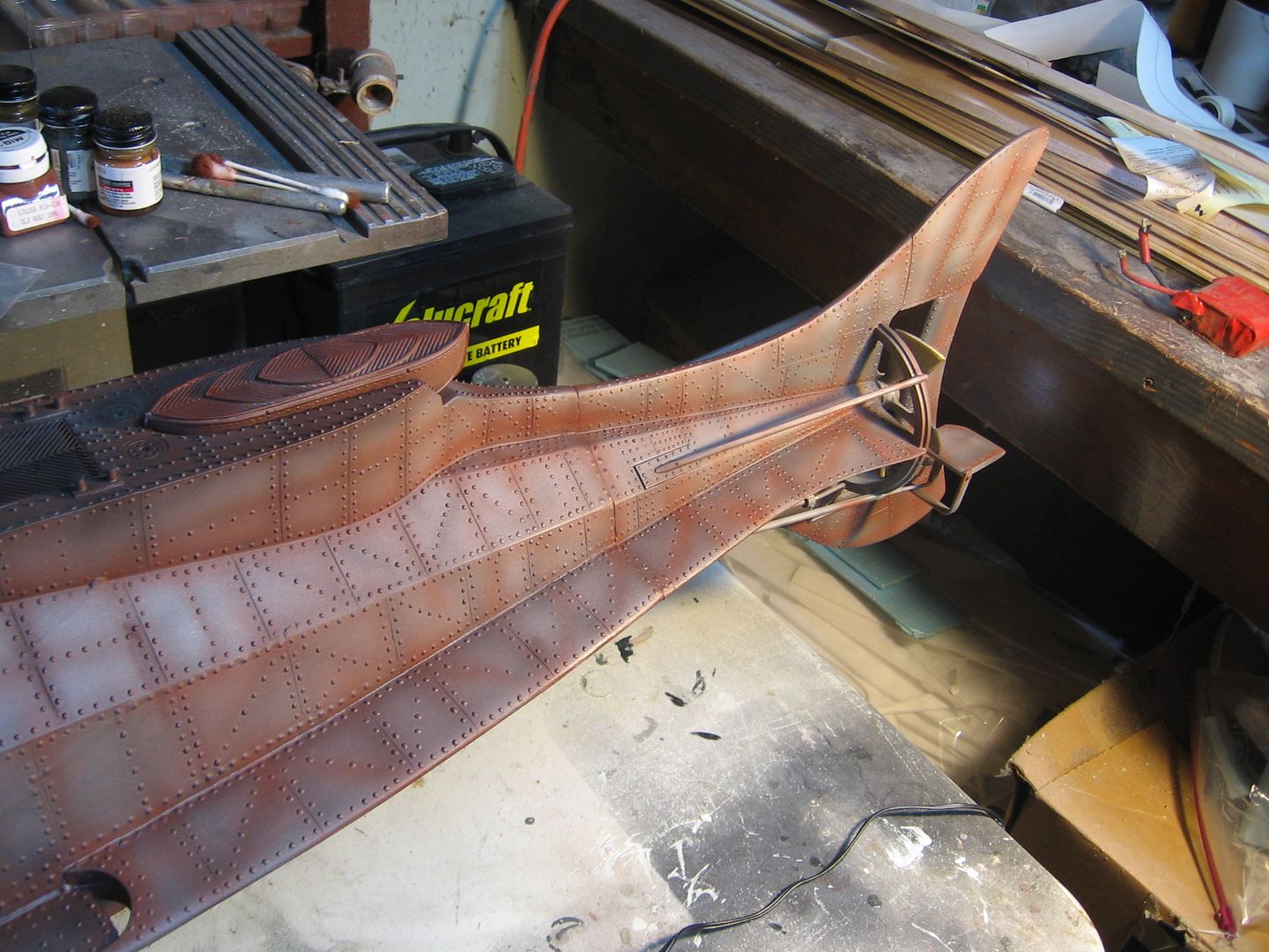

That one would have looked more like this scratch built I did a few years ago.
Steve

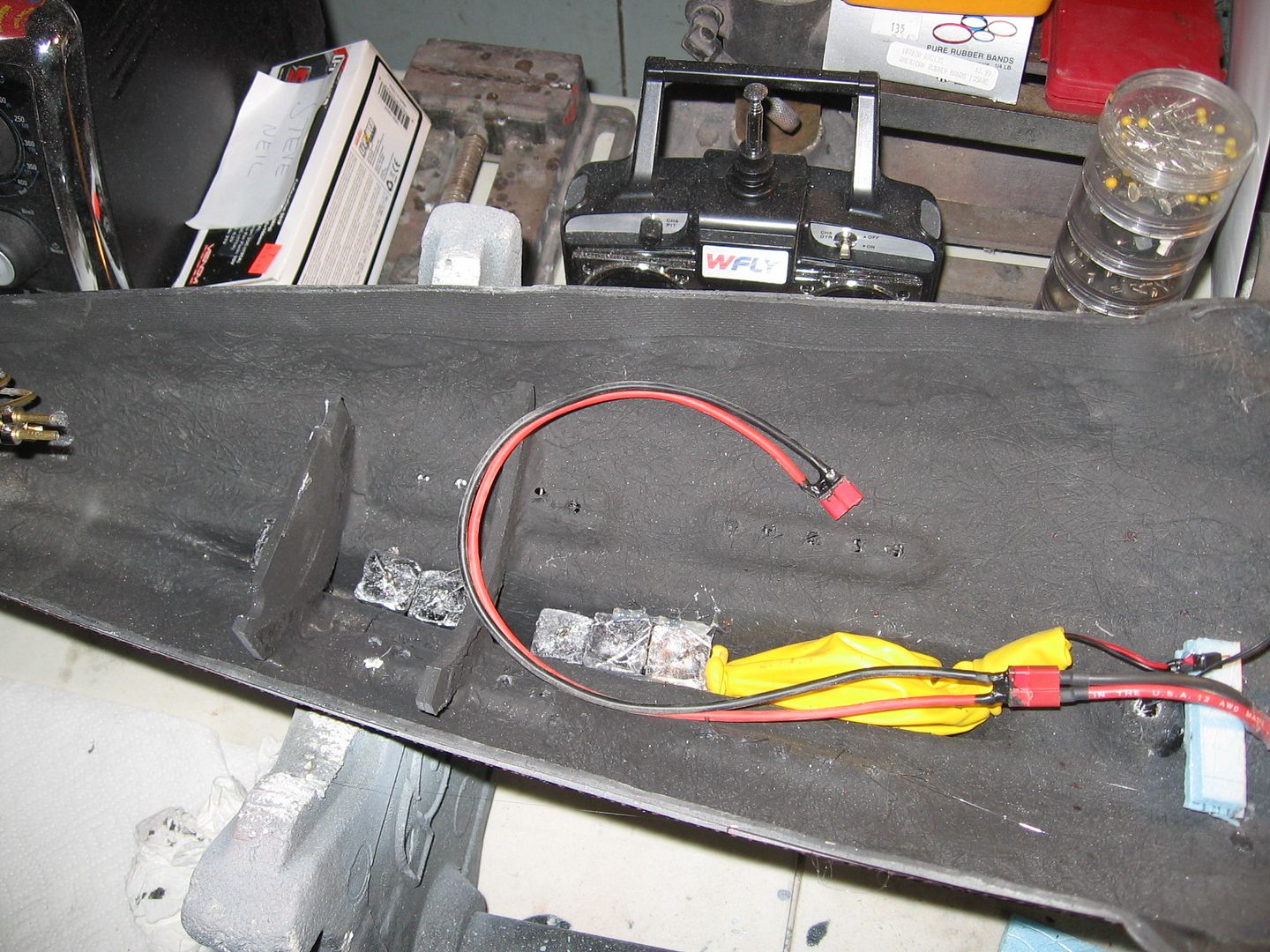

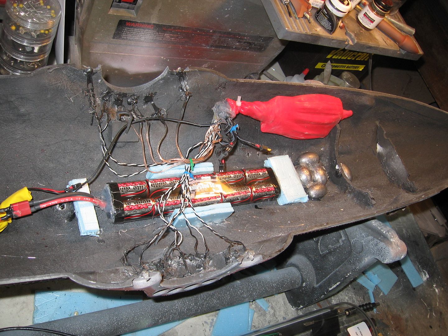

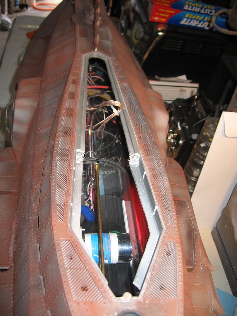

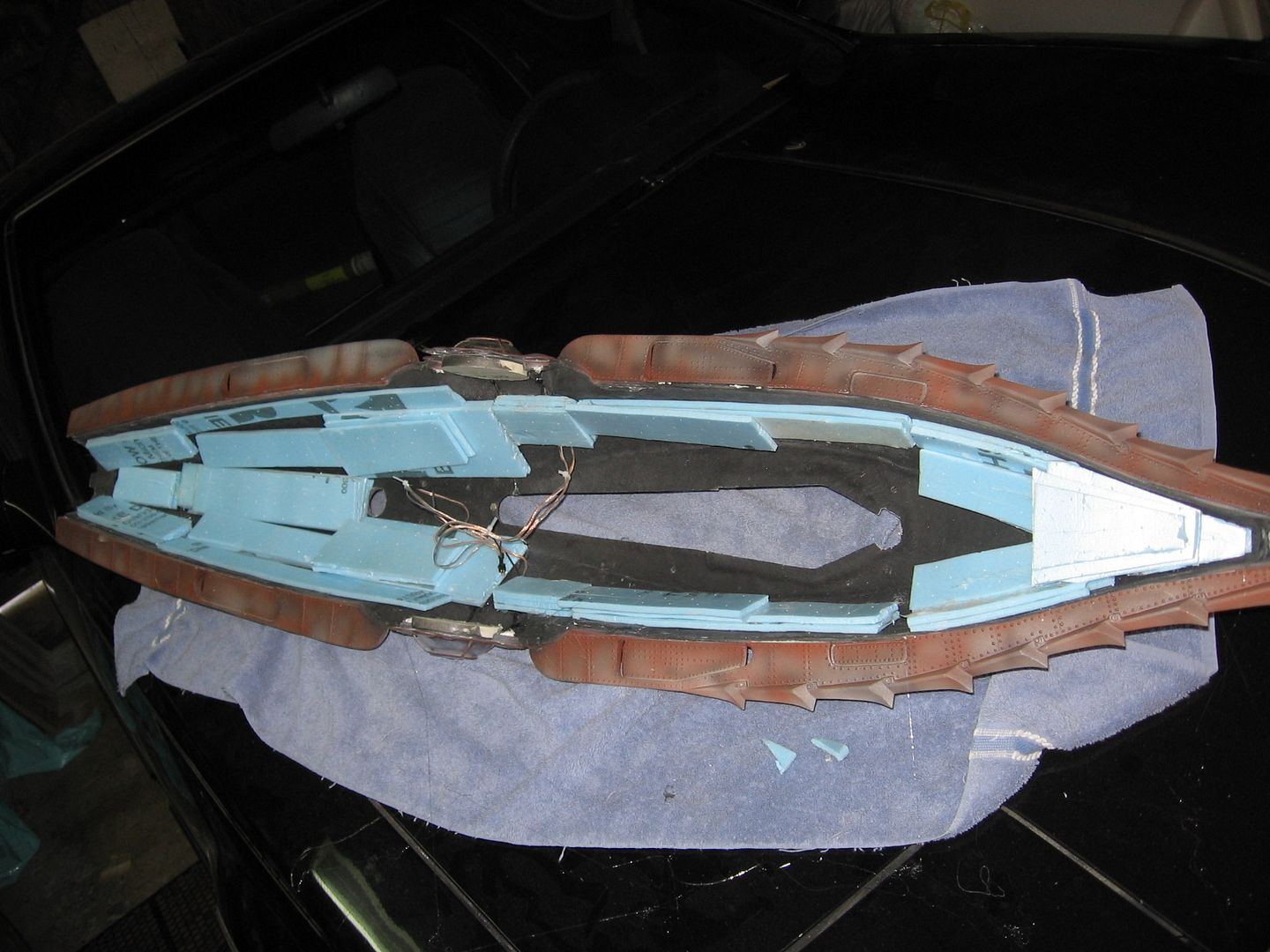

So she’s officially done except for water testing. She is ballasted with weight in the keel. Foamed below the water line. Water tight on the light board and the 9 volt battery both incased in punch balloons and seal with zip ties and silicone.
Everything lights up either from a 9 volt battery or the 9 volt power supply that plugs into the wall.

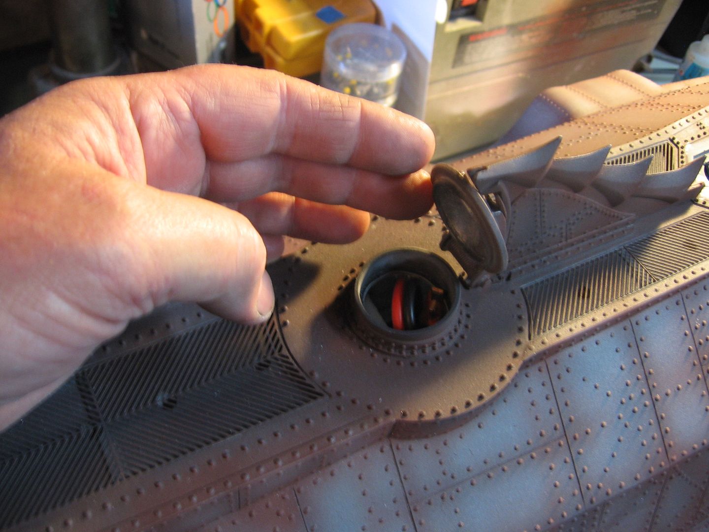

Battery that supplies the power to run the boat plugs in through the top side hatch. No need to remove the top to turn her off and on. Lights are connected through the lower hatch.

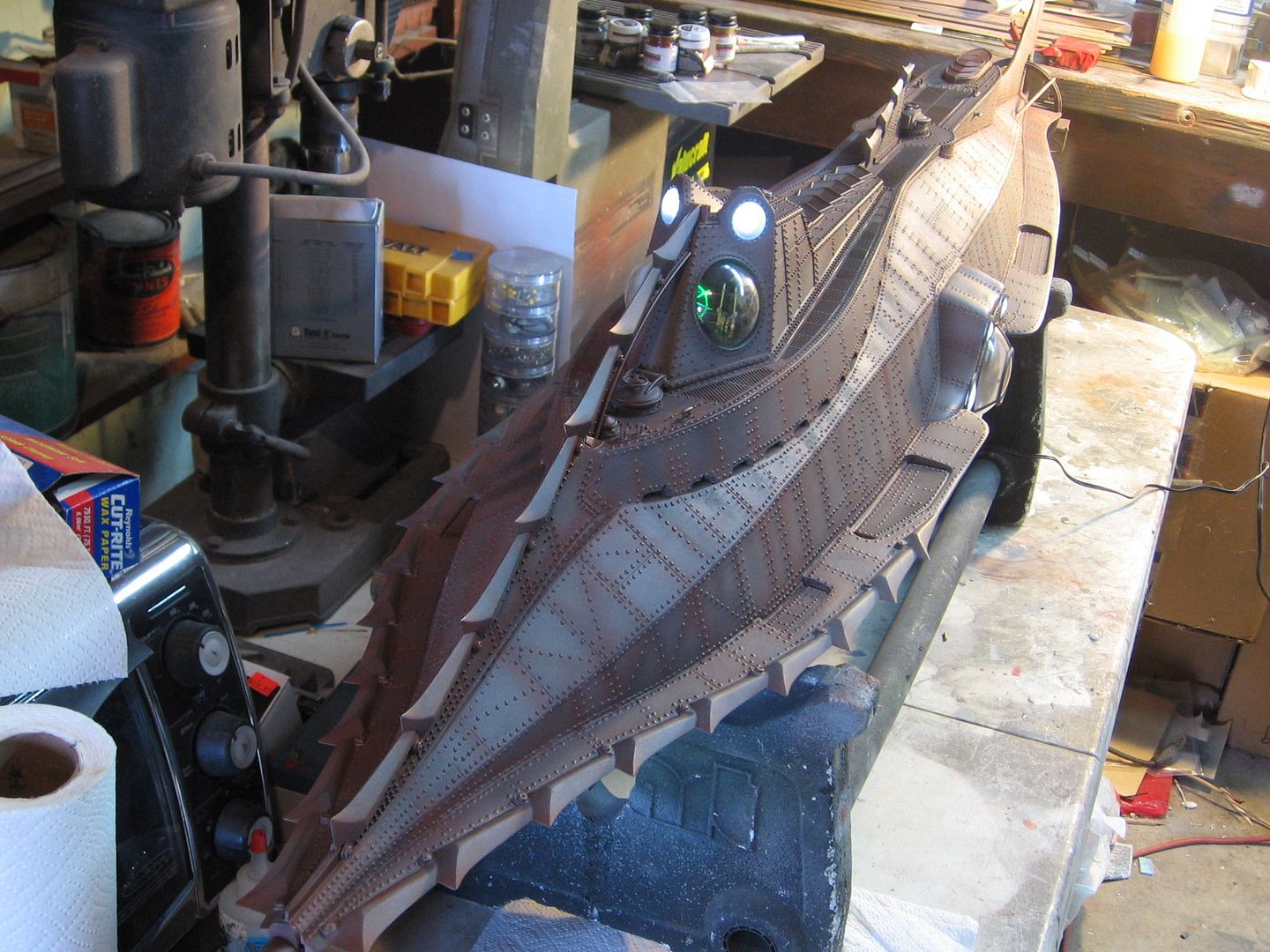

Clear coat is on.
So we wait 5 days for the clear to dry and on Wednesday I’ll run her in the pool and post video.
9 volt battery and ballast weight.
Battery is shrink wrapped and the ends sealed with silicone. Lighting board is visible and more ballast weight.
Top side foam for floatation and keel.
WTC installed and hooked up.
This is where you connect the battery for power to the drive module or WTC.

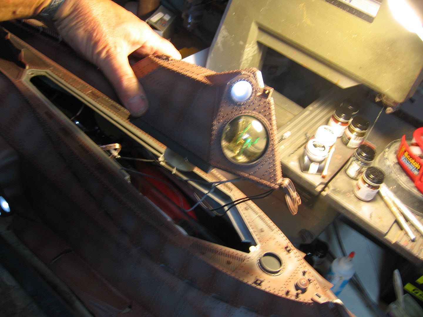

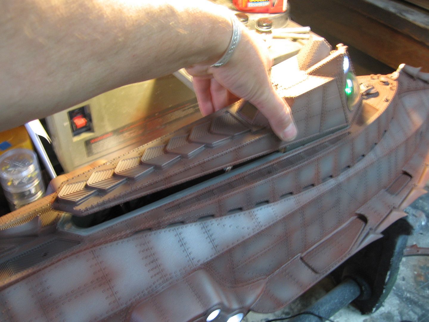

Have the ability to remove the wheel house give you easy access to connect the wheel house lights and inspect the closing of the top.
Simple as 1, 2, 3 the wheel house is installed and held with magnets.
These brass screws help to tighten the seam and further hold the two halves together.

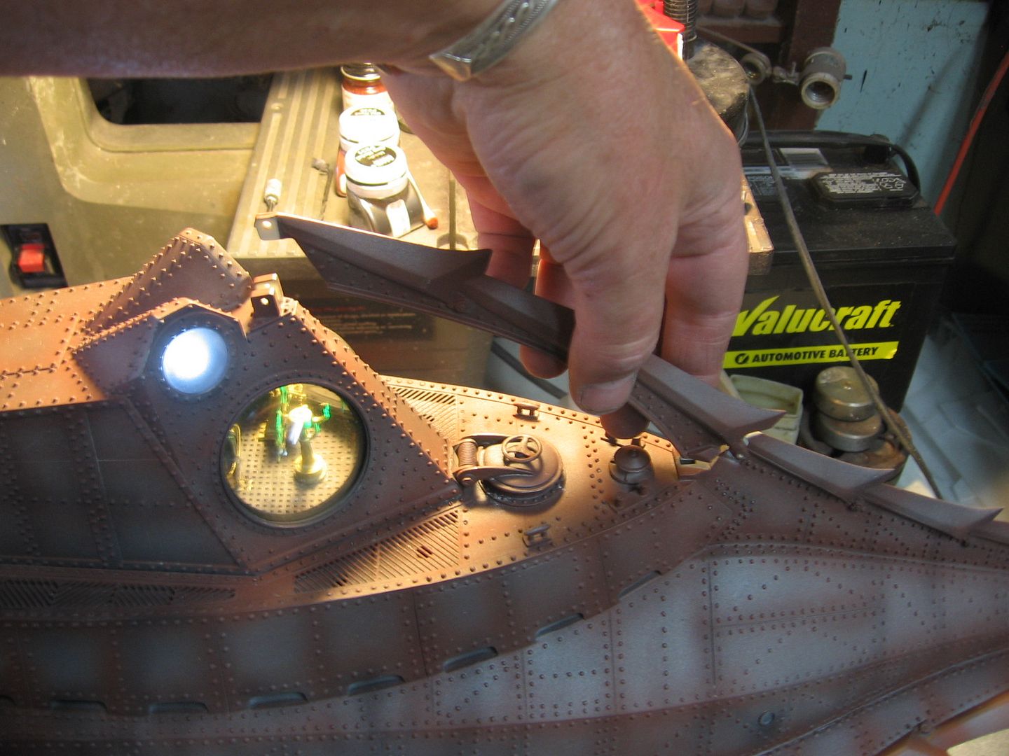

Dive planes the real boat should have had to work in the real world.

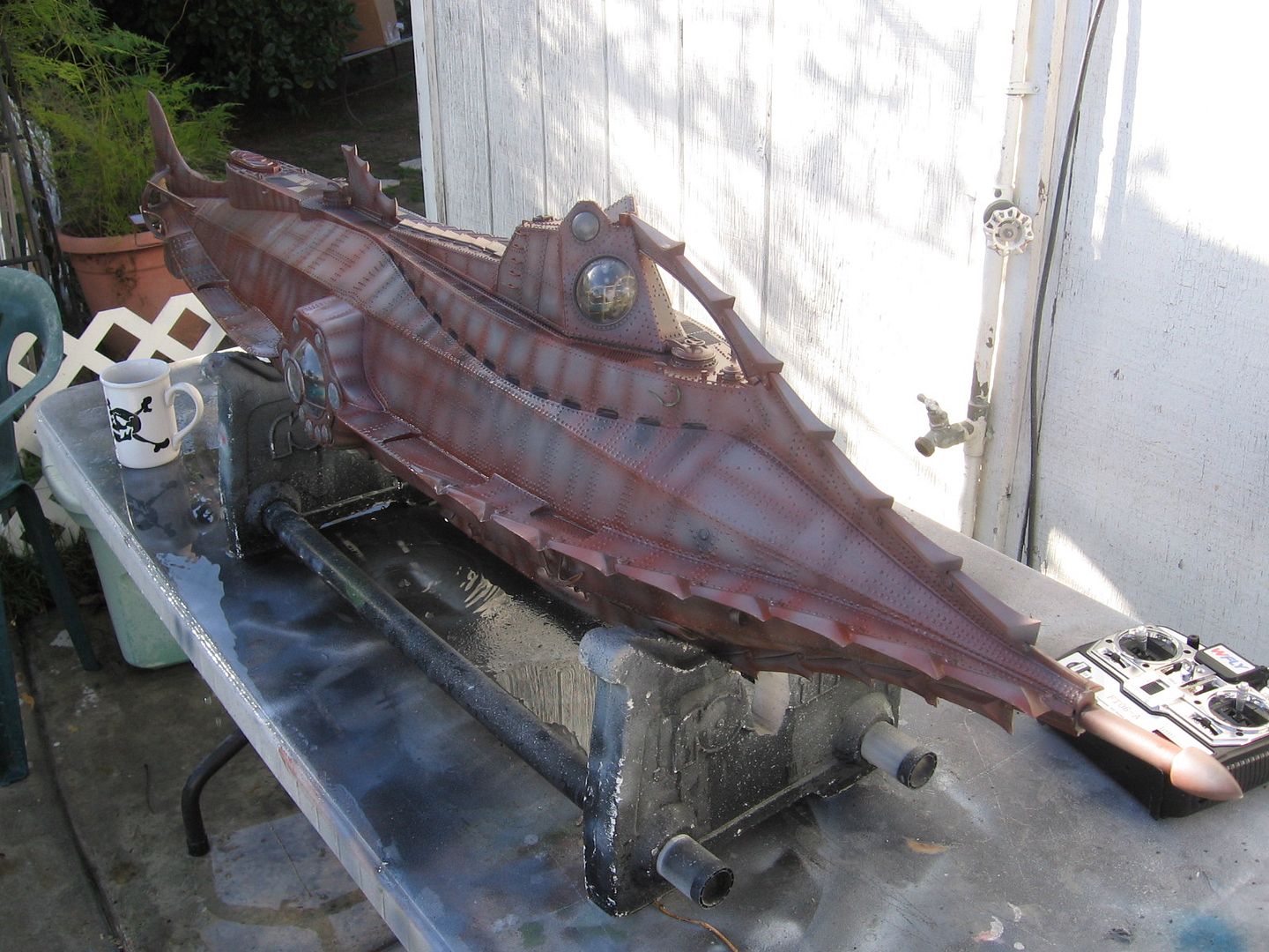

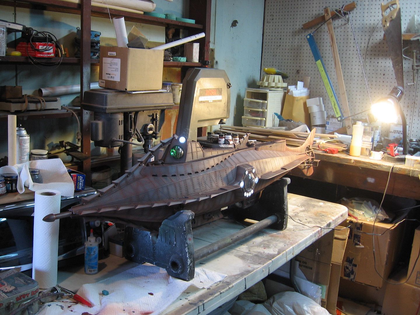

And the finished boat. What a beautiful thing.

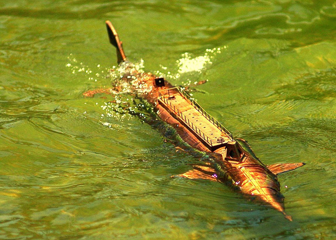

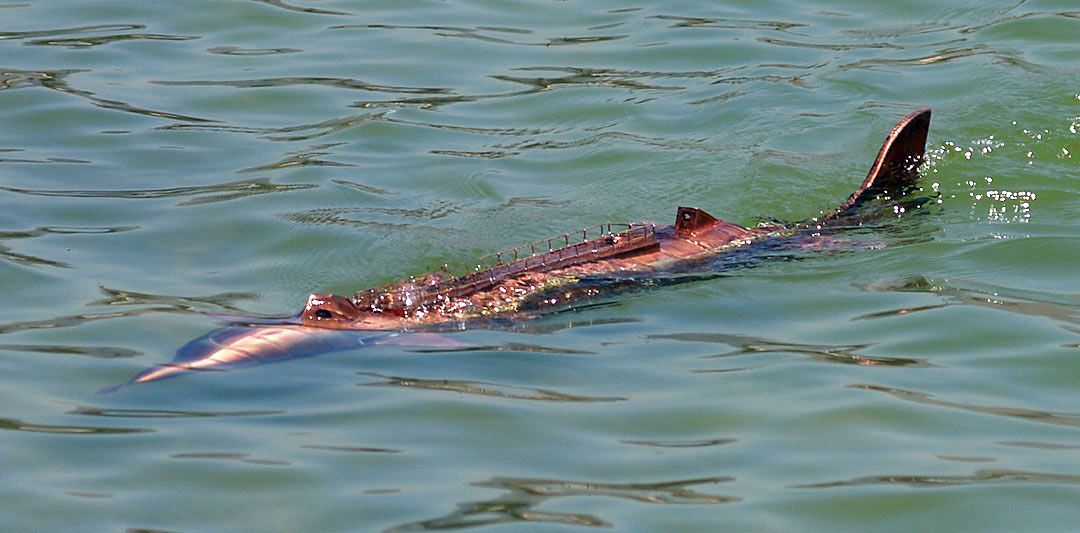

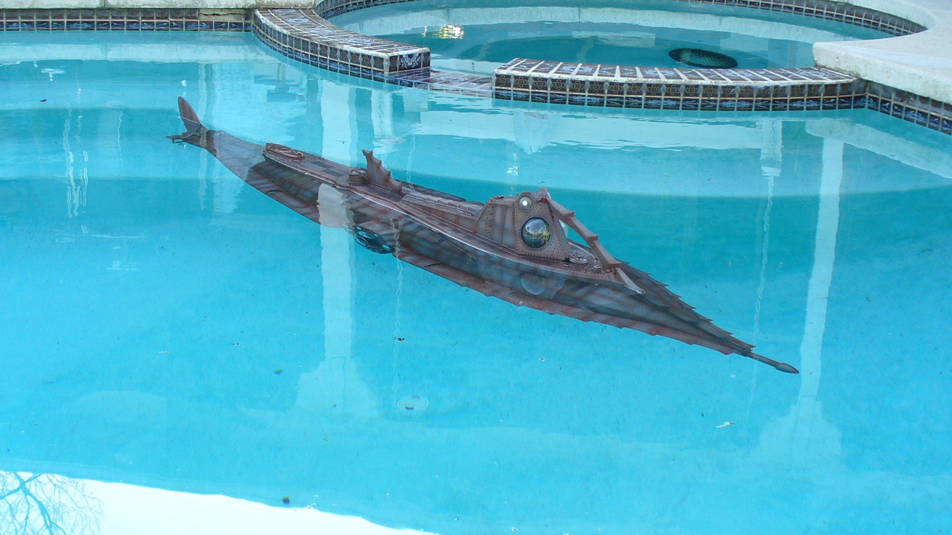

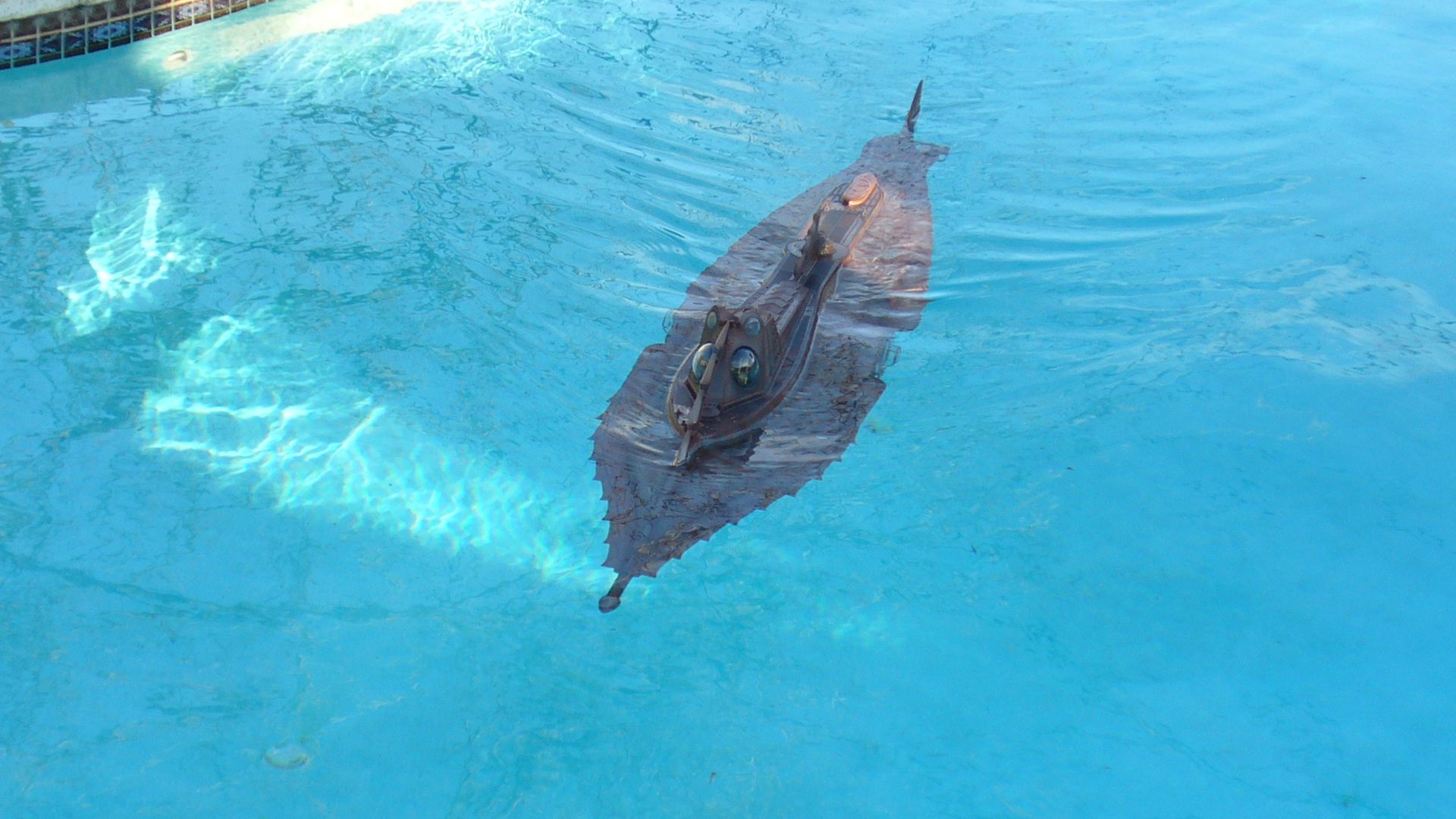

The sea trials went like clockwork today. Nice and smooth. My guess about the trim was pretty close and I was only about a pound off on the weight to the keel.
At first she sat perfect in the water but the free board was like that of a Gato Class or VIIC. She sat way to high up. So a bit of weight and a couple of runs got the trim dialed in just right.
Lights worked under water perfect no shorts or blow outs. They are hard to see in day light but should be killer at night.
She was smooth and very controllable. Ballast tank with the OTW was more than enough volume to dive the boat. I don’t think I used half the tank.
No leaks and no problems. Just plug and play. Much of the day was spent making a instructional video for the owner. But we had some play time and it was a real kick to run this big beautiful model.
