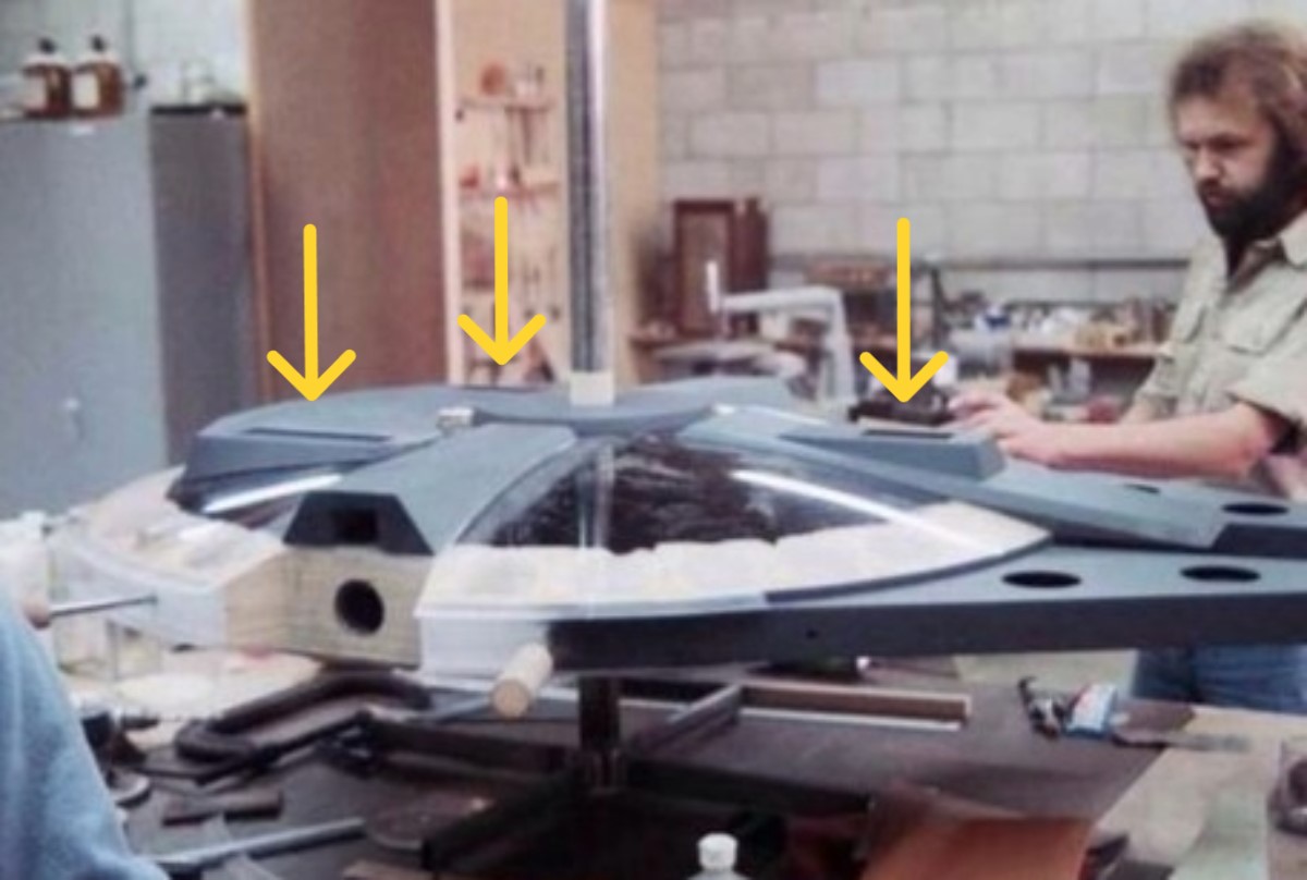

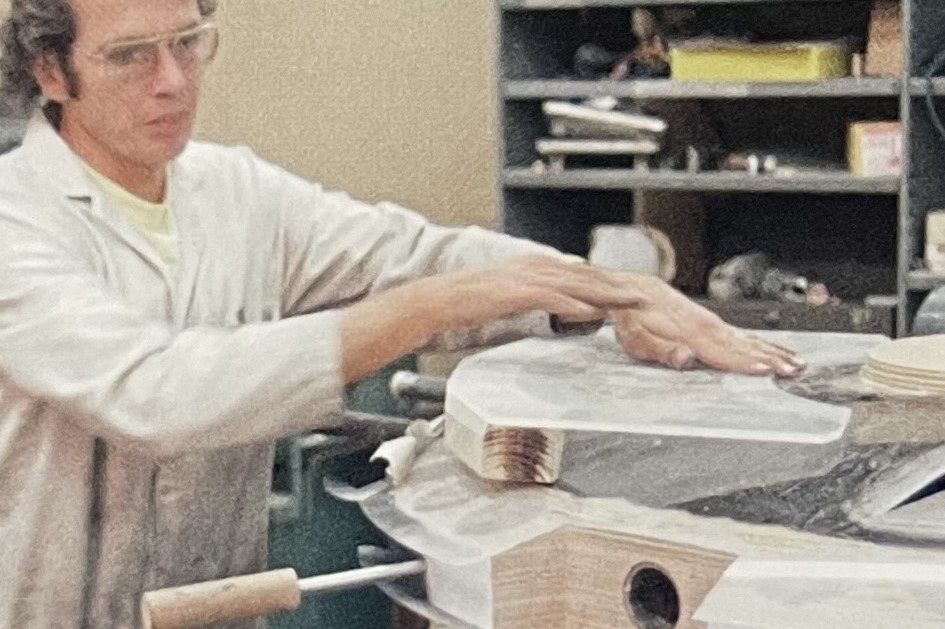

I think there is a possibility that a landing gear was made. It may just not have been used for filming.
Oh right, yes. I forgot about those. I thought those holes were just covered over?
The only photo I've seen of landing gear being created was clearly an Empire Strikes Back BTS photo. Either way, I have no plans for landing gear. I have never seen any photos of LG deployed in its original 'New Hope' configuration, so I'm just assuming they were never implemented.
Good photo though. A handy reminder.
I've never seen a picture of a landing gear either, so maybe I didn't actually make it. However, If the hatch that does not open, it should be enough to reproduce the rectangular mold with a styrene board, but why did they bother to make a rectangular hole in such a think acrylic plate? I like to fantasize about these things. lol
