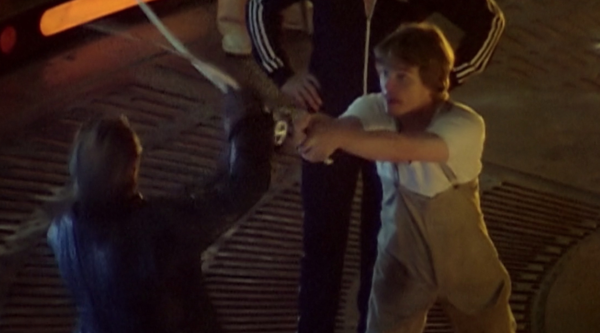

I didn't notice this before, but it looks like Bob Anderson's blade is thicker than Luke's.
All of the blades in the archive are very similar dimensionally, but perhaps different types of antennas were used for filming?
thd9791
Motion can play tricks on the eye, Bob and Mark have almost identical blades in that walk-through in the carbon chamber.
Post#364
Some blades are white, and some rehearsal sabers that are "older" in a sense, have damaged dark blades that seem to have never been replaced in those few years
Post#364
You may be right!
The blades in the archive vary in coloration, and some have reflective tape wrapped around, and some don't.
thd9791
I take some of that back - I rewatched empire of dreams and the clack of Bob and Mark's blades snap back almost instantly... I could believe this is like antenna now

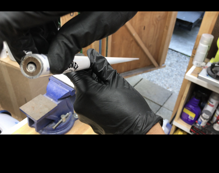

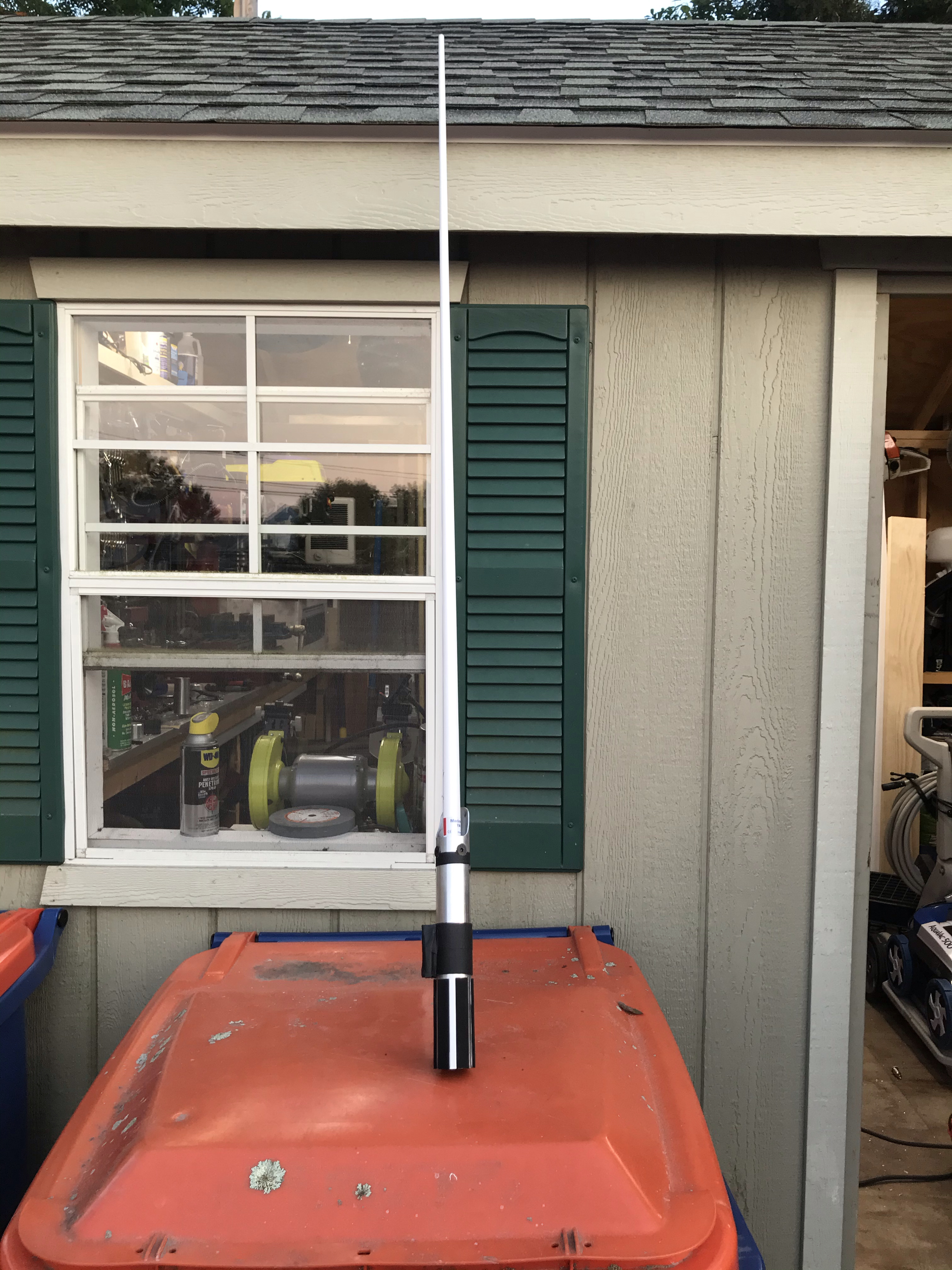

Tom and I’ve work side by side on this, we collaborated on a strategy. How bought the CX-4 on eBay to experiment with, I bought two glomex to do testing with..
I’ve had very little time his week. I’ve been in the shed all afternoon, I smell like a donkeys @$$...
I didn’t make much progress because I didn’t want to cut anything with out toms measurements so we can test the taper, and overall length
My scaling is coming with with 32” but I think the blades are all over the place in length..
I don’t have any time tonight because I got a project with the church I need to finish up with my family.
Tomorrow I will continue the experiments, make another adapter for the other pipe stunt, and begin some dueling
I am SUPER impressed with the flex on these things, I’m in the progress of making a video from unboxing to dueling.. so it’s gonna be a few more days
BUT swinging this in the back yard, whacking the side of the shed and fence, this sucker bends easy! Just like the photos!
The glomex has a brass insert, with a wire running all the way to the top which is hot glued in..
20mm on the bottom, 9mm on the top
