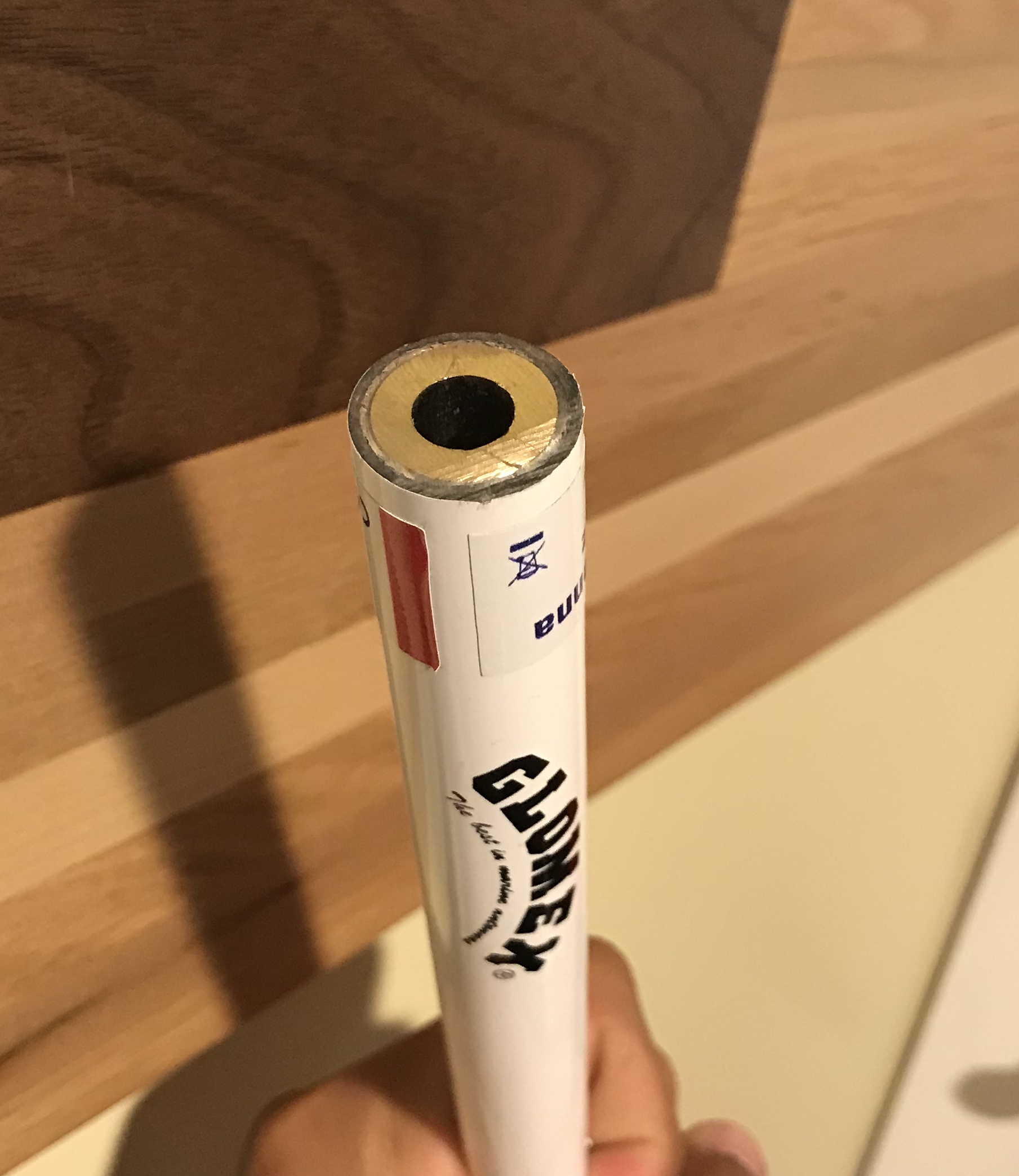

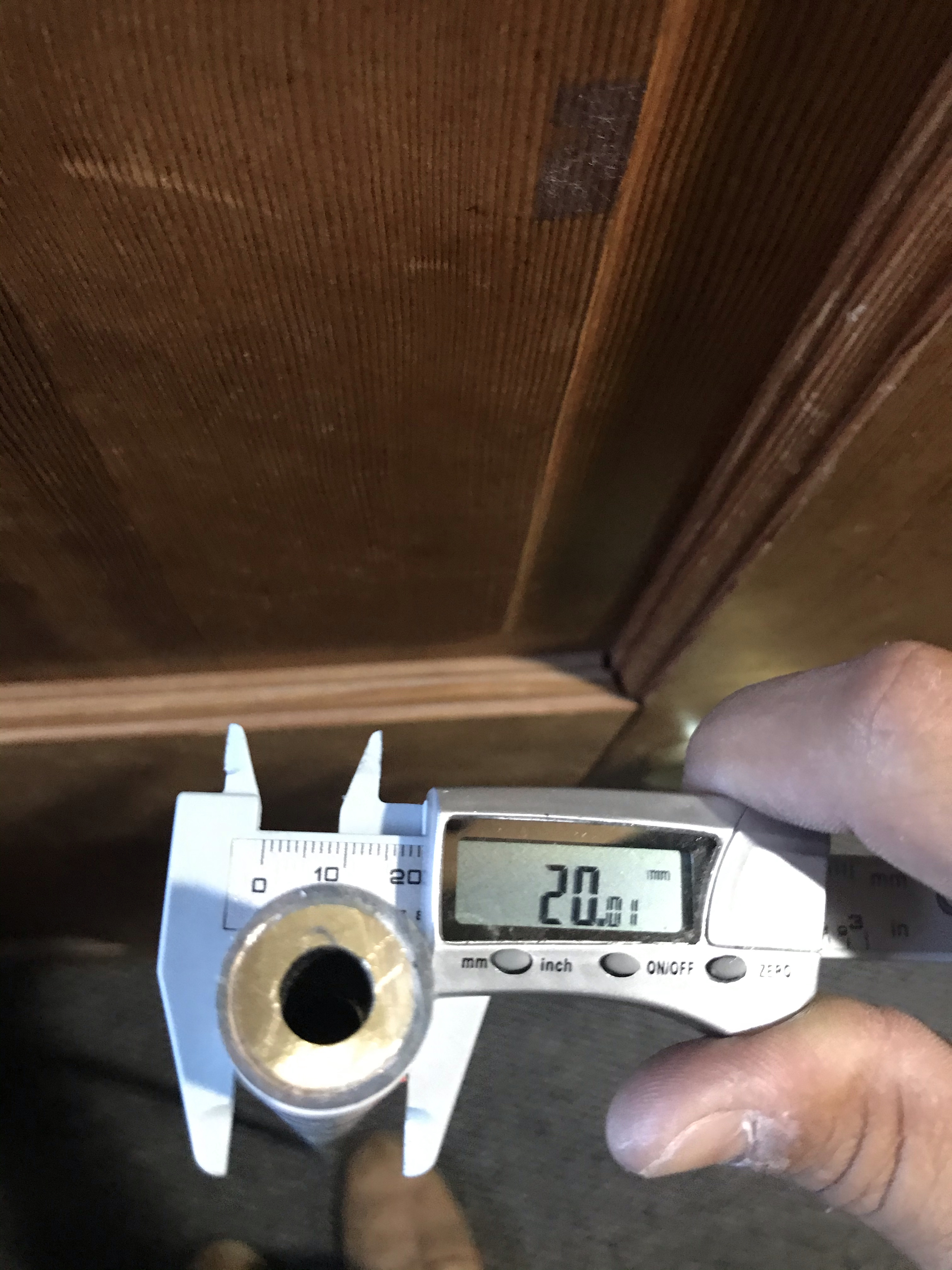

Can you see with a flashlight how far it goes? I mean, youd need a much thinner aluminum tube for the inner spacer if it goes a decent length
I’d have to machine something... this is paper thin.. I’m wondering if a 3D print will hold it good enough..

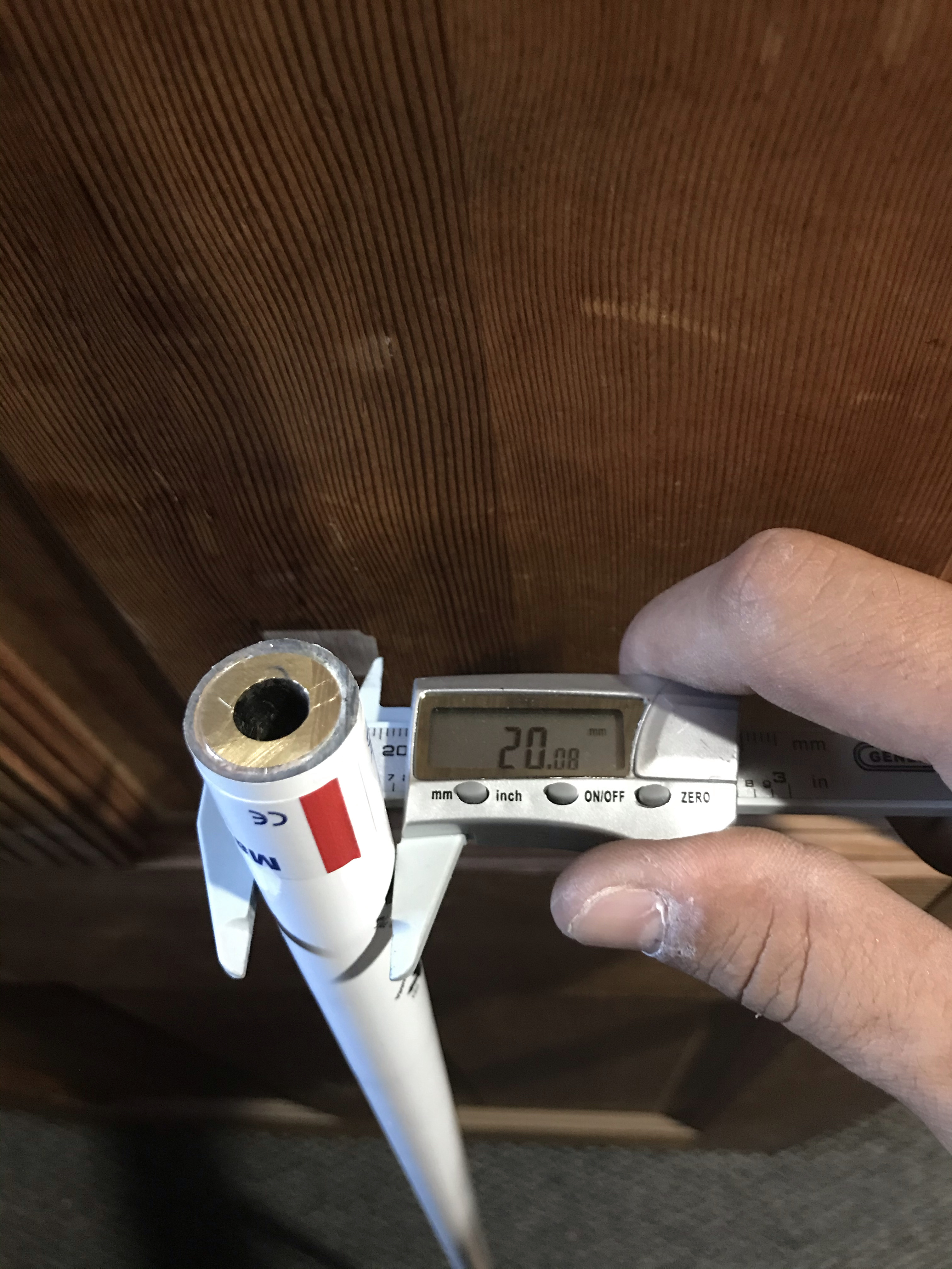

Thats not bad, i mean for display. For dueling I dont know the length of the tang - i realized these are tapered which means the inner sleeve would have to be tapered too?!
Doesn’t seem mine is tapered. She stays the same diameter for awhile before the taper
Are we saying the inside of these fiberglass tubes isn't tapered from the base? Vadermania's sure looks like it is. I would think the changing thickness down the blade means theres less space to take up further in, which means we can't just stick a piece of round stock in there
She doesn’t start to taper until 2” down

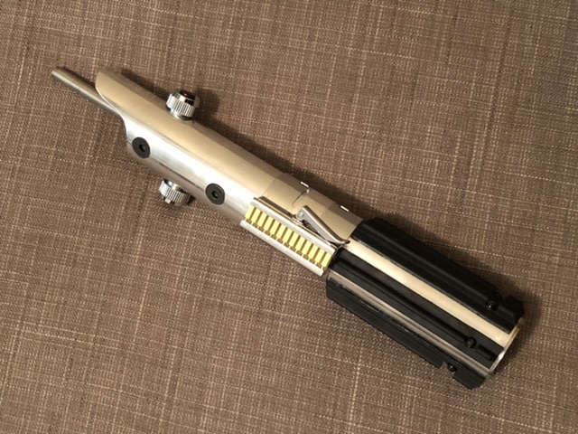

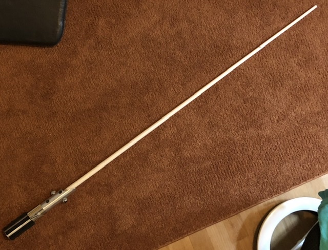

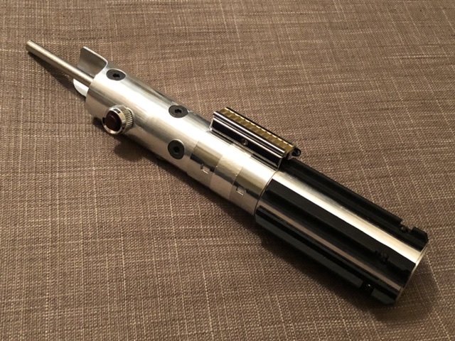

Spent some time in the past couple of days building an ESB style Graflex stunt saber for my antenna blades. It‘s not a precise replica of an existing stunt saber. I have used what I found in storage (rubber T-track, ESB replica clamp card etc.) plus an aluminum tube and inner core.

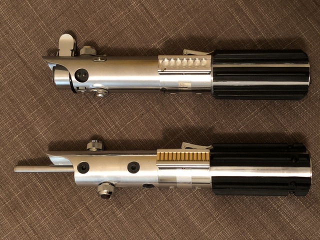

Together with my real Graflex:
that looks really cool! is it pretty sturdy?
very nice countersinking, clean job

So, I removed my ski pole and wrapped gaff tape around my first tang (ignore that it's a threaded rod, my first core was tapped, I now do mild steel rods) - This is the AC Antennas CX-4 AIS, which might be rather similar to their current CX-4 I've heard
I kind of want to cut it a little shorter
