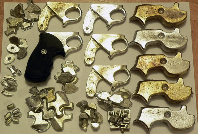

And for the main event of the evening:
Well... here they are. Pewter castings of all the Jubal Early parts. These are straight out of the molds with only the sprues cut off, which is why they're all burnt and yella'. You'll also notice that some of the parts (like the main body) are quite rough. Good thing I went and got some sanding, grinding and polishing tools today. (Sidkit parts they ain't.) Sadly the mold for the main body went bye-bye after five castings and the others began to show signs of heat stress, so there will at most only be five of these things and that's assuming I don't screw anything up. Luckily, pewter is easily filled in and repaired. I was hoping to get a least ten pulls but alas, it was not to be. I am very pleased however, that the trigger guard and handle fits perfectly into the Pachmayr grip.

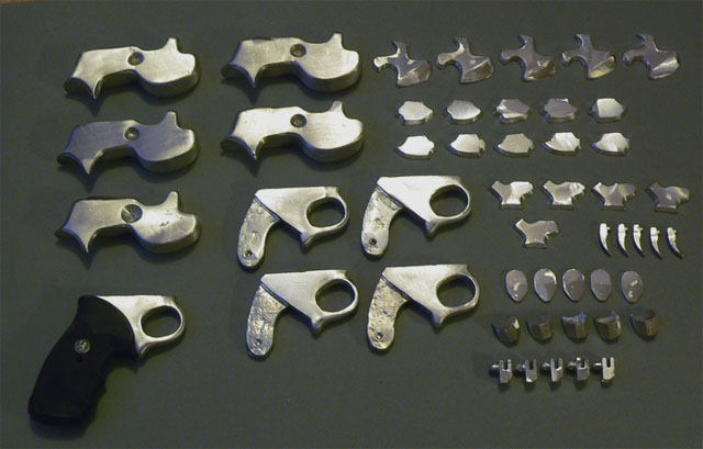

Well, I've just spent a day and a half grinding, shaping and buffing the Early pistol parts... man it's been a lot of work and I've gone though a lot of buffing/sanding tools so far. My hands are all numb and shaky after holding the Dremel for hours on end... even to the point of my finger-muscles "vibrating" by themselves when I tap something! :eek But now I'm finally getting close to "final assembly" stage. (Oh, and for those that want a set of parts... check the JY.)
Here are the parts after a couple rounds of cleanup:

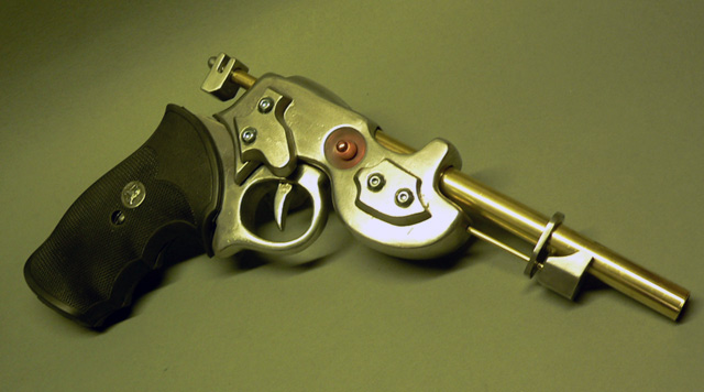

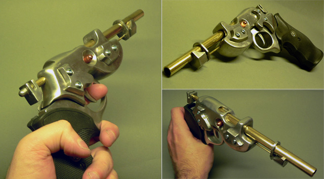

the first Early pistol is DONE!
Whoa... I'm feelin' all sorts o' pleasin' right now. The first Jubal Early Pistol is now complete!
I gotta say... I had my doubts about this project. I had a hell of a time getting good castings and I ruined more than one part on the way. Now, I usually try not to toot my own horn but today, when I picked up the finished gun I got kind of a "wow" feeling. It might not be perfect, it might not be cast directly from a screen used... but it's heavy and the metal makes it feel so right. I left the finish a little "rough" as I imagine an old Colt would be. Not a "dirty" weathering like Mal's pistol... more like a "been through hell but has always been lovingly cared for" look, which I thinks kinda adds to the realism.
Anyway... here are some pics. This puppy will be crossing the pond in the next few days to be with it's new owner (a fellow RPFer).
