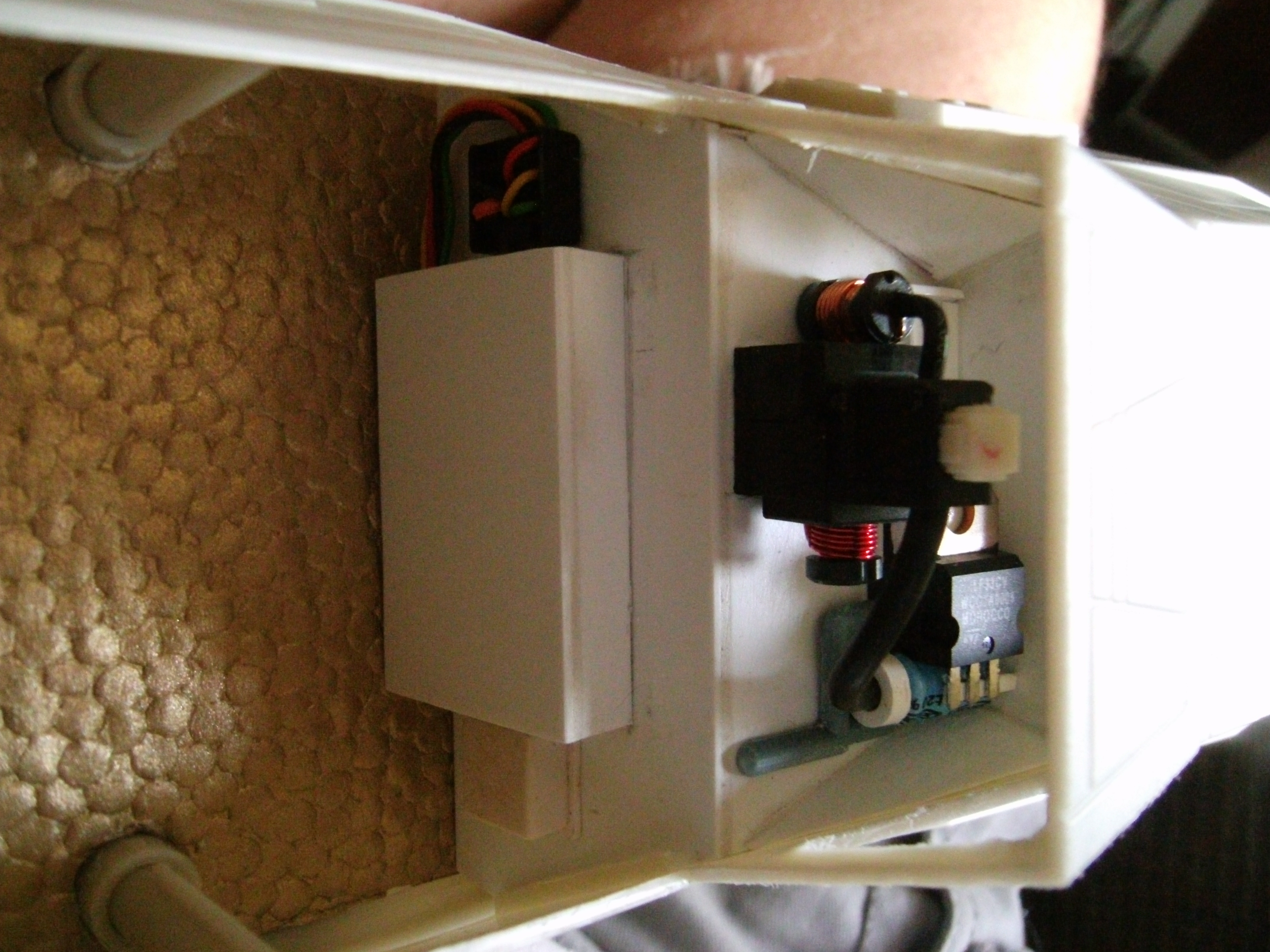

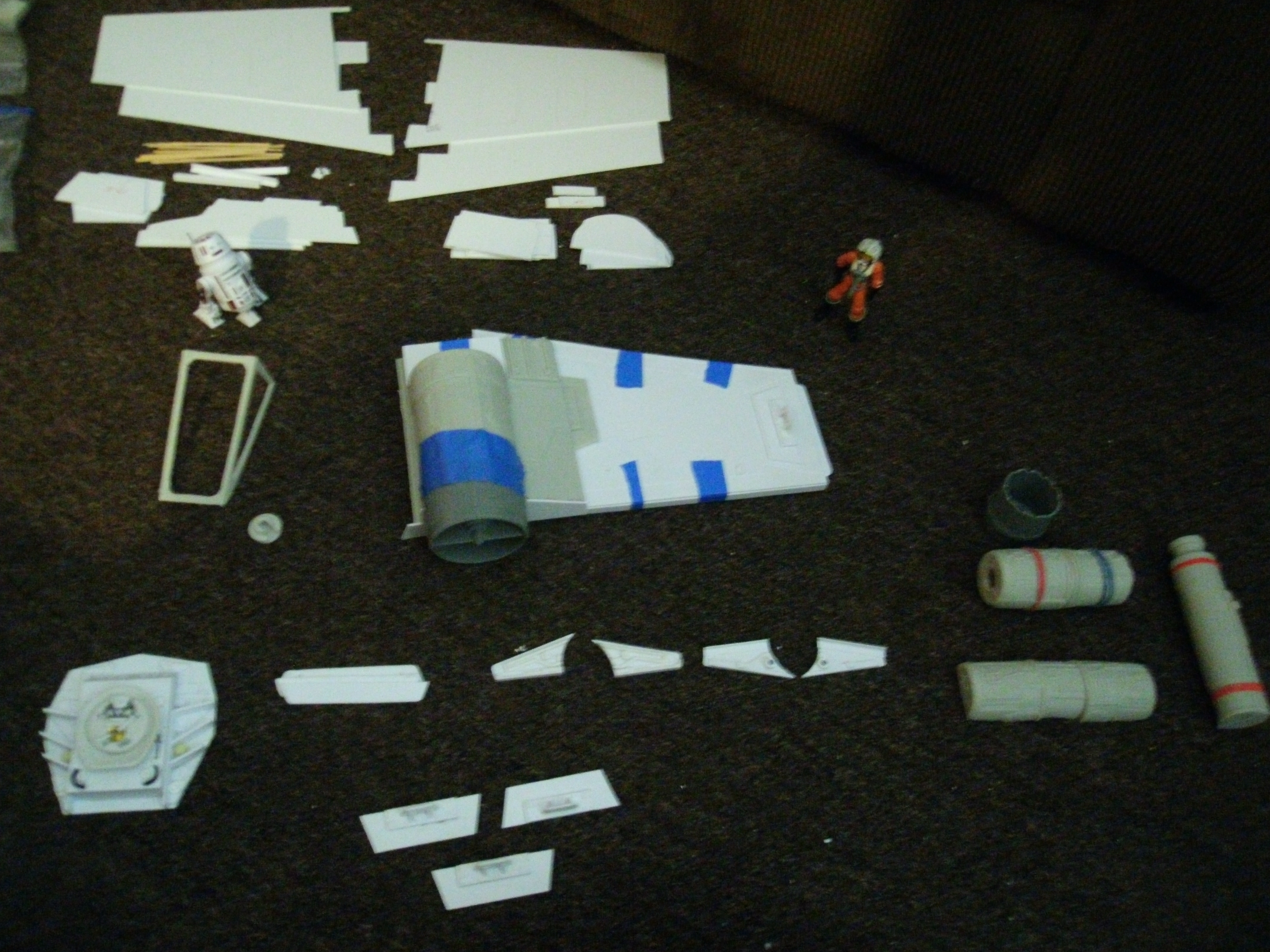

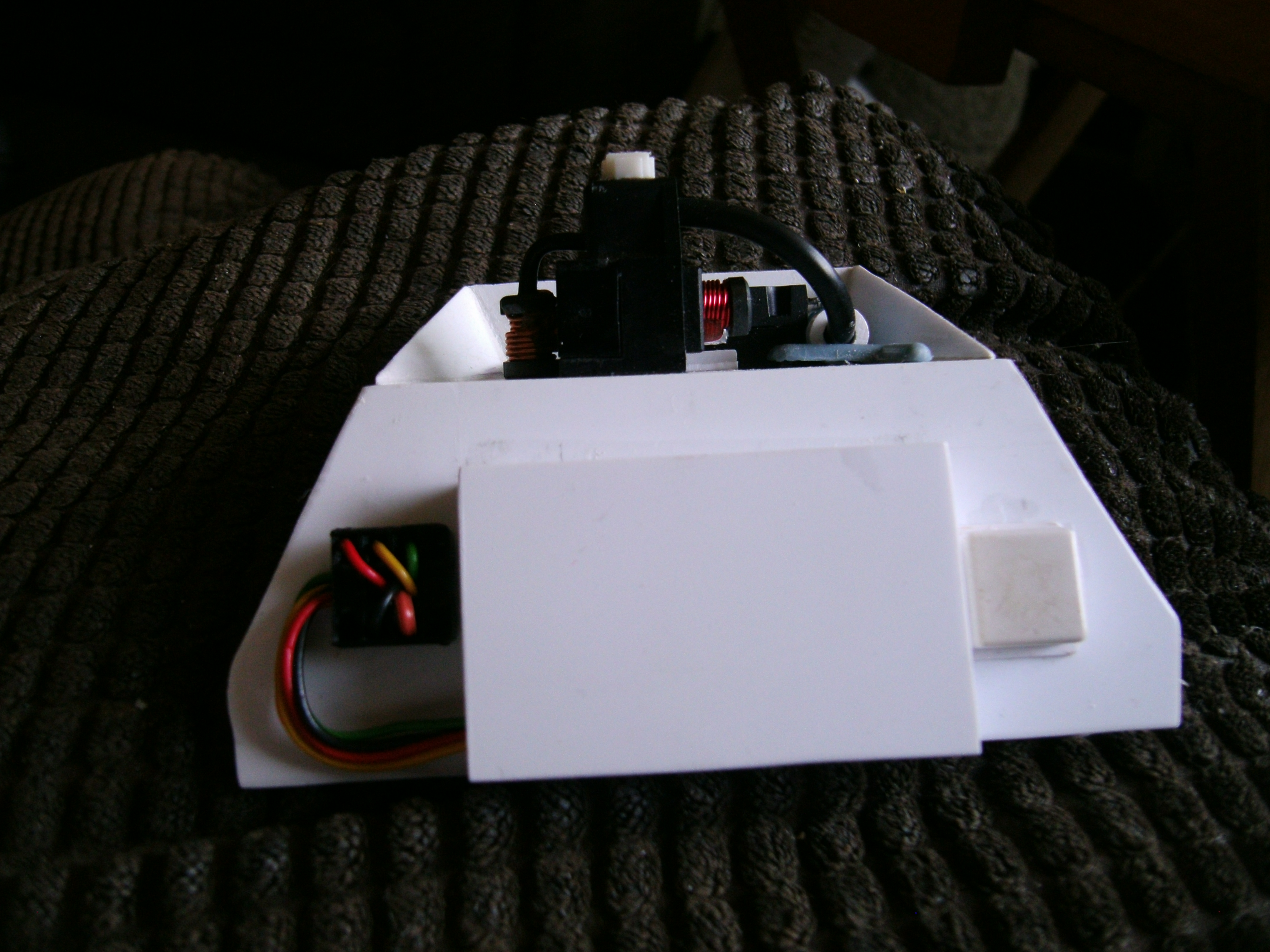

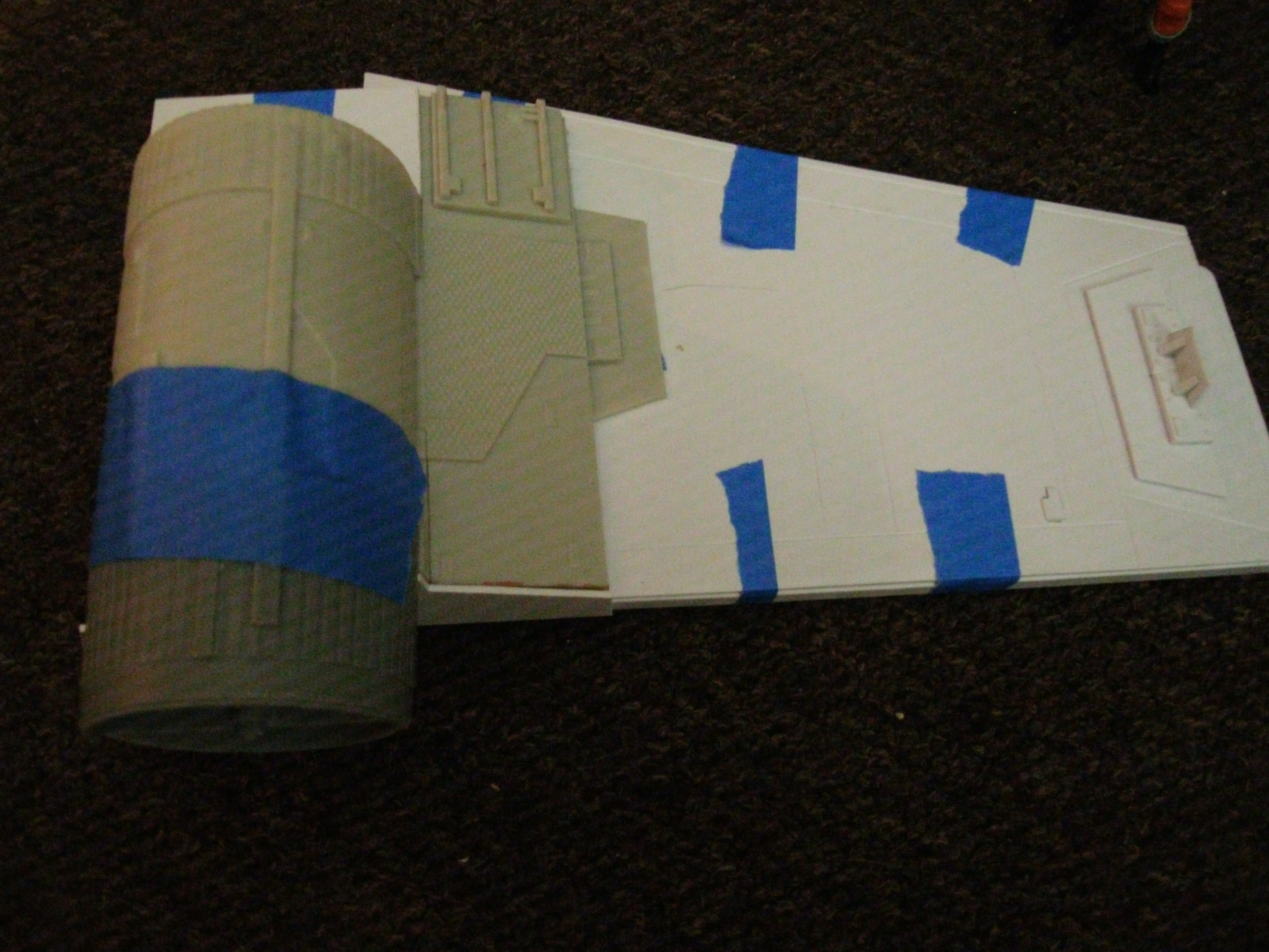

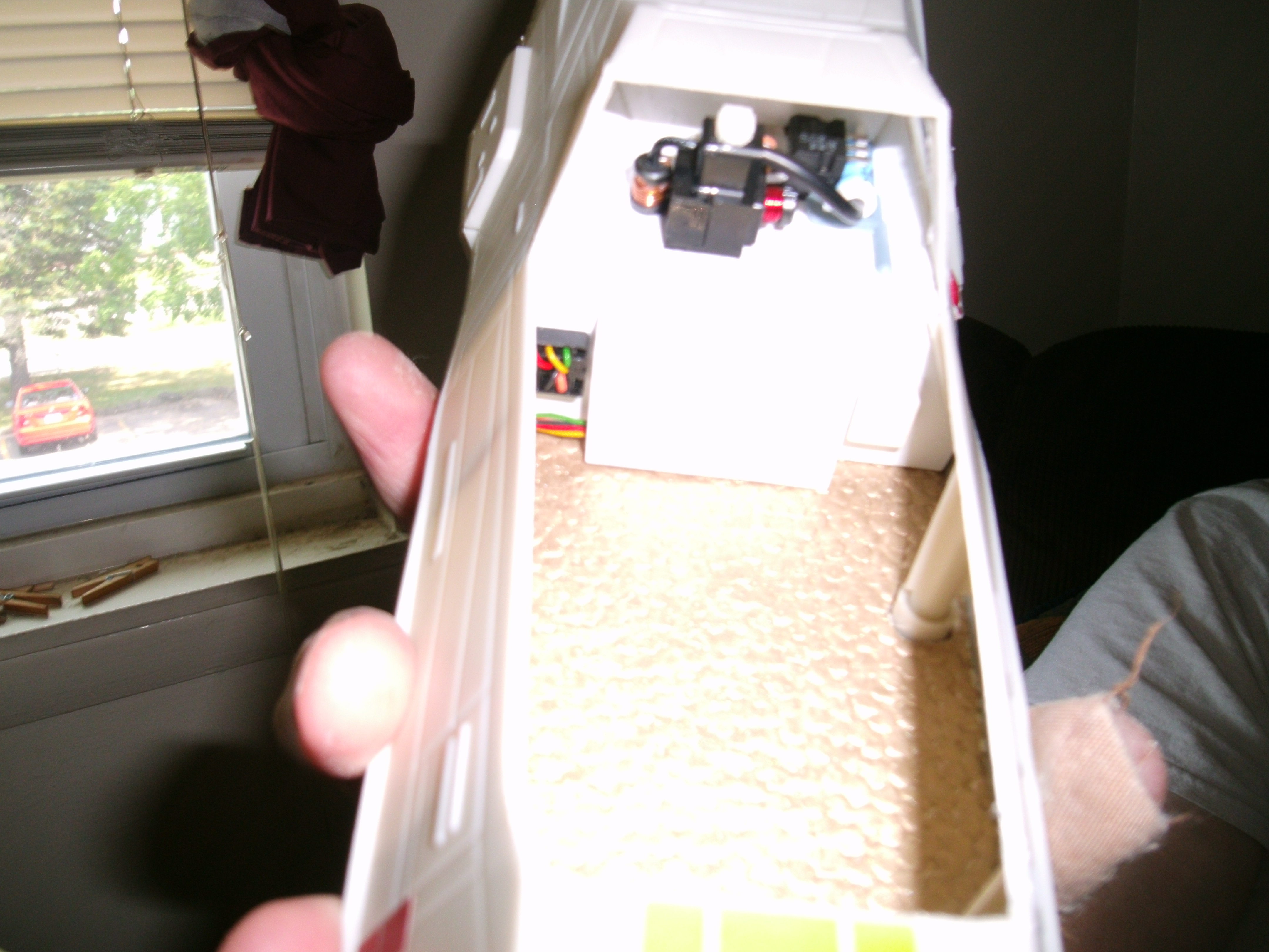

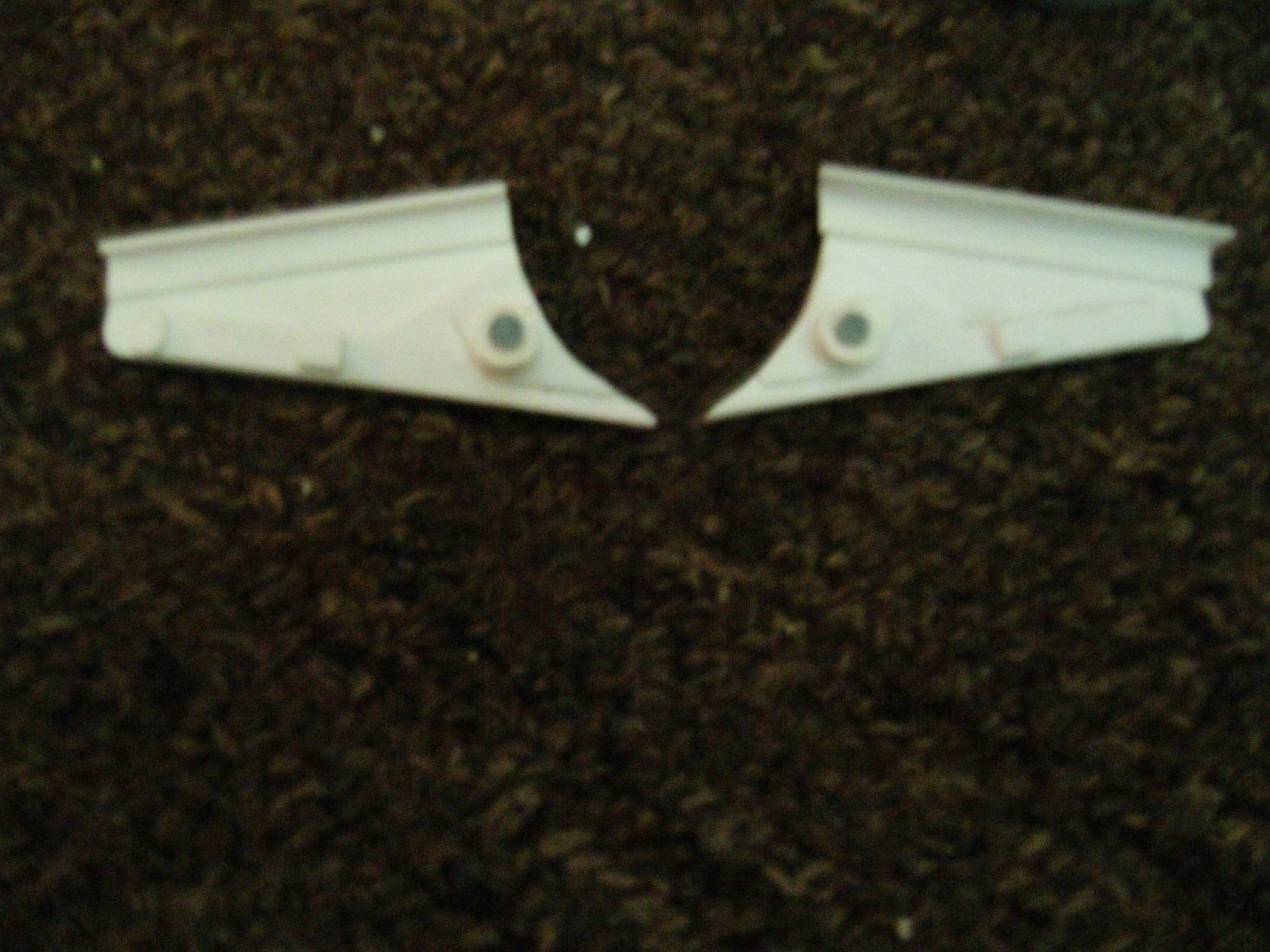

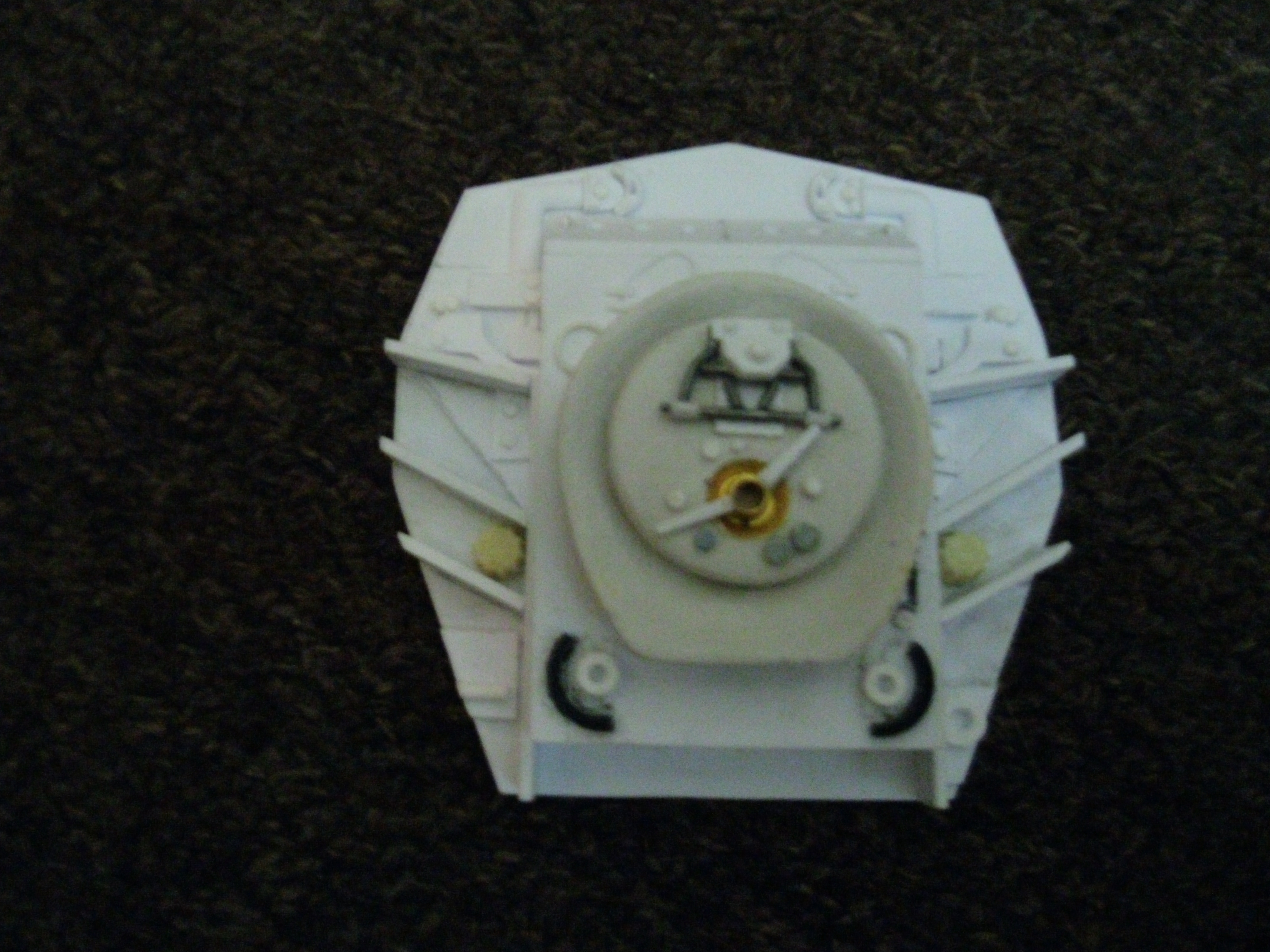

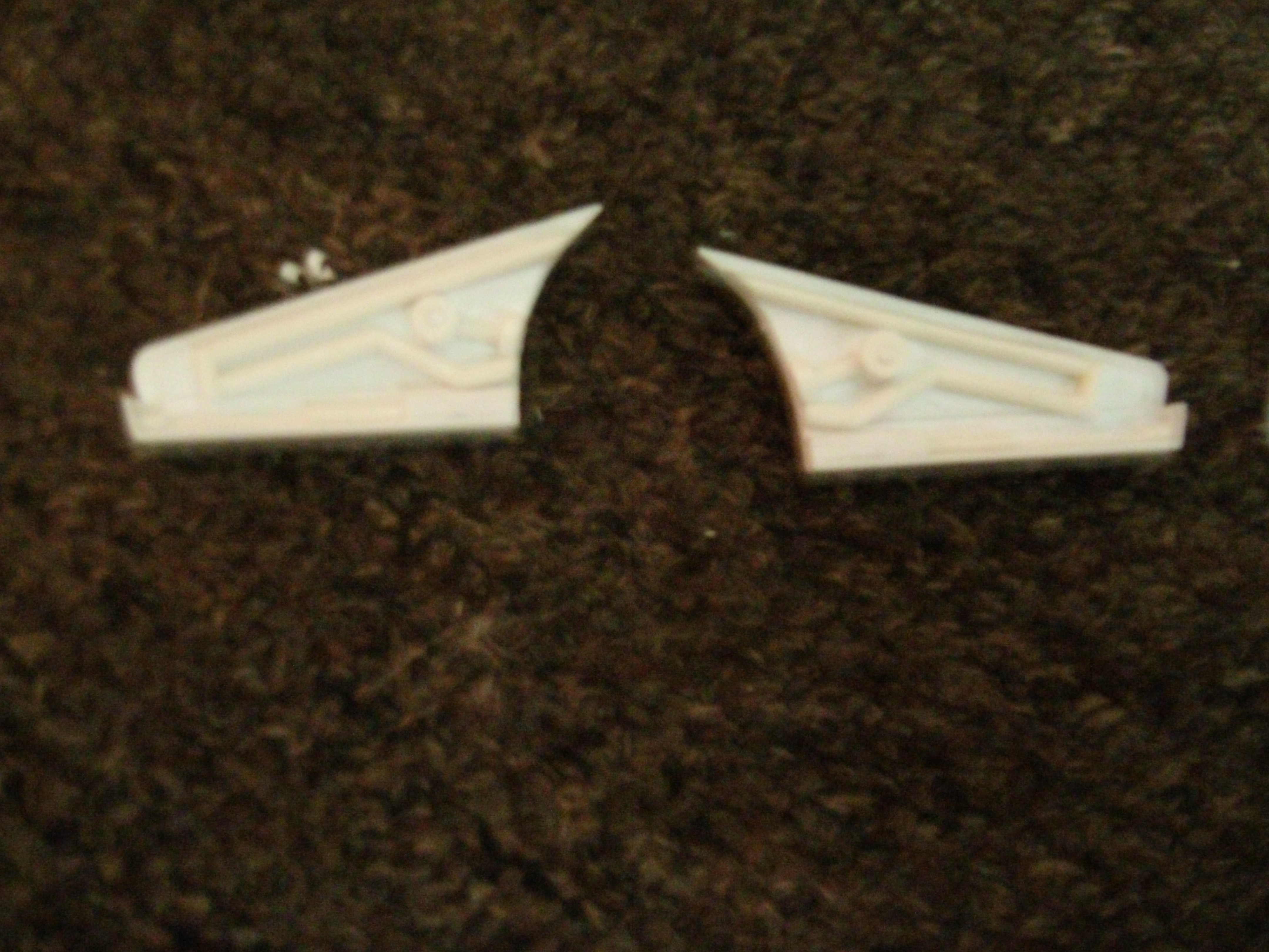

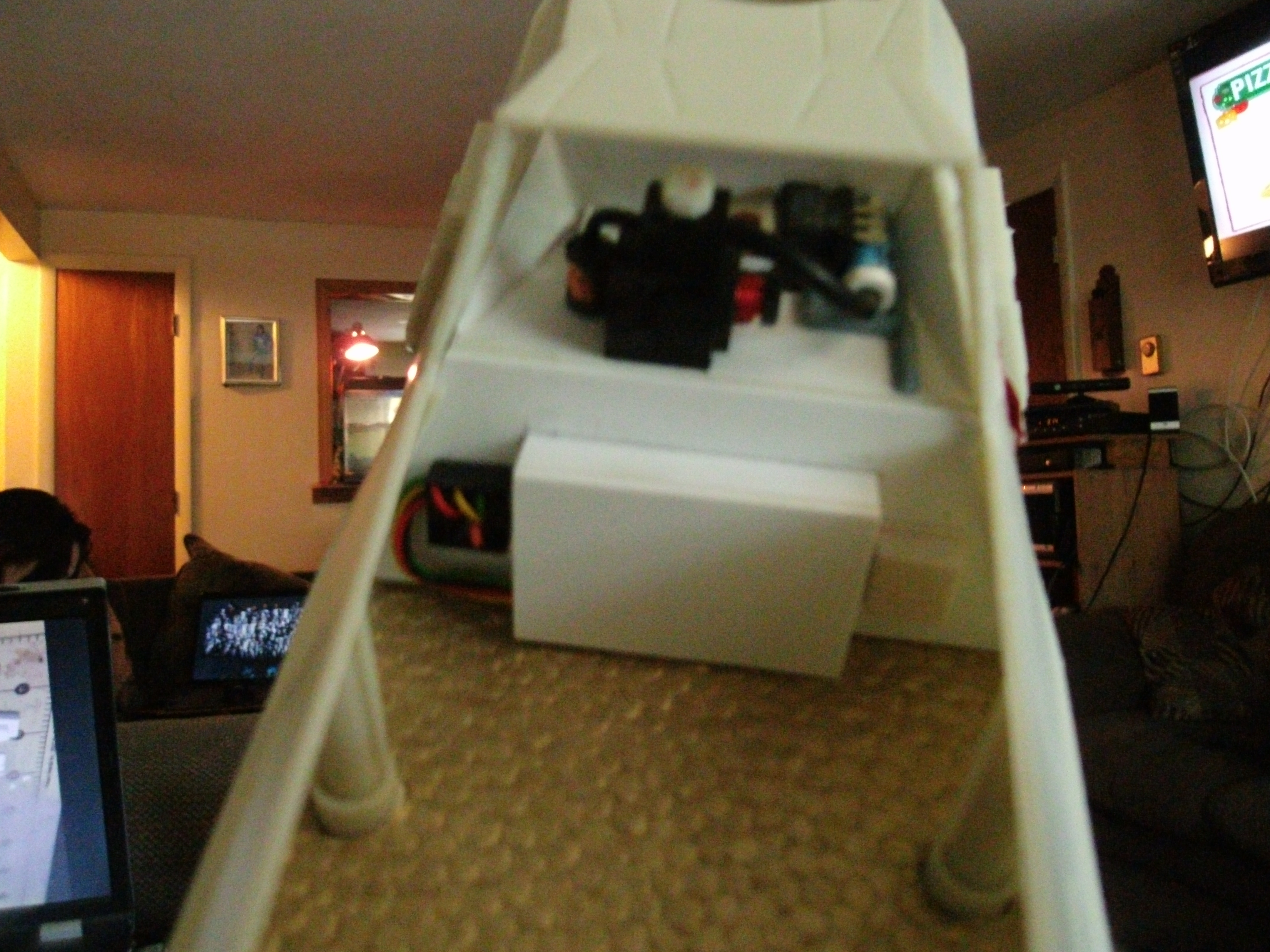

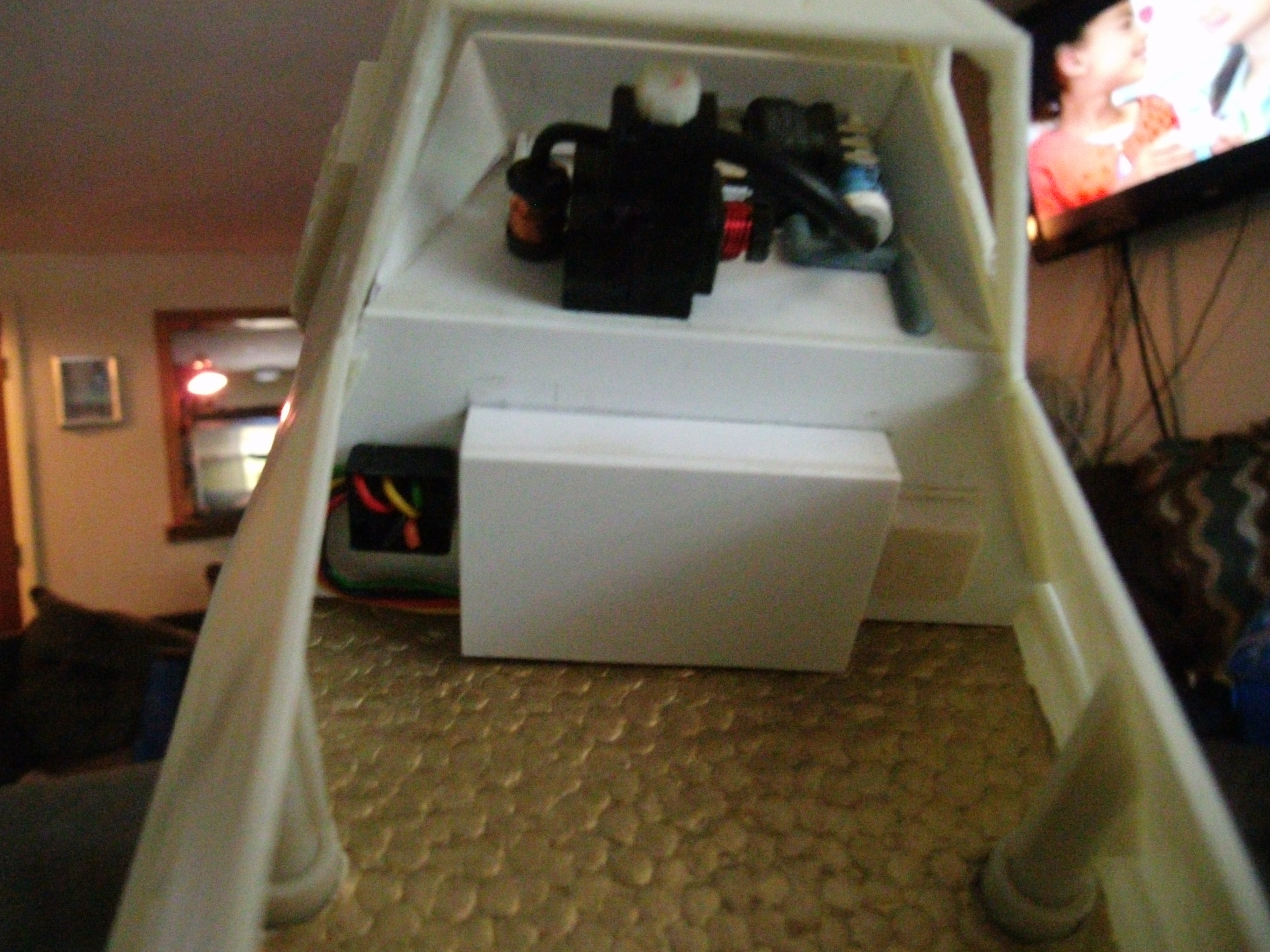

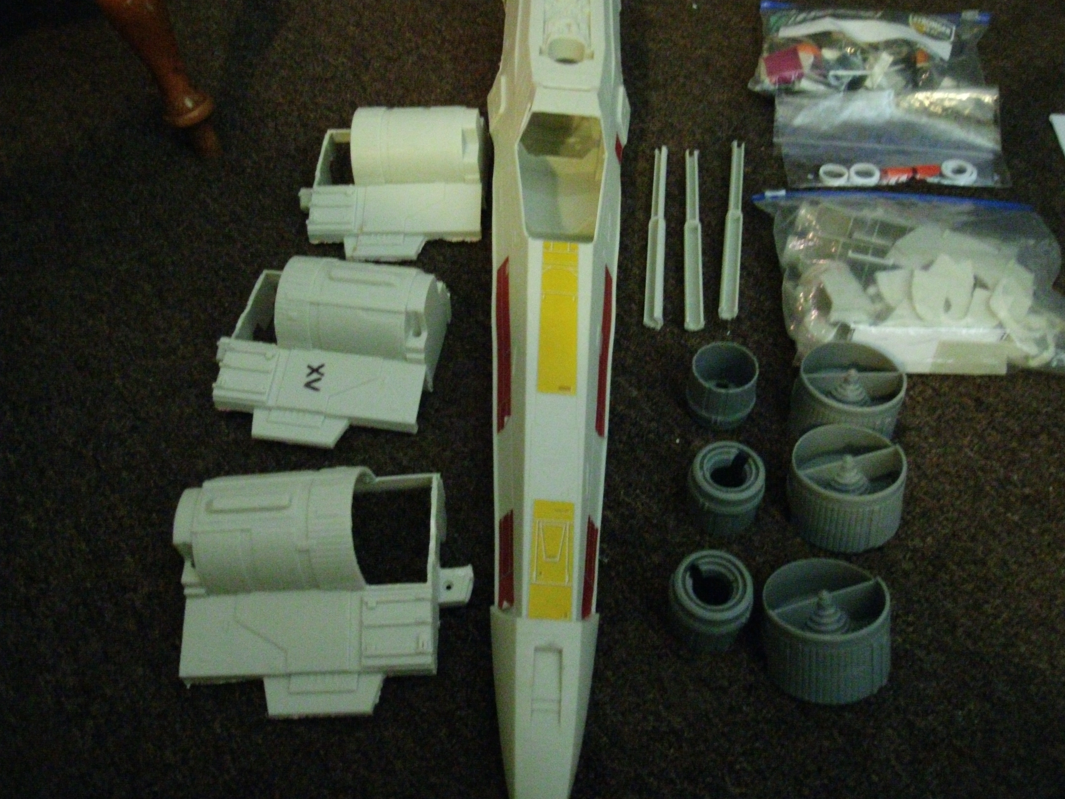

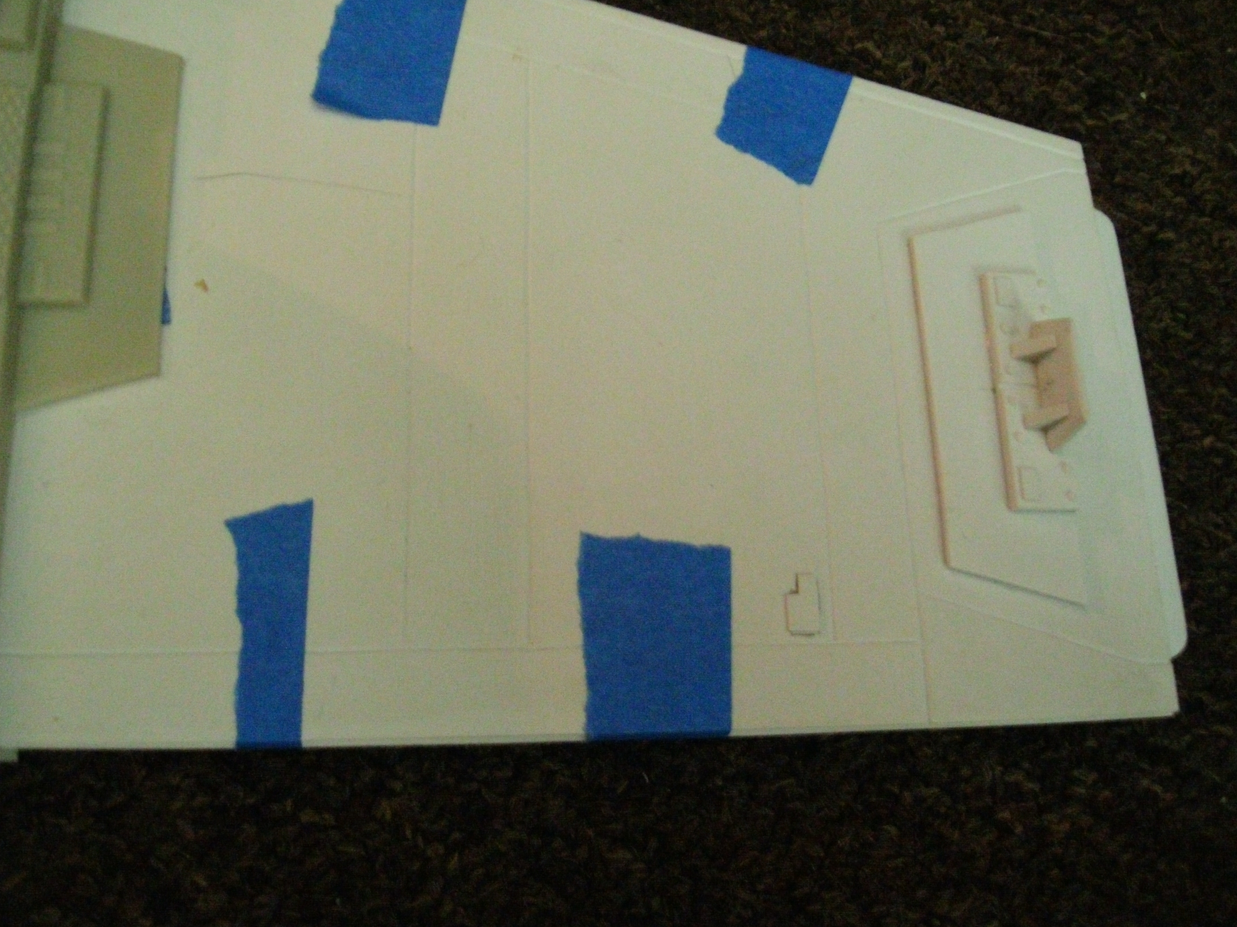

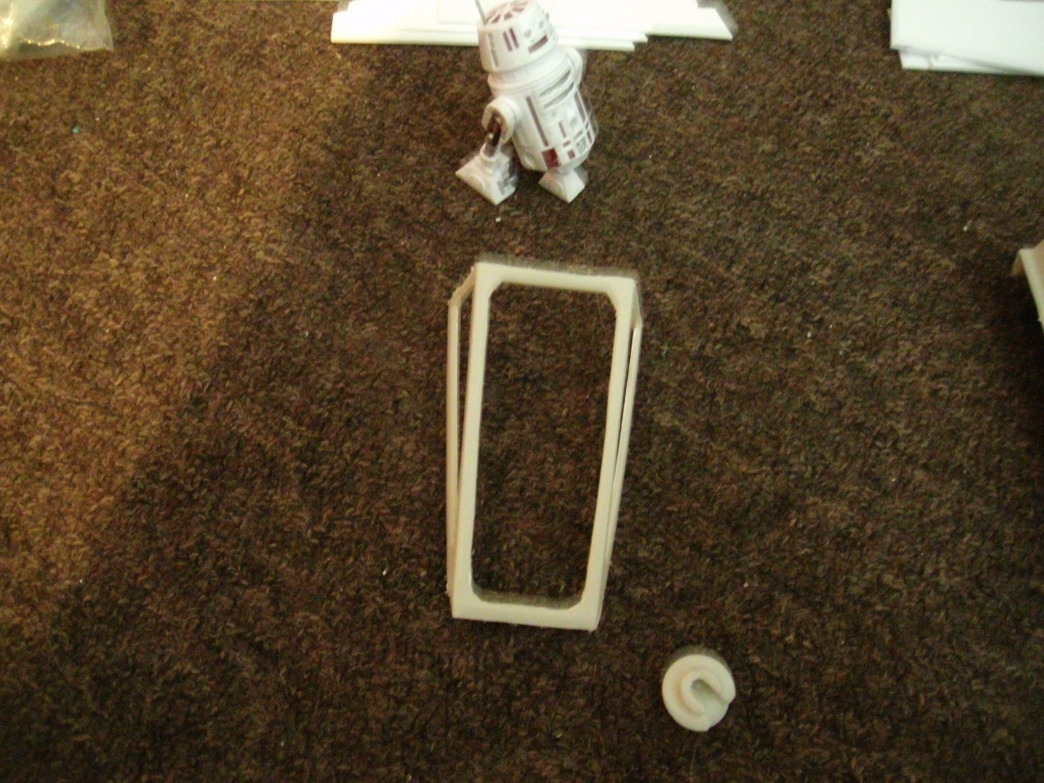

Ive ben following your work and rescently got my fighter here's some pics of my work so far.Ive ben copieing your work and adding a few things hear and there.Hope you don't mind ?
GEDC7763.JPGGEDC7760.JPGGEDC7762.JPGGEDC7764.JPGGEDC7765.JPGGEDC7766.JPGGEDC7767.JPGGEDC7768.JPGGEDC7769.JPGGEDC7770.JPGGEDC7771.JPGGEDC7772.JPGGEDC7773.JPGGEDC7774.JPGGEDC7775.JPGGEDC7776.JPG
Re: Pcoz's Hasbro Hero Star Wars X-Wing Conversion
Ive got three more wings to build as you can see im trying to build duplakits of my parts so i don't have to later . And i will have to start thinking about making molds for my engines and my lazer cannons as well .Then i come on your page 2day and see your work on your cockpit cant wait to start that as well . Im going to be lighting up the cockpit and the engines any recomendations on lighting kits? I think you recomended Ic 2000 to glue the 2 difrent plastics 2gether correct? The toy plastic and the evergreen plastic from hobbie store.

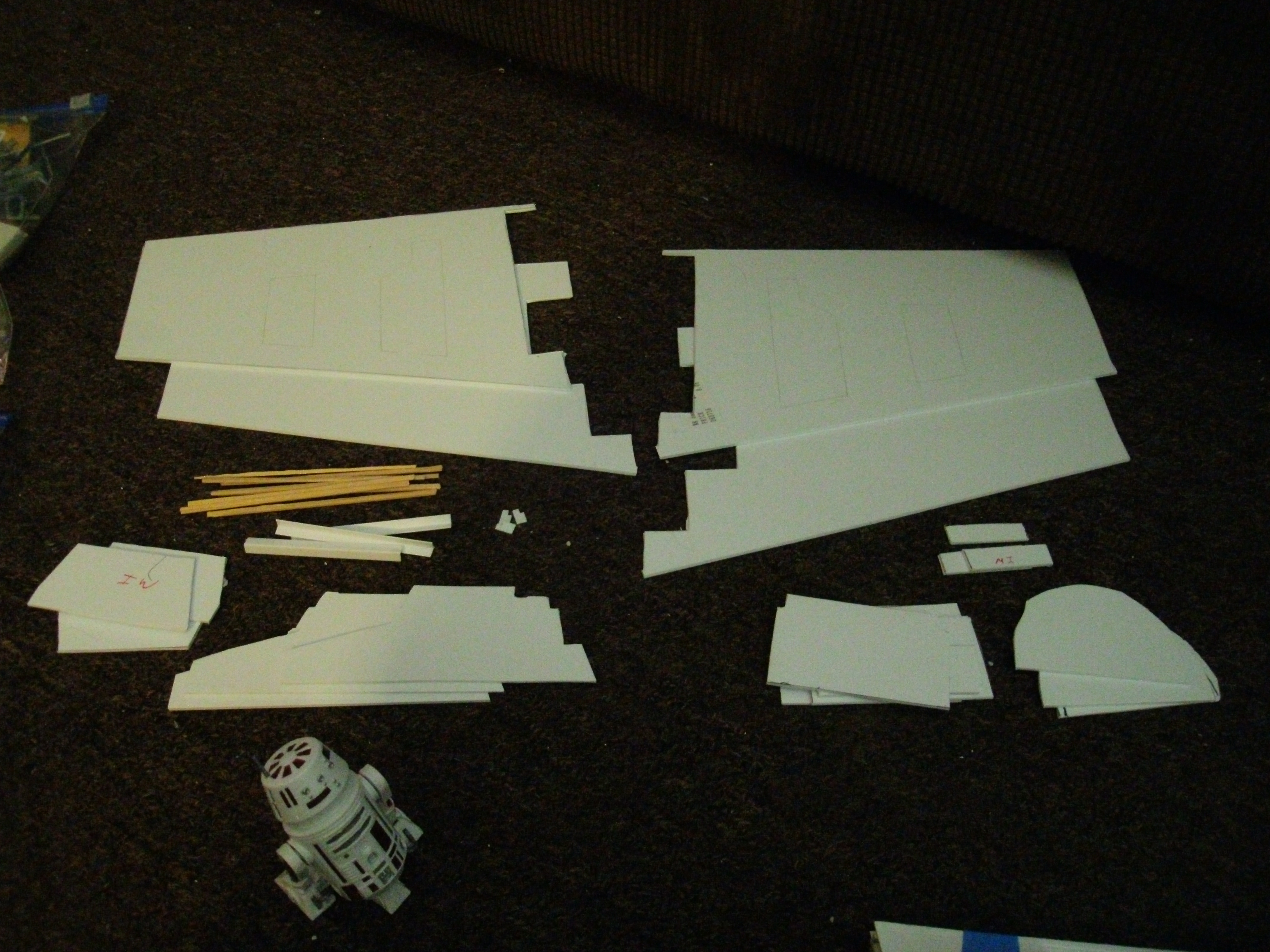

Do you have the dementions of the main blocks of wood for the x part of the wing as well as the add on pieces ?

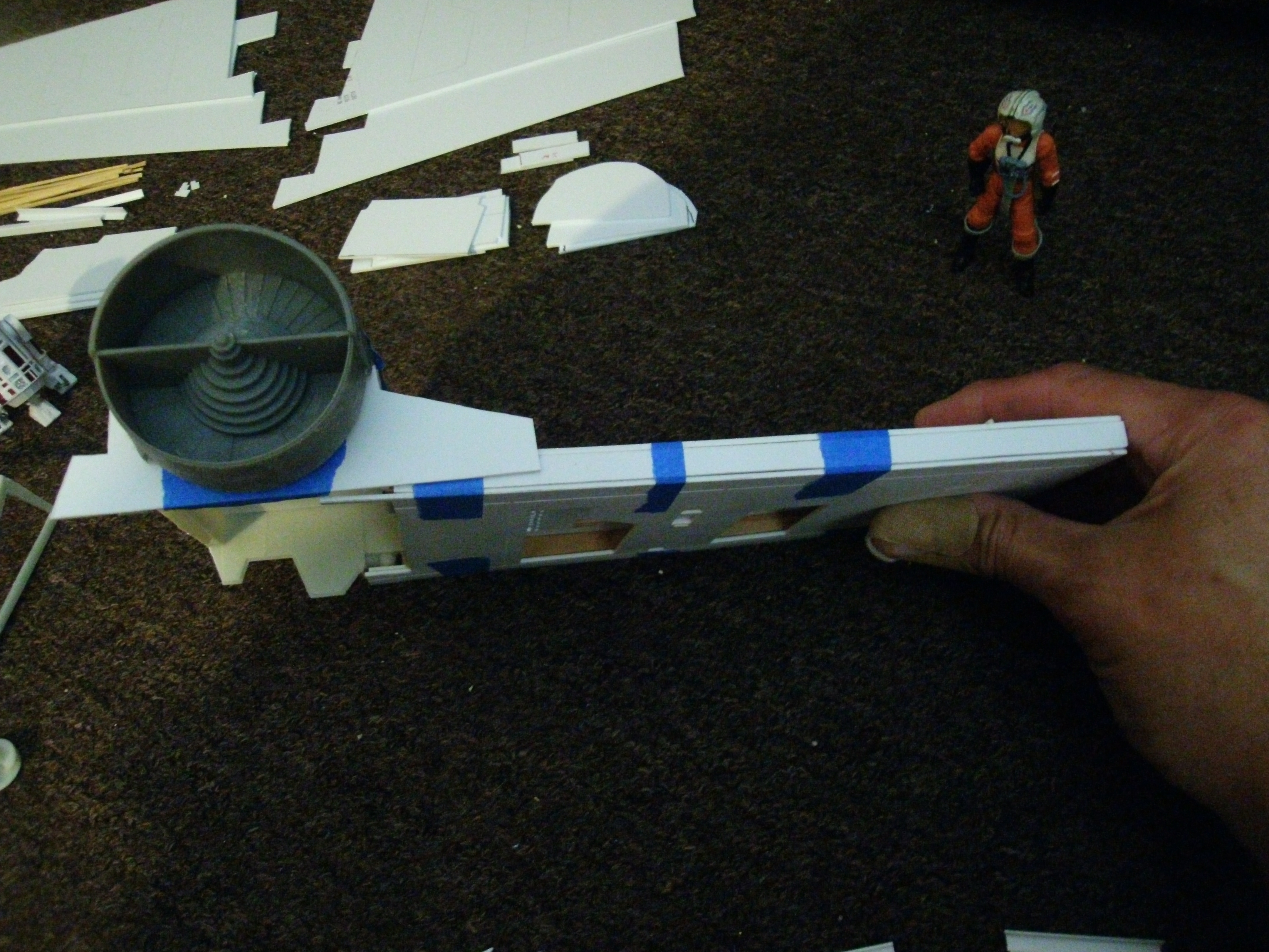

The added pieces the 15 degree ones i need more info on how to make those. The length , I got some of what i need from your pics but in some it looks like you did something to the 15 degree blocks later in the build.and if you have more pics of how the wings attach to the blocks ? And for the engines what brand of mold making did you use and what liquid plastic for parts ?Thanks Troy
I went back threw your pics. and saw you used wooden dowels to mount the wing so that answers that question.
Yeah Troy, I kind of messed that up....I should have thought about supporting the wings early in my build. I ended up using wooden dowels on the bottom since there wouldn't be as much stress. The top wings, I used aluminum rods for greater rigidity and support since there will be more stress holding the wings upwards. I would recommend some type of aluminum or metal angle iron to complete this task. Also, if you could support 2 wings all the way through might be better...i.e. top right attached to bottom left.

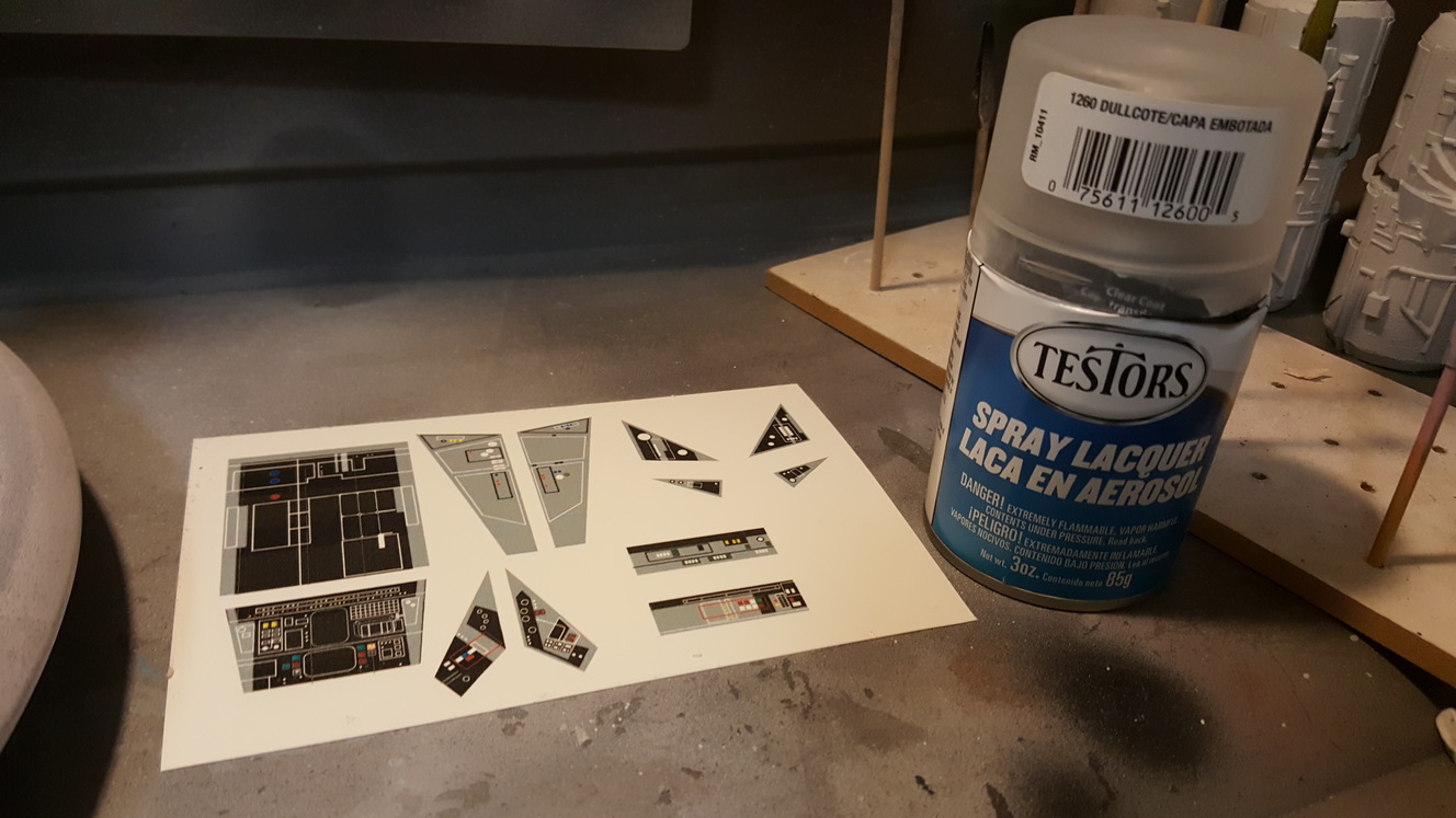

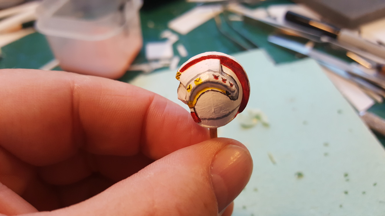

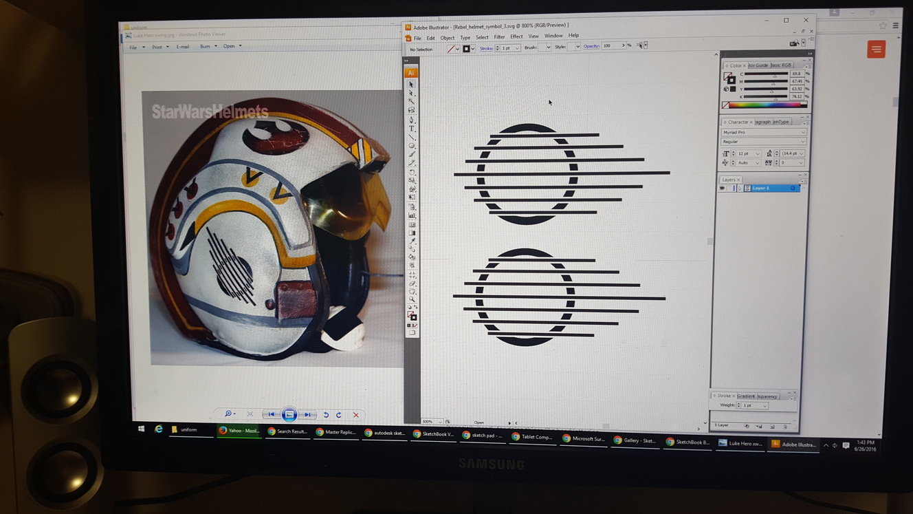

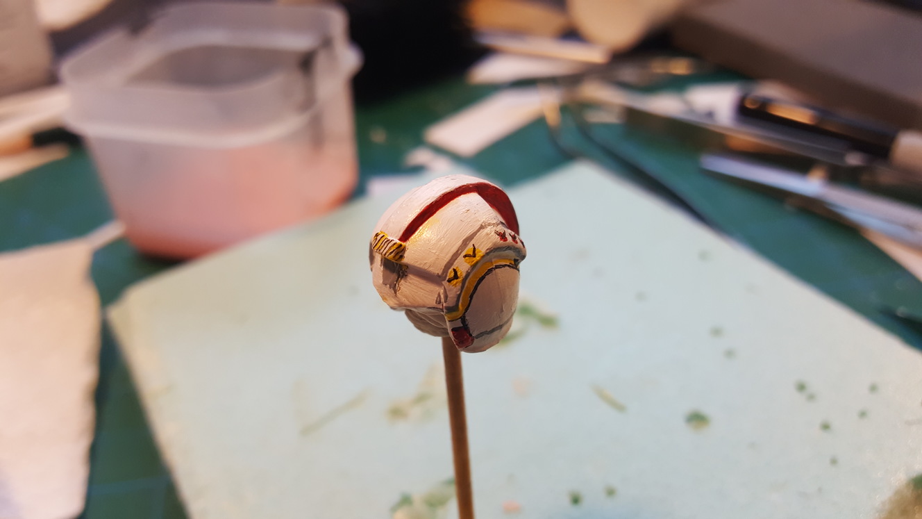

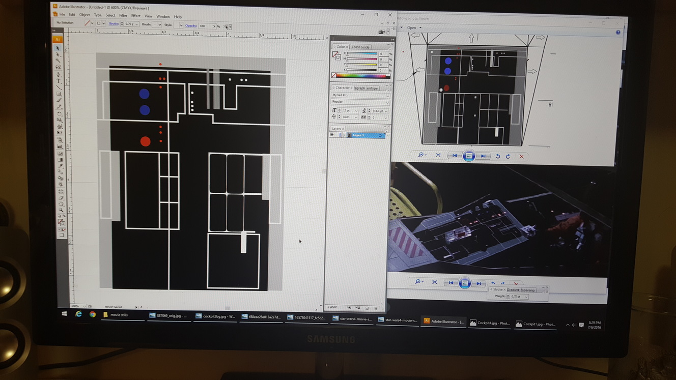

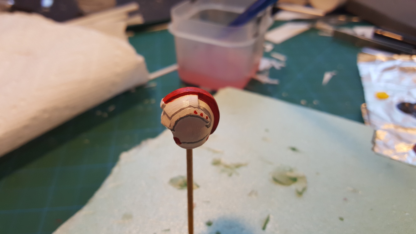

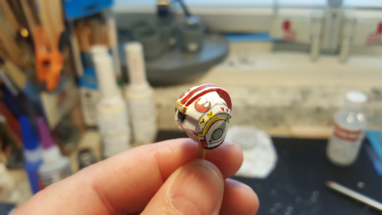

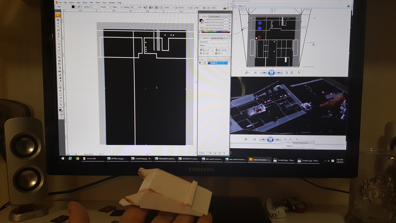

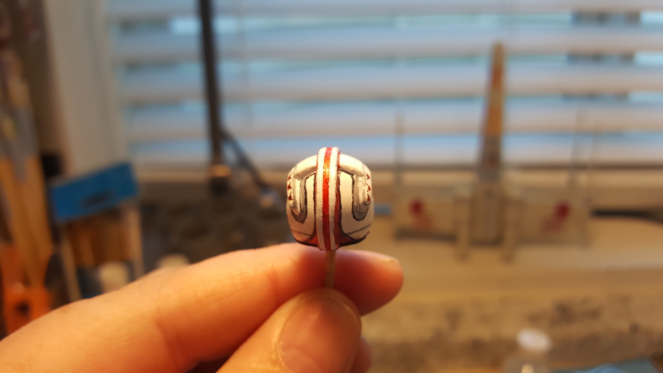

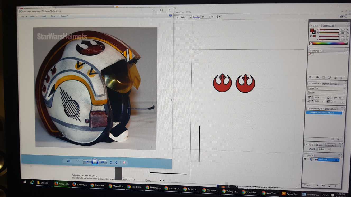

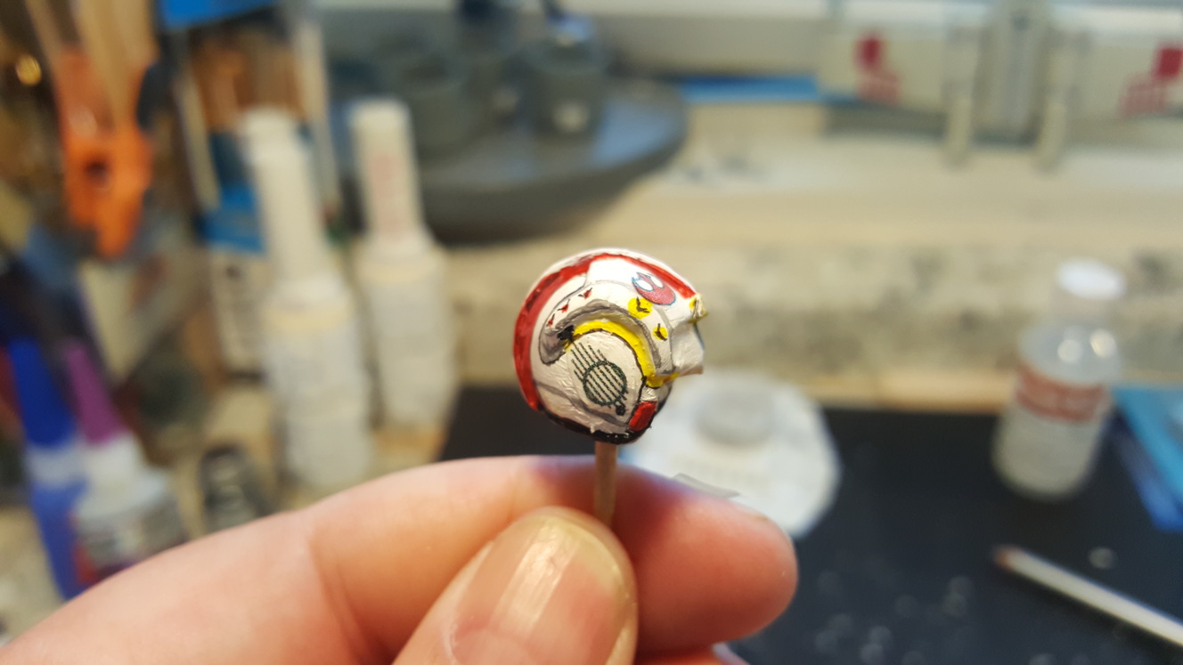

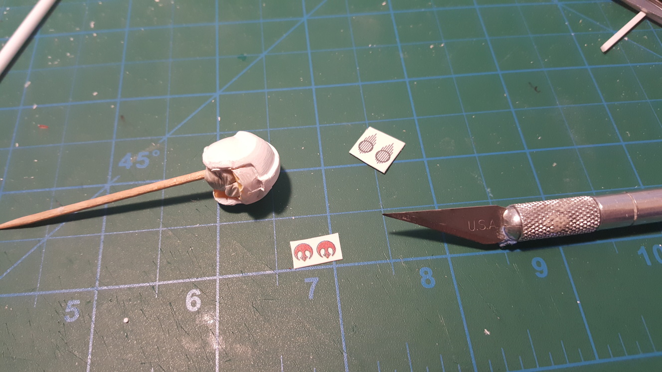

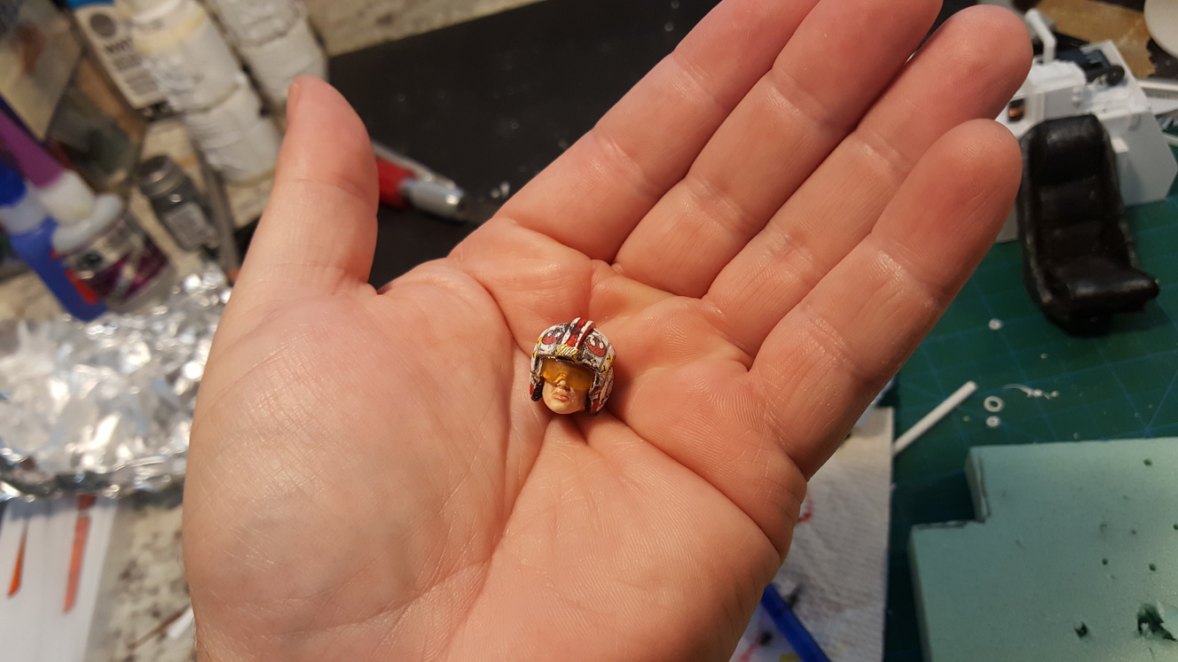

Looking at repainting the helmet and I realized there was no way I could hand paint the details and have it look good.

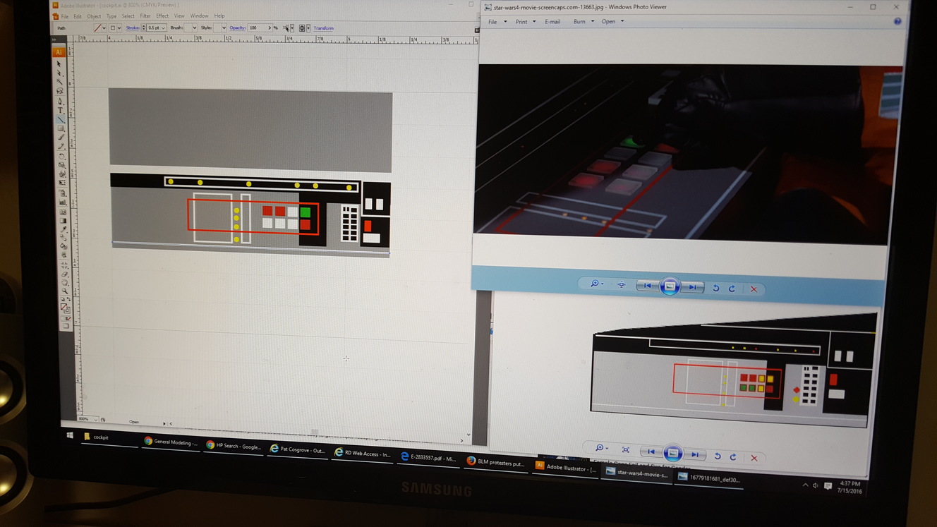

Hopped on Illustrator and created some graphics
Printed them out on clear decal paper and sealed them with Dullcoat
Hand painted what I could and applied decals
20160626_180057.jpg 20160626_183617.jpg 20160626_183641.jpg 20160626_184451_001.jpg 20160626_185742.jpg 20160626_185749.jpg 20160627_183613.jpg

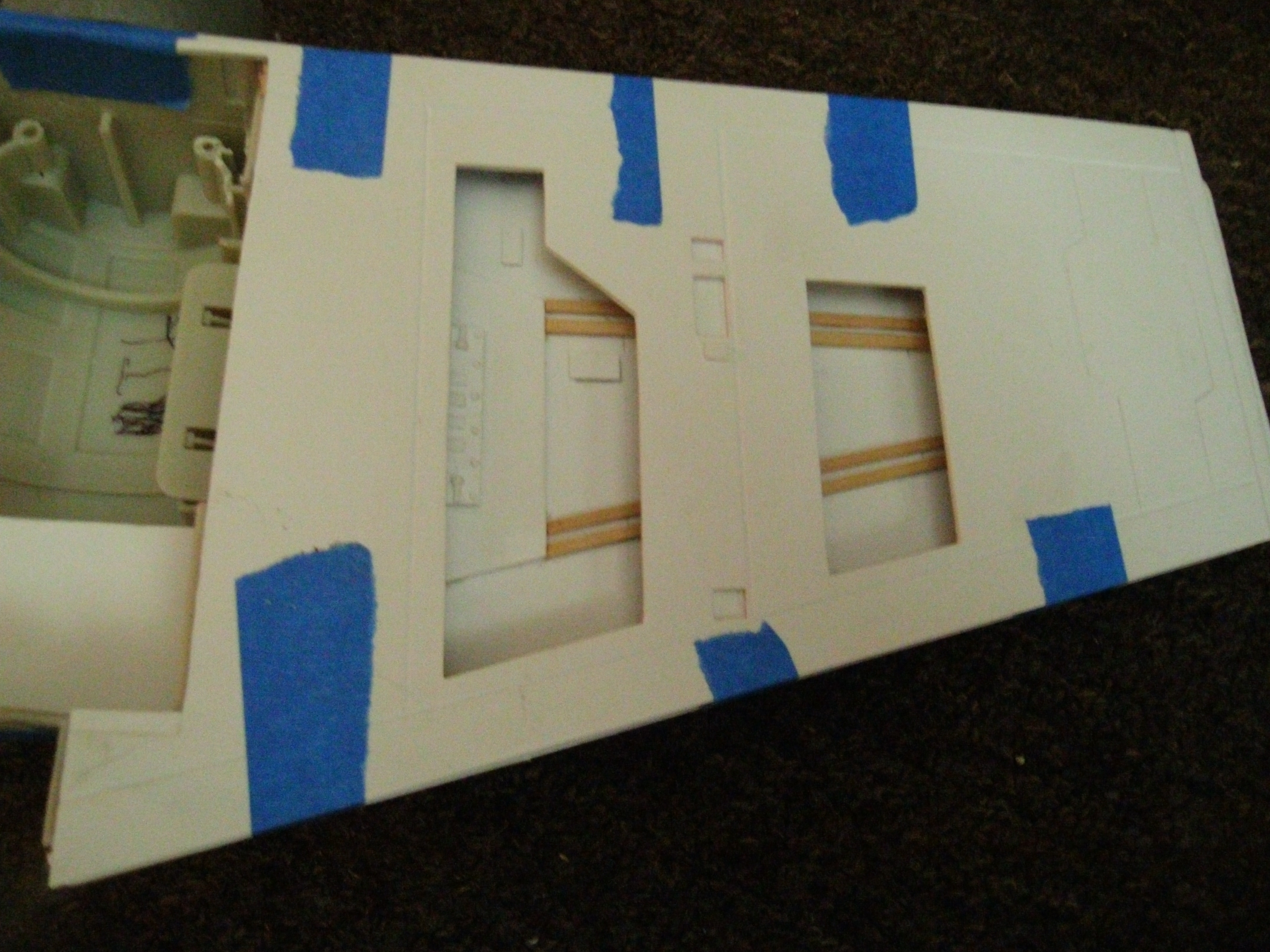

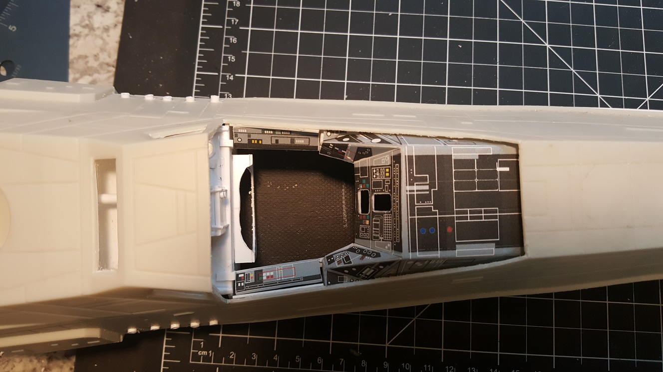

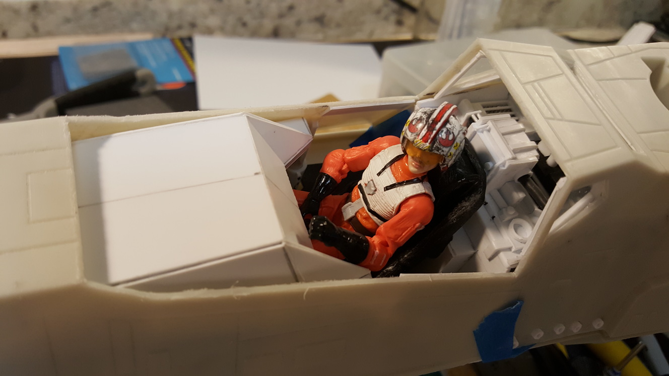

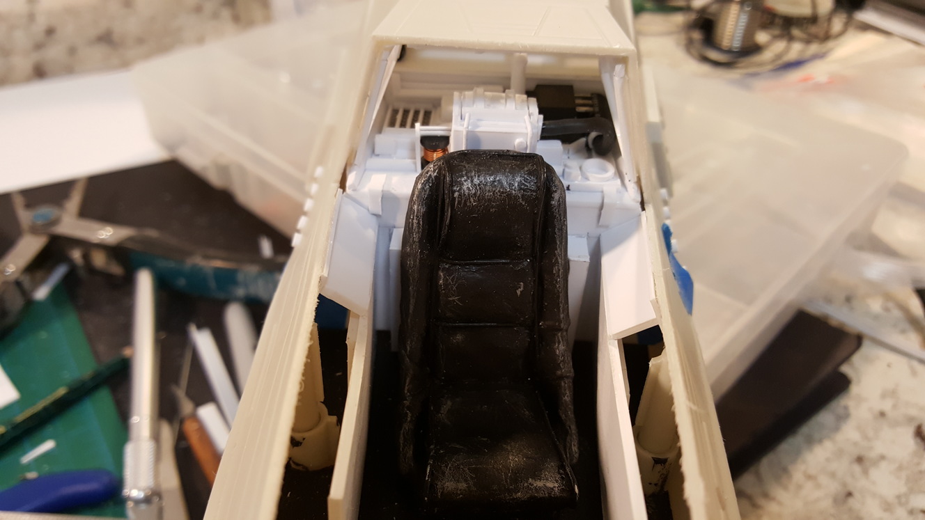

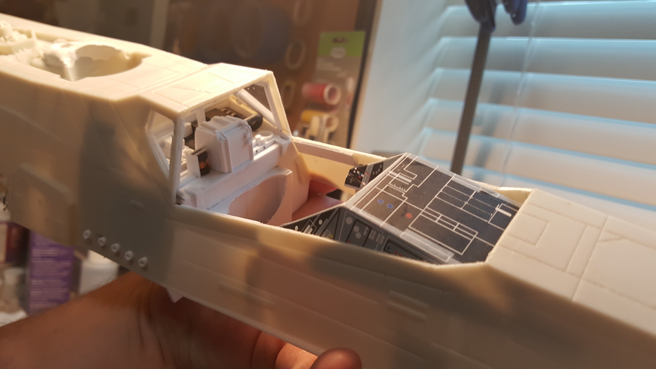

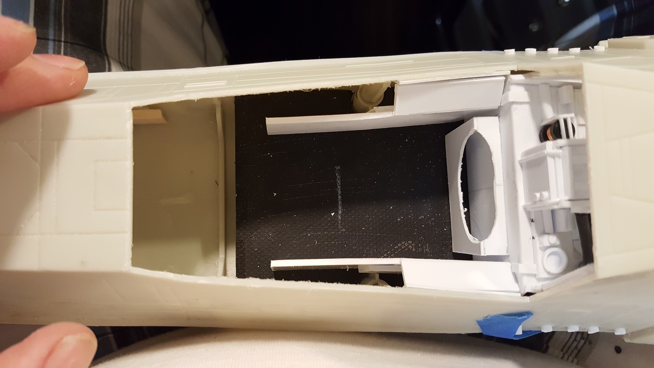

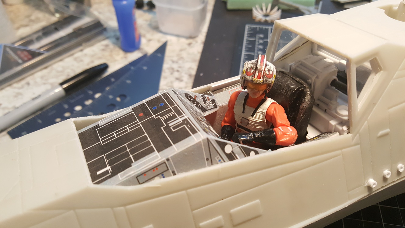

worked on building out the inside of the cockpit

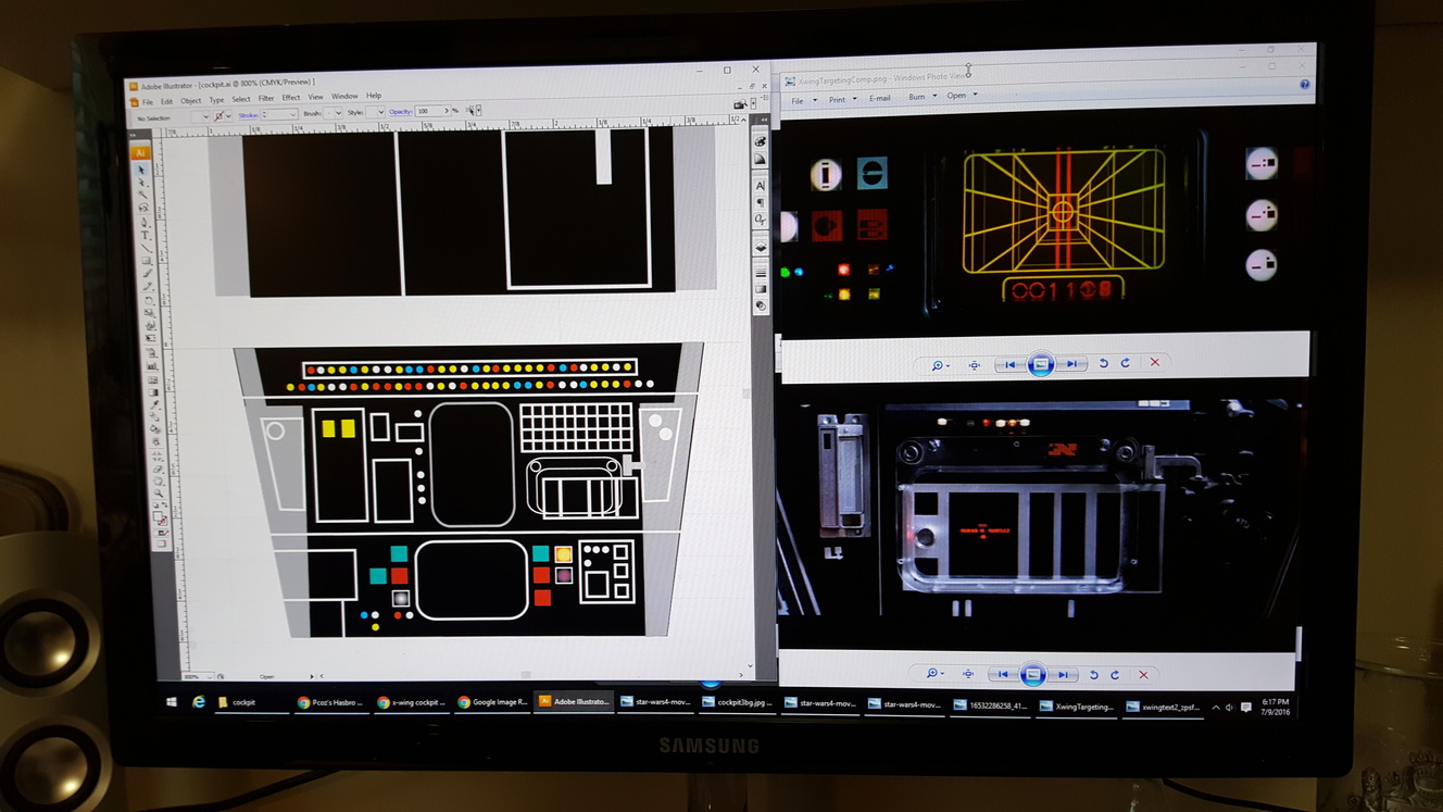

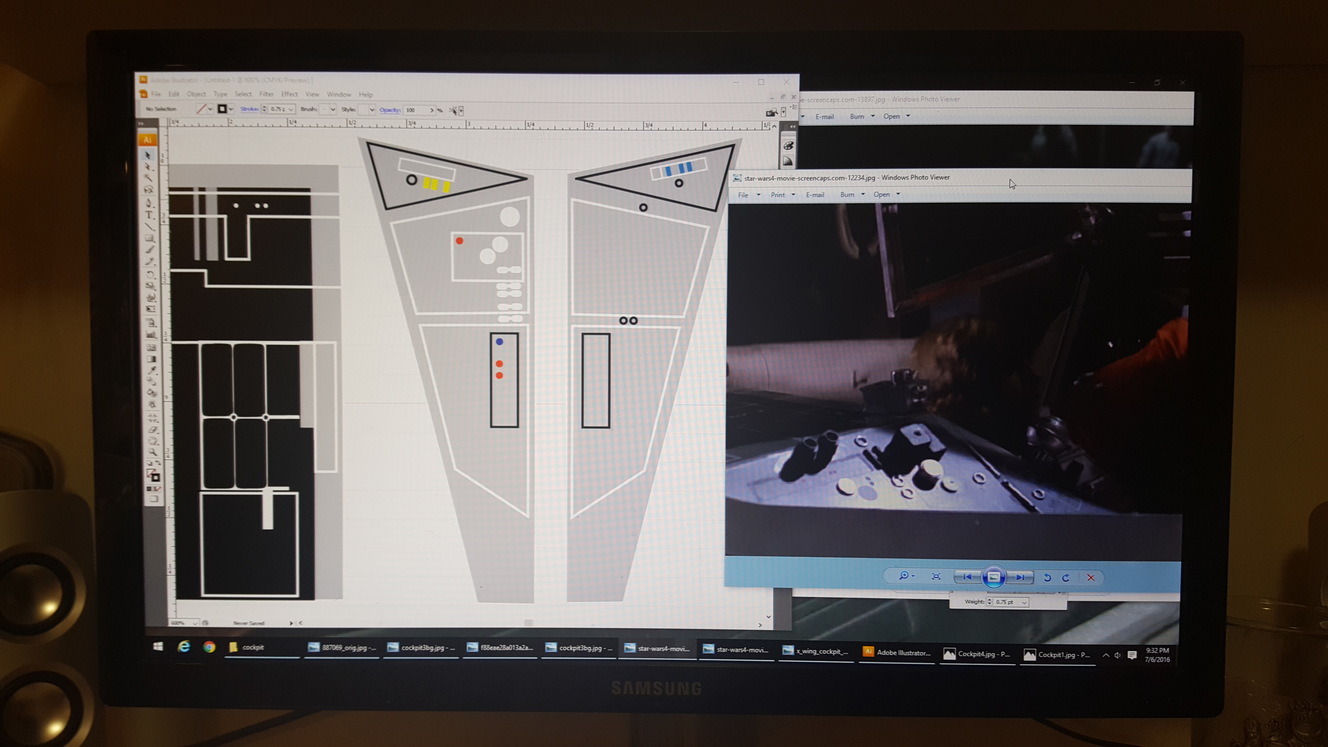

Again, there is SO MUCH detail at this scale, I'm looking at decals to pull this off and then paint and weather it to make it a little more realistic. I contacted IzzyMel and he was cool enough to let me use a little of his work for reference. The rest, I looked at movie stills.

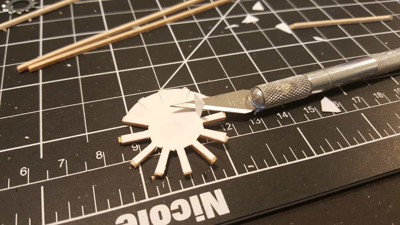

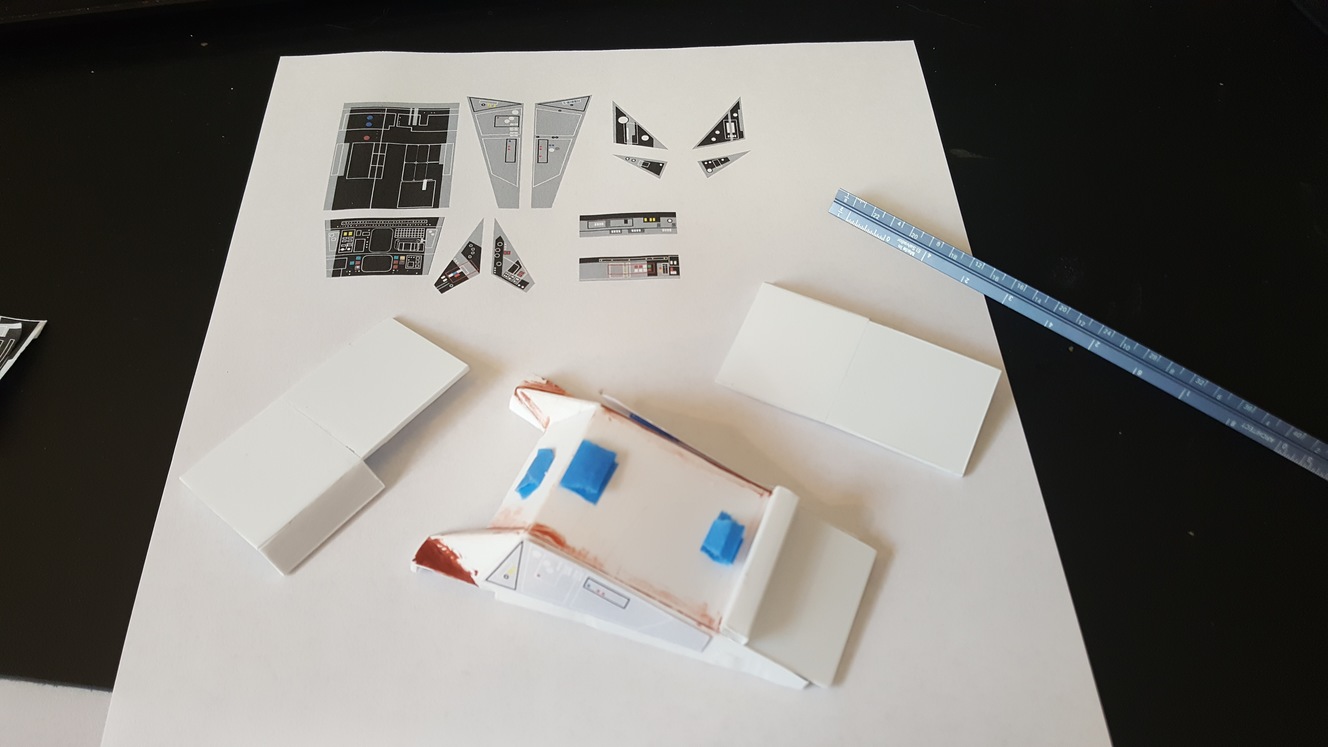

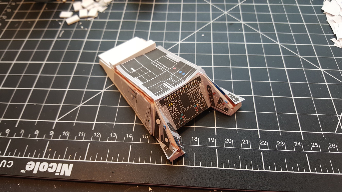

I measured the parts and then duplicated them in scale. This time I printed them out on regular paper to check sizing and accuracy.

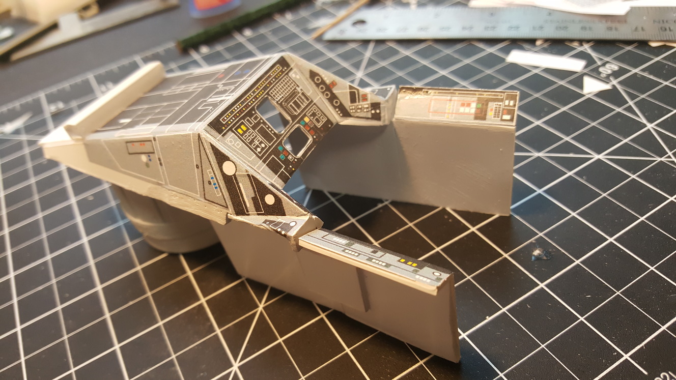

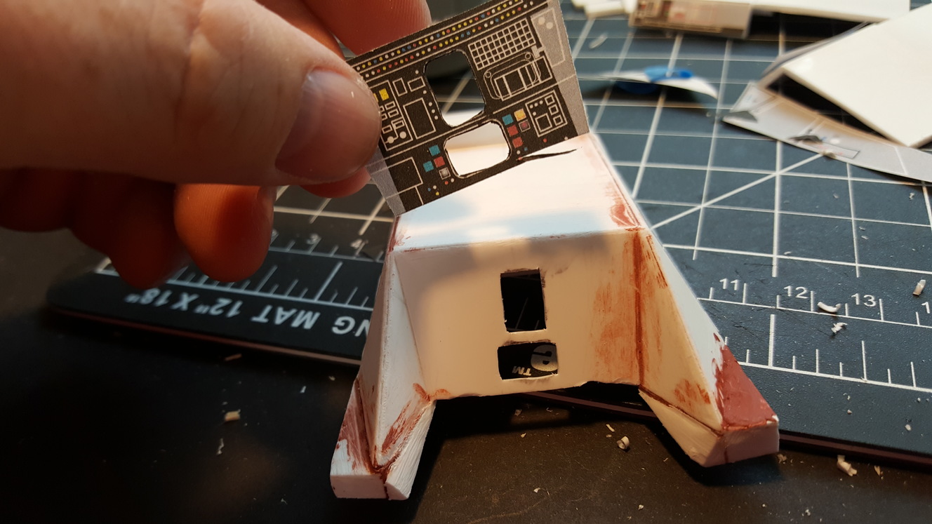

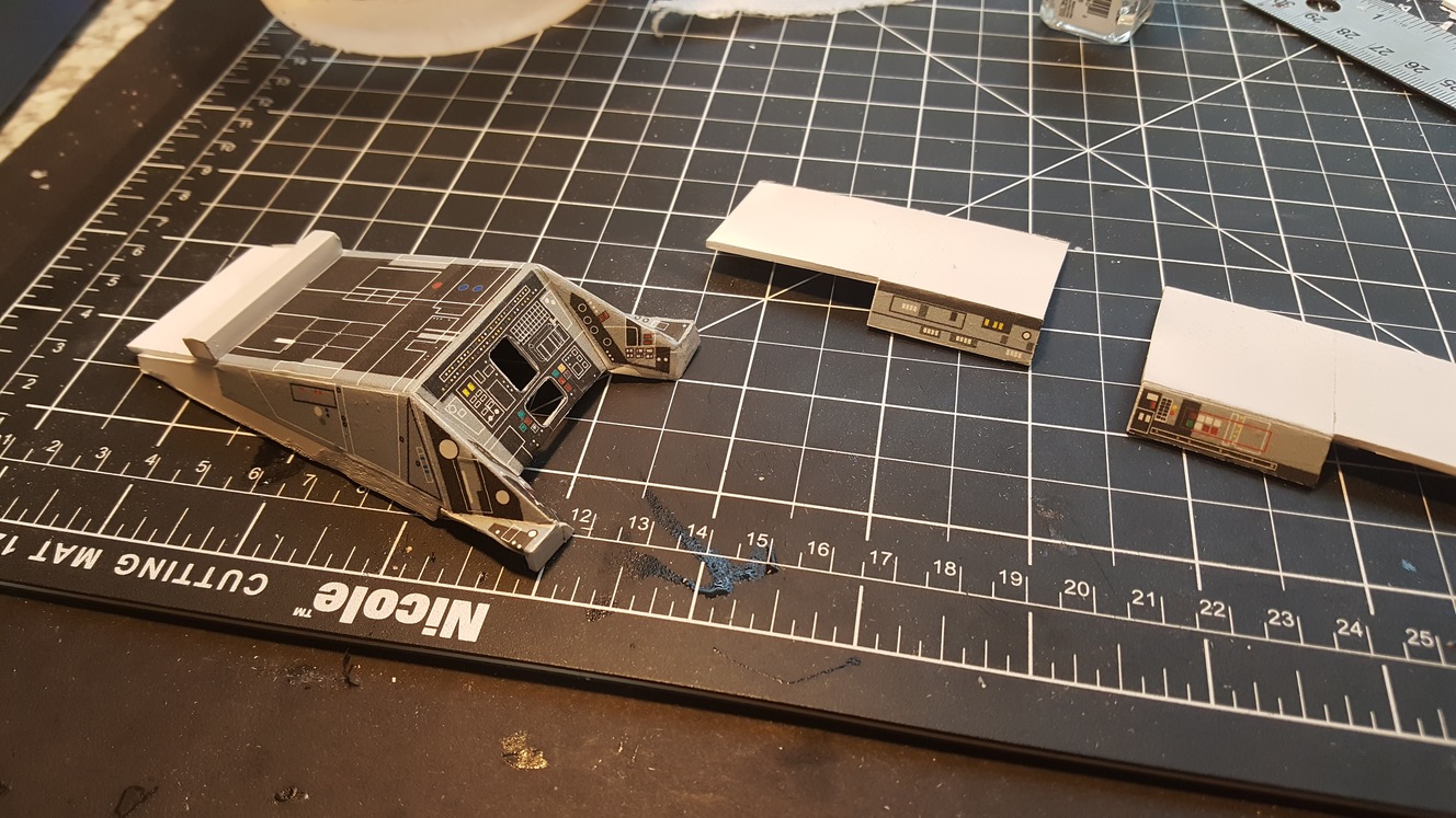

**Another Quick One***
I cut out the locations for the screens to be designed and install later...***** IF ANYONE HAS ANY RECOMMENDATIONS ON HOW TO MAKE THE SCREENS, PLEASE LET ME KNOW****

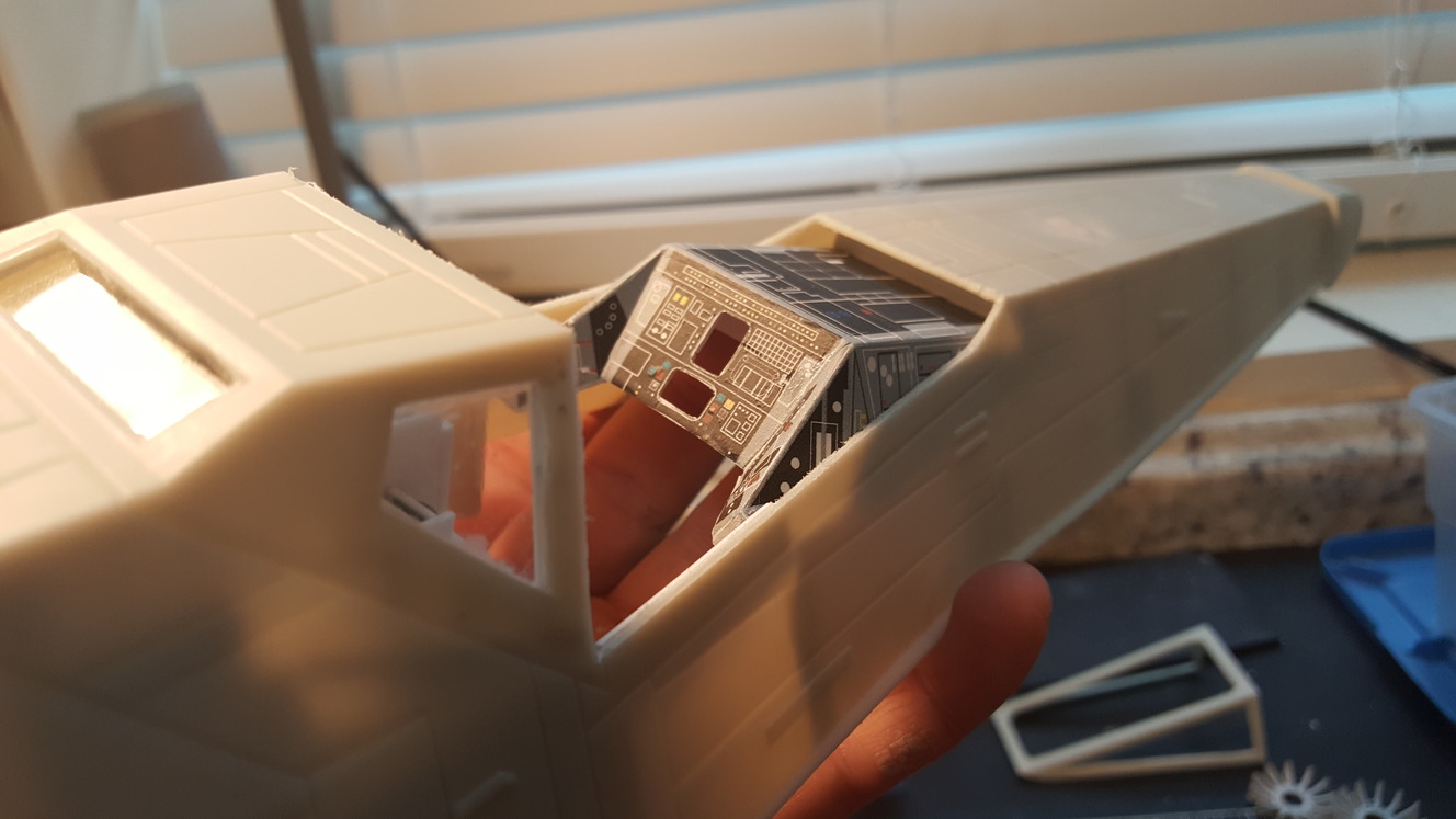

Printed out the decals, coated, and allowed to dry. Then applied to the appropriate pieces.
Checking the fit and look.
Although, I like all the small details, I'm not a huge fan of decals and would much rather paint. I'm going to try to weather what I have here and if that doesn't look right, I try to paint over and weather. We'll see....
20160719_161523.jpg 20160719_162246.jpg 20160719_162300.jpg 20160719_162411.jpg

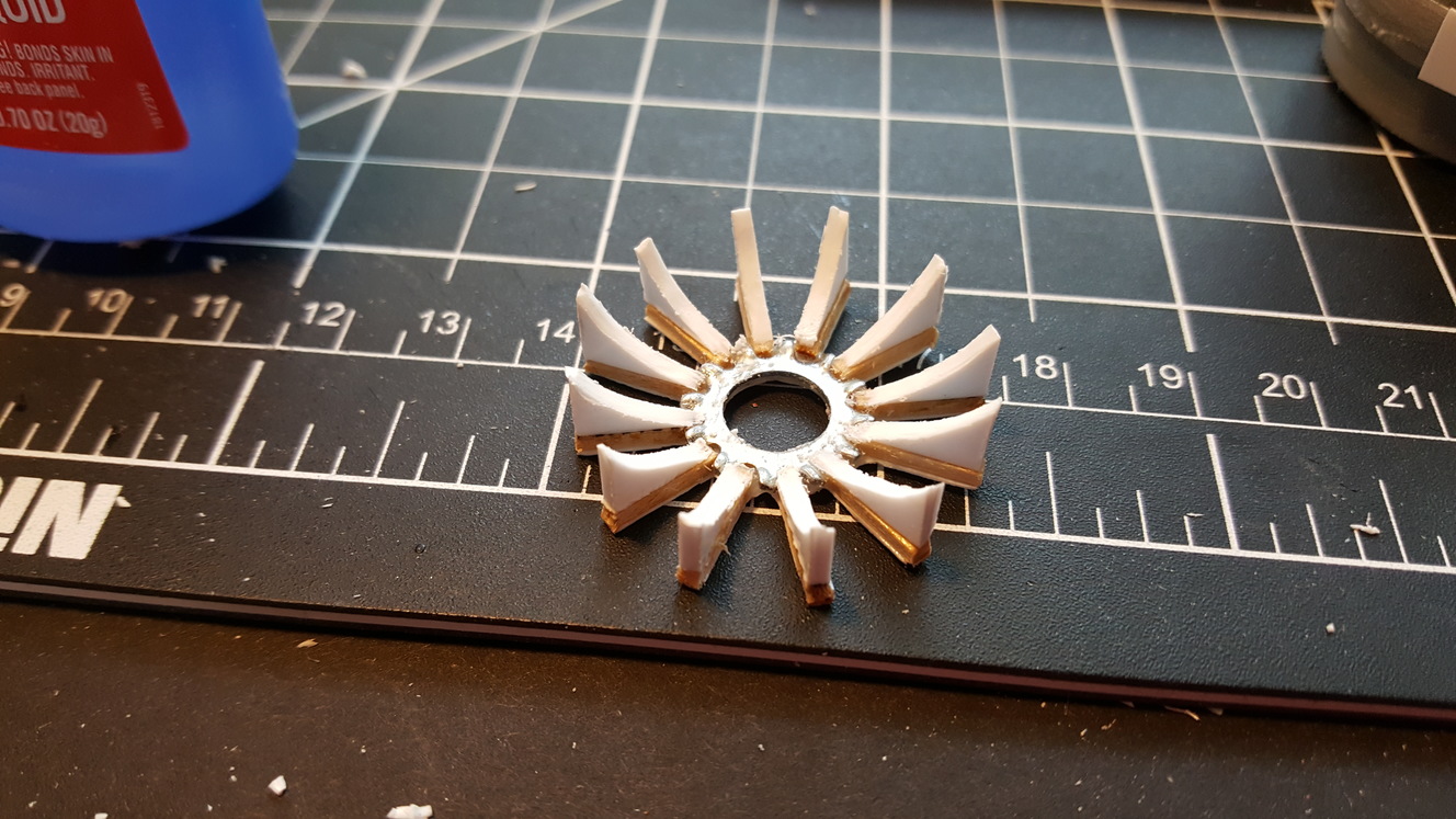

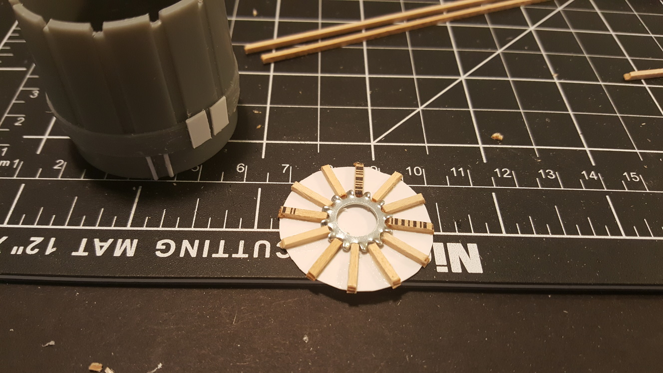

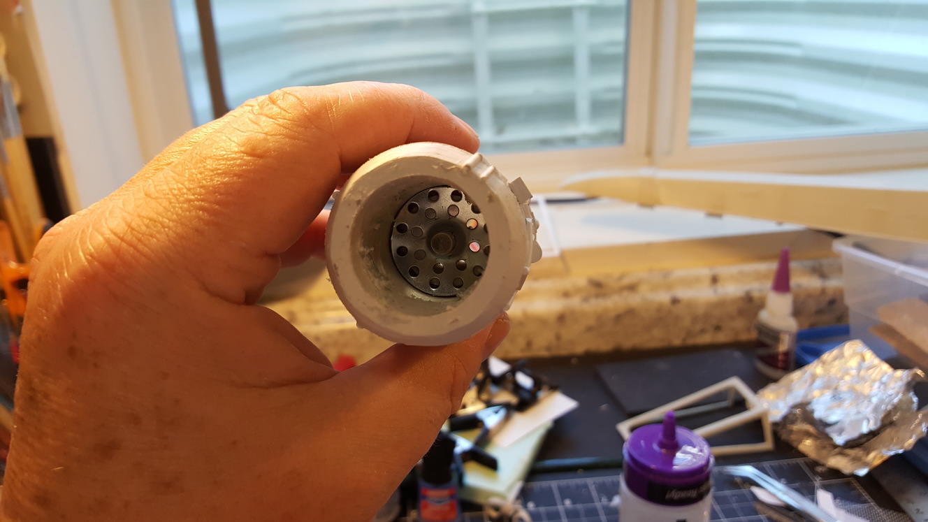

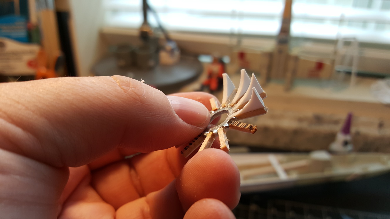

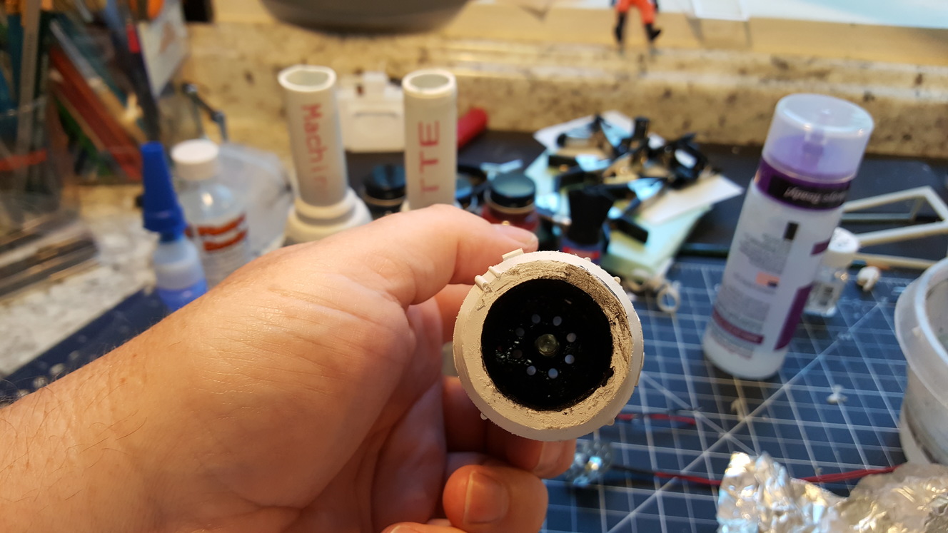

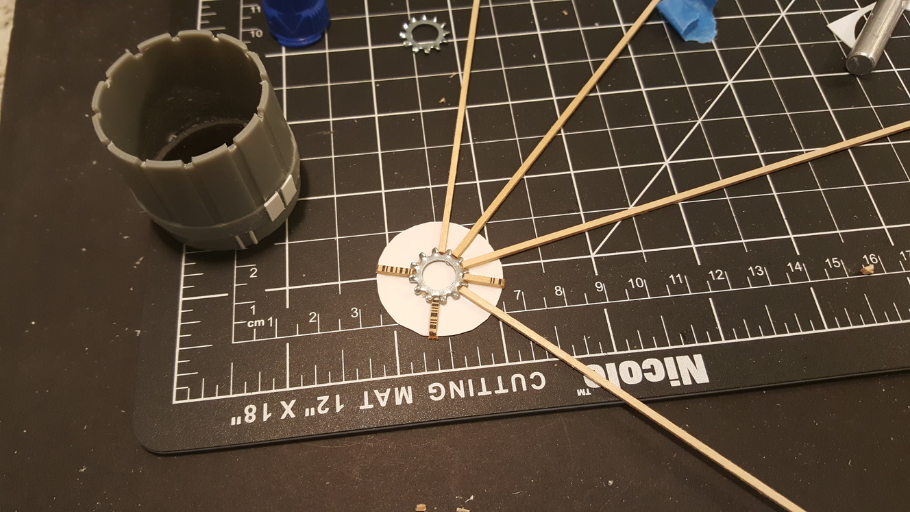

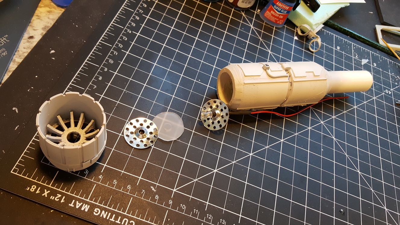

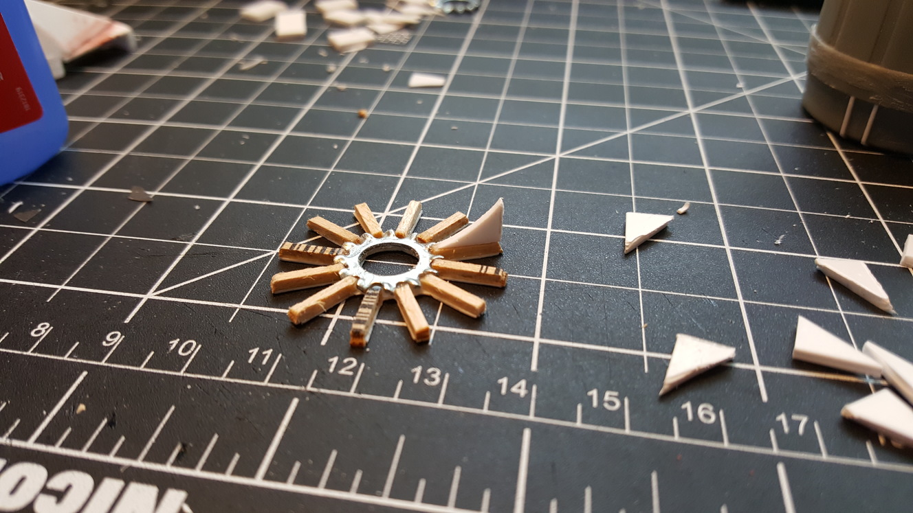

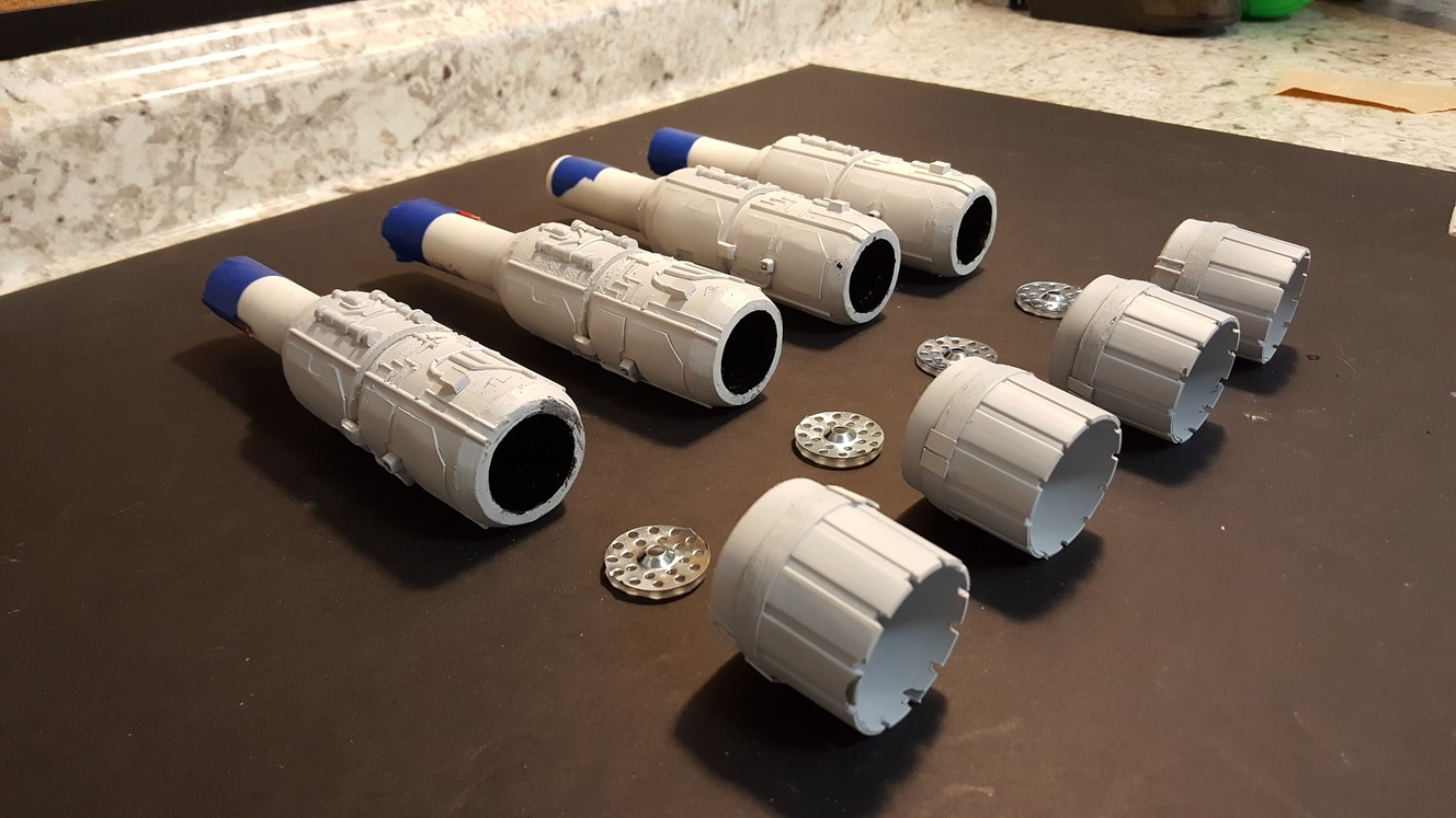

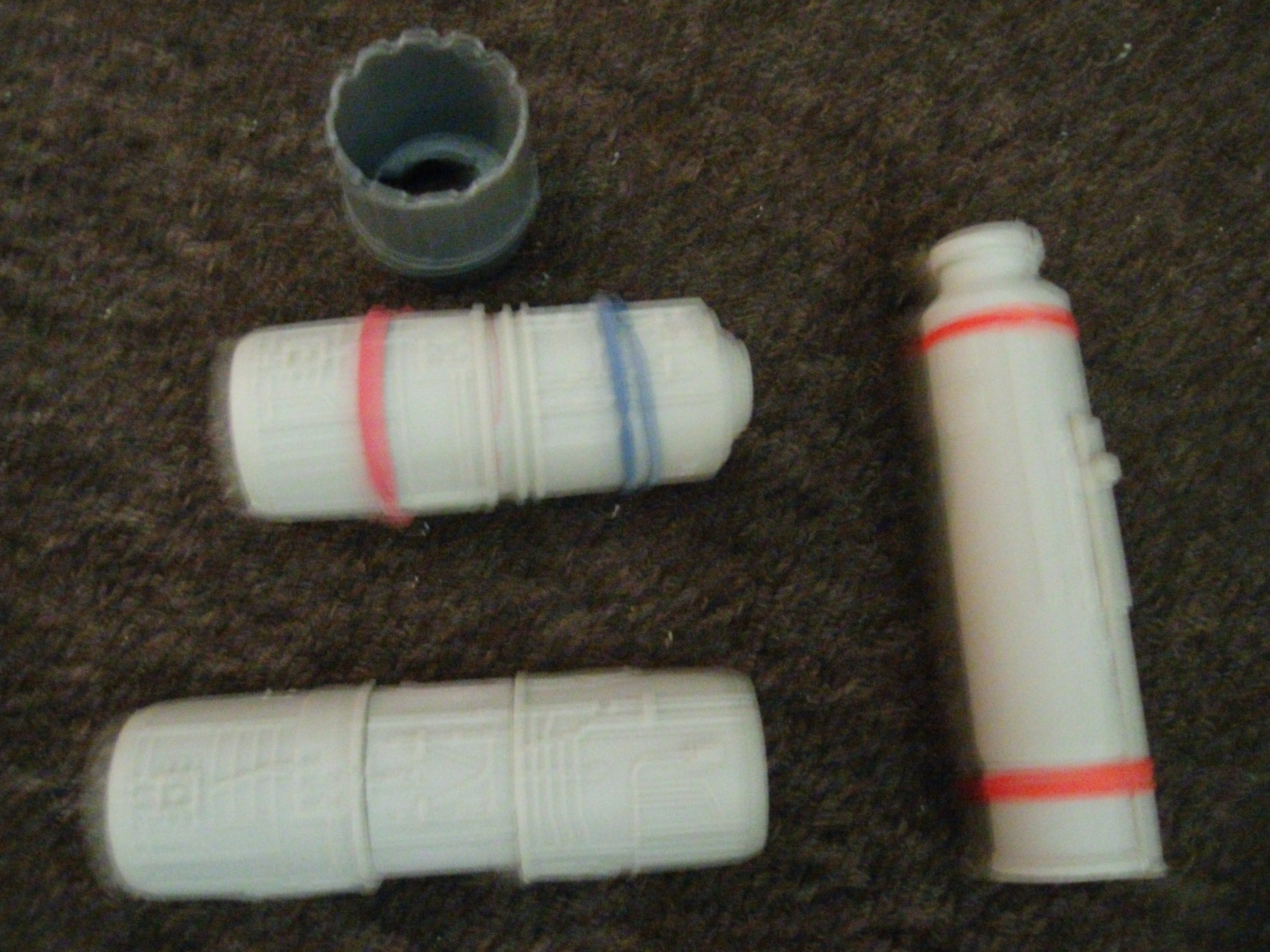

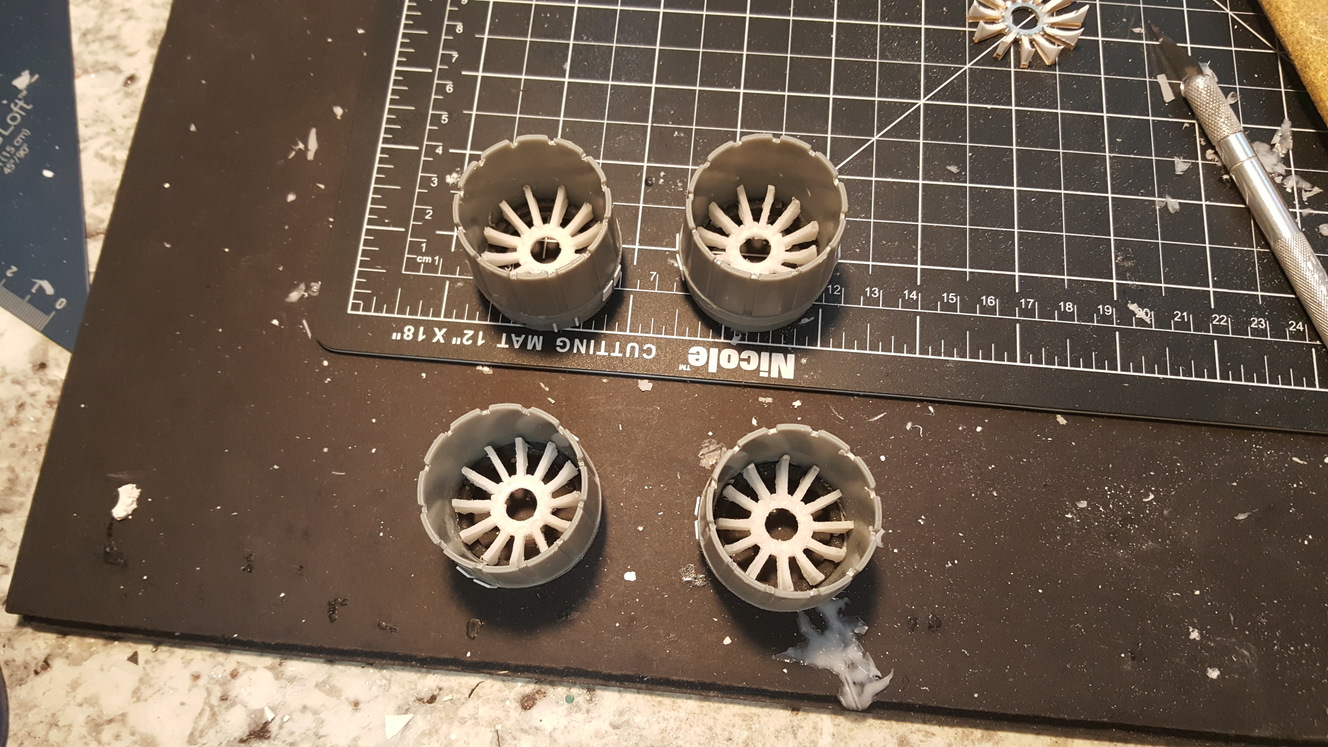

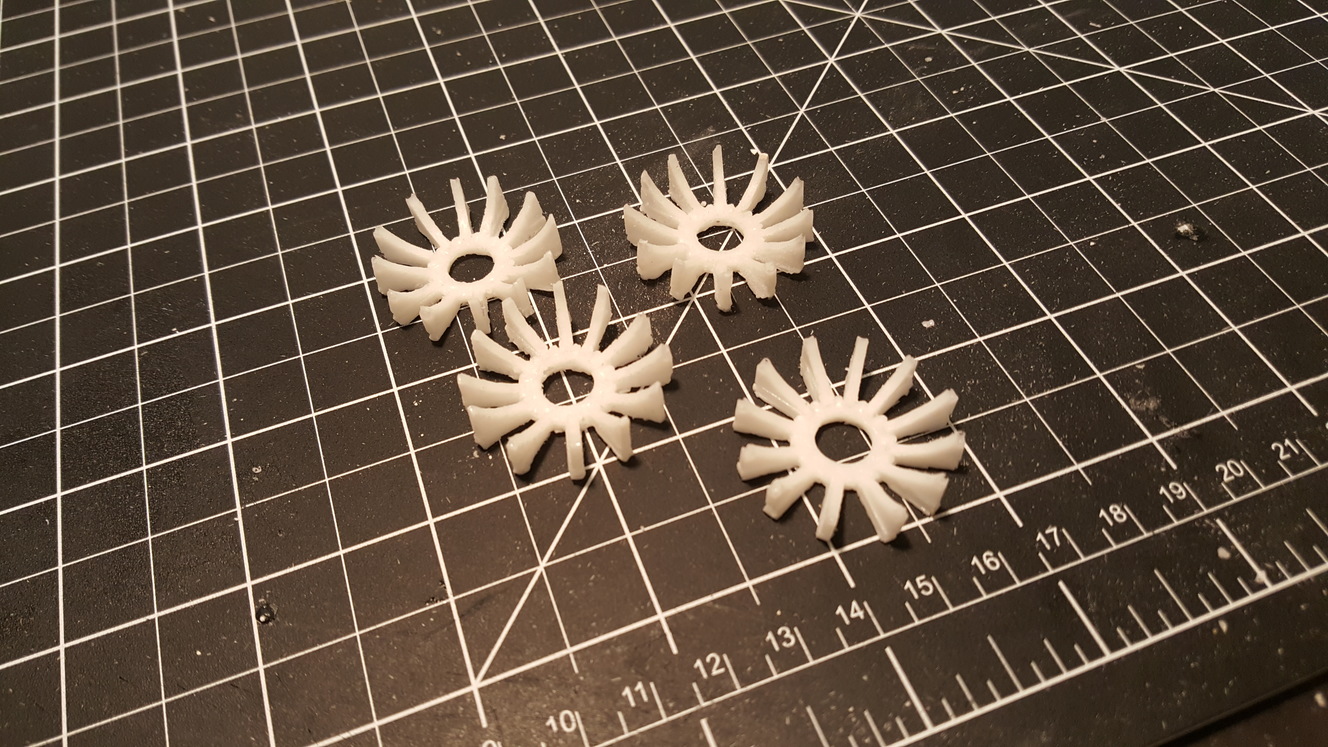

In the meantime, I did not like the interior of the engines looked. Redesigned them as well as getting the LED's installed.

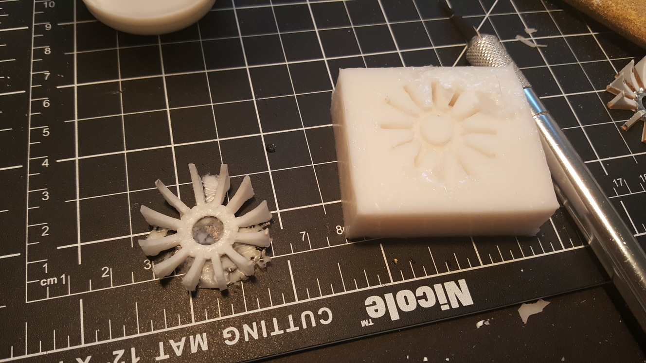

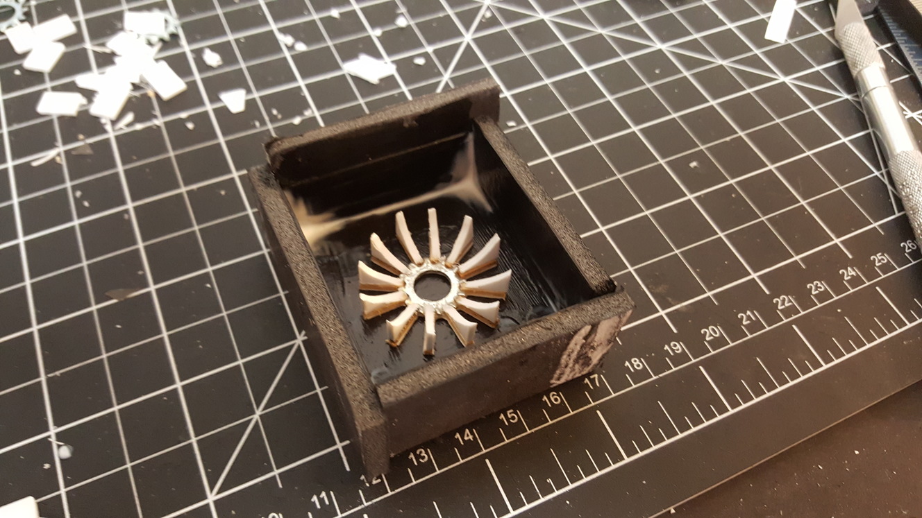

Worked on building one good one to mold and duplicate.
20160714_212450.jpg 20160714_212716.jpg 20160714_213335.jpg 20160716_143544.jpg

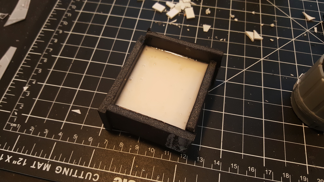

Didn't have anything on hand so, I picked up some Amazing Cast Resin from the local Michaels.
20160716_144059.jpg 20160716_145635.jpg 20160716_155925.jpg 20160717_122534.jpg
and molded a few.....
So here is the order of the engines. The obscured smoky plastic came from small dividers in a plastic case I had. The distance of the LED set back lights the entire circle, diffuses and softens the light.(Pic's next post of it lit)
20160724_171823.jpg 20160724_173540.jpg 20160724_174002.jpg 20160724_181612.jpg
Thanks for checking it out !
