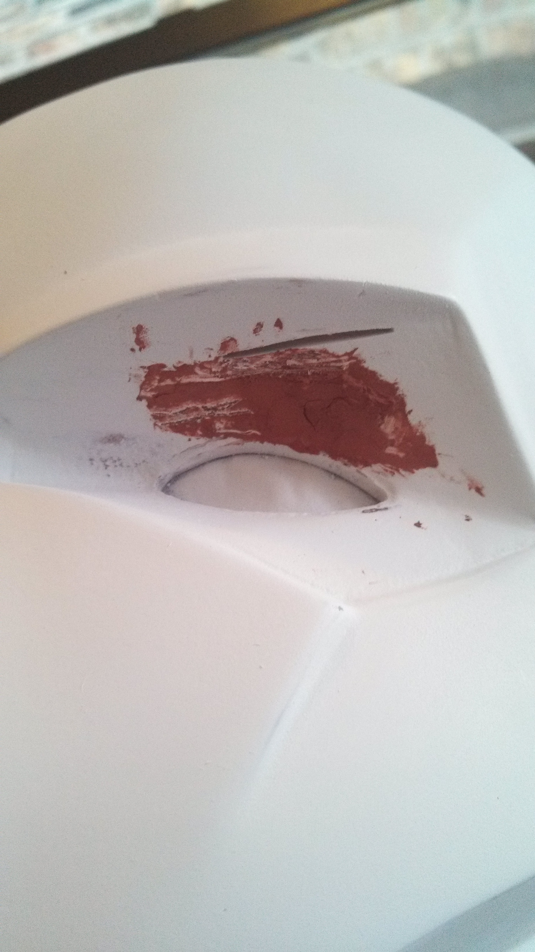

The bondo on the upper eye went pretty well, but since I had to lay on such a thick layer, it slightly cracked, and there is still a minor depression in the surface where the hole was. My perfectionism is getting the better of me. I will be putting on one more thin layer of Bondo some time this week, to even the surface out, then it is on to the third (and hopefully last) coat of primer! My schedule is a little full this week, so I might not be able to do this until Friday.

This is the crack to which I am referring:
It's nothing major, and could probably be filled in with a little super glue, except that there is still the depression that I want to get rid of. It shouldn't be a problem since it is just spot putty on top of spot putty. But I am going to hold onto that super glue idea for future projects, definitely sounds useful.

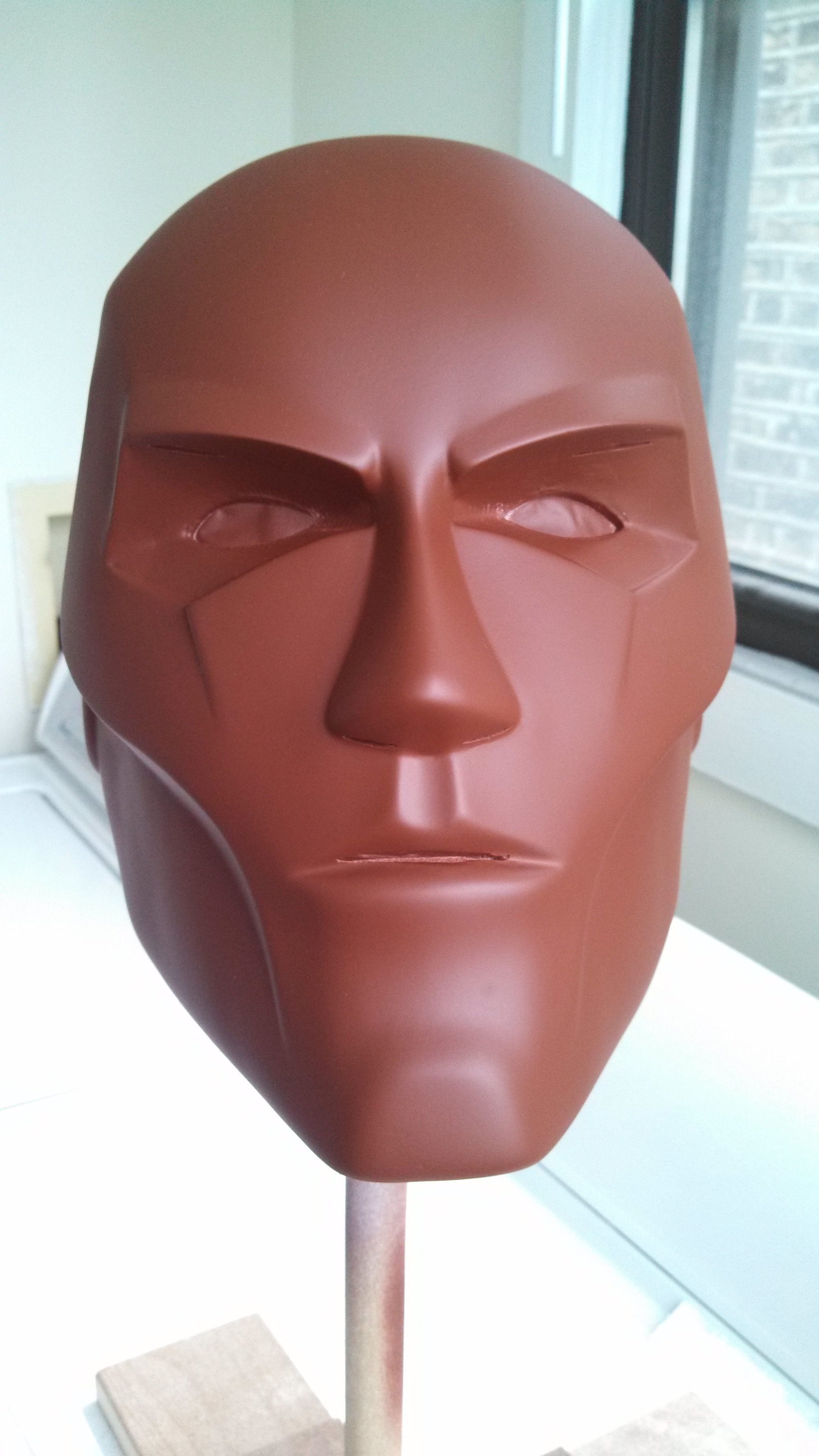

Update time!
I checked the Chicago forecast yesterday evening and saw rain pretty much all day both Saturday and Sunday. Then I cursed and looked outside. I had about 1.5 hours of daylight left, so I gathered up my stuff and ran outside. I sanded down the final Bondo applications (the crack I showed you earlier, and one other place that need just a little bit to finish it). Then I applied the 3rd, and looks like final(!), primer coat.
The putty layer is still kind of visible above the left eye, but considering how close you have to be to see it and that that area will eventually be painted black, I am not worried about it.

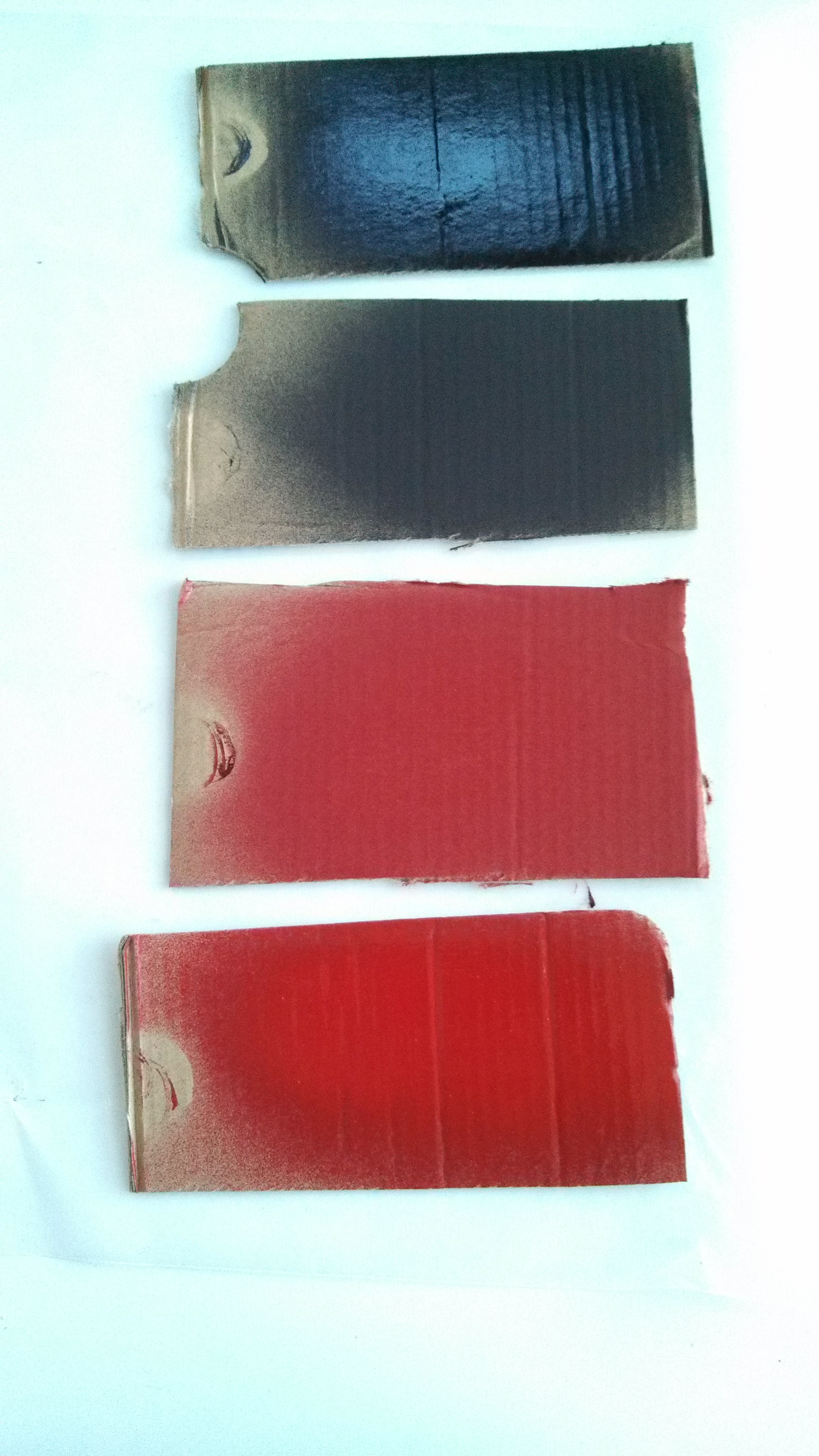

I did get paint, just picked it up near where I work since I work out in the suburbs anyway. And I sneaked outside to do a few test pieces really quick despite everything I just wrote :p
All Rustoleum brand. From top to bottom:
-Black Gloss Protective Enamel
-Black Flat Protective Enamel
-Satin American Red
-Gloss Cherry
For the eyes, I think the flat finish beats the gloss. But I'm torn on the red. The Gloss Cherry definitely looks more true-to-hue, but the satin finish just sounds better to me (I could not find the Cherry in a flatter finish). After all, Red Hood is a member of the bat family, so stealth is kind of their thing. He's already wearing a bright red helmet, I cannot see having a shiny, reflective surface as being helpful.

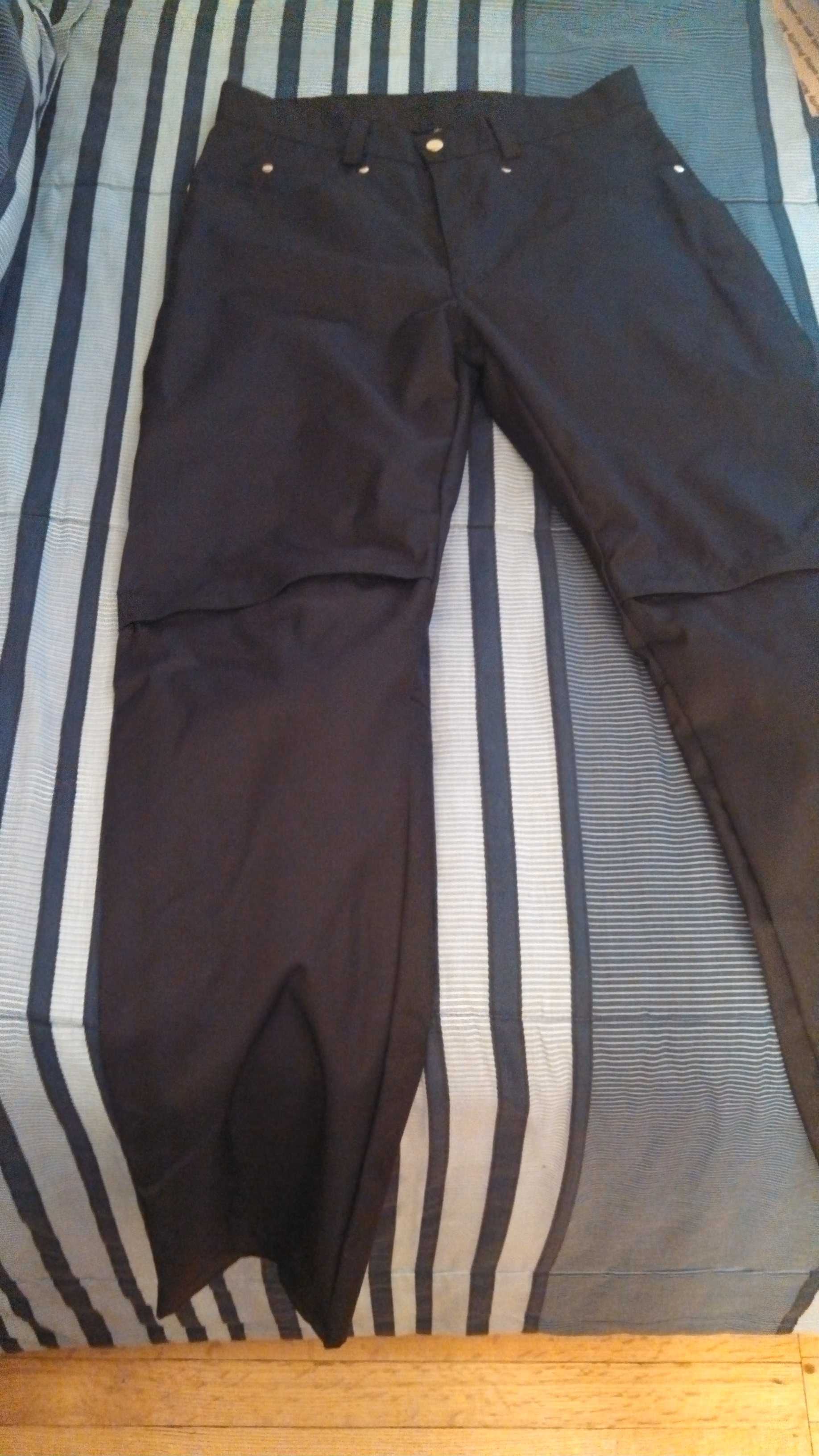

The good news is: I found the pants!
They are slender, but not constricting (unlike the originals). Have some nifty removable hip and knee pads, and are an inch longer than I normally wear, so they will fit well over boots.

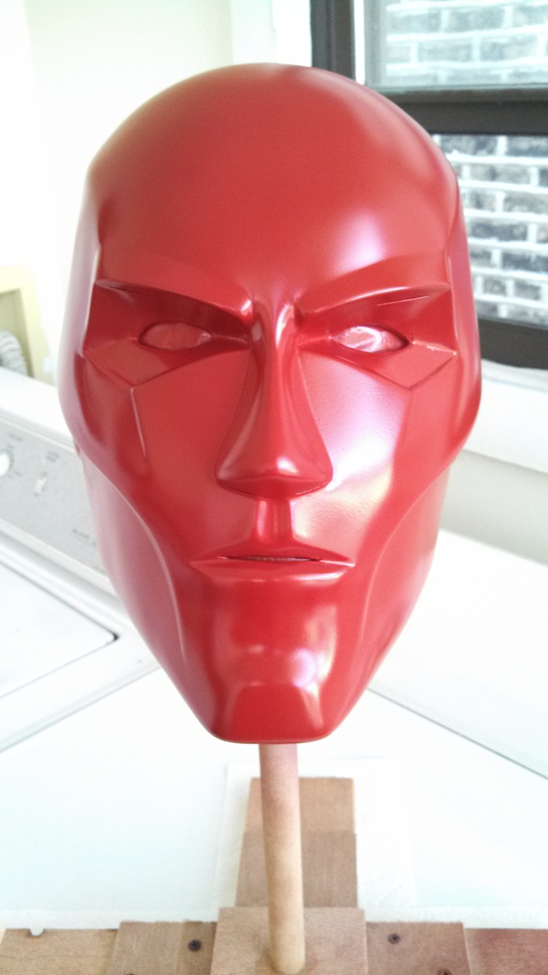

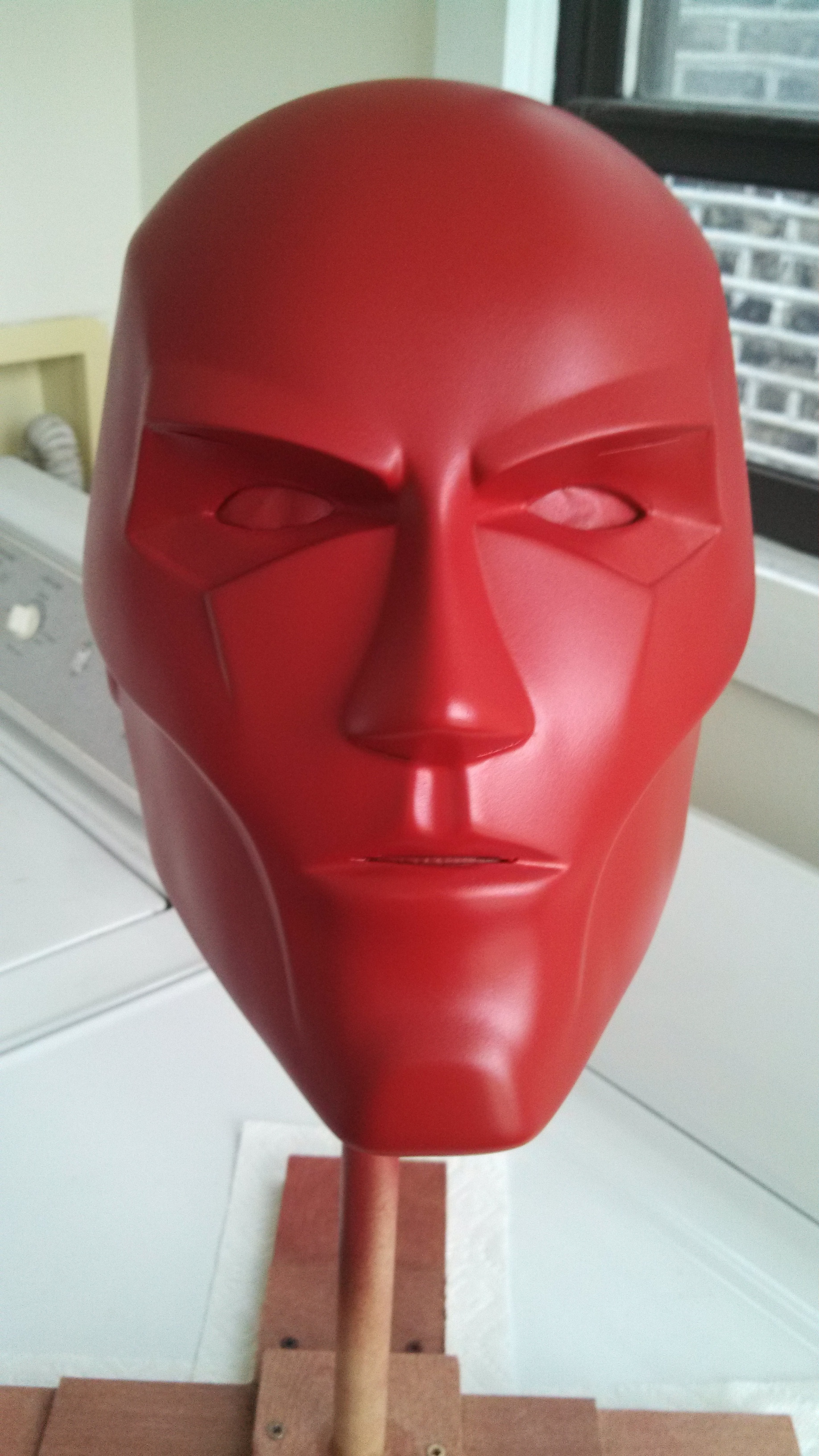

As promised, a new coat of paint, and I like the finish on this one so much better than the first.
The paint in that pic is still wet, but as of now it is drying beautifully. The first one looked like latex, this one looks much better in my opinion. In a couple days, I'll gently wet sand it with 1000 grit paper, and then decide whether or not it needs one more coat. If not, I'll give it a layer of enamel or lacquer, then it is onto the eyes!

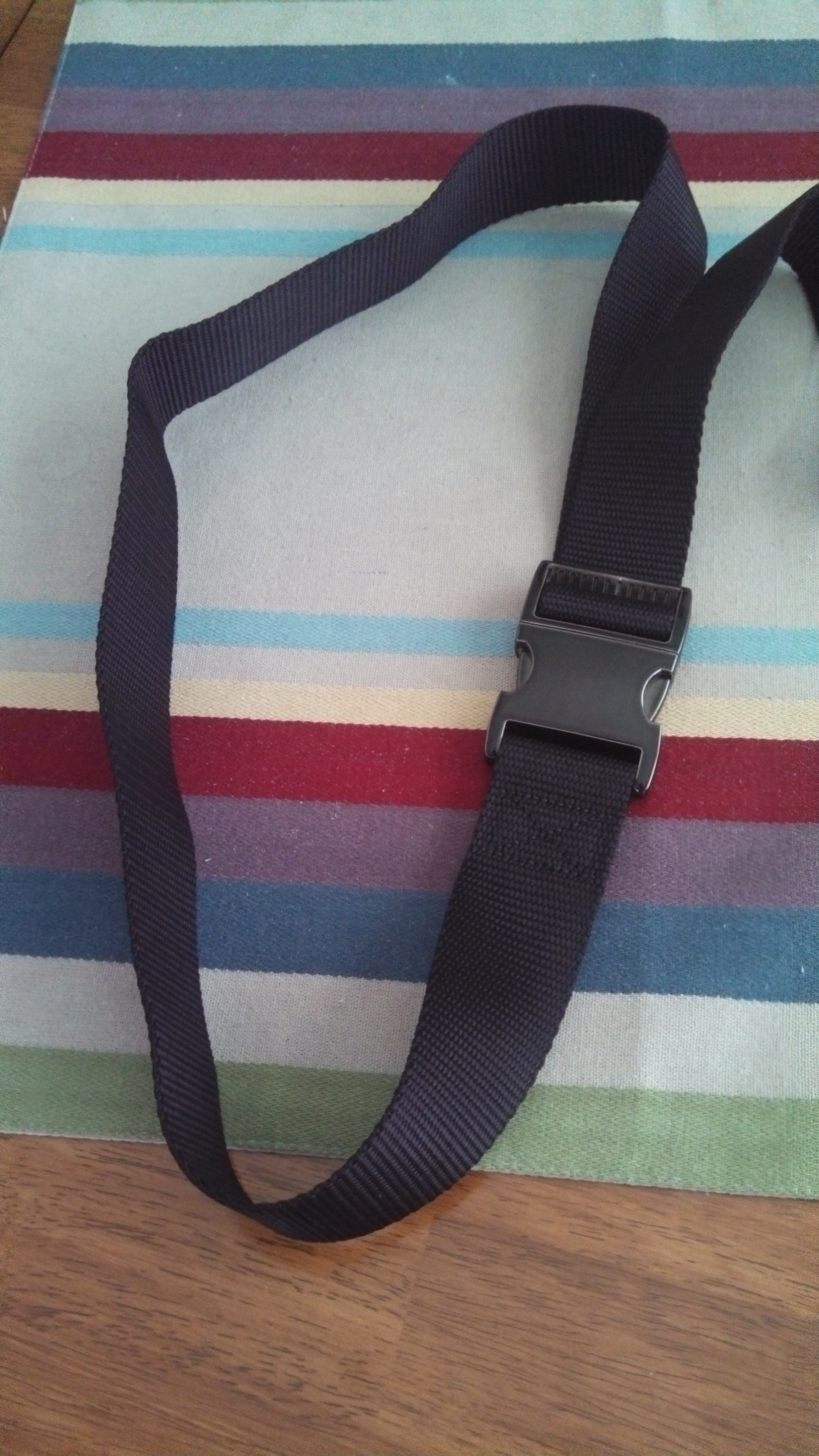

First off, my belt came in on Friday!
I ordered it from Strapworks(.com). I highly recommend them: very affordable, quick shipping, and customizable. They let me choose what width of nylon I wanted, what kind of buckle I wanted (metal, plastic, hybrid, etc.), and what color I wanted the buckle to be. I chose a "Gun-Metal Grey" which honestly looked a little lighter in the picture, but I still think it looks great.
I ordered 5 feet of extra nylon strapping, because I'll be removing some of the stuff attached to the holsters and sewing on diagonal straps, that will attach to the belt more like what you see in the source material.

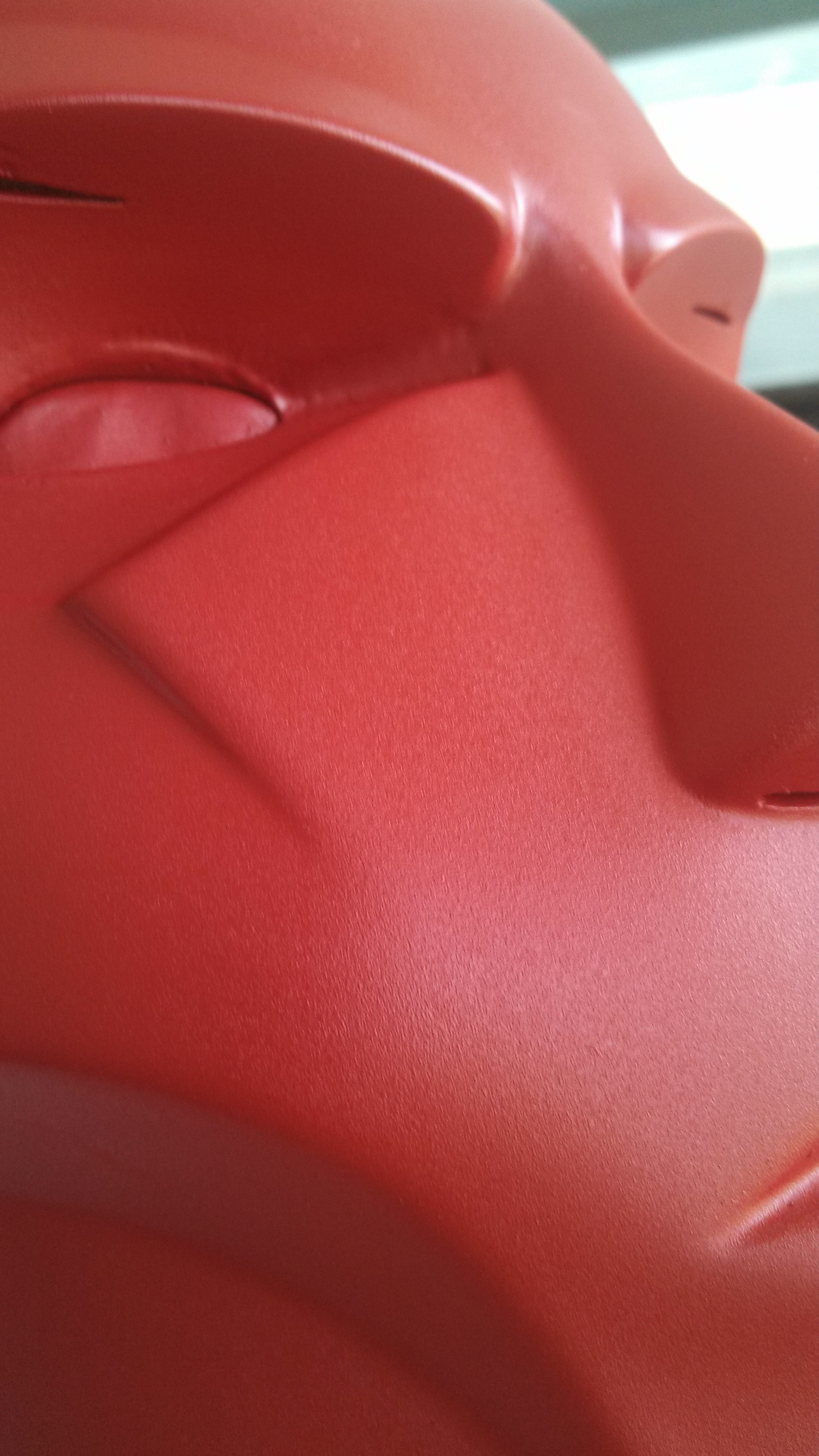

If you'll note, there is almost no shine to this coat. I am not sure if that is because the gloss paint was still shining through on the previous coat, or if it is because there was a higher humidity yesterday. There is definitely a rougher texture to this coat, like fine sand paper (hence the light diffusion), but it doesn't come off on my fingers when I run them over the surface. You can kind of see what I mean here:
So, question for anyone following this thread: Will the texture be a problem with the future coats (i.e. should I give it one more good sanding then repaint on a less humid day)? Or, am I good to proceed with a clear enamel and then the black for the eyes, followed by a final clear enamel?

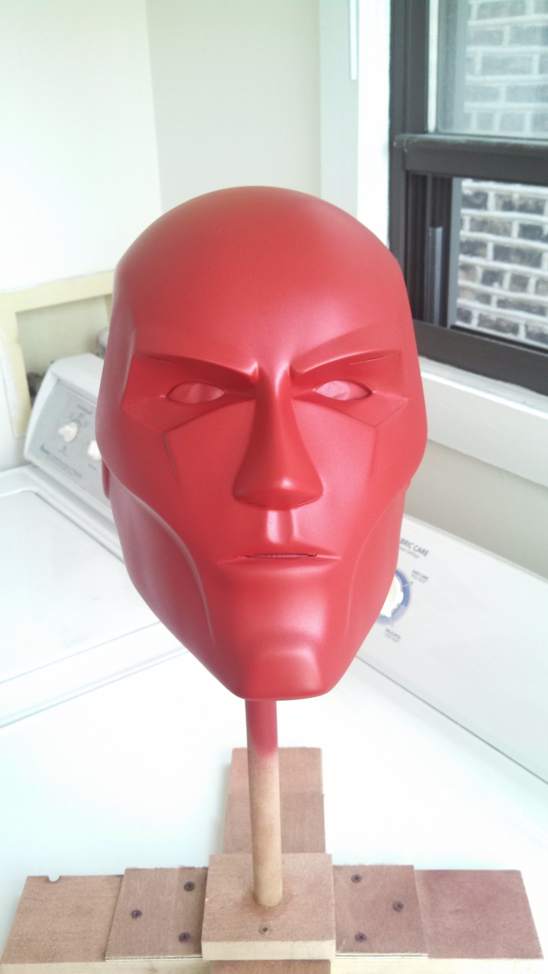

I didn't hear from anyone one way or the other, so I decided not to risk. I wet-sanded the whole thing down again with 2000 grit (thank you Auto Zone) and applied one more coat of paint. Though something went wrong with my can half-way through the coat, and the damn thing would only spray paint while upside down. For the record, it is very difficult to get an even coat while holding a can inverted! Nevertheless, I succeeded:
There is the slightest texture here and there across the helmet when compared to other parts of the helmet, but at 7 coats of paint total, I think this is as good as it is going to get. This weekend, I will spray a Clear Coat Enamel across the entire thing to make sure any accidental bumping does not ruin the paint, then I will paint the eyes. Hopefully I only need 2 coats maximum for those.

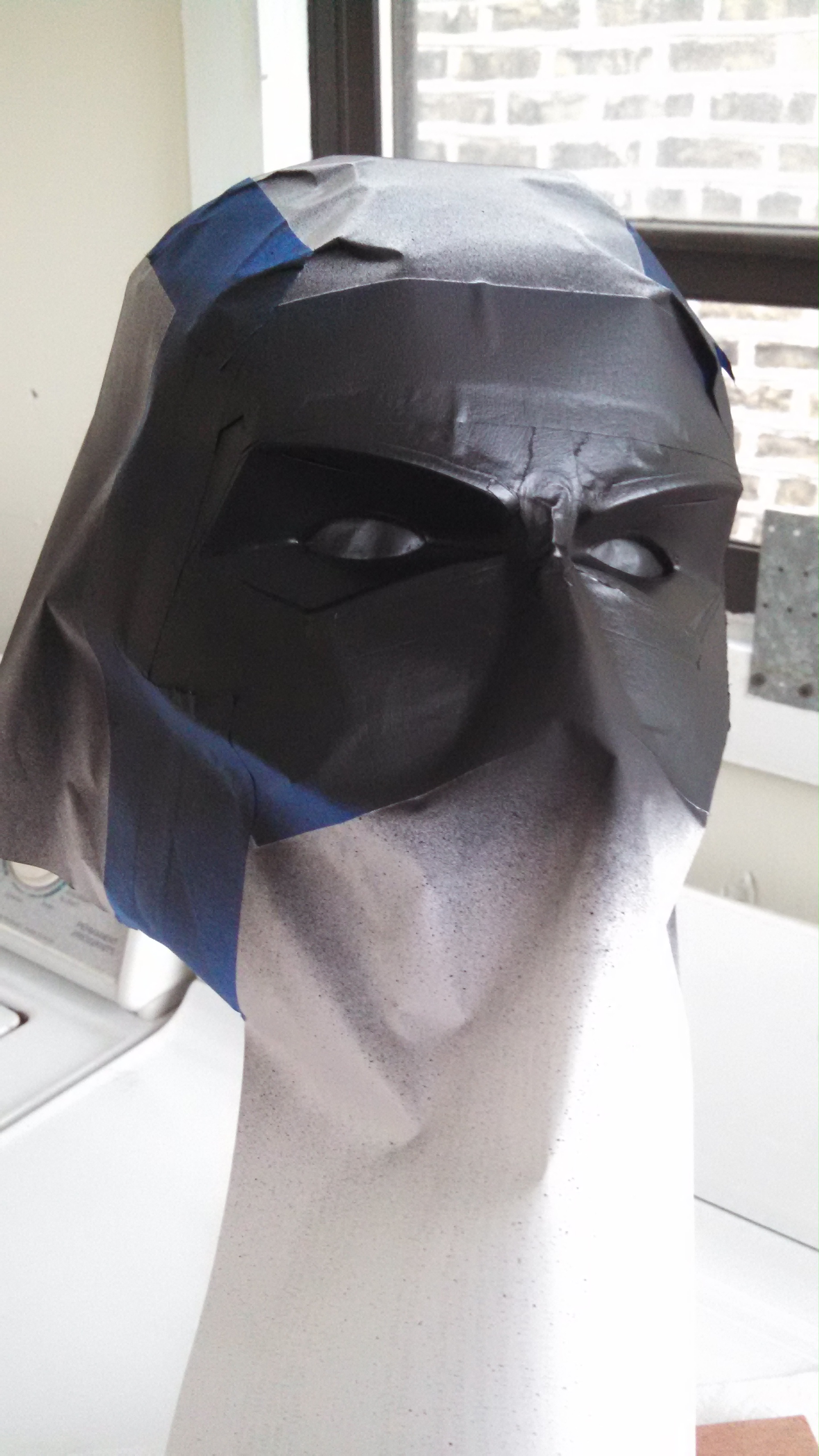

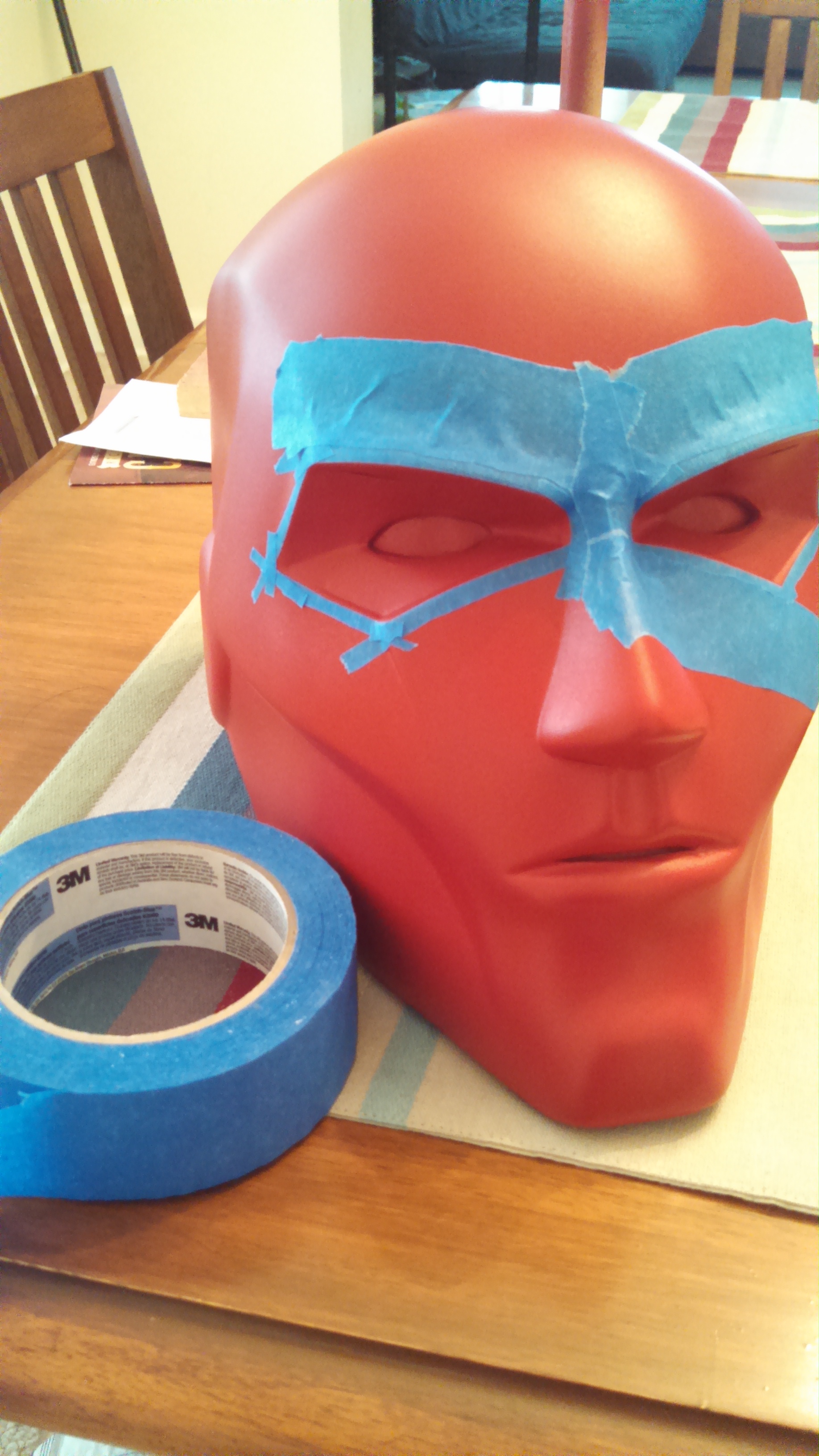

After an hour of meticulously taping out the eyes, then making sure every other inch of the helmet was covered:
I am going to give it a full 48 hours before removing everything. Sunday night will be the moment of truth. If everything held up and there were no holes in the seal (PLEASE let there have been no holes in the seal!), then I'll be ready for a layer of Crystal Clear Enamel and it will be nearly finished.

I fixed the pic! As for how I masked the eyes:
First, I cut the edges off strips of blue painters tape that I had. I only had a roll that was about 1.25 inches wide, and rather than spend more money, I would stretch out a strip of tape, then use a hobby knife to cut 1/4 inch strips off of both sides. Using the factory cut edges, I lined the eyes with those small strips first, allowing me to get around every corner and crease without the tape folding in on itself (since each strip was so thin).
Next, I took the rest of the strips (which I had set aside) and used them to line the edge strips, effectively extending their coverage.
Finally, I taped scrap paper across the rest of the mask to protect it from over-spray mist.
I was following Sorenzo's build thread because the cast is his design, and his came out beautifully. You can see his pictured step-by-step toward the bottom of the first page.
