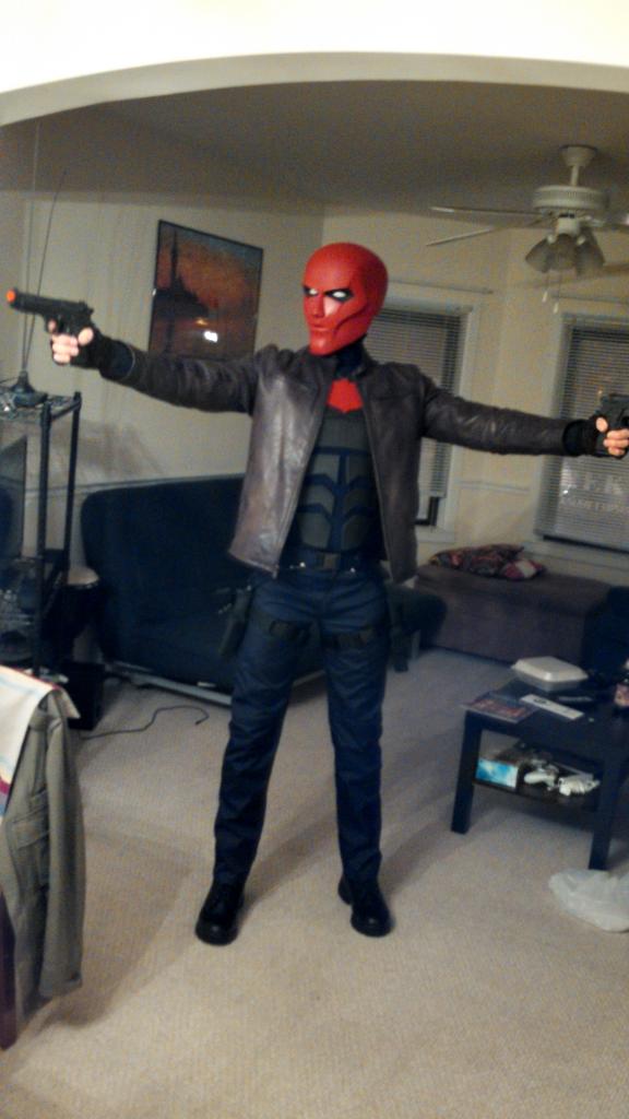

This post has been edited to show the completed costume. To see the process, please see the rest of the thread.
C2E2 2015

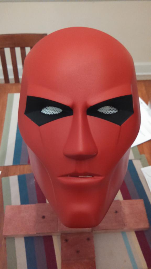

Helmet

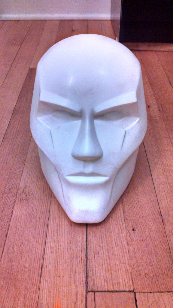

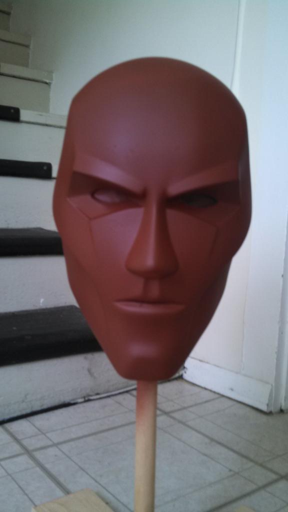

A huge thank you goes out, first and foremost to @Sorenzo for this cast. It came out beautifully, I only had to apply some Bondo spot putty to a couple small places. As for finishing the piece (see the rest of the thread for THAT big process), I closely followed Sorenzo's build thread, but reported my own progress here.

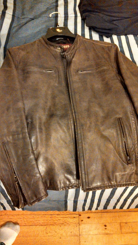

The jacket is probably one of my favorite clothing articles that I own. I got it a few years ago care of Wilson's Leather, should be perfect for the costume.

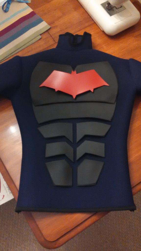

Torso

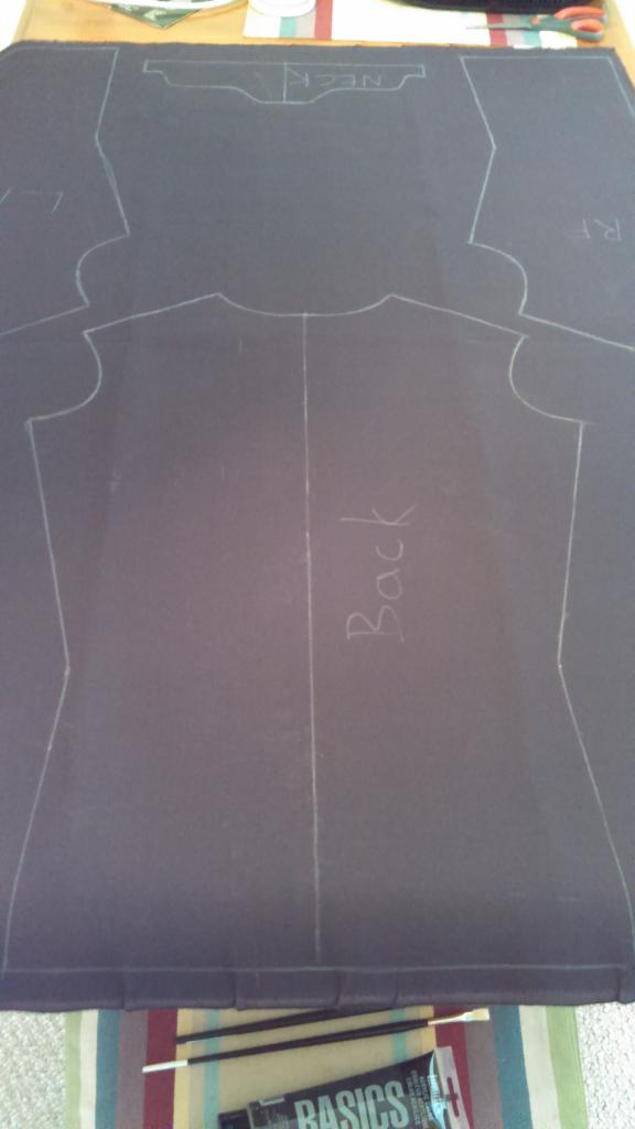

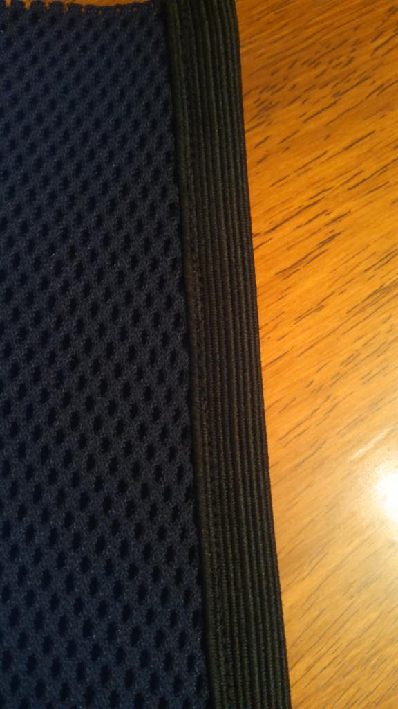

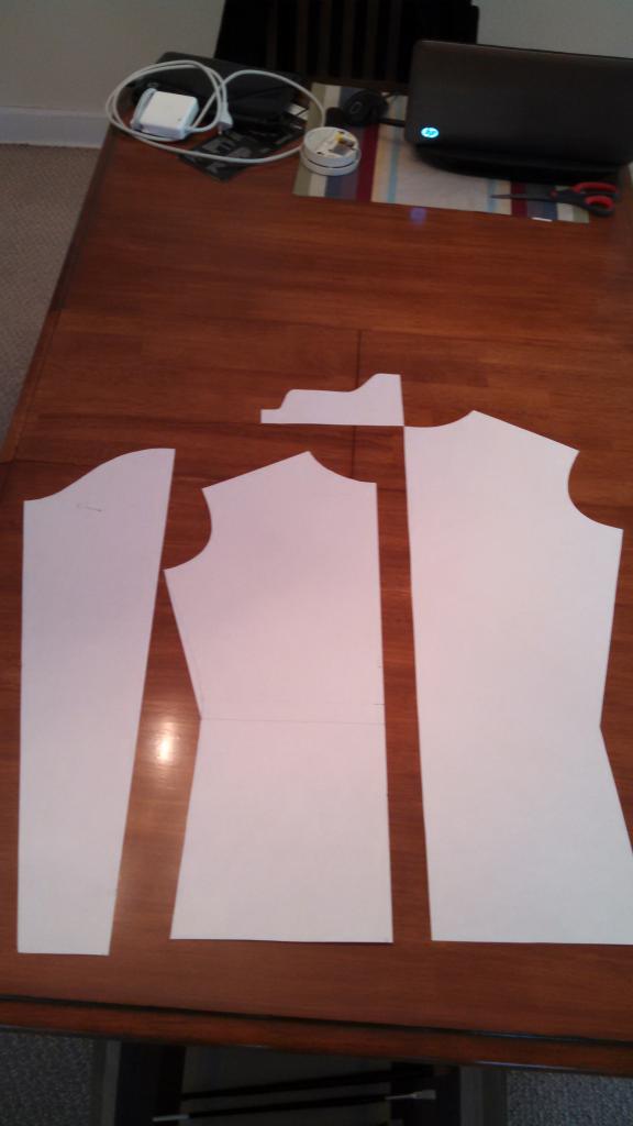

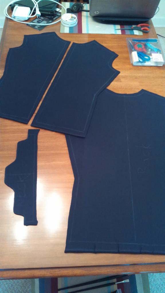

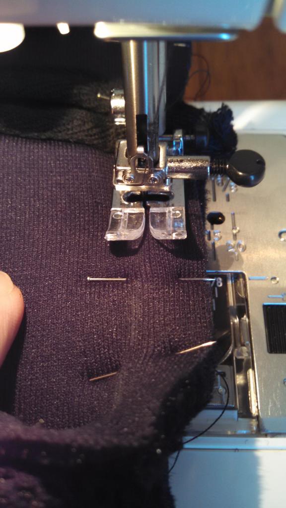

The shirt is entirely custom. I designed the pattern myself after many meticulous measurements. I ordered a stretch spacer mesh fabric, onto which I traced the patterns. The exposed edges of the shirt (bottom hem, sleeve ends) were finished with 1" elastic tape, folded length-wise over the edge of the fabric and stitched on. The elastic was too thick to follow line of the top of the neck, so that was finished with simple twill tape. The back of the neck was not sewn together, since the twill tape does not stretch and my head still needed to fit through the neck hole. Instead, the back of the neck is closed up (once the garment is put on) with two hook-and-eye settings.
Patternscutout.jpg PatternDrawn.jpg Fabriccutout.jpg Edging.jpg Sewing.jpg Layout.jpg

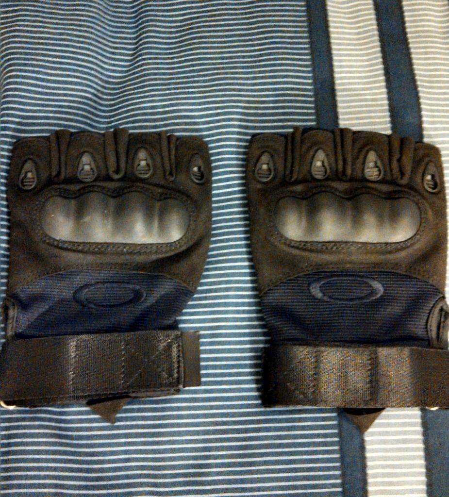

Purchased these a while ago for dirt cheap off Ebay. I know Red Hood has full-fingered gloves, but my frugality is winning out over my perfectionism. If I find myself with the cash, I may find more accurate gloves. But at the moment, that is low on the priority list. Note: the cloth is actually a sheen black, I think the camera is just picking up the blue tone of the comforter.

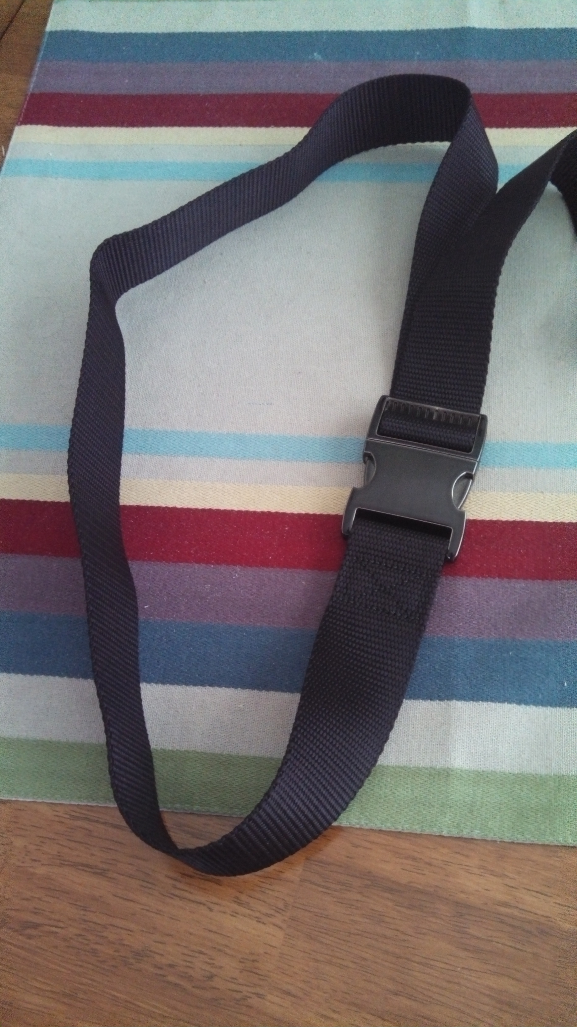

[UPDATE 7/3]: Looking into purchasing a custom nylon strap with metal aluminum buckle.
[UPDATE 7/27] Belt acquired, thanks to a custom (and very affordable) order from Strapworks.

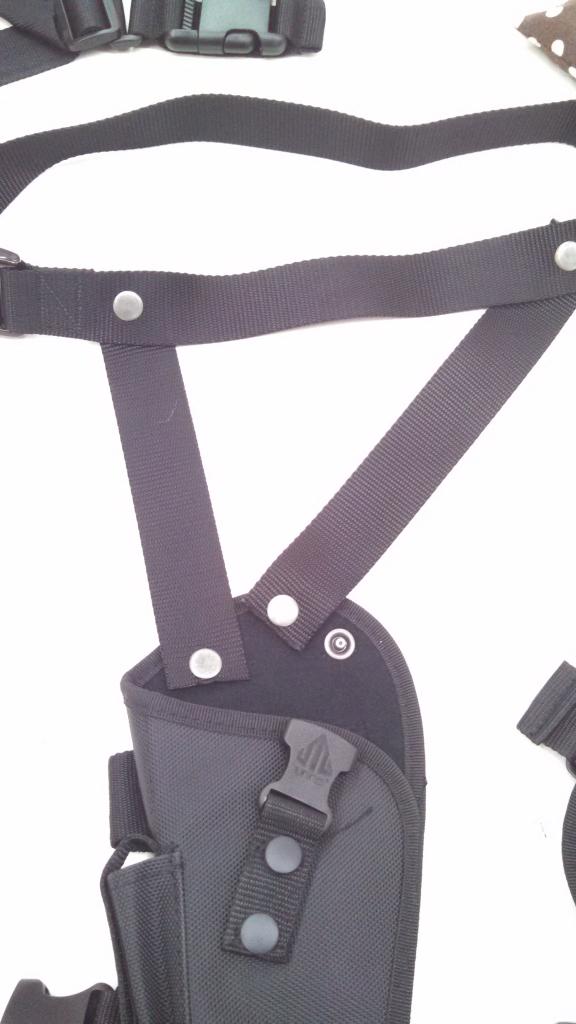

Holsters

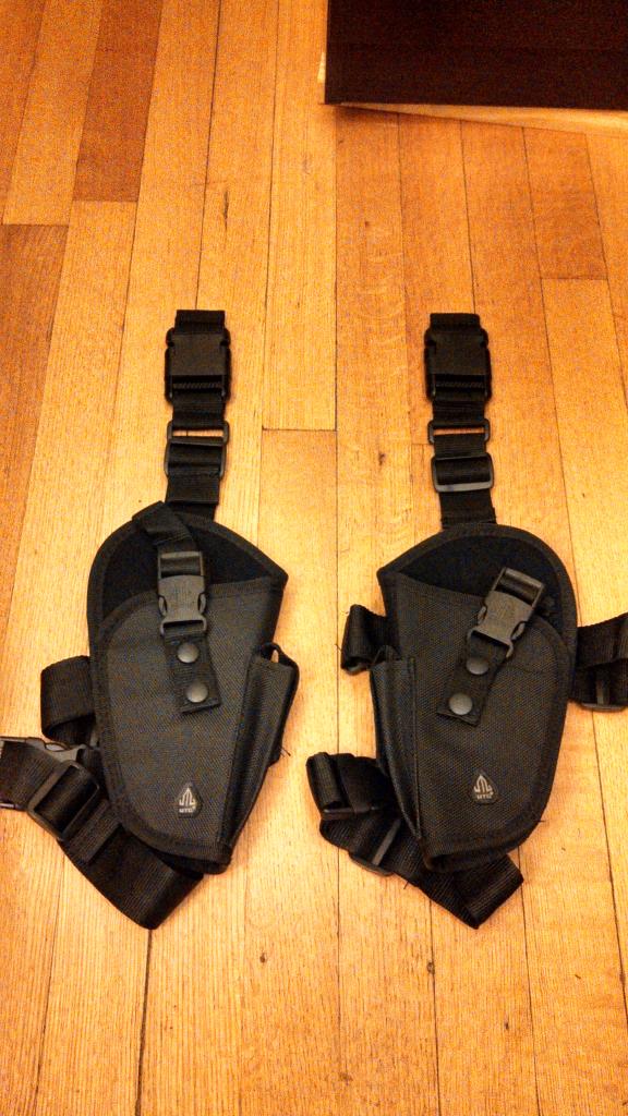

Got these off Ebay for about $15 a pop (free shipping!) and they are totally worth it. The come with a vertical strap/buckle to attach to a belt, and two thigh straps. I ended up removing the vertical straps and replacing them with my own nylon angled straps (as per the reference photos). I also removed the lower thigh straps because, thanks to the new straps, the holsters were sitting higher on my legs and the lower strap would not wrap around all the way.

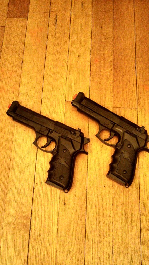

2 airsoft pistols, made of plastic, with orange tips, purchased off Ebay for $10 a piece. I will likely be dismantling them and removing the firing mechanisms (I have no use for BB guns) to ensure their Con safety.

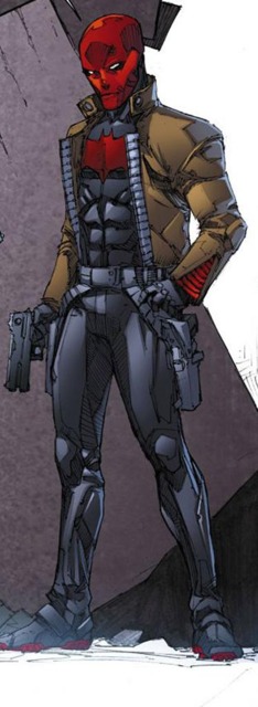

References:

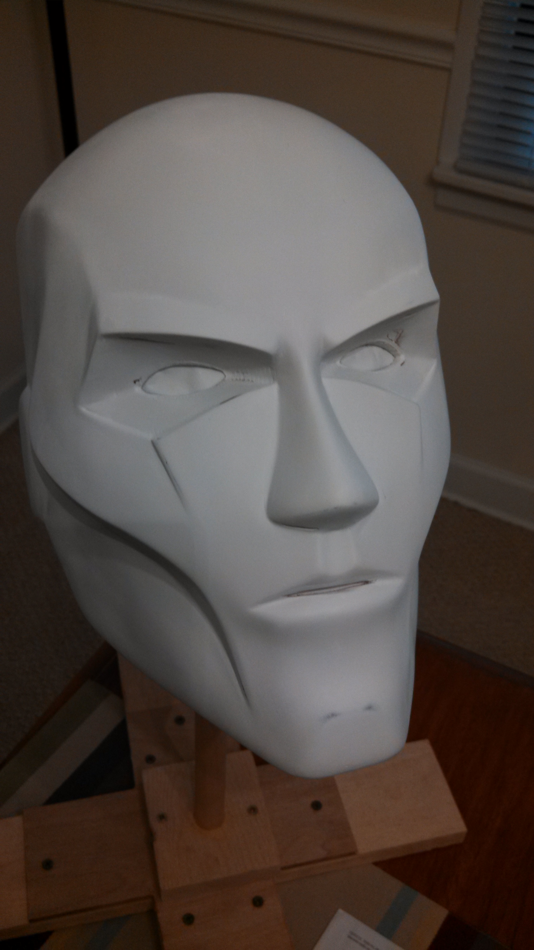

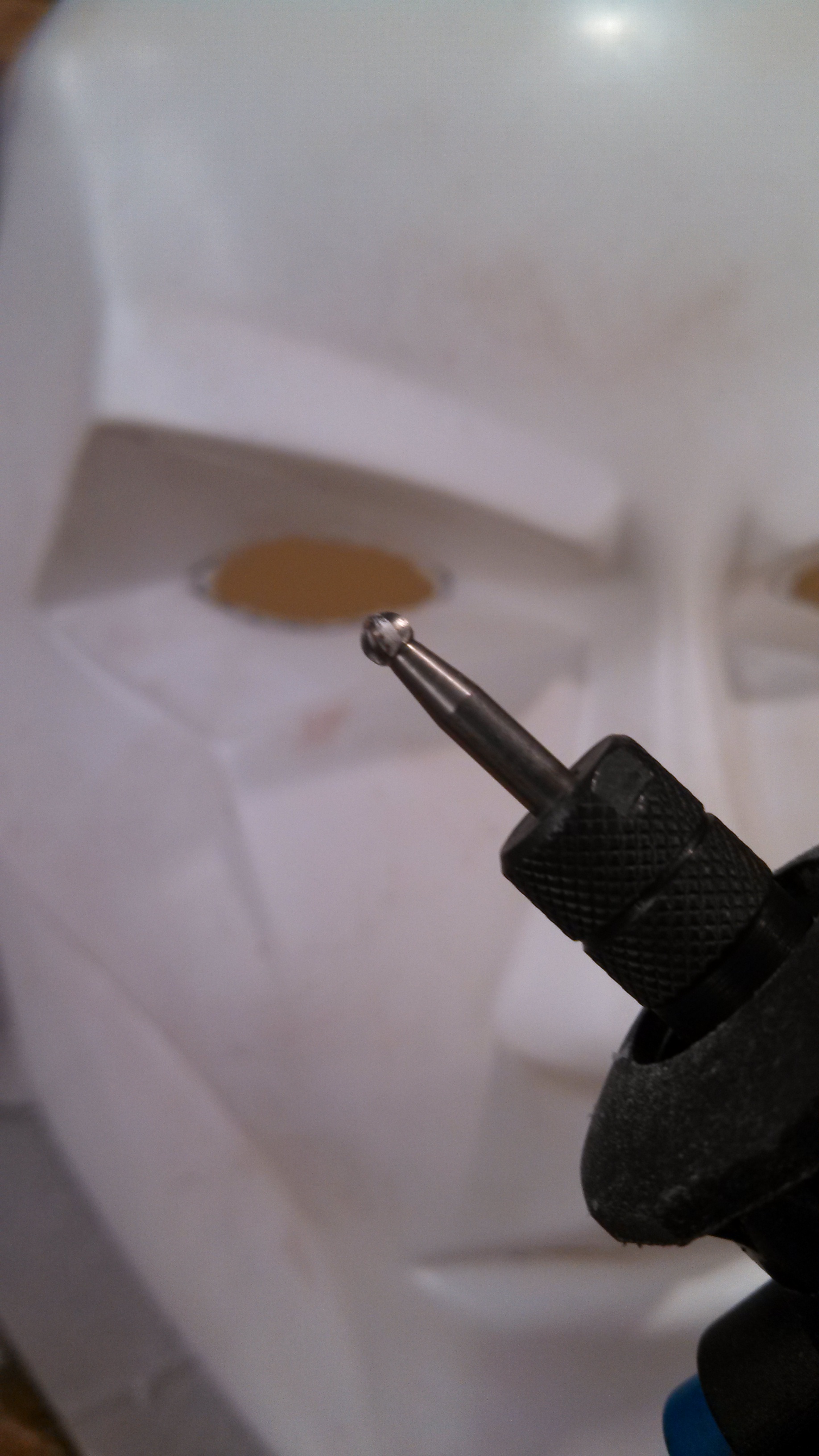

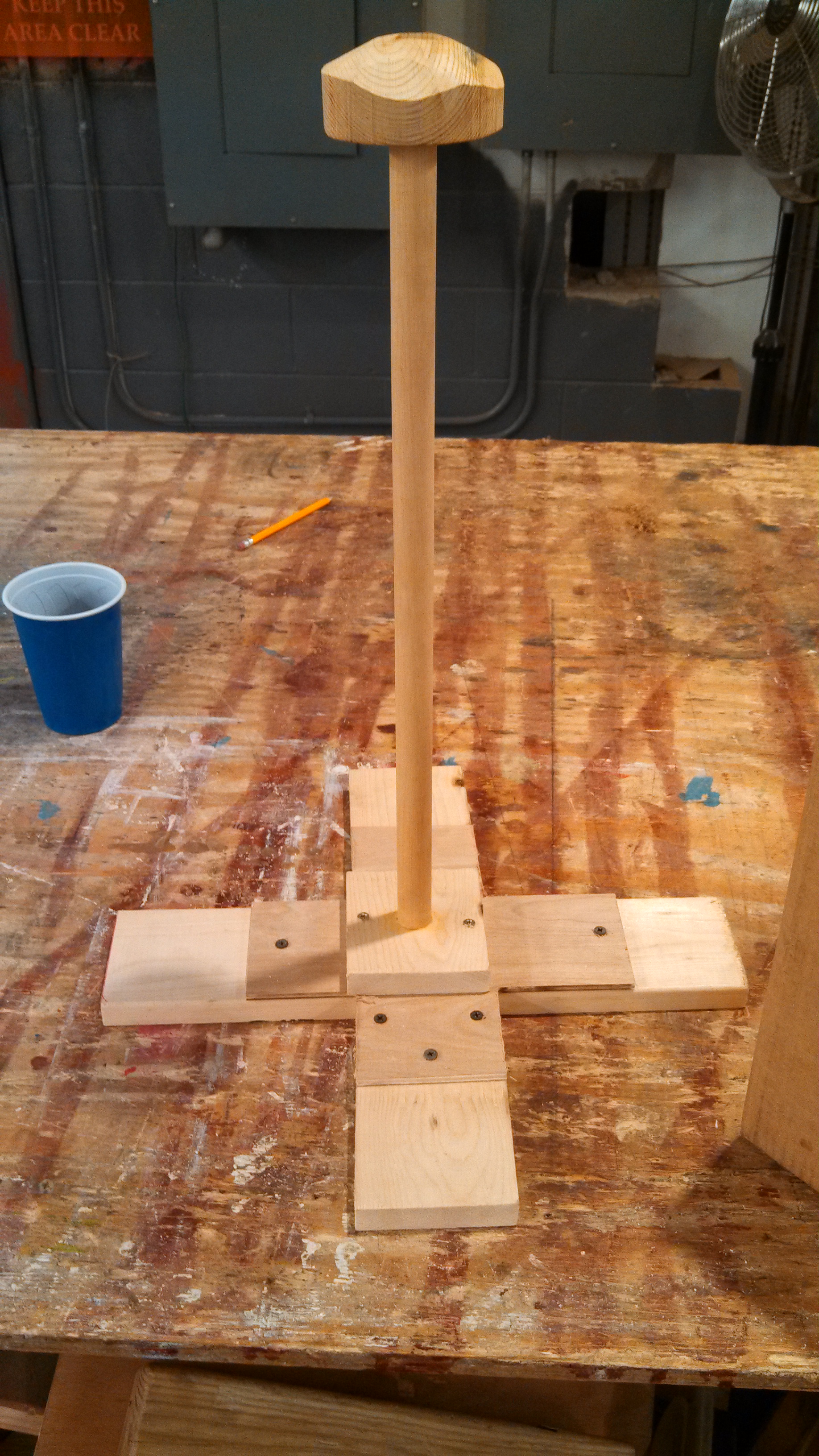

I spent about 5 hours in the workshop this week, working almost exclusively on the helmet. However, I knew I would eventually be painting the thing, and I needed a way to paint it in 360 degrees. So I bought some scrap wood from my local hobby shop for a few cents and made this:
It's simple, and the top is far from a perfect dome, but it will hold the helmet well enough so that I can spray paint it easily.
I had to trim down the bottom lip of the mask before I could get my head into it (which was a total geek-out moment). Then I used the same rotary tool + cut-off blade combination to cut the vents in the mouth, nostrils, and brows of the helmet (very similarly to how Sorenzo did it). I specifically did this all first before using Bondo on the minor problem areas because, this being my first time and all, I figured my hand might not be as steady as I want, and I nicked the shell a couple times while carving. So now I can fill those spots in again before painting.
Finally, I used a high-speed carving bit (pictured below) to carve out the eyes. I was able to get most of the eyes clean with it, but ended up switching to a veryfine drill bit to file out the corners. I will have to sand down the rim to truly make it smooth.

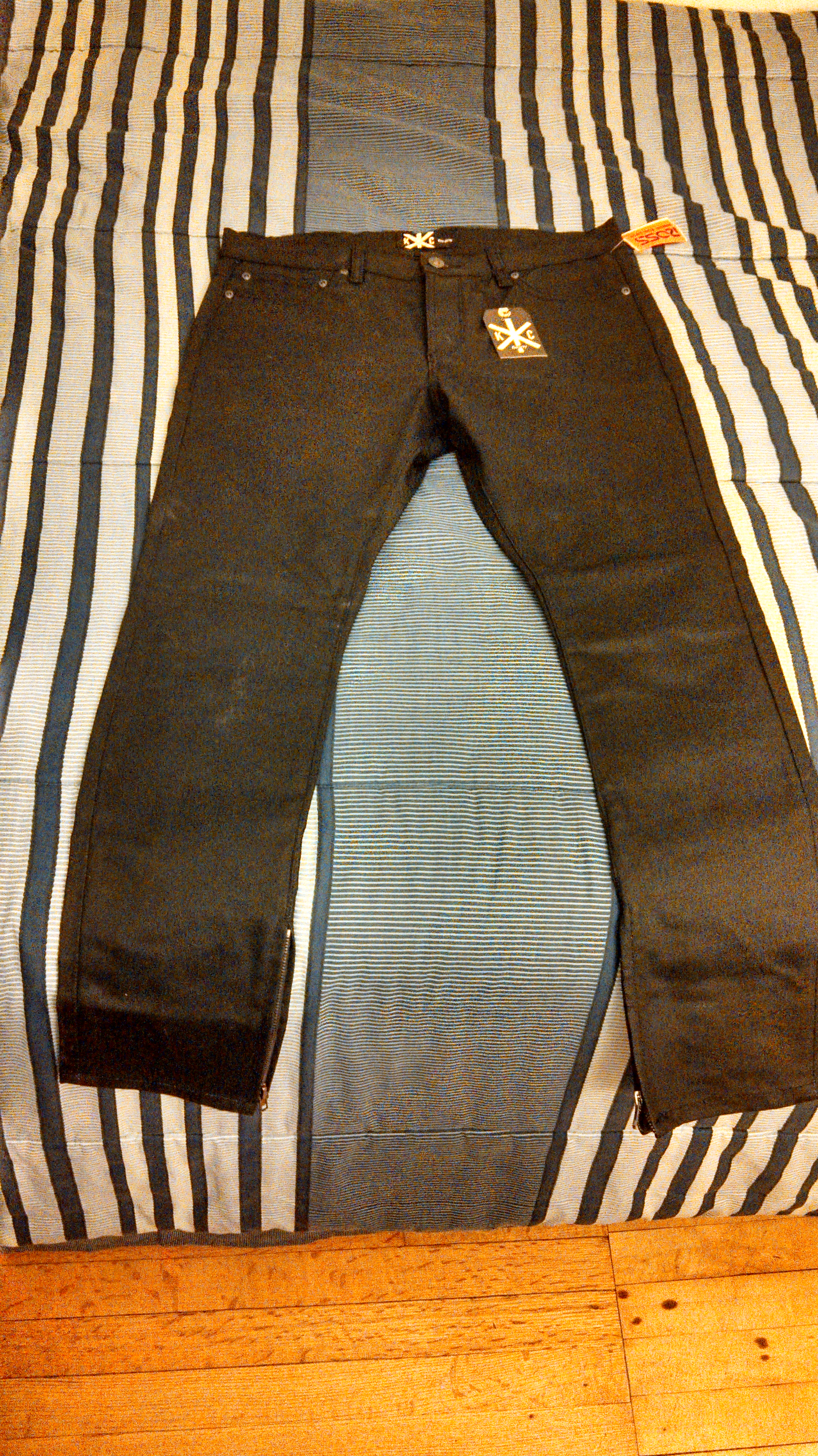

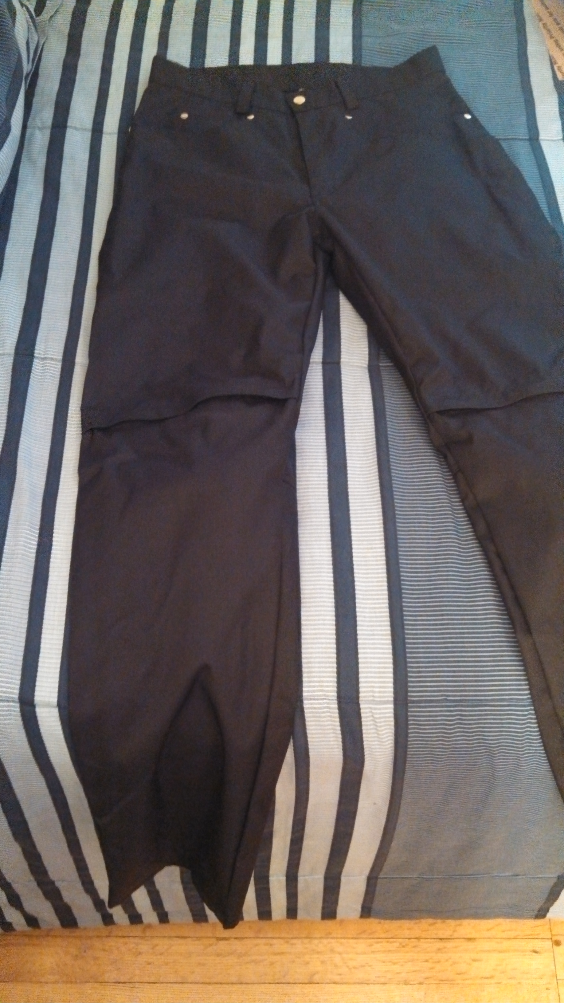

Brief update: I think I may have found some pants, and for under $20 to boot! Behold:

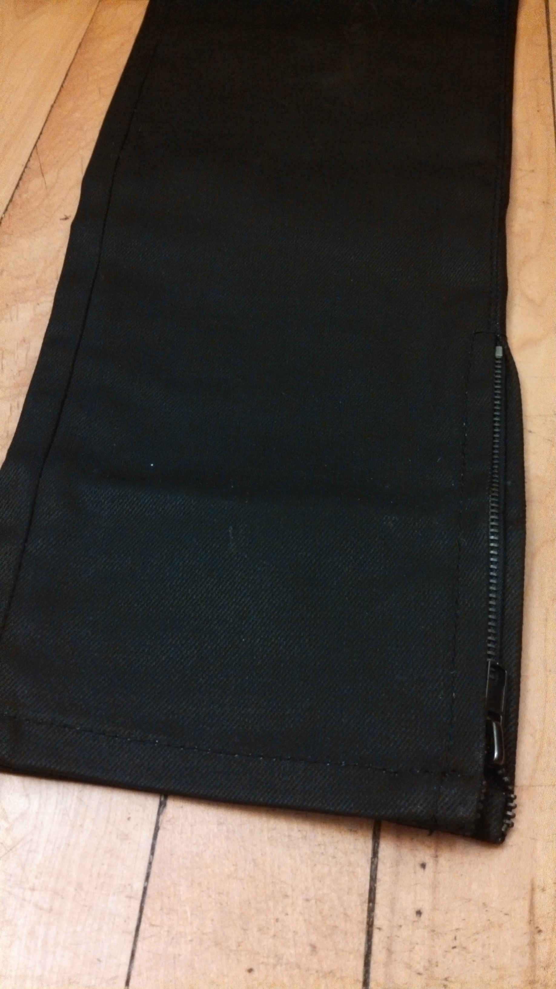

It's a denim material, with a slight sheen. 8 years of soccer while growing up, combined with genetics, has left me with some muscular legs (not a complaint), so skinny jeans/pants tend to really hug my calves and thighs, leaving an awkward shape. These definitely hug my calves, but leave enough room up top so that the pants can shift between sitting down and standing up. (There is NO shifting around the calves.) Plus:
Each leg has a zipper on the bottom of the inseam, which makes getting them over any boot-top a breeze. I will probably add an elastic cloth dart on the inside of the zipper, much like you will find inside the zipper of a motorcycle jacket sleeve. That way I can zip or unzip the pant without having the cloth flap around and allowing for some more customization options.
After trying the pants on with the boots, the overall shape was not quite what I was going for. The boots totally work for a pre-New 52 look (which I will undoubtedly build eventually), but the New 52 look is much more streamlined, and his shoes seem more form fitting and less elevated than combat boots. I found some motocross boots on ebay that have the right shape, color, and look, but are more than I want to spend. So, until my next update:
-Anyone have further feedback/opinions on the pants?

I'm curious, what are you planning to do with the eyes? You just leaving them open, you going to cover them with lenses or a see through material?
I will be using the same method Sorenzo used in his original build: perforated vinyl (the type of stuff they use to paint train and bus windows with advertisements). I will have to see how flimsy it is first. If it will not stay/look right on its own, I'll be laying that over two cut-out pieces of clear plastic bottle (already curved!) and attaching it that way. Makes for a very cool comic-accurate white eye effect while still allowing for pretty good visibility.

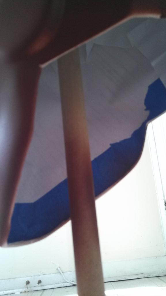

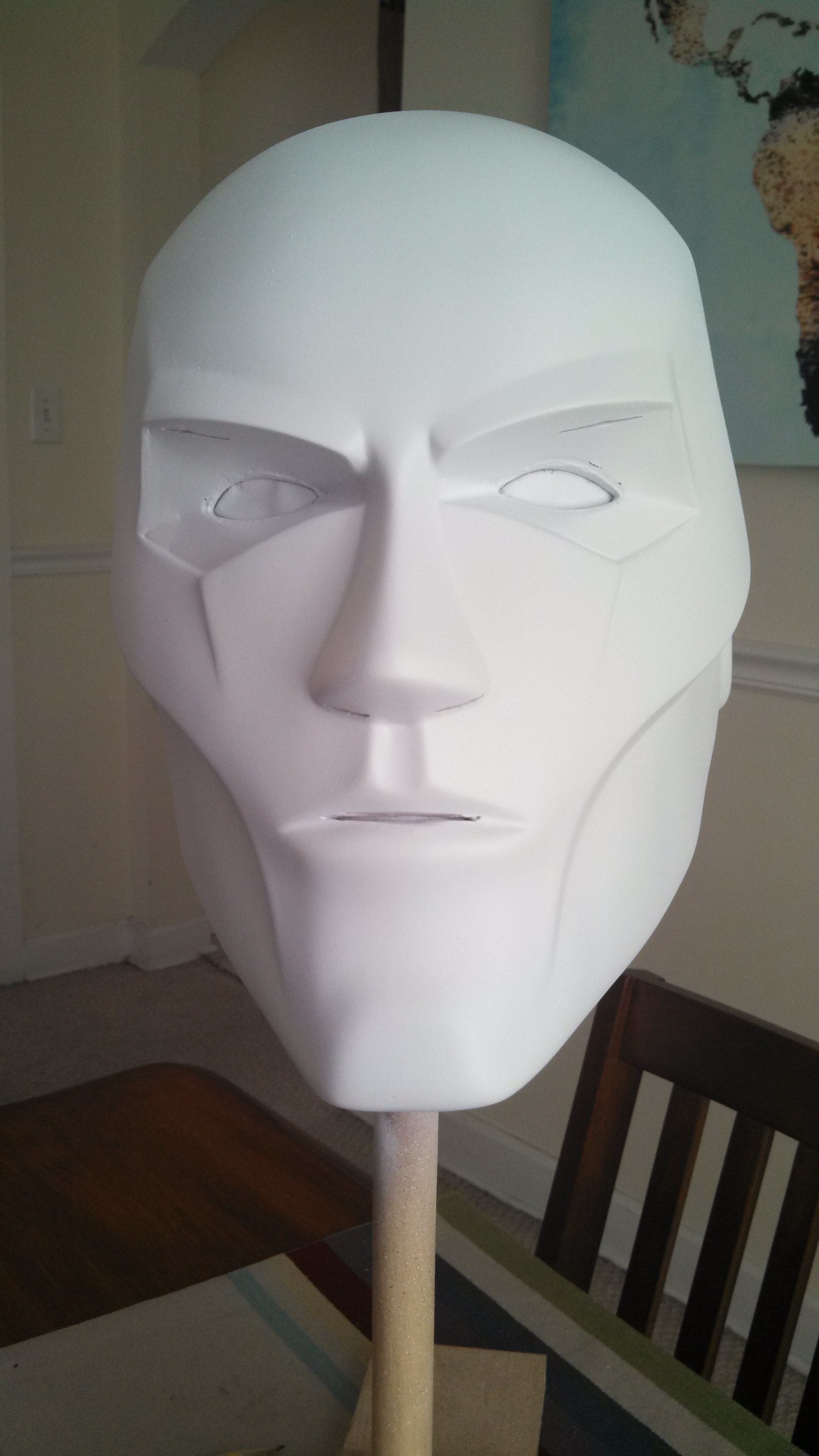

I did not get to work nearly as much as I would have liked over the weekend, but I did get the first primer coat on!
I taped up the eyes and vents with Scotch Blue, as well as the rim of the helmet opening (shown below). The rest of the interior was just lined with scrap paper, for any floating paint particles that may make their way in there. This was my first attempt at spray painting a very 3D object, so I missed a spot or two, as you can see on the lower part of the ear cavity in this photo:
Not a big deal since my next step will be to use spot putty on the few pinholes, wet-sand the whole thing, then prime it again.

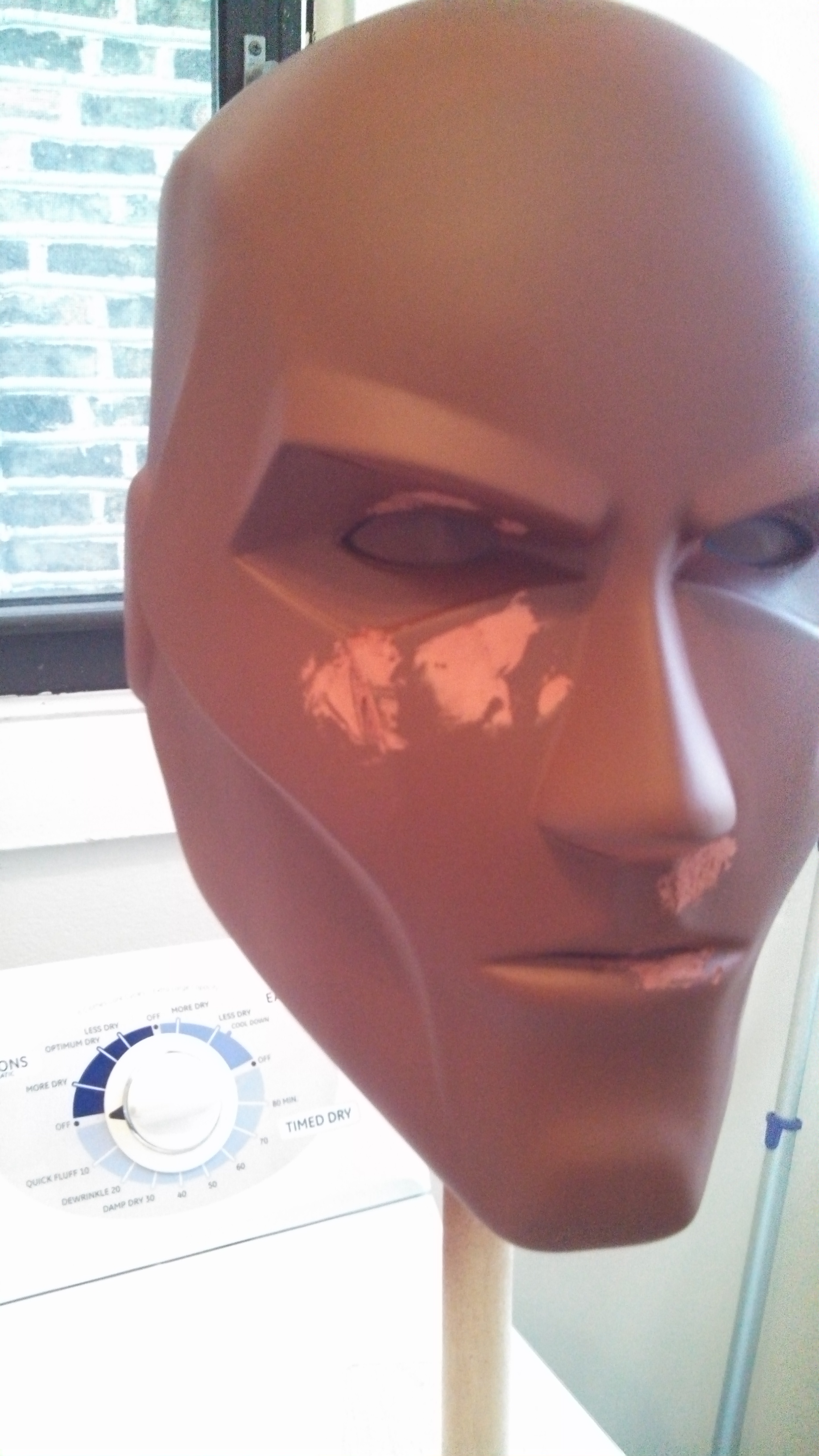

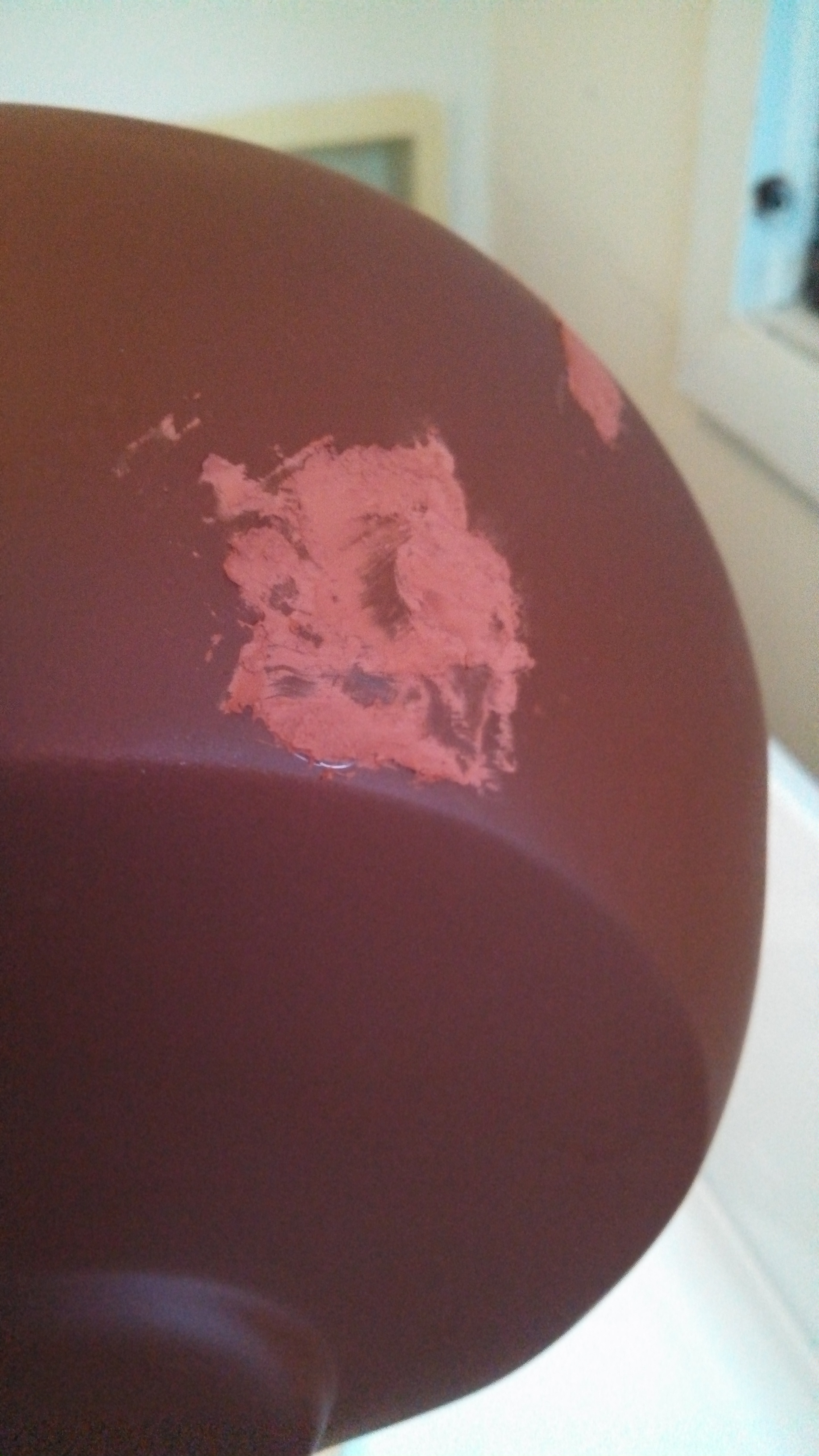

As predicted, the 1st primer coat revealed a couple more pinholes that needed filling:
It was time for Bondo Spot Putty! 1st time using the stuff and man was I glad I invested in a respirator. The only time I smelled it was when I flexed my face muscles from discomfort, which broke the respirator seal very briefly, and that was enough! Smelly stuff... but the application went all right. I was able to get all the depressions and pin holes, plus the one or two knicks that were my fault from a wild gesture with the rotary tool while cutting the vents.
Here's hoping the weekend wet-sanding goes smoothly, all the imperfections are filled in, and I can move on to the 2nd primer coat!

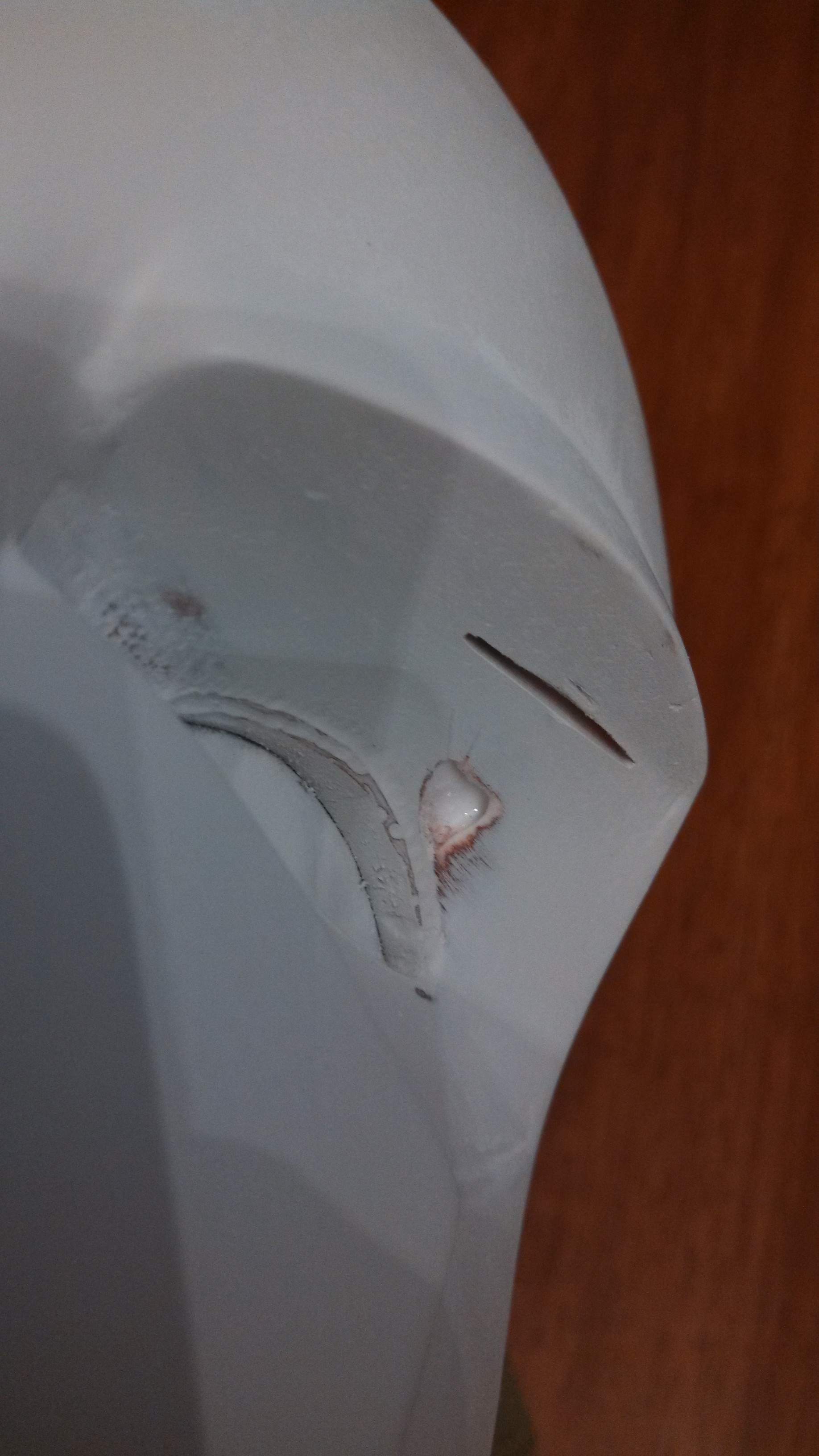

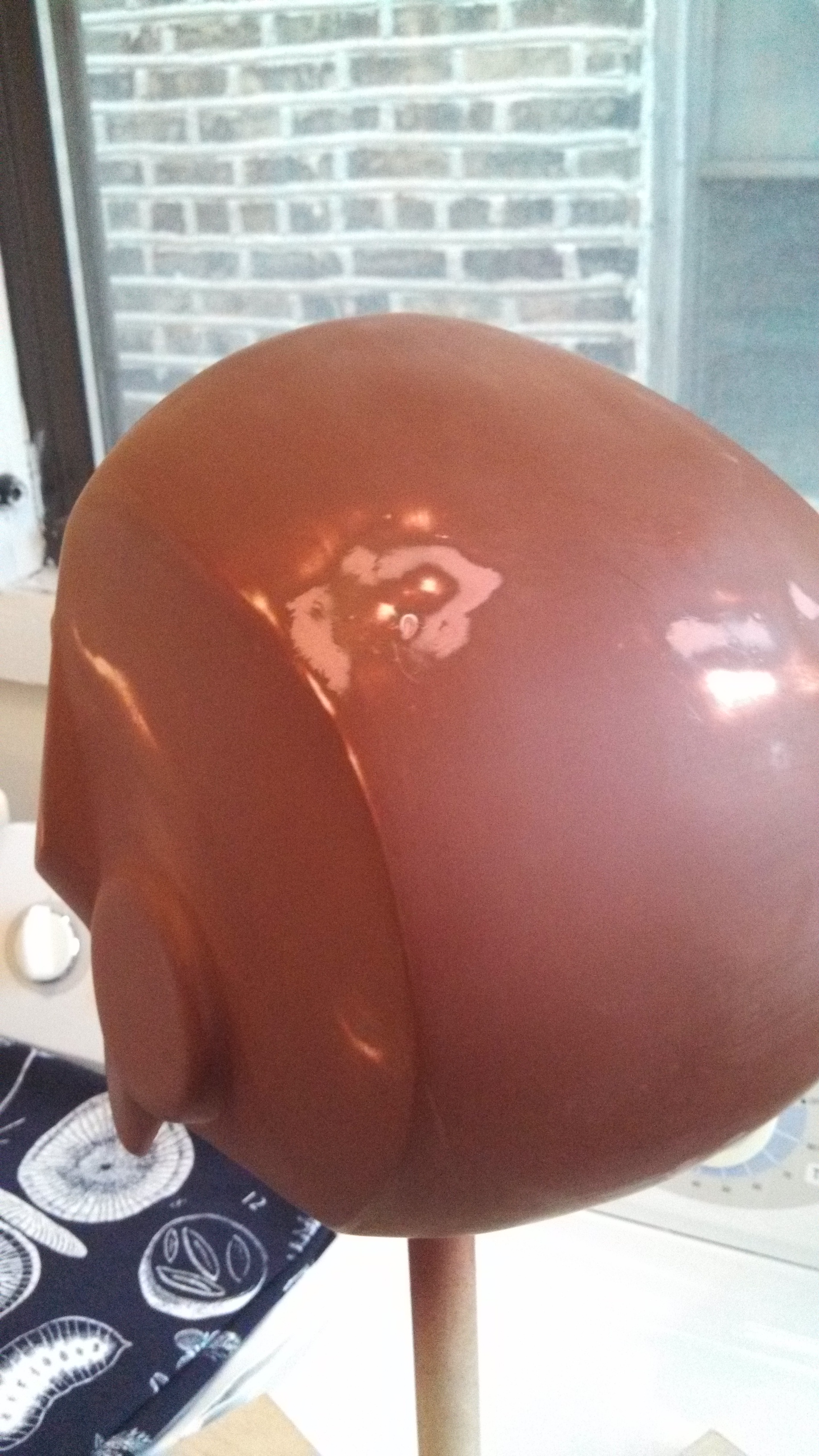

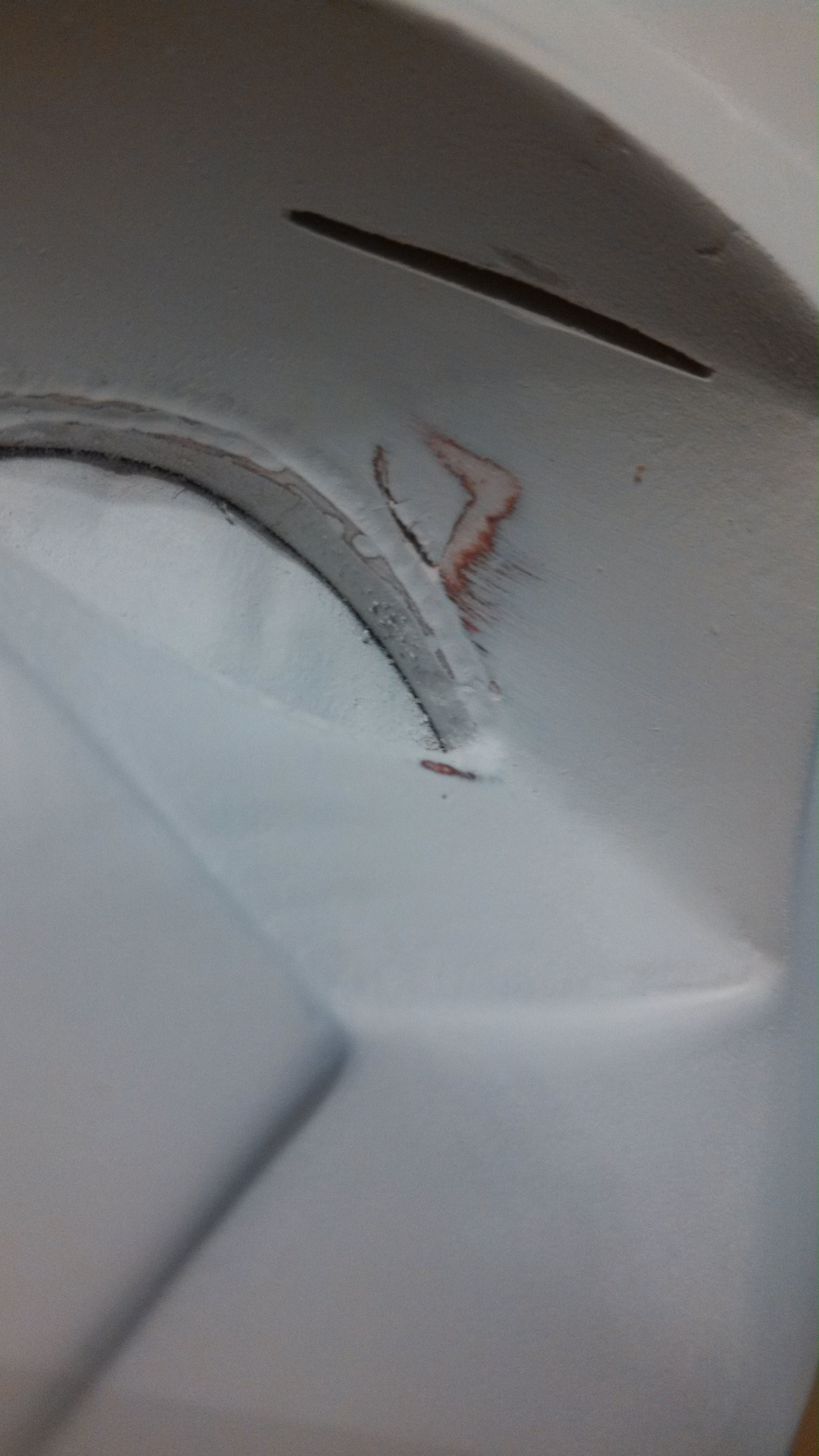

Minor setback today.
Wet sanded the 2nd layer of primer this evening:

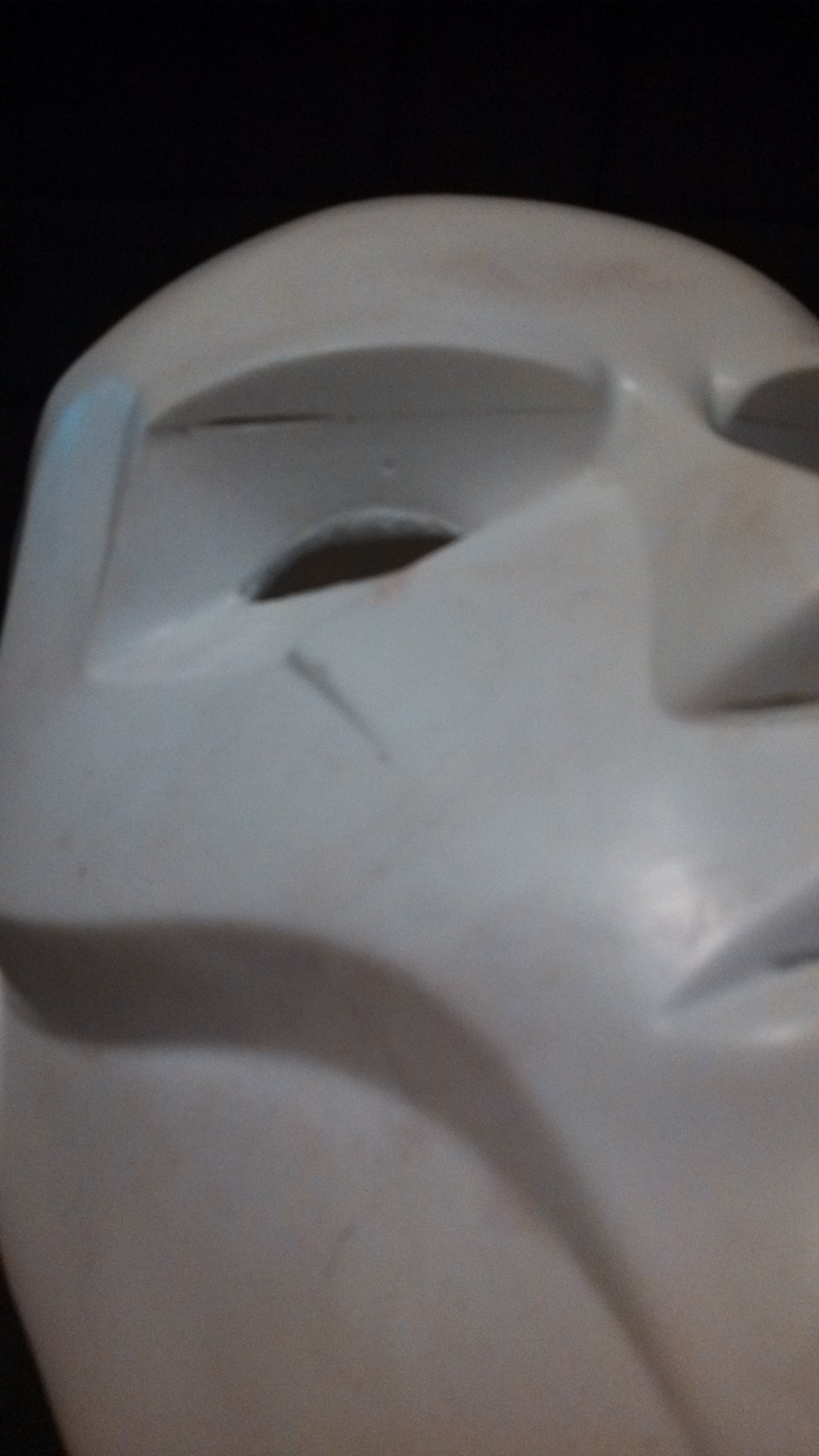

While doing so, I noticed what I can only describe as a split in the paint, above one of the eyes:
I gently poked at it with a hobby knife, and felt it depress slightly. My fear all but confirmed, I started to chip away at what was clearly a hollow spot:
BALLS! Of all the places to get an imperfection that size! My guess is a thin resin film formed over the air pocket while the cast was drying, and it probably tore open while I was sanding the first primer coat. *sigh* Looks like I will have to break out the Bondo again, and possibly buy another can of primer.

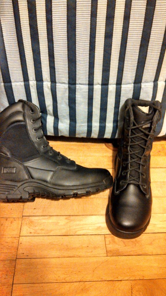

I need opinions on boots!
Here's what I'm going for:
Below is what I have. I returned the pants shown, but they give an idea of what the boots will look like with a tight fitting pant:
(Pardon my poor quality. Phone camera, brightened for visibility's sake.)
I think, even with pants that came down further over the boots (which is my end goal), I still need boots that a bit less bulky (i.e. a lower sole/heel). Am I being overly critical?
