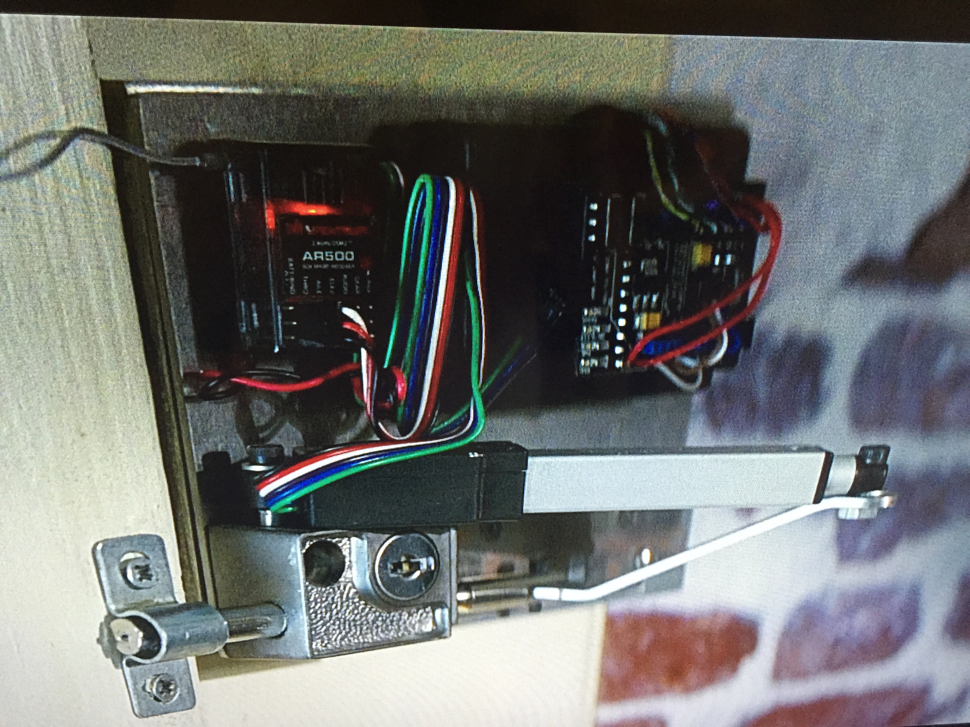

Hey everyone! I am new to this site and this is my first go at replicating a prop. I wanted to start off relatively simple, so I decided to build the automatic locking mechanism seen in Amazing Spiderman 2. I have seen a few attempts on youtube, but none of them are screen accurate.
I was able to get some screen grabs, which allowed me to identify the locking mechanism, actuator and receiver used. That being said, I cannot for the life of me figure out which controller is used on the right hand side of the receiver. I am thinking the main controller is just an arduino (or an arduino type knockoff), and there is some sort of shield on top. I cannot imagine it is a custom shield, so if anyone has any idea what shield this is (or board in general if it is not a shield) please let me know!!
Any help would be greatly appreciated, and I will continue to update this thread as I progress with the build. As of right now I am just waiting for parts to arrive that I have ordered.

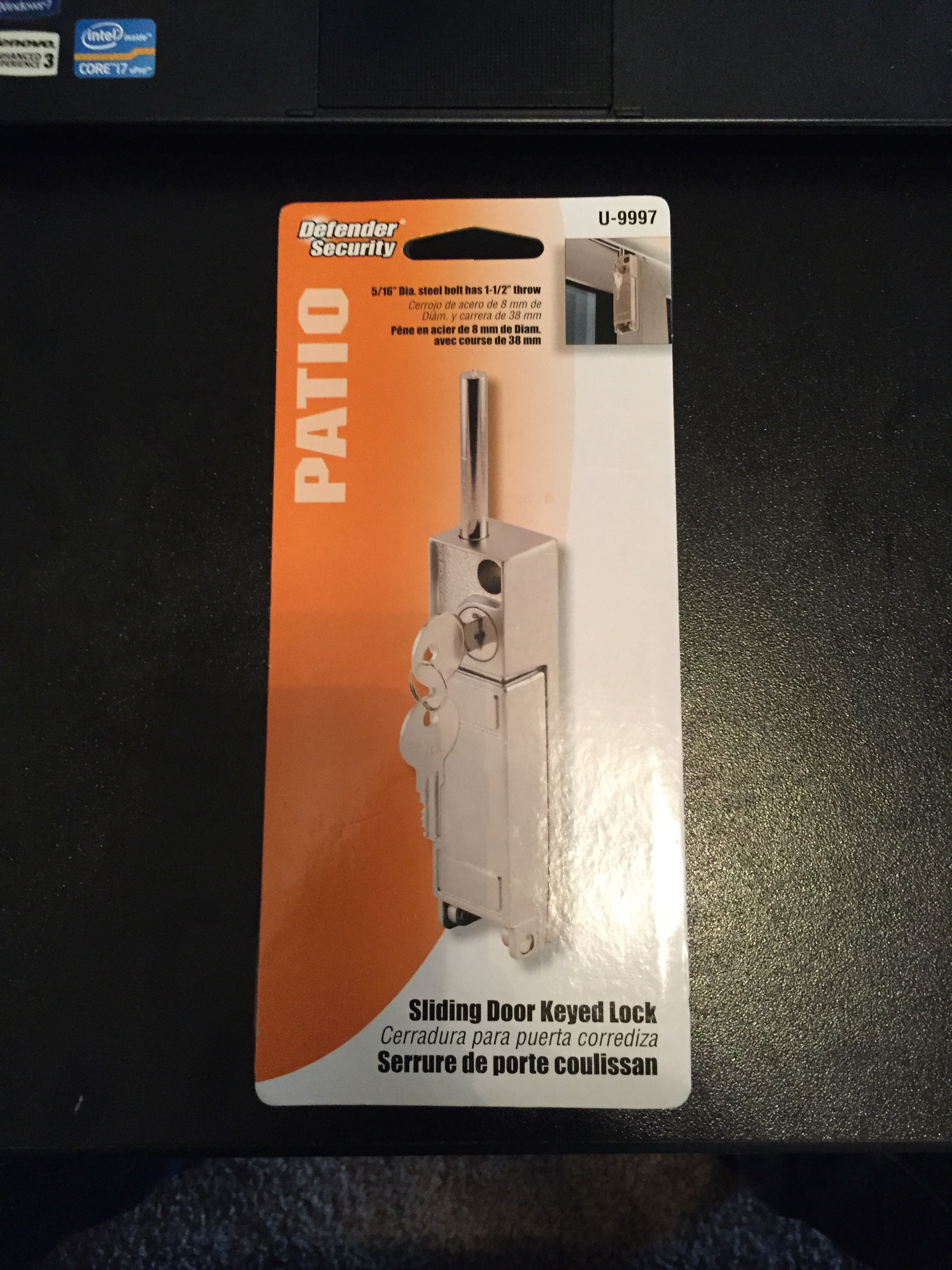

The lock arrived today, and it looks like an exact match. There were more modifications done to it than I originally expected.The arm that connects the bolt to the outside housing is much larger than what comes with it, so I will either need to find the linkage arm or make one. Also, the post that the actuator is mounted to is not there.
Now comes the task of figuring out the size of the linkage arm and actuator from the known dimensions of the lock. I know this is probably relatively simple to do, however this will be the first time doing so. If anyone has any tips, please let me know!!
