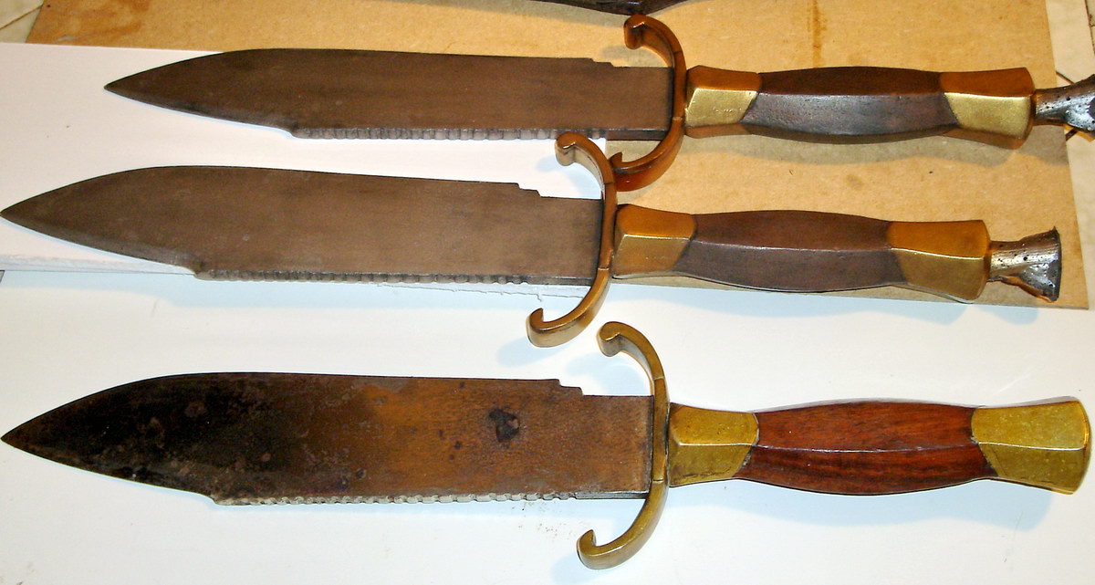

The casting material itself plays a big part in the durability. I use a high impact plastic that was developed for prop use. Ive made cast in color parts as small as a few grams that held up after heavy use. These knives are a great example. The master was not modified in any way retaining the original blade edge and thickness. In the end the hero wasnt even used, just the castings. These held up for a few projects being thrown, fist fights, bounced off walls in Django Unchained... Cast in color, no paint, strait from the mould. I still have them. Ironically a stuntman toying around broke the tip off of one by trying to stick it into a table full force. Just the tip broke off.

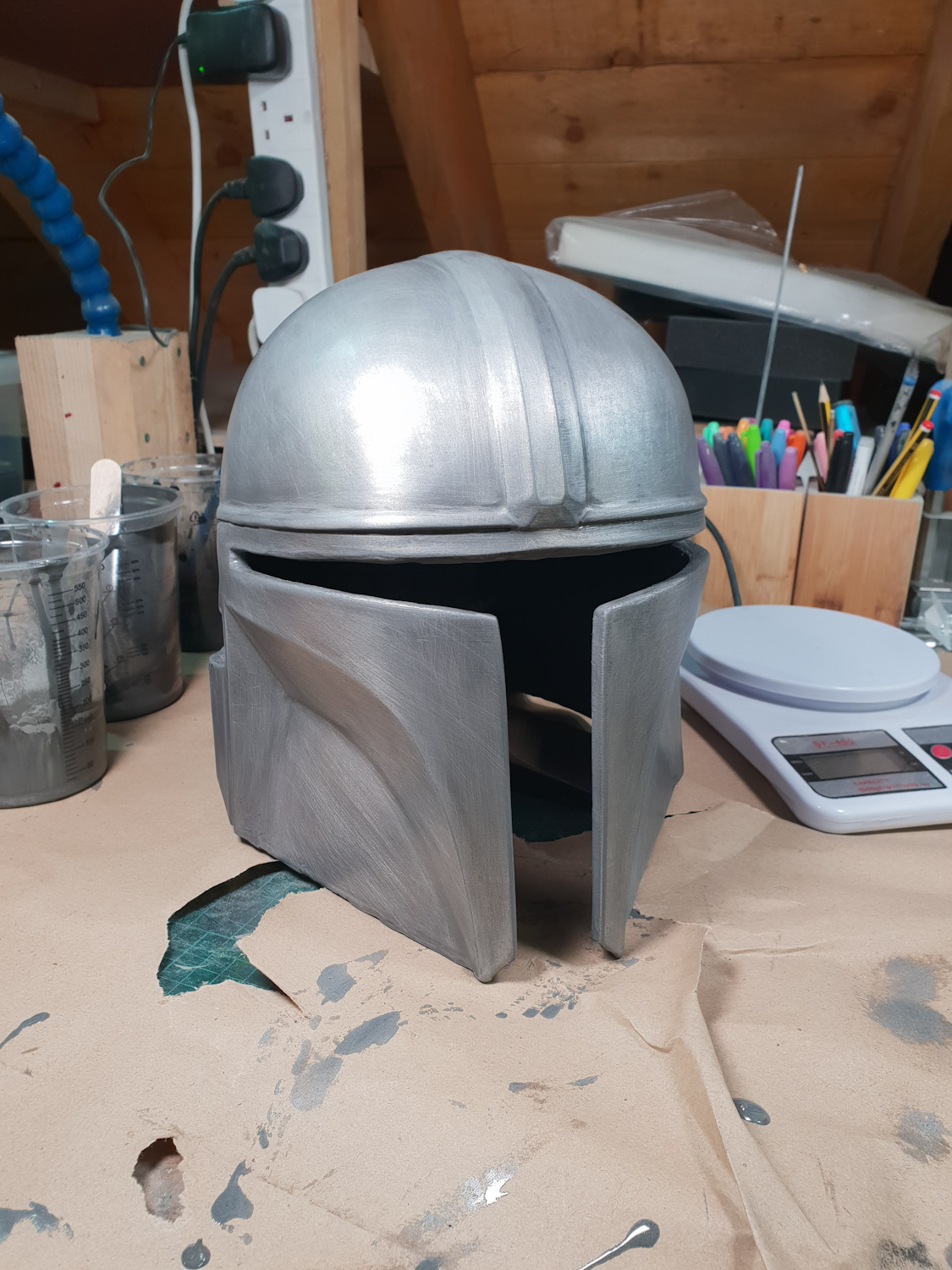

ok well i'm doing a mandalorian helmet and i 3d printed and doing an xtc-3d coat over the top and had pretty good success adding aluminium powder for a predator mask to the surface coat so i thought i would try it again but to darken it down i added some graphite powder too - will report back tomorrow how it turns out
well it works with aluminium in there too - just makes it slightly darker - doesn't come off on your hands but then again i think would need a lot more of it if it was just by itself
