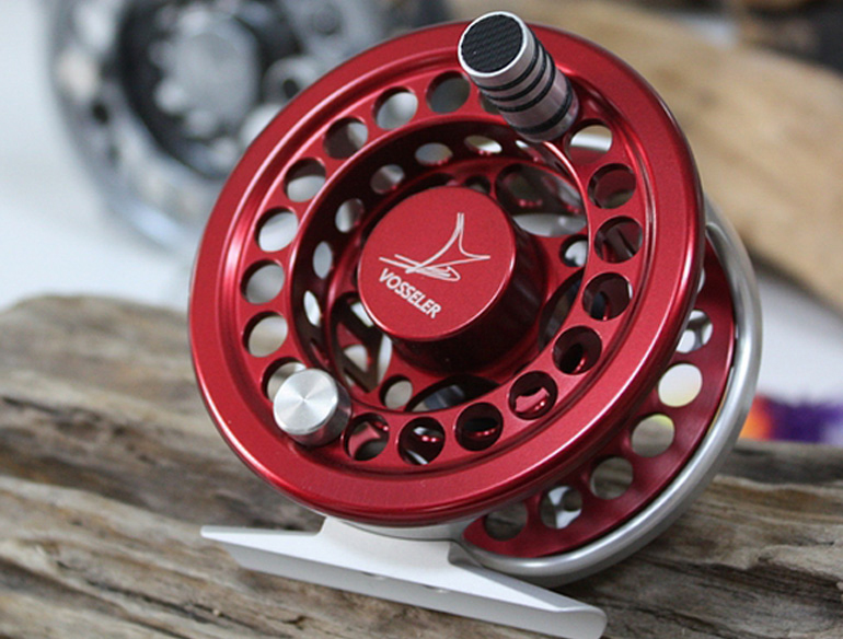

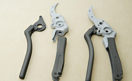

I plan to have the body professionally anodized with some sort of black, similar to the handles in the following picture:
I'll probably be getting the pommel anodized in a dark red, since that'll probably match the screen used ones the best.
The anodizing should hold up a bit better to abuse than a powder coat... Though I'm not sure I'll be dueling with this hilt. This may be the heirloom on the mantle...

You know, I thought about anodizing too, then taking steel wool to it for some weathering, hitting the new exposed metal with some aluminum black, and going from there. The hero has a weathered but polished sheen, which I may be able to accomplish with the clear coat patina sealer. If you end up getting a quote for the anodizing, would you please let me know what you find? I'm still interested in possibly having the end cap anodized. That sure is a nice color you posted there.

There are clear Ano's however I'm not sure how that would effect a patina. I suppose doing some test pieces to build confidence will get it. I probably would try polishing the clear sealer first.
One other note about Anodizing if you go this route. It's more of a chemically bonded adhesion vs paint. You can break an anodized surface, but it's much harder and less forgiving. Also specific colors are much harder to achieve. If you have for instance a very specific red color your trying to achieve ie Pantone color you may be doing a lot of trial and error to get that specific color. If close enough works for you or there's a specific ano red that a vendor supplies that might be just good enough. Just FYI in case your thinking about weathering also. I think paint could be the most forgiving especially if you need to re-paint or address some areas again.
Anodizing is more of a commitment and much harder to go back plus at a micron level will become a part of the AL so stripping or breaking an Ano gets into the base material. Sometimes the Ano isn't the smoothest finish. You can get a very subtle orange peel effect on the surface. This might be what your looking for and on a weathered piece it might be just fine. I'm thinking for myself if I were to go with an Ano I might just use it on the pommel bit, but only if I could nail the color and that's where I know I could absolutely nail it paint.
I'm sure there are some folks with more experience that could add their two cents. Just offering my experience. Hope that helps.
