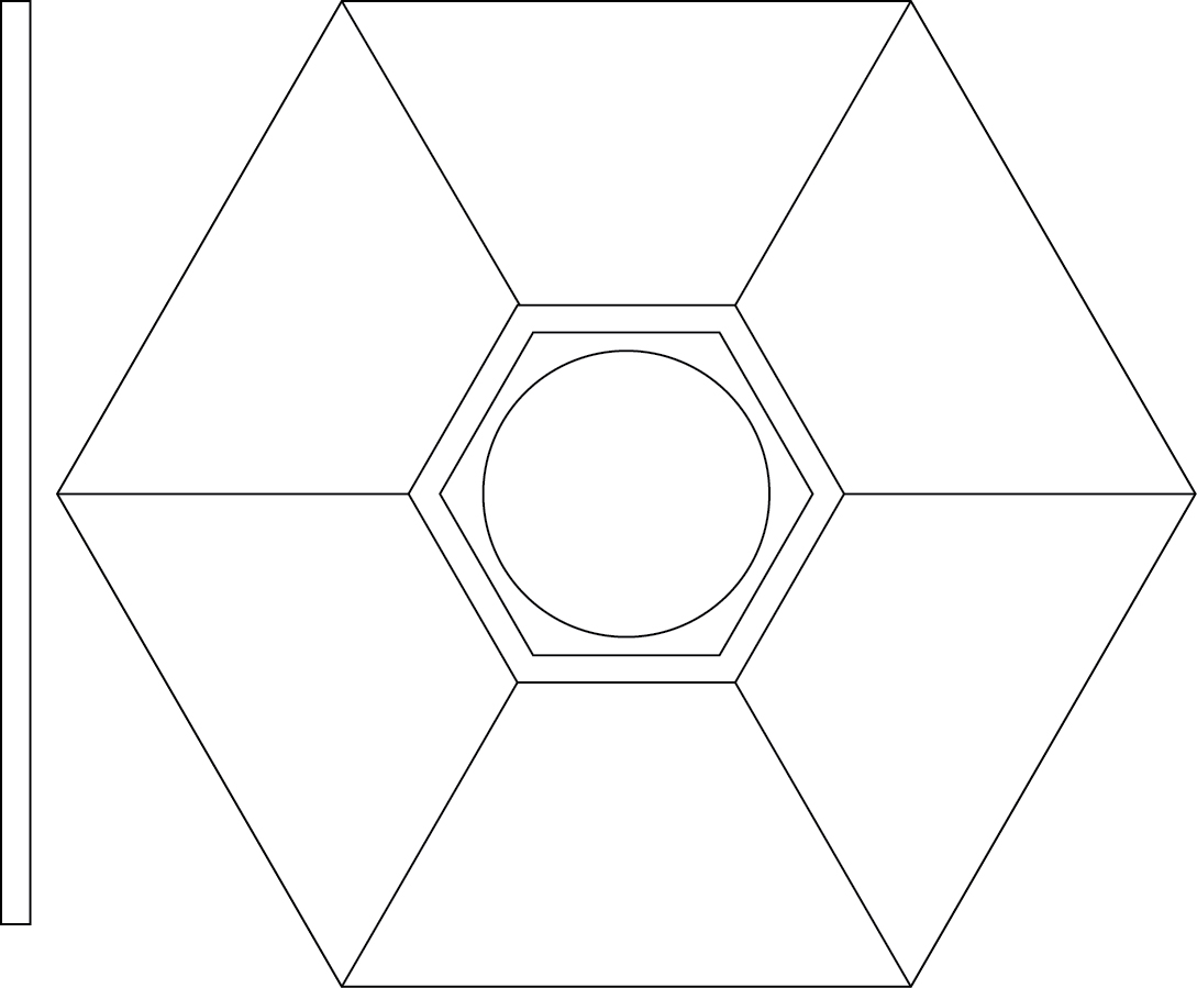

Problem 1. Not a big problem, but I'm a man of action, not a man of maths! So, I created a scale version of the console and then stuck a scale box, the same height as Jon Pertwee, next to it. tardis console scale.jpg
After several photocopies I had a console that was the correct size for the action figure. I think...?

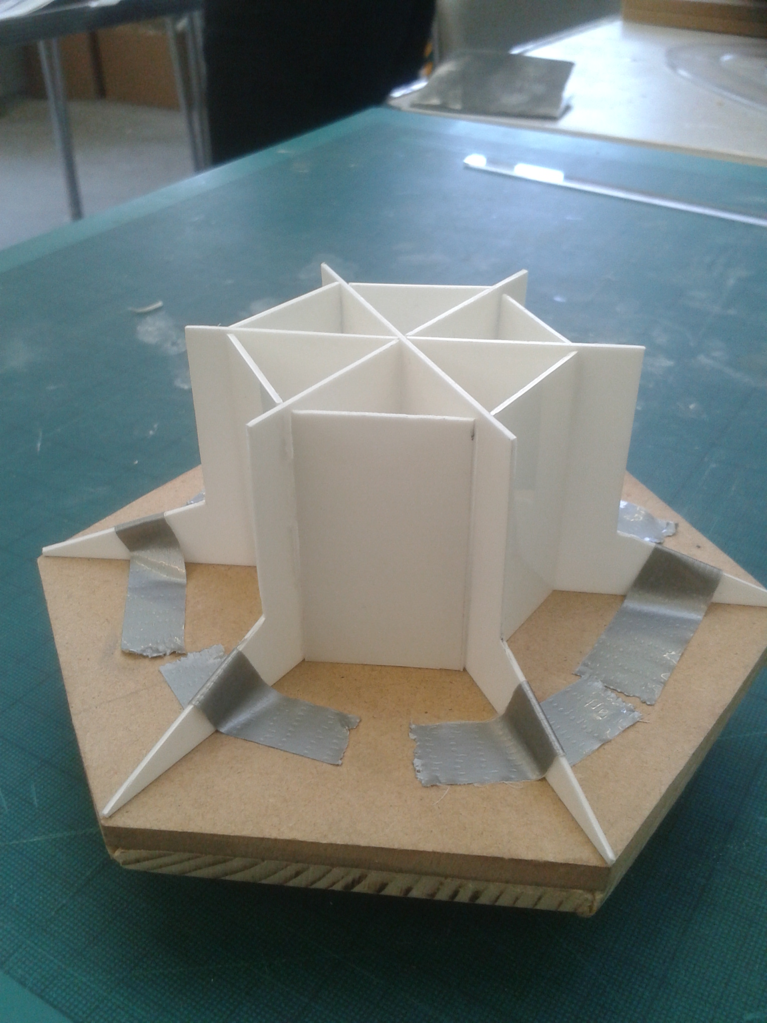

I've started with the base and then built up some quadrants and attached them all together.

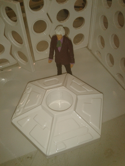

Now it's time to vac form the base. (Anyone who knows me also knows that I am impatient and always jump further a head than I should).

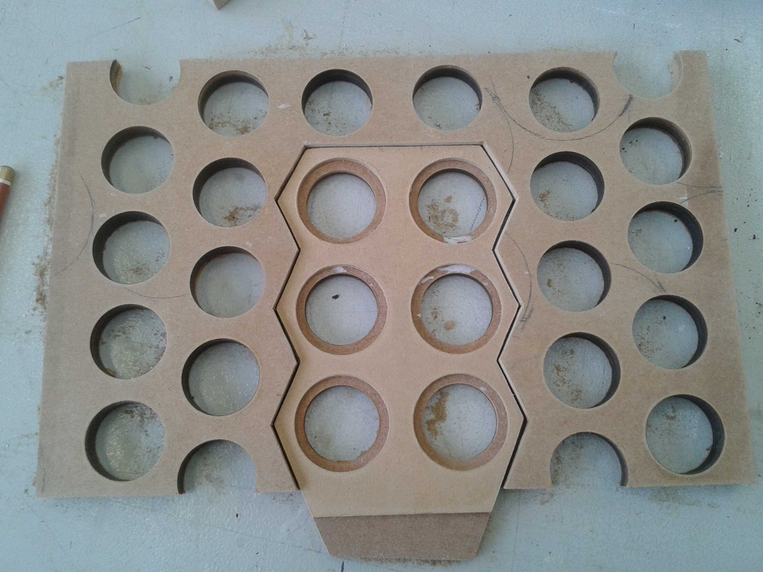

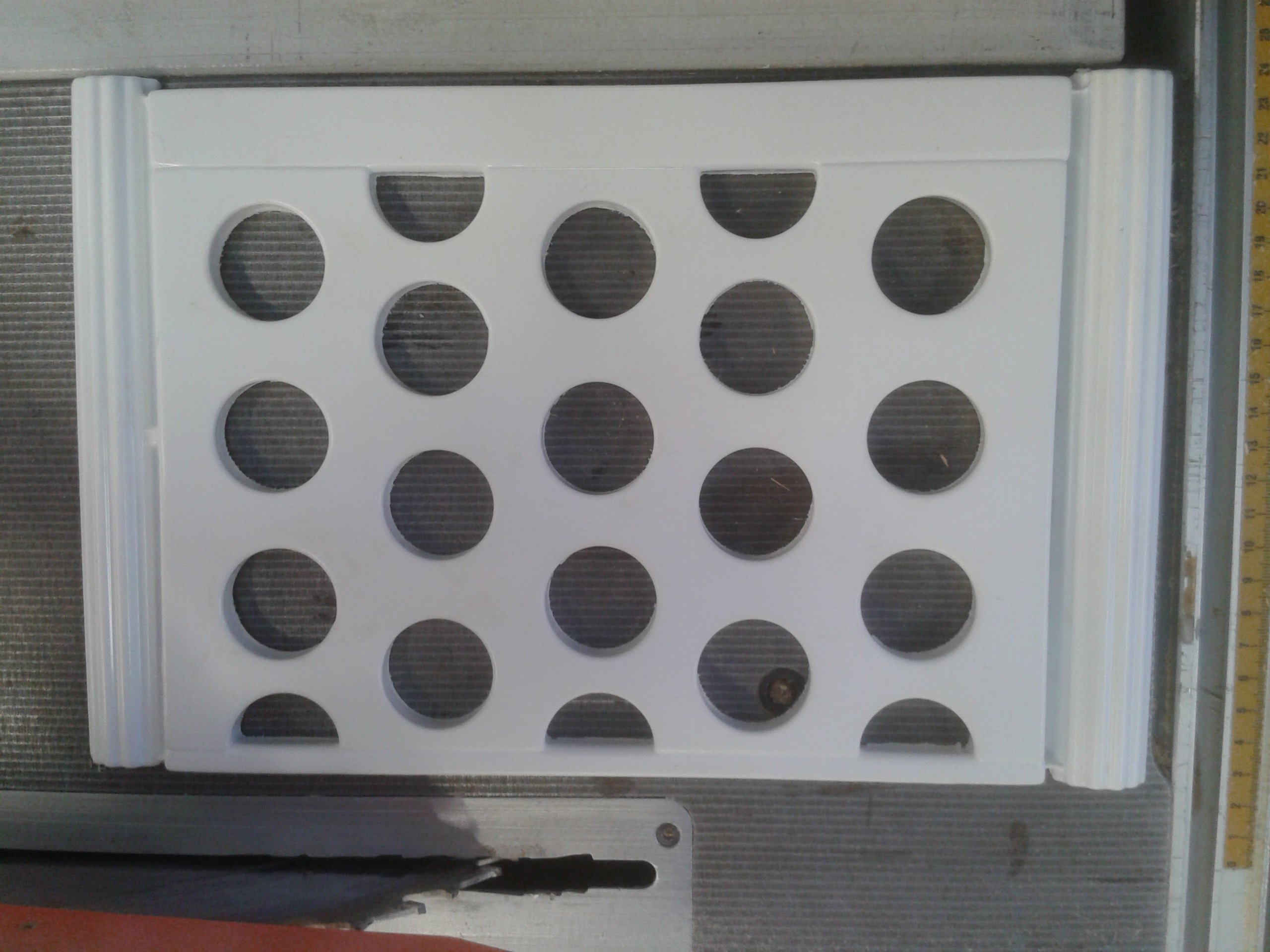

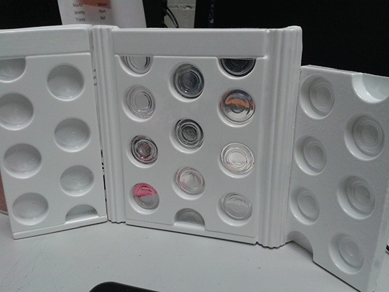

2014-02-06 16.20.06.jpgBeen working on the walls. Vac formed plastic. Sorry the picture is upside down!! And here's a couple of walls put together. This is the vegemite Tardis interior. You either love it of hate it.
Heres the door. I will have a go at vac forming it later today. I think I will have to make the door frame wider to accomodate the plastic thickness.

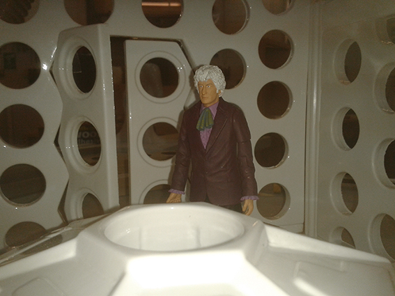

Tried the first pull of the console. Came out a lot better than I thought.
vac formed console 2.jpgvac formed console#.jpgThe panels are just the bases for all the buttons. Now comes the detailing.

I think I'm going to make a Three line wall and a two line wall. Here is a pic of the two line. As another test I put the roundels in the vac form instaed of sticking them on afterwards. Might work?
