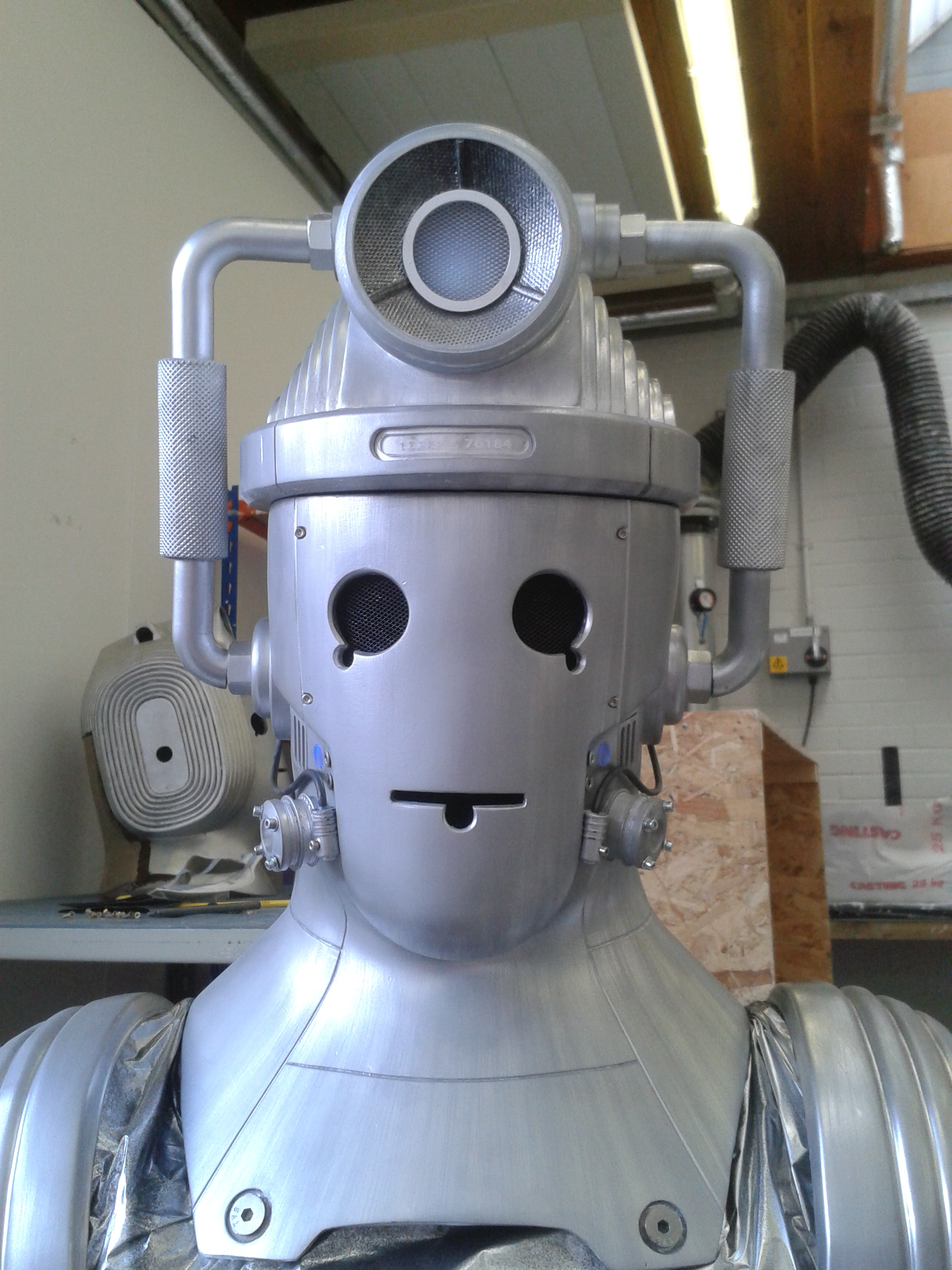

And once again I cheated and painted it silver. I'm glad i did though, it has showed up some marks I hadn't seen before so now I can deal with them. It's getting close, I'm trying out some textures to try and get a nice brushed finish. Any ideas?
View attachment 154939.
I will be moulding the ear pipe and making them in one piece which will eventually have a textured handle grip on. Oh, and I have to do the lights... forgot about that. Luckily I have a bag of blue LEDs from another job I was doing.
