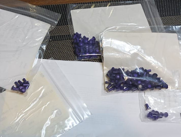

The one thing i was nervous about the purple rivets just got cleared
:love::love::love:
Rivets should be here early next week.
Hello Everyone.
So after looking closely to the purple rivets I found that they had a flat spot on the top... This bothered me like crazy. So I went back and looked for other options and found that I had selected the wrong head type. I picked mushroom head but I shoud have picked a round or snap head. I went back and ordered more cause I just dont like these. You know that thing that not every one will notice but you know its there and the OCD kicks in?
Well the new rivets arrived, and what it seemed like i solved one problem... It actually solved 3. I was smart enough (this time) to pick several sizes just in case and when i opened the box I saw something magical.
There were 2 different tones of purple/violet and this is something that I had wondered why the original prop had 2 tones of purple.
The final problem solved is that the head diameter on these, is slightly smaller than the mushroom; which to me it was making me wonder if i needed to increase the size of the knob or not... turns out thast these are the perfect size.
So yes I am super happy, which means you will get the screen accurate rivets on the Eeth Koth /Gallia hilt.
Note that this is still the 3d printed hilt. The prototypes are not done yet. One more week to go. Also note that the bottom rivet for some reason in camera and screen looks more blue than it really is. In person that blue changes between purple and blue hues. You can see in the bag how they change in tone more purple than blue
I can confidently say that these rivets are the same type, head and body diameter as well as anodizing colors used on the prequel hilt.

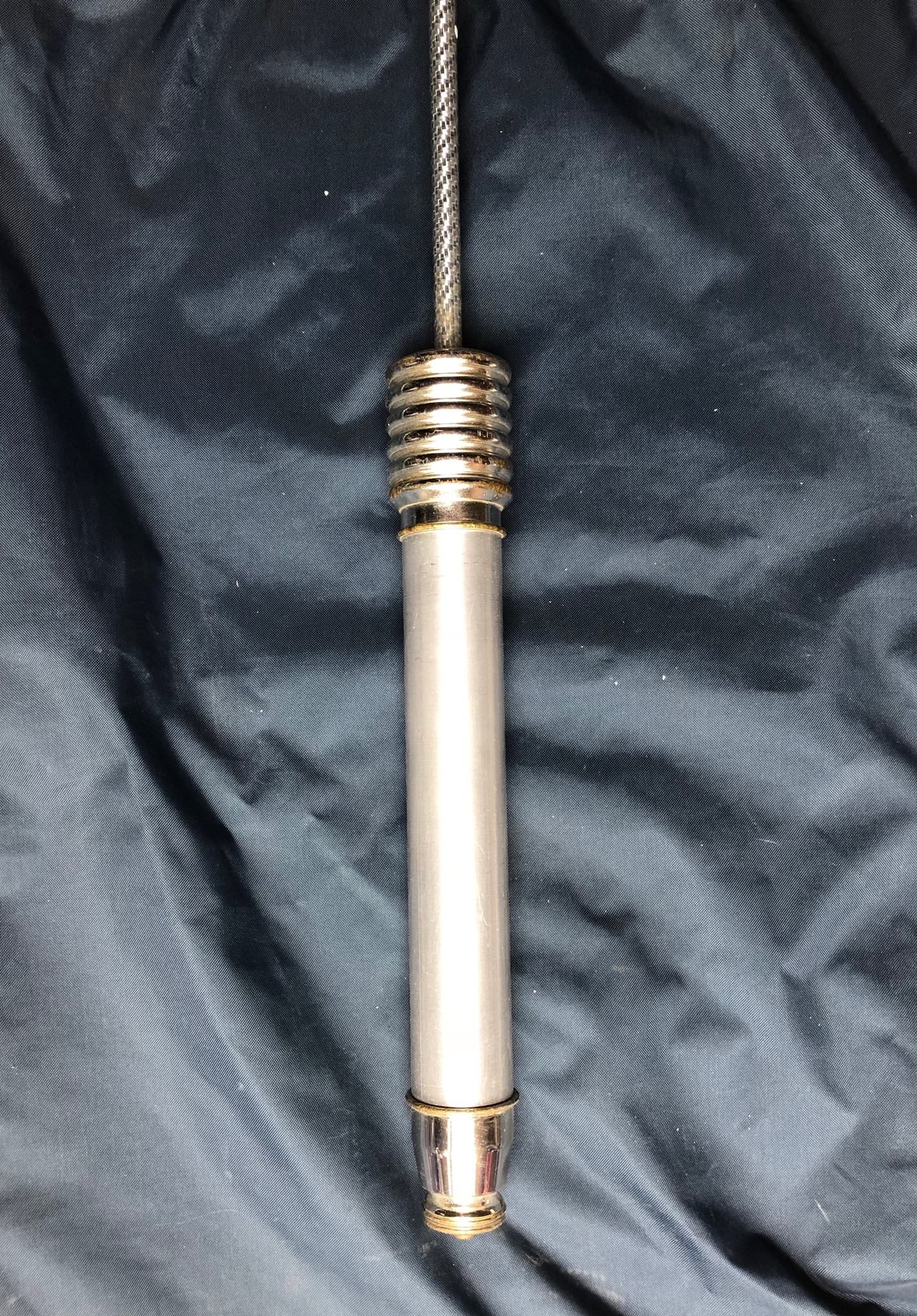

Is the cin drallig hilt interest list next? Because you've don't interest list for basically the 2 sabers it's made up off. (I know the body section is slightly different to shaak ti.) Thanks
Hi thats a very good question. The Cin Drallig is something that Im still figuring out the approach. There is essentially 4 saber designs: Stunt (Nick Gillards), The Lightsabers collection book design 1 (Cin Drallig artwork) and 2( 3d rendered hilt) & the clonewars version (not really seen well).
Stunt
Book 1
Book 2
Clonewars
Im probably going to make 2, the Stunt and the Book 1 version but probably using the shaak ti body, and fisto parts in brass.
I was hoping for book 2 version. But any1 of them will be amazing it's a hilt I've been after for ages and to be done right. Can't wait for this 1. Thanks again

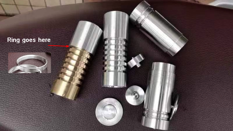

Here is a quick update on the samples. Shop said they will finish this week as promised.
View attachment 1808179View attachment 1808180View attachment 1808182View attachment 1808181
Just something I noticed is that the grip section (second picture posted here) on these samples appear to only have 7 grooves compared with the 3d printed model and original prop that have 8 grooves.
Am I miscounting or something? Your 3d printed model was correct, but unless I'm missing something, these appear to have only 7 grooves.
Apologies if I'm not seeing it correctly.

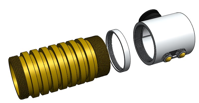

They forgot to add the clocking ring to the assembly, the clocking ring is the 8th groove. The clocking rings are on the third pic. The purpose of them is to properly align the rivet section with the top section buttons.
don't worry those parts still need features to be added, but to your question it was just assembled incorrectly.
Here is how the grip assembly goes:
If you are not planning on swapping parts out, once you have the proper clocking just add some thread locker so that ring is fixed and that should be it.
Ah ok great, thanks for the explanation. Just more complicated design than I expected.
