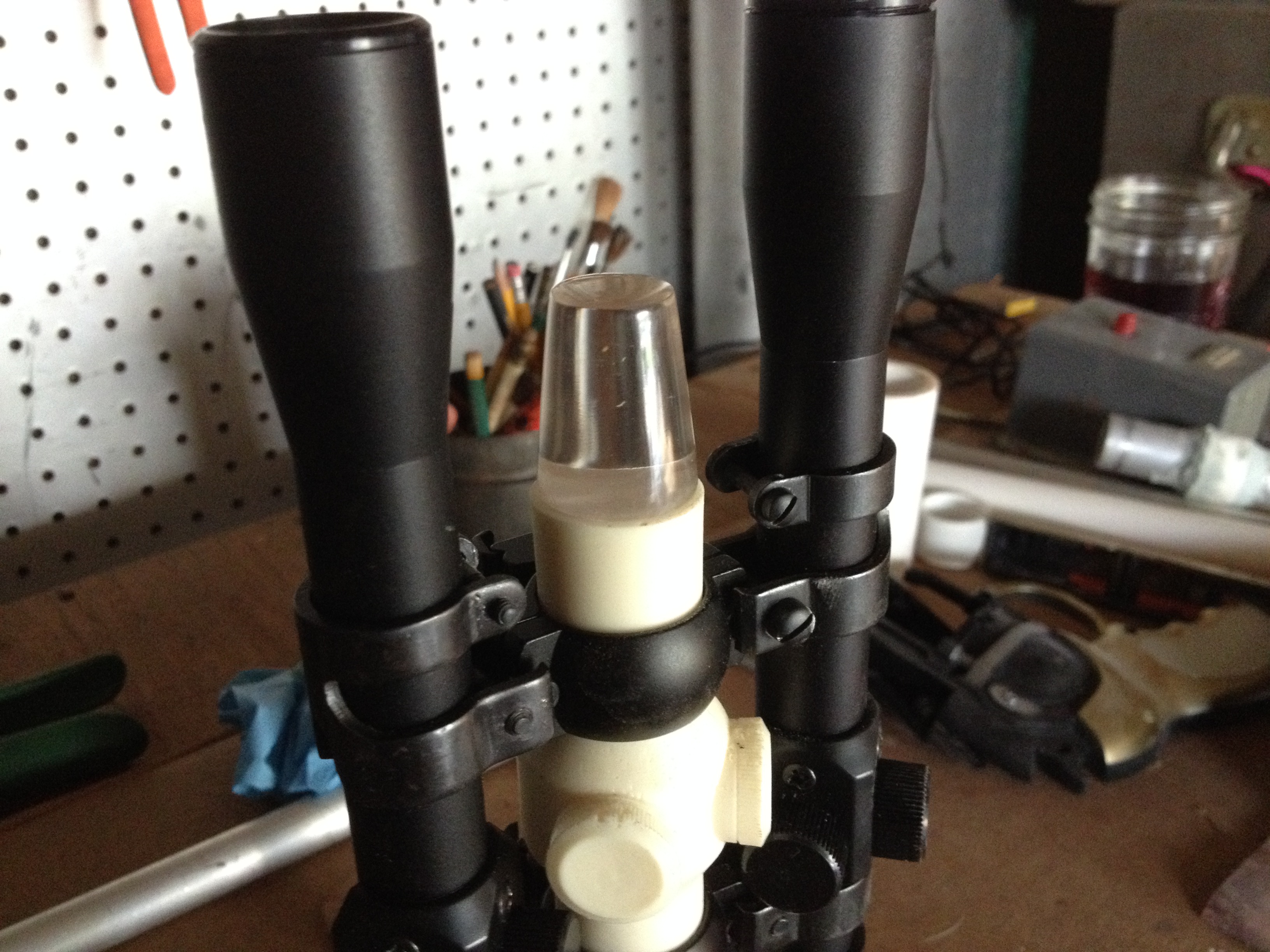

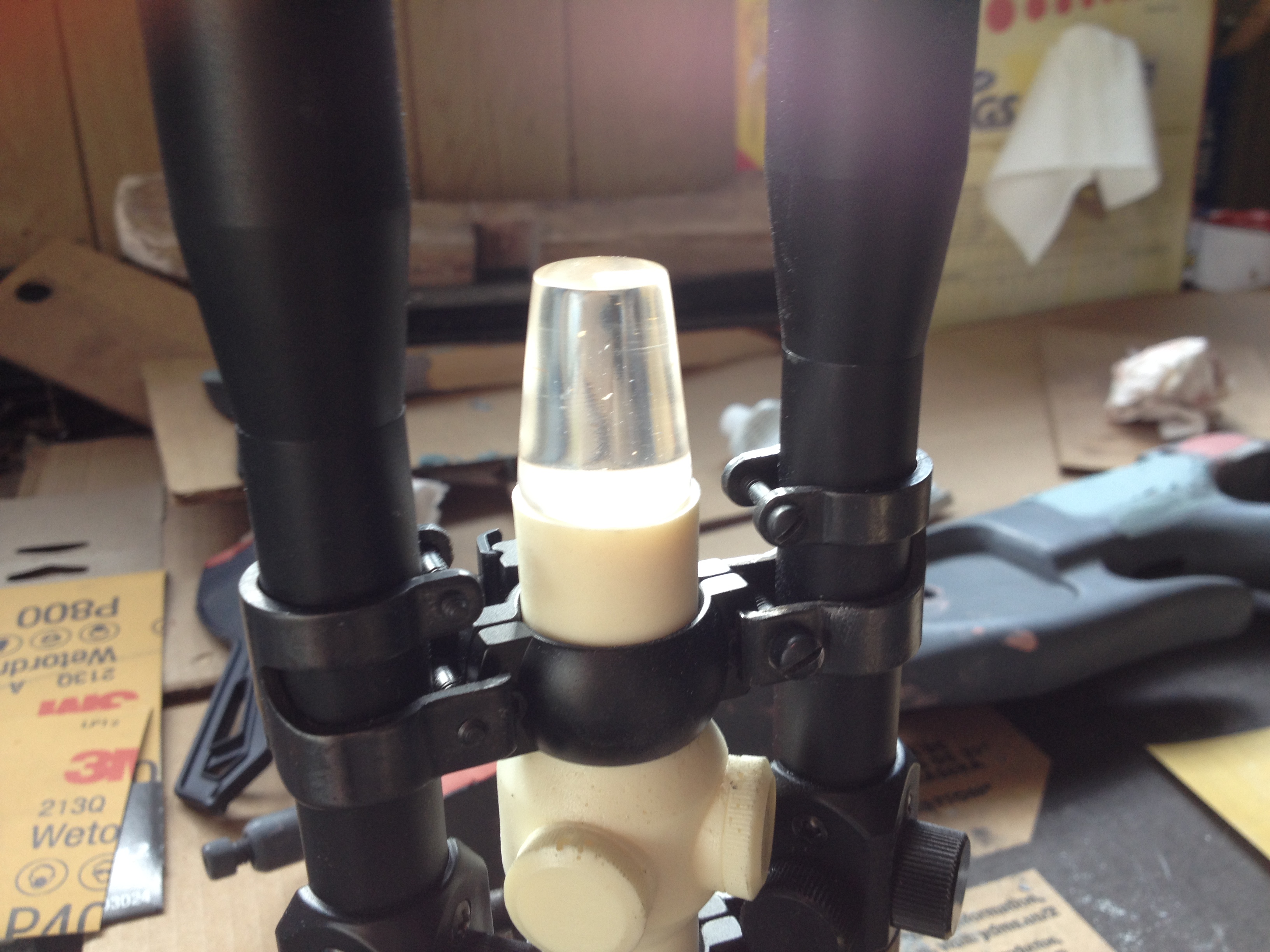

the above pics show the scope rings where I mounted the two upside down. Im thinking of taking the screws out and drilling out the threads then inserting the screws and a nut on the opposite side or should i leave them as they are now?
Re: Chewbaccas bowcaster build
Looks good to me in the absence of correct scope rings.
Thanks Kurtyboy. Trying to get the look right without spending years and tons of money. Might try to make the "tabs or feet" wider to match the original look on the scope rings.
You just need to cut four rectangles from sheet metal and drill holes in them.

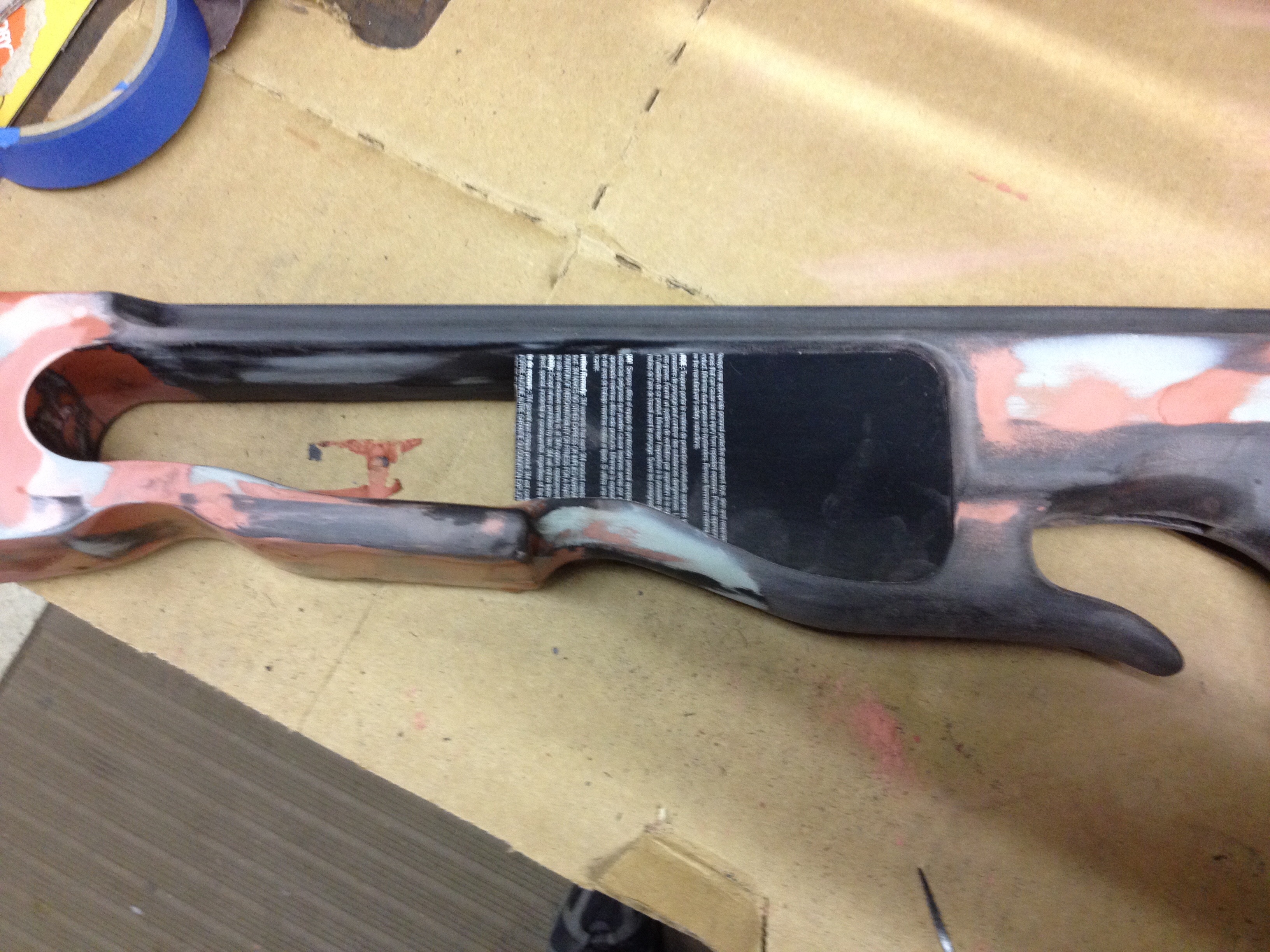

Still sanding on this and now finally making headway! Started wet sanding now with 320 grit and its getting really smooth. The areas that have filler feel like glass and tgats how i want the rest of it to be. Ive used glazing putty on the imperfections. Next is wet sanding with 400 then priming. Its slow going

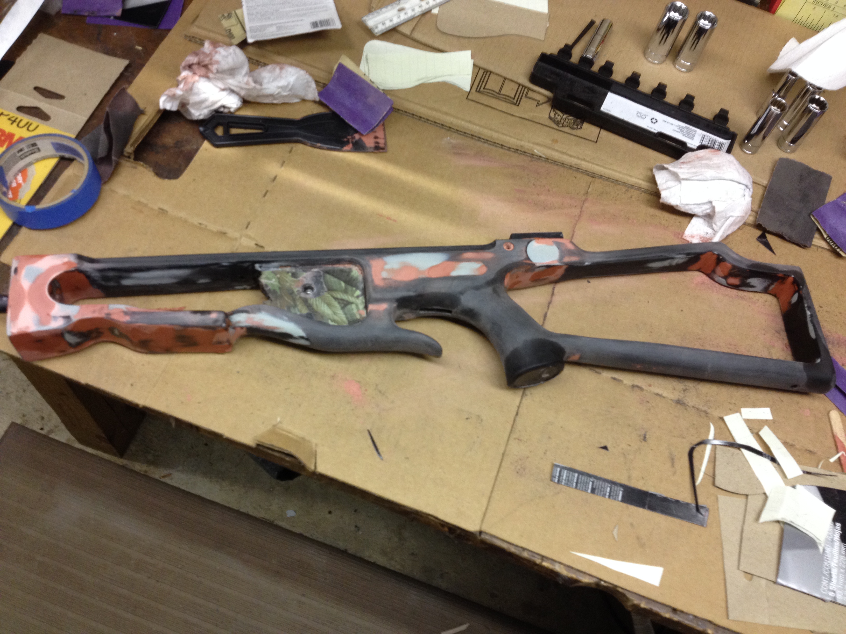

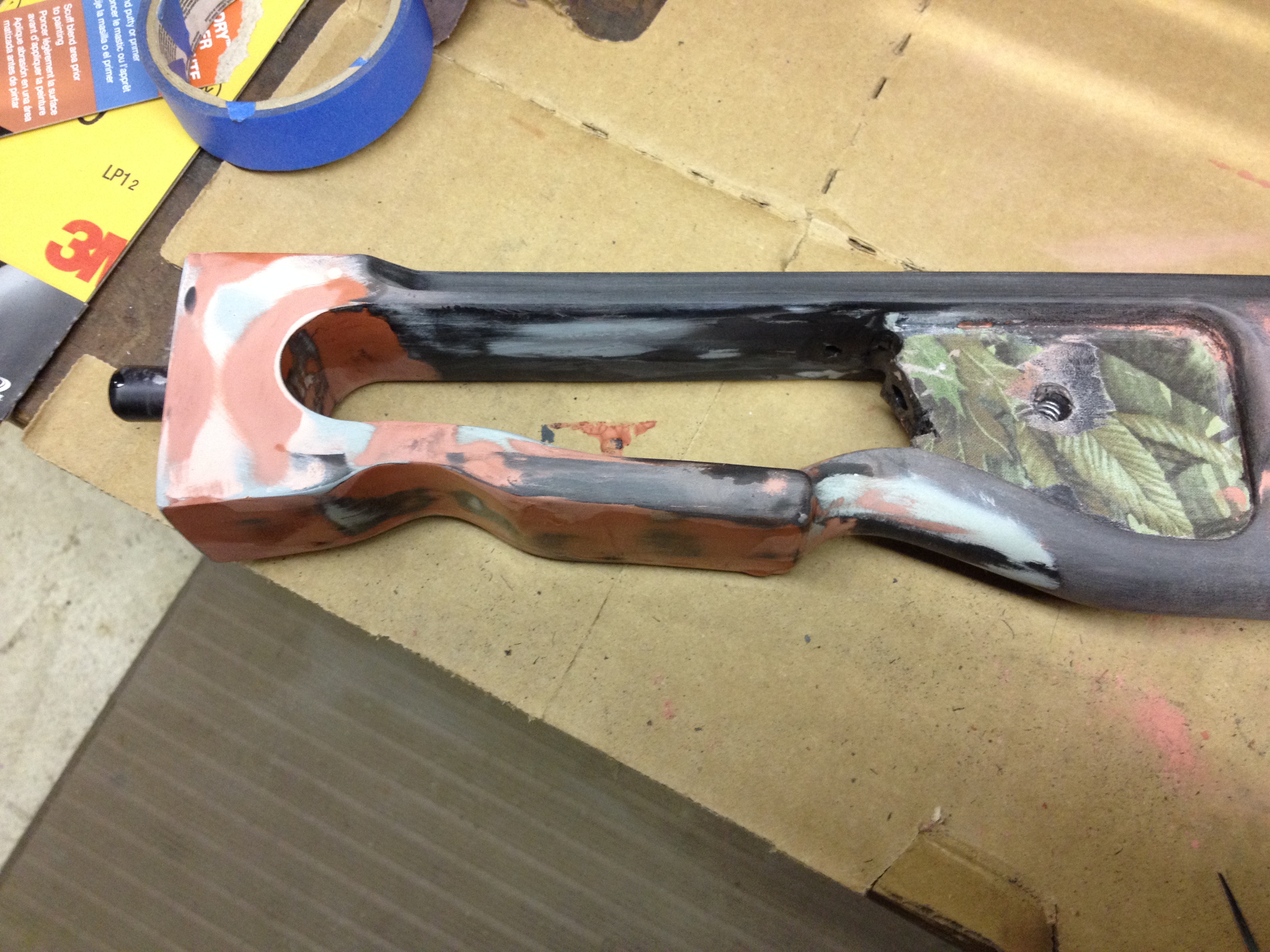

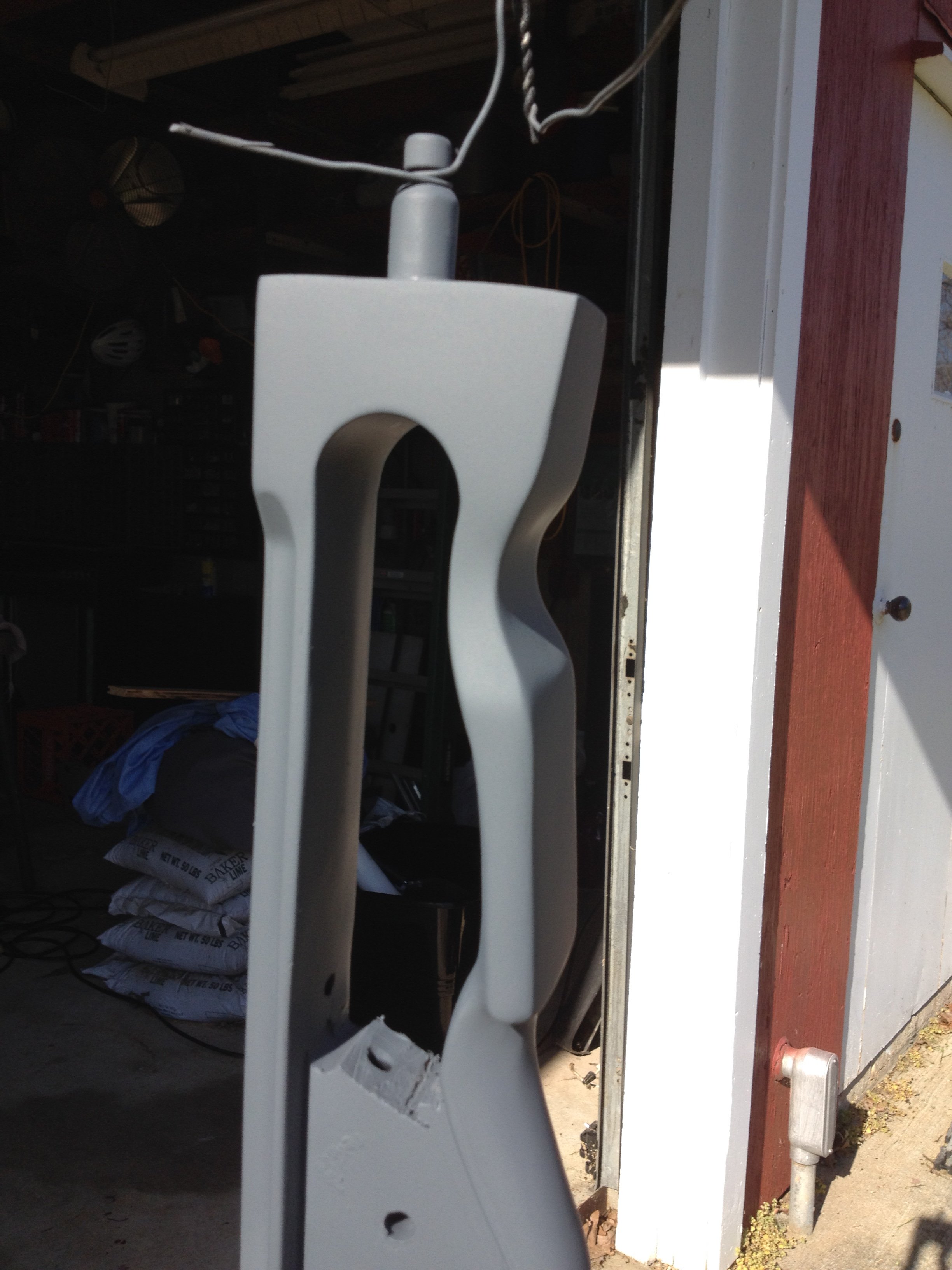

image.jpegimage.jpegimage.jpegHeres som more progress pics. Still wet sanding and adding glazing putty to smooth out imperfections. Also cut out a cardboard template for my sideplates.

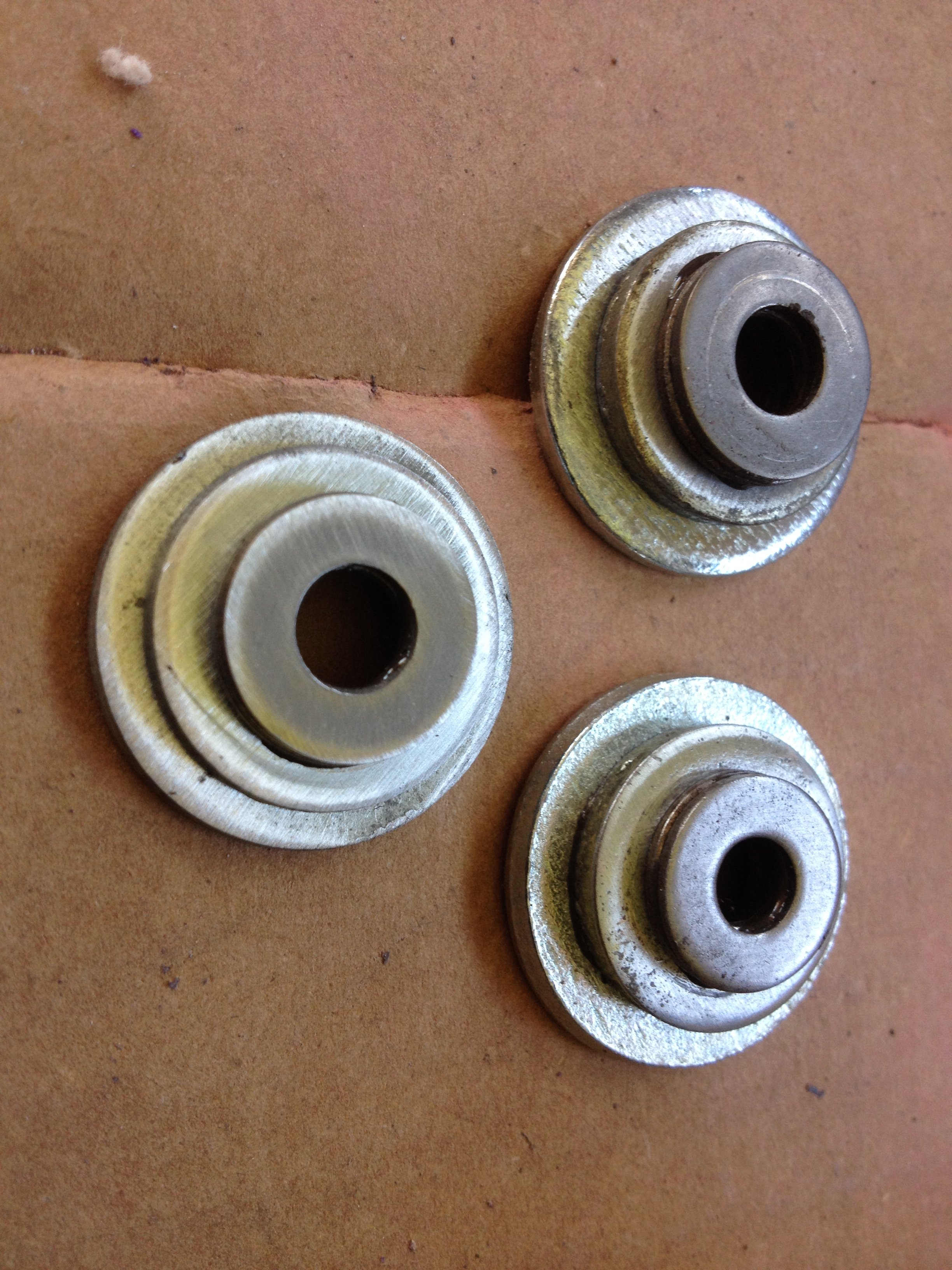

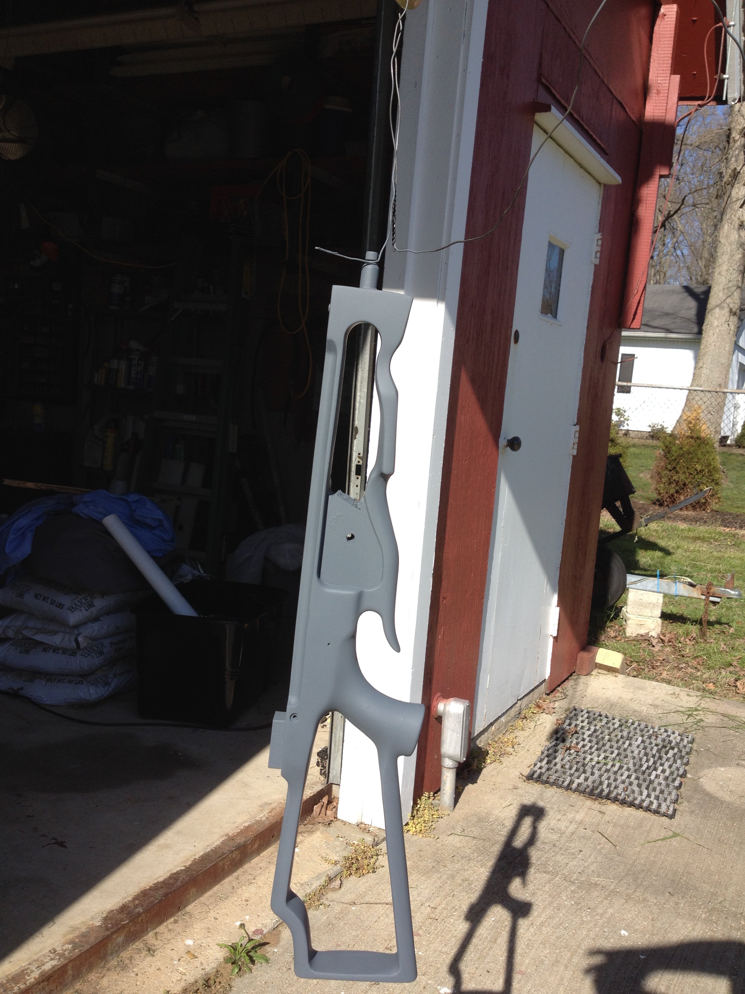

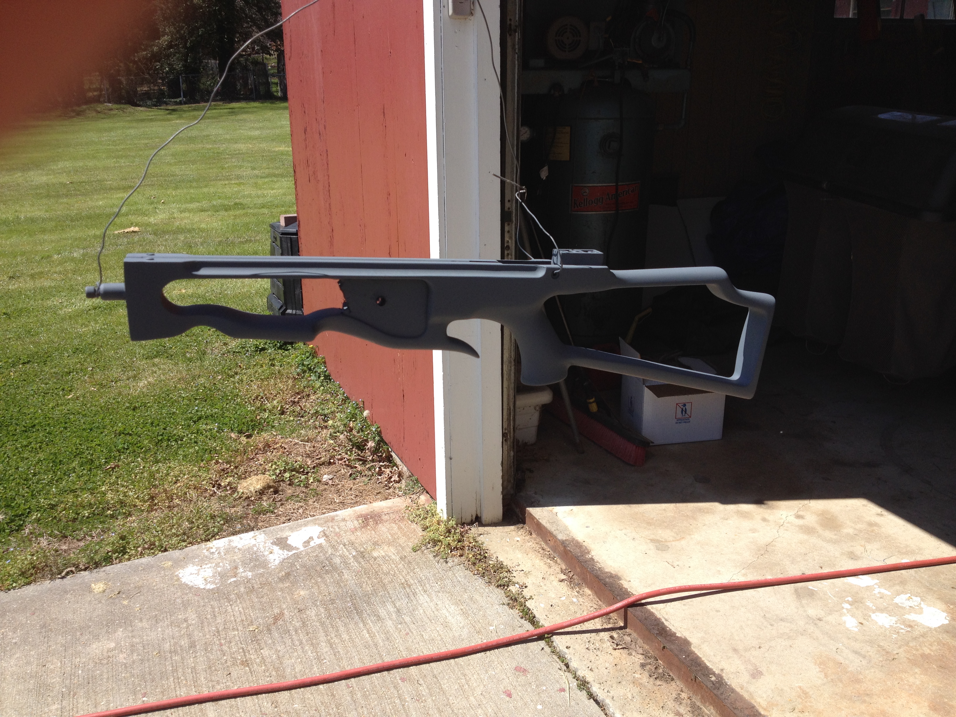

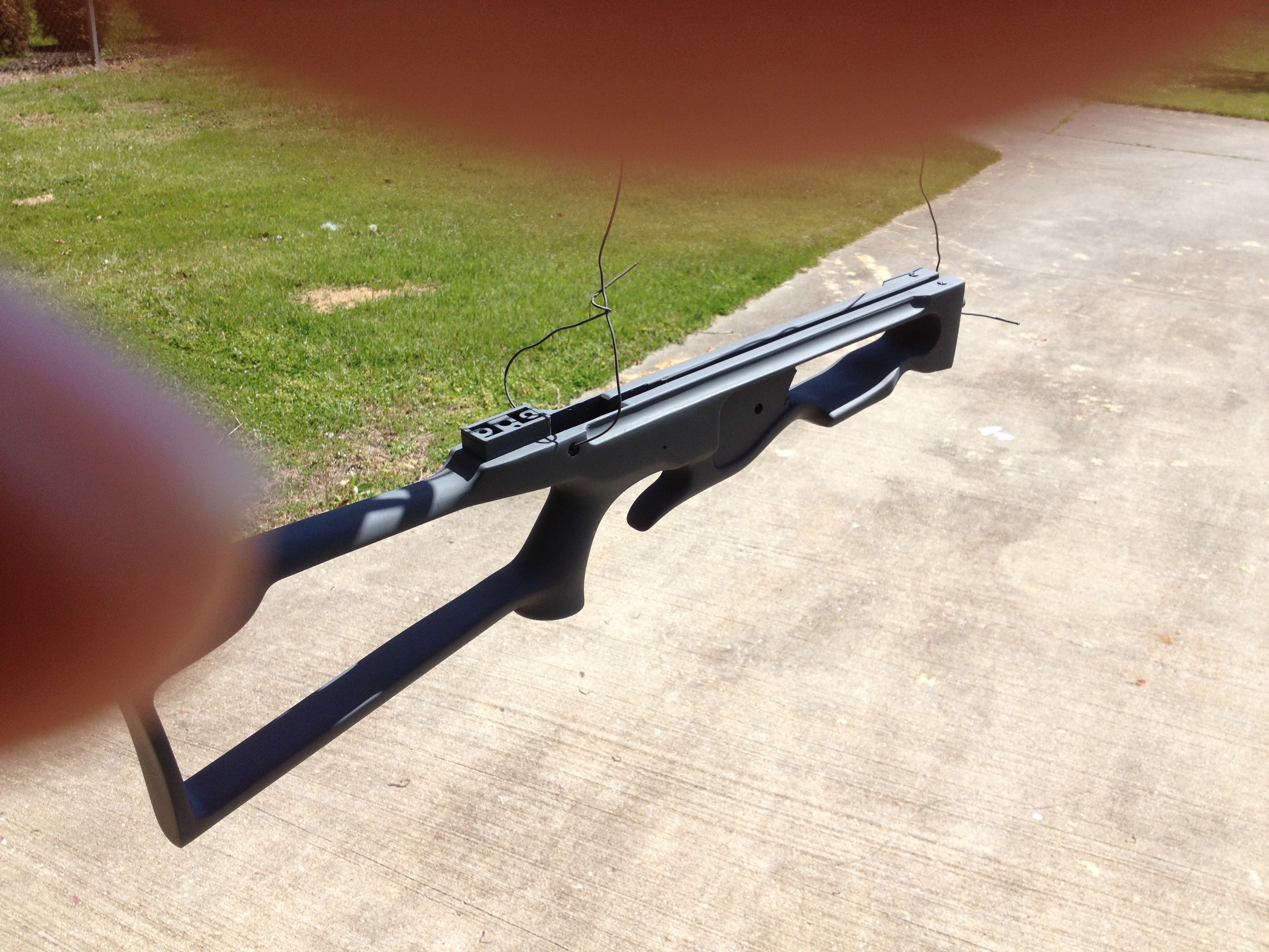

So after many nights of sanding and applying filler and gazing putty I was finall able to get some paint on the bowcaster body. What a differerence! Thank you Kurtyboy for the advice about sanding this down. Im very happy with the results. Still a couple of small areas to fix but its looking a lot better. Gonna wet sand with 400 then spray it with satin black. While the paint was drying i started making my imperial discs( just thick washers glued together.)Still lots to do. Ordering the fender knob and the philmore knob tonight. As far as the other camera knobs ill either substitute what i can or see what i can find. This is going to be a half scratch build and half found parts. Well less than half found parts! Lol I know the body doesent look exactly like a horton magnum but I feel i got close compared to where and what I started with.

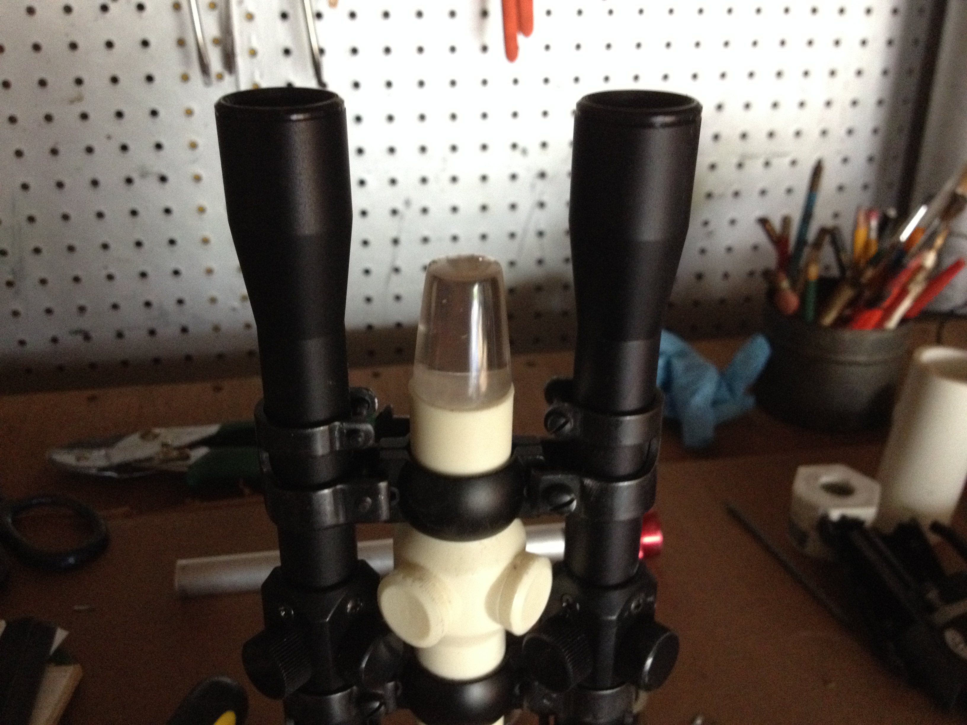

Finally found the two major knobs i needed. The fender and the big philmore style knob both on ebay. Still sanding out the imperfections on the caster. I also wetsanded and polished the cone for my resin singlepoint. The cone was not cast very well. Was still sticky and vey wonky looking. Coverd in fingerprints when you handled it. All in all pretty ugly so i decided what the hell cant make it worse so sanded it with 320 400 and 600. Then used a polishing wax then a plastic polish. Only thing is theres no red filament in it. Was thinking of drilling into it and filling the hole with red paint. Anywhere i drill into the plastic i think will be cloudy. Any ideas
