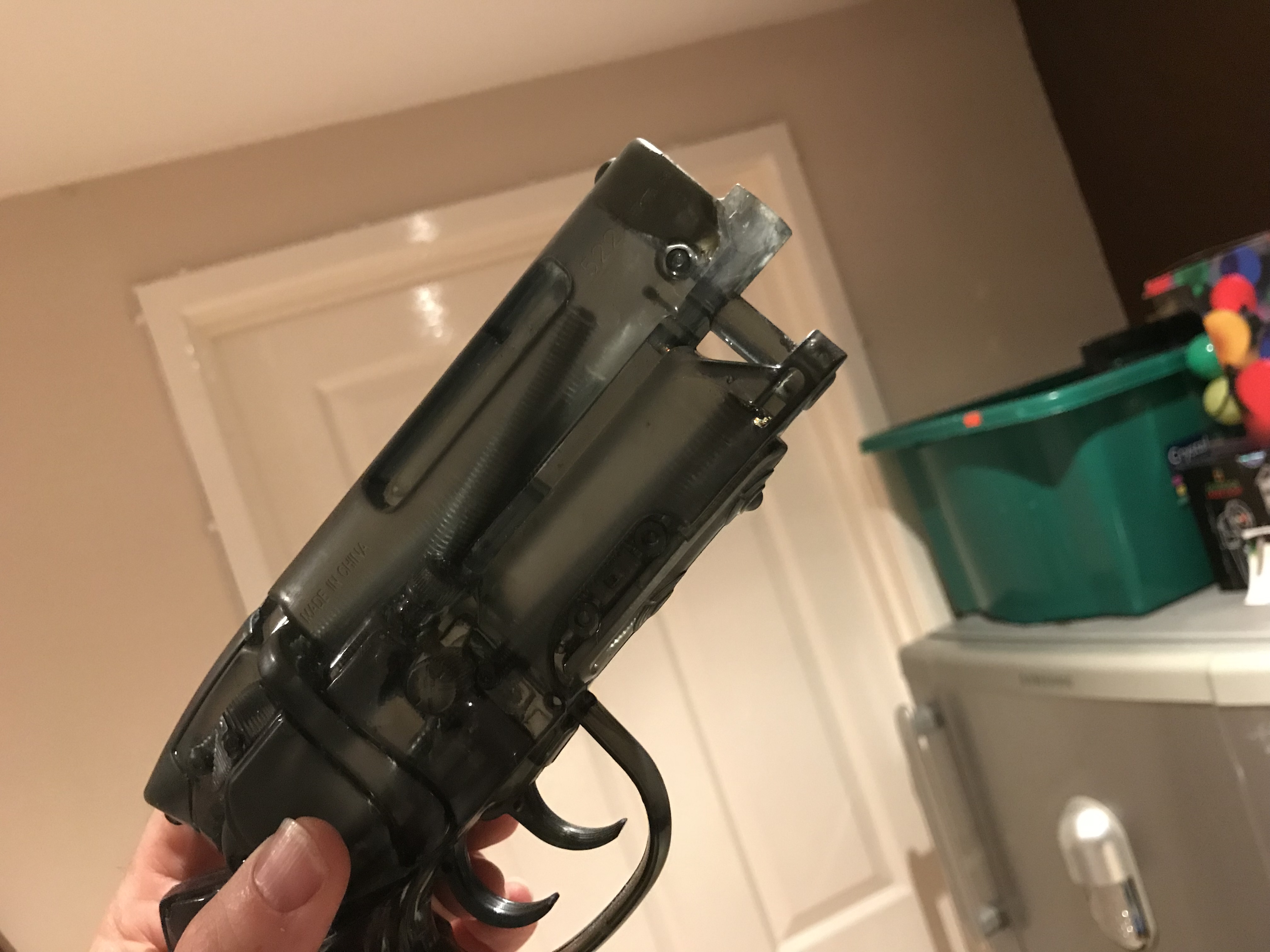

Finally worked on my sidkit today!
All the seams are gone, the whole thing has been buffed up with 000, it took me a long time but i have finally managed to insert, fill and sand even the grip insert.
BUT I need help guys before I go ahead and fit the receiver cap in and weight it all, I've decided that if I was careful enough I could probably cut the magazine out, should I?
it would give me more things to work out like lighting and how I'm going to weight it (I was originally just going to fill it up with sand) and how I'd build up the inside but I am on the fence here I'm not sure, I need an opinion.

I weighted mine with threaded rods and resin.....worked a treat

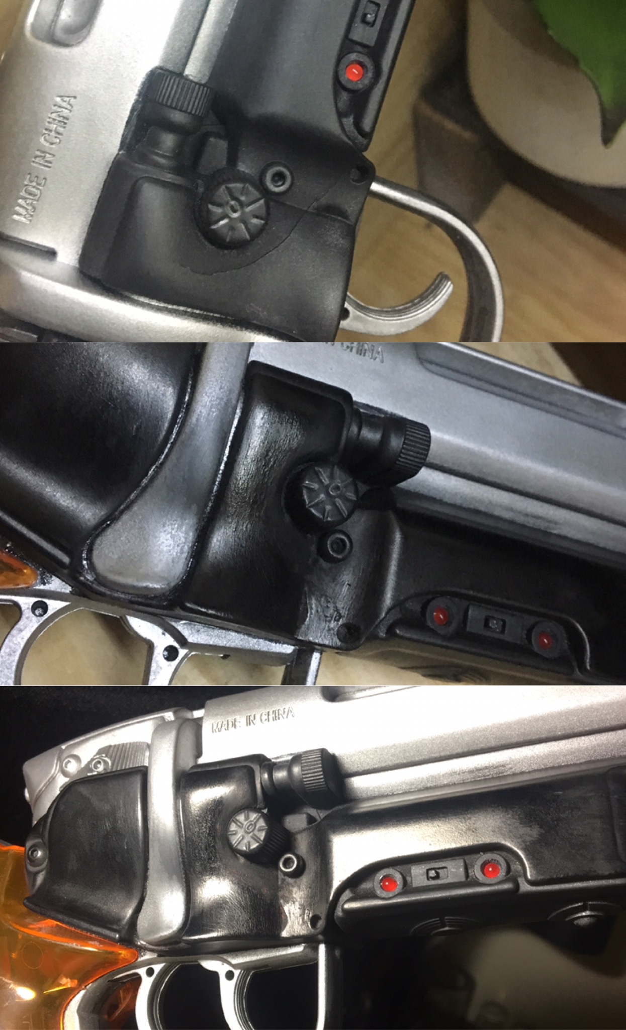

" I only managed to get the blue handled pistol, so tried to make it work in my favour as a futuristic plastic type deal!"
Whole thing ooks pretty damn good to me kri5! I never liked the look of the blue handle before, but you really pulled it off!
I also like your scratches on the black glossy area, is that rubn buff or another technique?
Thanks ArthurRackham I'm glad to hear that you think it works! I was worried about getting the right look with the wrong colour but its good to hear that it can work! And yes i used rub n buff just on a rag and brushed across the glossy parts with my finger; tried to make it look very scraped and used

The first one that I made I used Copper BBs for weight, and some clear Elmer's glue to contain them. It took some time for the glue to cure, and I def recommend adding the glue in small amounts so it cures quicker. Learn from my mistakes haha.

Cut the mag out. It's not that difficult and the benefits are many.

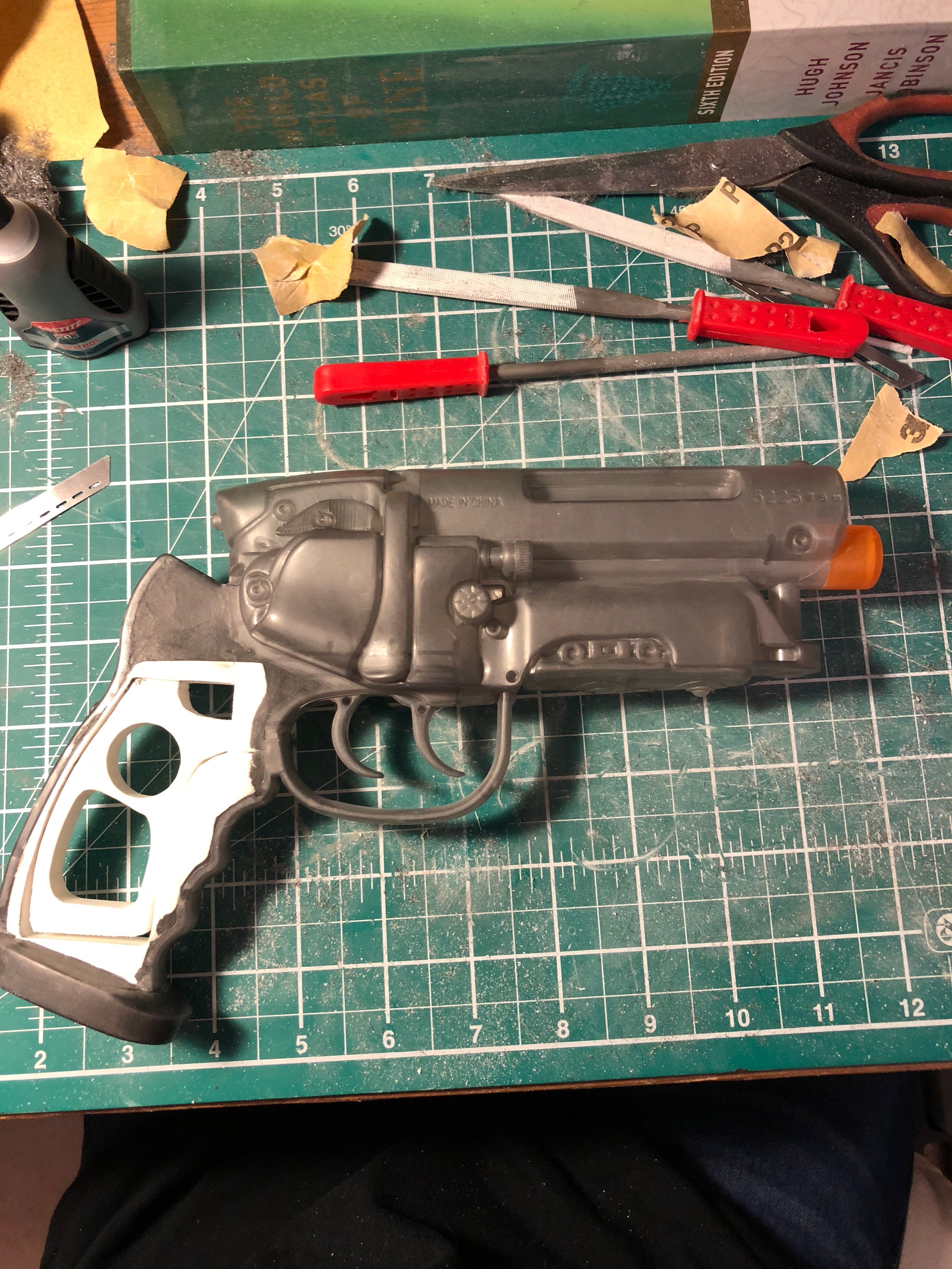

Working on repairing a crack that the blaster had when it arrived
After sanding the bondo I wanted to see where I stand after a lil' rub n' buff.
Still have some work to do before the finish is nice and smooth. It's an improvement imo though.

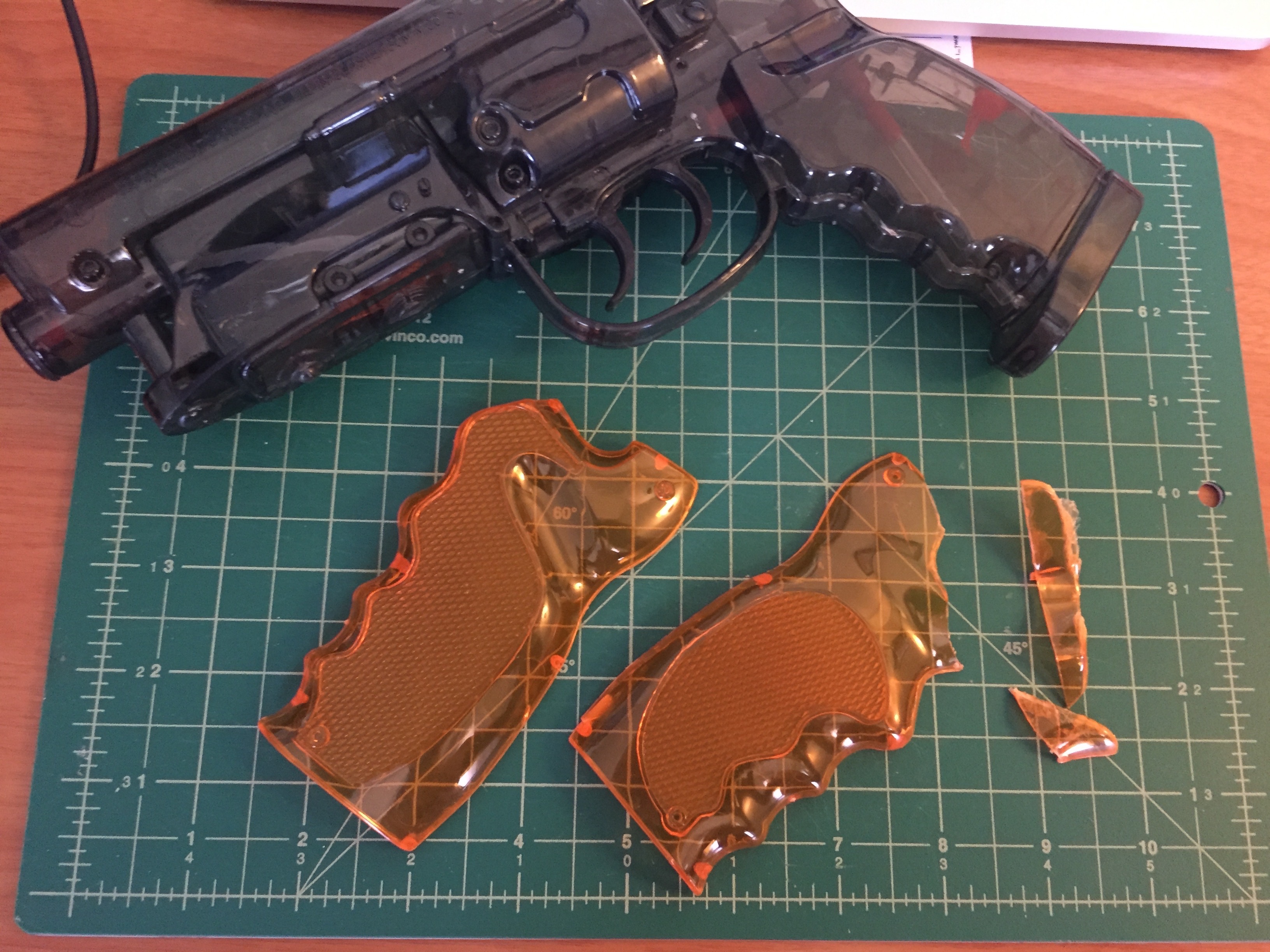

I was able to pry the orange grips off with an Exacto knife and some patience. The first side came off easily, but the other was really stubborn. The part where the grip meets up with the receiver was glued in so well that I ended up cracking it in 2 places in order to get it off. Fortunately I have Soulinertia's deluxe upgrade kit ordered so it doesn't matter.
Should I keep using the Exacto to split the two halves of the gun apart, or is there a better way to go about this?
I realised too late that I could do everything I wanted without splitting the gun. Have a long hard think about it.
