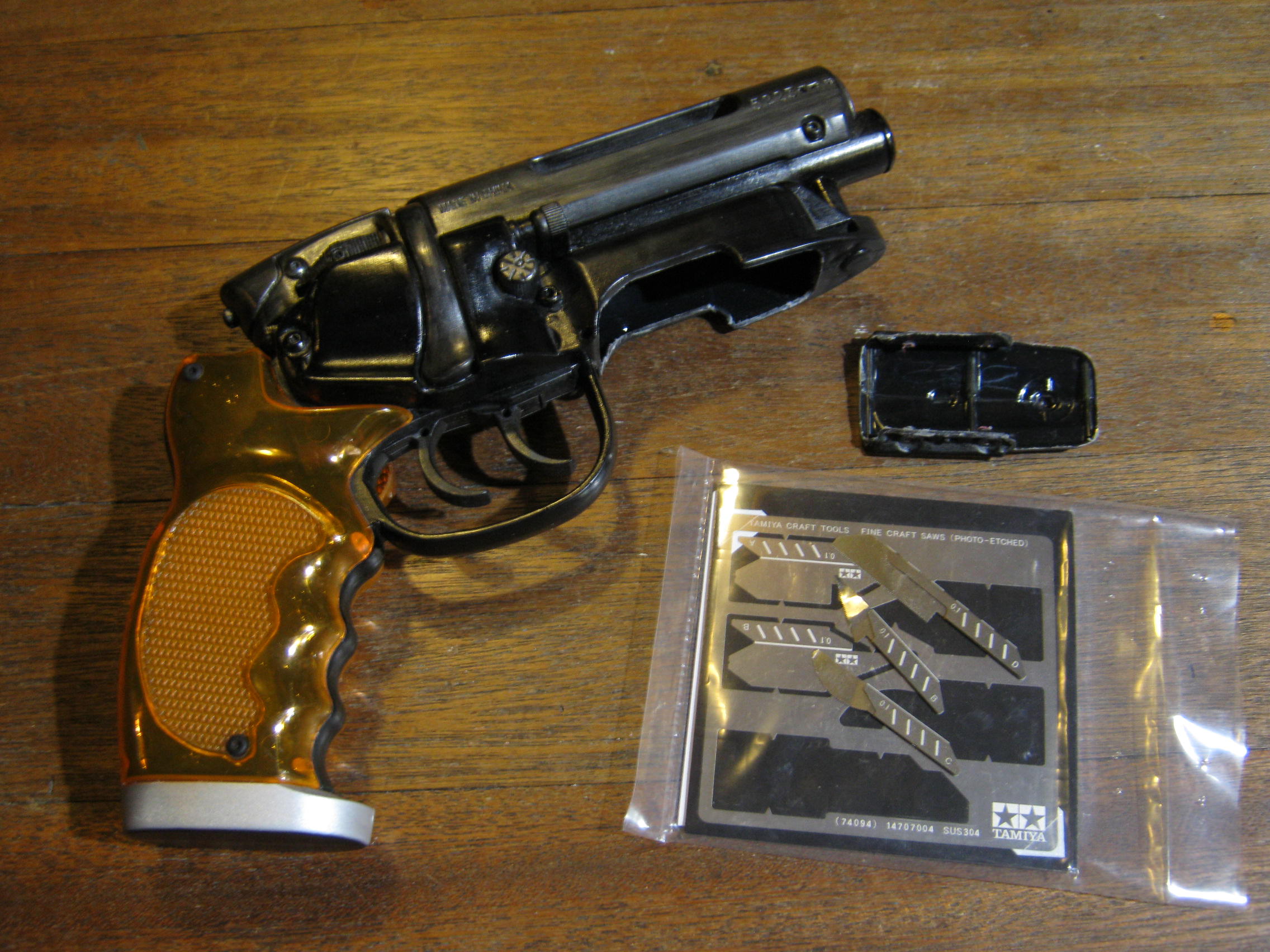

After what seemed like forever, I finally cut the mag off. I got the thinnest blade to need the least amount of cleanup but I wasn't expecting it to be as thin as aluminum foil. When put back together it's like it wasn't even cut, just the paint on the edges being disturbed.

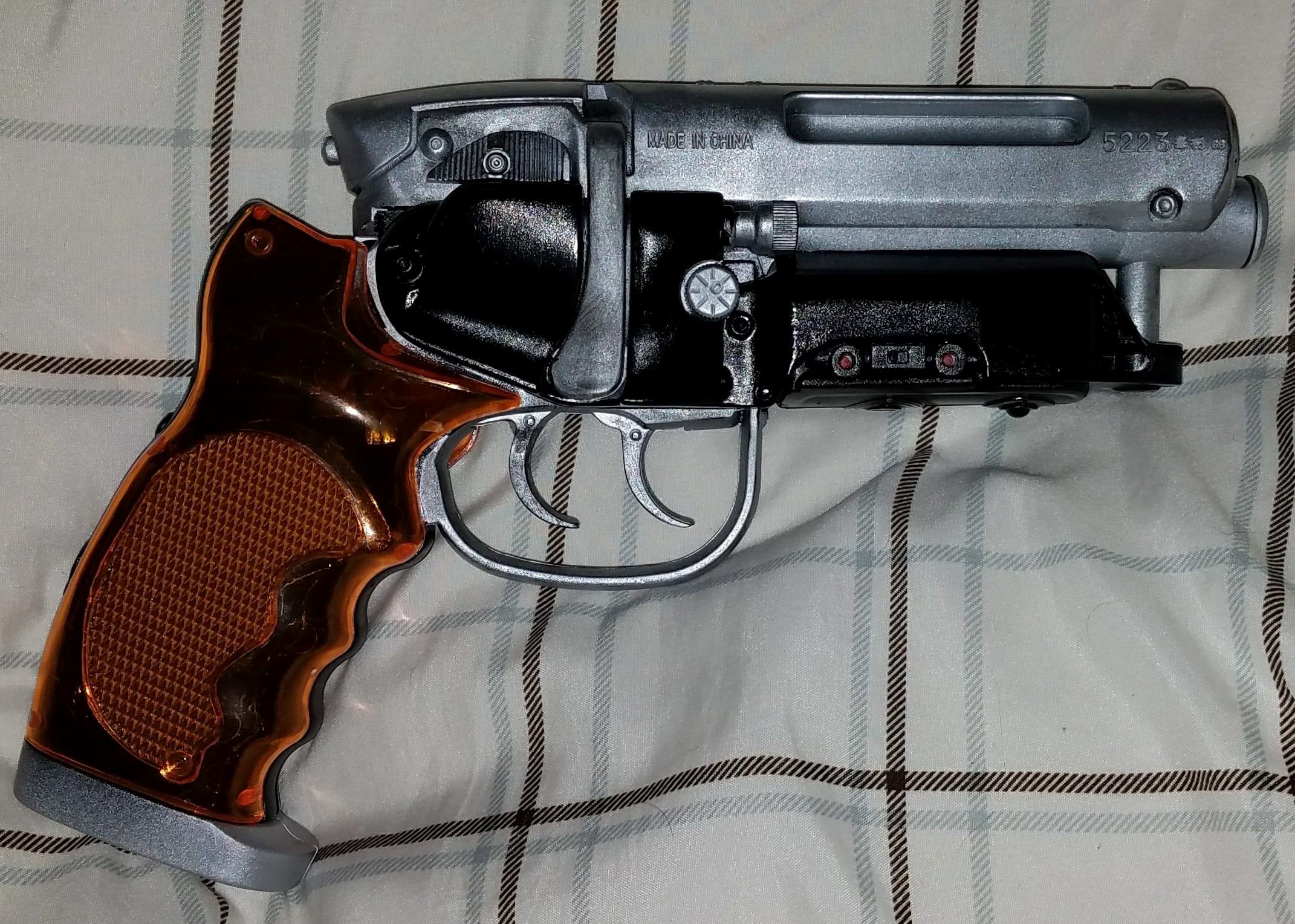

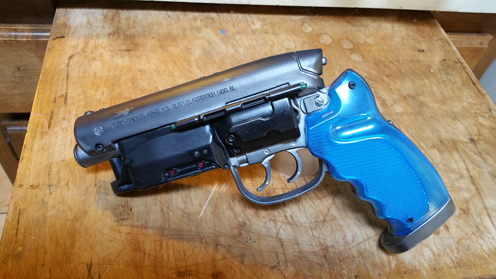

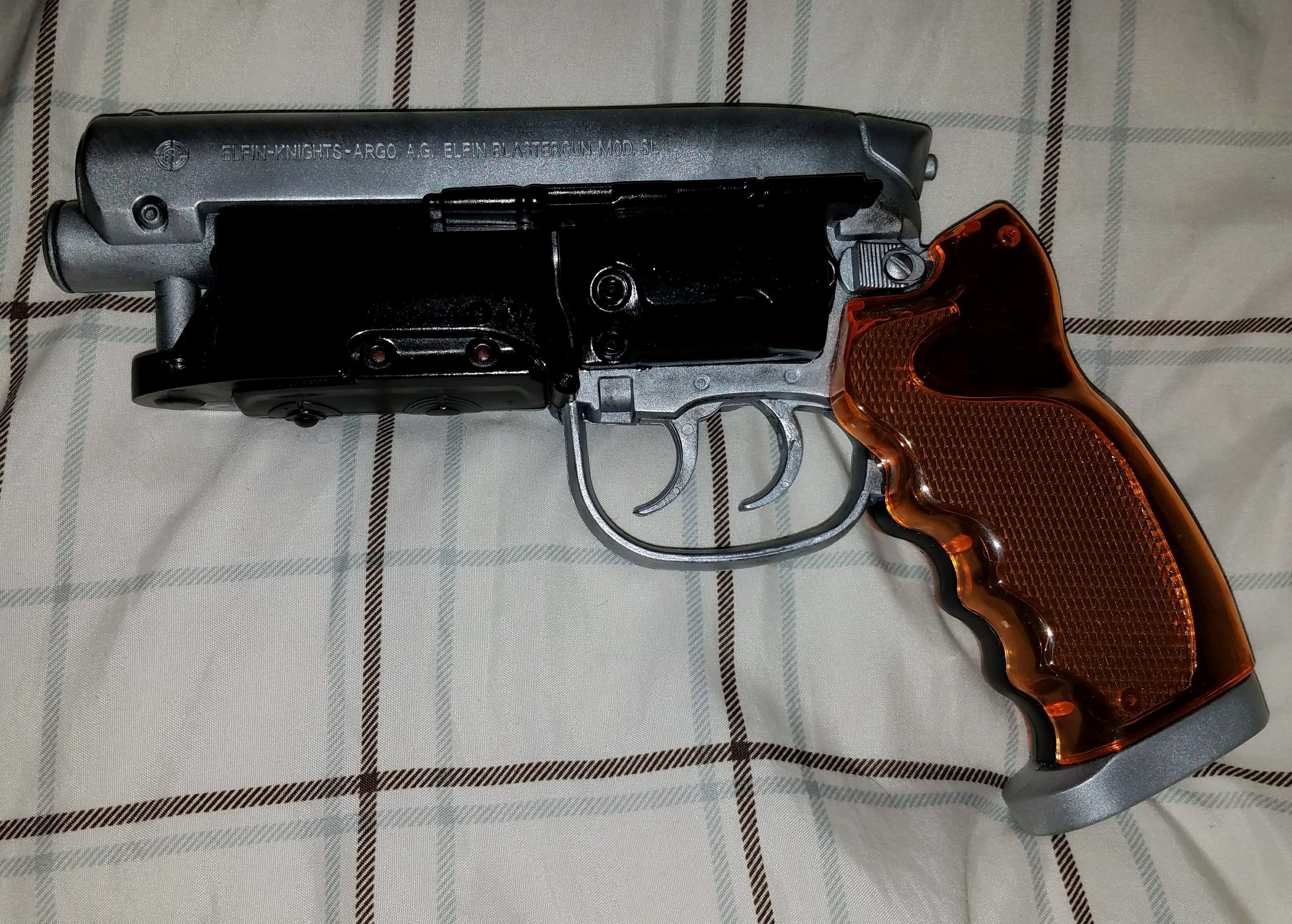

This is my attempt at it. However the grips aren't actually attached, cause I don't wanna cut into the water holding bit and they are a tad too small. The ones I have for it are blue.
Sent from my ONEPLUS A3003 using Tapatalk
RLD9K ,
Nice smooth looking finish on your pistol . Congratulations . Wondering in #991 , there’s a Rub’n’Buff tube - did you use that on your build and if so what finish is it ? Thanks ,
Ged
@RLD9K ,
Ged
Thank you, still gotta add some rust though (somehow). And yes I did use Rub n Buff. The finish I bought was pewter, which has a slight gold tint to it, making the gun look tarnished. I wasn't sure on it at first but it actually turned out alright in the end. [emoji106]

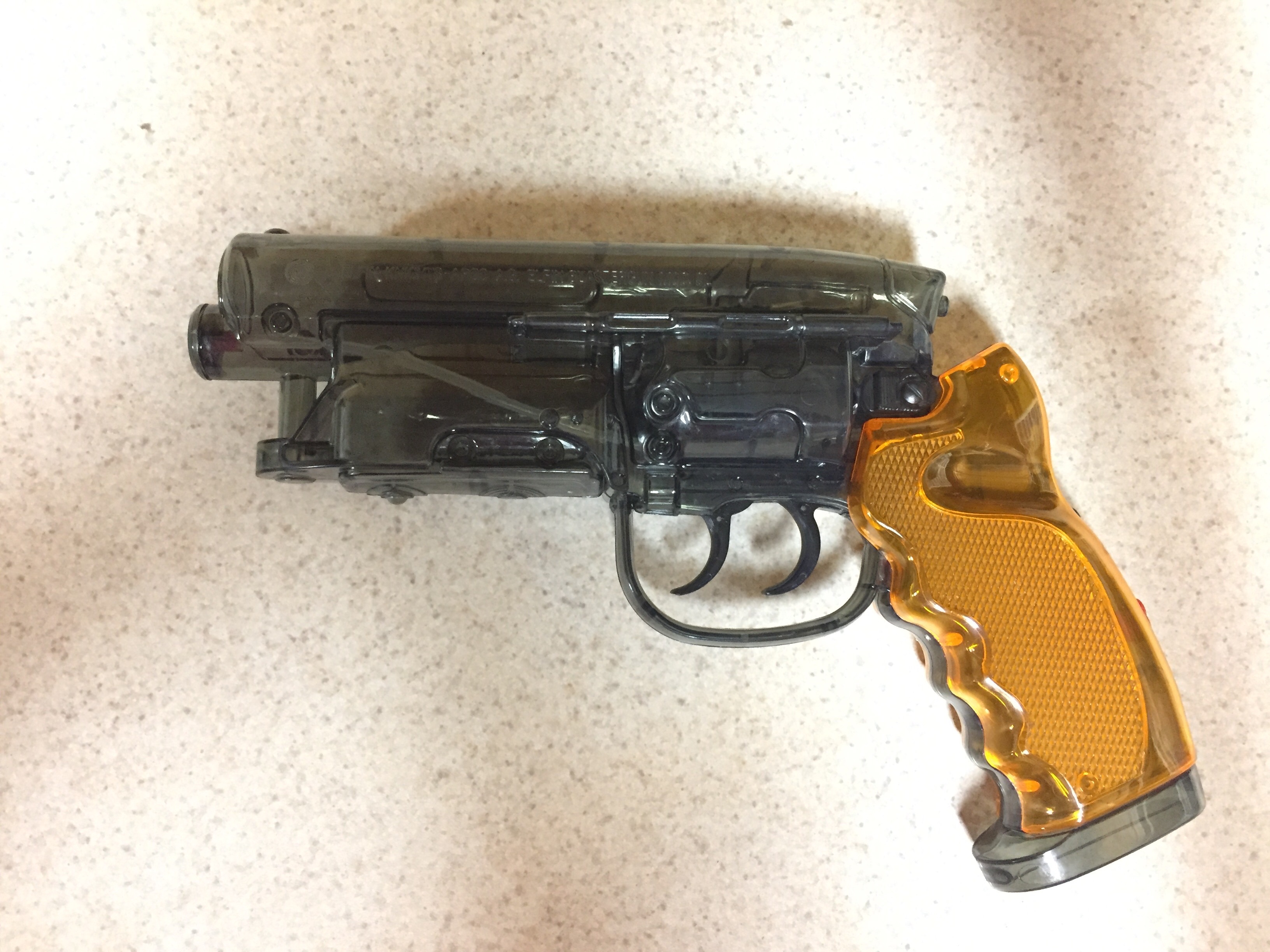

Much thanks to 829Japan, I finally got my hands on one of these. It's gorgeous! I wasn't very interested in this prop until a few months ago, but now I'm in love.
I'm a bit timid to start working on it since the water gun is so beautiful on it's own. You all have done such an amazing job with yours. I'm feeling very inspired by this thread!
