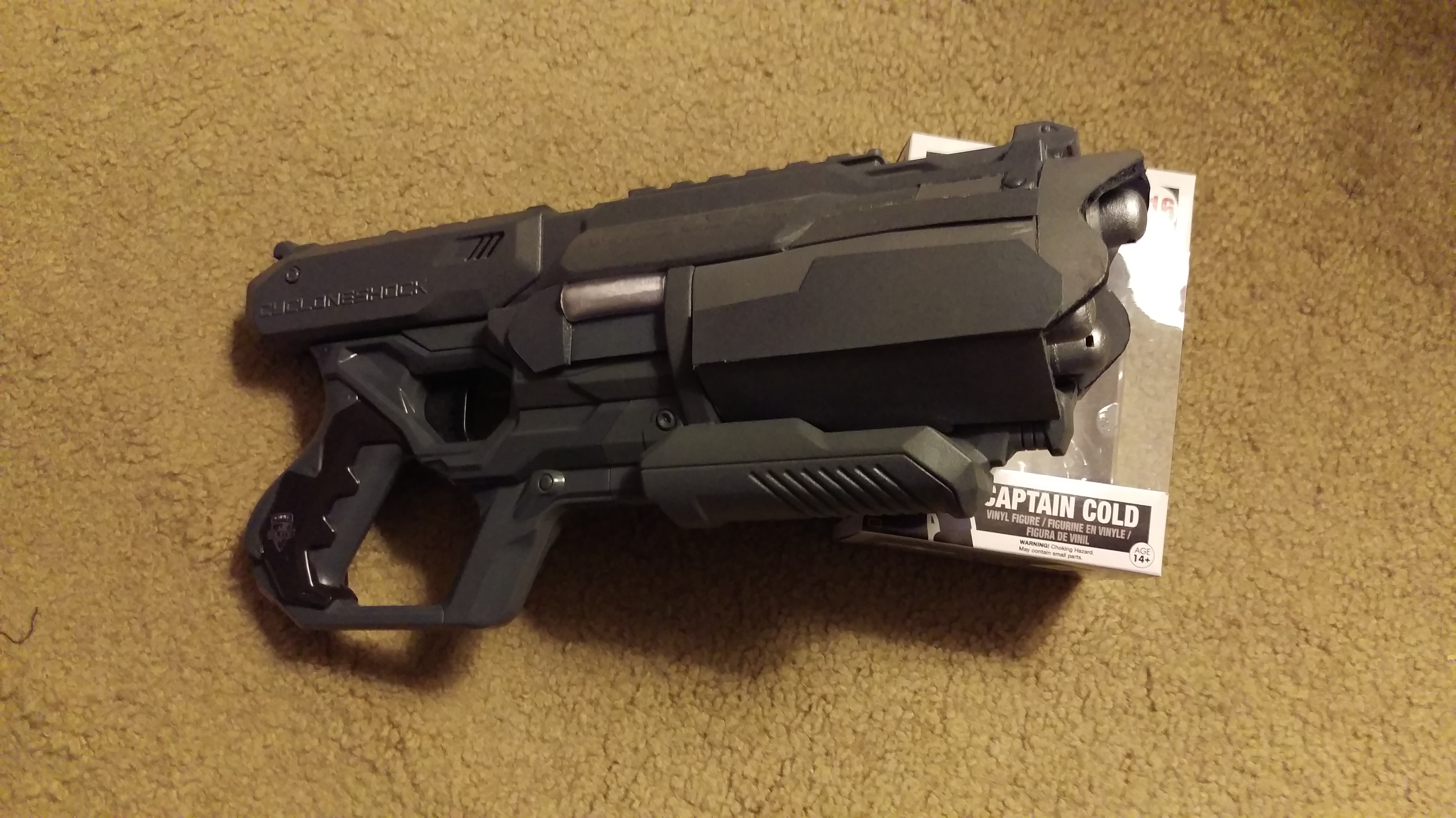

Here's what I managed to do for my cold gun

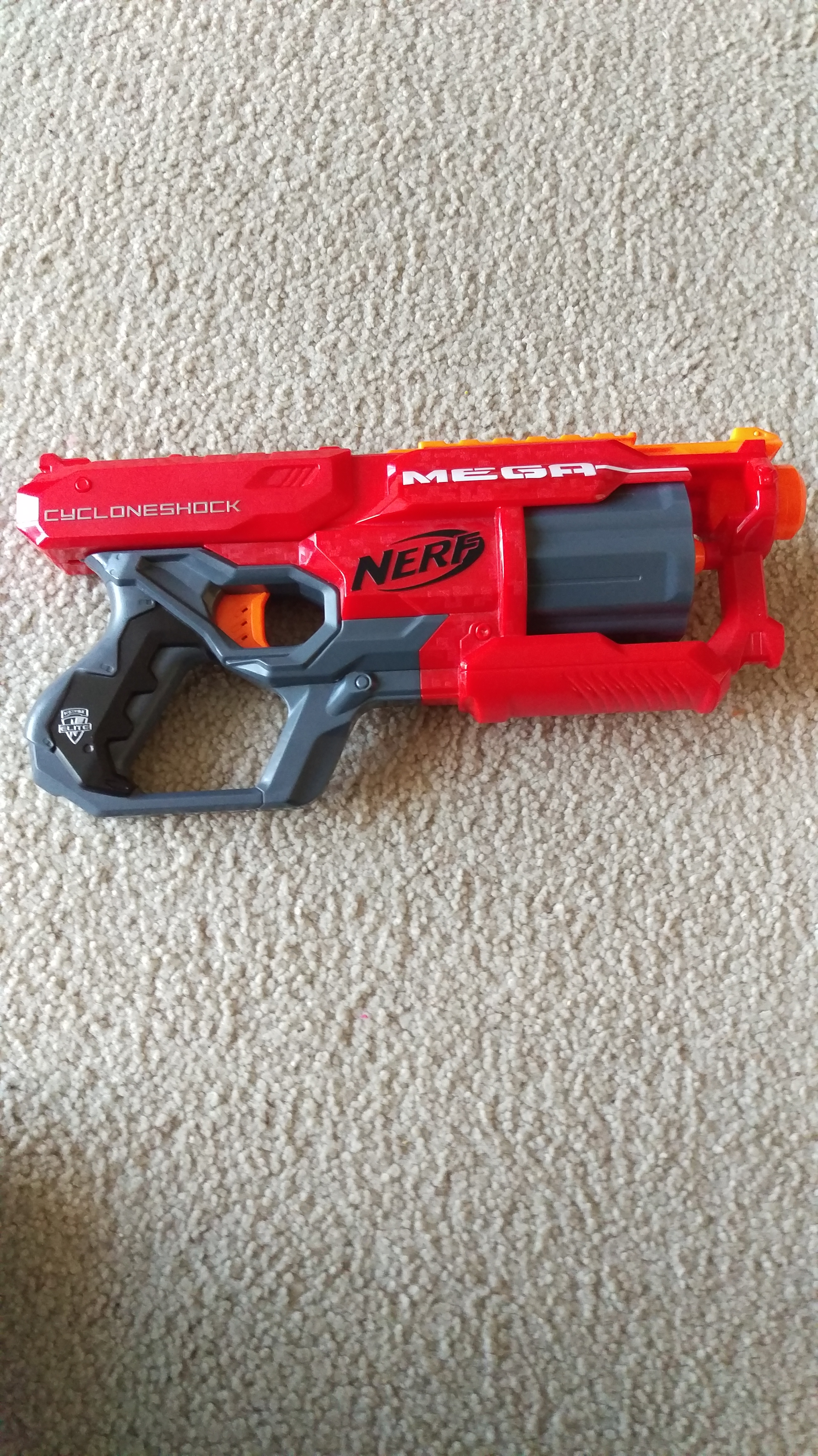

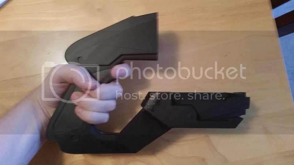

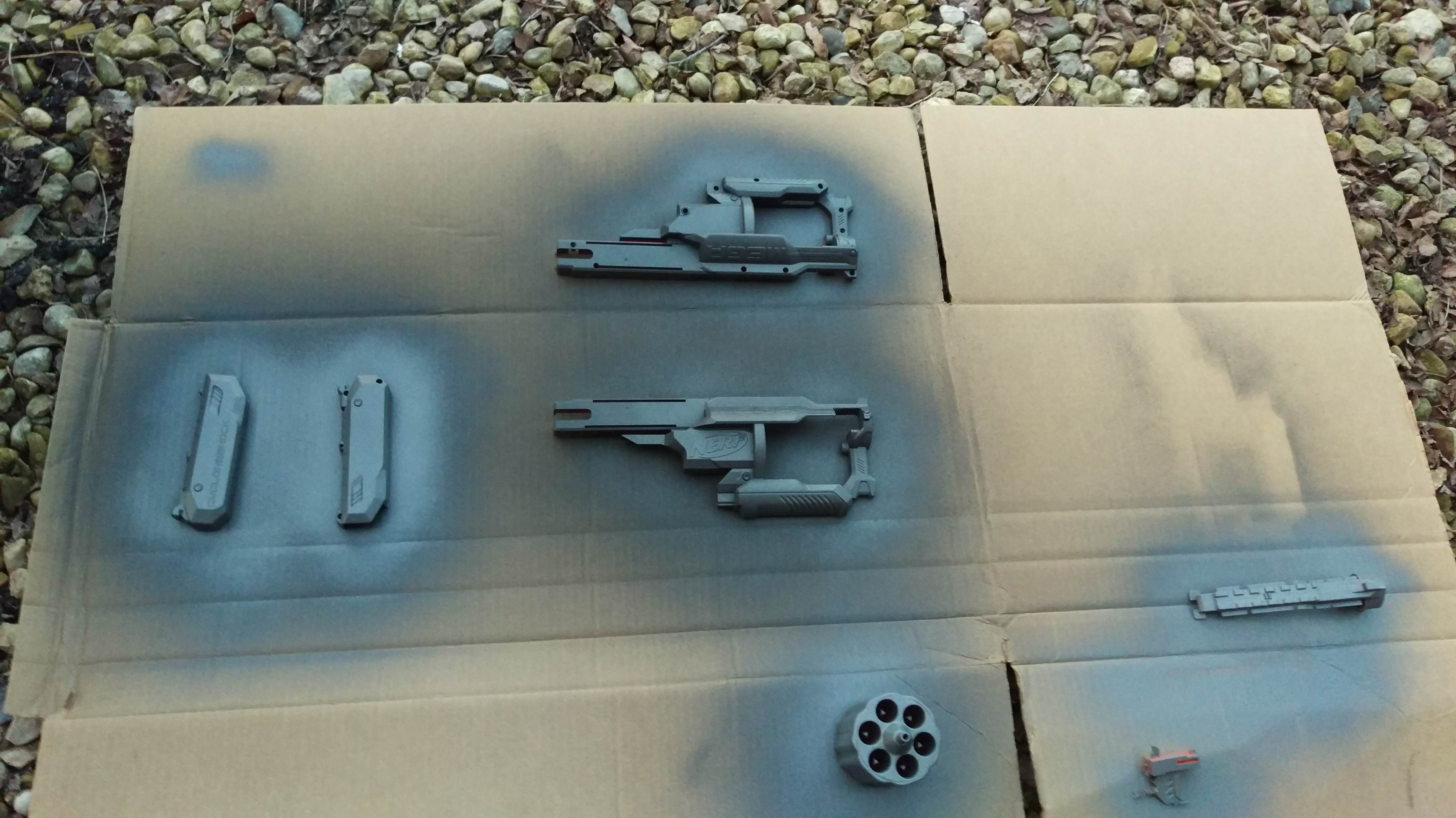

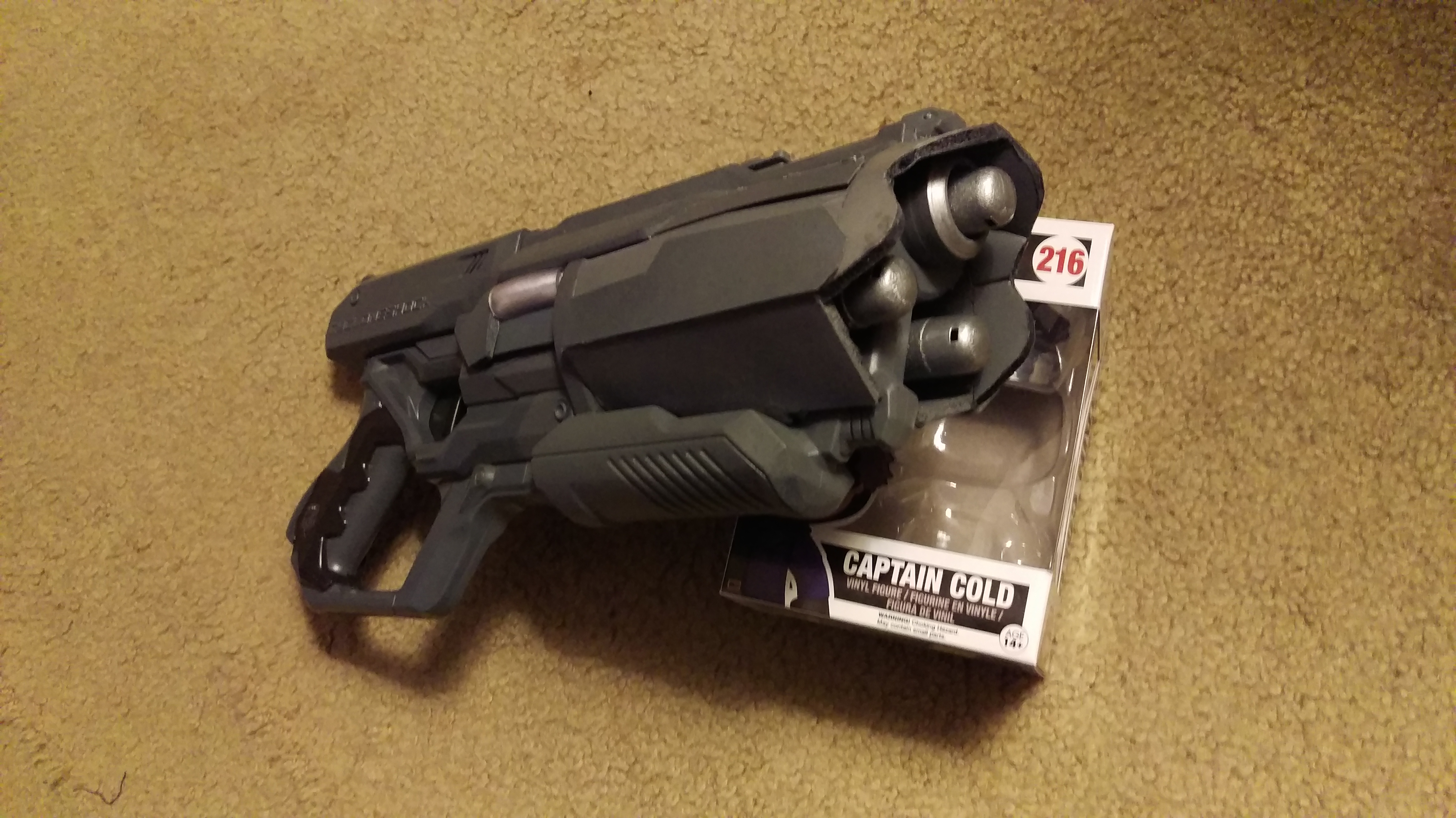

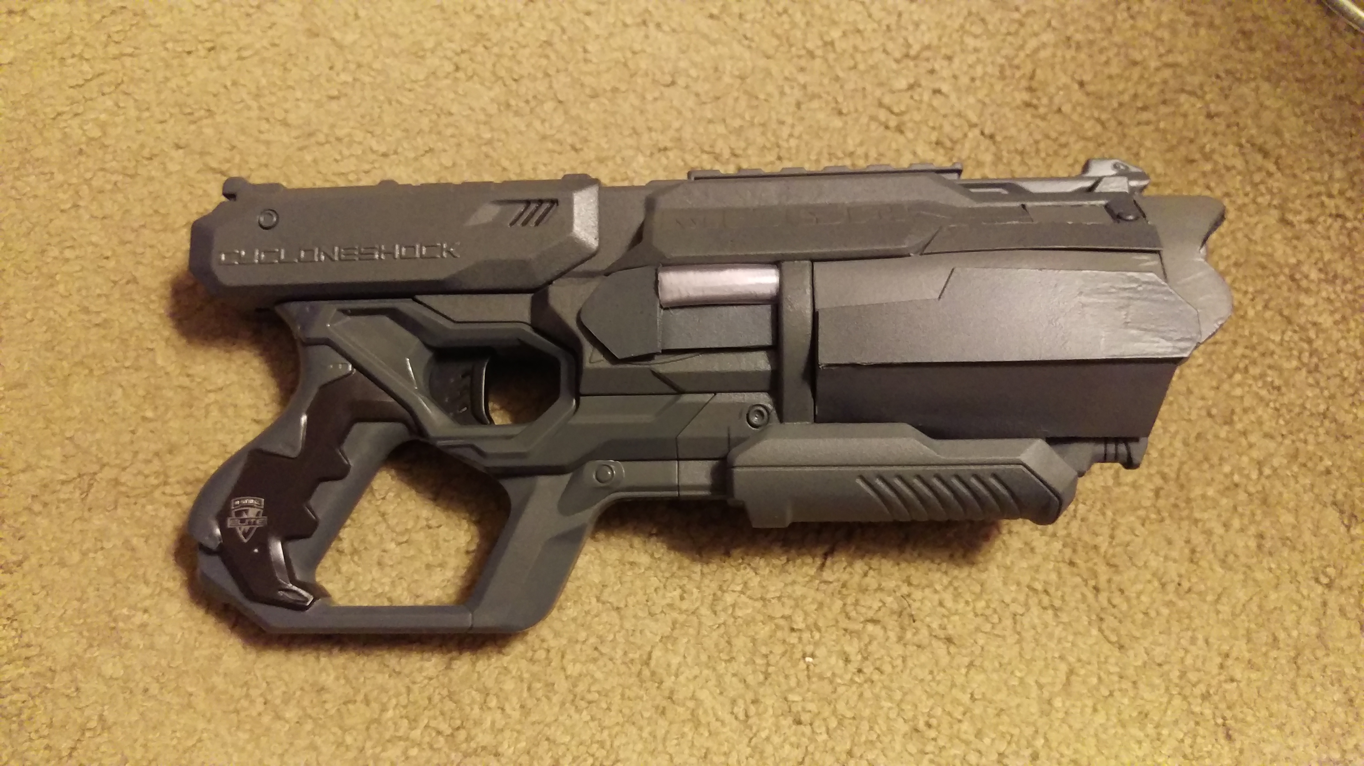

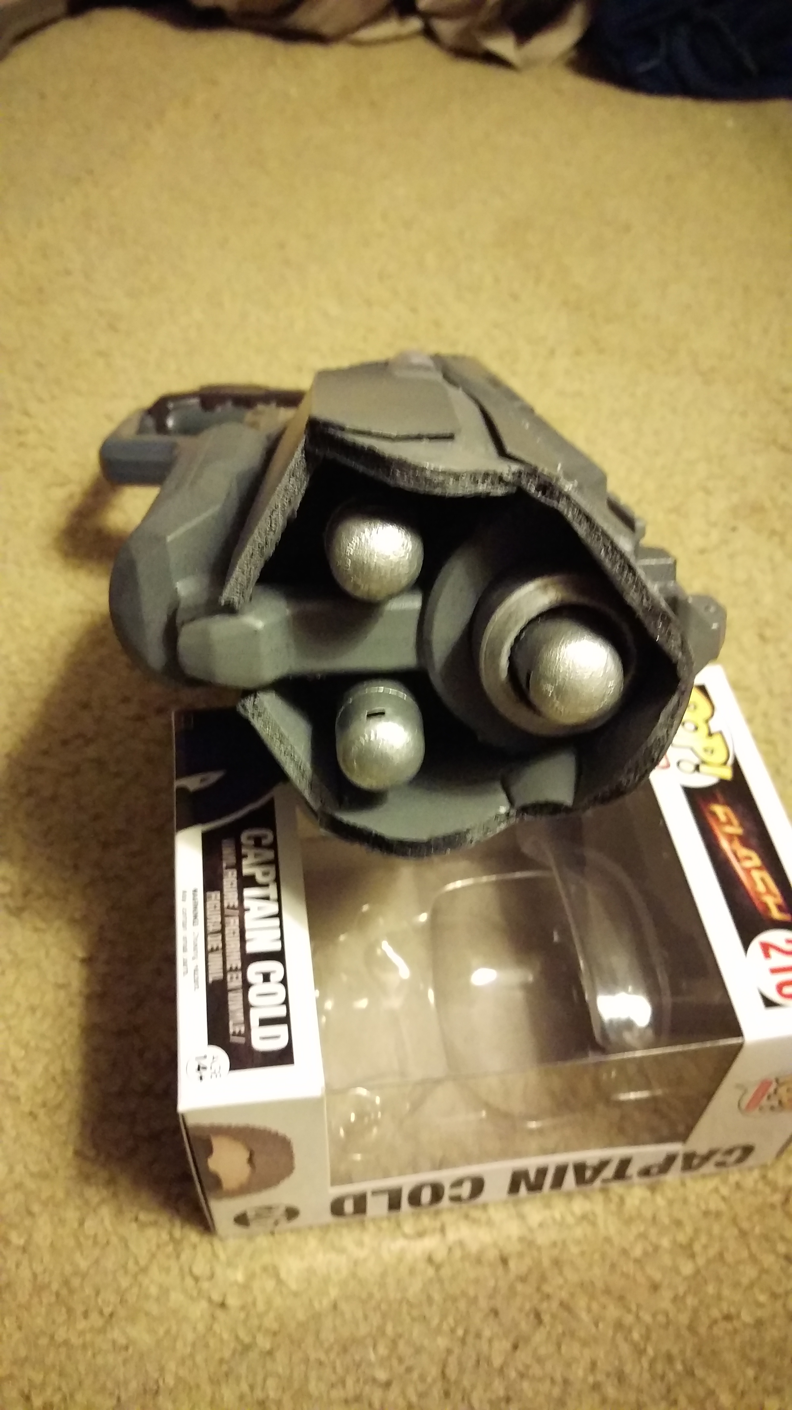

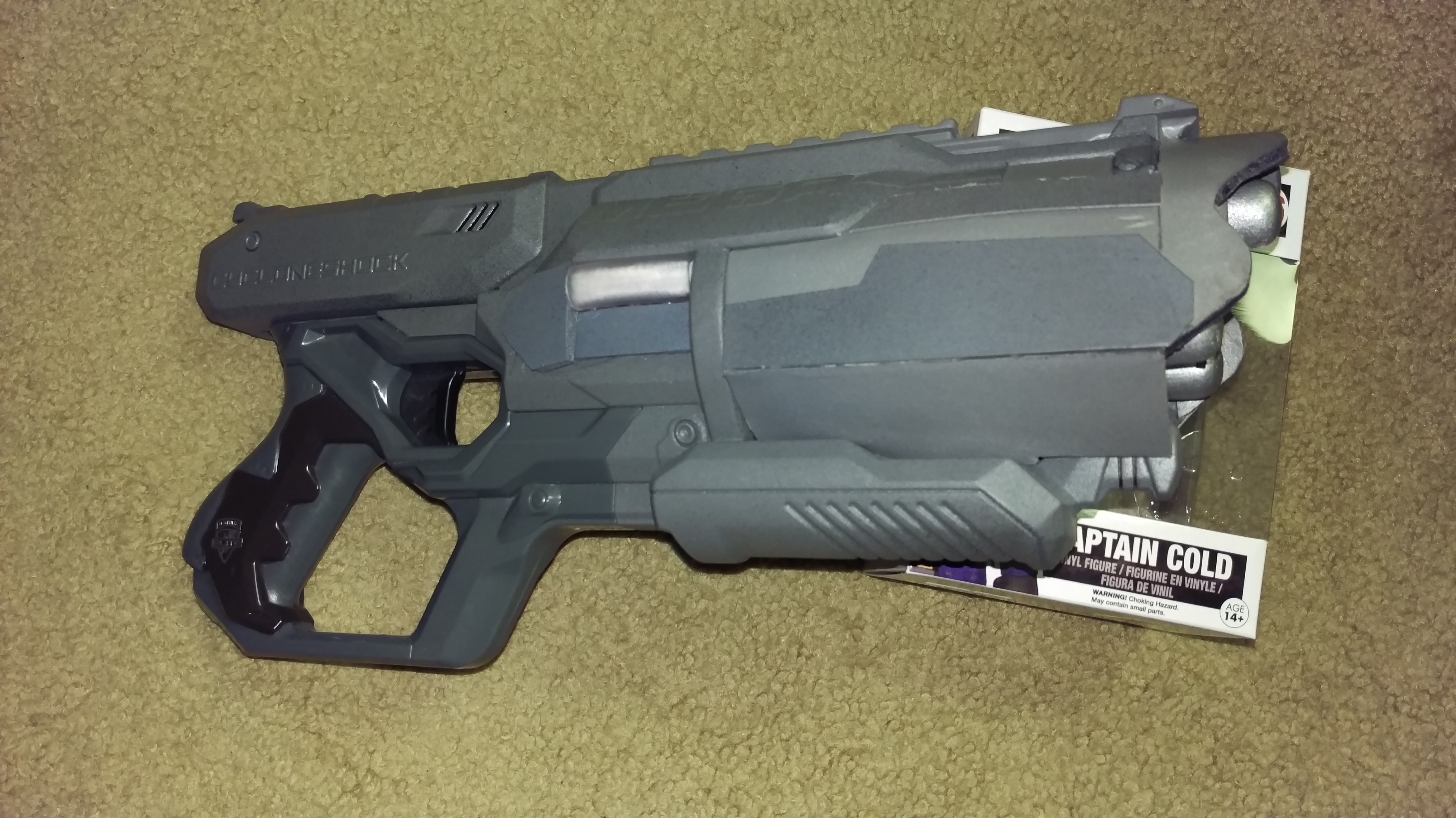

Took a Nerf Cyclone and painted it.. Obviously..... then took some hard foam board and cut it to the shapes I needed and painted those. Took some clear plastic tube and put a pipe cleaner in it to give it a glow look, since the LEDs I wanted were WAY to big and the batteries weren't able to fit inside the gun. Then painted the darts and glued them in place. All in all took me maybe 12 work hours not counting dry time and ran me $30 to $35.

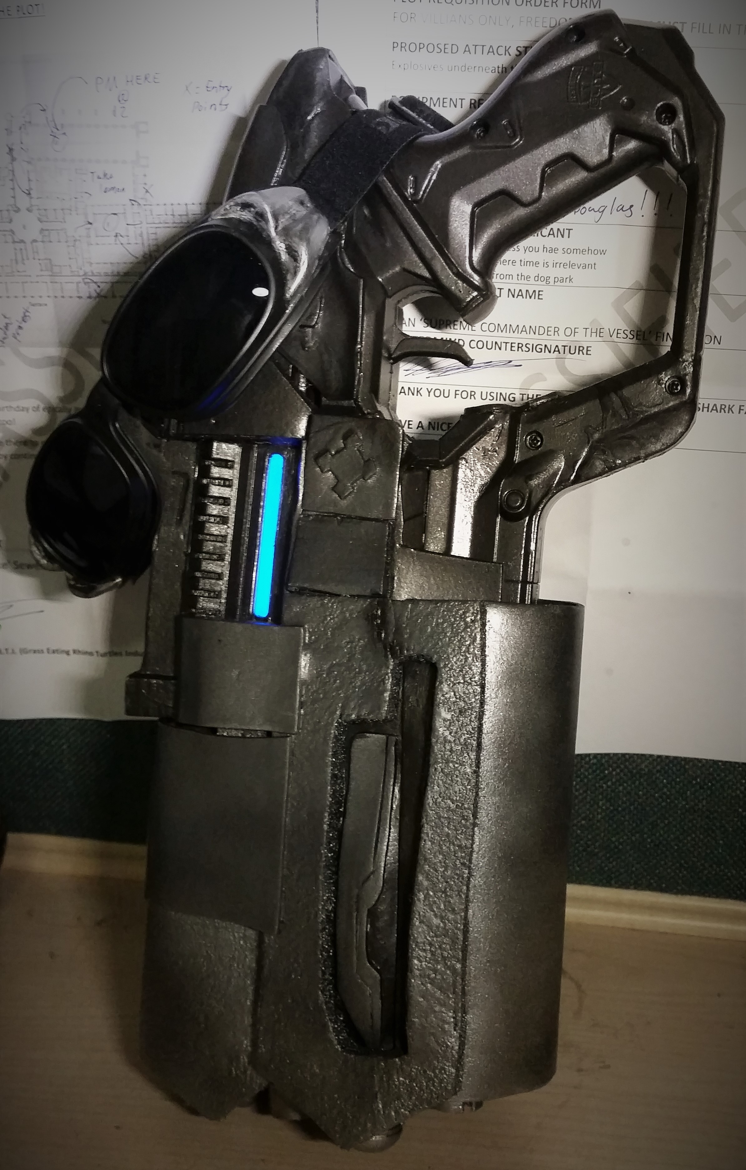

Hey everyone!

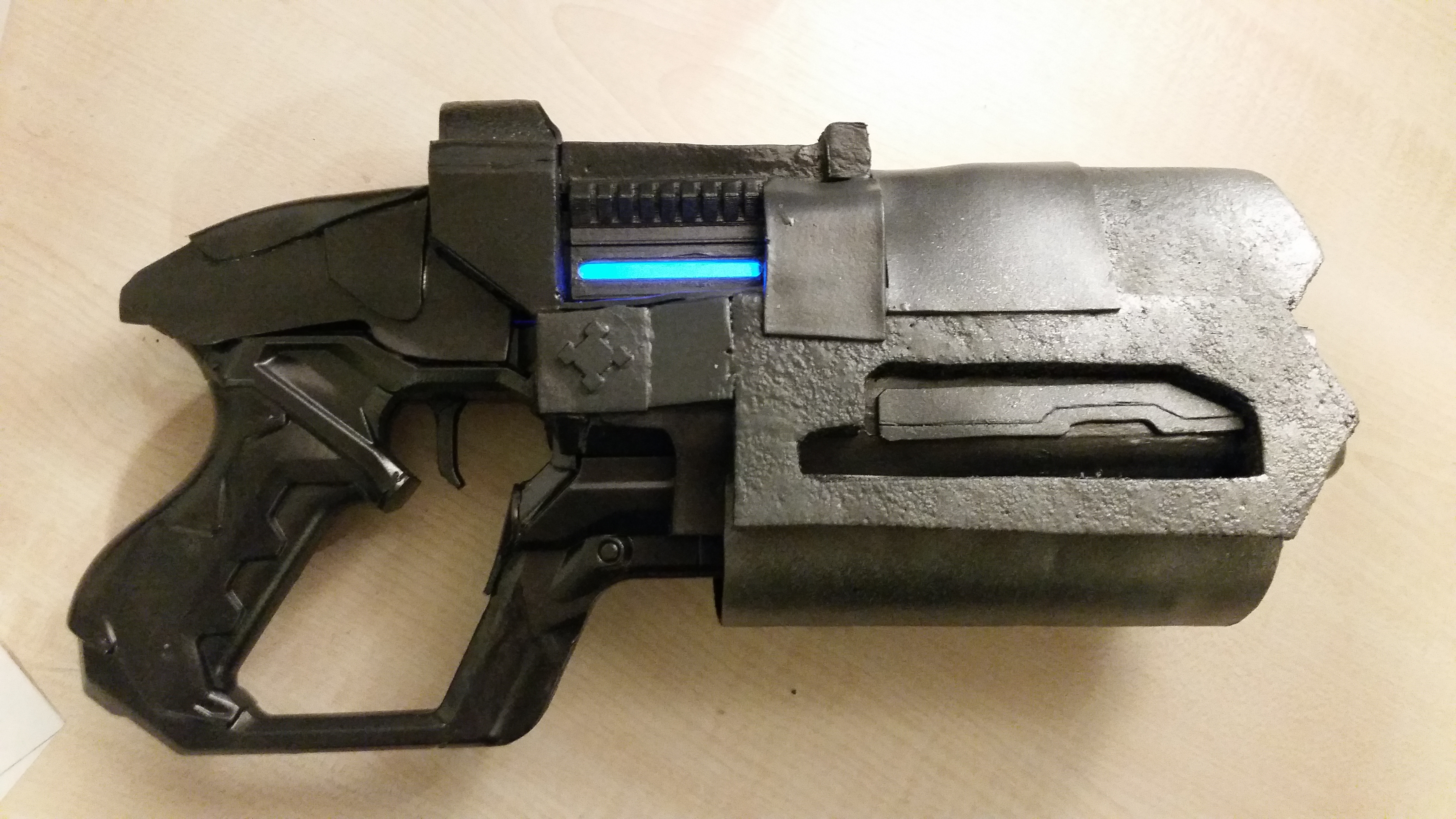

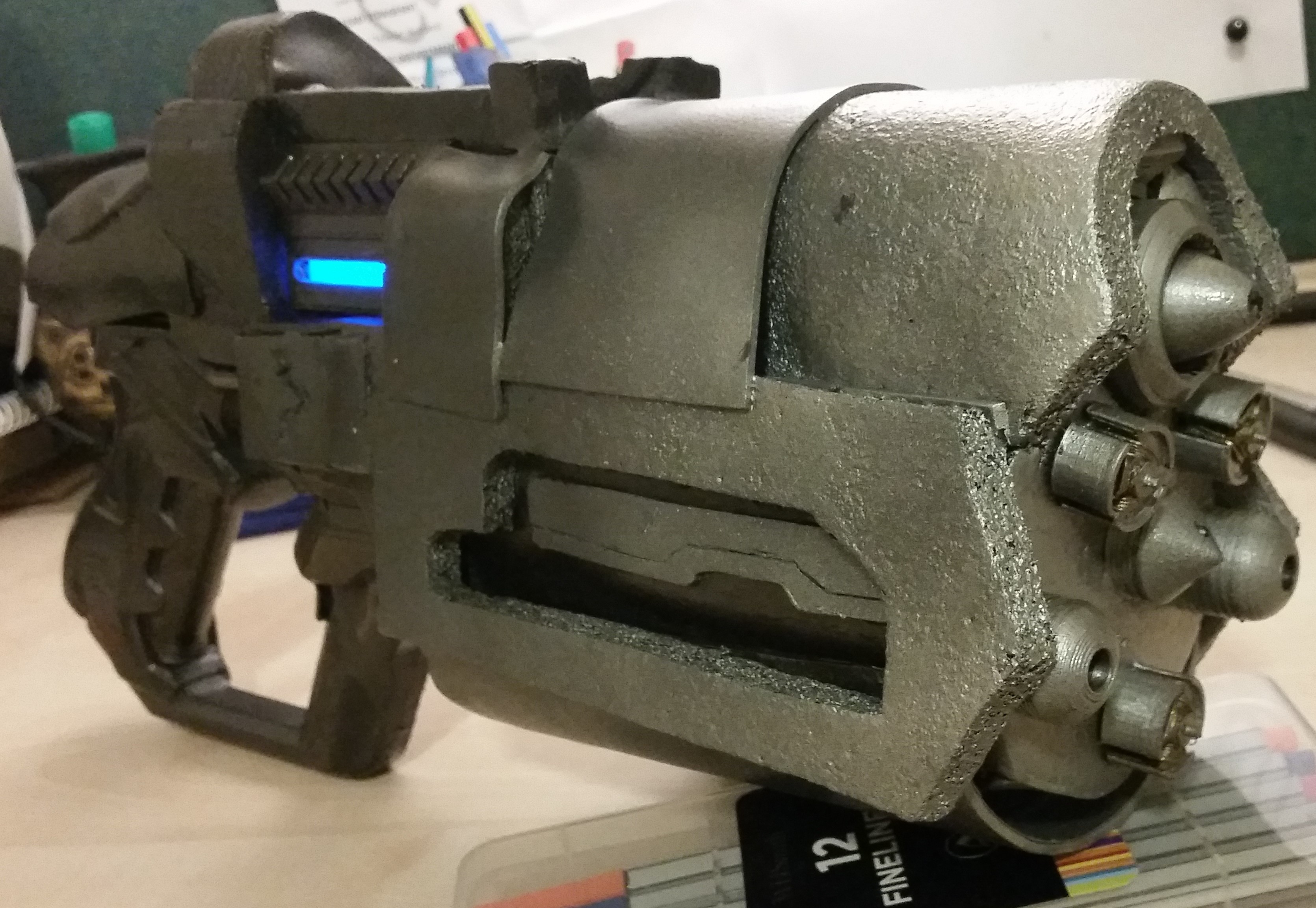

I'm going to be cosplaying Cold at London MCM this coming Saturday and I've finally completed my Cold Gun! It's modeled on the NERF Cyclone but heavily modified - I removed the barrel entirely and dremelled out quite a lot of the body to get the right shape. The panels with the energy bar, as well as the pointy bits/firing mechanisms on the end of the gun are all 3D printed, but the rest is foam.
The energy bar itself is EL tape which has been wired inside the body of the gun (the battery pack is hiding in a removable slot on the base), and the side bits of the goggles were made with milliput! If you want me to upload my progress photos (if that would be helpful to anyone) I'd be happy to, but here's the finished piece!

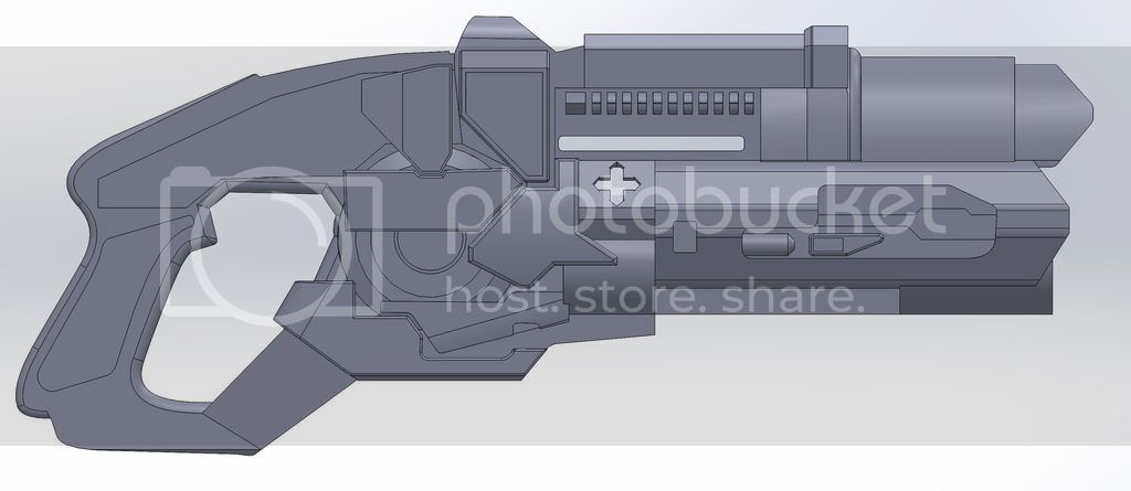

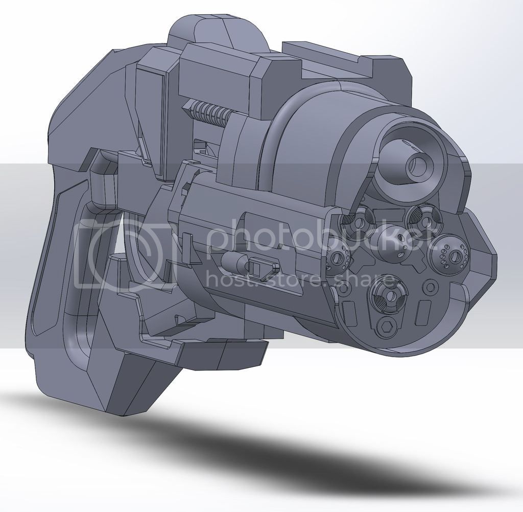

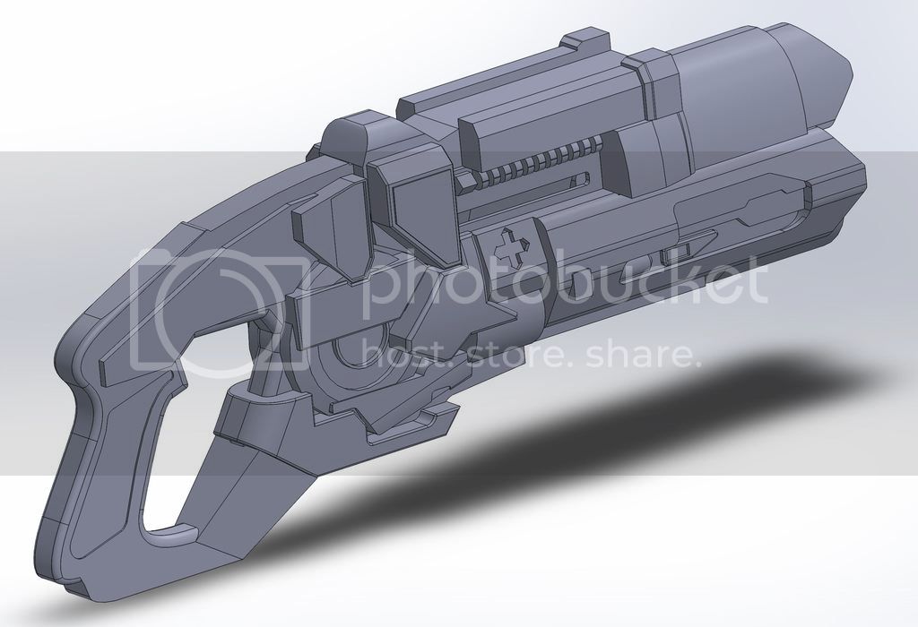

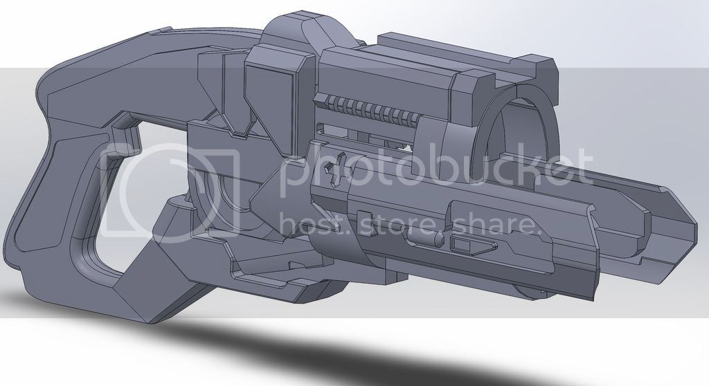

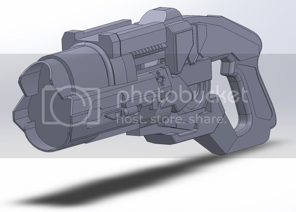

Anywho, this is what I've got so far after some hours in SolidWorks:
Hopefully I'll have some more time to work on things. I'm making it hollow to allow for the variety of electronics I'll be fitting in there, as well as one effect that folks will absolutely love if I can get it to work right.

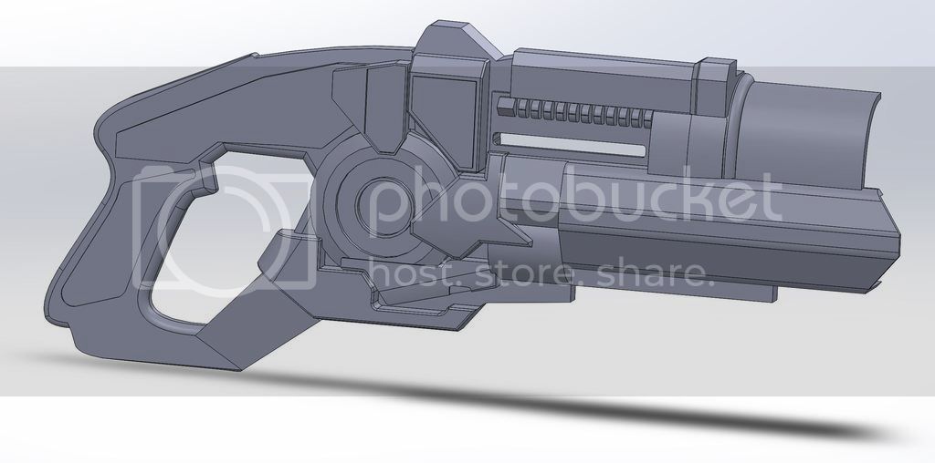

These pics give a better view of the whole design.
503419496_model_1.jpg503419496_model_2.jpg503419496_model_3.jpg503419496_product_4.jpg503419496_product_6.jpg
Your design for the Cold Gun is awesome, btw.

Thanks for the cold gun compliments. :) I am super excited to work on this project with what I have planned for what the gun will do. :D
Gotta say, having both a toddler and month-old infant at home sure does cut down on the amount of time one gets to work on anything...
In any case, I did get a bit of time to work on the model. The original barrel shape I had was totally wrong, so I redid it. Also did a lot of the greebles and such.

Having pinched a nerve in my back yesterday and trying to take it easy, I got plenty of time to work on the model even further.
All that's left are the inserts for the power switch (the cross-shaped hole in the side), the clear power indicator on the sides (long line hole in the middle) and the front nozzles. I've got some special plans for the latter. :)
Got the chance to work on it a bit more tonight and finish up the front details.
I also modified the main shell so I can print the arched parts separately from the rest of the body, since they're smoothed out and look like one piece rather than two halves. This way, I can have two main sub-assemblies that can easily be put together or taken apart to access the electronics and such.
The cones and domes on the front are separate pieces to make painting much easier.

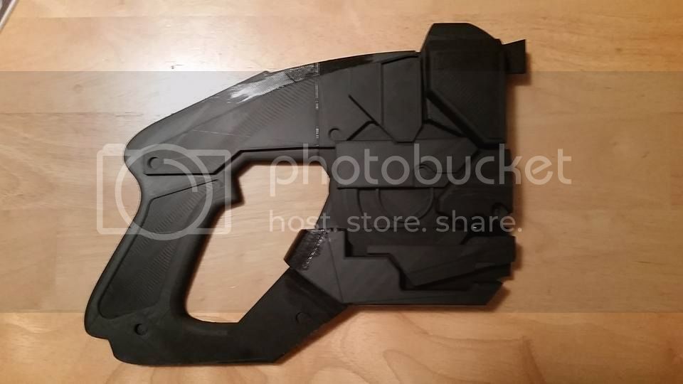

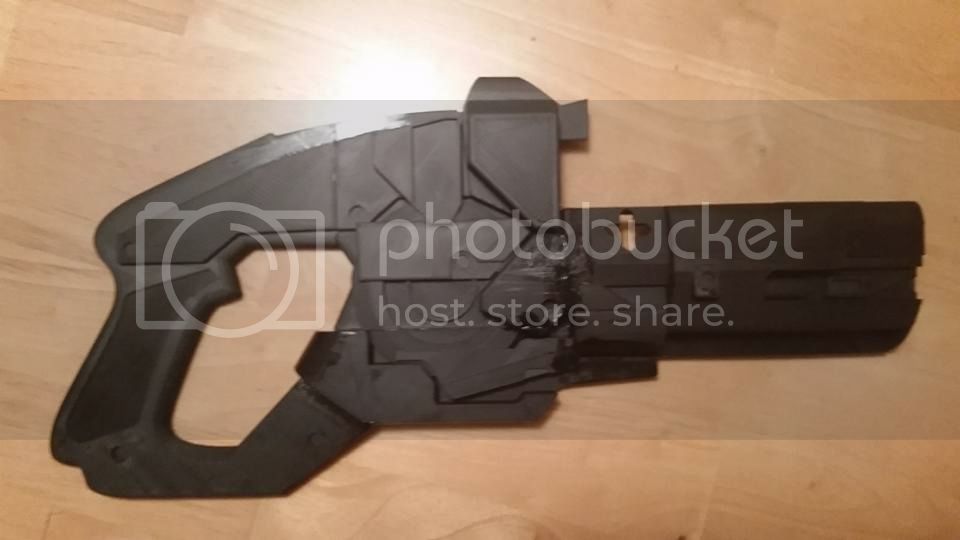

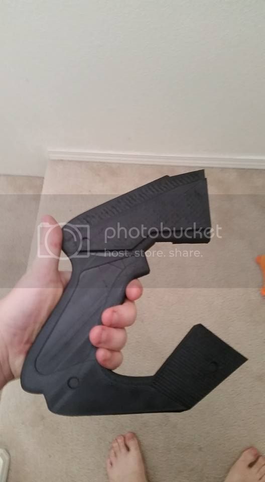

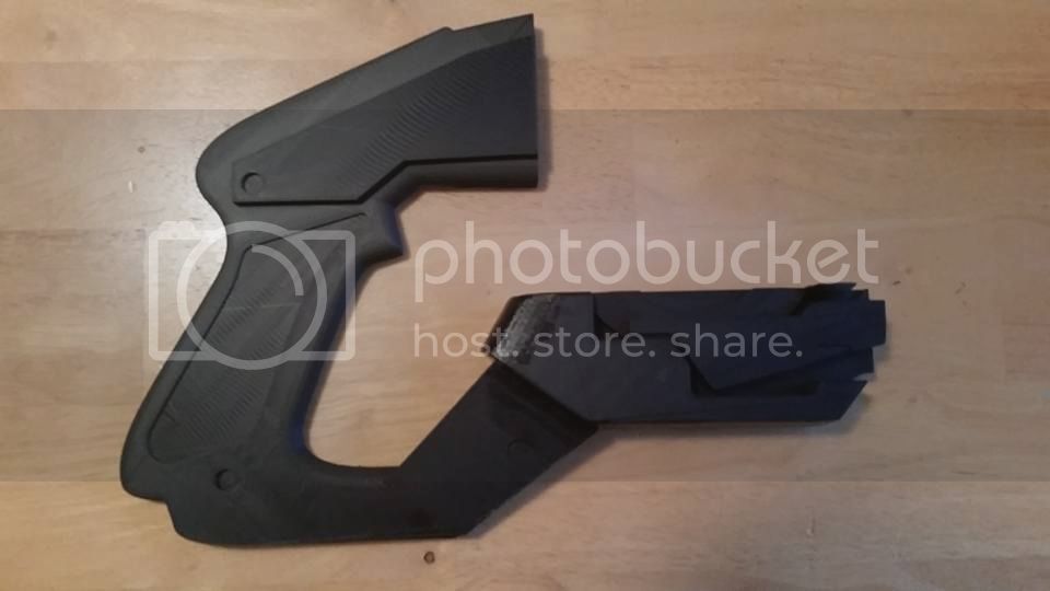

Got a few pieces of the gun printed at this point. Had a bit of a scaling issue:
Yikes, way too big! Let's scale that down a bit...
MUCH better! Also had a second piece done by then and attached it to the handle.

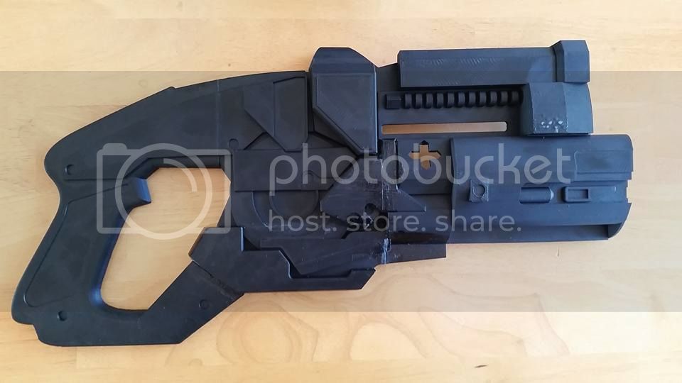

Another shot, sans hand.
This is the part where I started giggling maniacally a bit. This is turning out beautifully!
The next piece is about an hour away from finishing being printed. After that, there's two more pieces and this half of the shell is done!
