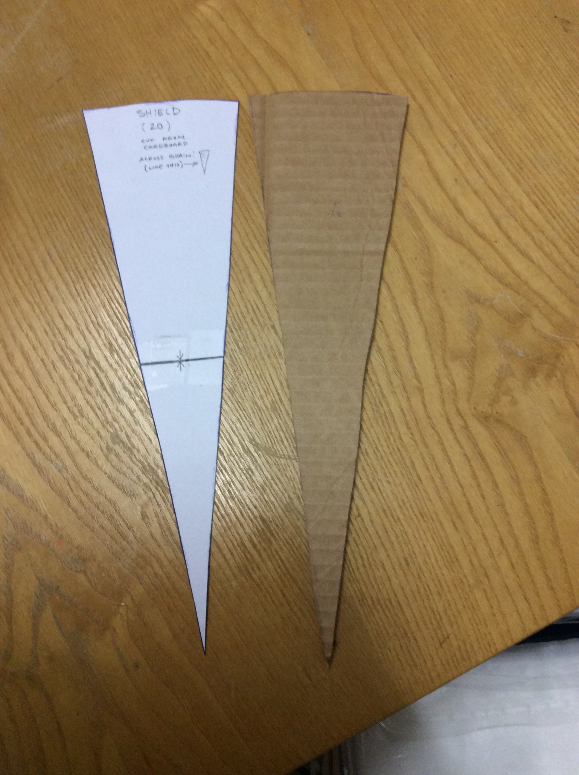

I started with this pattern (which I found on the Internet)

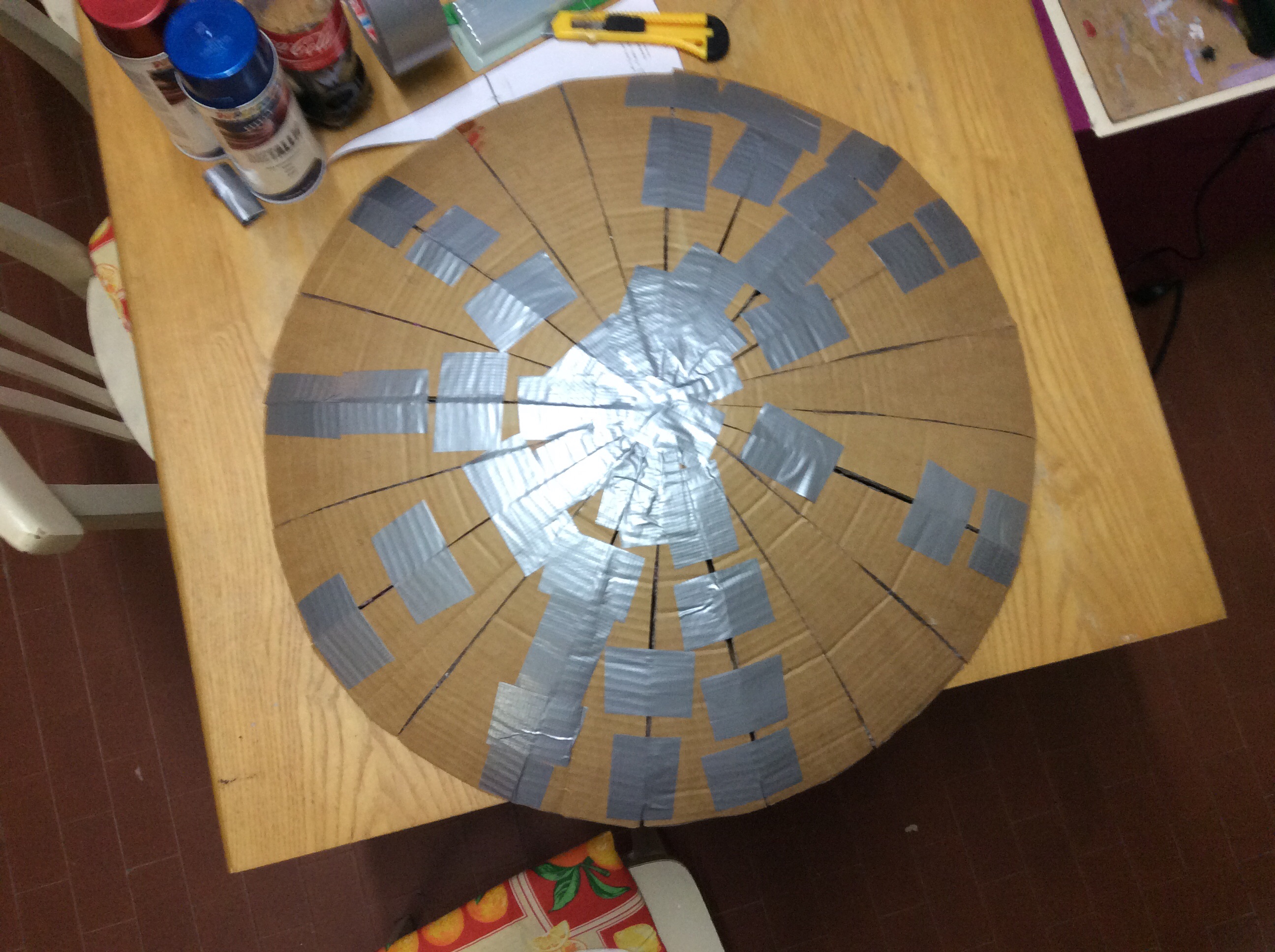

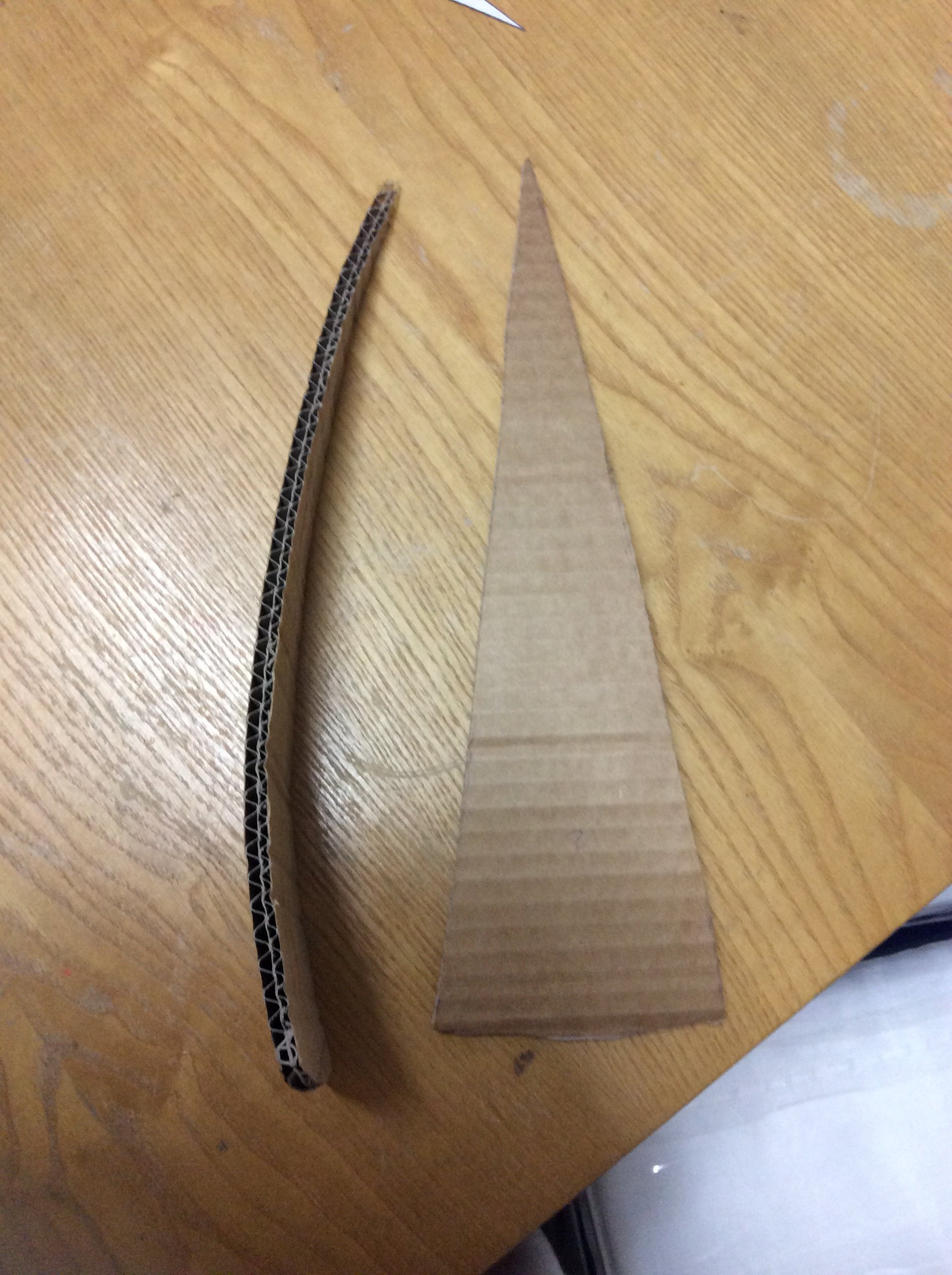

I cut cut the triangular part to do the main corpse of the shield
I cut 20 pieces! With the corrugation of the cardboard perpendicular at the pattern, like in the pic
then I bent them like this
At this point I should have hot glued them together, but.... I forgot to buy hot glue....yeah, I'll do it tomorrow...

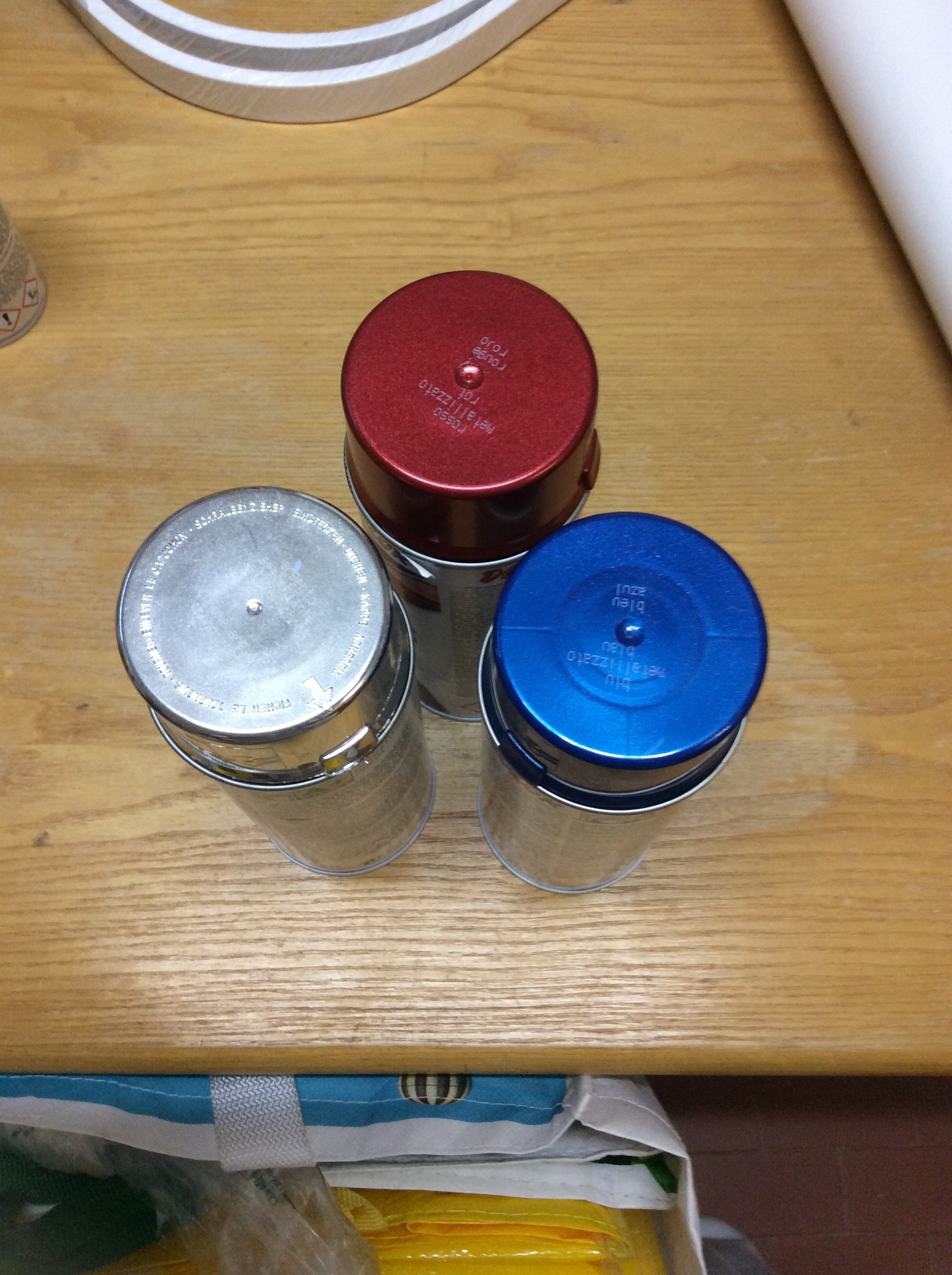

The painting will be with metallic color since I'll use silver instead of white
these are the spray I'll use

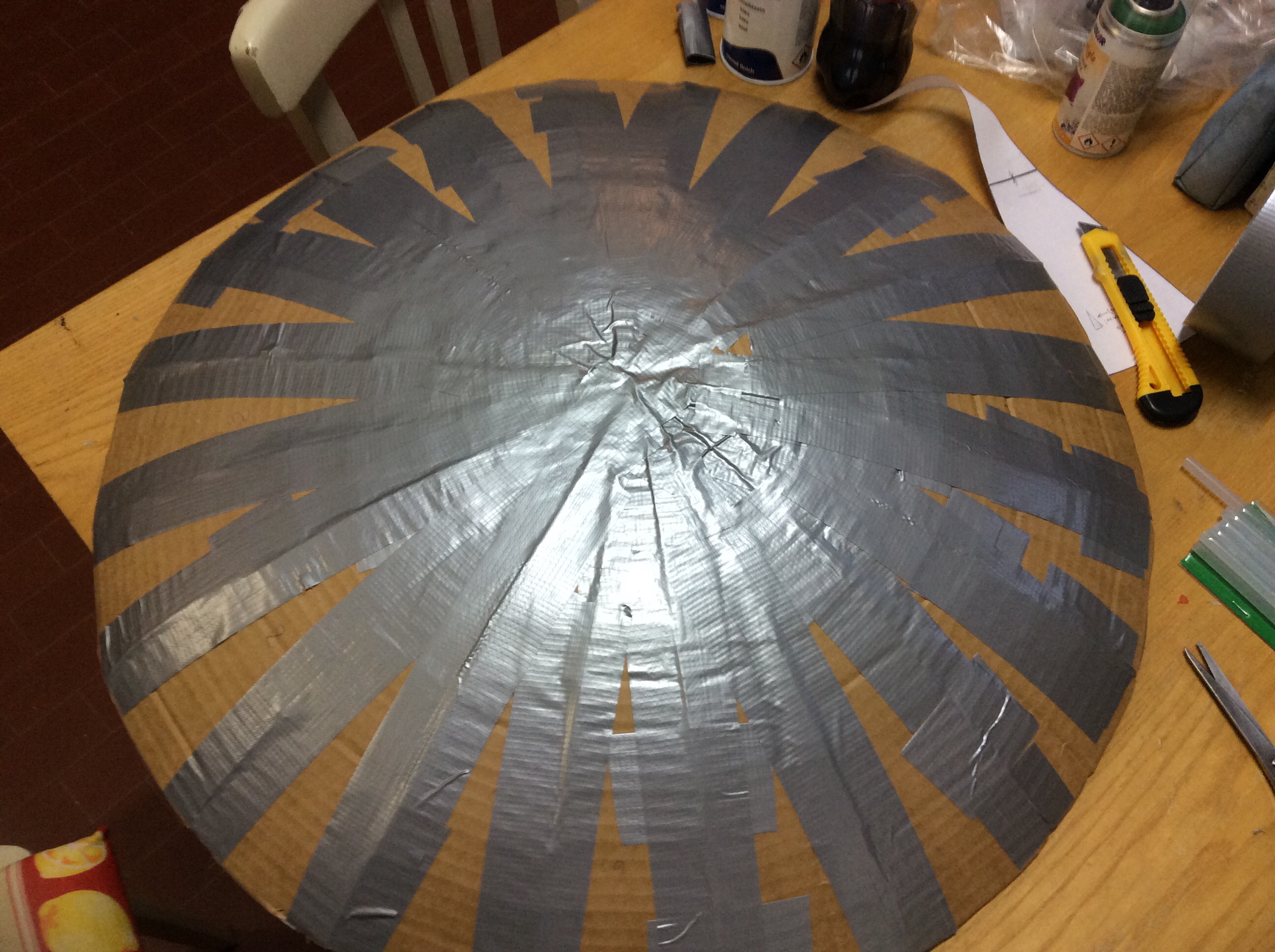

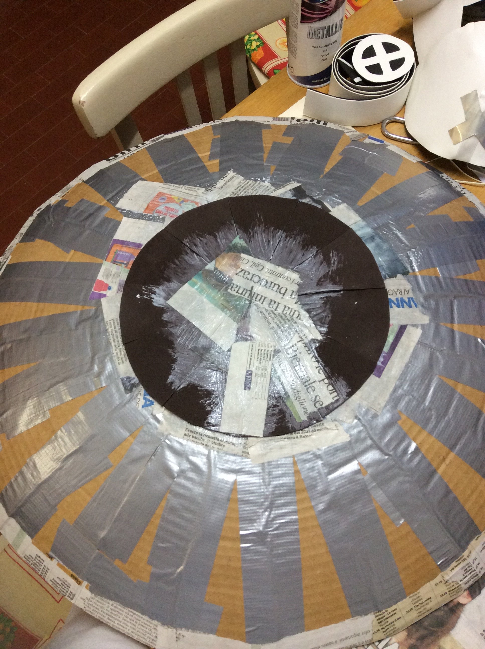

I intended to use the hot glue.... Well, I found out I'm not good with it so, I relied on my beloved duct tape!
as you can see, a lot of duct tape XD well, you know right? If you can't solve things with duct tape, you're not using enough of it
anyway, I used hot glue on the inside to fix the pieces better

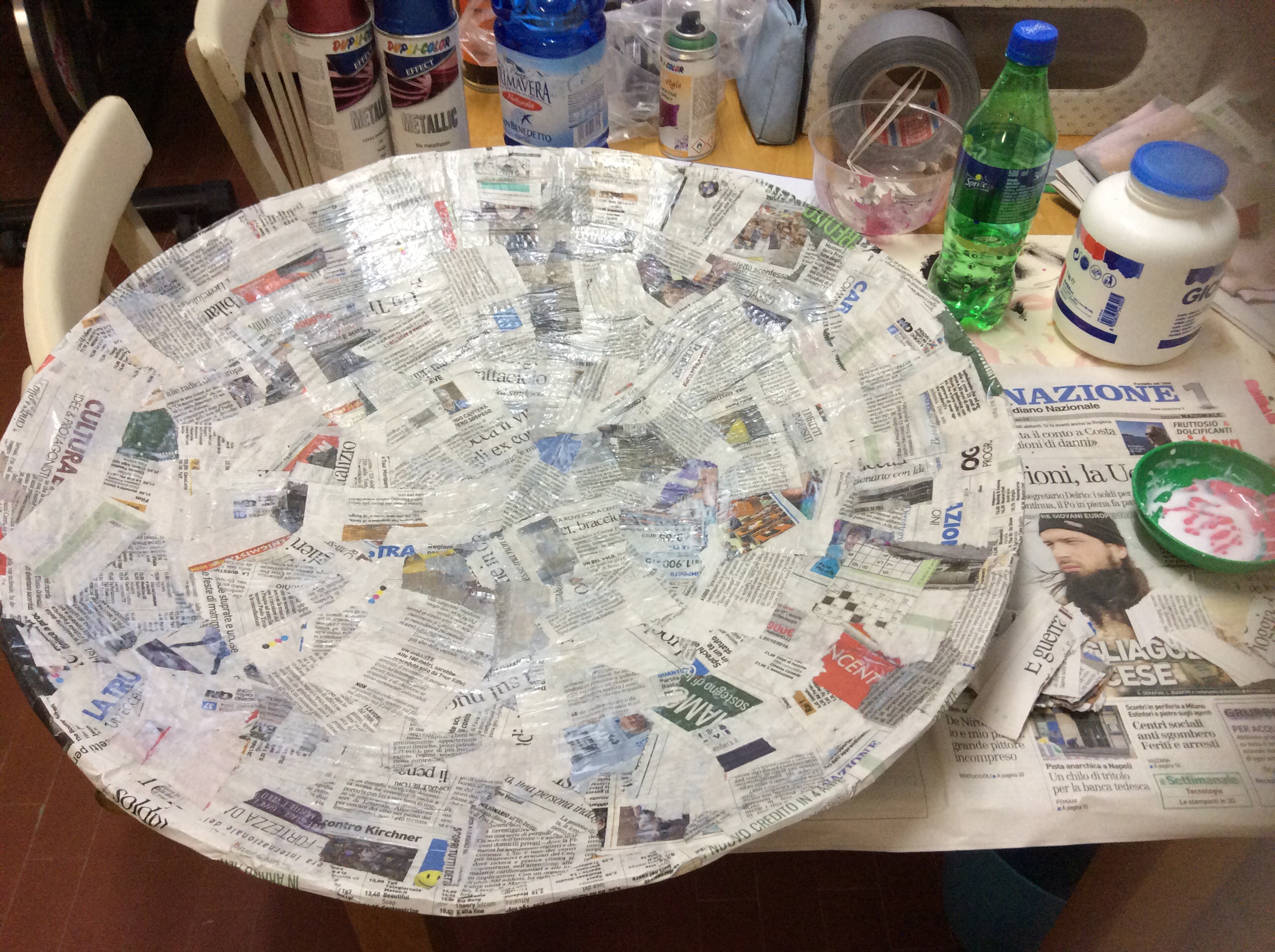

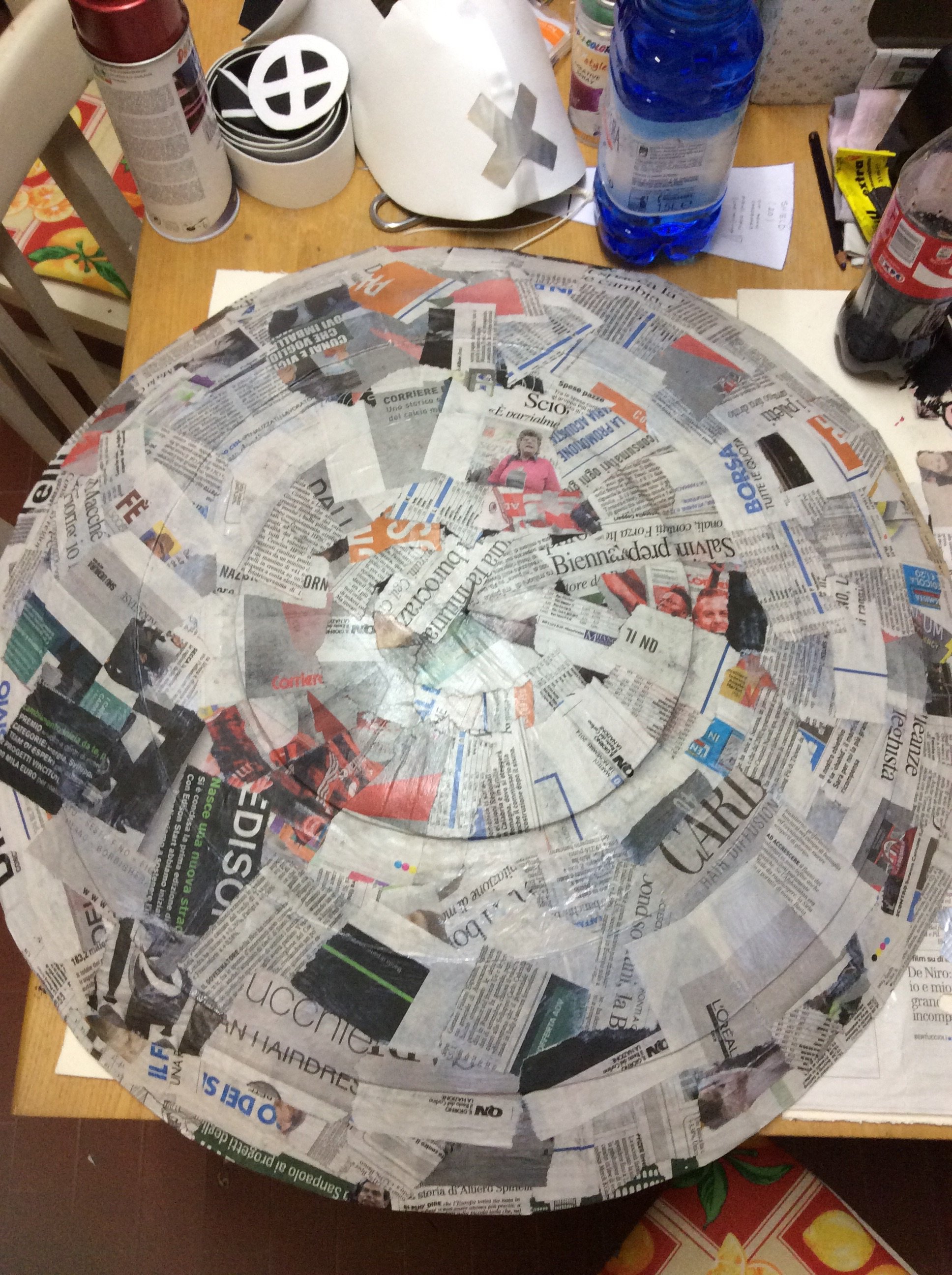

the I papermached it

I papermached under the foam and the on the foam paying attention at the grooves made by the foam
p.s. I hate papermache XD

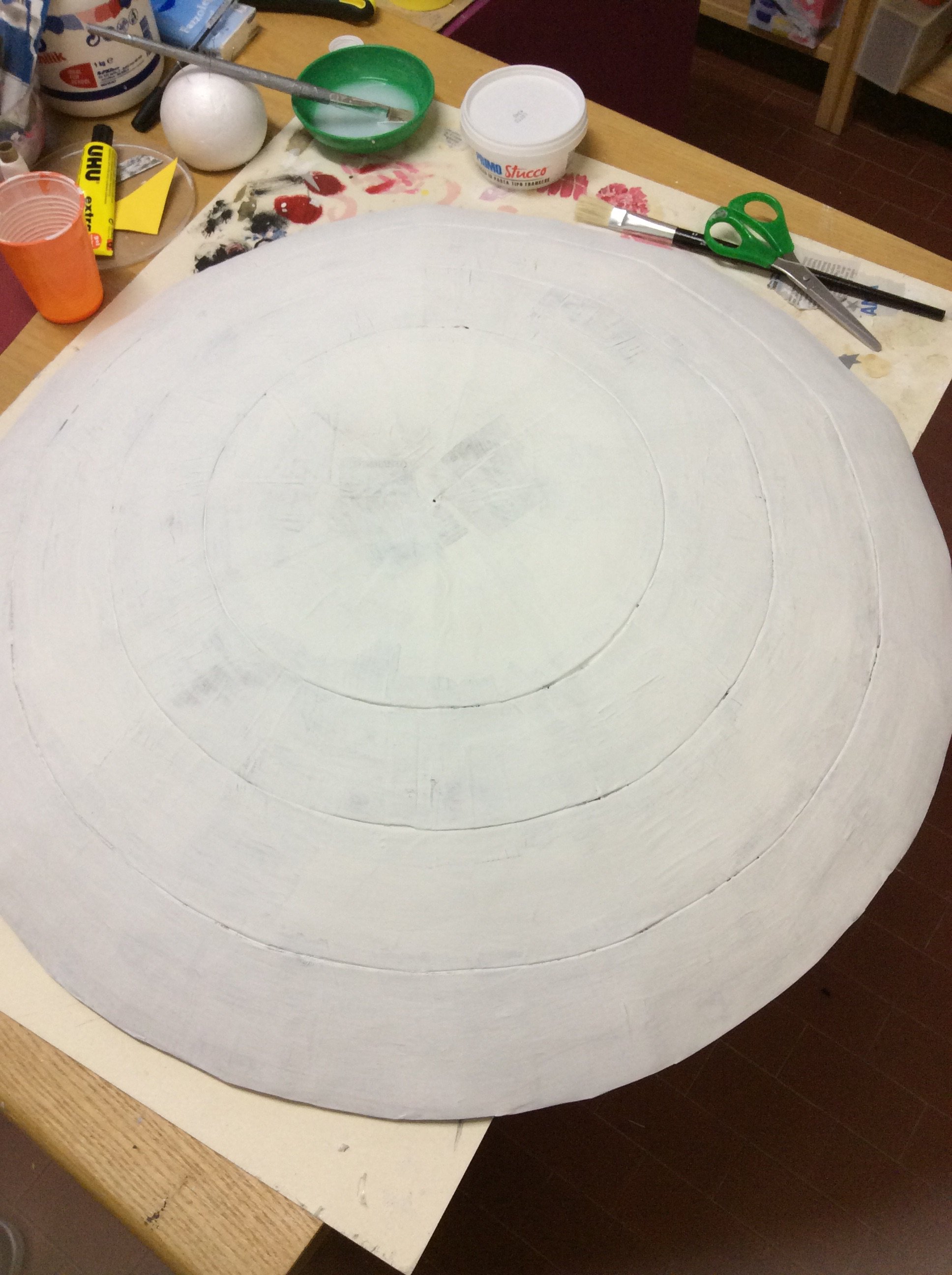

then I diluted some "stucco" you know the one used to relate holes in the walls
And applied several coat
I think I'm going to apply more coat and then sandpaper everything until it's smoot enough, will that work?
I think I will discover it soon XDD as before let me know what you think aaaaaand I'll update soon!
I suggest you to duct tape them together before the glue part.... They can get a little bent in the wrong way with just glue XDD
I also decided to use tape to hold the pieces together before applying the glue because otherwise it just kept falling apart.

Nice job with the paper mache, too. What are you using for the paste? Is it just PVA glue or something else? Also, what matrial are you using for the paper mache?
I'm not using a proper paste, I'm basically just gluing pieces of newspaper with normal glue, but they might get a little wrinkly, that's why, I'll use the plaster and the sandpaper to smooth them

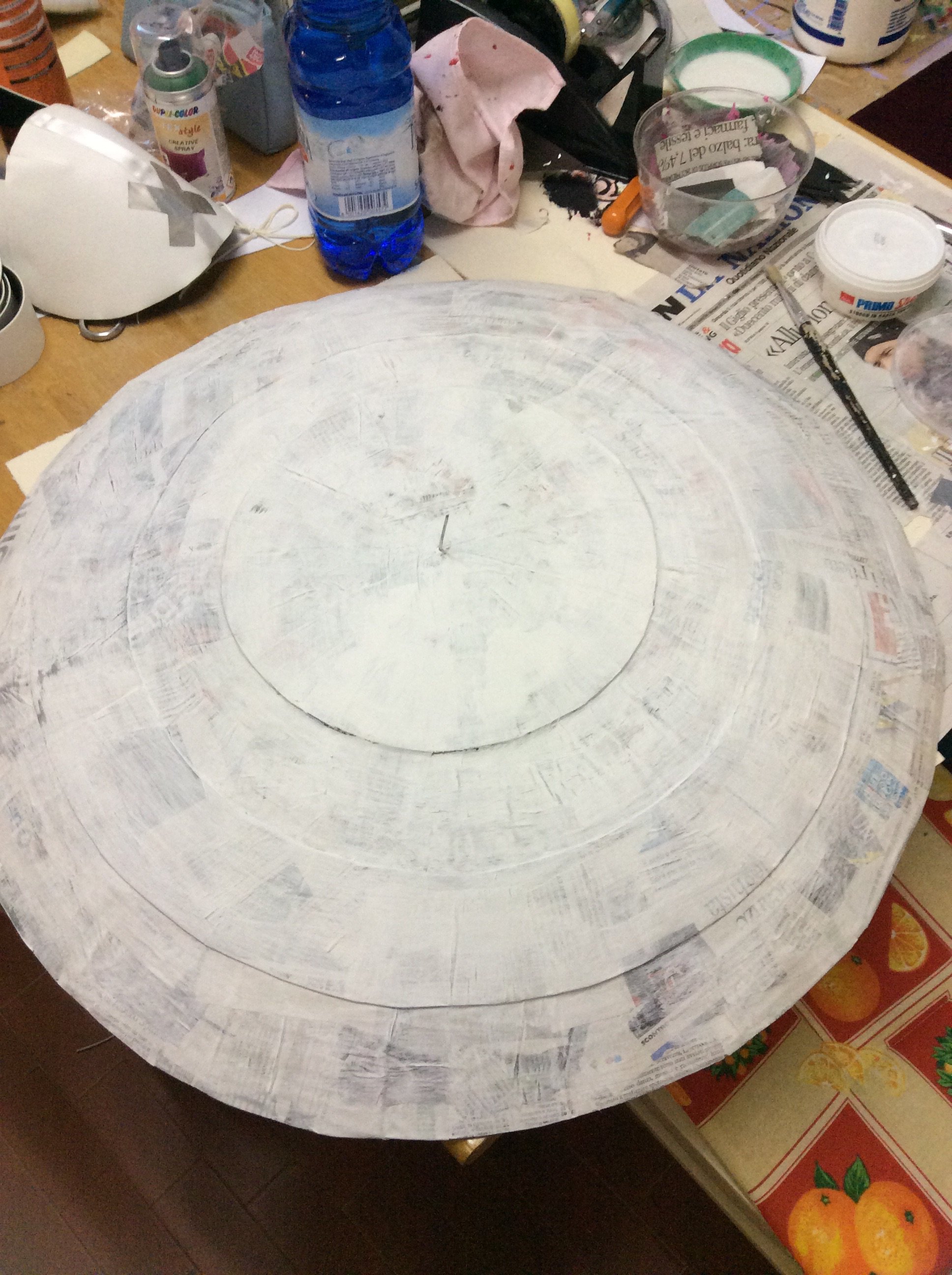

Here I come again with new updates!!!

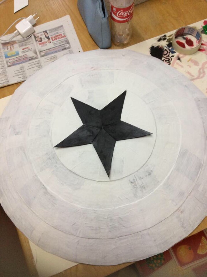

after lots of layers of stucco:
Tah dah! Or so I thought, since after sandpaper and glue it turned out like this:
Horrible! The parts without foam look so... Angular!

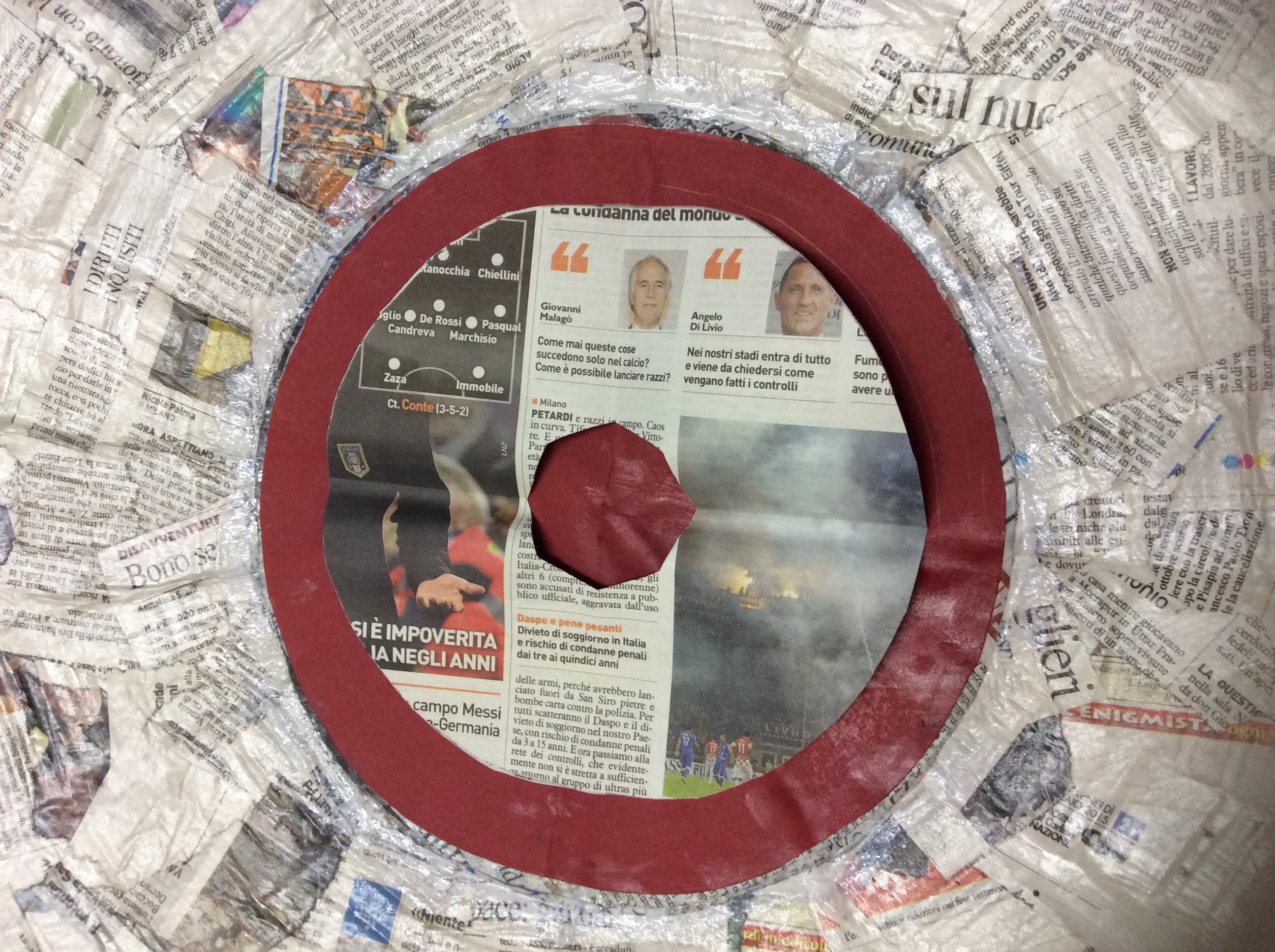

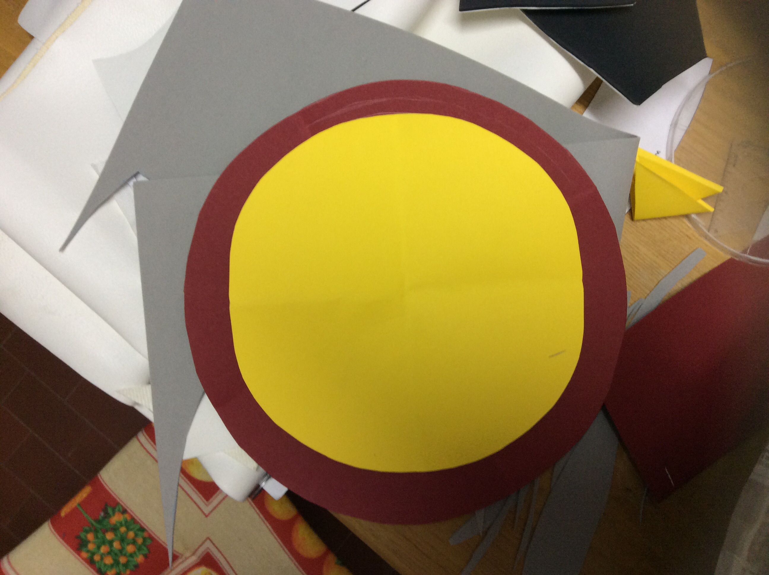

That made me think a loooooot so I decided to foam the other two circle
here's the first! And then my beloved papermache!
That's it for today! Stay tuned for new updates!
(I apologize for any grammar/syntactical error since is midnight and I'm not thinking right XD)
Not at all! It takes well the paper mâché, the stucco and the sandpaper too! I really recommend it, because it preserve the shield from being too angular

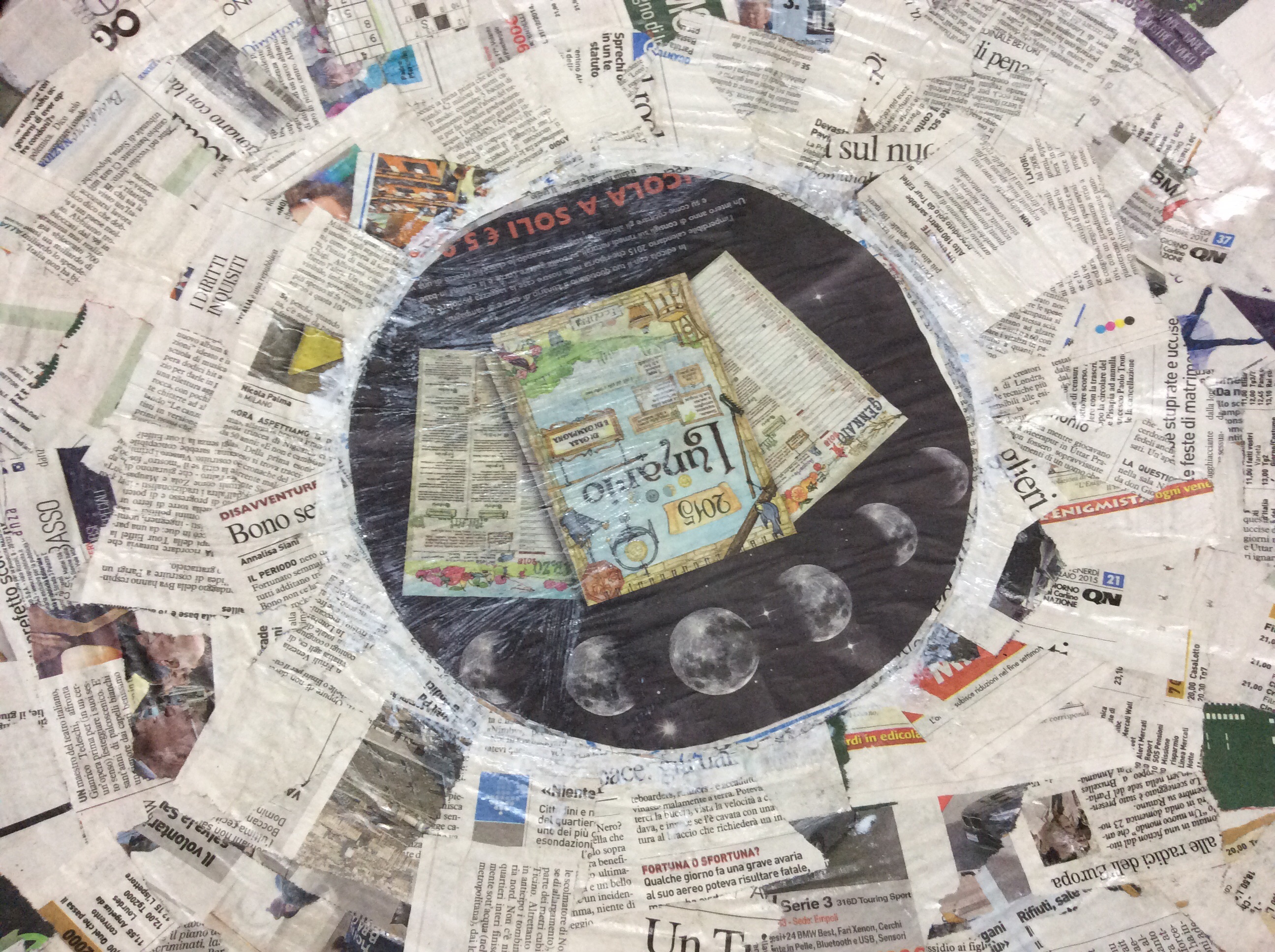

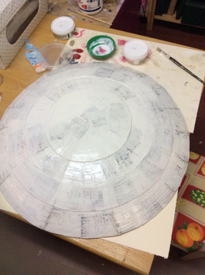

After papermacheing the two foam circle I added it looked like the first pic, then I used others layers of stucco,
But looooooooooook it's definetely less angular

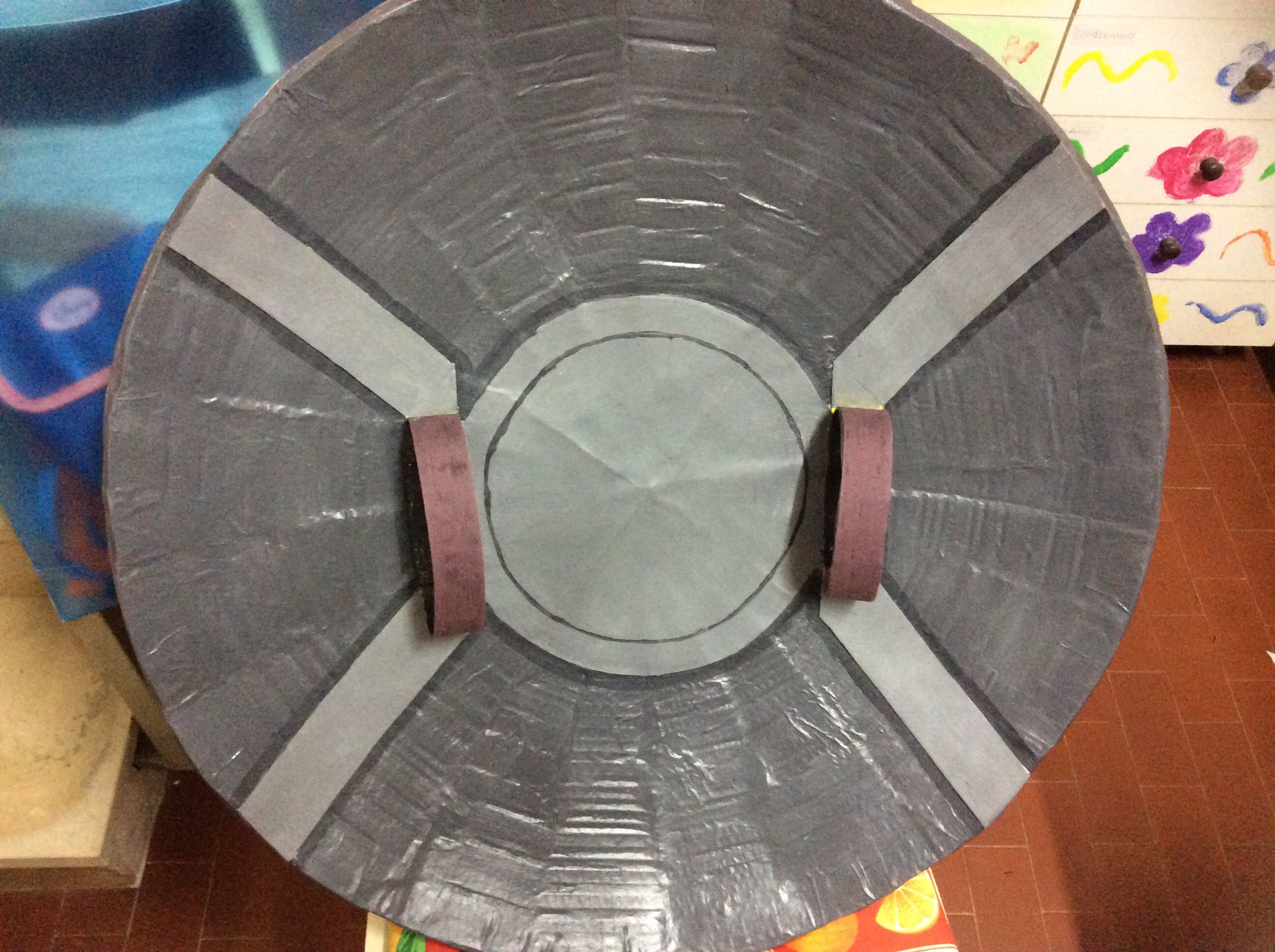

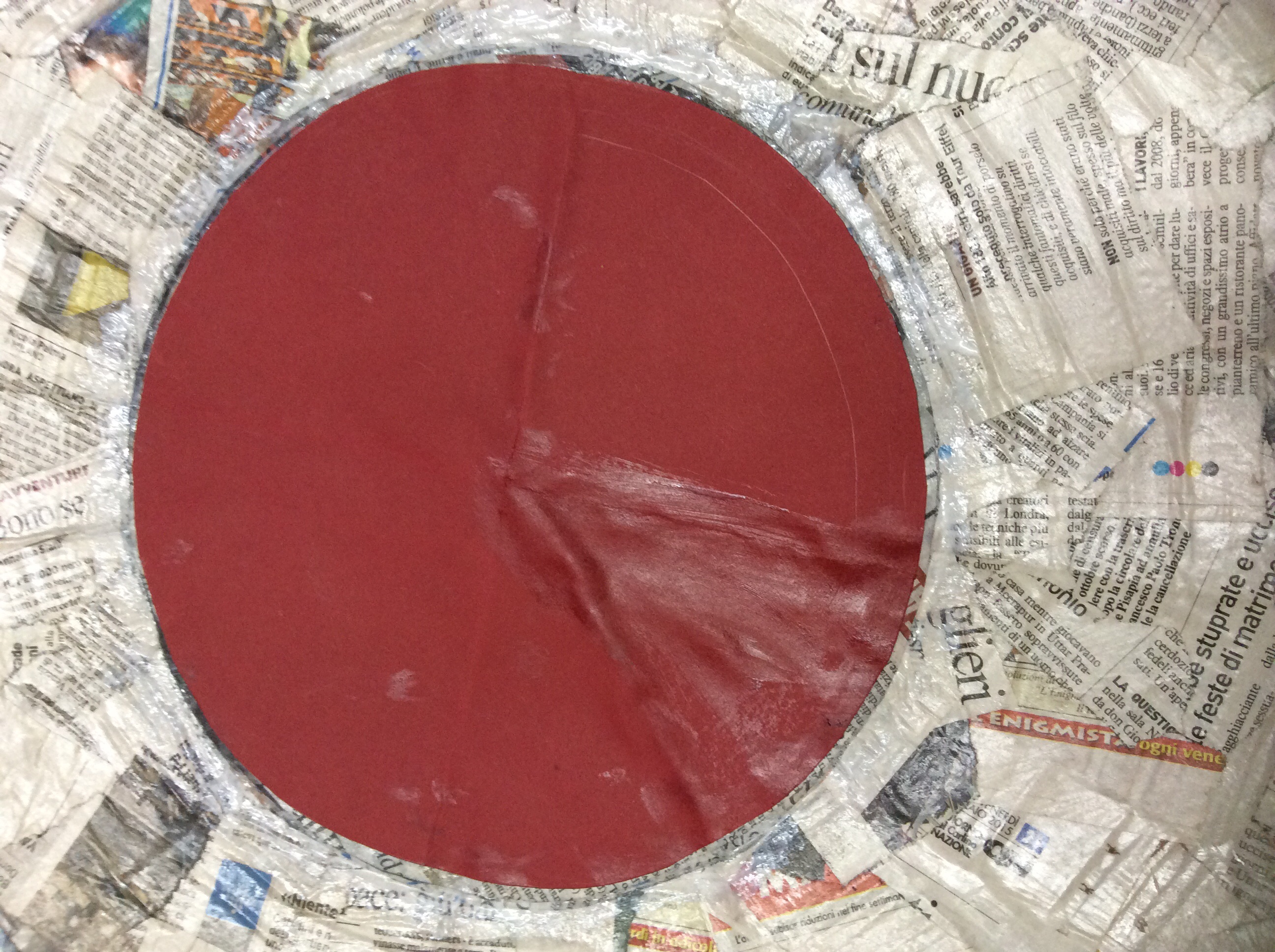

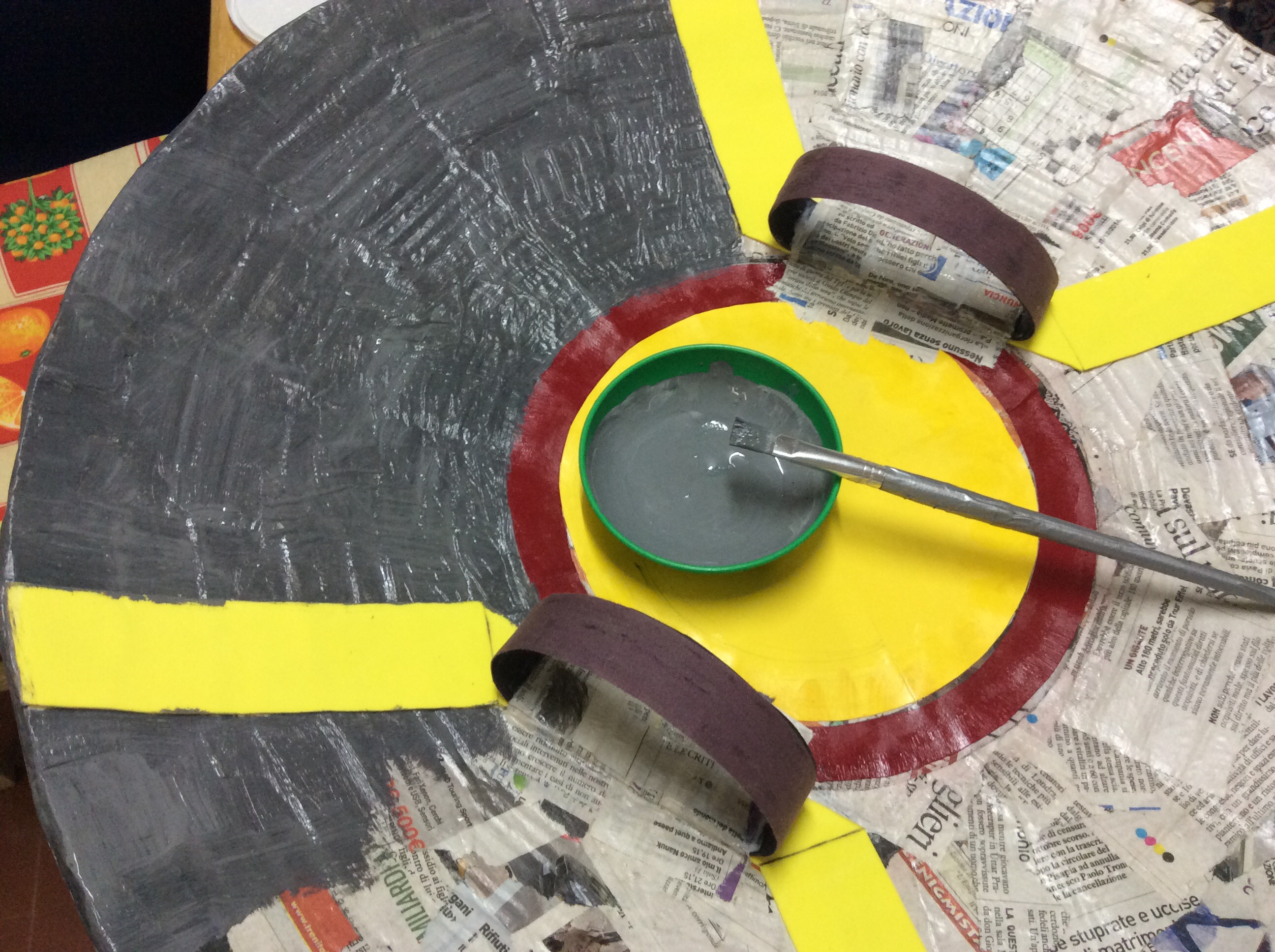

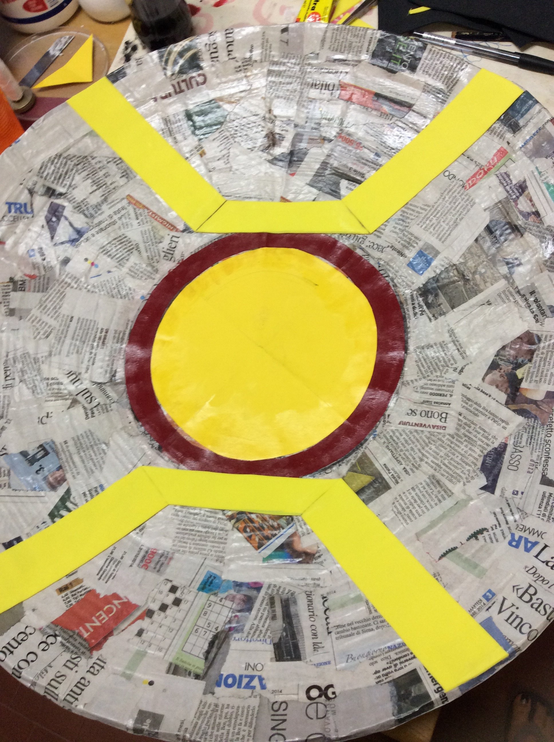

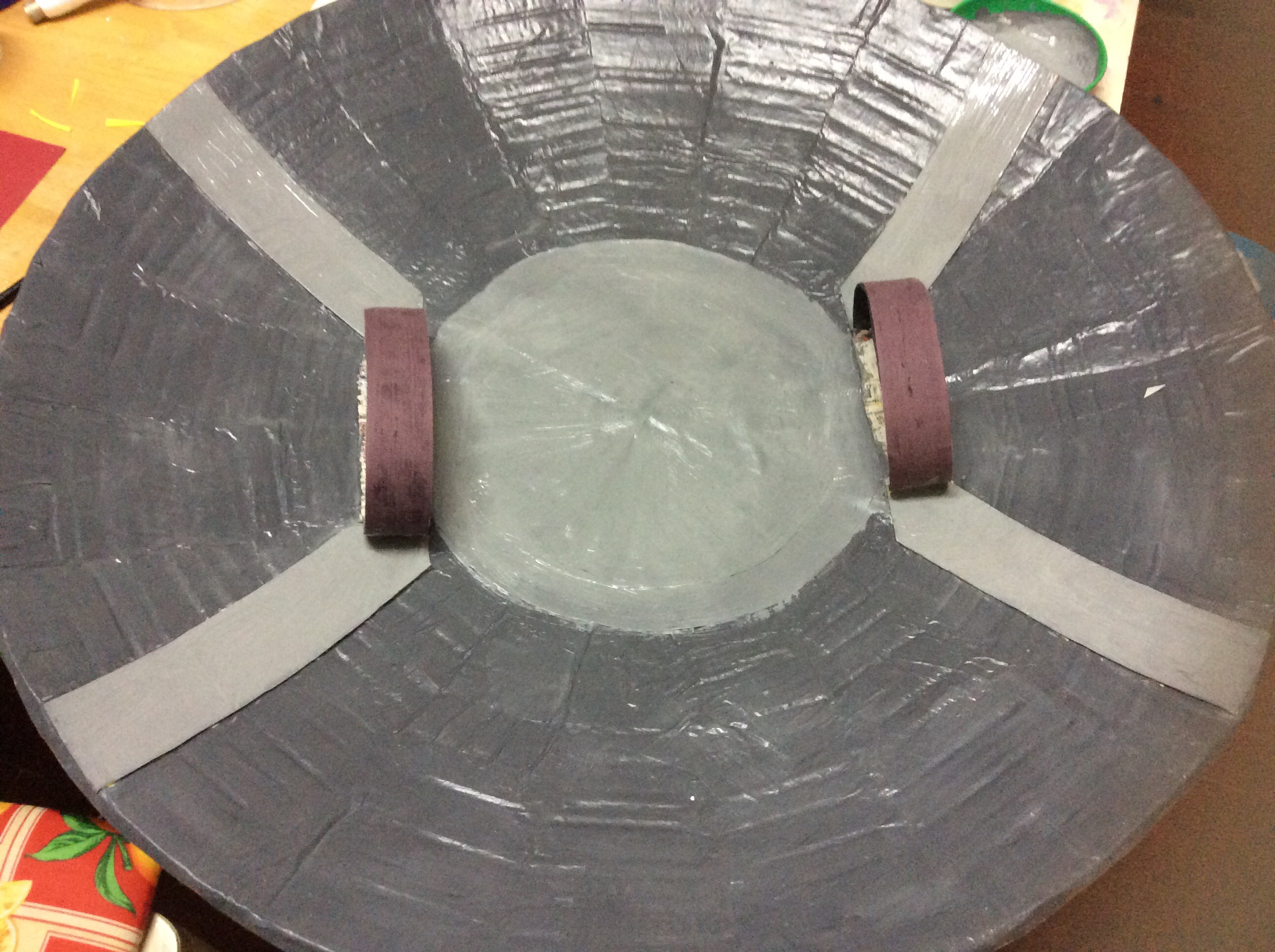

Then I started doing the back

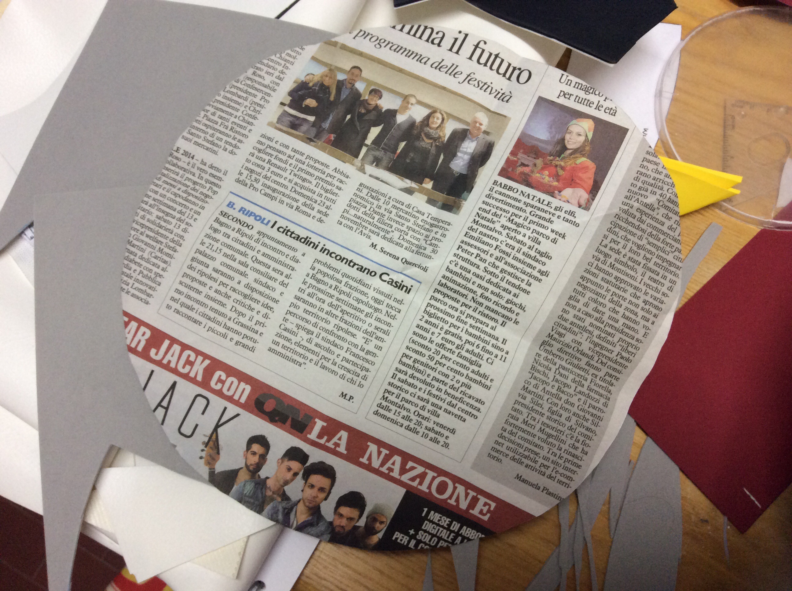

after cutting the two main discs to attach them to the back I used some newspaper discs
Then I made the things near the central disc with foam, and voilaaaa
It's all for now, but I think I'll update soon, so stay tuned!

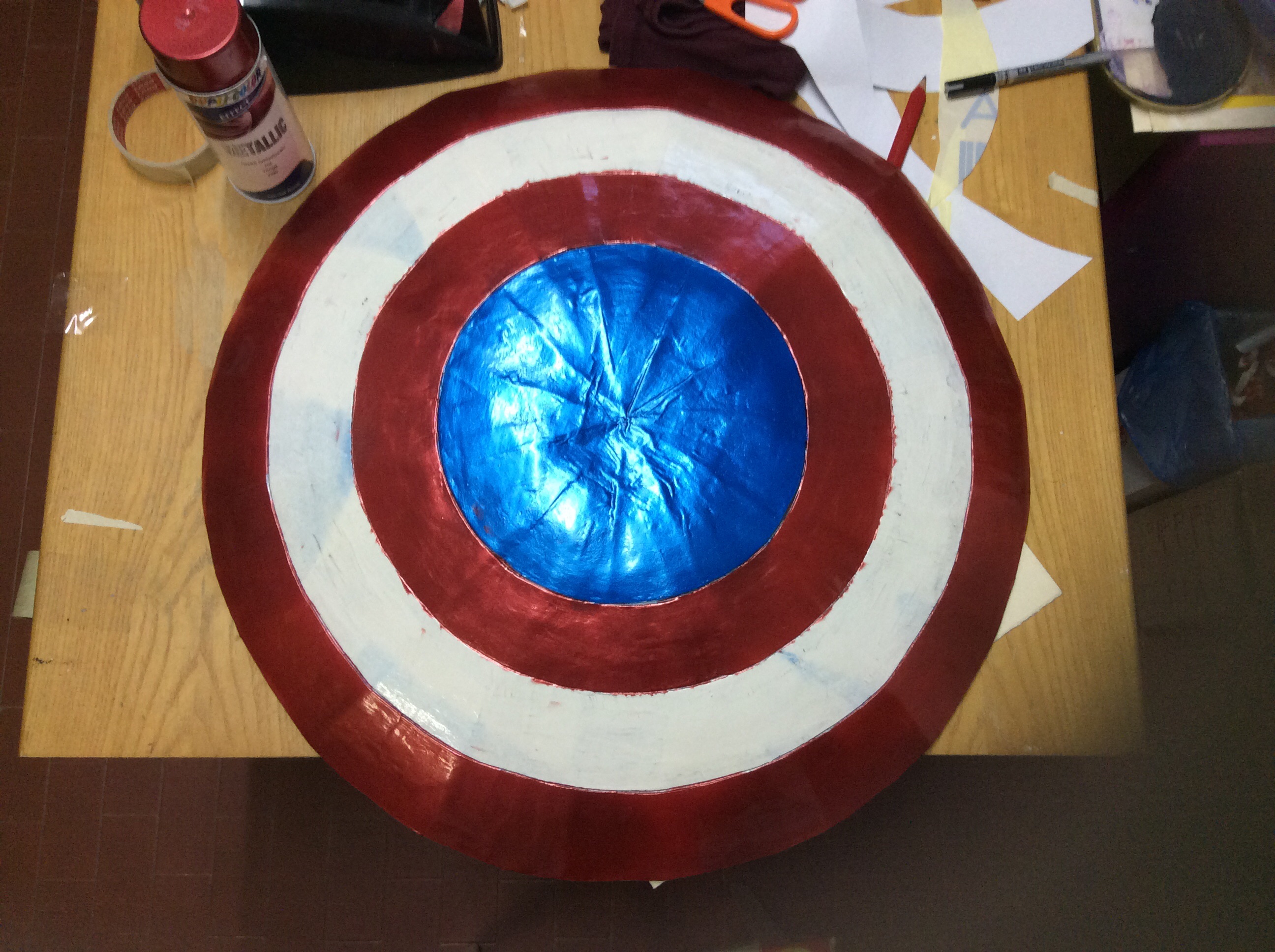

Well... In the end I didn't update as soon as I thought, sorry, but here's what I did until now

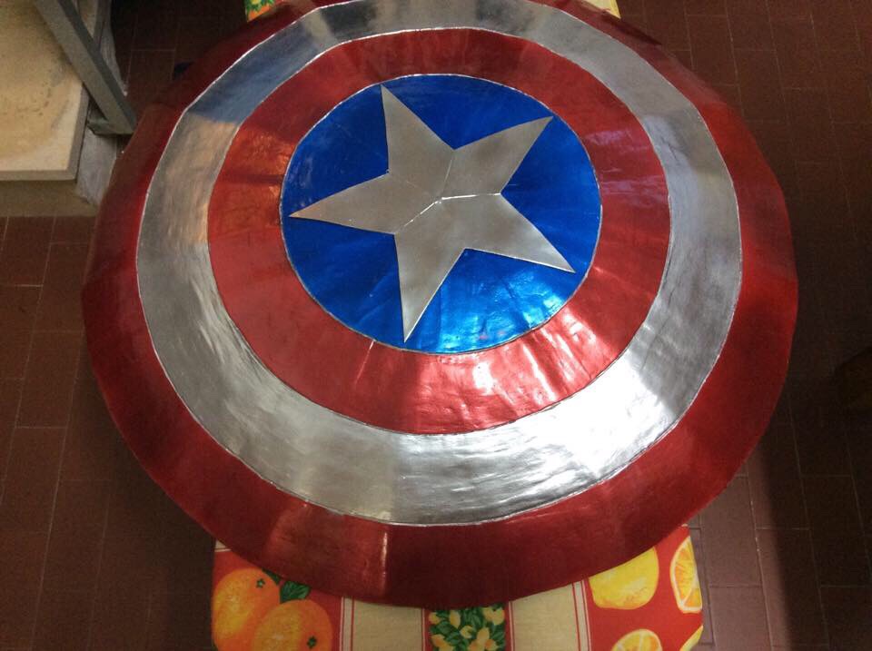

i started by coloring the back, with paint mixed with glue

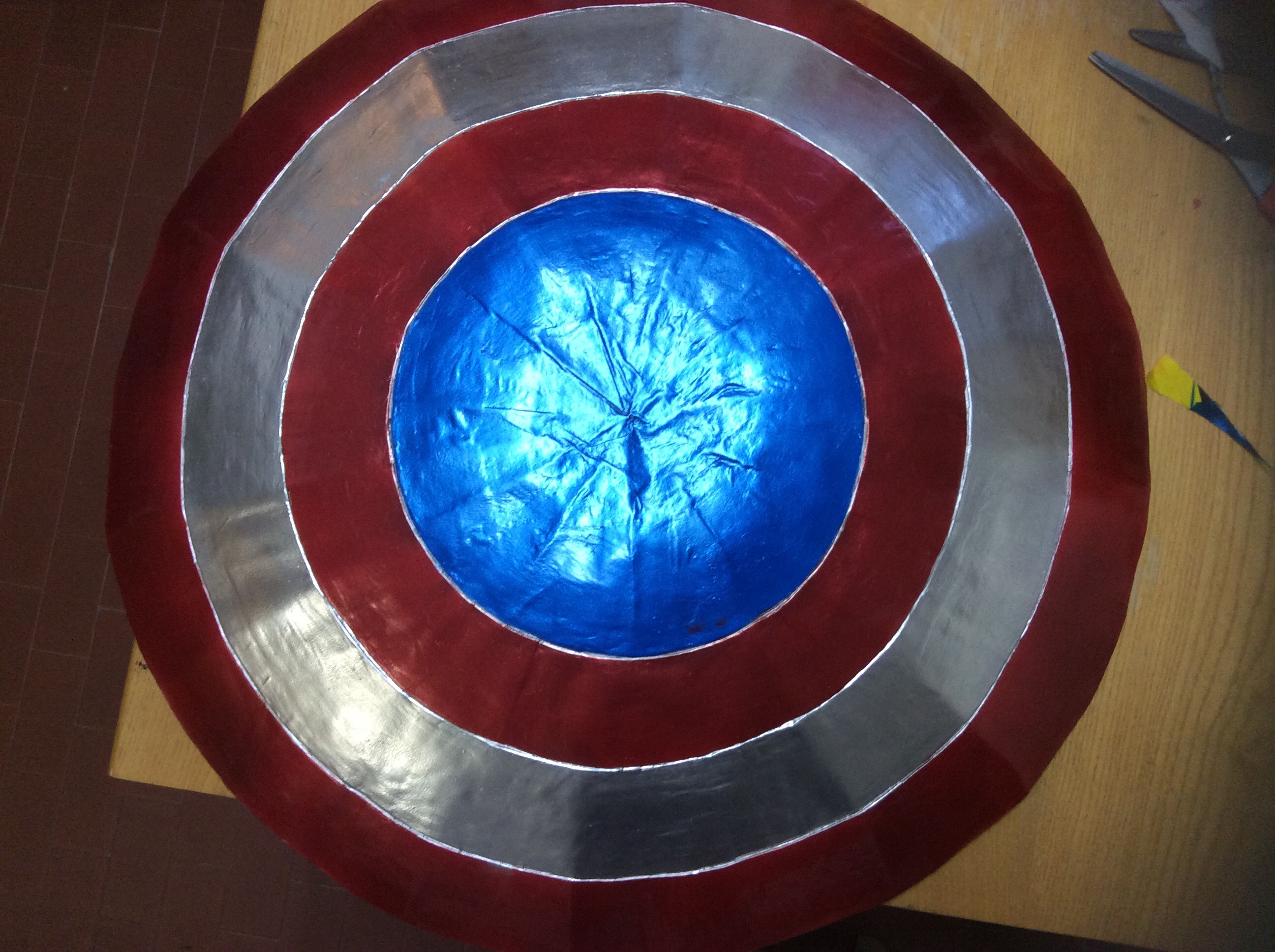

Then I started spraying the front, it wasn't easy..
And here it is!!! Finished!

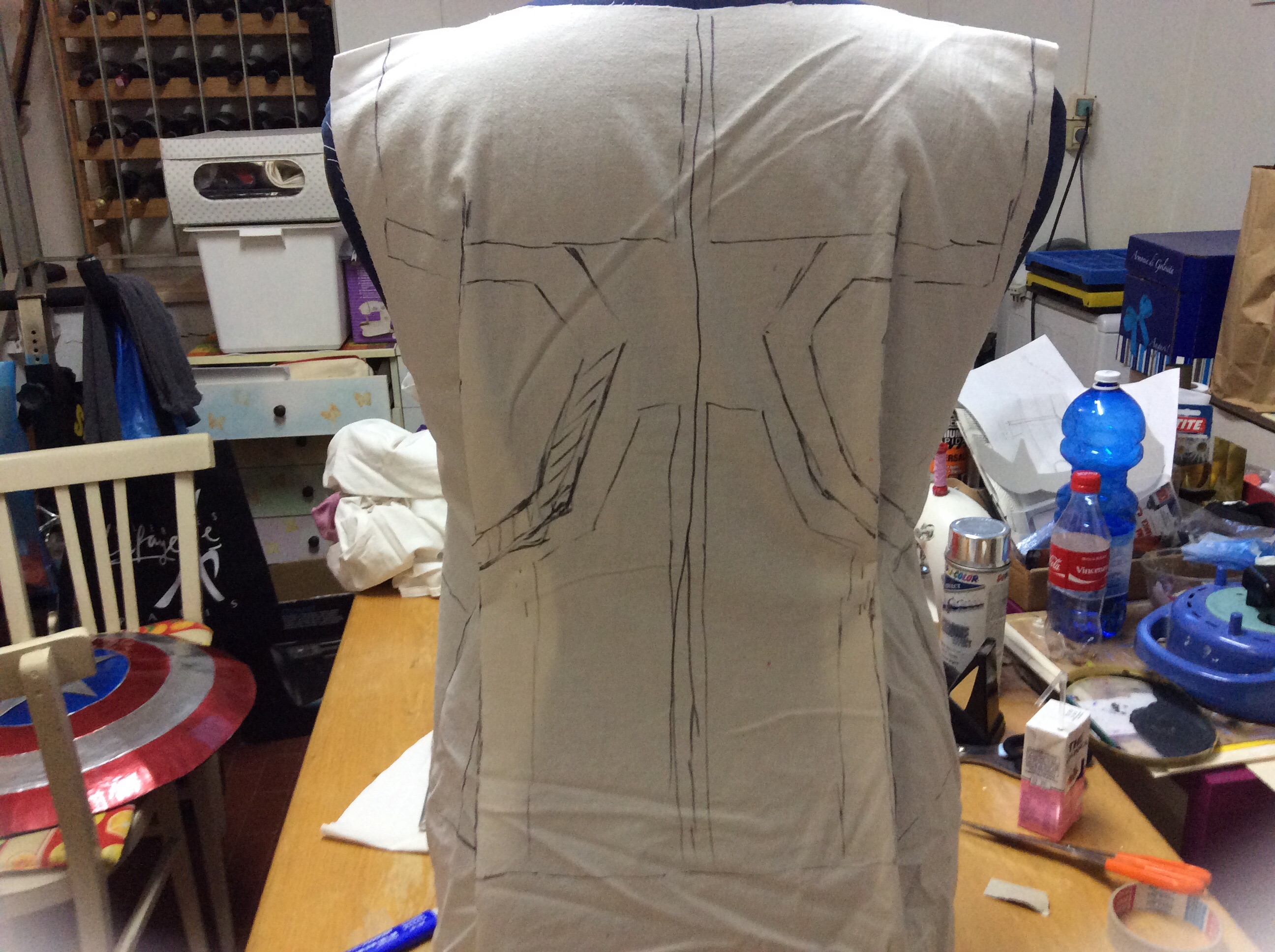

i made a simple shirt with bed sheet, since I didn't want to waste good fabric
and on that I draw the things that I'll need to sew on it
Done that I discovered that I'm a total failure at sewing... But with some magic I managed to make a shirt out of that cursed fabric!
image.jpg <--- yes, that blue thing

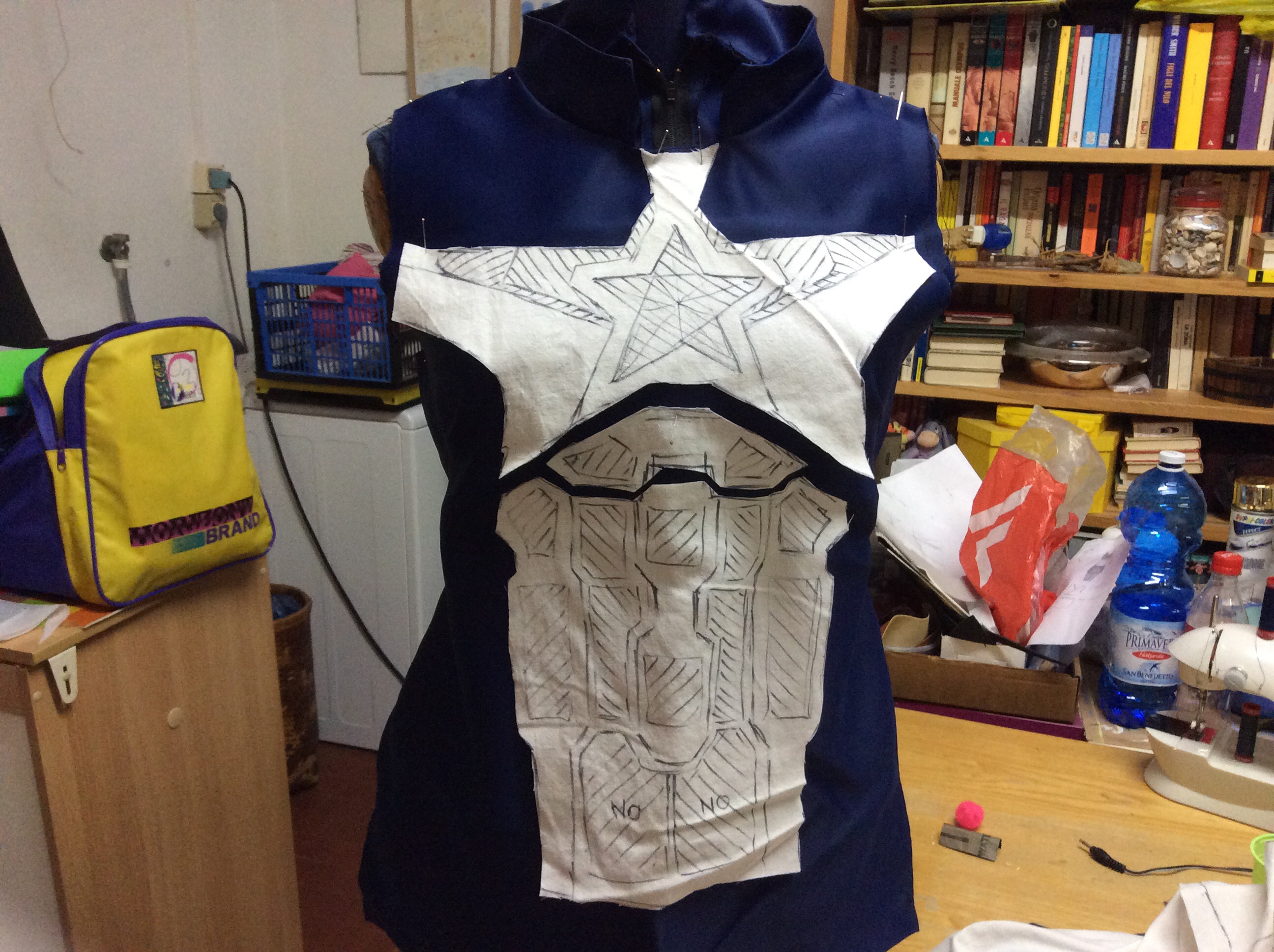

then I hanged it on a lay figure with some needles since is too small to fit, then, I cut some pieces from the white shirt and voila! Now I'll have to make this pieces with the right fabric and sew them on... And I have to do the sleeve too XD
