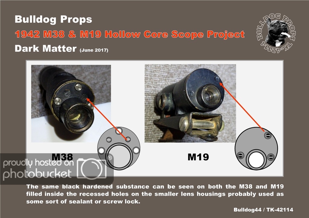

Just thought to post this and hear thoughts on why this black stuff was used or maybe it is just dirt build up. Seems to me like a sealant or screw lock to prevent tampering.
For finishing the scope kit, this may be one way to detail the scope but I want to make sure this actually the case with other original scopes. Any thoughts?
It´s present on pretty much all scopes, that have not been disassembled at a time...and yes, the substances purpose is to act as a sealant IMHO
Thanks Markus for your help. I am starting to assemble some scopes from my castings that did not qualify for my kit parts and started to think that if the originals had the sealant then replicas would be more accurate copying that. I was seriously going to have custom slotted pegs made like the M38 hasty at sit behind the two holes but if those two holes are more accurate sealed up then why bother.

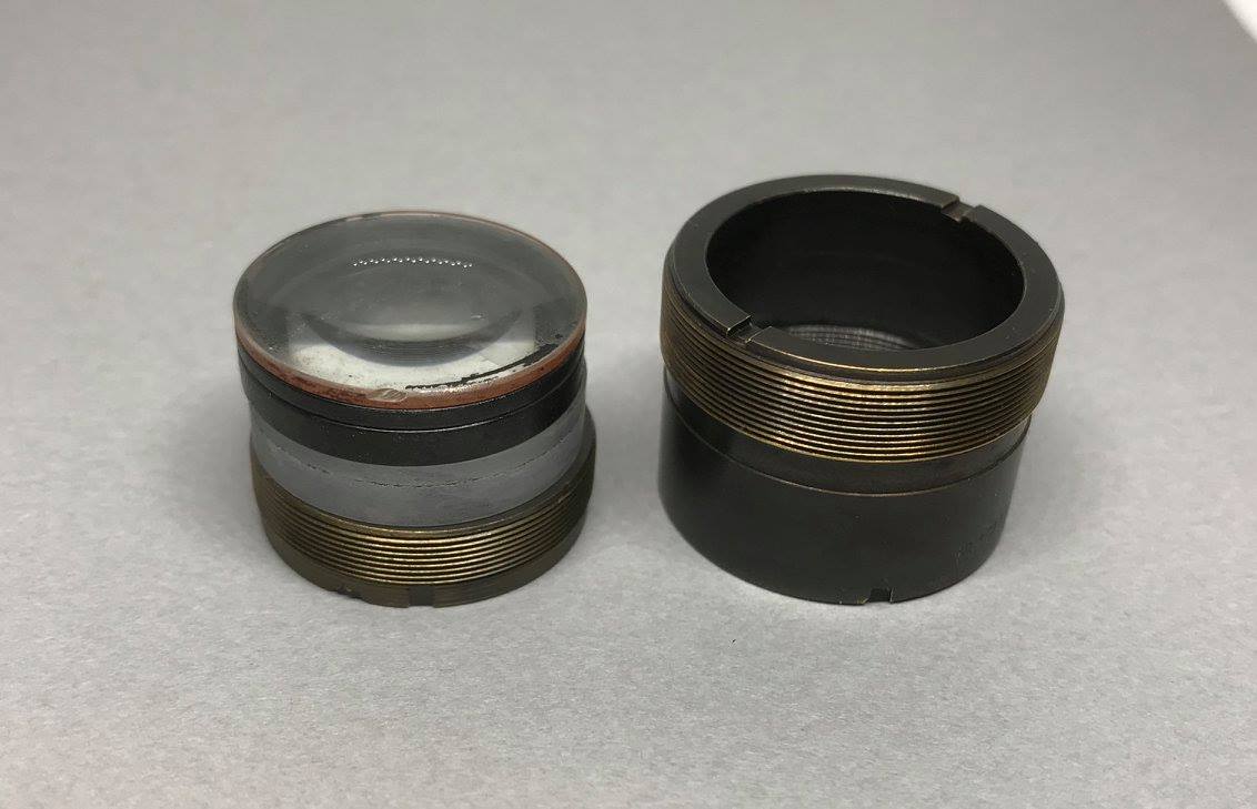

I was able to remove the two central reticle assemblies from the M38 & M19 scopes and fully disassemble them. Now both scopes can be molded down to every part.and a central reticle can be installed just like the originals have. This was a bit risky but i managed to get them apart without serious damage, a few scrapes here and there that is all. Taking these apart will make it more accurate especially for the M19 as there is a thin slit on the side of the reticle assembly where light passes through from the light port focal bulb. Its pretty hard to make this 100% accurate but at least its one step closer than before. I am trying to source some flat glass reticles that match the size for each scope but its not easy unless I spend lots having them custom made. Ebay sells 3mm thick acrylic disks that are okay but still 1mm too thick. Going to have to order some and try for now.
Once I get more silicone, I will re mold the M38 and make an extra M19 mold as well. Updates on that when I get supplies in hand and make time for it. In the meantime I am starting to piece together scopes from parts that do not make the cut for my kits. They are pretty much fine but the inner surfaces are riddled with air pockets. Just going to assemble them, paint them up and offer them if they look good. These will not have all the inner parts or screws, just the lenses and 3 outer slotted screws on the M38 . For the M19 I may just fill in the screw holes with a filler like the original scopes had. :)
