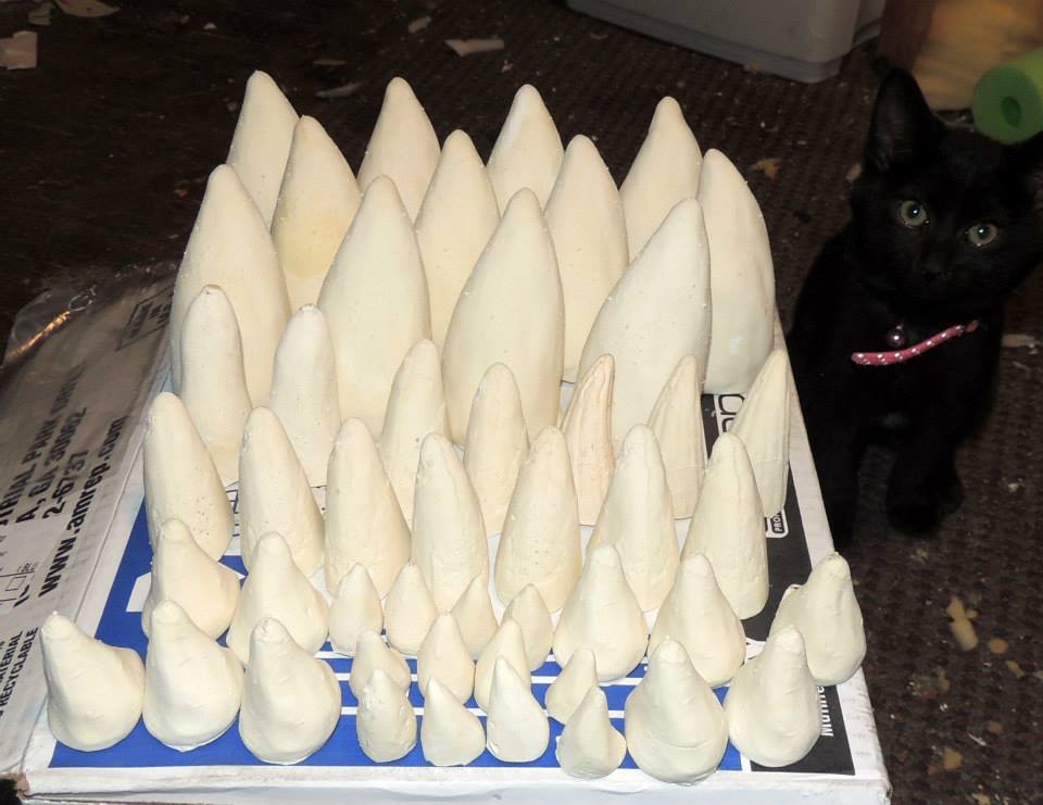

Next I decided on trying an updated Mugato - that white ape with spikes from TOS Star Trek? I sdulpted, molded and cast the face in foam latex; sculpted, molded and cast horns in liquid latex; and made some arm extensions with cable operated fingers.

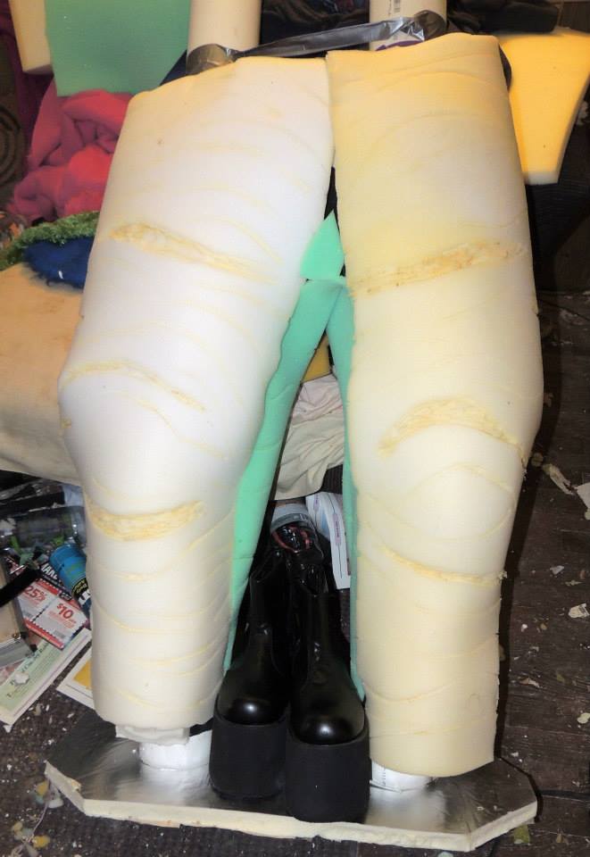

10/28/14 - I started bottom up. So I first built a PVC structure to support a pair of scrubs. Then added foam. I took a soldering iron and burned in creases and folds.

I temporarily glued some horns on it to give an idea of the look. eventually I will contact cement them on then add the latex, which should make them permanent. But so you and I both have an idea where I'm going...
