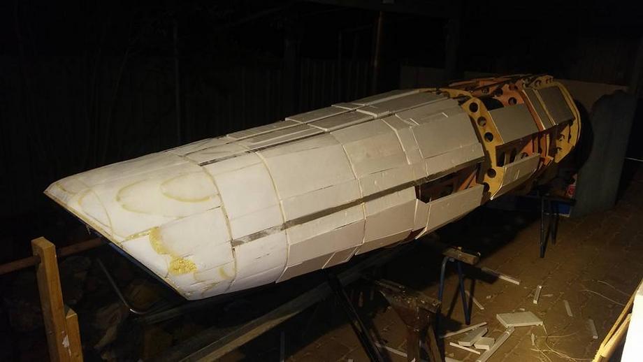

Finished up on the stringers on module 2 at the back. Bolted in a top reinforcing longeron on module 2, some strengthening brackets on module 1. Happy that module 1 is going to support itself on the end of module 2, so it's now onto skinning it with some foam and beginning to sculpt.

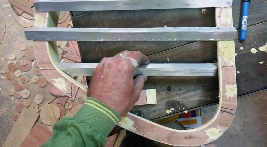

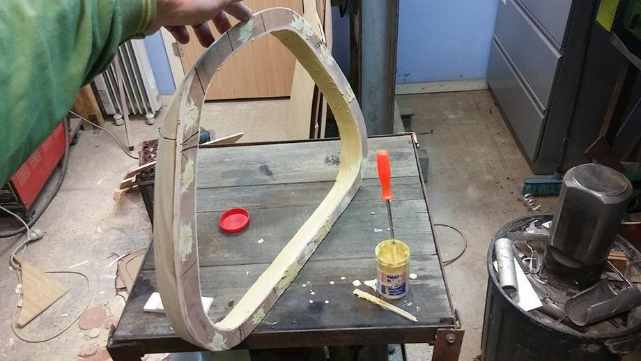

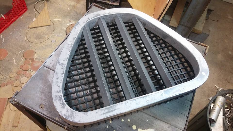

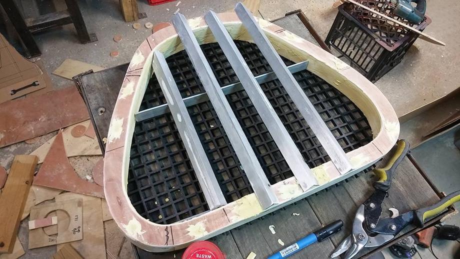

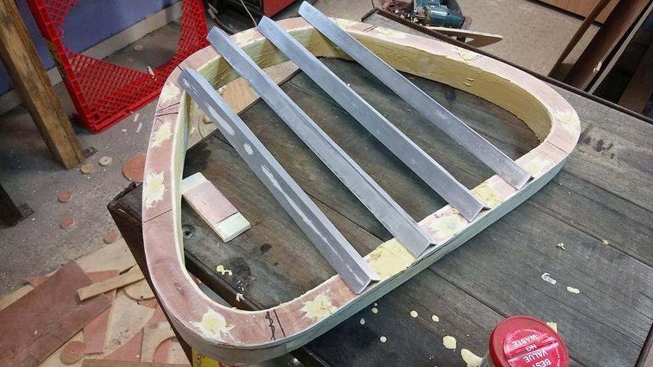

I've now started cutting the formers for the cockpit. Looks like I'll be welding a steel box-frame inside to support the weight of the cockpit, occupant and to hang the nose from the front firewall. I also finished the nose intake grill.

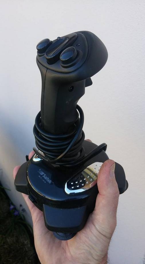

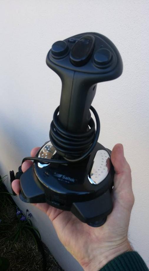

Meanwhile, the centre joystick arrived. It's pretty ballsy, a lot bigger than I thought it would be. Doesn't feel like a toy.
