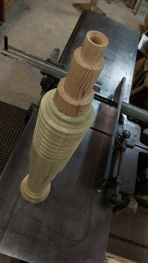

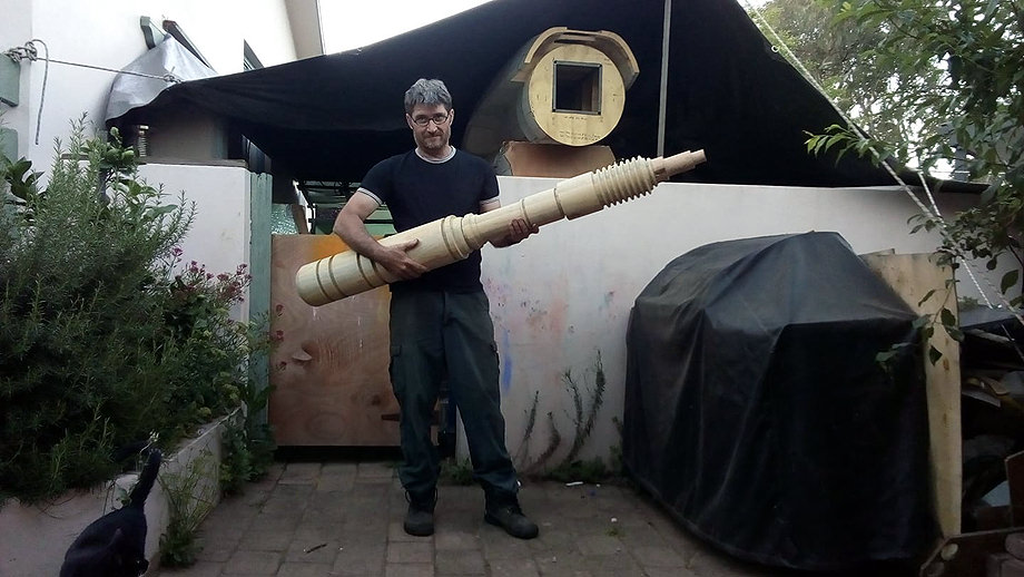

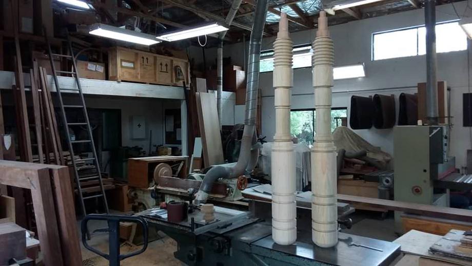

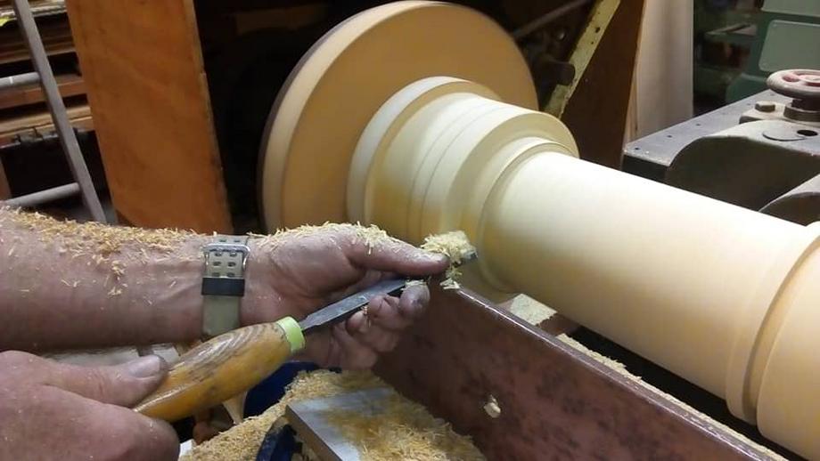

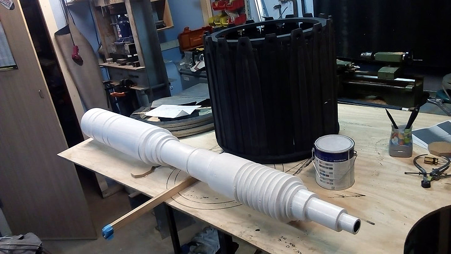

Front half of first mass accelerator cannon turned to size and sanded silky smooth!
I wonder if you could put a steel cup on the interior of the barrel like a liner, then set some small fireworks in it and light them off to simulate gunfire.

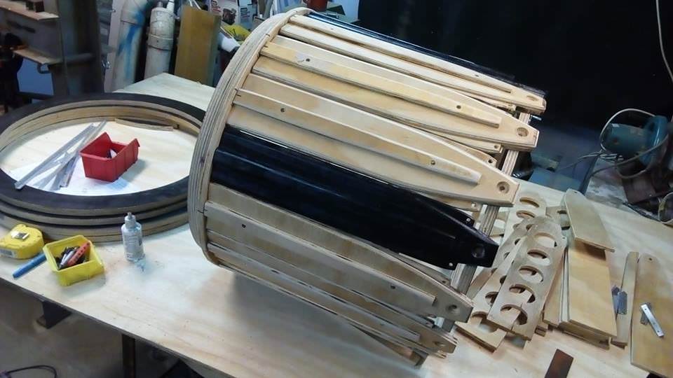

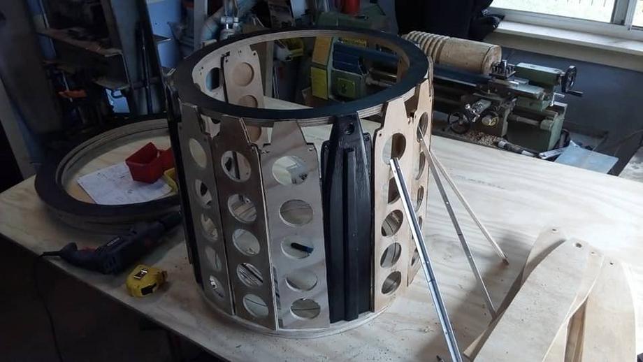

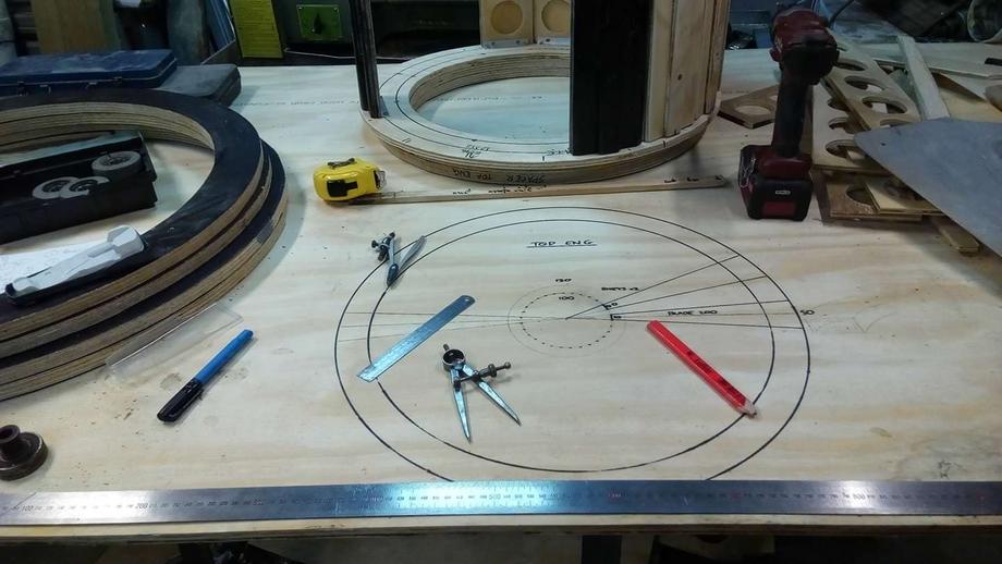

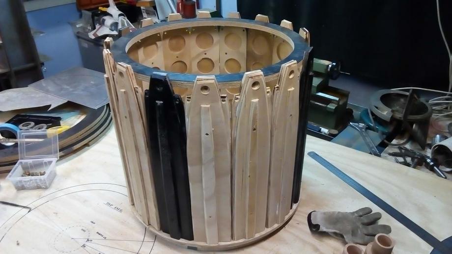

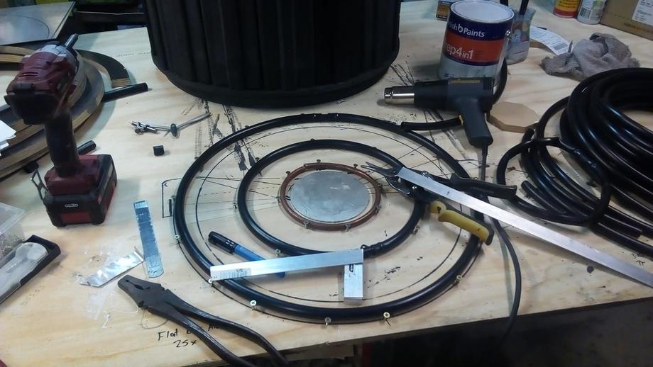

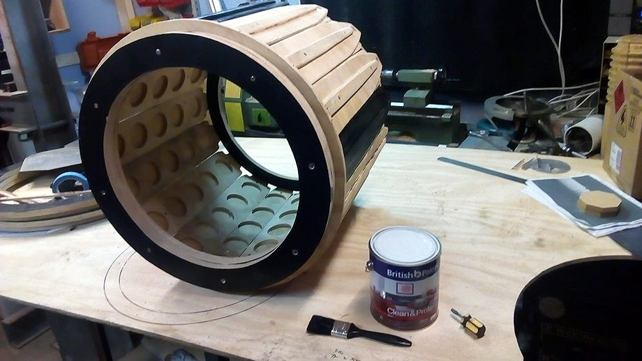

I've been working on concurrent activities all over the ship, but while some things are on hold, waiting for the right moment/planets to align,. my workbench at home has the engine exhausts on the go.

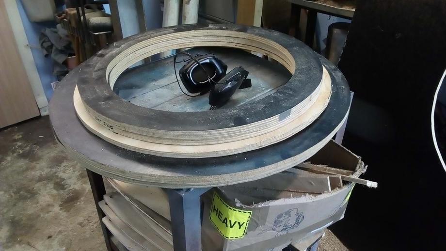

I toyed with roll-forming steel rings to make a cage, but the hollow section profiles proved problematic at best, so I have gone back to wood.
Here's the top engine exhaust under construction.
Today was a good mix of the engine work and a little trip out to Myles' place to finish turning the cannons. I brought the barrel ends home tonight with a couple of borers, to drill them out to 30mm as per the ammunition calibre.

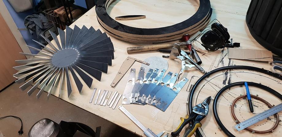

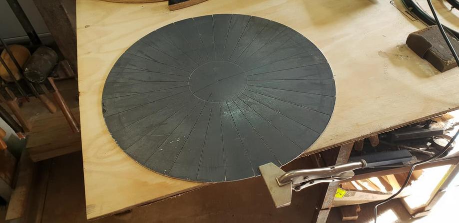

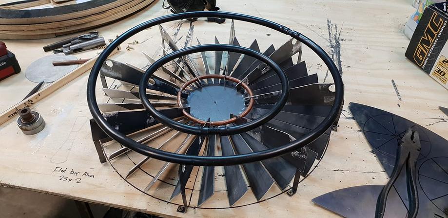

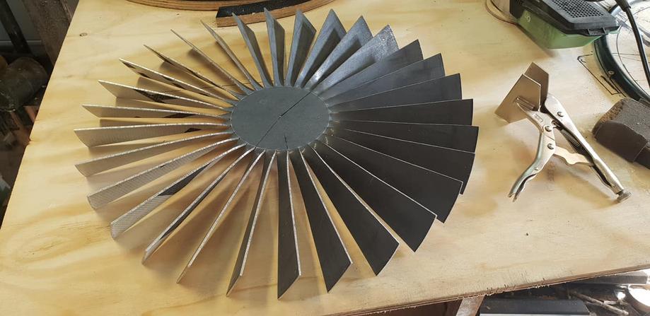

Back in the shed tonight and continued on the engine turkey feathers, than a bit of sheetmetal cutting to make the turbine fans.

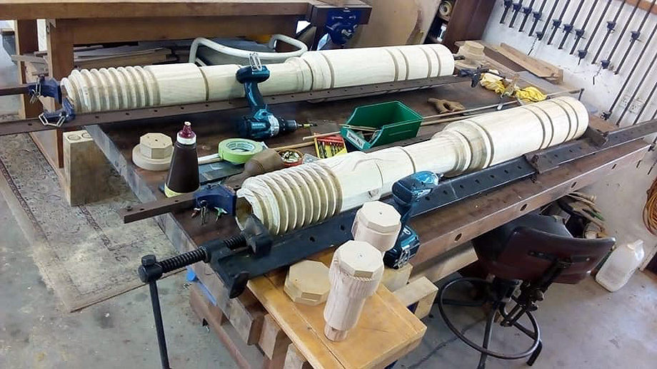

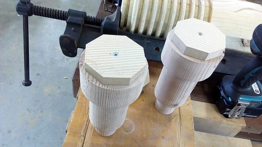

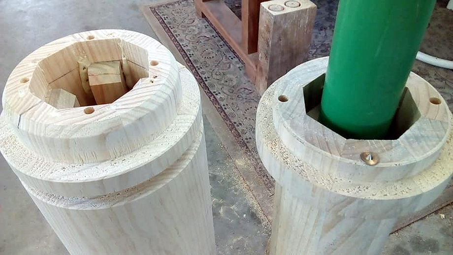

After work this afternoon, I returned to Myles’s workshop to finish gluing up the cannons. Myles had a few nice little tips and tricks that made things go smoother, plus because of his earlier precision, I was able to use the octagonal arbours we made to fill the end of the guns and centre and seat the barrel. Not shown, I dowelled the octagons and removed the screw. Myles suggested that I might want to bore the barrel end out later and the screw would get in the way. I agreed.

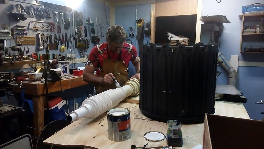

I spent all my earnings from a recent knife sale and bought paint and glue for the next few stages. Last night I stayed up until well after midnight to paint an engine exhaust and one of the guns.

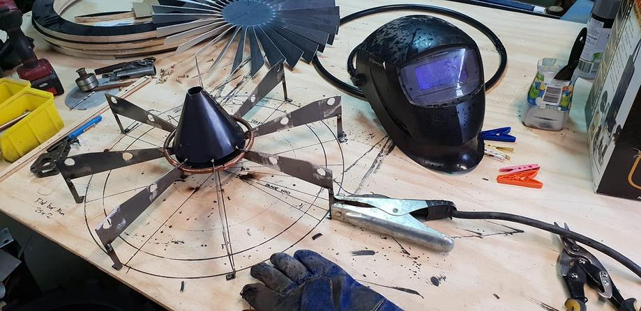

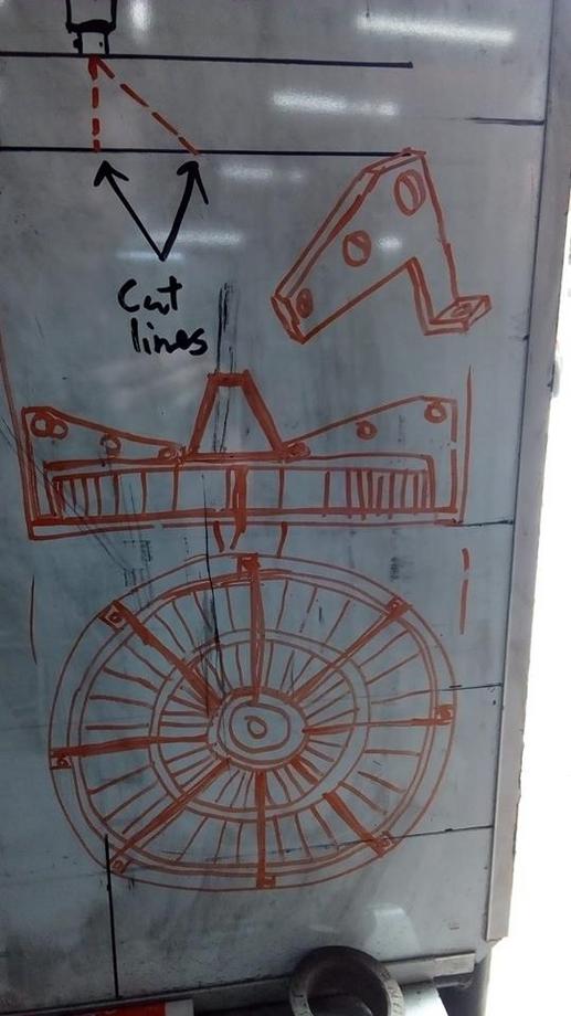

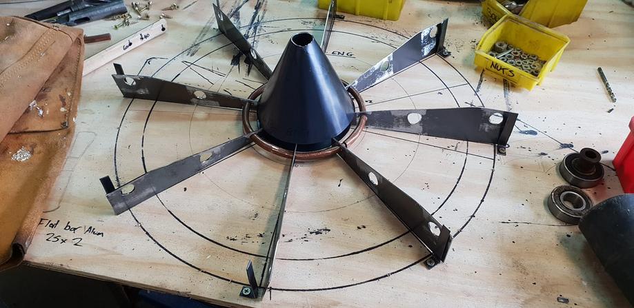

Scratch-designing my turbines at the rear. I know I am taking a lot of licence inside these engines, especially after being so careful to stay faithful everywhere else... but something the X-Wing fighter on display last year, at the Tuggeranong Hyperdome showed me - is that some static displays suck.
Sure it LOOKED similar to the fighter from the movies, but close inspection revealed it to be flat, static, flimsy, rough molded and BORING. My engines will be multi layered, have depth and moving parts. Light, sound and motion.
Bear with me...
I have used a combination of lightweight and easy to source materials, sacrificing a little bit of weight for weldablility, as I can't weld aluminium to save my life, so I've used steel.
This last one has everything just sitting on top at the moment. Once assembled, it will be lower profile.
Wow! The level of detail on this thing is unbelievable. It looks so real people are going to ask to go for a ride in it.
oh those look GOOD! might want to redo the front facing compressor blades in steel too (unless you already have and i missed it) so they match
