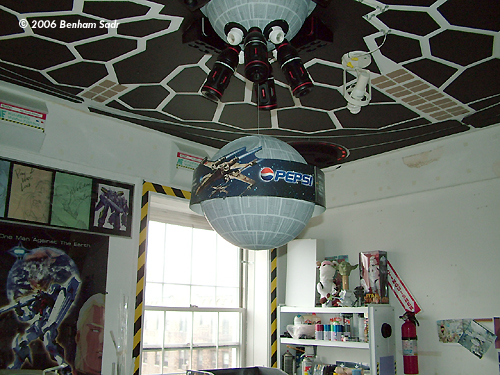

Really enjoying this thread..makes me want to pull apart my old Pepsi DS & rebuild it..
You know, once you're done with this, you'll have to do the 'cutaway view' :lol
It's just a 2 part styrene display model like the one in this pic:
http://www.starshipmodeler.com/starwars/bs_cooler_DeathStar.jpg
I got it from a friend whose dad managed a grocery store..It's hardly accurate, but it does still have the motor that turns it! I always wanted to put fiber optics in it..
Question for you.. could you use those smaller CF lights in your dome for temp. control? or do you have to use incandesents for enough light output?
Cool! I've never seen that display before!
