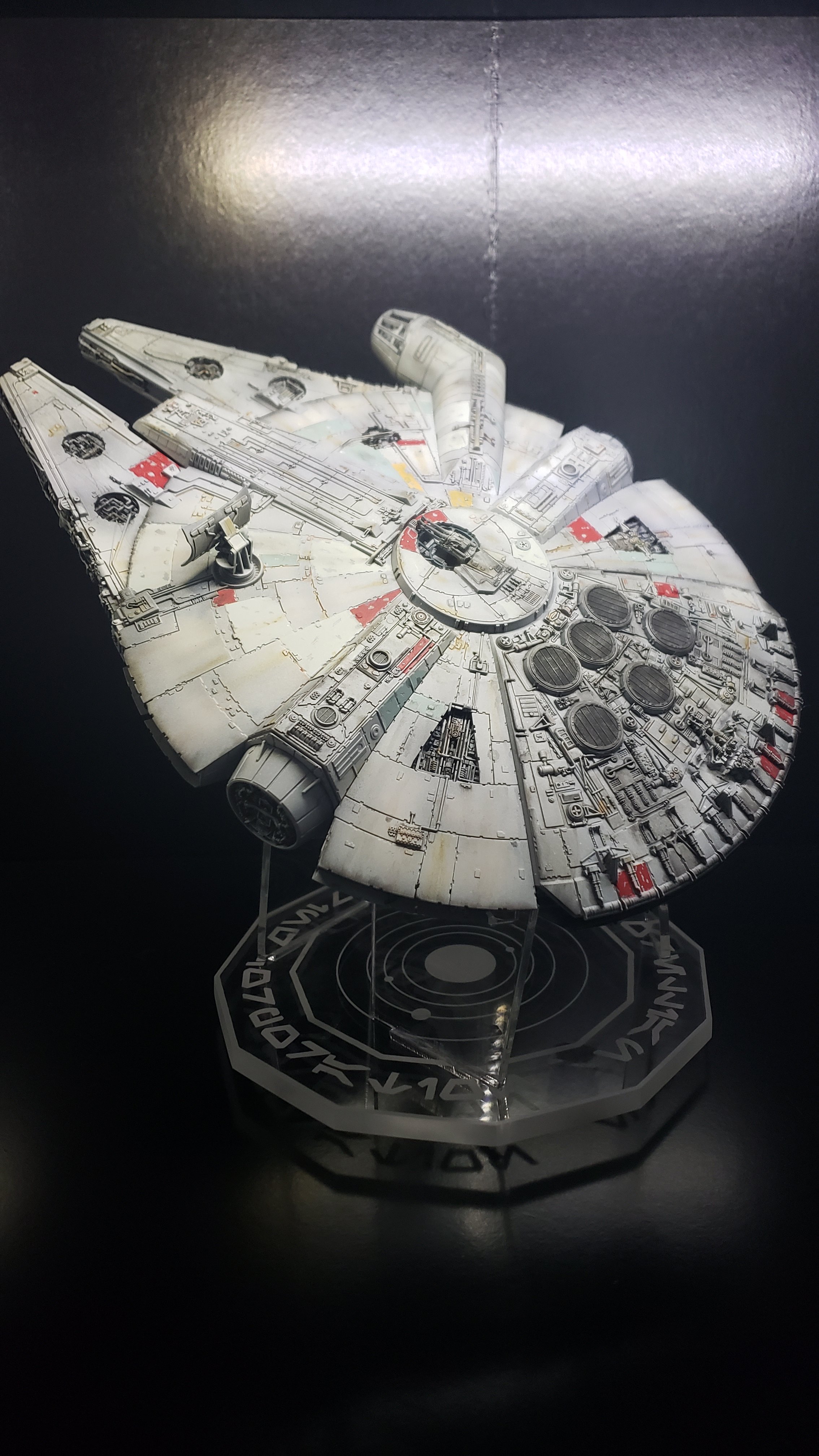

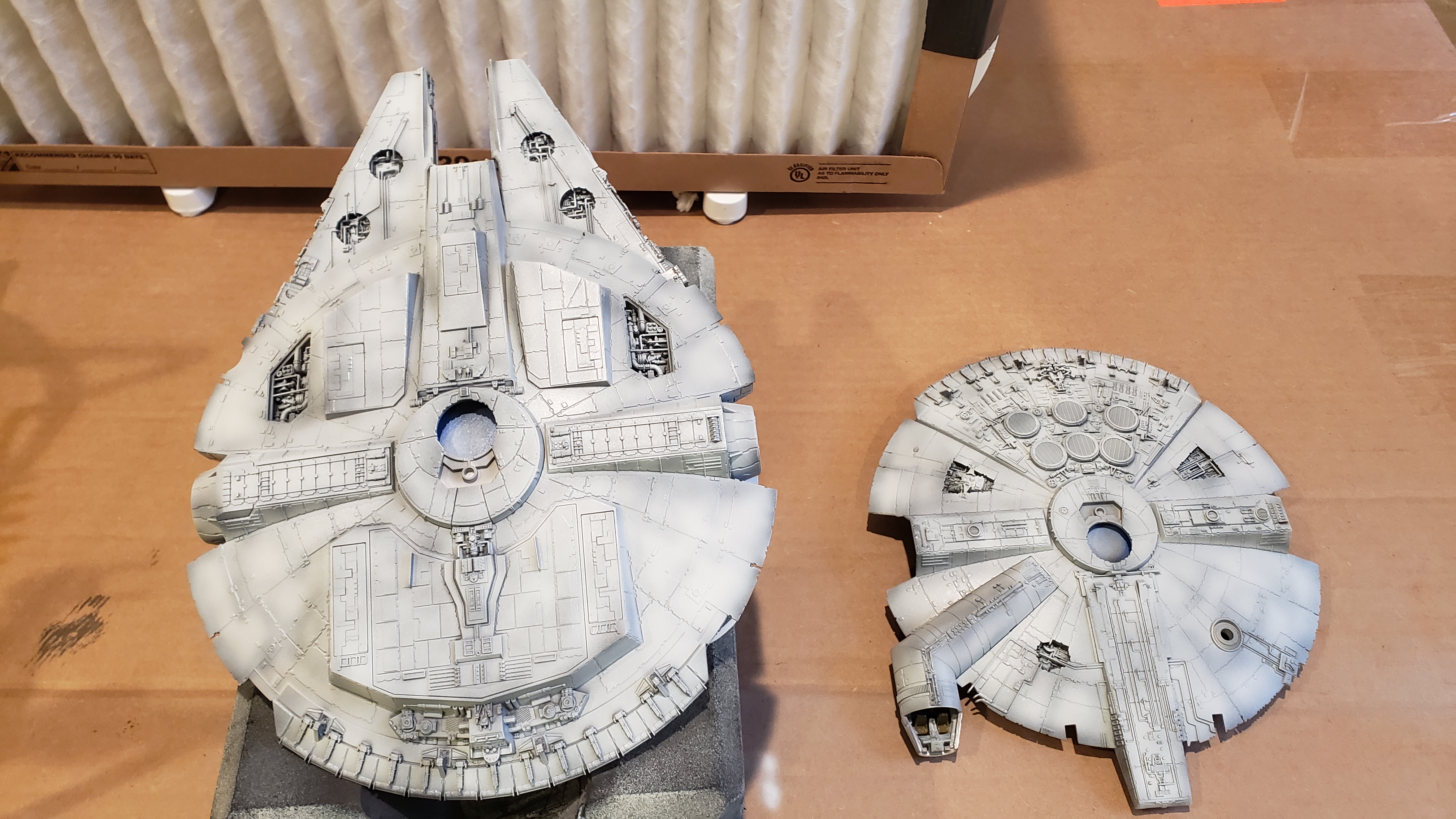

Once assembled, here is the basic process I followed:
Primed with Tamiya Fine Surface Primer
Used Tamiya XF-1 black to pre-shade (I think in the 1/72 I will individually shade the panels, but at this scale, this method worked for me)
Once that was dry I used a combination of XF-2, XF-55 and a touch of XF-53 for the base color. I have only used an airbrush a hand full of times, so I am still getting the hang of it.
Once I let the base coat dry for a few days, I hit it with a few light coats of Tamiya TS-13 in preparation for adding the decals. When I get to this stage on the 1/72 build, I will paint all the panels instead of the decals, but at this scale, for me, the decals seemed the way to go.
I used a liberal amount of Microsol and Microset to get the decals worked into the details. I never actually used this product before, it's pretty amazing and seemed to work really well.
Once all the decals were applied I proceded to 'chip' them a bit with a razor blade, which I think worked pretty well.
Once everything was done, I put a few more coats of the TS-13 clear to seal in all the decals. This is something I have done on previous builds and seemed to really help when it came time to weathering.

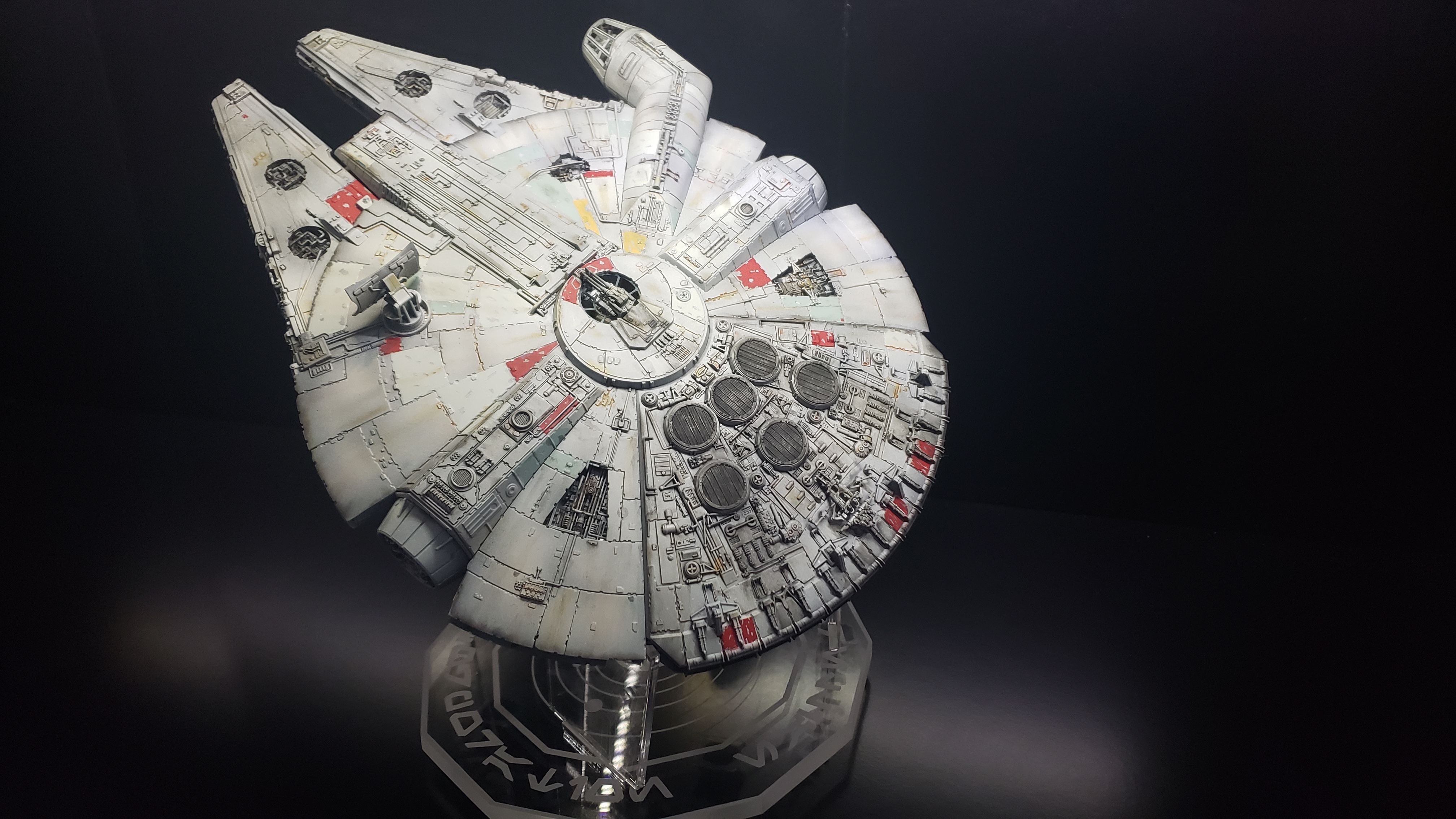

With the shading done, base coat on and the decals applied, it's time for weathering. Weathering has become my favorite part of building these models! I used to be afraid to paint them, now it's my favorite part of the process. The level of satisfaction you get from the finished product is tough to beat!
I used a combination of some of the basics to get my desired effect, Vallejo washes, various oil colors from Abteilung (these are my new favorite paints) and finished it off with some of the Tamiya weathering master kits.
As soon as I posted these pictures, I realized that I had gone way too dark on the engine 'stripes'. In the middle of this post, I broke out the thinners and toned it back, a lot, so I think the final product will look slightly better.
The last part of this build was to do some custom electronics, along with a few photoetched pieces for the interior of the cockpit. I wanted to light up the cockpit and the engines, but I don't want to take the lower cover off every time I want to light it up. If you look closely there is a key fob on the desk next to the shot of the engines. I wired up a wireless remote so that I can turn the Falcon lights on at any time, without taking it apart.
I also ordered a display that I feel works a lot better than the factory stand.
Towards the end of this week, when everything is 100% dried out I will put the two halves together and give it a coat of Dullcote. I will post the final pictures then.
