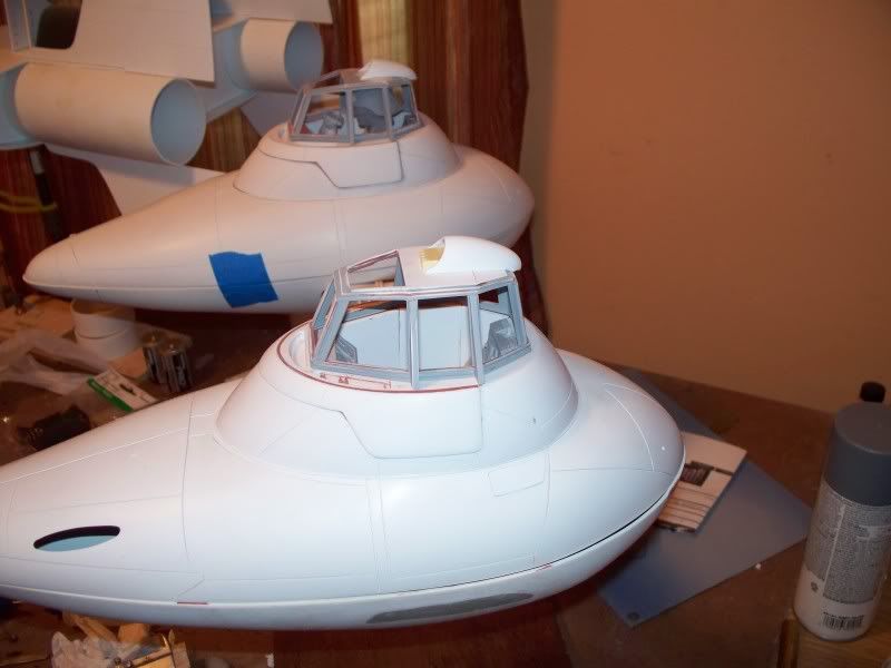

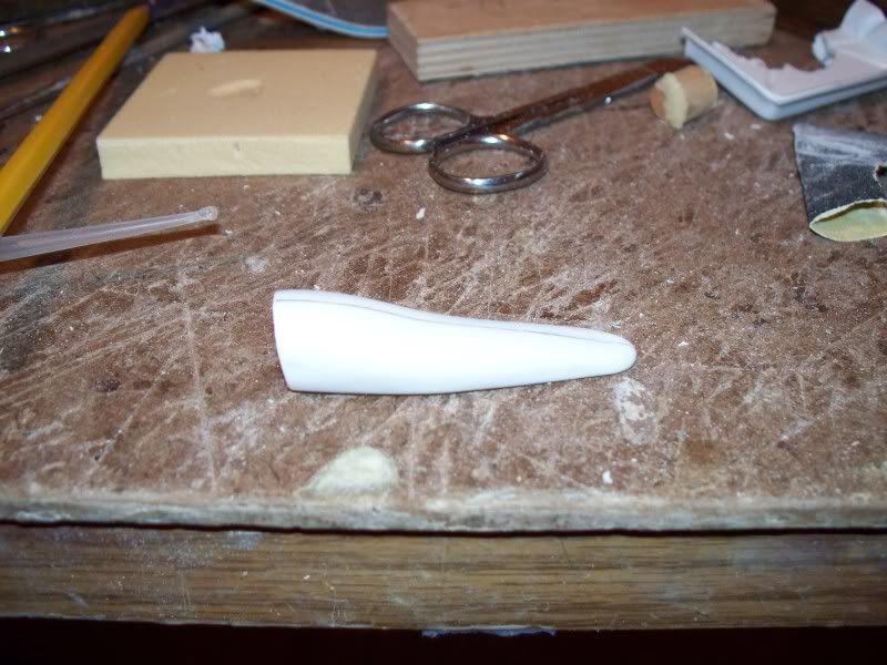

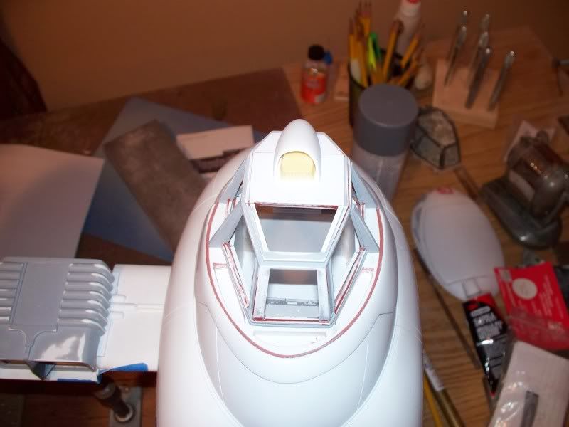

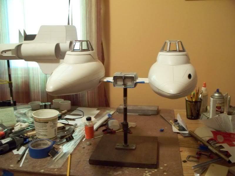

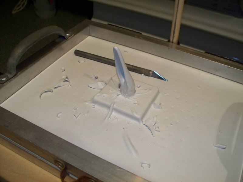

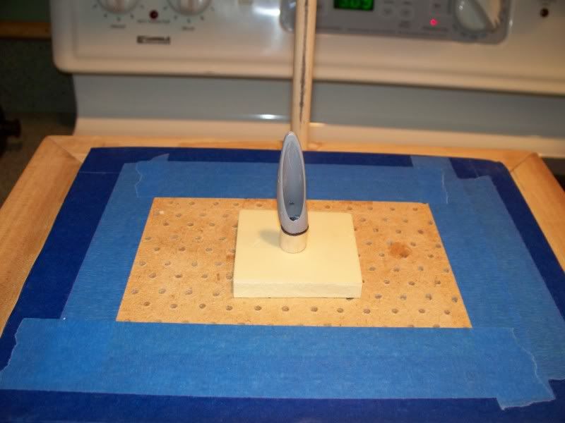

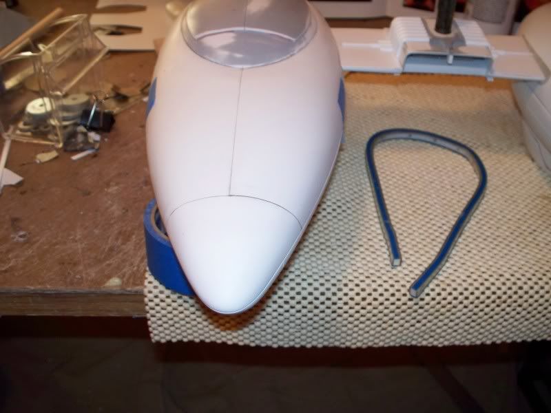

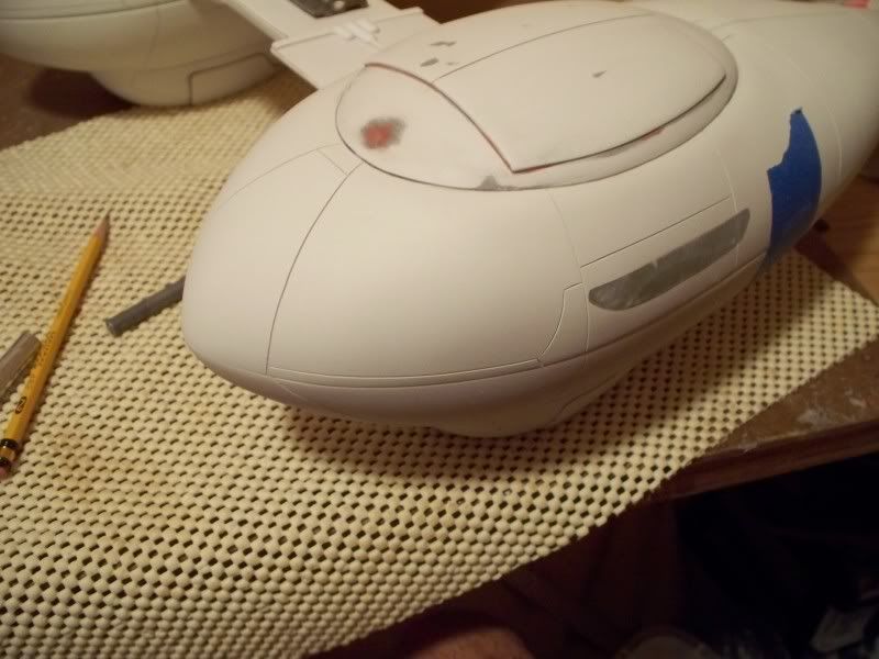

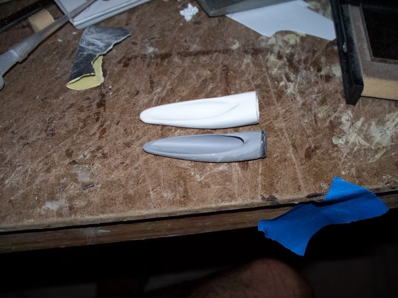

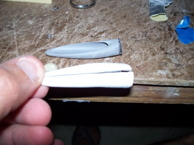

Moved on to forming the bulges that sit on top of the canopy,
and the laser cannon wells.
Looks great! The gun tubes look like they must be difficult to resolve, but you make it look easy. Sorry if I missed it, but are you intending to light this? I'd love to see how you'd go about doing it.

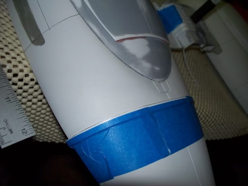

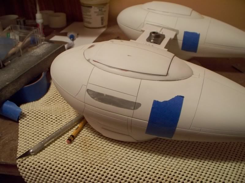

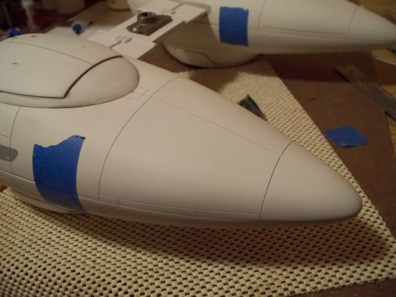

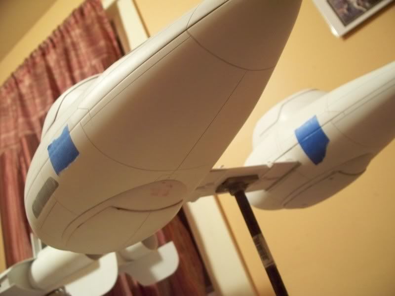

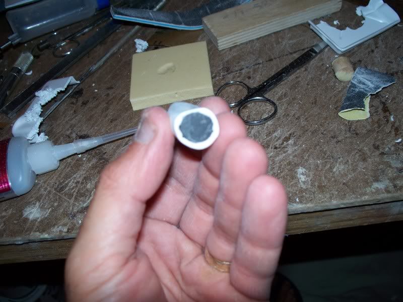

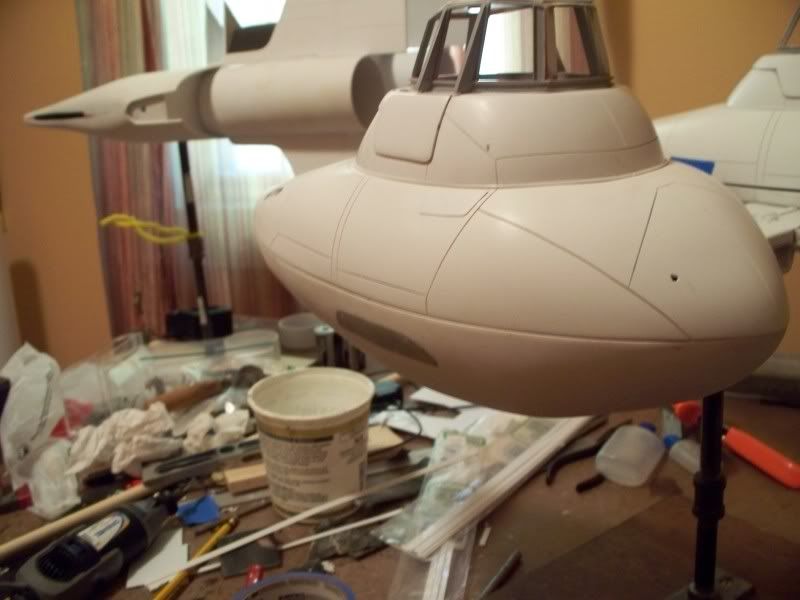

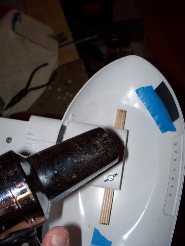

Decided to weld in some strip styrene all the way around the inner wall
of the lower hull, this will allow for better welding of the top and bottom
hulls when the time comes.It basically created a 90deg angle so the top hull
won't slide off during welding, and it gives it another welding surface.The plastic is thick enough with out it at 2mm wide....but better safe than
sorry!:$

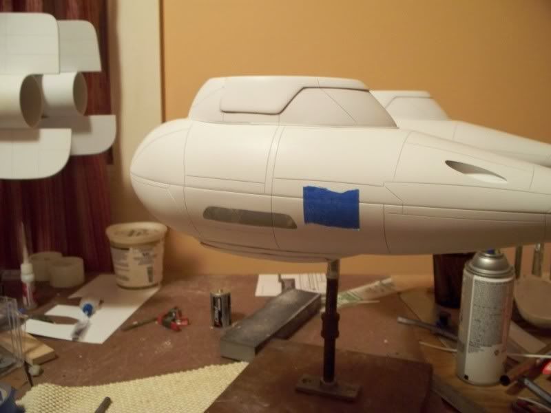

I will get the lower panel lines finished on Monday,
then get started on the lights.Hopefully I can have it lit
Tuesday or Wednesday.

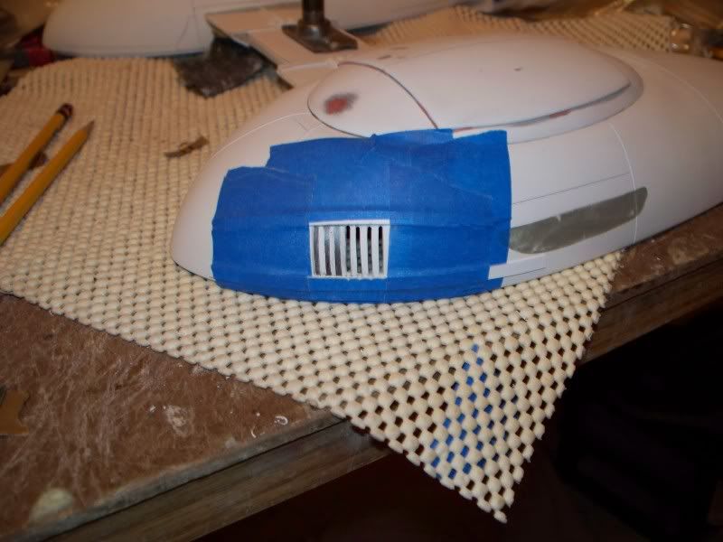

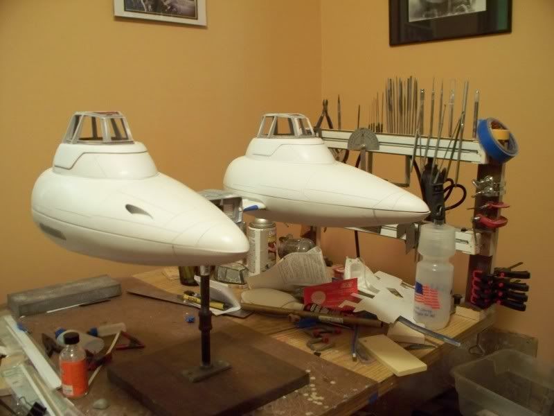

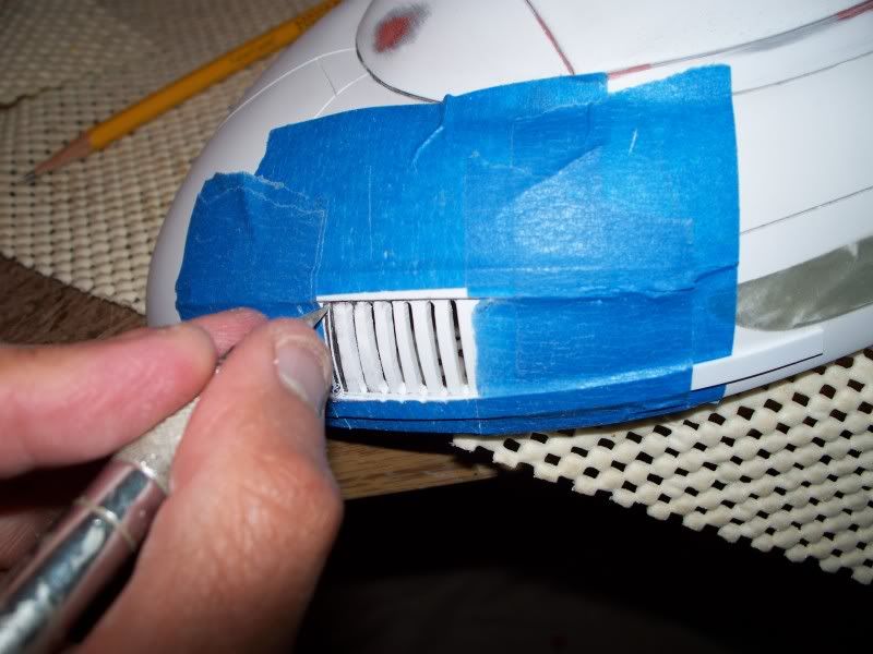

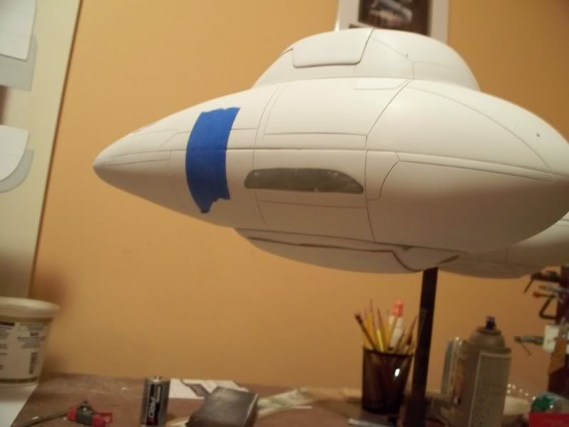

Hear is something that is not easy again!!:lol:thumbsdown

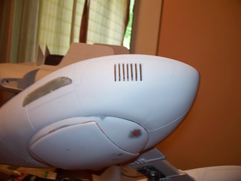

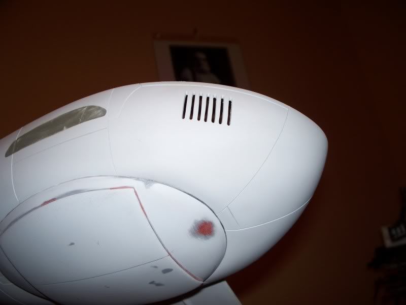

Opening up the vents on the sides of the lower hulls......
%^&$^$#@()_)&*&%#@@!:angry
There is only 2mm of room I am carving into, and the plastic is 3mm
thick so it's a real chore! Don't want to risk it with the trusty dremel!:lol
