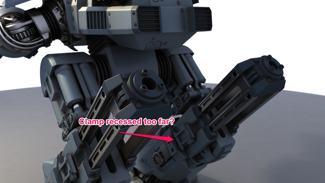

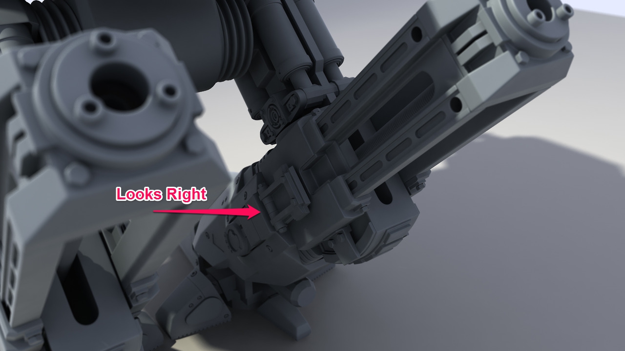

One thing I noticed you have retracted the leg 'clamps' in quite significantly from the earlier renders. This is an area of frustration for Chris (Cheesygrin) and myself, as we're working to the dimensions of the Horizon kit. The earlier renders look more accurate to me. What prompted the change? (Apologies in advance for scribbling on your photo - hope you don't mind.)

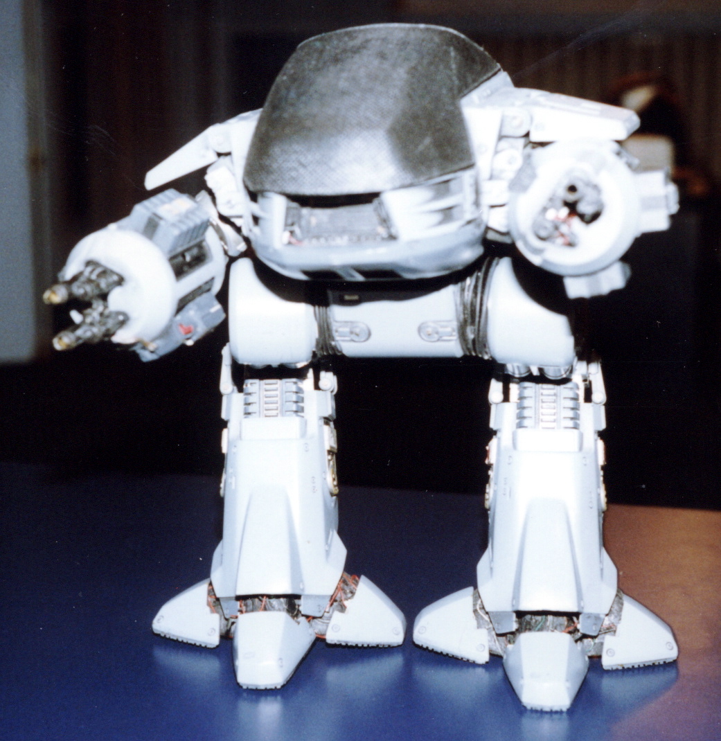

Here's a head on shot of the puppet for comparison.

Awesome work!! One of the best I've seen. Vectorzero commented already but I'll add my $.02:
I agree that your earlier render appears more accurate. The hinge of the foot clamp extends beyond the vertical plane of the leg shroud. I've been mocking up the "H" slider today and have something close to what will be fabricated:
I took some liberties with my design and, like Vectorzero said, it's based on the Horizon kit dimensions.
Ah, good find, thanks! Without actual ed blueprints the proportions were really hard to nail down especially since the movie prop and puppet were fairly different. All the toy models out there were way off so, I decided to not go off those. I had noticed the long metal leg sliders were way too big after I had added a ton of detail so, I had to scale them down. You can see it by comparing the old and new renders. I didn't realize how it affected the clamp position. Consider it fixed!

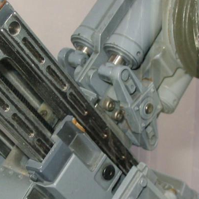

You are entirely correct. The rams are not at all attached. This is a great close up of the filming miniature (Source: Crop of Ed_60.jpg from Robocop Archive via Frank Robbins), where you can see just how cosmetic those rams are. Note that part of the circular base on which the ram assembly slides as well as half the "H Section" which moves up and down the leg rails are missing. If you watch the film carefully more and more parts of ED disappear as it progresses which I presume was the hard life the miniature got, and a lack of budget and time to effect repairs. (Look out for the shrouds between the feet and the toes, as well as the big shock absorbers front and back of the foot.)
