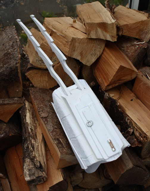

Final sanding done. Gauntlet is what I'm calling finished, onto the bomb gaunt today...

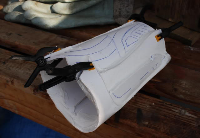

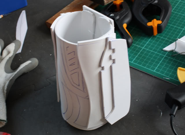

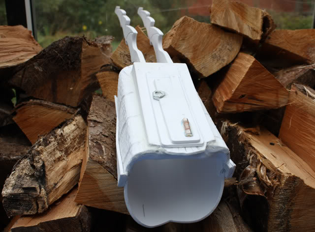

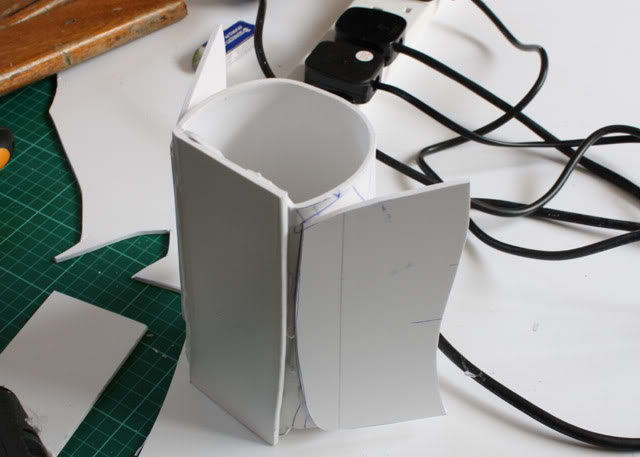

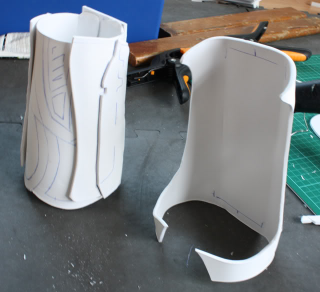

Cheers guys. Got the bomb gaunt started this morning. Used the same former to create the basic arm shape then started eyeballing the various pieces for either side to build it up.

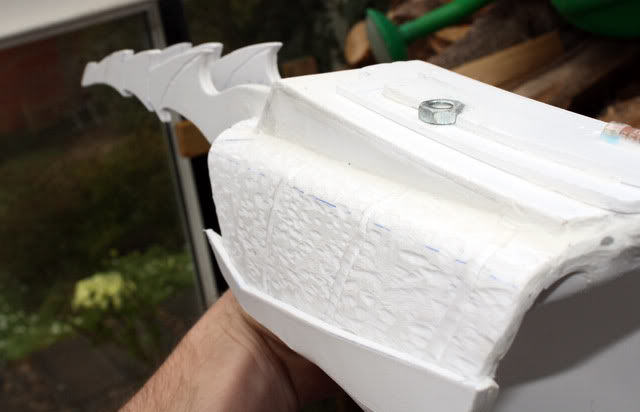

Next taped a sheet of paper to the what I had to mark out a top piece to cover all the edges and give me a smooth base to mount the buttons and dials piece later. Heated it with the heat gun and curved it round the main arm.

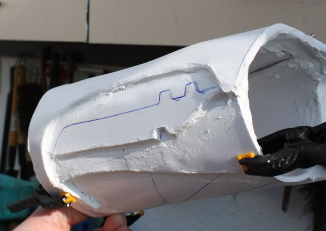

Bought a cheaper version of the No More Nails and what a difference! So much easier to spread and smooth, made filling the gaps a doddle. It's in the greenhouse drying and will need a fair bit of sanding and a little dremel detailon the underside. Not screen accurate by any strecth but a decent homage I think. Possibly get the numbers and dials piece done tomorrow night.

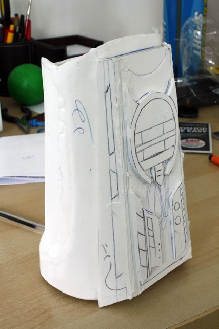

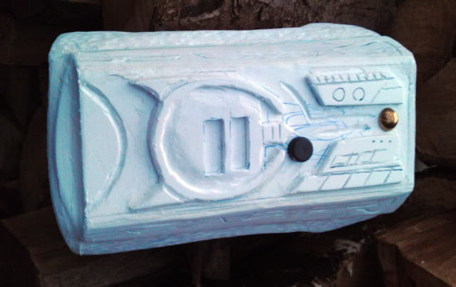

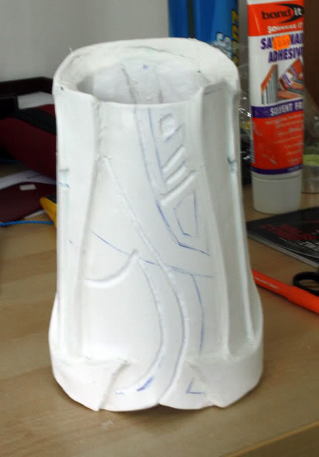

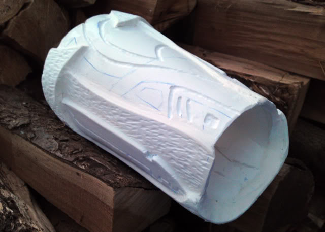

Finally got back onto the bomb gauntlet today. Got the main frame sanded down and the carved details on the bottom and sides added.

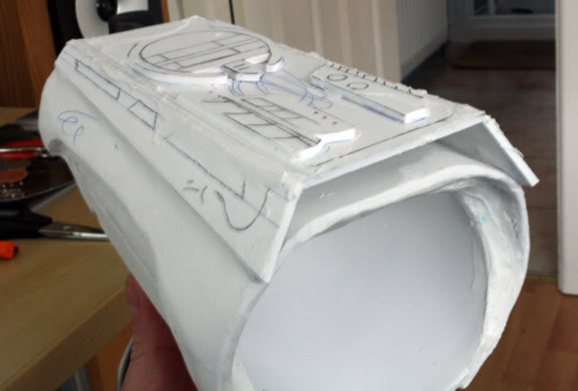

Then made a top section for the actual bomb controls. Cut some rough shapes and stuck them on. These will all need profiled and carved to look like buttons, dials etc. Have to hunt around for some round discs to add as lights. Also need to seal the 2 end up. Letting the cement fry for now...

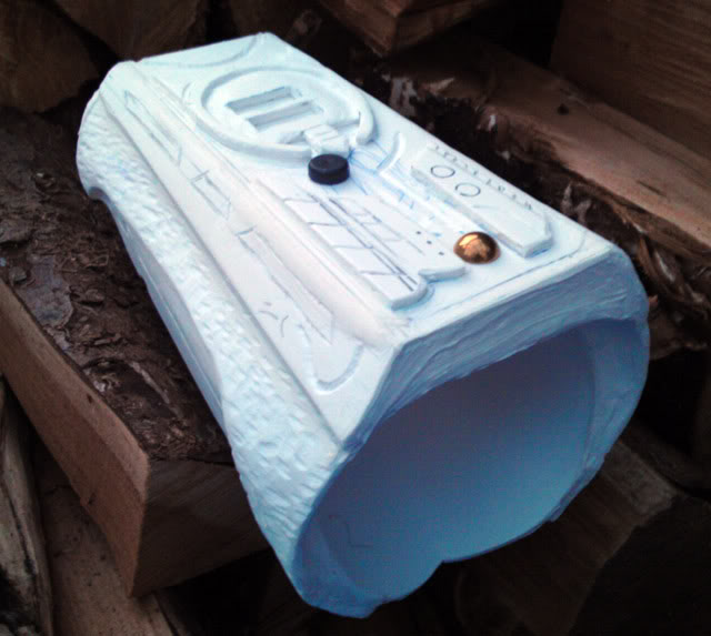

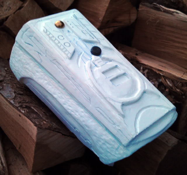

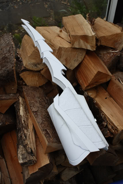

Bomb gauntlet done. Finally got round to finishing this one off. Just needed to add a bit of texture and also sculpt the top section. GOt the ends sealed up as well and all that's left will be a bit of minor sanding and some tidying up once the last of the glue dries.
Next, onto finding an easy way to make a claymore...
