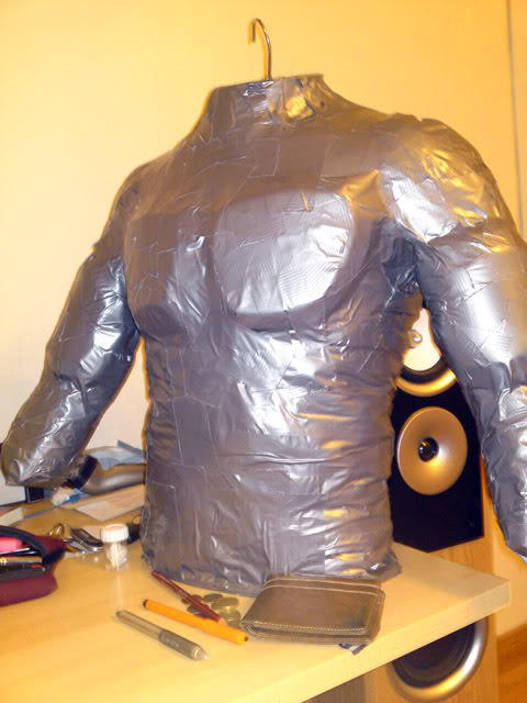

Started with a torso DT dummy. Made a full one last year and it was a bloody pain to keep round the house. Also knew not to pack it with paper and cloth this time. Weighed a tonne and started ripping everywhere in the Summer heat.

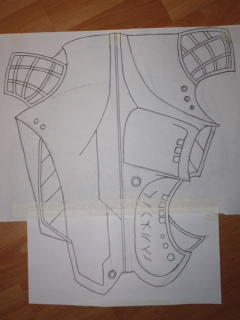

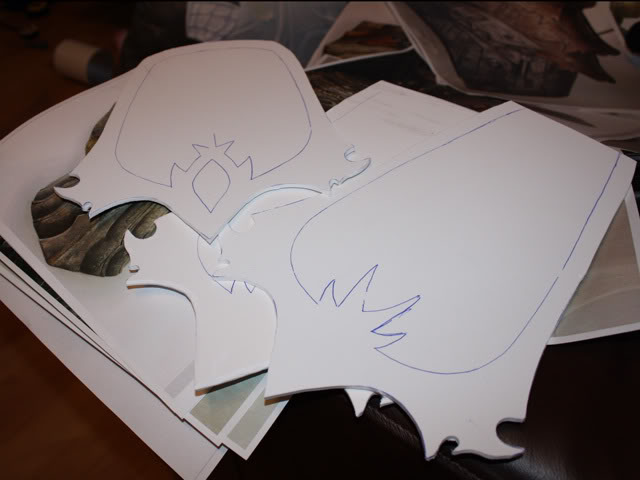

Printed out every decent picture I could find of the Wolf and am just eyeballing all the pieces. Accuracy is way too time consuming and I'm not that bothered anyway. Using Vinman's approach and making templates of everything. Laid paper on the dummy and sketched out what fitted. Next stage was whacking them into Photoshop and splitting them up into layers so that the armour will all have depth and strength. Uselss tip which I'm sure most folk know anyway is to only draw half the template and use Photoshop to mirror it giving you perfect symmetry. And half the work.

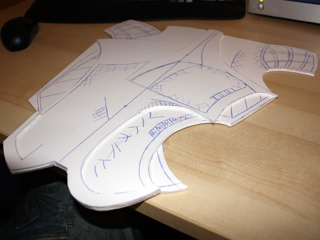

I printed them all out, cut them and markd them onto the Foamex. In came Stanley and his trusty knife and sliced the pieces out before attacking them all with the Dremel to add texture, scribings and some details. TESCO's finest clamps held everything in place whilst the 'No More Nails' set.

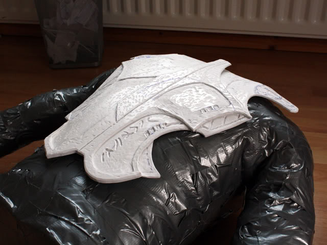

Got the backplate marked out for Dremelling tomorrow. Not sure if it is going to look chunky enough but may add some foamies to bulk up some areas if necessary. There are 3 layers of foamex on some parts so hopefully will suffice. Have no clue how I'm going to attach a backpack to this once it's been heated and moulded to fit be back.
Belfast Neil

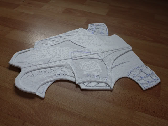

Got the back plate carve up and textured this morning. There must be a quicker way to do the metal hammered finish other than bouncing the Dremel all over the piece! Takes forever! Also got the heat onto it and moulded it to fit my back. Managed to melt through a small hole near the shoulder but am planning on Isoponing the shoulders anyway to add rigidity as they will have to hold the 2 cannons.

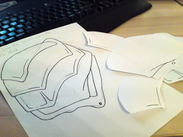

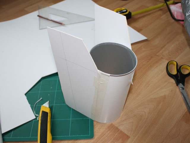

Cheers for all the feedback guys, much appreciated. Made a start on the backpack today and it is sloooooooooooooooww... Still not sure exactly how I'm going to put all the pieces together but I've a basic cardboard form done and the three curved plate things.

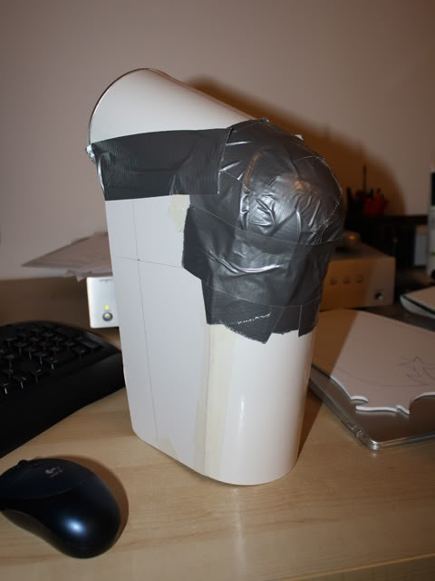

Started making a former using some cardboard tubes, duct tape and a drinks bottle to get the ball end.

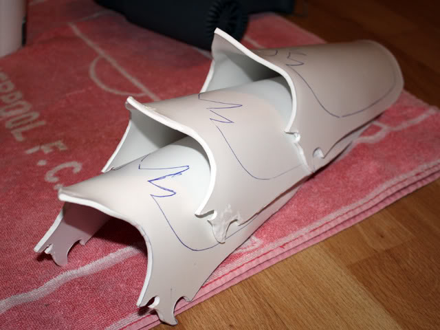

Eyeballed 2 templates for the top plates, doubled them in Photoshop then printed them. Cut the foamex with the bottom plate and the middle one being the same.
Fired up the heat gun and moulded them over the top of the former. Had wanted to form the ends over the ball but a test showed this was just never going to work. Had to make do with the one plane and just curled the ends up.

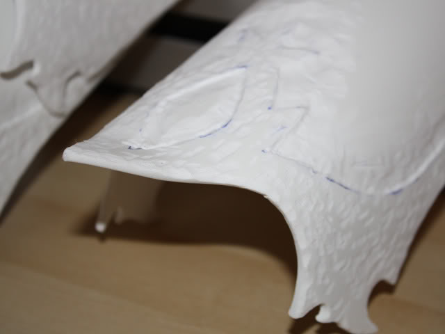

Then onto the Dremelling and this took ages. Will need to sand off the inner pieces to give a smoother appearance against the hammered edges but will do this when I'm ready to paint.
