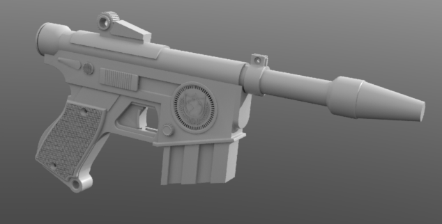

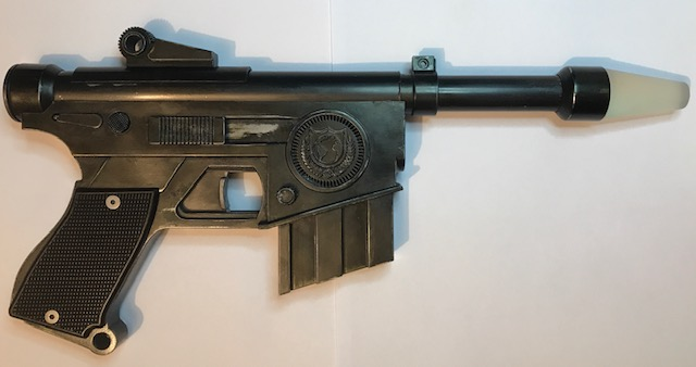

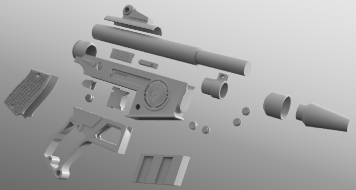

The 3d model I did, based on the toy.
Since we only really see the front of the balster on the poster, I took the liberty of adding the EDF logo on the side instead of the plain disc that's on the toy.
I made it hollow so that I can add electronics (see below), so the trigger will move, the side switch will function as an on/off and there will be a couple extra functional buttons with fun effects.
Printed parts:

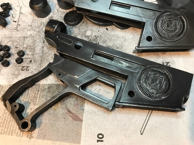

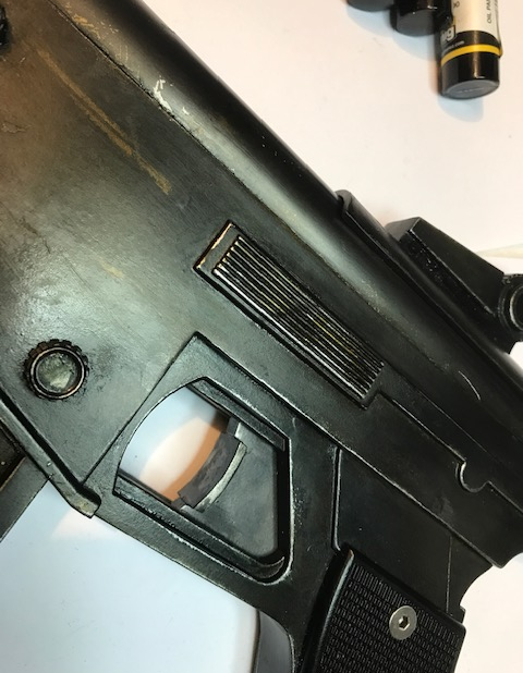

Some work-in-progress shots. I'm using a 15(-ish) layer paint method to replicate the look of old brown-blued steel, like you'd see on something from the 40s or 50s. (I've used this method before on my Mandalorian blaster, and a simplified version of it on a Blade Runner pistol.) It's a mix of layers of blacks, metallics, graphite rubs, transluscent blue+orange-brown and such.
Here, getting a graphite rub:
And here, after more weathering. Note the 'corrosion' on the surface in some areas.

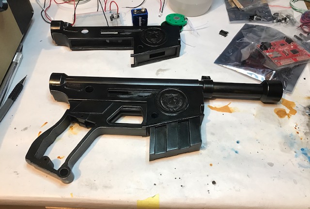

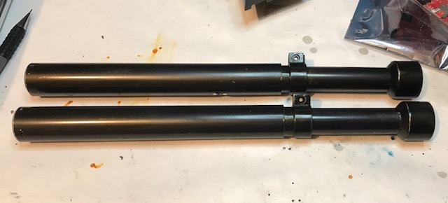

Photos of wiring up the blasters:
I don't go through a lot of hot glue, as I find it rather messy to work with, but I like it for securing electronics. On a piece like this, which will be sealed up forever, I also use it to stop wires from moving around.
The sound board just barely fit across the length.
Barrel in place:

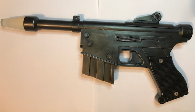

Once the entire pistol was assembled, I went over it with an additional layer of oil paint weathering. It really does make a huge different to the final finish!
Oils wiped off. Grips are screwed in place and can be removed for battery swapping.
First (of two) blasters done.
