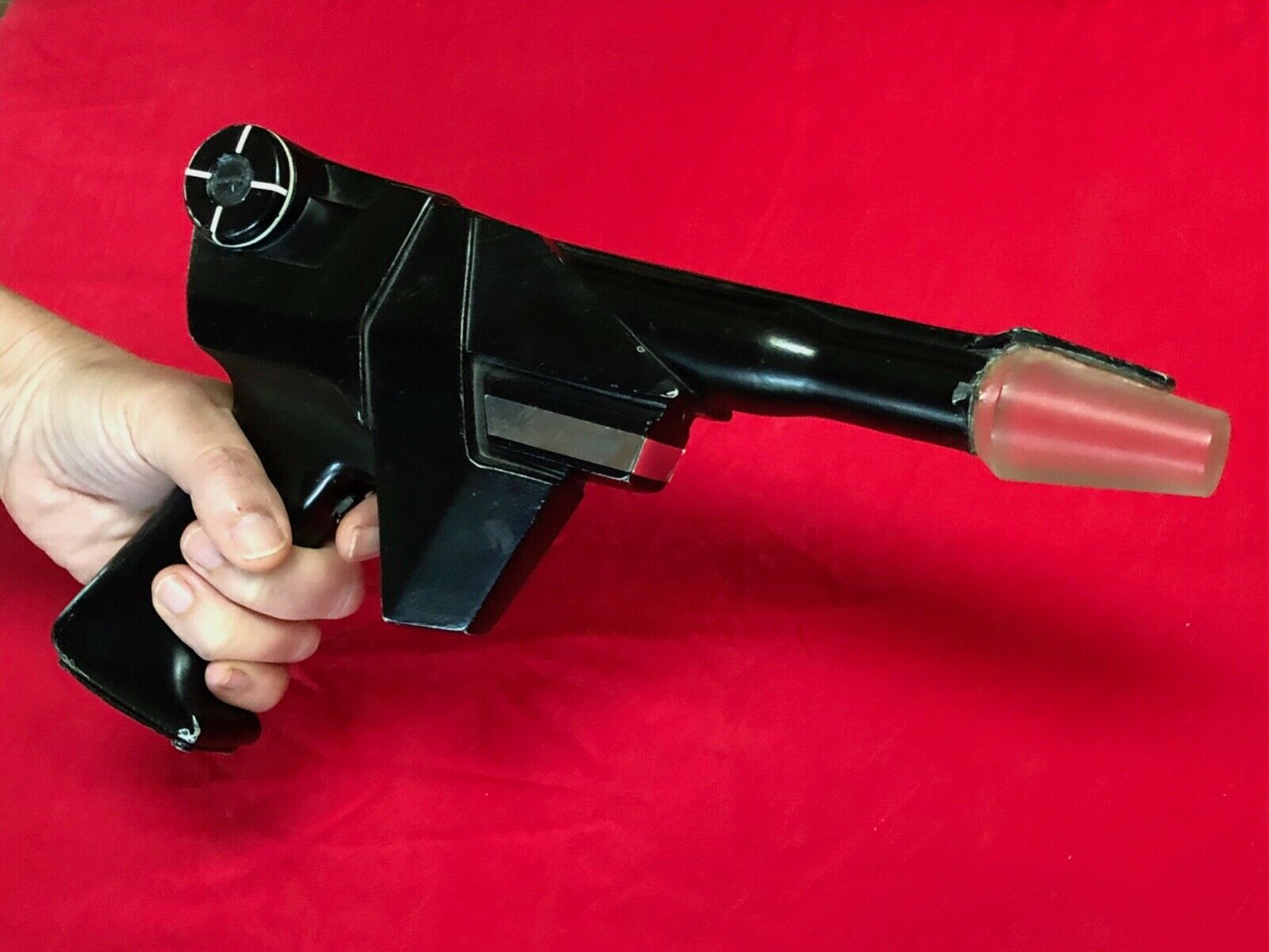

Buck Rogers Season 2 "Hero" Blaster Build
Corellianexports
Reference photos:
(Screen used from "The Golden Man" episode.)
(Used briefly in Battlestar Galactica)
Here's the kit:
While waiting on my other Buck Rogers blaster to dry, I figured I would start work on this one.
I went through a bunch of reference photos but unfortunately, I couldn't find a good one of Gil Gerard holding this particular prop, so I'll have to go through my Blu-Rays. From what I've seen of the other versions, I think this one is my favorite. Oddly enough, it was used briefly in Battlestar Galactica, probably by a security guard or "bad guy".

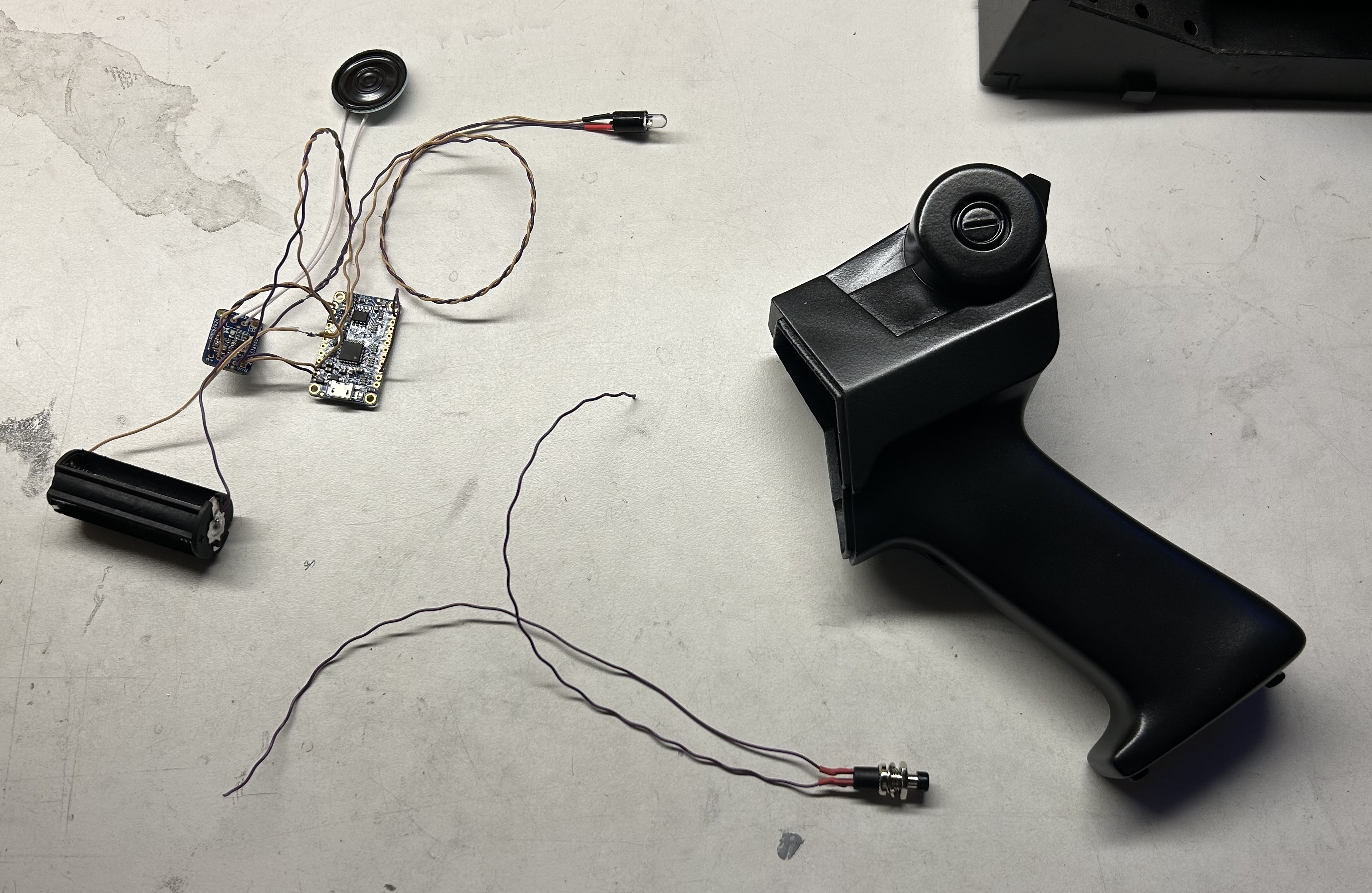

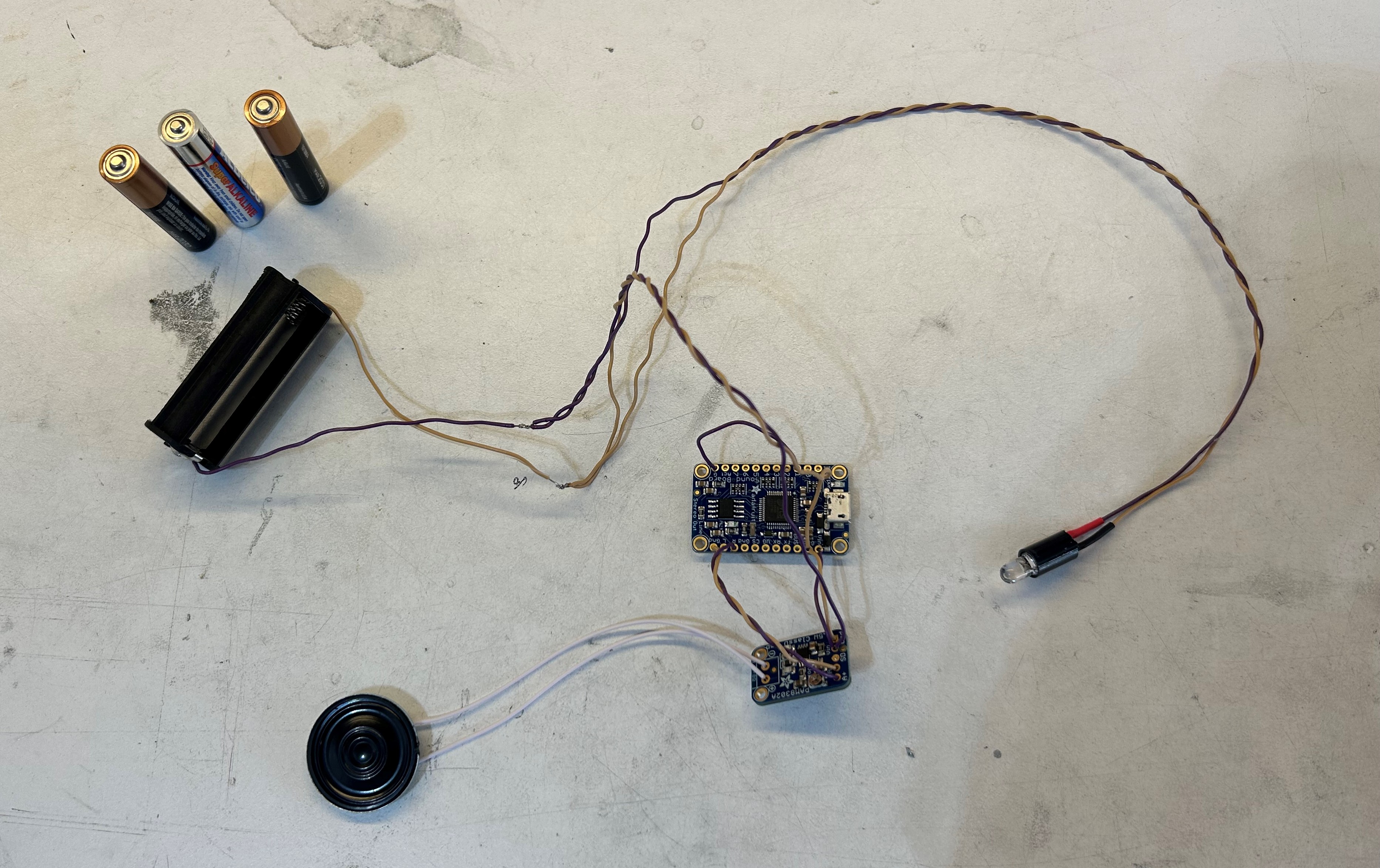

Over the weekend I finalized the soundcard setup. I didn't think the sound volume was high enough, so I considered a larger speaker, but the area inside of the blaster can't fit anything larger than about 1", which is the diameter of the speaker below. Also, after testing the setup with 3 AAA batteries, the volume is actually very good. I'm using an Adafruit sound card with an amplifier (smaller card below). I probably should have gotten the sound card with a built-in amplifier, but this amplifier has a volume pot, so it's easy to adjust with a small screwdriver:
I had originally tried one and then two 3 cell batteries but after a couple of tests, they ran out of power quickly. The tutorial suggests using either 3 AAs or 3 AAAs. The AAs won't fit inside the grip area, so I opted for the 3 AAAs. I didn't have a AAA battery holder on hand, so I pulled one out of a small flashlight I got as a freebie from Harbor Freight Tools. One of the problems with this type of setup is that once the sound card is engaged, the LED light flickers or turns off, but with this setup (3 AAAs) I didn't experience this problem.
Adafruit doesn't appear to have a schematic (which I prefer to use) on their website, but they do have some nice tutorials, including one specific to the Han Solo blaster or any blaster for that matter. It's a fairly straightforward setup because we're only using one sound that gets repeated when the switch is engaged. For future reference, I'll draw up a schematic and post it at some point but for now here's a shot of the tops of the cards wired up:
Both cards require power, so they're wired together via the power connectors (ground and positive), which also goes directly to the battery holder. An alternate way of connecting power is through the data connector using a smart phone battery with a standard USB/Data cable. This is the same connection used to transfer wave files. I have the sound card wired up so that it uses the first sound selection. The wave file is named "T01.WAV" for this selection. To create the wave file, I used the Audacity app to record the sound from a video of the Buck Rogers blaster. It actually sounds a lot like the same sound used for the Battlestar Galactica Viper laser cannons and probably is. The Audacity app allows any sound recorded to be trimmed and then saved as a wave file.
Here's a shot of the back of both cards:

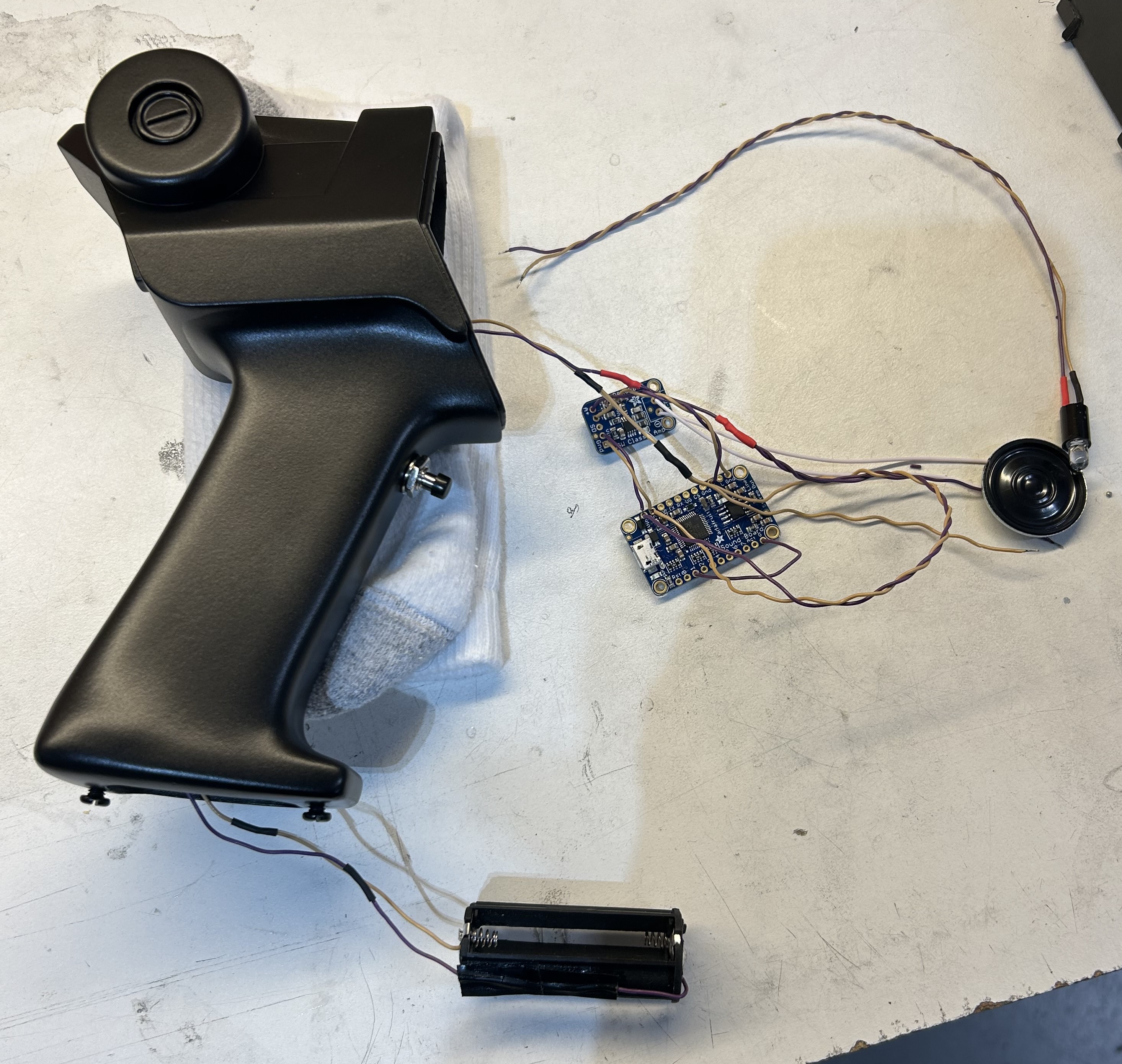

Unfortunately, I ran into some paint related problems at the end of the summer and basically had to start all over again, so that's one reason why it's taken so long to finally get to this part of the build. The good news is that the final paint job turned out really nice and now that all of the parts are full dried, I can start installing the electronics. At this point, the electronics are still testing good, so it's time to remove the battery pack and attach the button, monetary switch:
As with any electronic project, the switch acts as a go between on the positive wire that connects the battery to the sound card/LED. I'm using purple wire to signify a positive connection, so I've attached two pieces to each end of the switch.
The switch is installed, just like the original prop with the lock washer and the nut attached to the outside of the handle:
The battery back will eventually go into the handle so that the batteries can be easily replaced.
With the positive wire now attached to the switch, I've pulled it through the handle and have attached it to the battery box. The negative wire is attached to the LED and the sound card:
I tested the switch with batteries installed and everything is still working perfectly.
Since the length of the wires attached to the LED are a bit too long, so I've cut them off, to make it easier to run them through the barrel section.
I've attached the LED to the clear, acrylic emitter using a little contact cement:
I'll let this set over night before final assembly with the barrel section.
Probably the easiest part of the build is simply snapping the clear emitter into place:
Definitely one of the nice options of 3D printing. :)
The speaker also needs to go into the barrel or "forward" section of the blaster. I tried lifting the speaker above the "speaker grill" area, but it sounded better right on top of it, so I've kept it in place will a little clear silicone:
Once it's dried, I'll attach the boards with some mounting tape I found at the Dollar Store.
