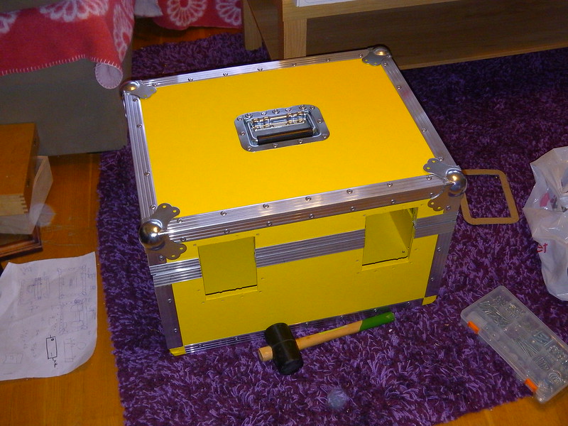

Have done some work on my Case that i started in 2012....
Have done 142 pop-rivets today and have about 94 left to do.. My hands are gonna feel so bad tomorrow.. Feels like i should invest in a airpowered rivet gun instead of doing it by hand. https://c4.staticflickr.com/8/7647/27632866875_a722257f9f_c.jpg
I feel your pain. 200 rivets and counting!

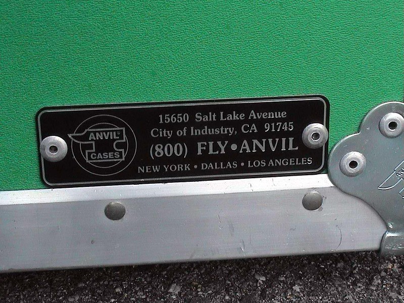

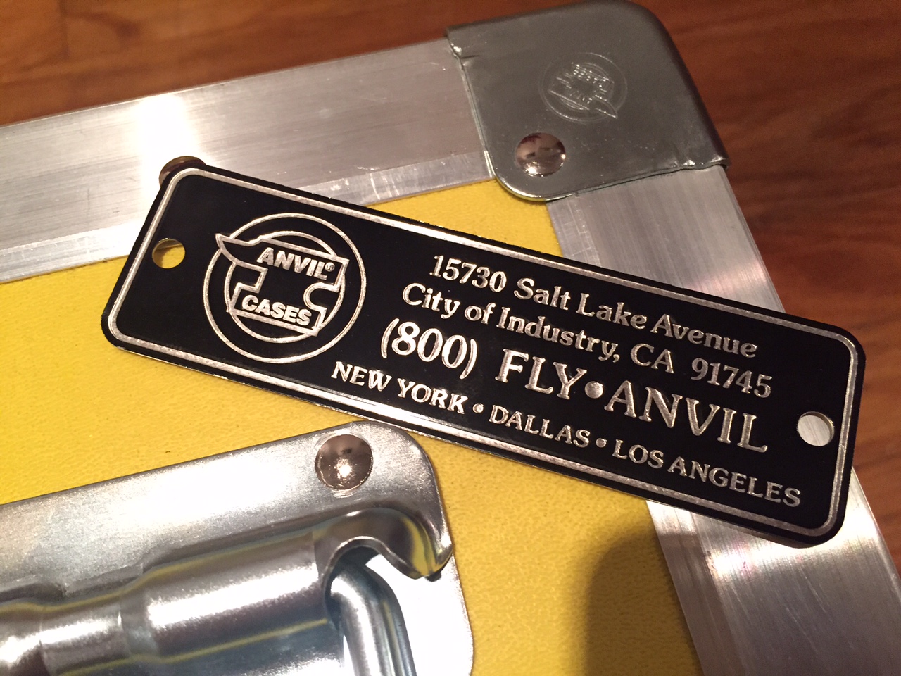

I'm in the finishing stages of my scratch-built Plutonium box, Everything is riveted and it needs the stickers and "Handle with care" text painted on the front. But i wanna add a little extra on my box and as we all know the original box was a Anvil box that have this logo on it :
As the reporter tells us in the movie that the box been stolen from "the Pacific Nuclear Research Facility"

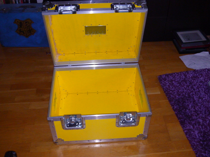

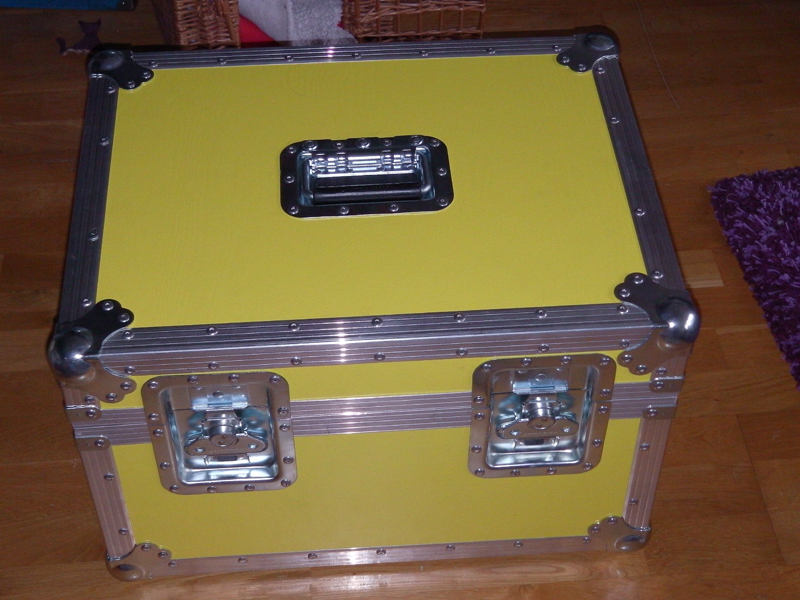

Here how my box looks like at the moment. Need to fix up and paint the inside a little more.
