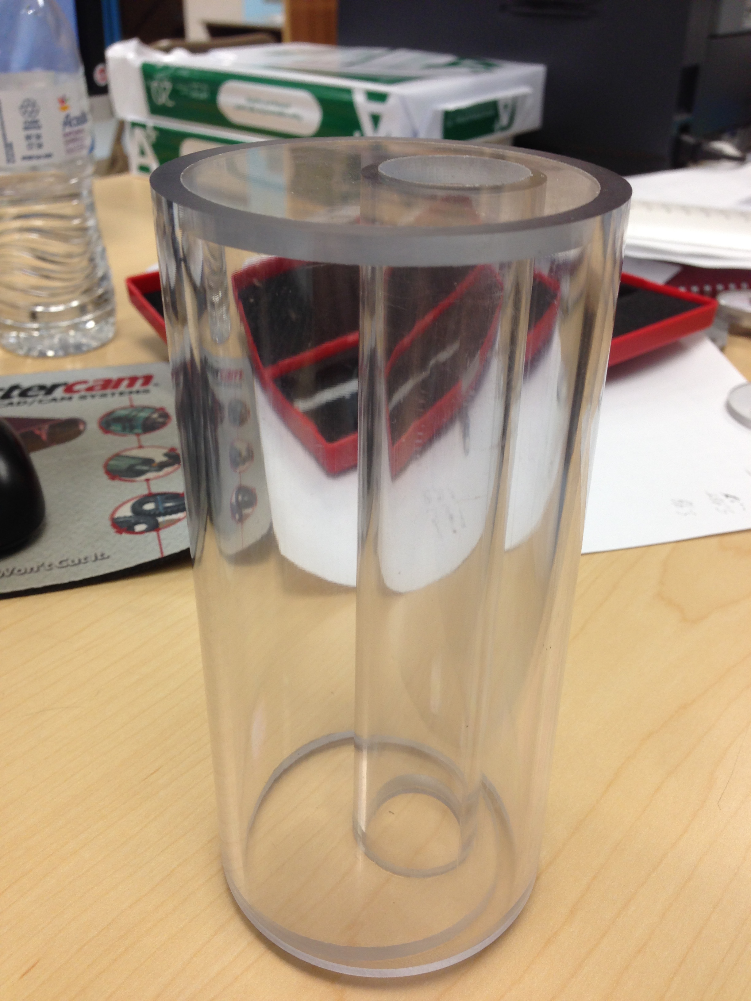

Got a chance to machine the top plate yesterday.
This means I need to shorten the inner tube a decent amount.
The thickness of the parts are 3/16" (4.7625mm) thick. I think 1/4" (6.35mm) is just too thick.
More accurate top:
Picture to show thickness of parts. I think any thicker would look like too much.
Bottom pictures to come after I cut the inner tube.

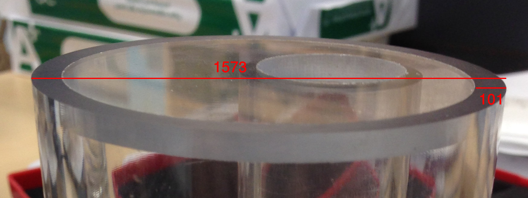

... The thickness of the parts are 3/16" (4.7625mm) thick. I think 1/4" (6.35mm) is just too thick. ...
You're absolutely right. 1/4" is too much. And I'm really an idiot. :lol I made the mistake of trying to detect the thickness by counting pixels in the middle of the prop. The tube is a perfect circle and in its middle it acts like a magnifying glass in spherical shape - it doubles the thickness. Now I did the same again on top of the tube. And you can see: it's just 1/8" (2000 pixels = 3"; 83 pixels = 1/8"). I did the same again with your picture and it works: your thickness is 3/16".
(click to enlarge)
Roland, what do you think of the thickness of my top plate? Depending on the angle of the camera changes how it looks in the picture.
The thickness of your top plate seems to be perfect. It's 3/16", right? The thickness of the top plate of the screen used prop is 125 pixels on the picture. That's exactly 3/16", too. :)
