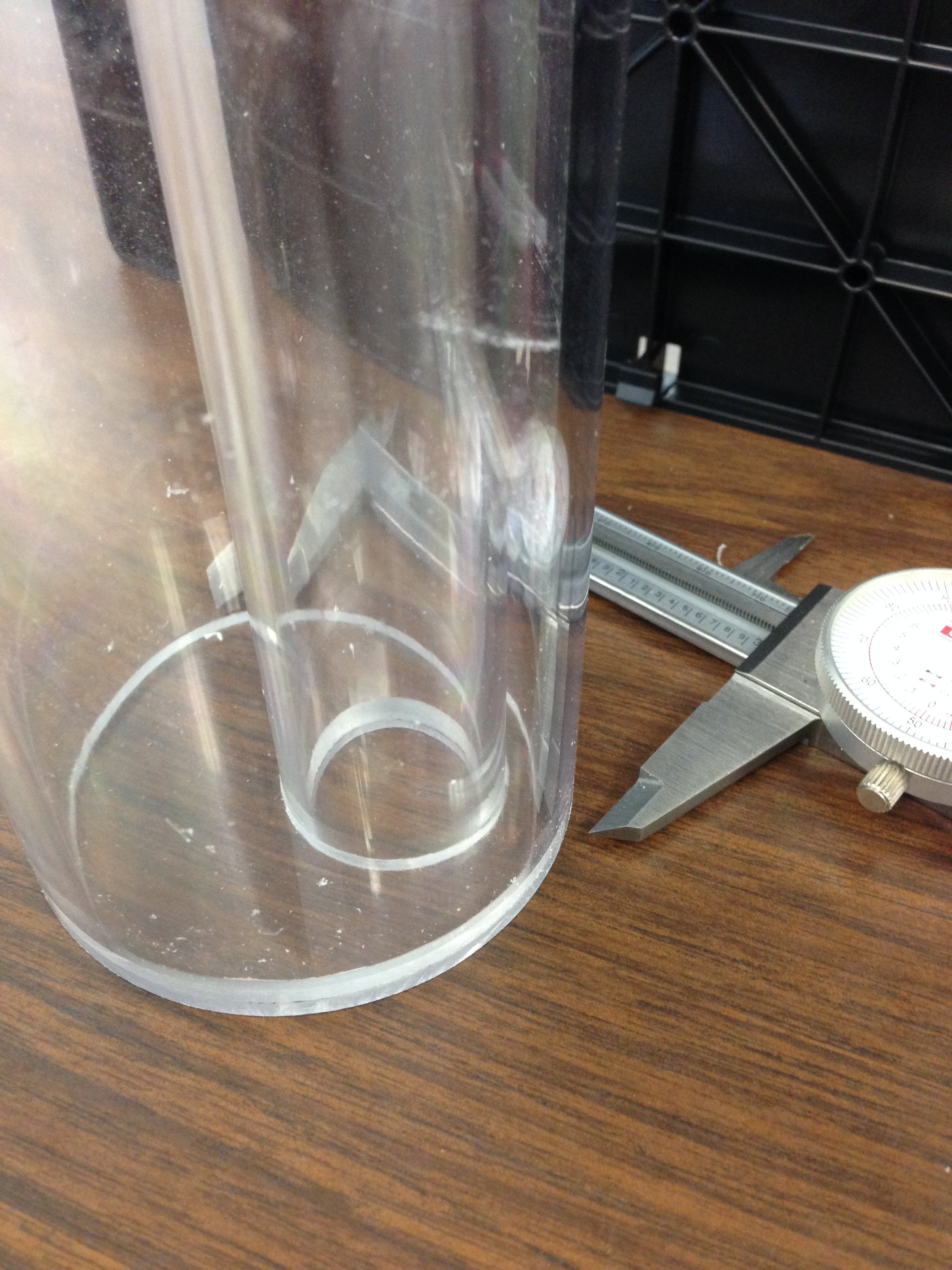

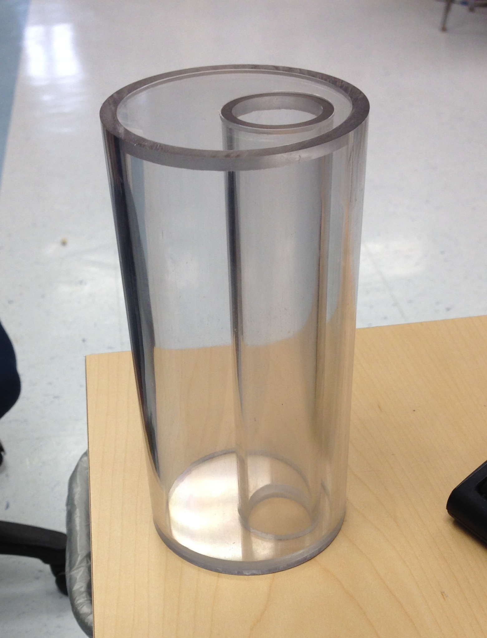

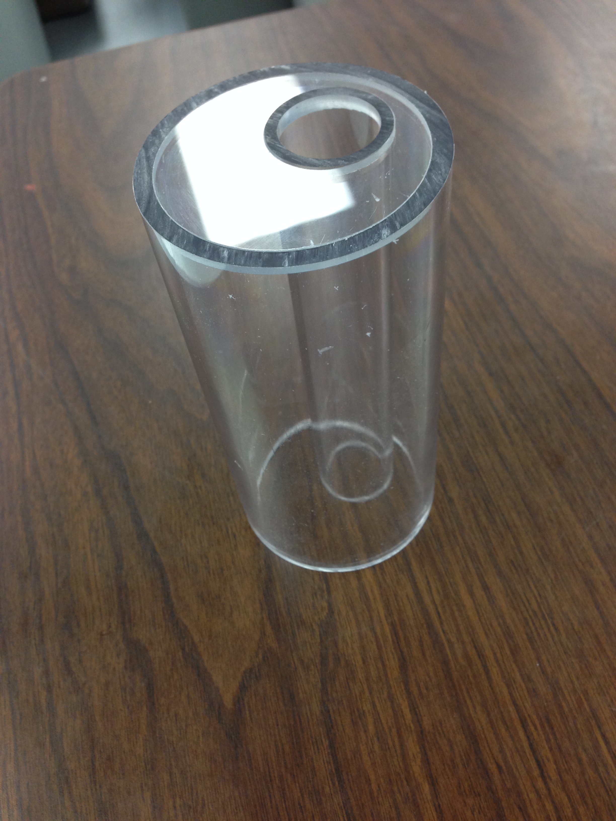

After Roland posted his replica plutonium labels, I ordered materials to make my own canister. (See this thread for labels)
I finally got around to CNC mill a prototype end cap and the fit is awesome!
Here are progress pictures, the outer tube is 3"x6" and the inner tube is 1 1/4"x6"
I think I got the offset of the inner tube pretty good.
Future plans are:
CNC mill another endcap for the top
Fill with some sort of fake water... something that will harden and still look like water, but not yellow over time.
Cut the "plutonium" out of red acrylic rod, adhere a clear acrylic rod to the top and where the seam is, use Rolands labels.
What do you guys think?

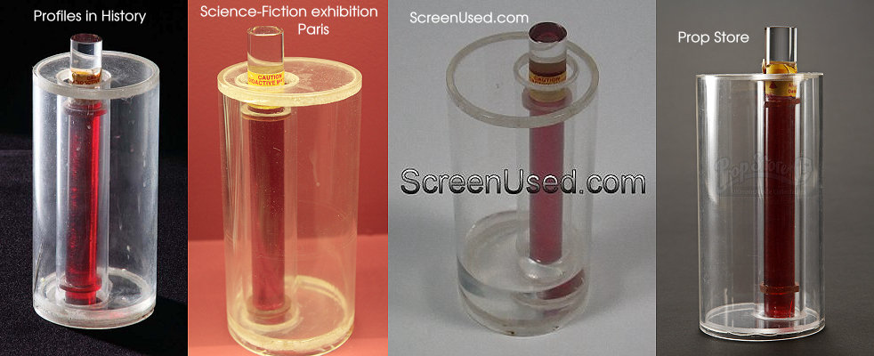

If you need any pictures of the original prop, just tell me. By the way: I've just noticed, that there must be two different original capsules. The capsules shown on "Profiles in History", the sci-fi exhibition in Paris and on "ScreenUsed.com" seems to look the same, but the prop which is currently for sale by Prop Store has another top and bottom. Maybe one of those versions is static and the other one is turnable? Which one will you use for your replica?

Roland, I THINK I see what you are talking about but lets clarify... In the "Profiles in History", the sci-fi exhibition in Paris and on "ScreenUsed.com" it looks to me as though the inner tube goes through the top and bottom? Yet in the prop store, the inner tube is glued to the inside of the top and bottom plate?
It also appears as though the thickness of the one from the prop store uses thinner materials. Is this all true?
If those are the same differences that you see, I plan on going with the "Profiles in History", the sci-fi exhibition in Paris and on "ScreenUsed.com" versions. If I missed the differences PLEASE point them out to me!
Thanks for the reference photos. Any good screen captures of this prop? For example, how high should the water go up?

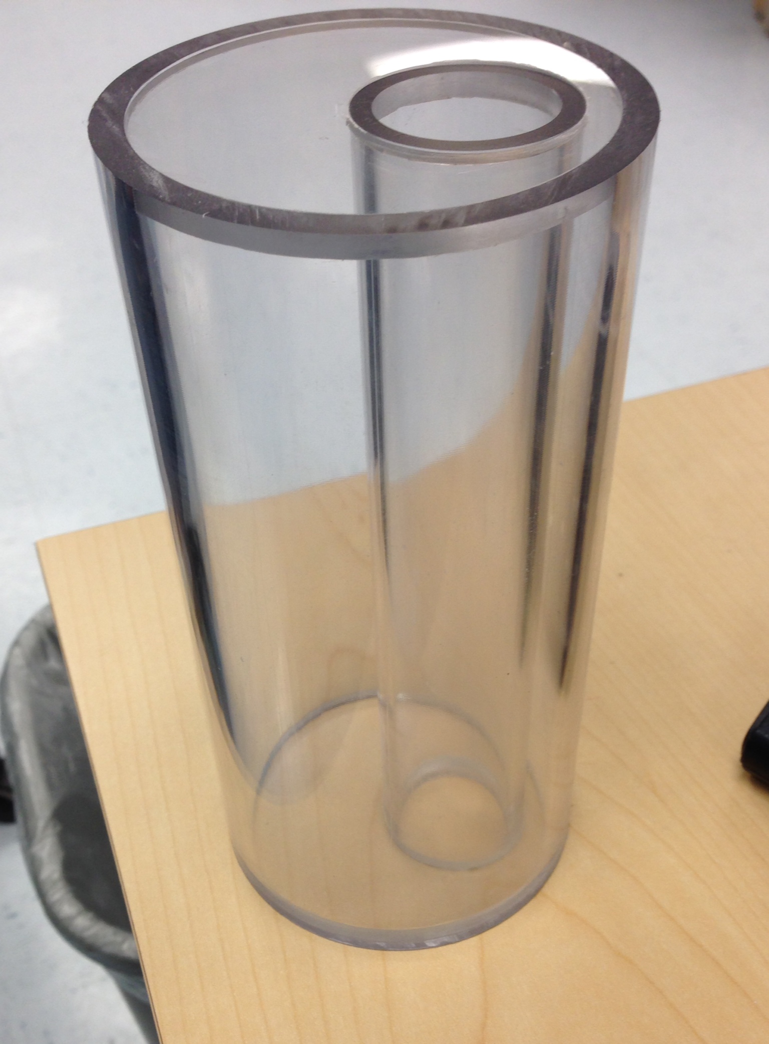

Here is how my current top plate looks. It is all perfectly flush at top.
I can see that the "screen used.com" model has a much thicker base..it really looks wrong.
Also it looks like they glued two pieces of rod together, a red rod with a clear tip and used the radioactive label to hide the seam.

Also, here is my progress on this:
