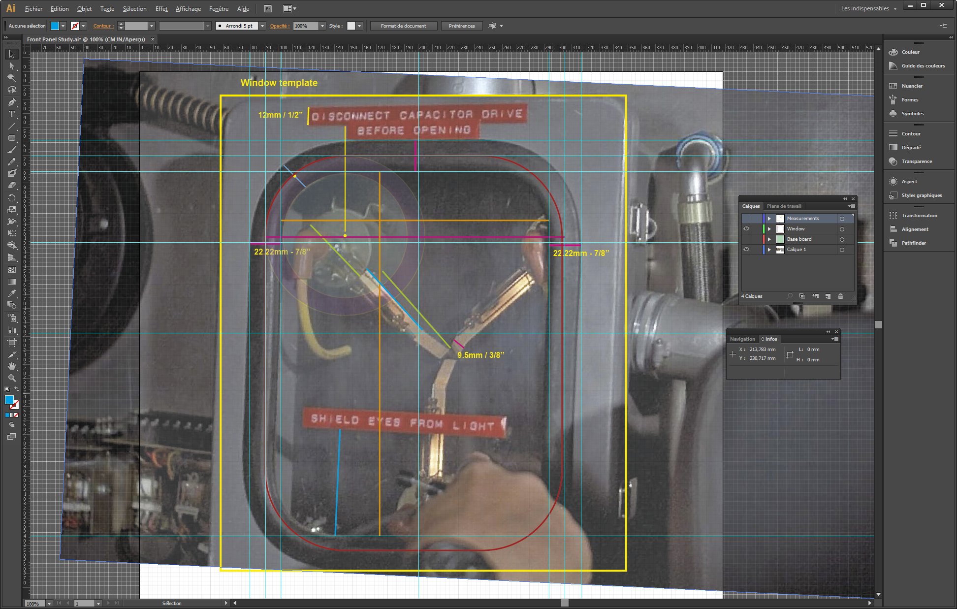

Printed a few paper props and used the laser for custom framing. I enjoy ripping "protected" pictures from shutterSchmock because I think their policy and marketing is horrible, so I just help myself and vector everything in AI within seconds. The DMC engraving on MDF was really cool to see finished (and lasering it looked cool as well)

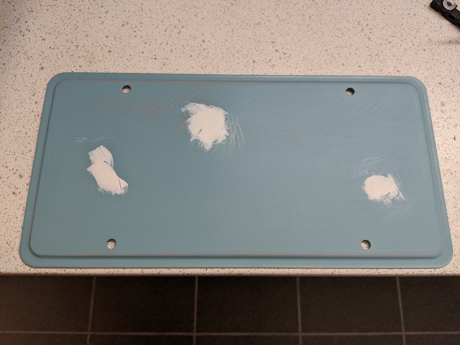

I've also decided to add a "outatime" license plate, since I don't have any blank and it's all USA stuff, I modeled one in Inventor and printed it in ABS, now being primed before I can apply decal on it and put a nice clear coat on top

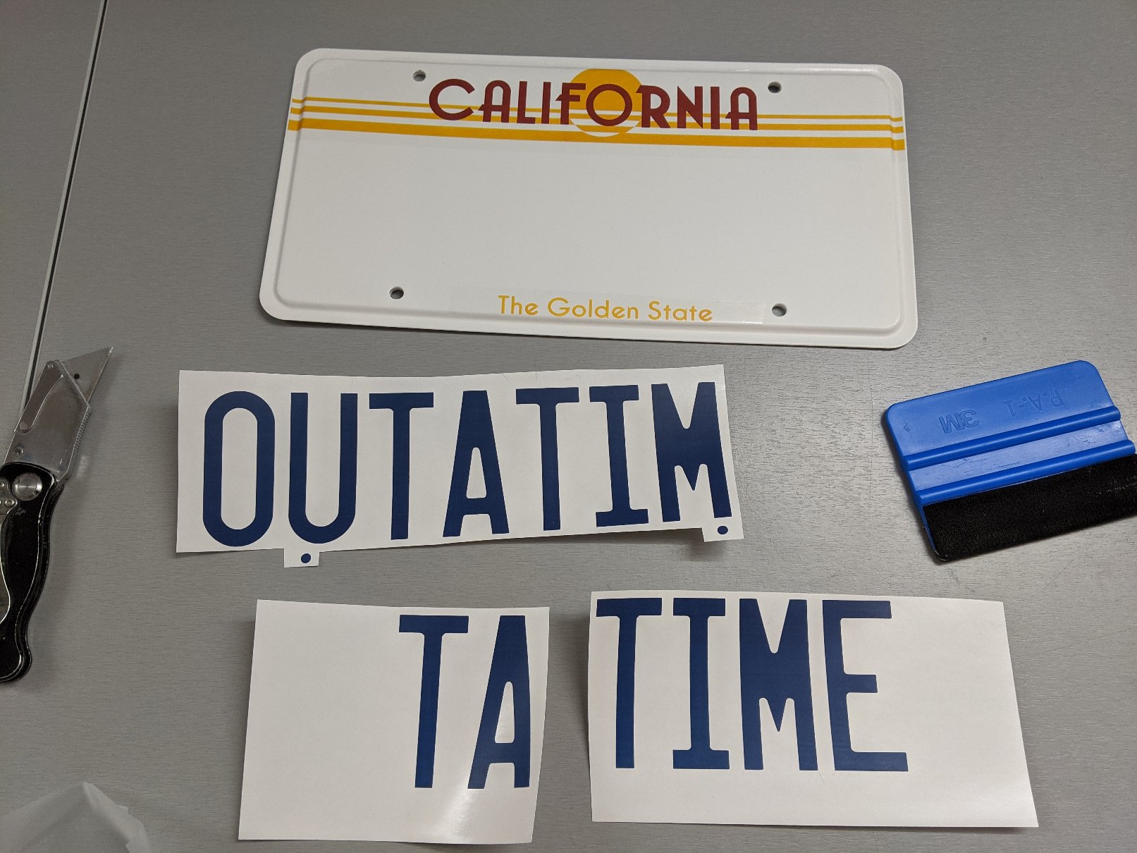

finished the license plate this week, working with laser printed decals remains extremely hard for me, very stressing process for decals of that size... I ****** up the first attempt, not flat enough, it warped on the edges when I applied the 2K clear (glossy). Fortunately, the 2 part clear keeps leveling very well, so I just added a couple of more coats after securing the OUTATIME blue lettering, and started over the decals process after curing the place 45 minutes in the paint (dedicated) oven.
I used some (laser) printable vinyl to get a proper color for the letters, and used the cameo + registration (optical) marks to cut them, pretty handy.
It's still way unperfect. Got some dusts during the clear (no primary filter yet at that moment in the paint booth) and the toner cracked a little on the decals since they are very fragile. I didn't redo it, it's important that I remain aware of my fail-fu and it's also just a stair case decoration. Won't get my clear spraying "wings" this year, not a problem. In practice, you really see the defects under that sort of light, but hung on the wall, it looks "decent" I suppose

What dimensions did you end up with for the main window cutout? I'm working on one as well, currently in the Fusion 360 modeling phase.
