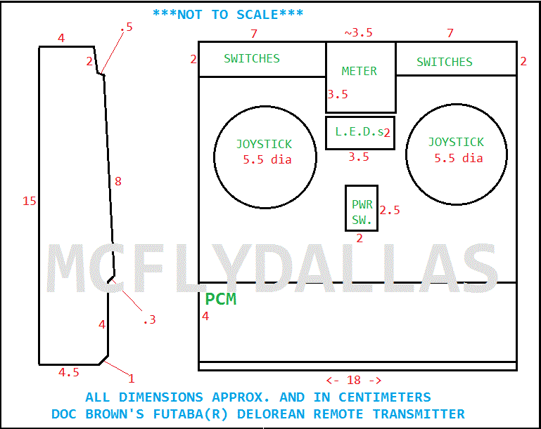

I searched is not found relevant descriptions. Someone you could give Futaba radio dimensions ?
(length , height, depth , etc. ) Thanks!

Here's what I came up with for you, if you're still interested.
(I saw you are in Hungary, so I made the measurements in metric to be helpful. Hopefully it does help)
Regards,
David M.
aka McFlyDallas
Thank you so much!
(no problem if either metric or imperial units)
Regards,
Zsolt

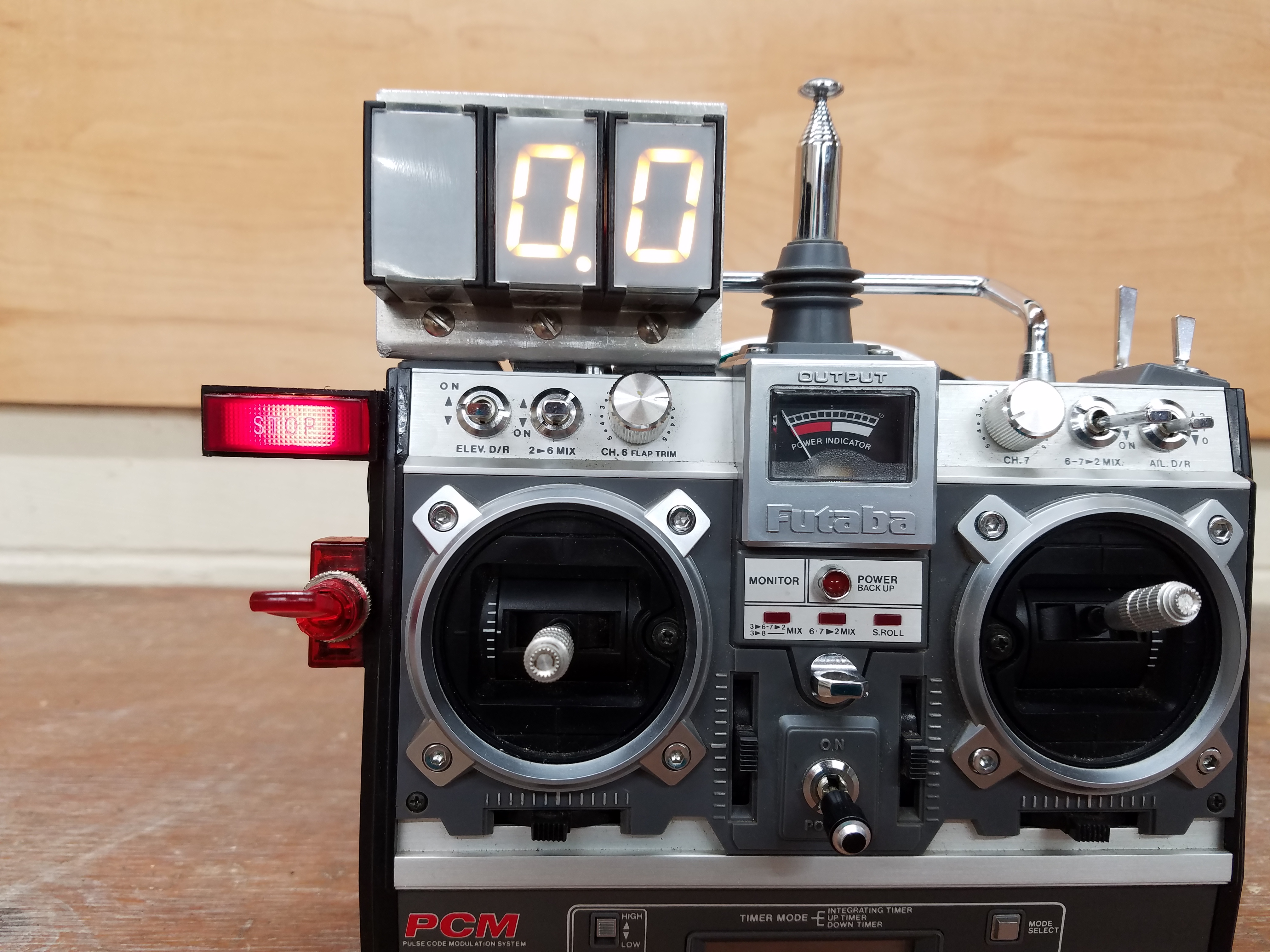

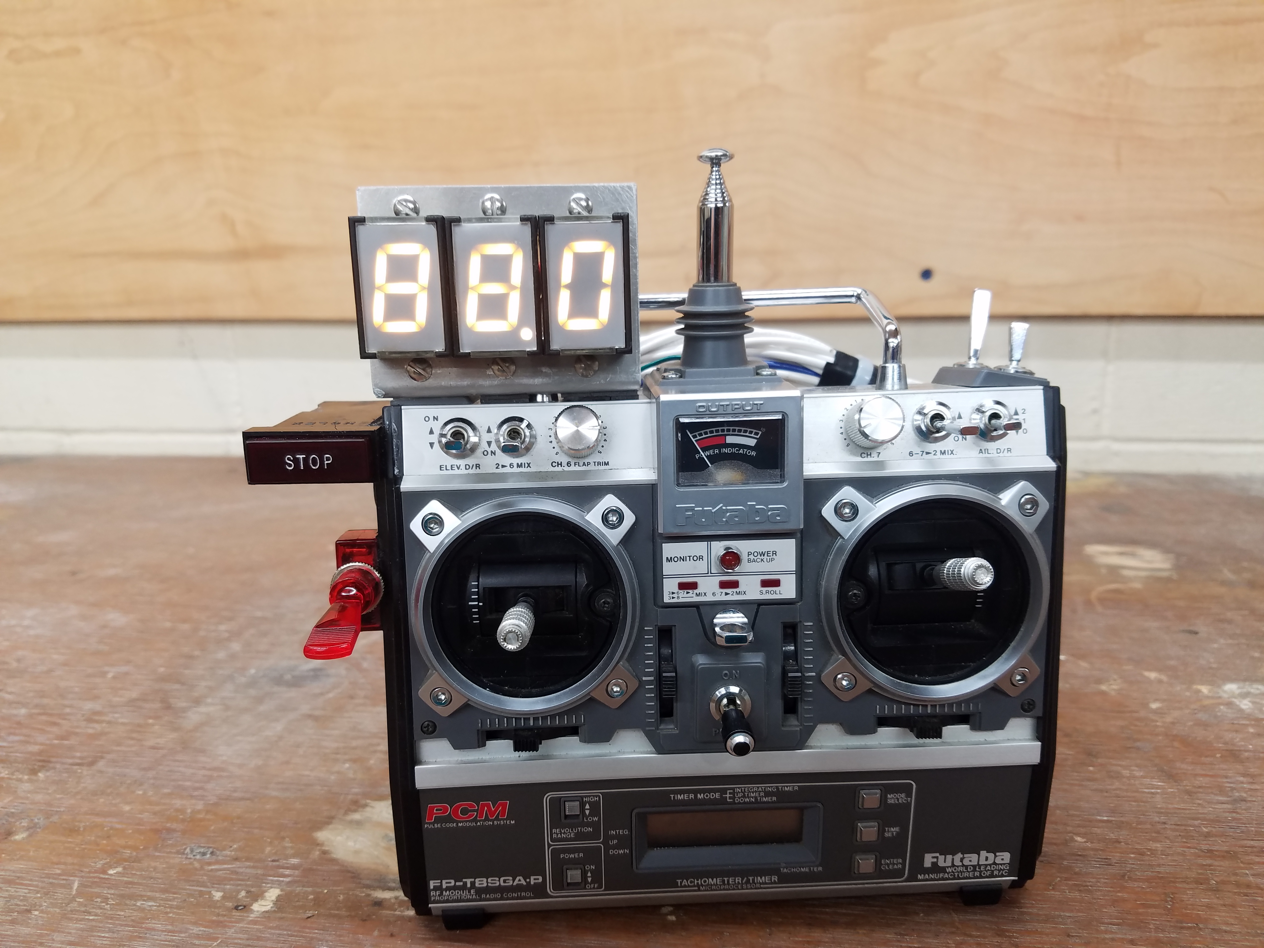

This looks incredible! Looking forward to when these will become available...
That looks awesome!! Great job sir! I also am looking forward to when they are available.

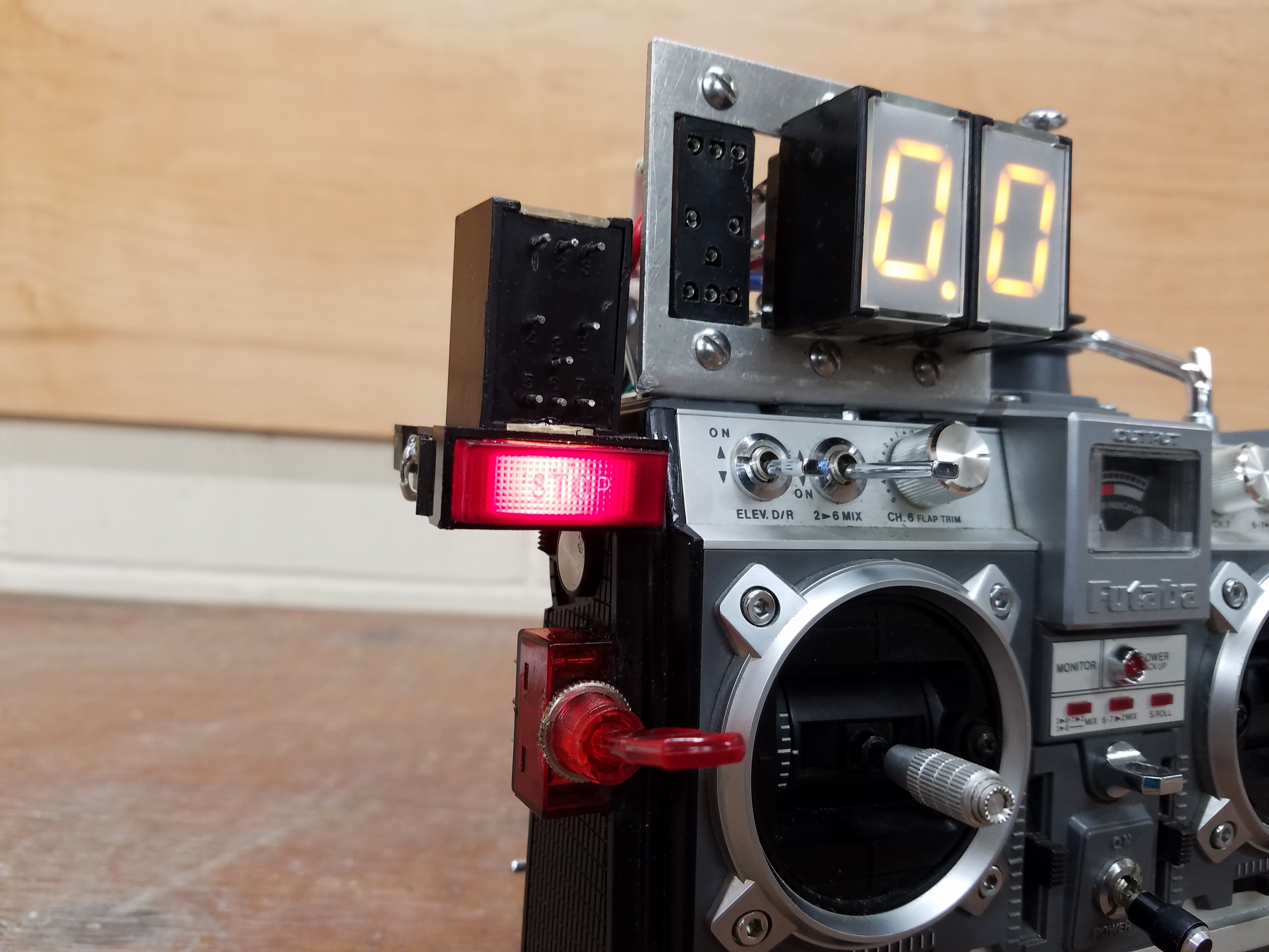

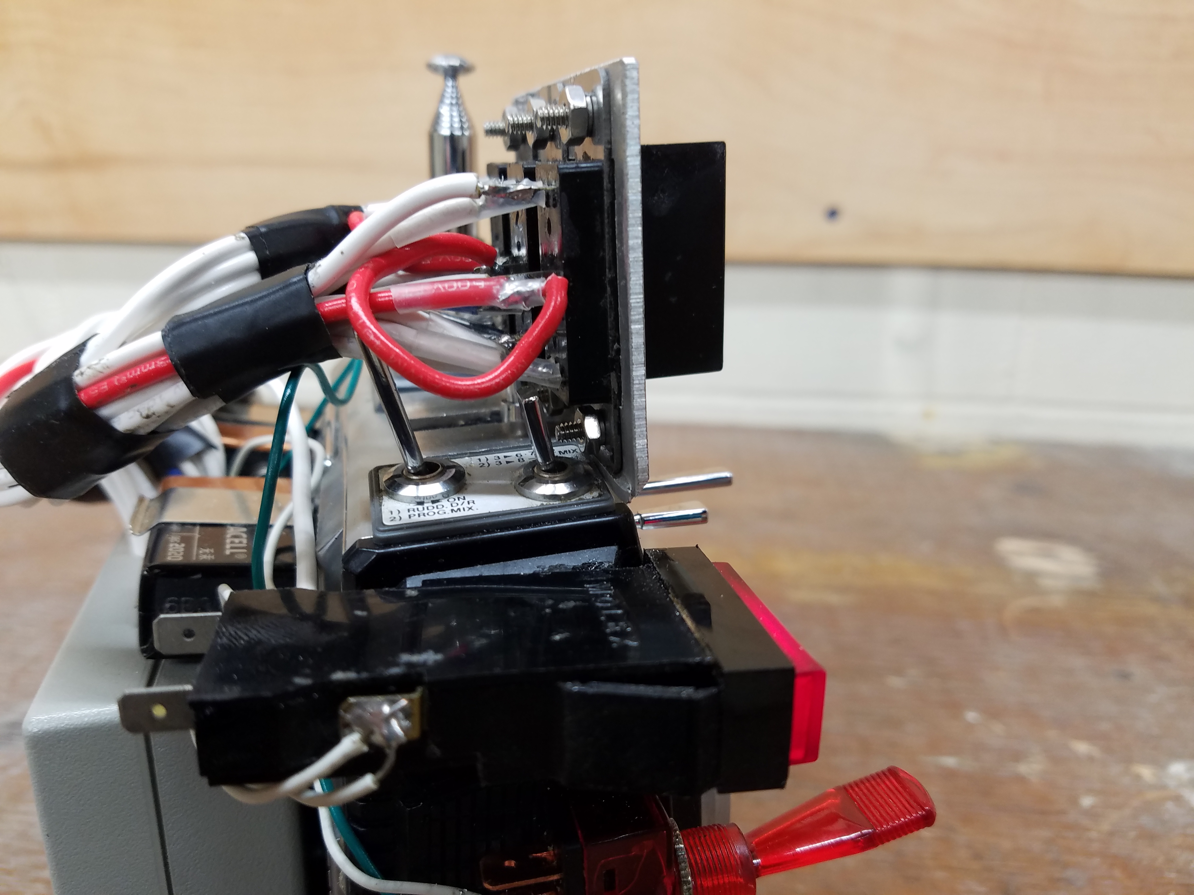

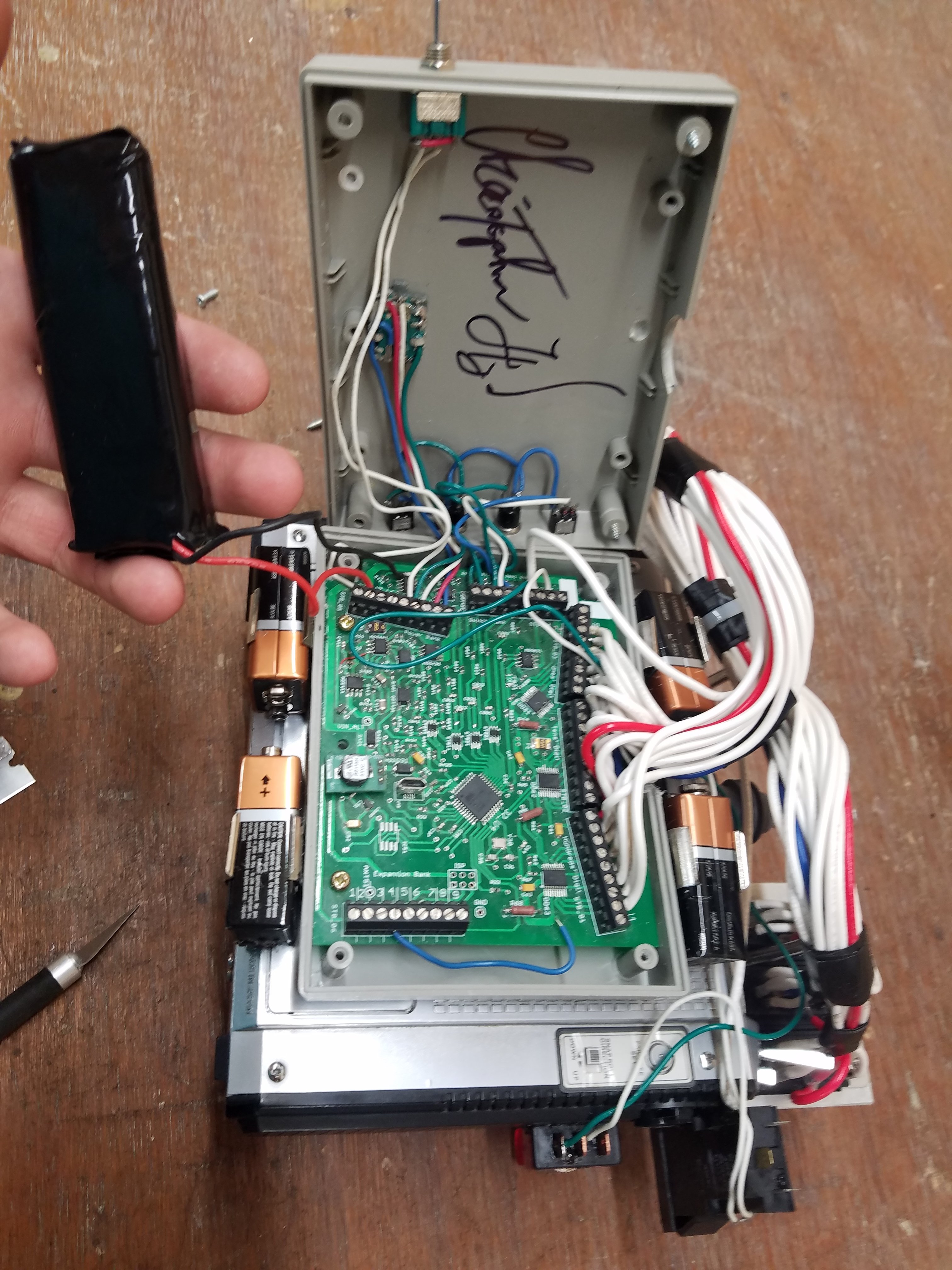

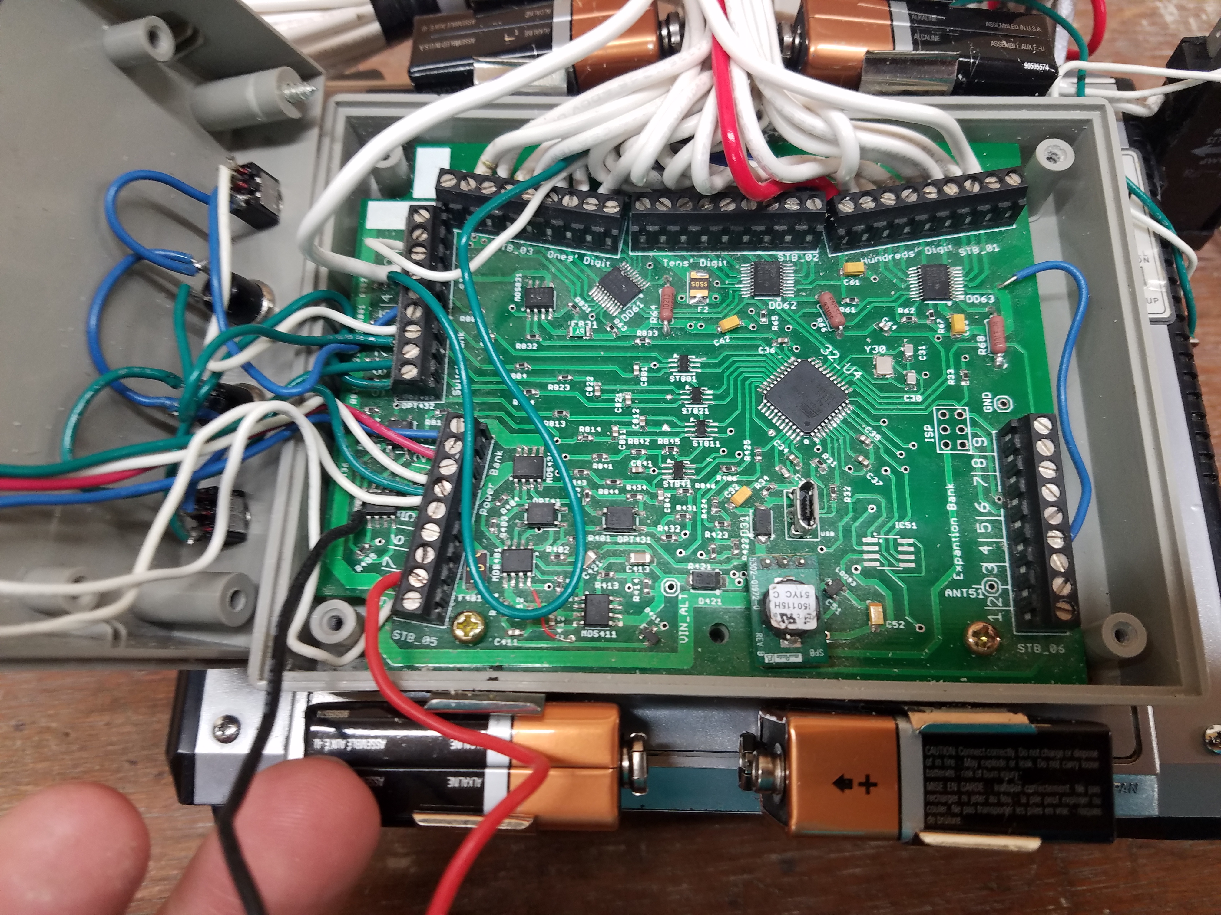

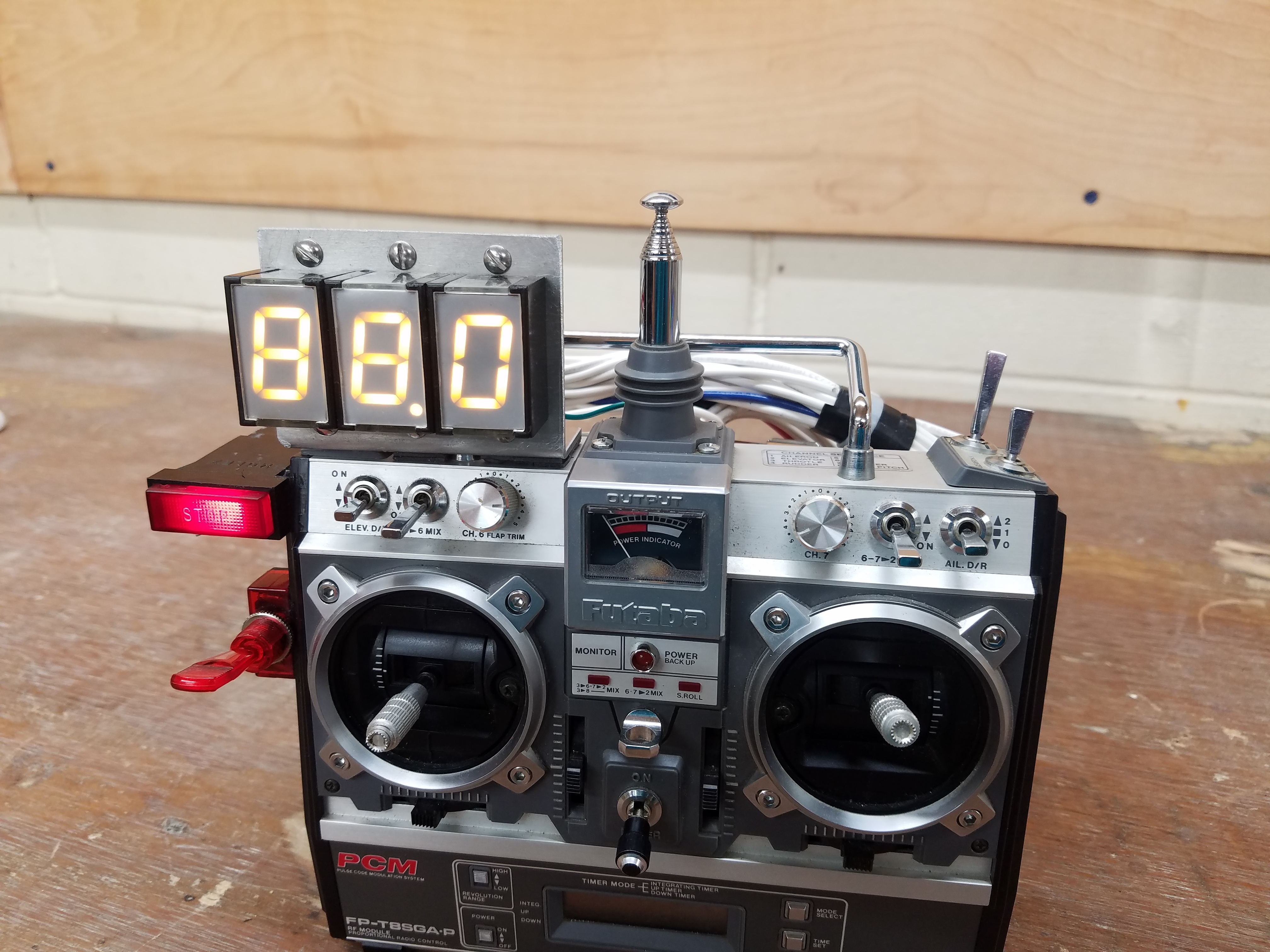

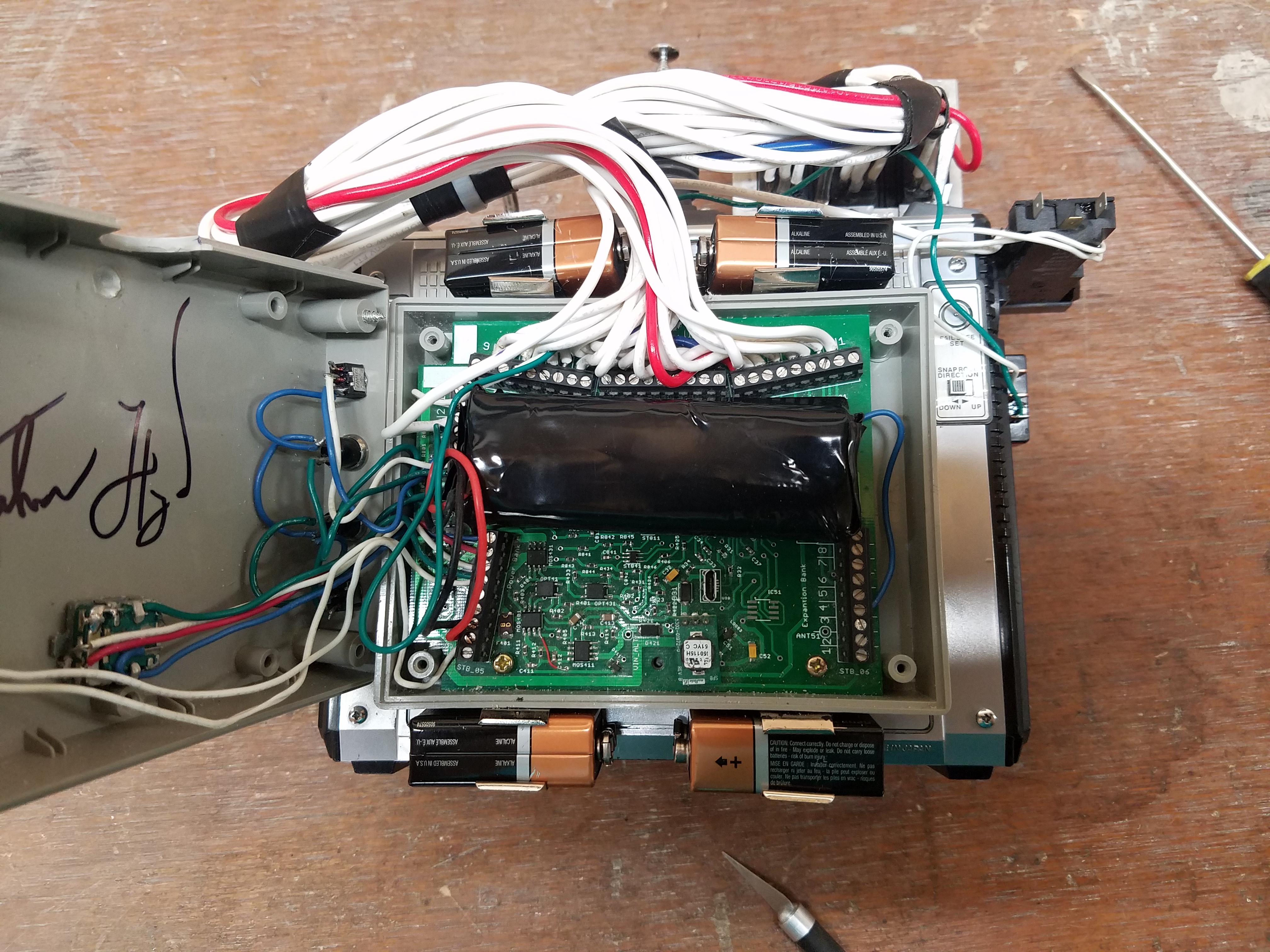

Here are a few pics of the front and the inside. This one was built in time so I could take it with me to a convention, so it was rushed and things aren't right or final.
like for instance; the plate is slightly wrong on the dims, the molex light is mounted too low, the jacket size on the wire is too large, the switches, ...

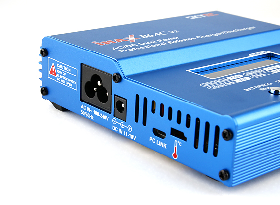

In other news, to charge my setup I am recomending everyone get a " iMax B6v2 " charger.
Fakes / clones that do not work well are extremely common, so only buy from a reputable vendor. Here is a recommended link to one http://www.hobbyking.com/hobbyking/..._Professional_Balance_Charger_Discharger.html
You'll be able to charge both types of kits; the 'everything in the Unibox' type, and the 'much larger battery inside the remote' type.
-Gary
Did you try hobbyKing? I know they have an EU warehouse and ship all over. They should be able to ship to almost any country. You may have to search their website to get the charger that comes with the correct wall plug for your region, but if you dont the plug is easy enough to find locally.
The power supply is built in and should accept 115-240v, or DC from 11-18v.
As an alternative for EU, this site SEEMS on the up and up. I would definitely check the holofoil serial number when it arrives.
http://www.agmhobby.com/item/imax-b...discharger-dual-power-with-eu-plug-p-925.html
Comes with EU plug.

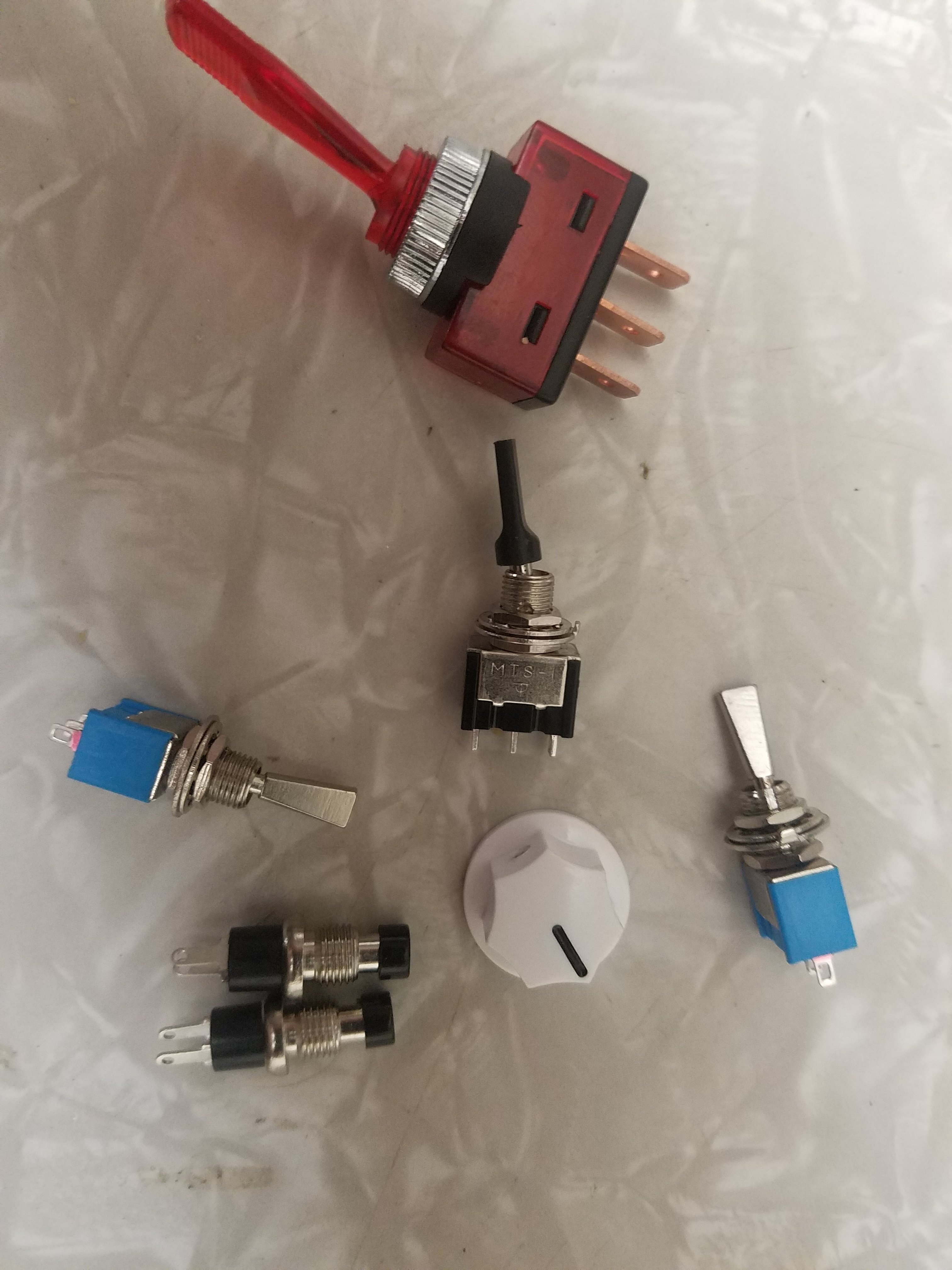

The order I placed 2 months ago for the switches came in today.
The wrong color knobs were sent, though.

In my diligent research, I just came across another tidbit of information.
The knob has a continuous indicator line running down it. The previous best guess on the correct knob has segmented indicator lines.
