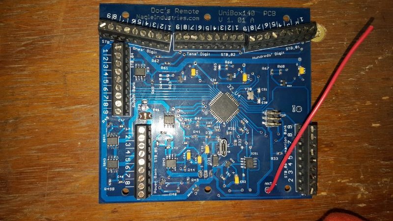

I've decided to split the circuit design in two parts. The main PCB will go inside the Futaba and do most of the work. A daughter board inside of the Hammond box will handle all of the non-futaba switch connections, molex light, and the 7-seg displays. The boards will connect with a 0.1 inch keyed header cable.

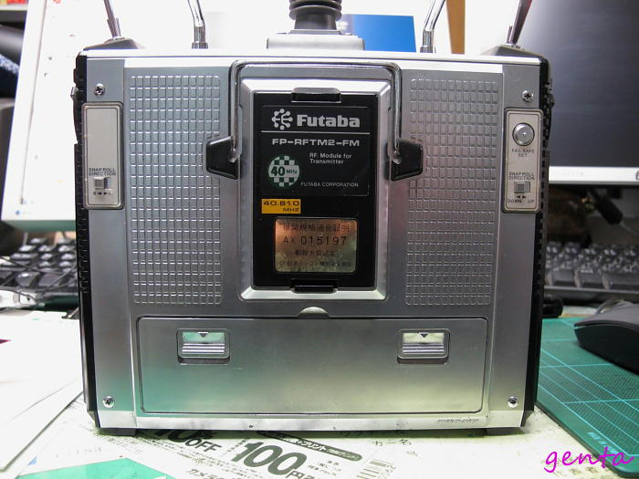

This is the back of a correct futaba:
The black RC module can be removed to make place for some parts, but this would not damage the remote or make it unusable, when you take the "doc's remote parts" back off. I can understand that you need some attaching points on the back housing of the remote and have to drill some small holes in it to attach screws, but also this wouldn't really break the remote (only leaves some small holes in the back-plate). So is this what you are planning to do?
To be clear: I'm interested to transform my remote with the correct parts and some light / maybe sound effects, but don't want to be able to actually trigger something remote with it. So if these kind of functions can be housed in the hammond box.
As for the "battery pack"... I guess you are referencing the black RC module, right? My futabe only has a battery inside that can only be removed by taking the remote apart. I have no removable battery pack at all...

I might be ordering a preliminary test PCB tomorrow if the day is as free as I hope. The design is close to finalized in my mind, just need to do some component selection and finish the layout in EDA.

Most of the design is finished and working. I need to finalise my circuit schematic and finish laying out the PCB. Then I will order a test board and build it up. hopefully not too much will need to be changed on it.

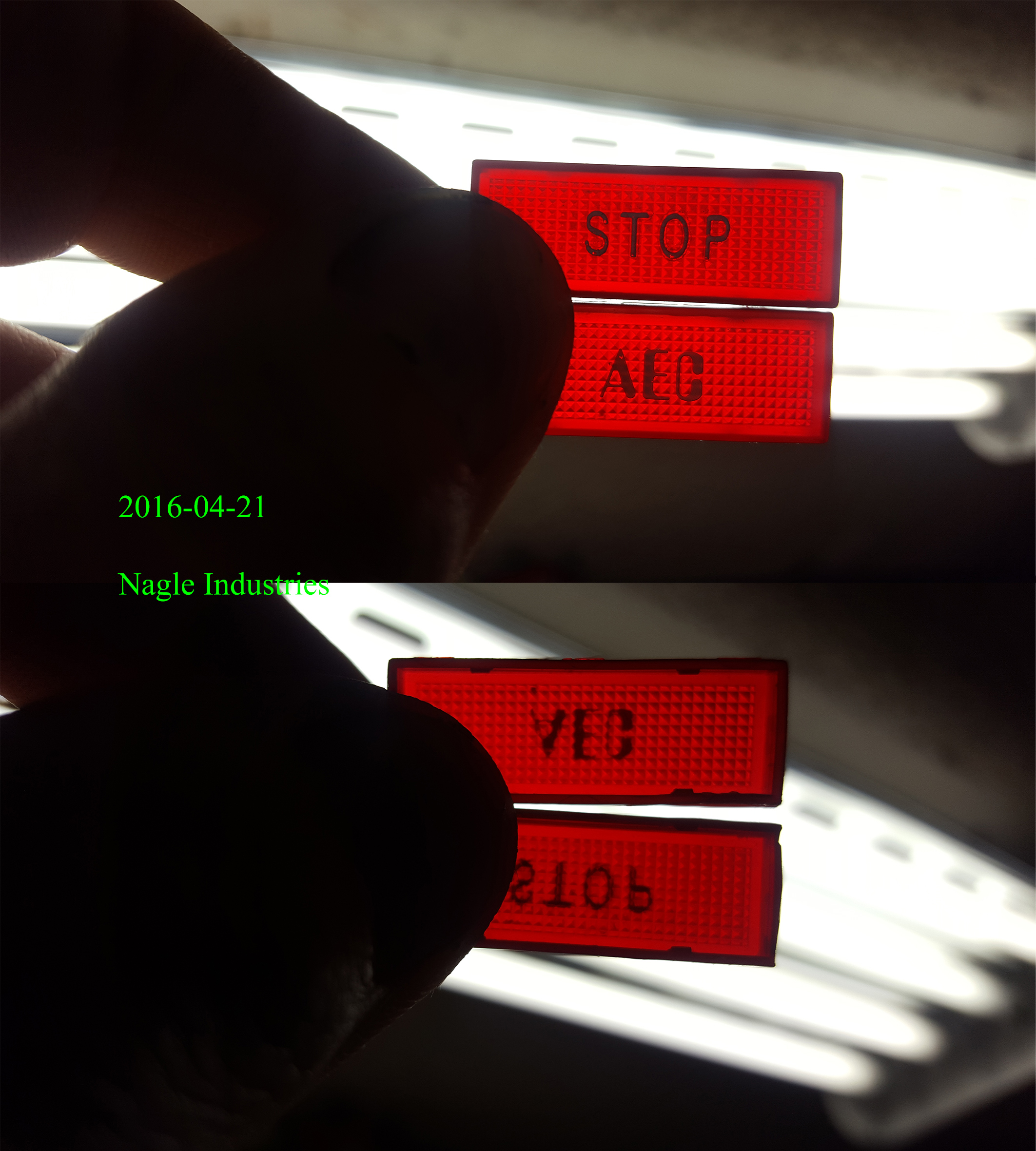

Here is a look at a stop lens from a few months back.
