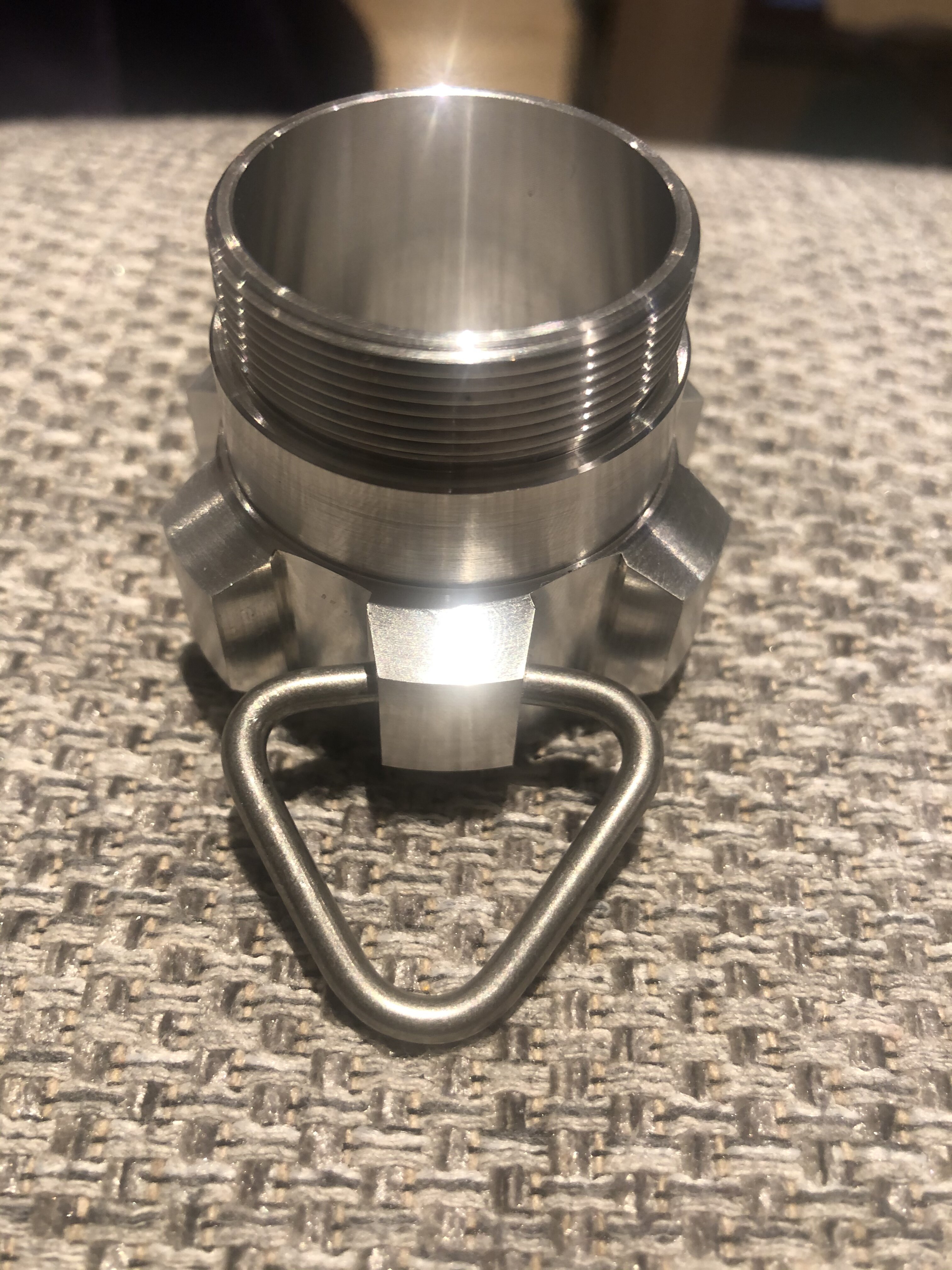

Just received my elite kit today and it’s mind-blowing! Really appreciate all the love that went into creating this. I am eagerly awaiting the reveal board but in the mean time could one of the 3 legends give us a tutorial on how to best install the Tri-ring?
There's already a legend! (Romans Empire) ;)
Same process:
Obviously you don't need to clip the ring, but using needle nose pliers and a channel lock pliers is the easiest/ most common route.
Another tool that can be used to great effect if you have one is a chain plier like this:
the tip allows you to open the ring (the same way as the needle nose) and the cuts inside the grip are good for closing it back down like the channel locks.
***Protect your surrounding cubes with layers of tape***
DO NOT, try to close it all the way where the points touch...
I designed it that way to make it easy and you want that width to be about the same as the way it came in the box so do take note of that dimension when cinching it back down in the hole... it is also splayed out a bit to make sure it grips while inside the hole. This is designed so that it has some friction and can stay in whatever position you set it (which is canon!);)
