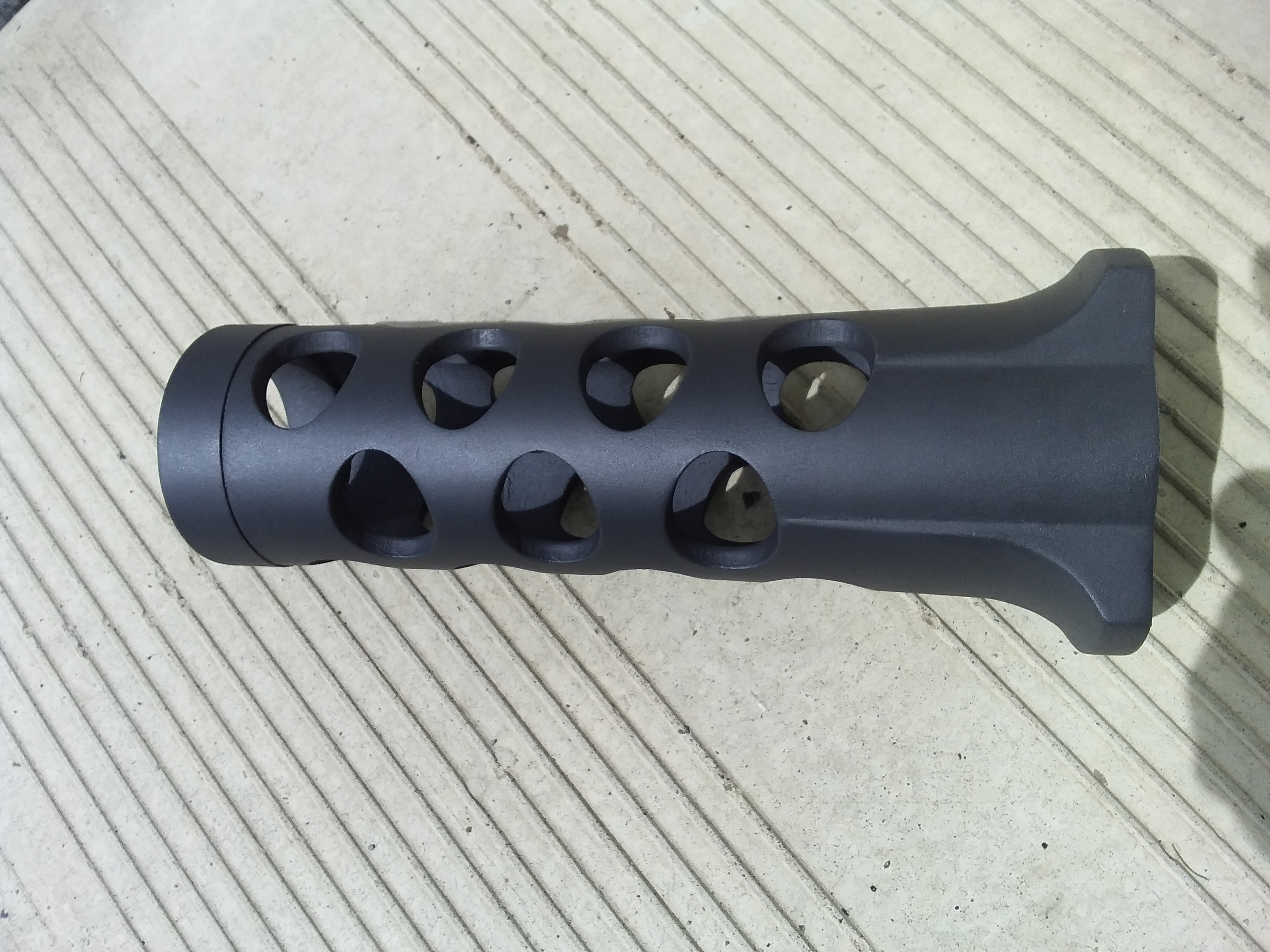

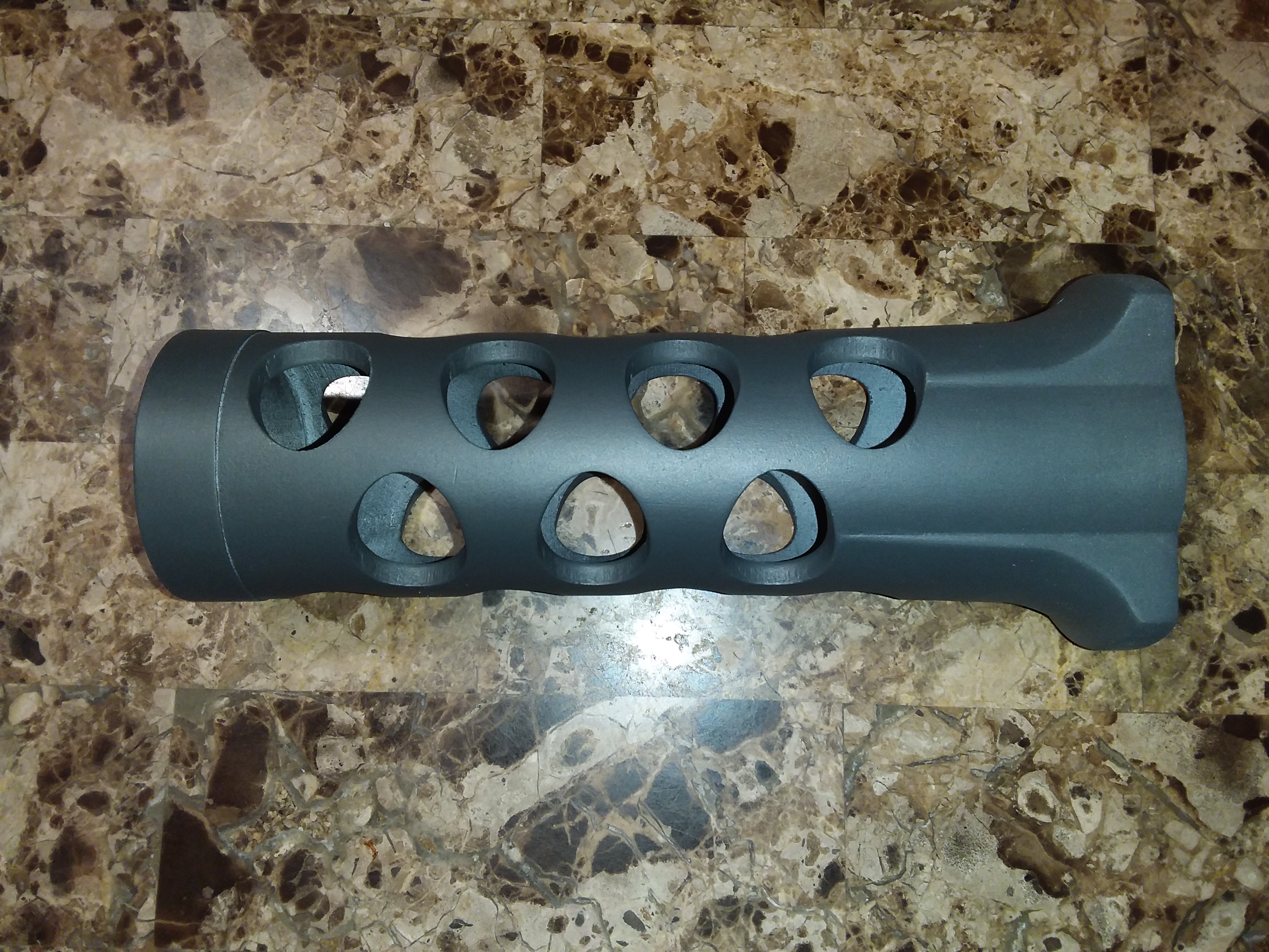

That looks great! What did you use to achieve the parkerized grey finish?
No parkerized finish yet, that is just the finish of sanded black PLA. I only painted the flash hider flat black. I'm going to go with a Rustoleum paint called Chalked. It is supposed to have a ultra flat finish. Charcoal with be the colour, even though that may be a bit dark. I will undercoat with a silver and sand the Chalked paint to slightly reveal the silver and see if that looks right.
On my old scratch built M2 I painted it flat black and rubbed in graphite powder to give it a metal finish, but it was too metal like of a finish.

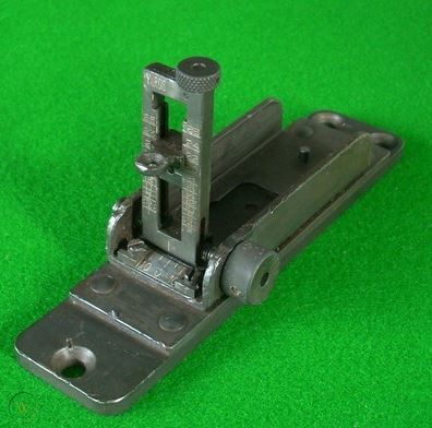

A real world example.

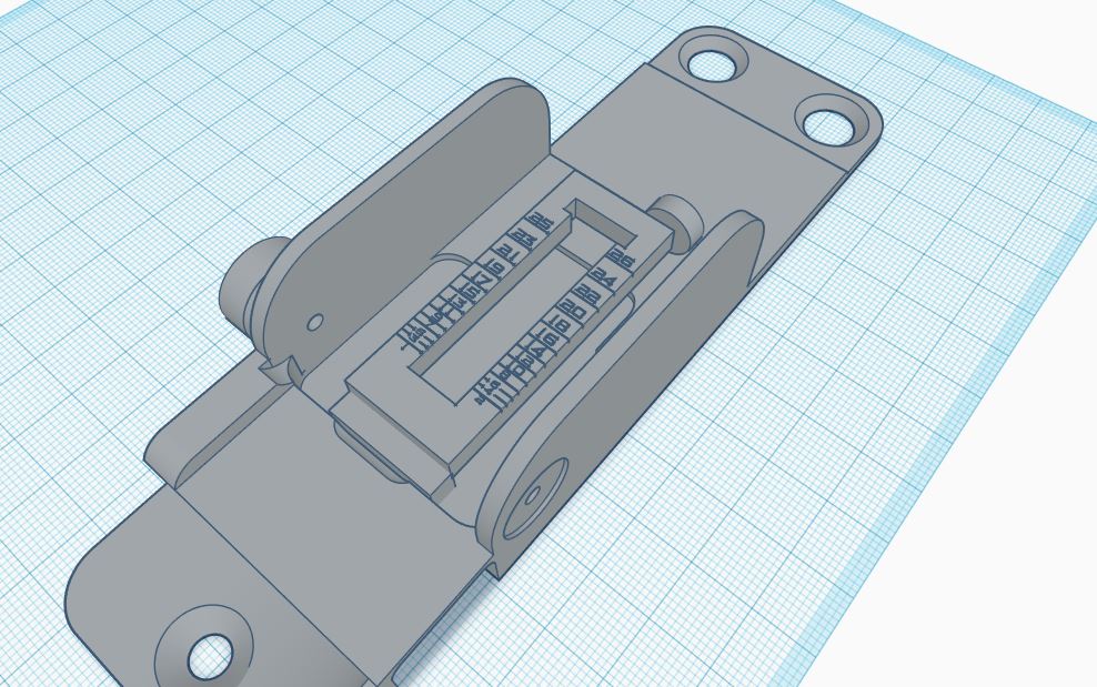

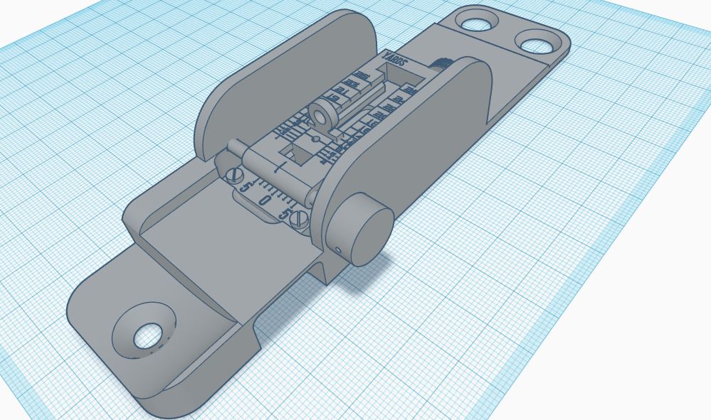

My design, not complete yet, and not exactly the same sight.
Due to the small details and graduations, the actual sight part will need to be printed on a SLA printer, since it is doubtful that a FDM will be able to show the detail.

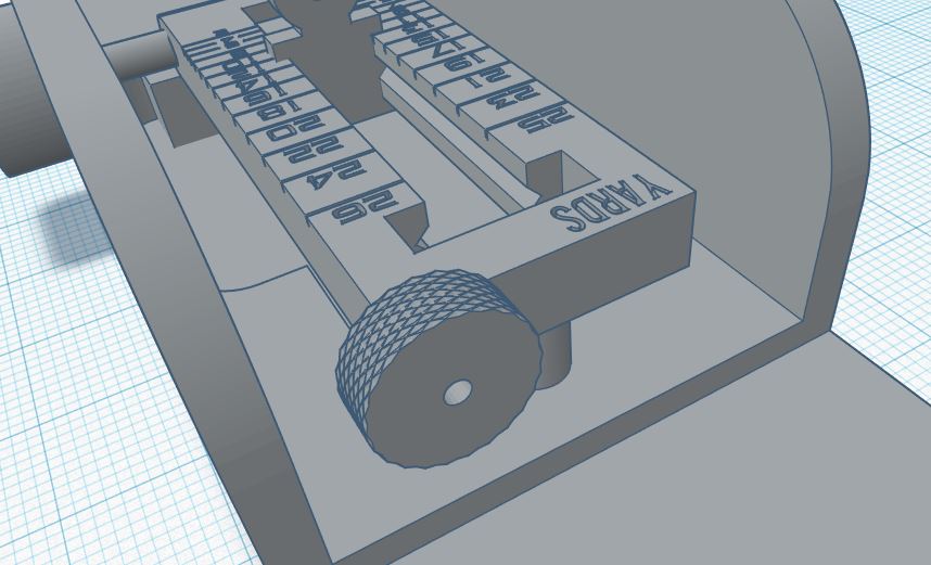

Some modifications with size and detail, but the first version of sight finished. Found an easy way to simulate knurling. The knob won't rotate the aperture(?) but it will slide up and down on the triangular guides. It wouldn't take too much to make it work, but there really isn't much more functionality that will add.

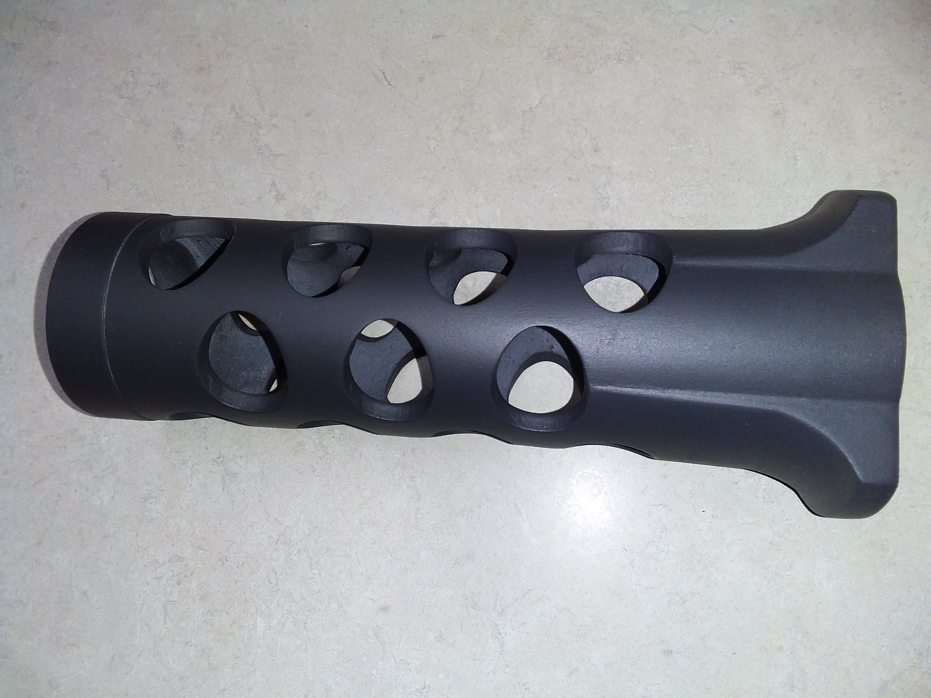

About 99% printed out. Started sanding and painting parts, just to see if the paint comes out right. This is the Chalked Charcoal spray paint from Rustoleum. It is darker than a parkerized finish I'm familiar with, but if you look at pictures of M2s in the field, (Army and Navy) the finishes vary from what looks like flat black to a medium grey. The colour perception is also dependent on the exterior lighting and the background. The first photo on the marble surface is from a 2700K and the next is from a fluorescent cool white at 5000K. Both pics had the tablet flash to supplement the lighting. I will have to try a picture in bright sunlight.

so is this the spray your own "chalkboard" paint? and did you seal it with a flat clear coat? it look's great! (y)
Looks good Taz.
I used Rustoleum 'Age Grey' Chalked Ultra Matte on my Death Star, to help fill in scratches and level it out. I was quite pleased how it turned out. I just wished it had the same consistency as the Tamiya grey primer, otherwise I would have used for my base color.
Thanks. No, its store bought called Rustoleum Chalked. No clear coat, just a single coat. It seems to take a little bit to fully cure. I started sanding the internal ring so as not to scrape off the paint on the barrel when I slide it on, and it lifted on my palm. It had 12 hours to cure, but I guess that is not enough.
I think I will either dry brush the edges with silver, or weather it to make it look a bit less factory fresh.

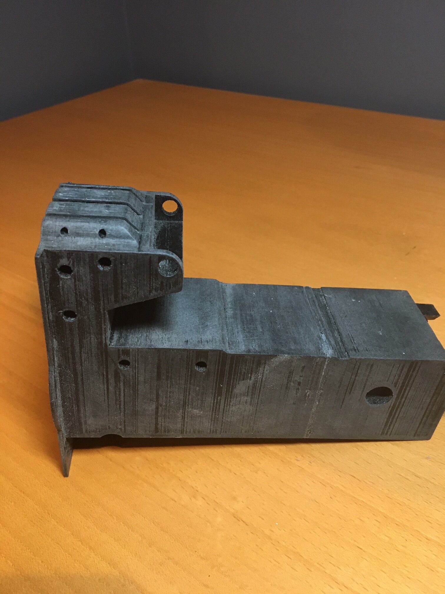

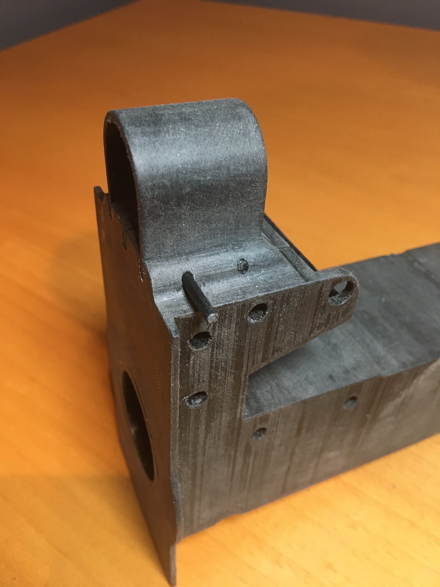

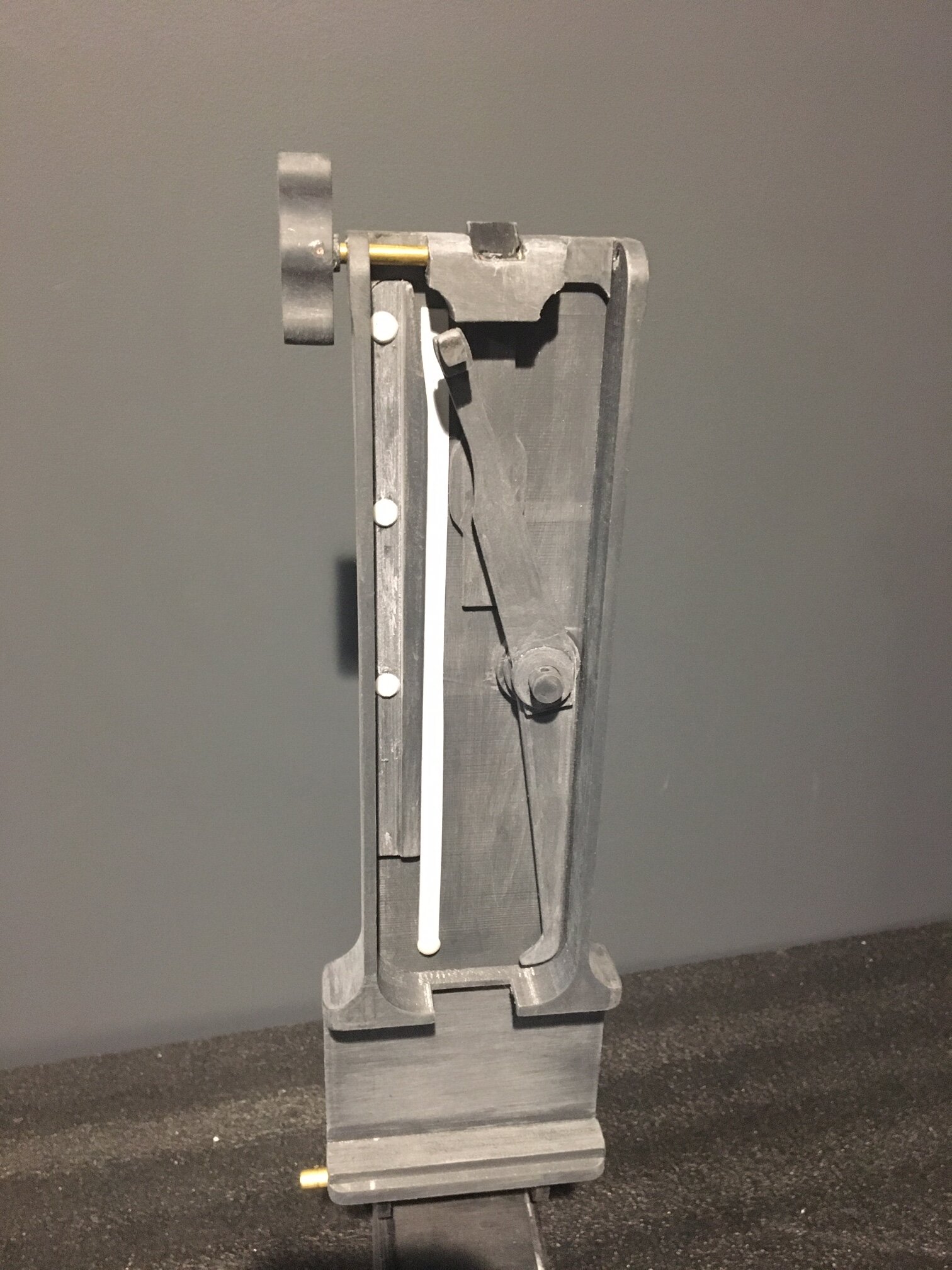

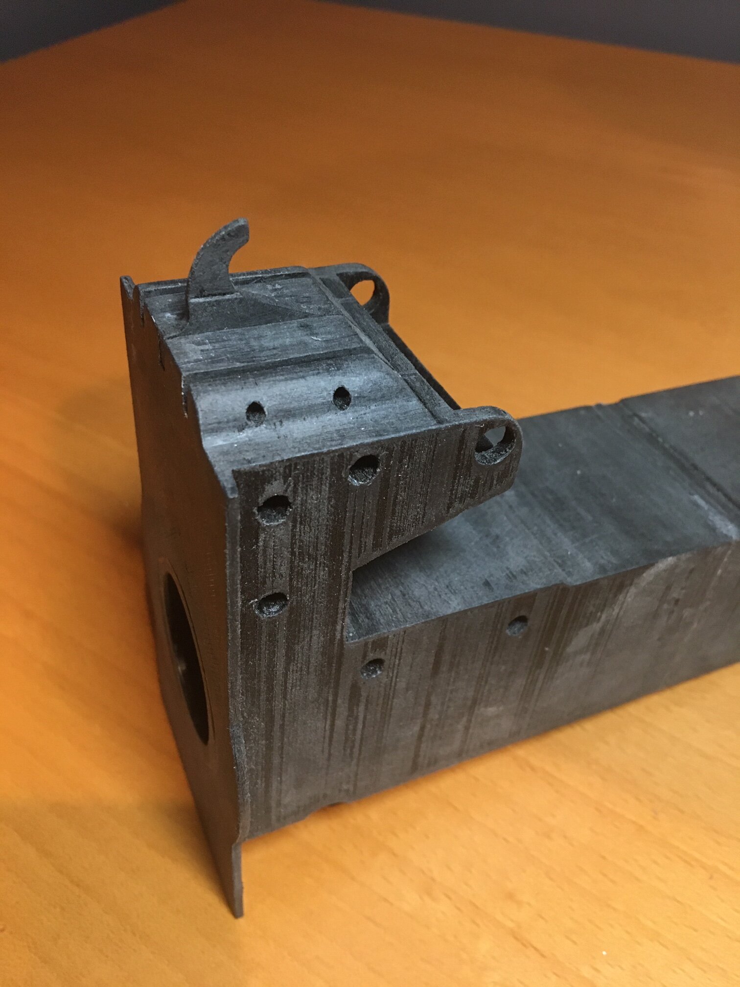

The trunnion block, which is the main part that holds the barrel on the M2 is completed and ready for paint. The front sight and sight hood, are modelled exactly like the real weapon and are held in with pins that are made from Bandai SW kit sprue. If the sight or sight hood breaks, they can be replaced.
Internal parts on the feed cover were also created. As I said before, this is not meant to fool anybody with close scrutiny, and the parts on the real weapon were designed to move the rounds into the weapon. My parts are just a facade.

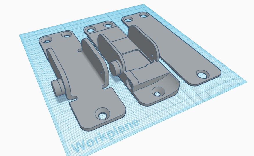

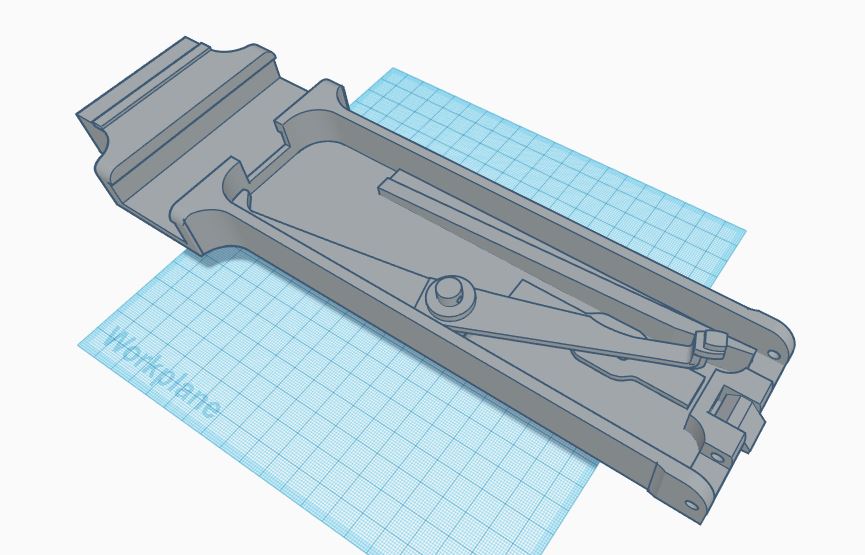

The Browning M3 is very similar to the M2. The feed cover is slightly different as well as the back plate.
Pictured here is the underside of the feed cover. The latch, is spring loaded and of course...latches.
