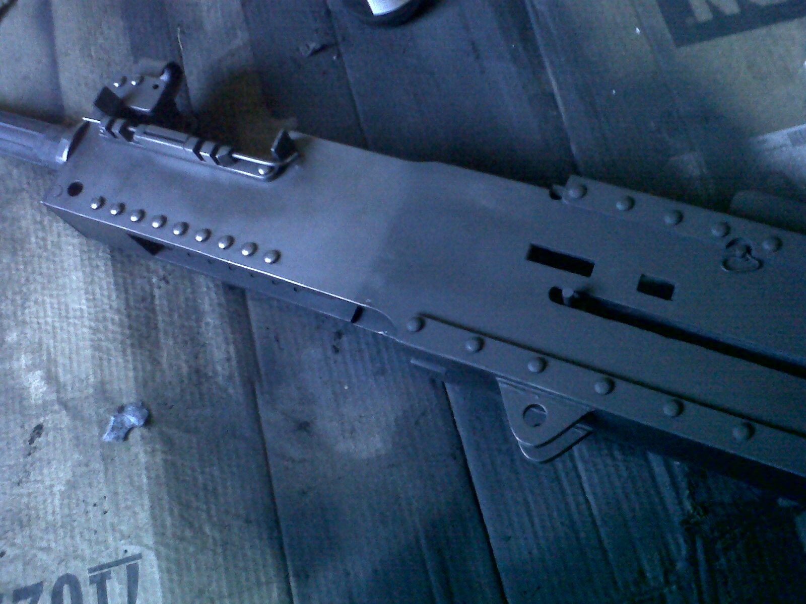

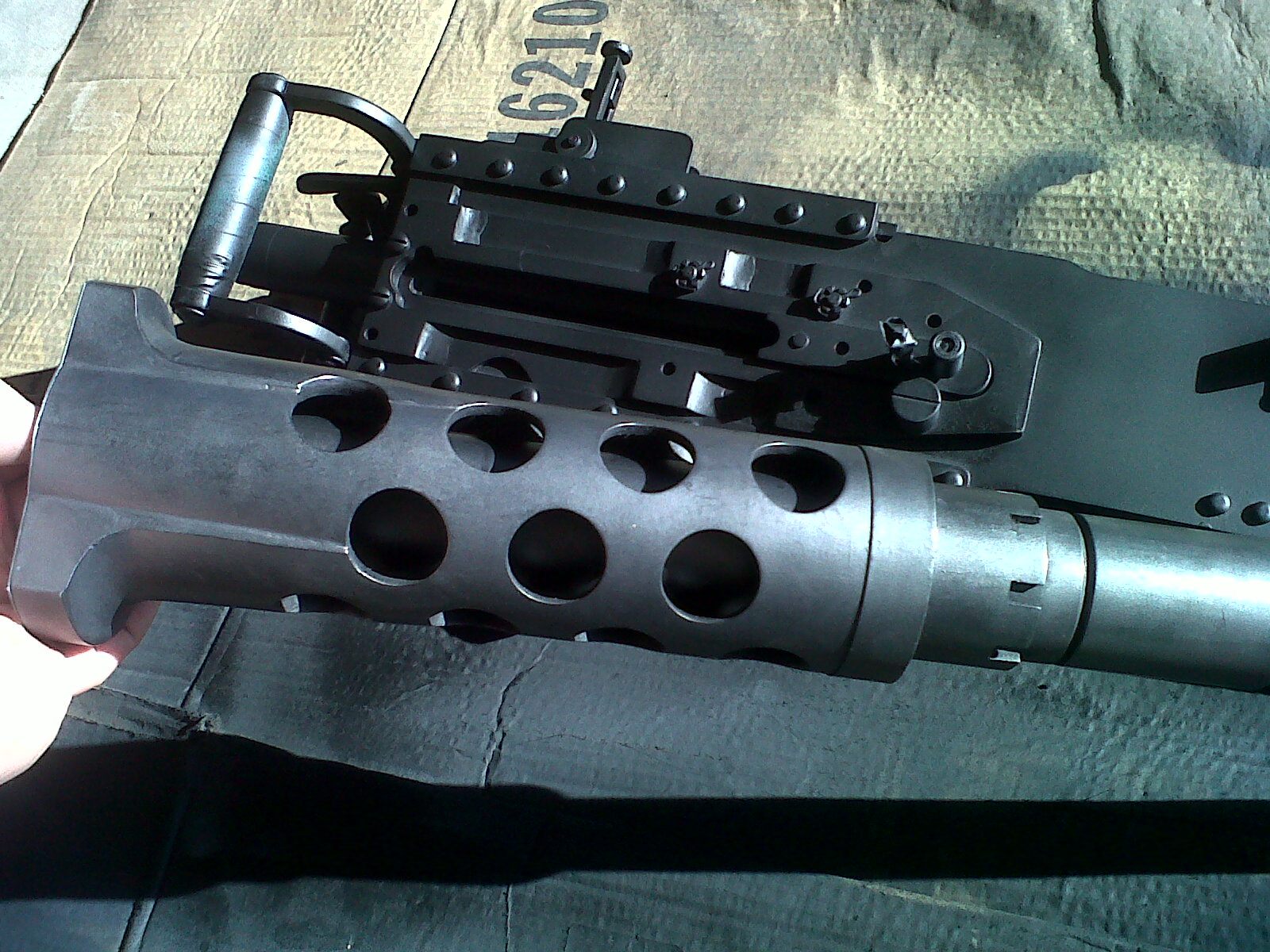

Taking a break from a lot of other ongoing projects to make this baby. For as long as I can remember, I have always liked this weapon. Basically the front is pretty well done but there is a lot of detailing to do aft of the barrel support (the thing with the holes in it). The feed cover opens up but I'm not going to replicate the internal moving components. Since this is made up of mostly styrene, a bit of wood and PVC/ABS pipe, this will just be for display, since it would never survive the vibrations of being mounted on a jeep or being handled too much in any way.
As always, I started this thinking it will only take me a few weeks. Several weeks later I'm still going at it.
A tribute to vets from all over the world.
TazMan2000
TazMan2000
Sorry for the grainy photos. Photos taken from a crappy phone cam.

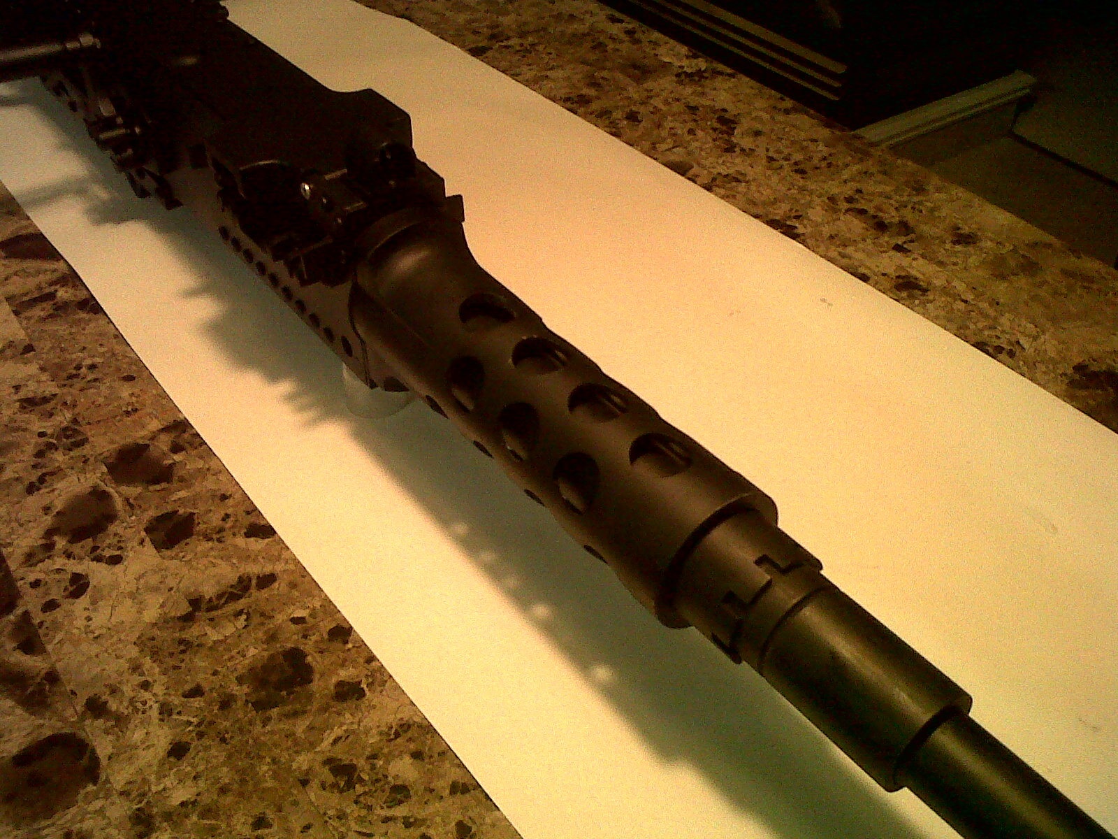

Finished building. Put a couple of coats of flat black on it. I think it looks too dark. Probably will try a lighter grey coat.
I'll take some more detailed photos with a good camera once I get this painted up.

Wow, color me impressed! I've fired that beast on several occasions and that is looking dead on. :thumbsup
Yeah, the black is too dark. I would suggest Tamiya Color for Aircraft "Gunship Grey" AS28.
That looks to me to be the closest to the MilSpec finish the M2's have.

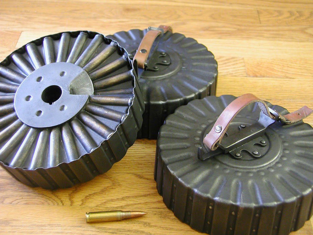

Very cool! I did an M1919 in a similar fashion for a short film a while back:
It's motorized so the charging handle goes back and forth when you pull the trigger just to simulate the movement. The muzzle flashes were added in post.

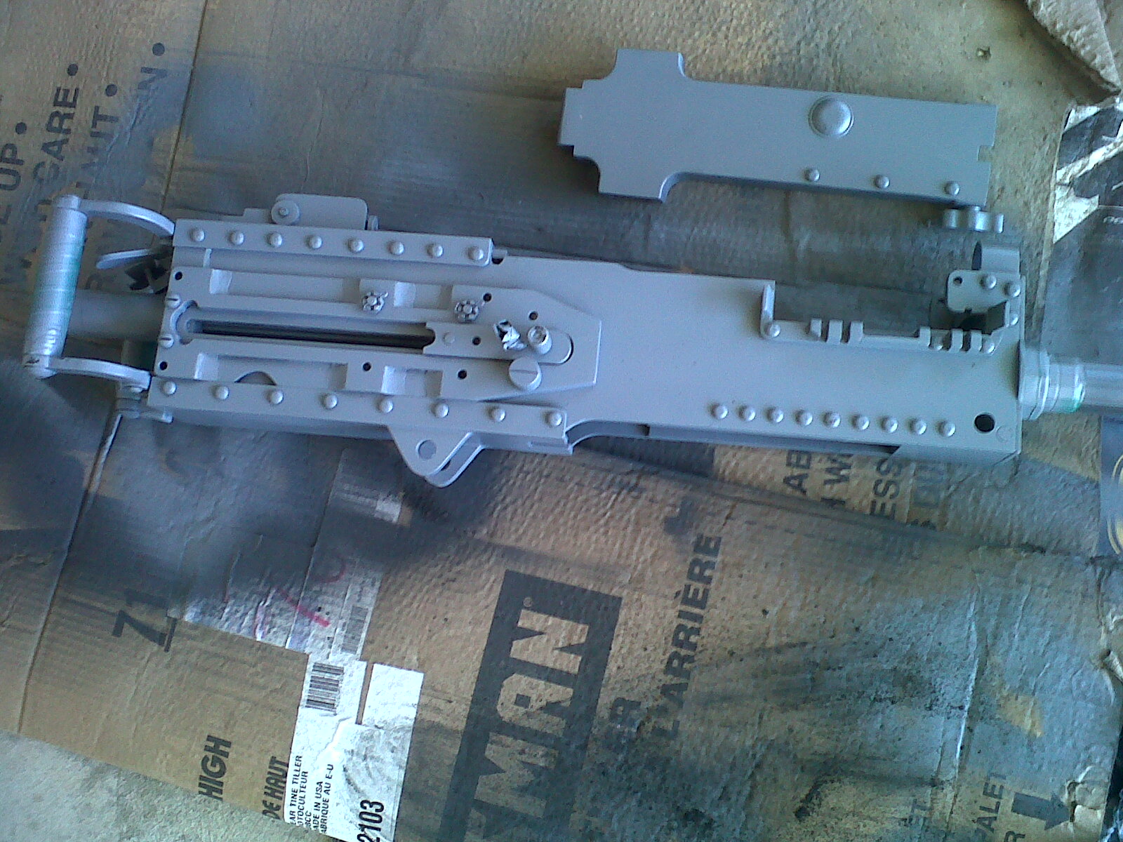

I used Tamiya's AS27 paint, and it came out way lighter than expected even on a flat black base coat. Even factory fresh, I think that the M2 didn't look like this. I'm going to try your idea Mr. Nagata. Is this the graphite powder for drawers and hinges that comes in a tube?

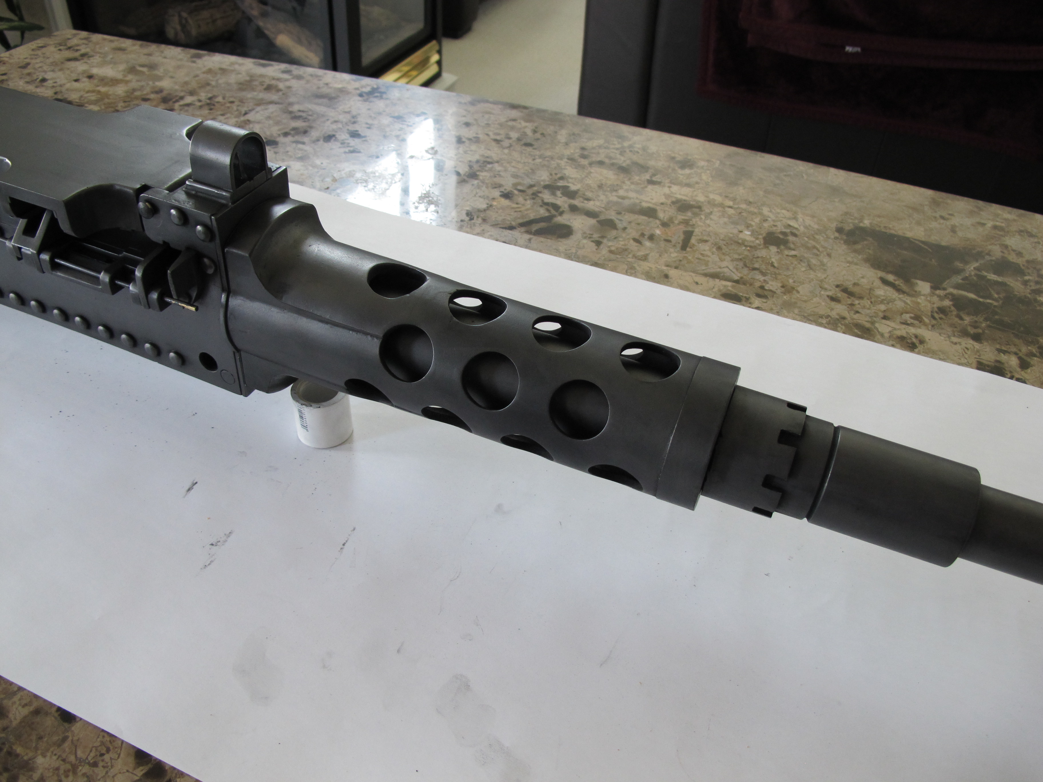

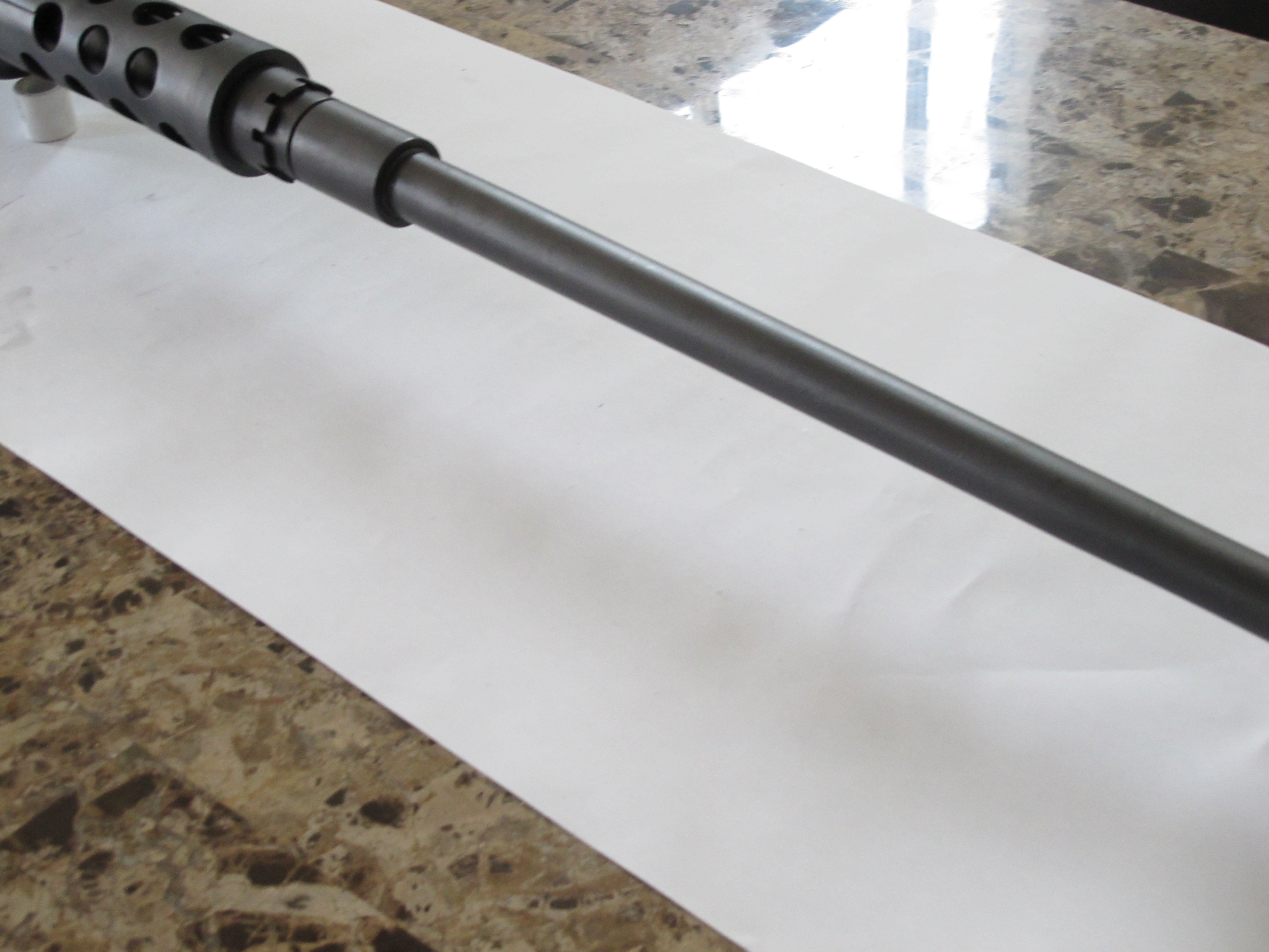

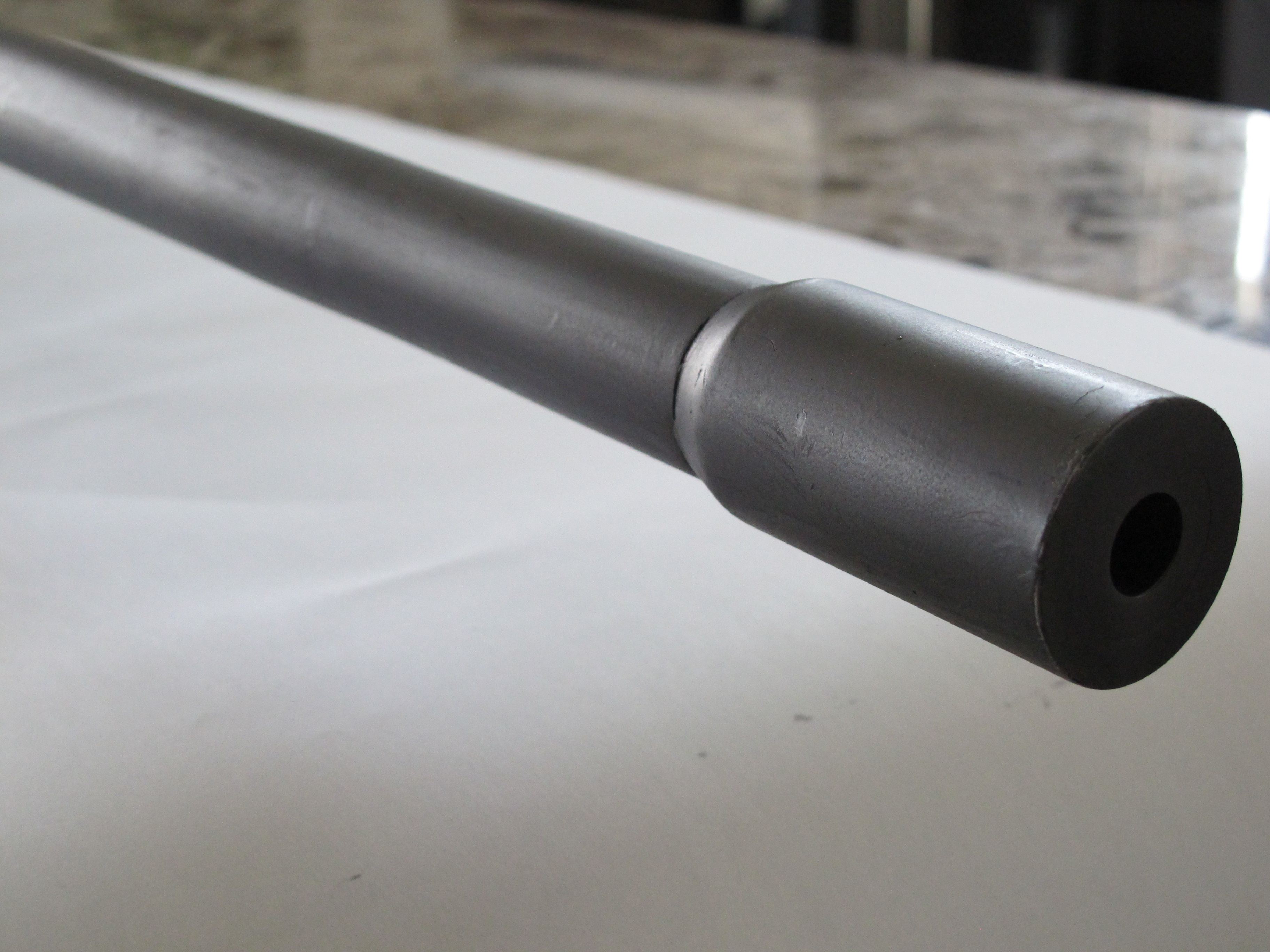

OMG!!!! What a great trick Mr. Nagata! I tried it out on the barrel and barrel support which was still painted black and it turned out amazing. I couldn't believe the result! I felt like King Midas for a second, where every where I touched with the graphite powder, turned to steel in my case. Thanks for sharing that.

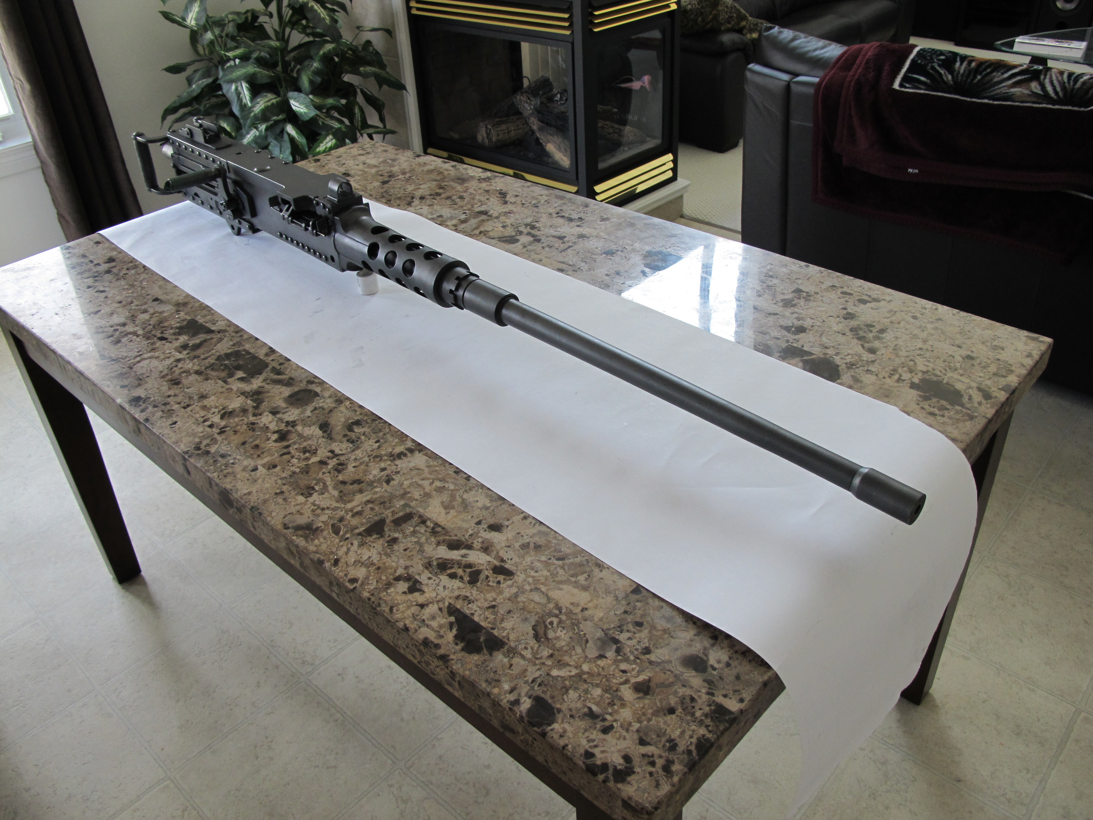

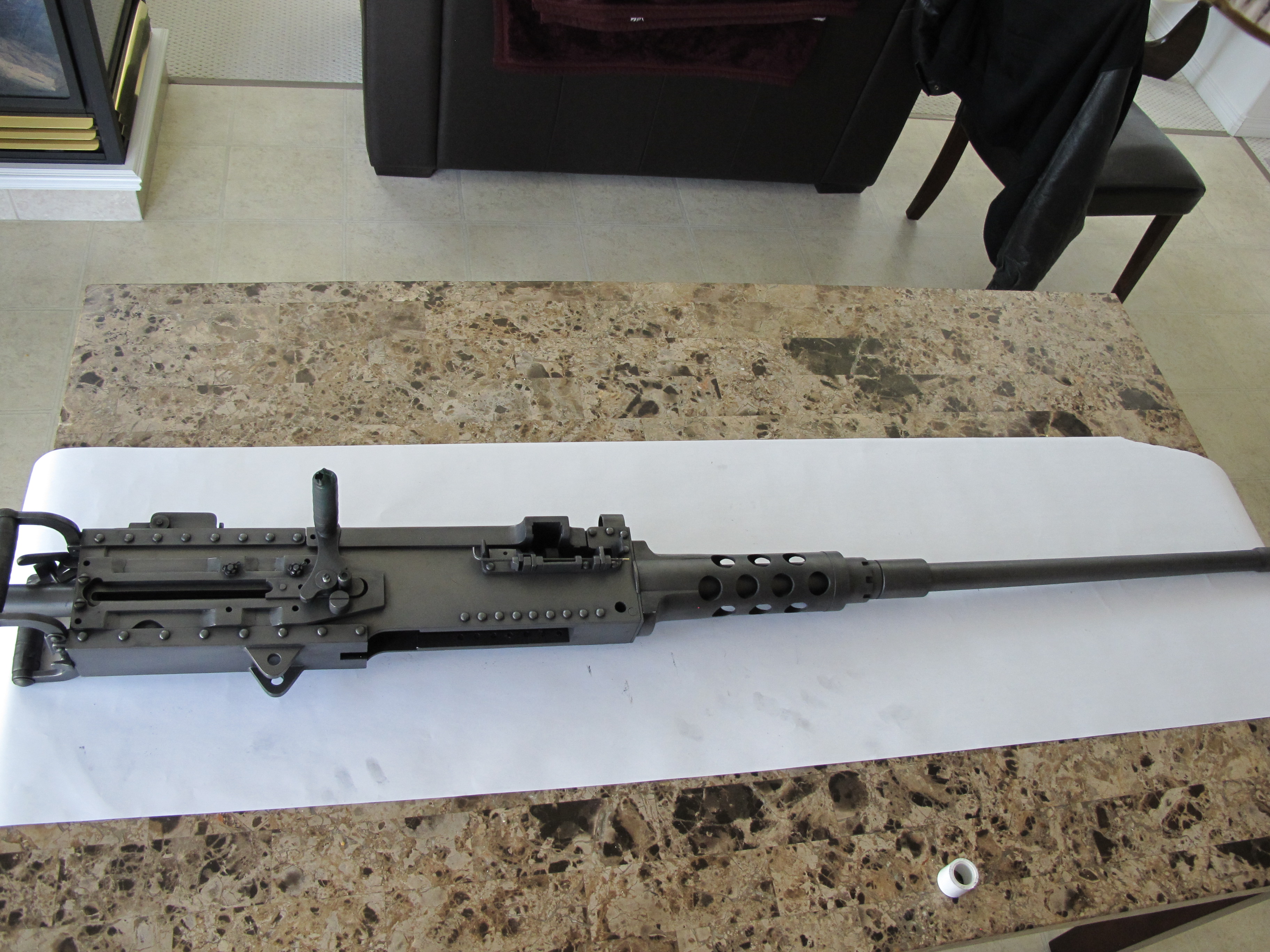

The first image is the flat grey color I painted it. Nice, but it was as boring as the flat black and neither were convincing to any degree. The next is the barrel and support. My cell phone camera doesn't do it justice but you can see the beautiful sheen the graphite gives this piece.

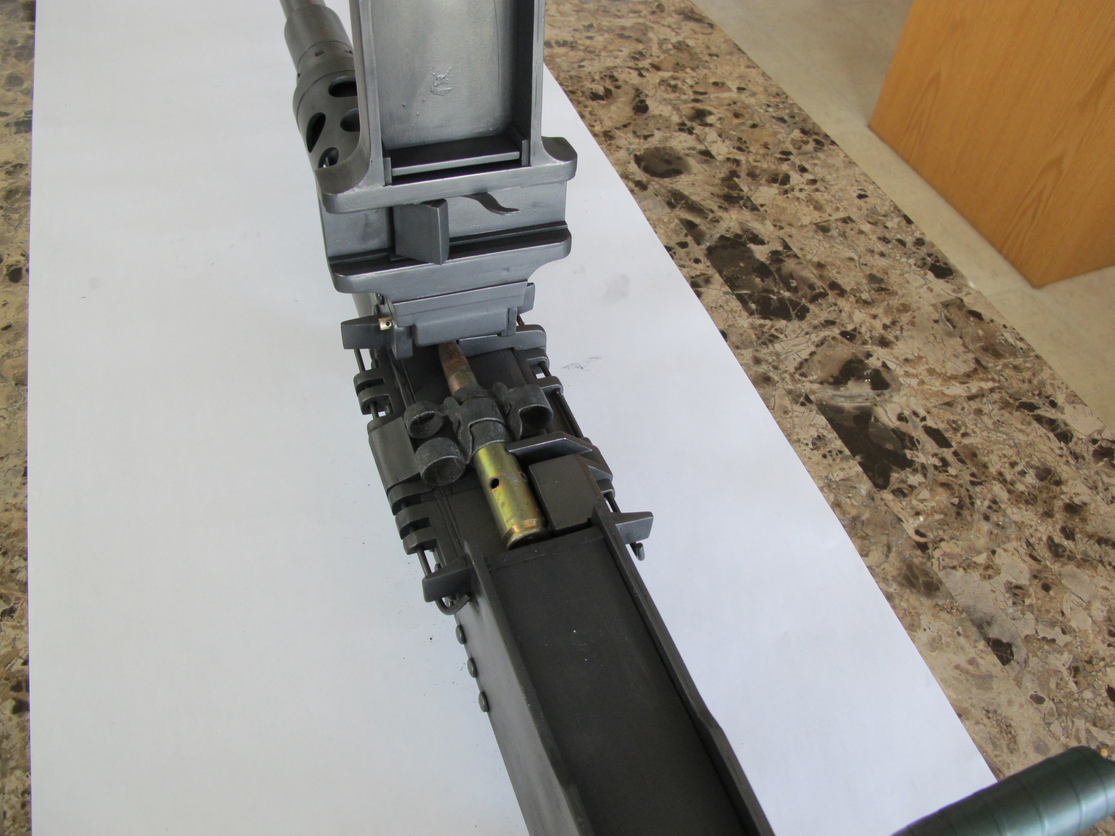

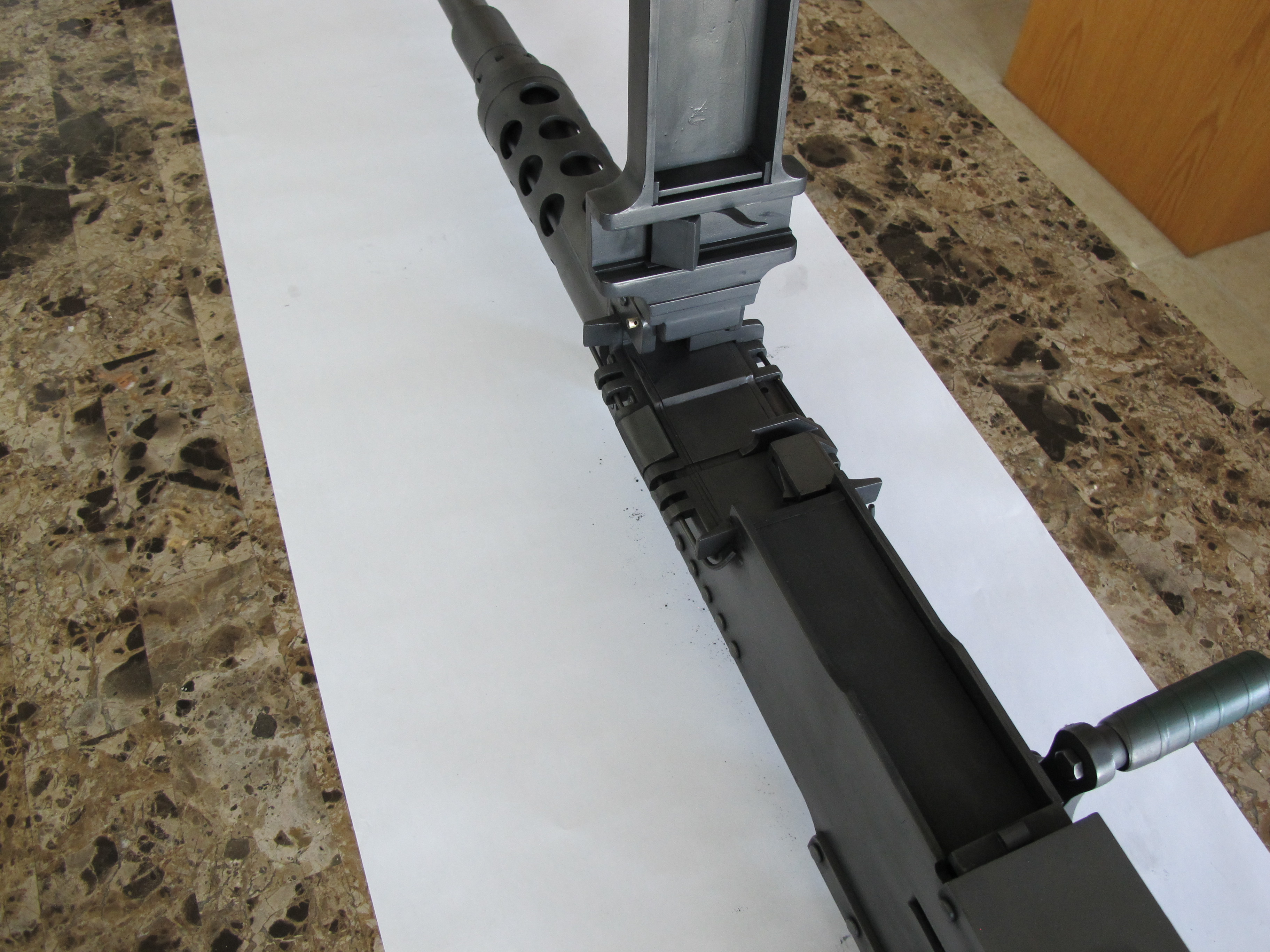

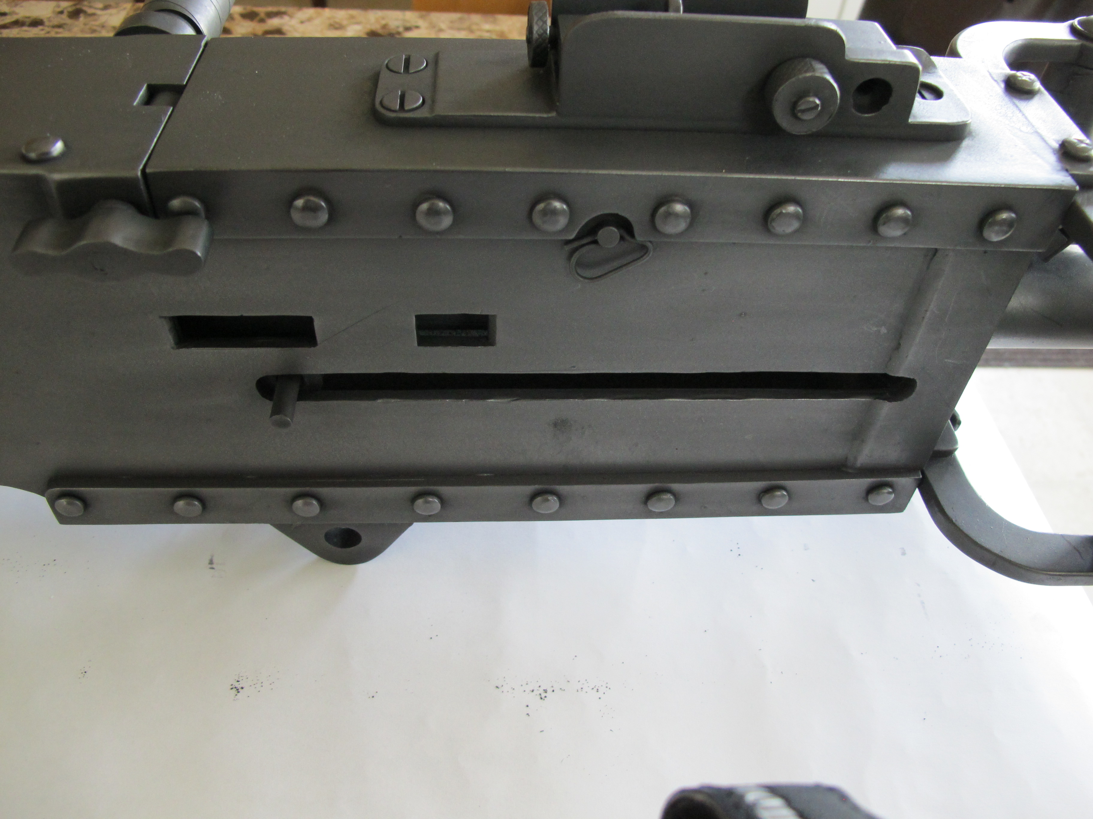

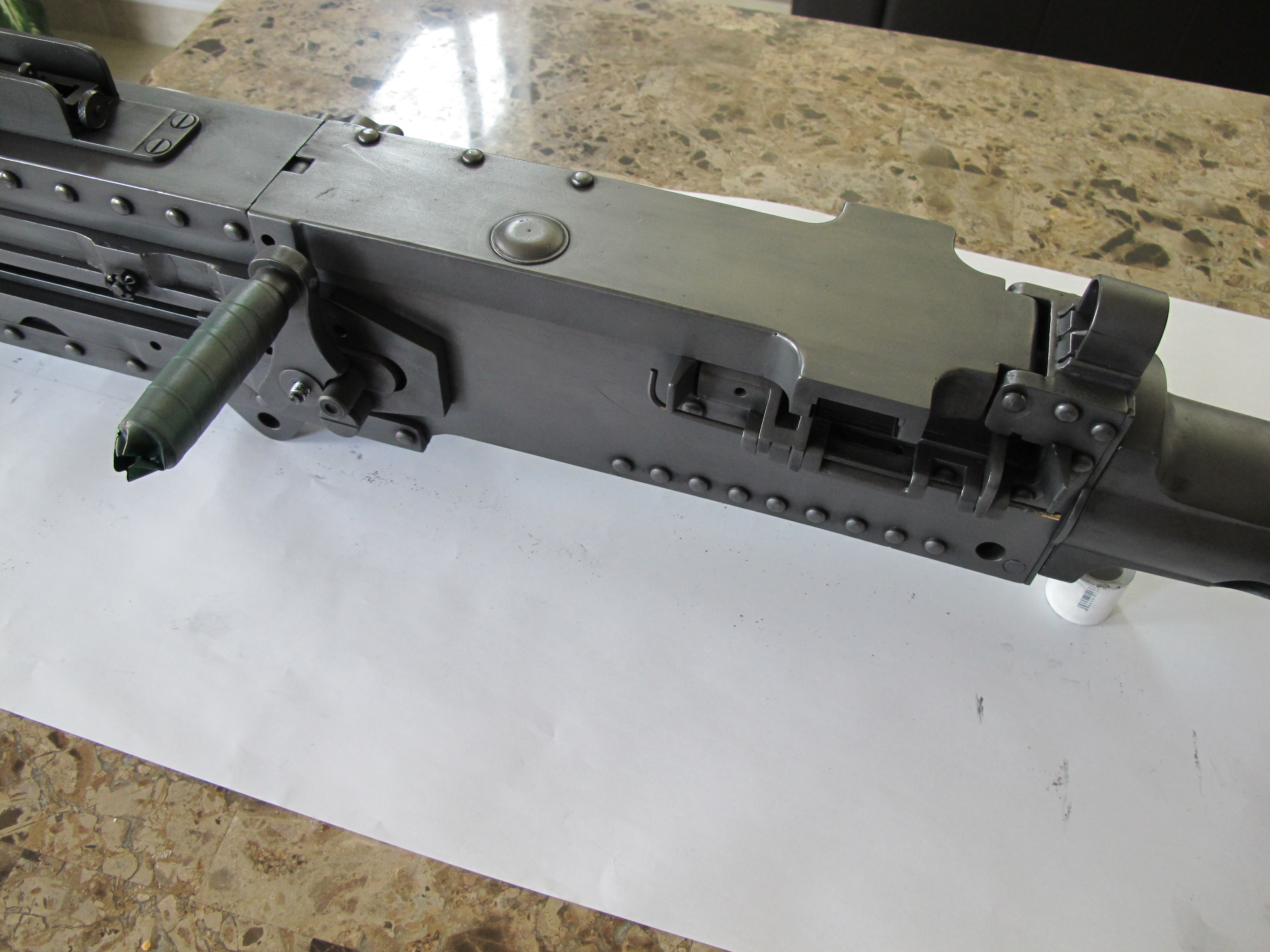

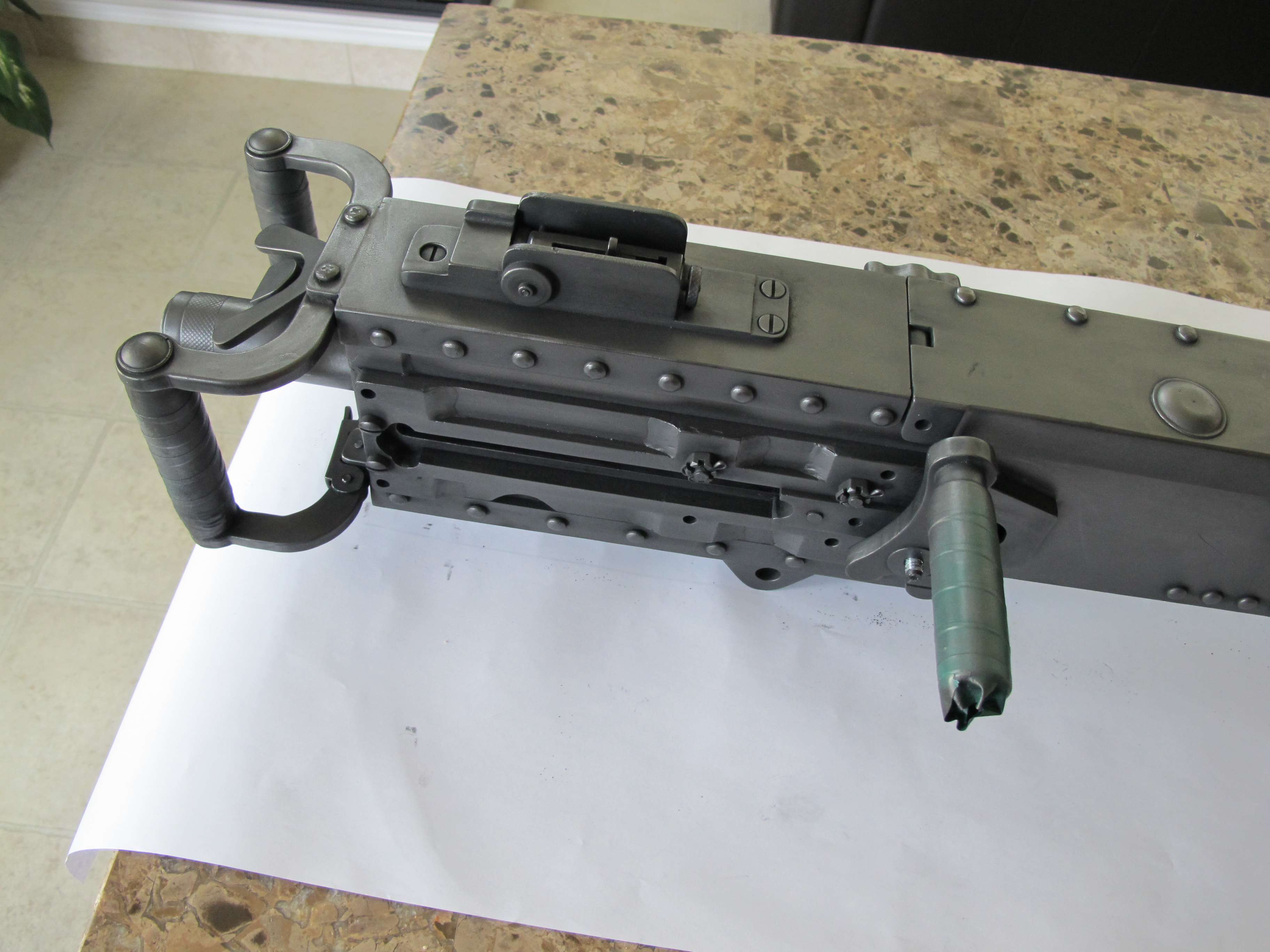

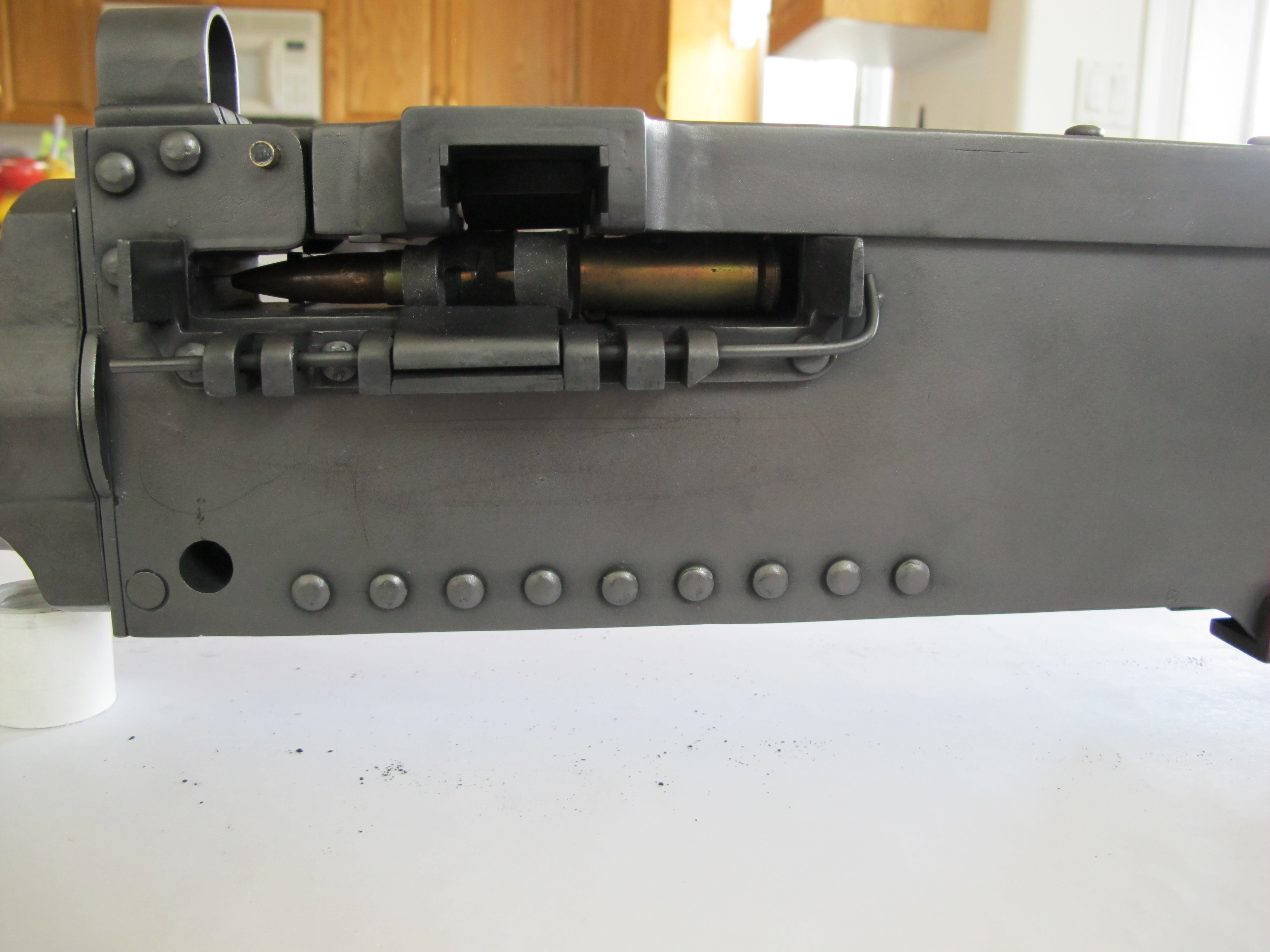

As promised some higher rez shots (Except for the first one).
A lit of bit of touch up to do, but as you see by the first pic the difference that the graphite powder makes. Many thanks to all who showed interest in this and helped me to make this project better. Be warned that this graphite powder has been found to cause cancer in California and it really gets everywhere so take precautions if you try Mr. Nagata's trick. It's definitely not meant to be handled after this stuff is applied because it does come off on your hands as Mr. Nagata told me. Not certain, but perhaps a varnish or fixative is needed.
