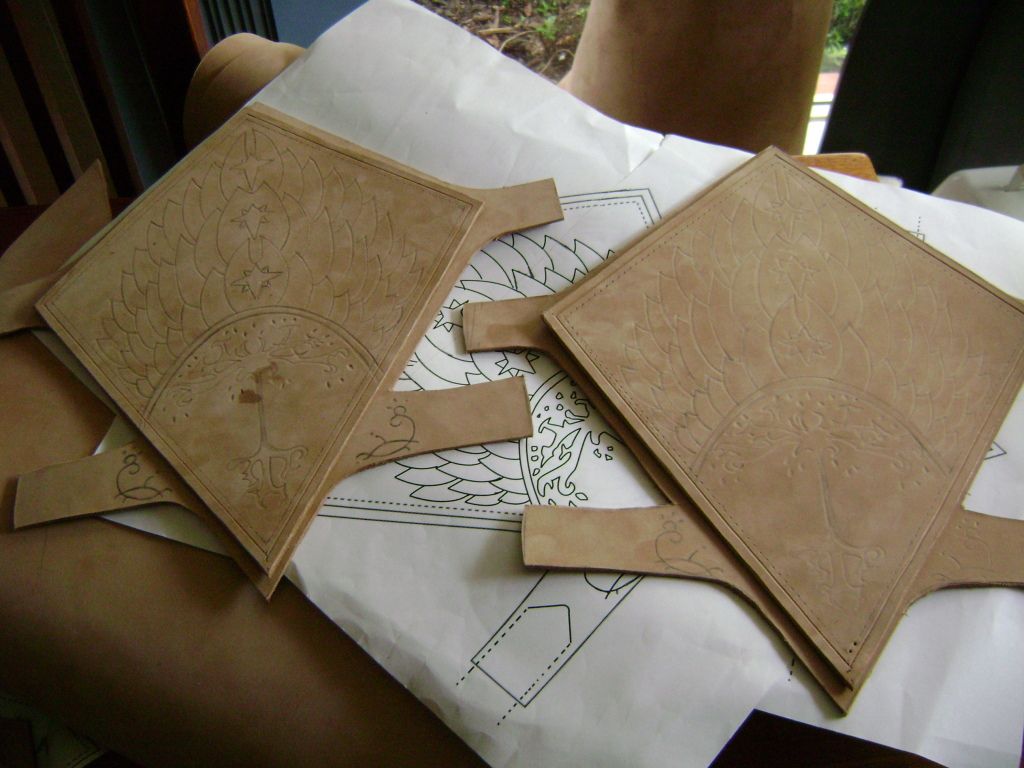

So this past week I've been working on my Bracers of Gondor and here's how I've gone about doing them:

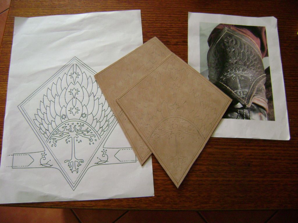

After drawing up a template in illustrator, tracing photos of the screen used pair I then cut out my pieces of leather, then transeferred the design to be tooled onto the leather with a pencil. I then did the grooves along the edge and marked the stitching placement with an overstitch wheel:

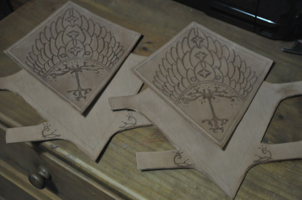

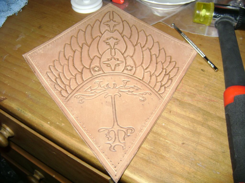

Then I punched the holes in for stitching and then begun tooling the design into the leather pieces:

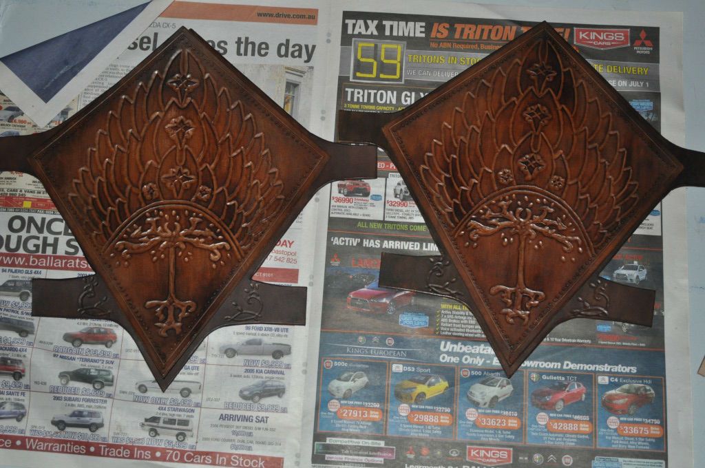

Then, once that was all done I was up to the fun part, dying the leather :) :

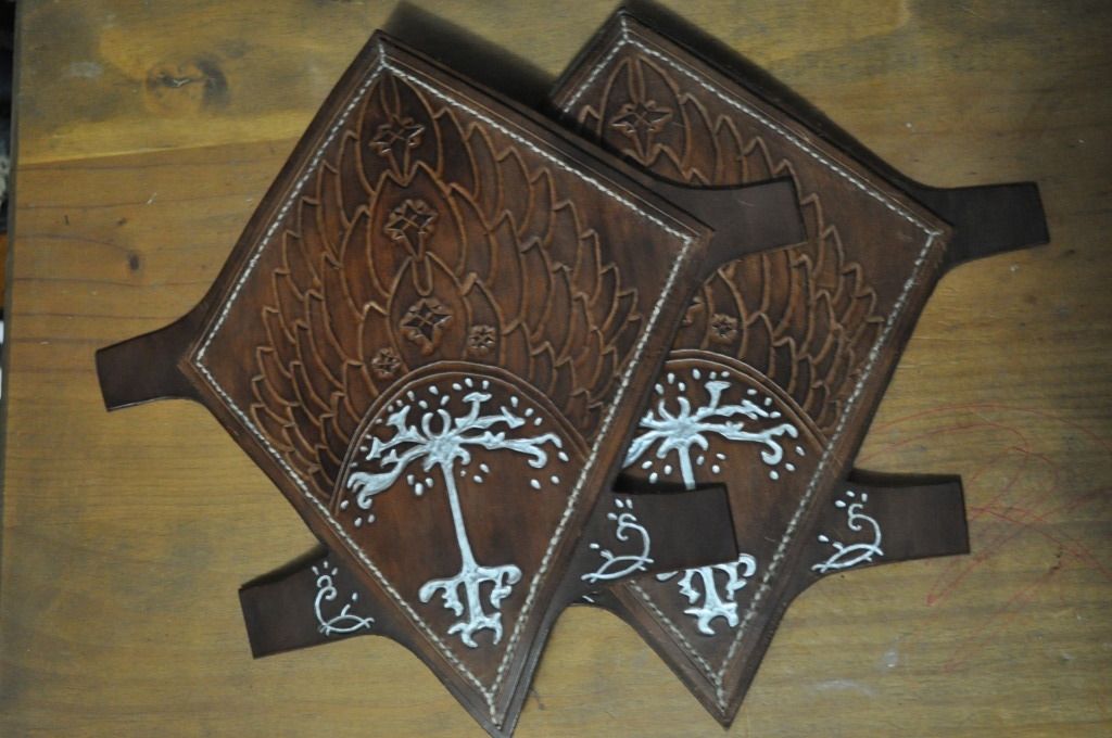

I also gave them a light coat of antique finish to age them a little then added the silver detailing:
I then spent my weekend hand sewing the the two layers together on each bracer with some waxed thread, my least favorite part so far >.<:
So apart from sore hands from sewing these together I'm really happy with how these are turning out, especially since it's my first attempt at hand tooling and sewing leather.

Been following this for a while now. I gotta say your work is amazing! The level of detail is intriguing. First time leather work? :thumbsup
:eek First time??? I'd say your work is incredible for your first time!

I'm really enjoying leatherwork so I hope to do lots more in the future and hopefully that will include some hardened leather armour of some kind eventually :)

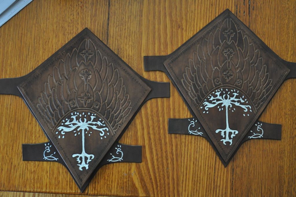

OK, so in a mad rush to get the Bracers done for the photoshoot this past Saturday I didn't get any more progress photos but here they are finished:
