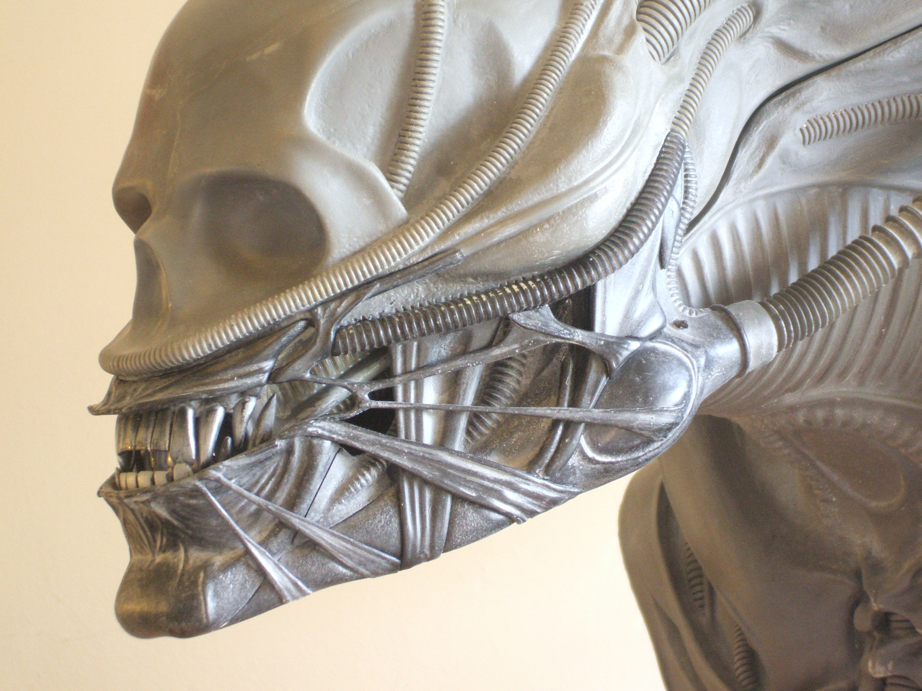

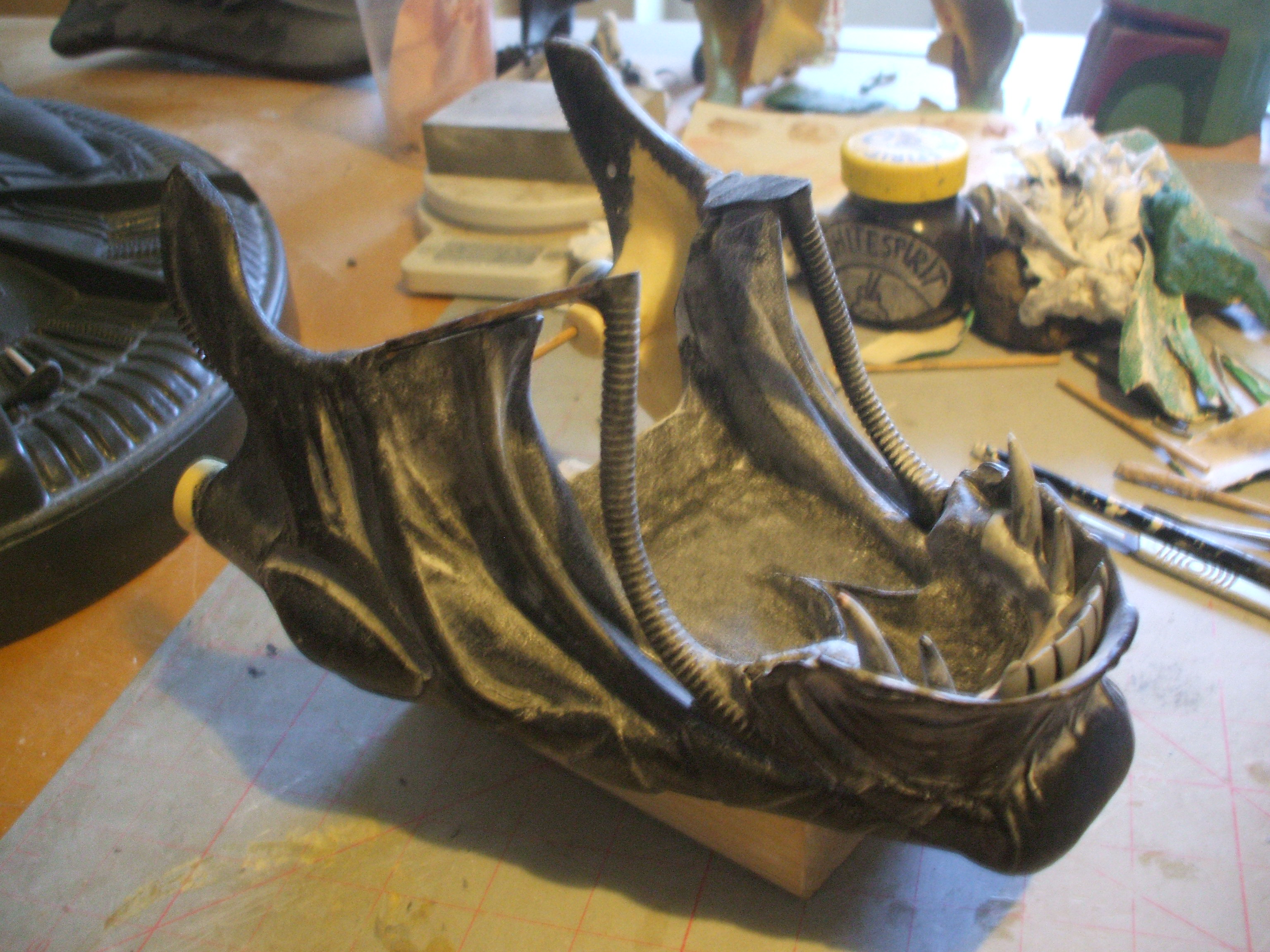

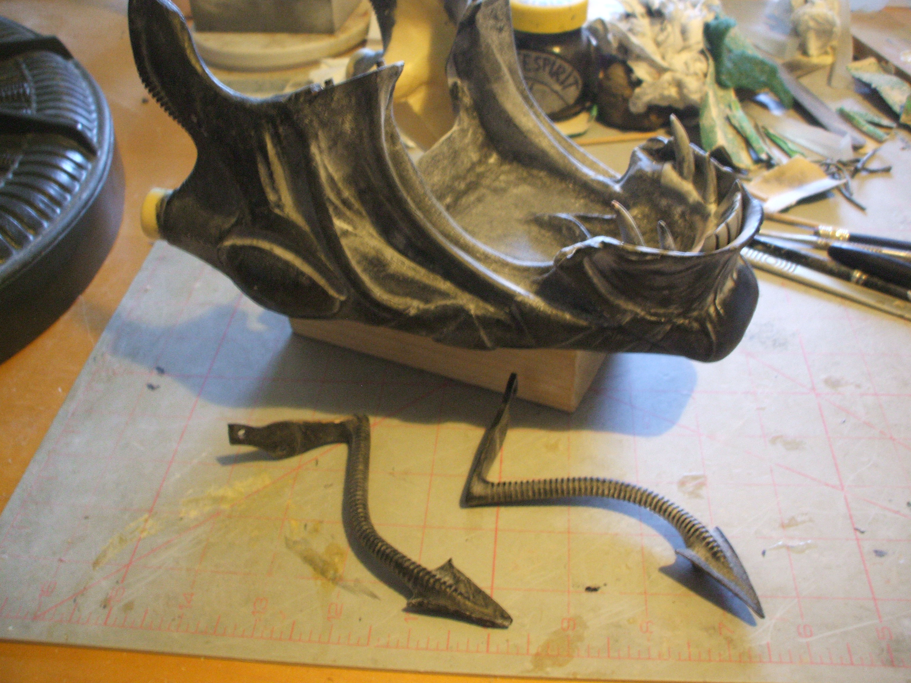

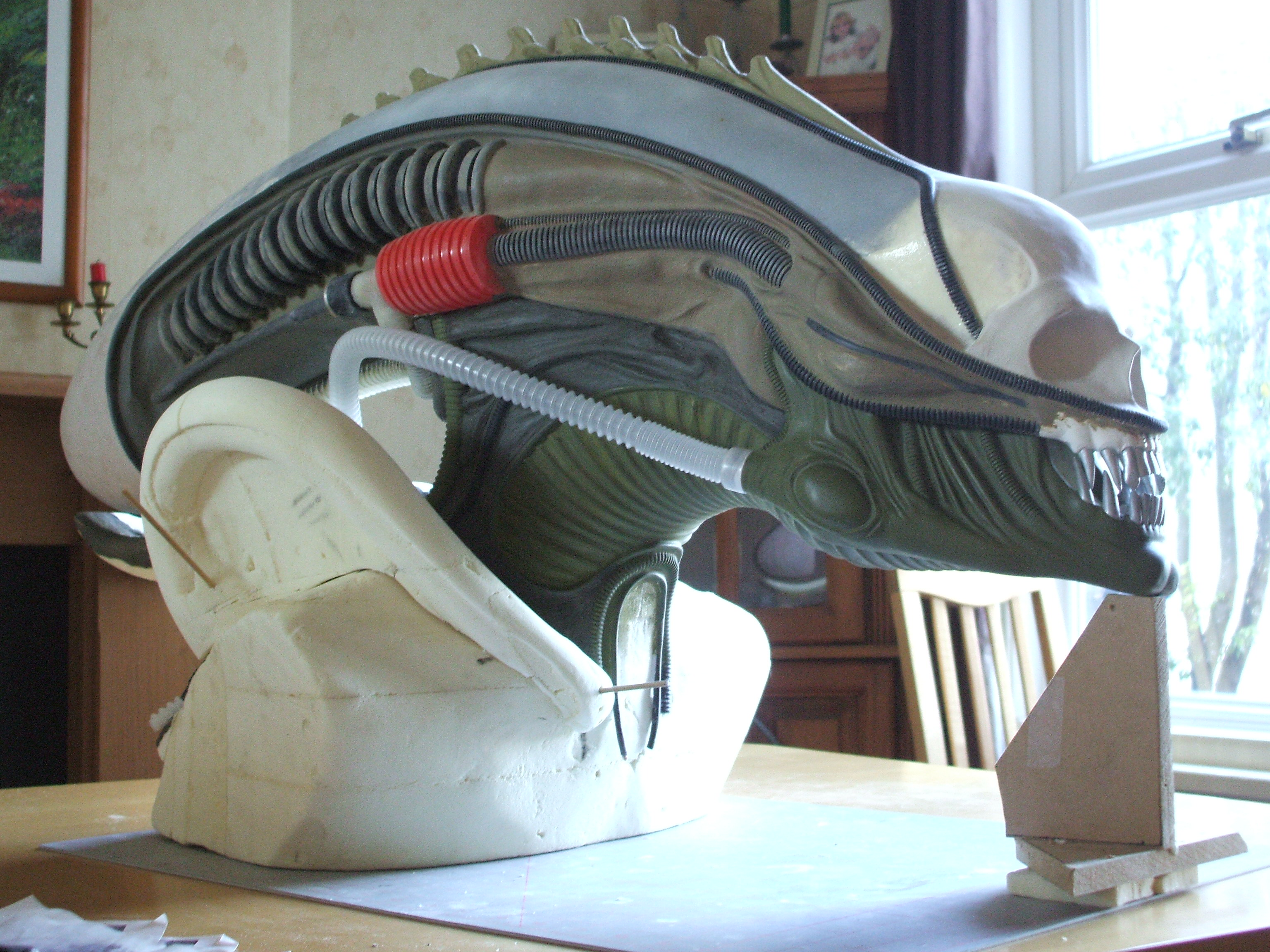

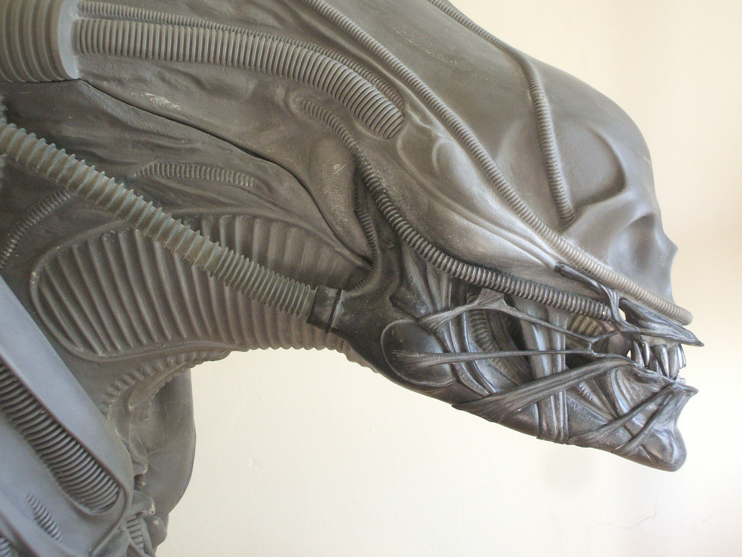

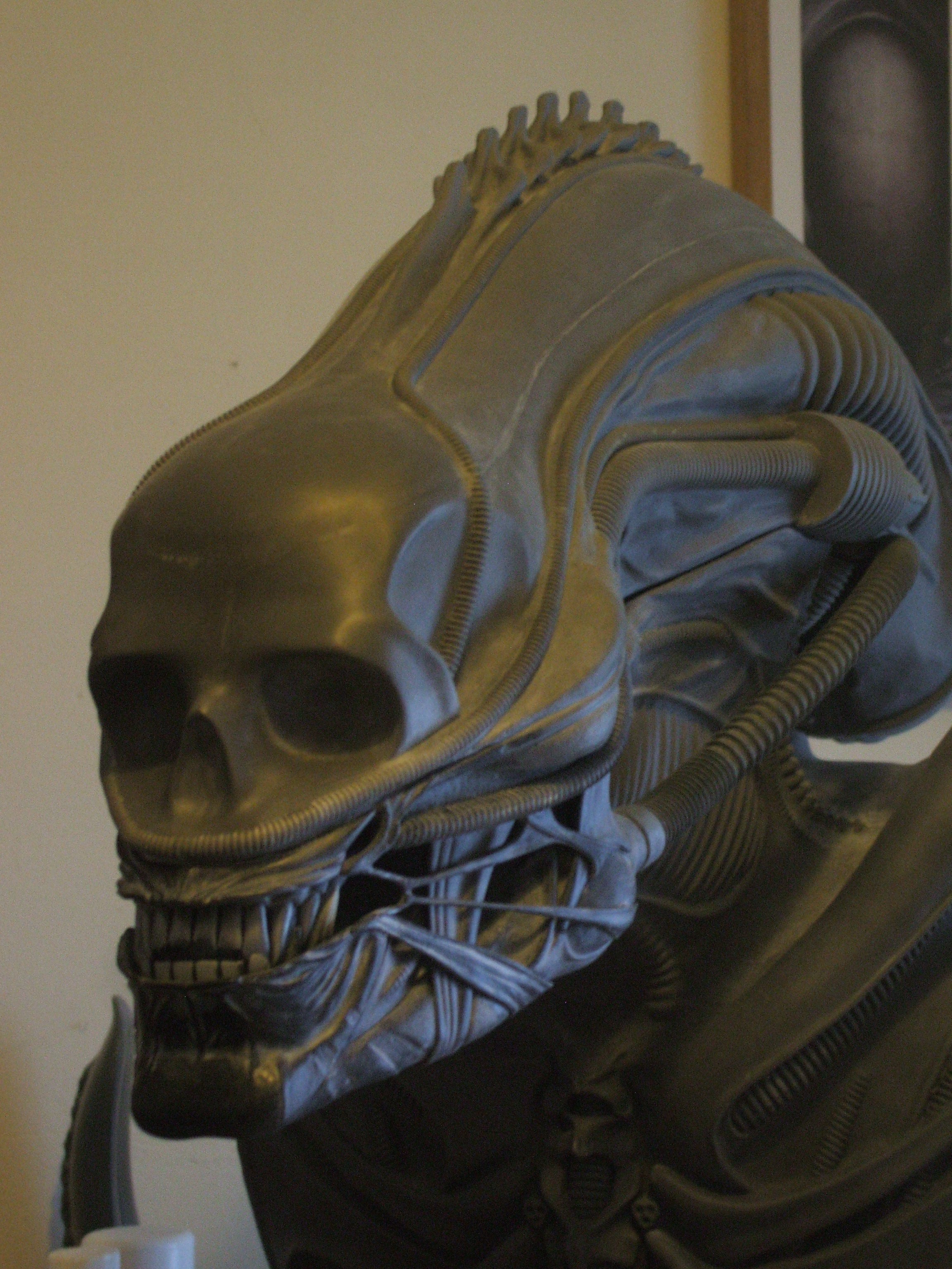

As I mentioned above I modified the jaw. Quite a lot of work has gone into this & lots of subtle changes. The extra tubes are there to represent parts that do appear to be on the original in the ref's I'm using, its difficult to see exactly how they look but this is what I've gone for :) The flat area's inside the mouth will have a rubber insert fitted. This insert will be a bit like a sock that'll fit round the tongue & will have extra detail (not too much though) & the tongue will slide in & out through it. This insert part will be completely new as there wasn't one (to my knowledge) on the original.
Here's a couple of pic's :)

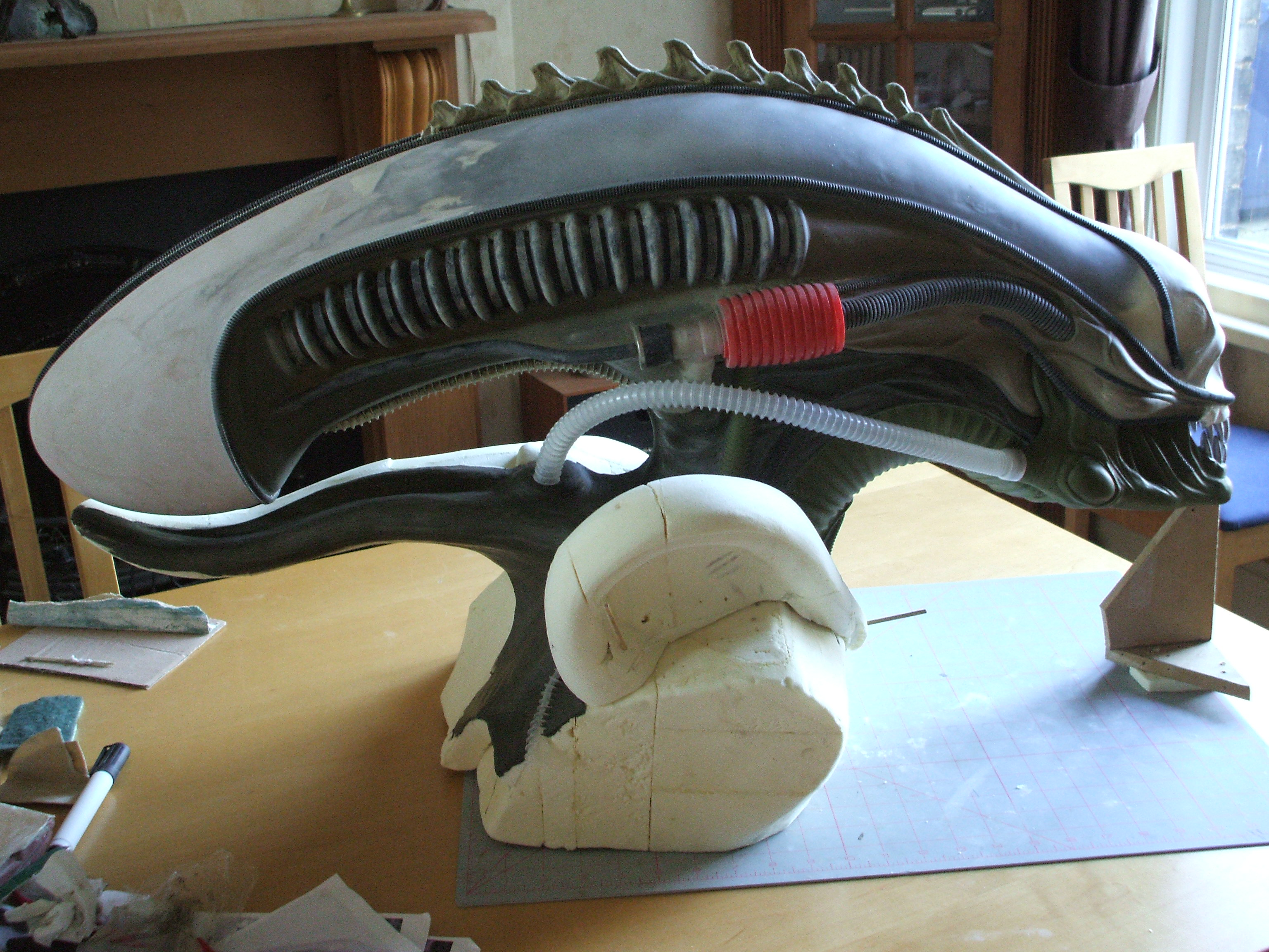

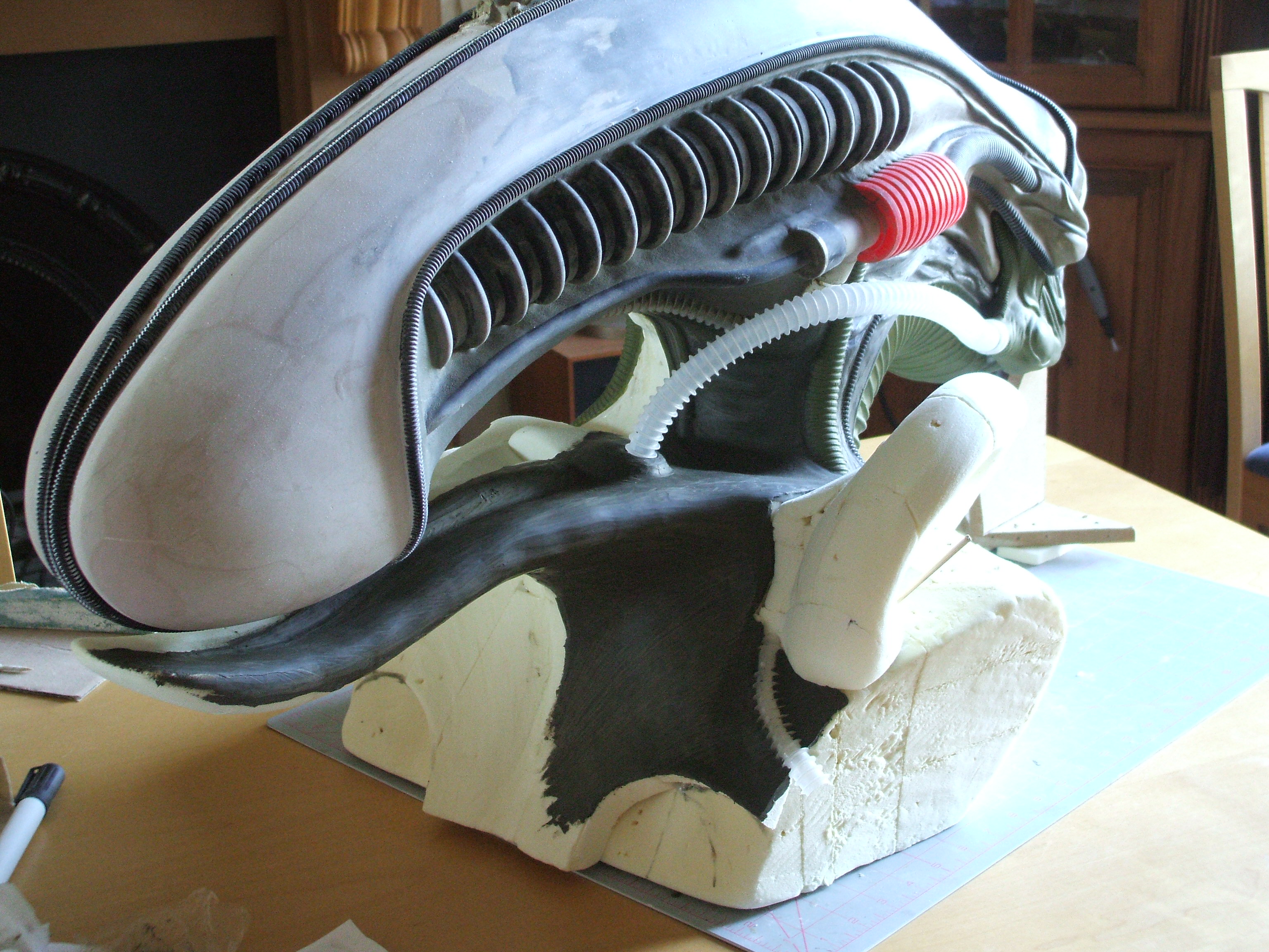

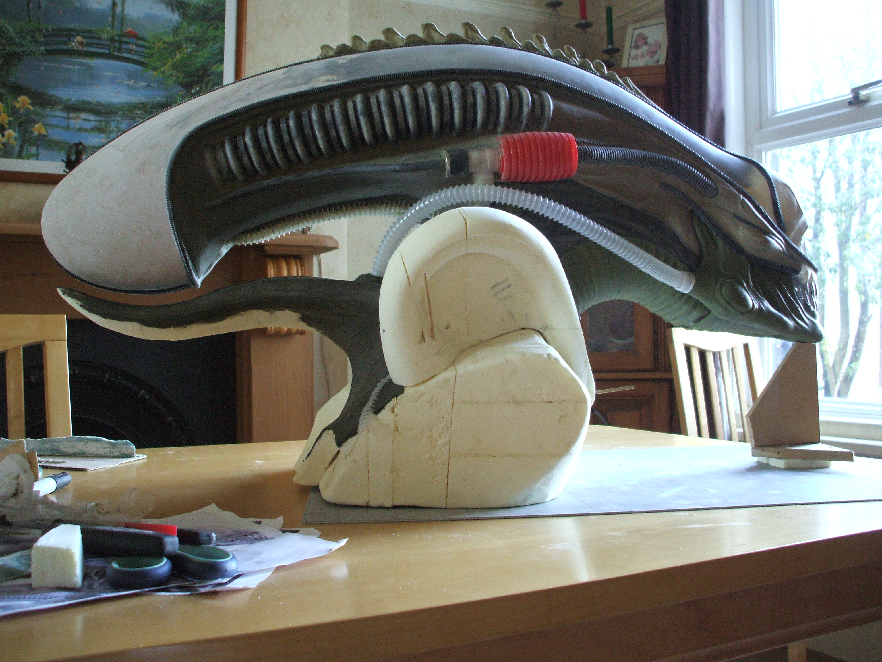

So what are your next steps?
I've got a little more work to do to the back of the jaw & some texturing. I've got some subtle modifications to make to the upper face part of the main head casting & then some tweaking to the head mould to accommodate the changes (that'll be interesting).
Then I've got to make rigid moulds for the rubber parts & test the casts to make sure they work how I hope they will :)
I've got some silicone moulds to make for the lips, the cheek tubes & the throat flap.
Then I need to decide what to do with the dome :/
It reads like a lot but the list is getting much smaller :)
