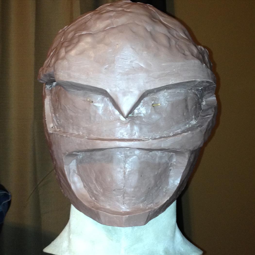

#1 Don't purchase your products until you have something to mold! I purchased all my products naïvely believing I was going to make a full Iron Man suit (let's just say pepakura isn't for me). When this didn't pan out, *gasp* they sat on my shelf for a full year before I put them to good use. To my credit, I decided in September of last year I was going to do the Blue Ranger and I made it happen! Fortunately they were still good but they just as easily could have expired and I would have been out $250 dollars.
#2 Buy at least 10 pounds of oil based clay if you're wanting to do a helmet. I find that it takes at least that much to cover the adult male head to the proper thickness and proportions of most helmets. Get your self a good, sturdy armature (ideally I would advise making a lifecast of your head). If you use one of those foam heads you're going to need more clay, the diameter of the head is not life sized. I used monster clay and I recommend it.
#3 Maintain a center line around the whole sculpture. I only maintained a center line on the front of the helmet where the majority of the features were and I paid dearly for it when it came time to do the body work. LOTS of Bondo was called for. The asymmetry will only be visible if you have the visual queue that is the center line. Asymmetry doesn't stand out on the basic, overall shape of a helmet the way it does when you have a feature out of place. In other words, in the case of the Blue Ranger, it's easier to tell when a horn doesn't look like it's in the right place than the back of the helmet isn't filled out enough on one side.
#4 Don't add features until you have achieved the basic shape. Obvious, right? It's only obvious if you realize you still haven't attained the basic shape. The worst way to realize you haven't is when your features don't line up despite your best efforts. To put it another way, don't put your beautifully wrought features on an ugly canvas. This can be a tremendous time sink if you have cut off something you've sculpted, reshape the area, and try to reintegrate the piece you cut off back in. It may turn out that you can't and have to resculpt it.
Here are just a few pictures of the sculpture's humble beginnings. The holes poked in the sculpture of course represent where my eyes would be. After I'd added the lips the holes made the sculpture look hilarious so I had to cover them just to concentrate.

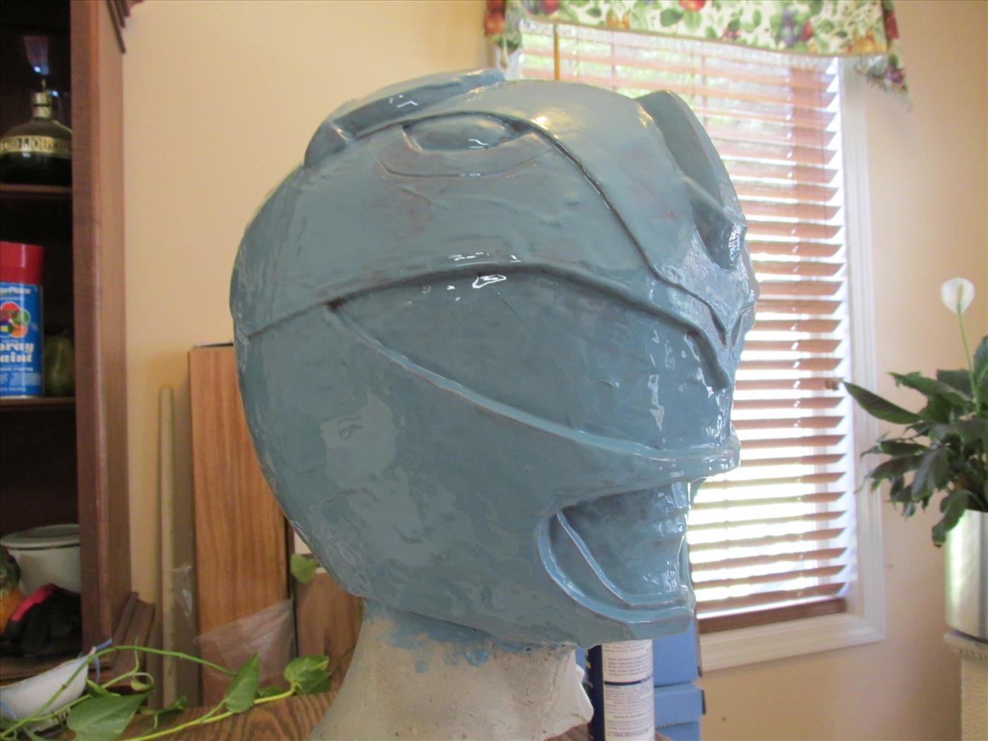

On to the next phase! The jacket mold. The product I used was Smooth-On's Brush On 40 urethane mold rubber. While it picked up incredible detail, it is not without its drawbacks. The most minor of which is that it's white in color. You have to tint either the plastic or the rubber so you can see what you're doing while slush casting. It's difficult to dispense and the cure time is quite a bit longer than most silicones, sixteen hours. However the biggest drawback its poor performance when bonding to itself. The layers have to be added while the material is still tacky or delamination may occur. In other words, the structural integrity of the successive layers is comprised by waiting too long. This makes adding on registration keys made of the same material a pain because they have to be set up enough to handle but not so cured that they just don't stick.
Let's continue to enumerate my mistakes.
#5 Thankfully I only made one very minor mistake in process of making the jacket mold. When making the registration keys I mixed up too much rubber and by the time I'd poured the last few the material was too viscous. The product didn't settle and the sides that were supposed to be flat to join with the wet urethane layer were rounded and didn't want to stay in place. Let me tell you, it's not as simply as just cutting off the rounded bit! Urethane is tough stuff, very dense. So, I battled with my registration keys slowly sliding off. In the end I got them all where I wanted but it was a mess.
#6 I'm not well versed in the chemical compositions of these types of products, the difference between an epoxy and a urethane is completely lost upon me. However, from an observational standpoint the urethane rubber and polyester resin for the fiberglass mother mold didn't seem to play nice with one another. I feel like they bonded chemically. If you chose Brush On 40 to make your jacket mold, be sure to release it with some Universal Mold Release (another Smooth-On product) before laying up the fiberglass for the mother mold. I literally broke into a sweat trying to pry the thing free.
#7 Use more than just 2 layers of fiberglass. I am a skinflint of the first water. This has served me well financially but it can come back to bite you when taking on a project such as this. I had only fiberglassed once before this project and that was years ago. What's sad is I had plenty of glass that I got for free and I still skimped... I broke the mother mold during said prying but it still served it's purpose admirably.
I circled a couple of the registration keys that didn't sit flush to illustrate what meant about them not having a flat underside. These aren't even the worst of them! As I was alternating colors I put the registration keys on the second to last layer. This was my intention even before I realized how bad a few of them were and it helped me to fill in the gaps.

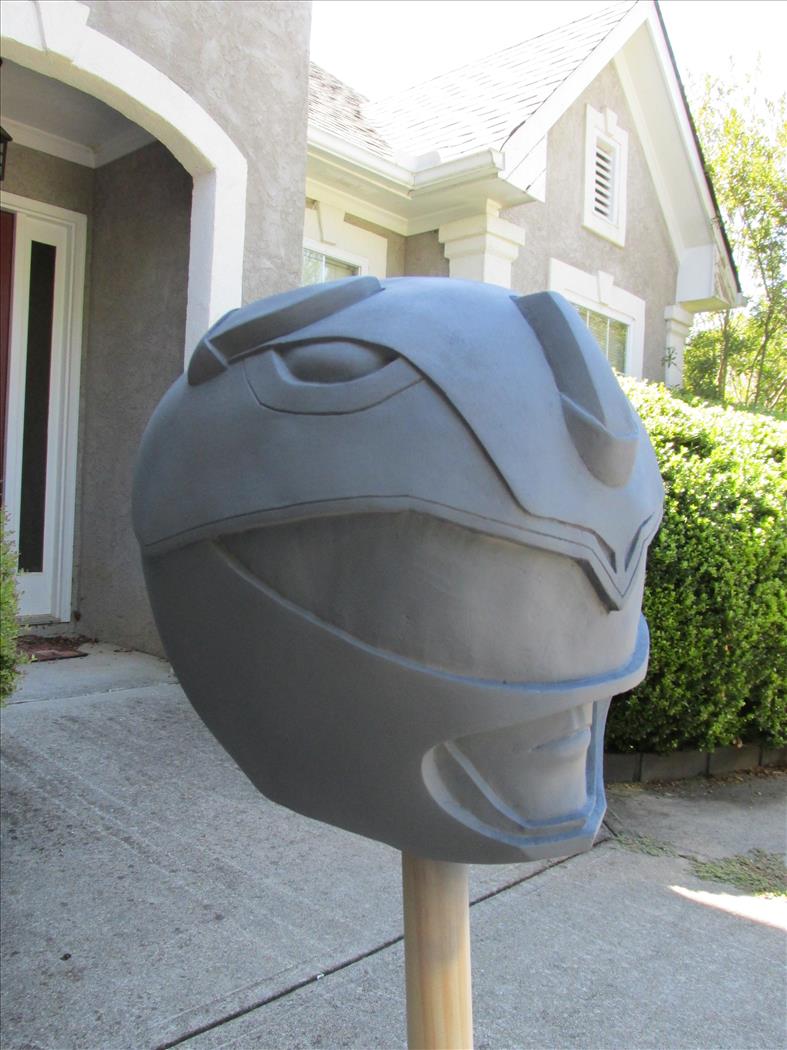

On to the mistakes! When it comes to paint, the information here applies to rattle can paints and primers. Obviously, these are not ideal for flawless, beautiful work. However, because you can get tolerable results and they are cheap & ubiquitous, people will continue to use them. Here is a list of things NOT to do.
#8 More or less finish sanding your piece before you prime. Even if your piece is stark white and it's difficult to discern where it needs it, do your best to hit every spot. You don't have to go crazy and work your all the way up to 2000 grit. However, take the time to make sure you rub out the tool marks that were in your sculpture. I didn't sand in the nooks and crannies where primer is wont to pool up, compound this with the micro rake marks that were notoriously bad about getting clogged with primer and you'll have a gummy mess before you know it. Needle files are obviously the way to go here. I left this picture large so you can see the rake marks at the base of the front horn. I simply did not sand well enough.
#9 This one belongs more to the sculpting phase but I didn't realize it was a mistake until it came time to cut the visor out. Don't recess the visor area too deep into your sculpt! The diameter of the cut wheel on my dremel wasn't as large as the area was deep so the grip of the tool bottomed out on the face of the helmet. This coupled with a really, really thick spot where the plastic cured in a blob made cutting it out a nightmare.
#10 Make sure when sanding to not allow any plastic to show through!! If you sand through your primer, prime it again and use a higher grit. It will take longer but you don't want to see any plastic. Embarrassingly, I thought it was ok that I could see the plastic because, hey that's just what happens when sanding your primer coat, right? Oh, and the box says the urethane is paintable right? Wrong. Sadly I sprayed my color with the helmet looking like this.

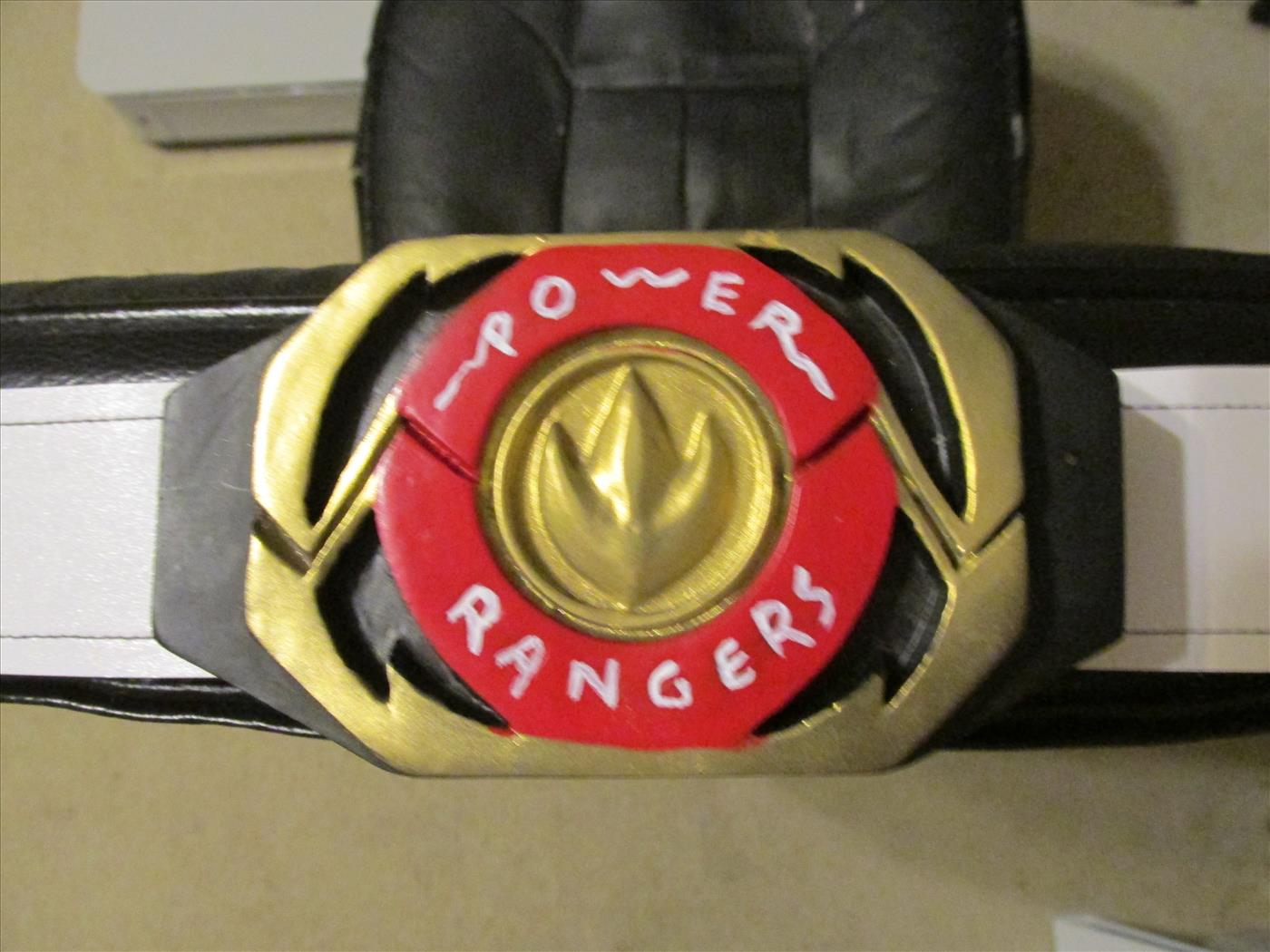

Belt: 3/10 – Even if they hadn't sent me the wrong one I wouldn't likely have settled for it. You read that right, they sent me the wrong belt. The Green Ranger's belt to be exact. Have a look.
The write up for what all it took to make their belt serviceable is considerable so I'd best save it for the next post. I'll also review the boots I purchased separately from hunny_lee.
