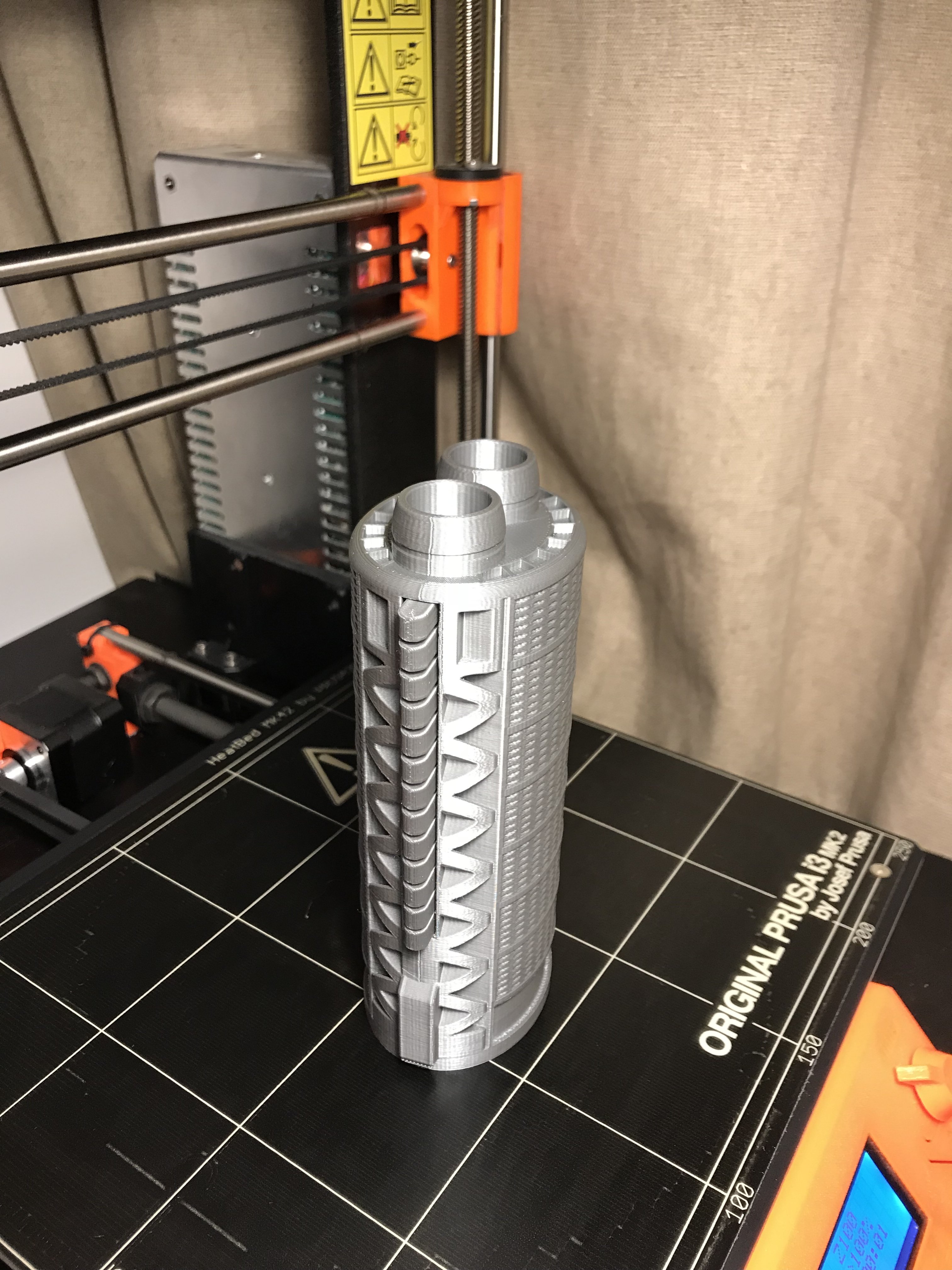

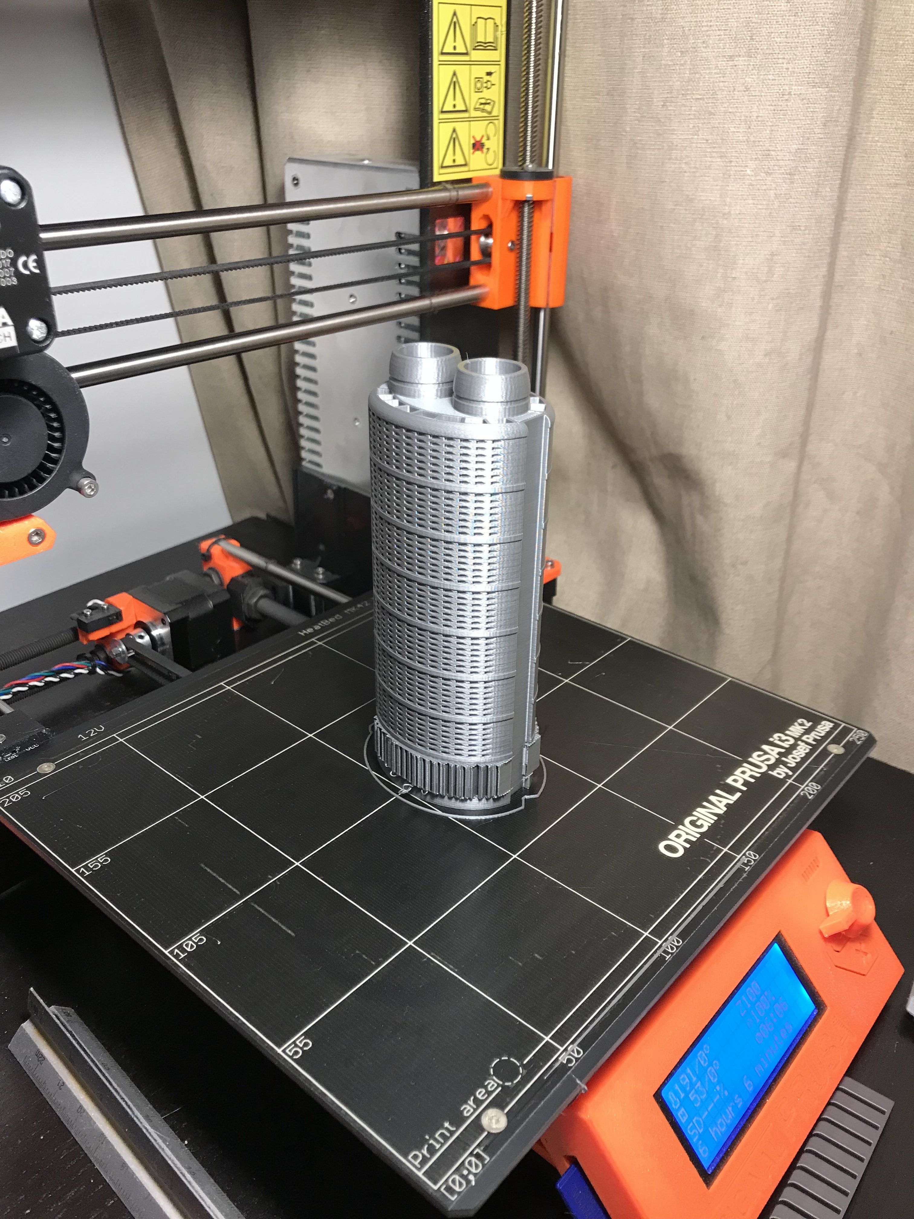

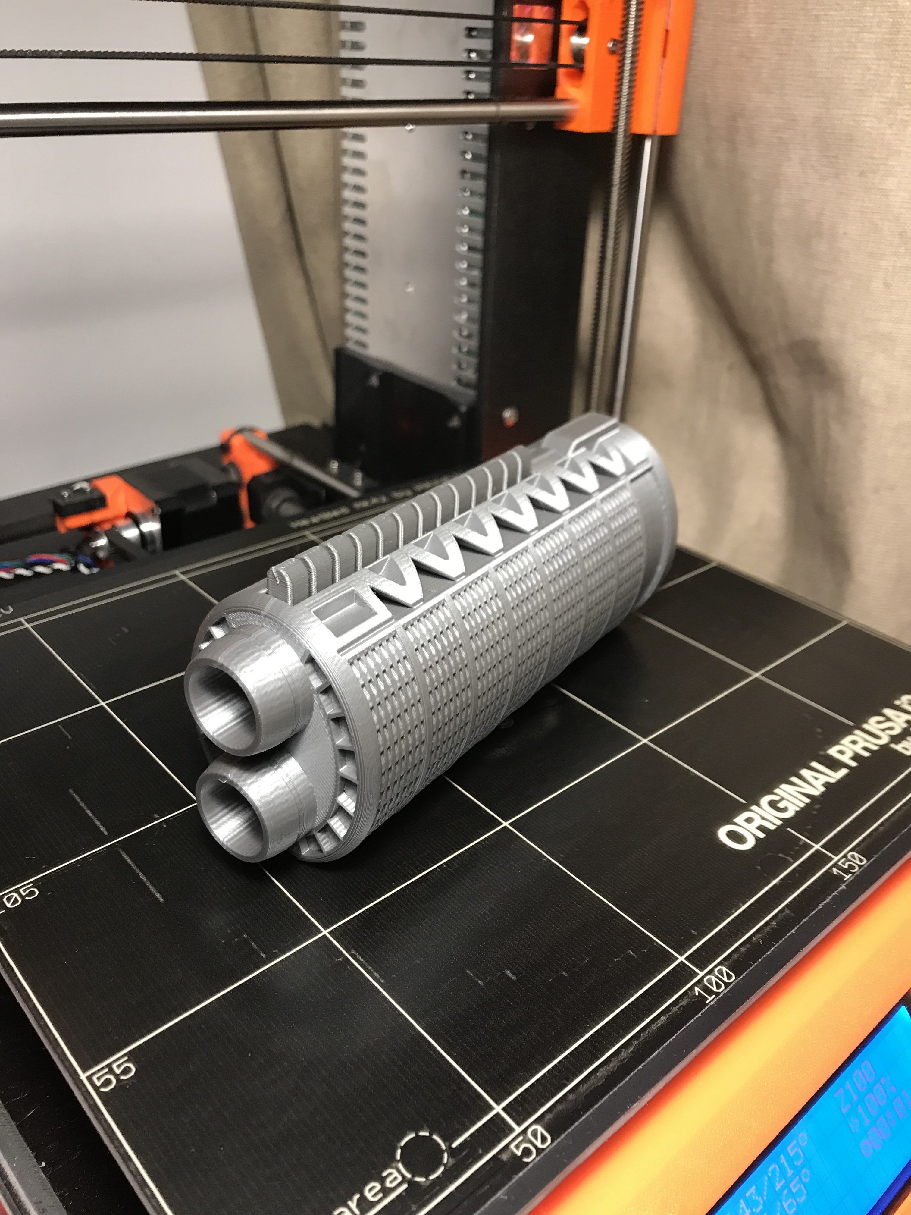

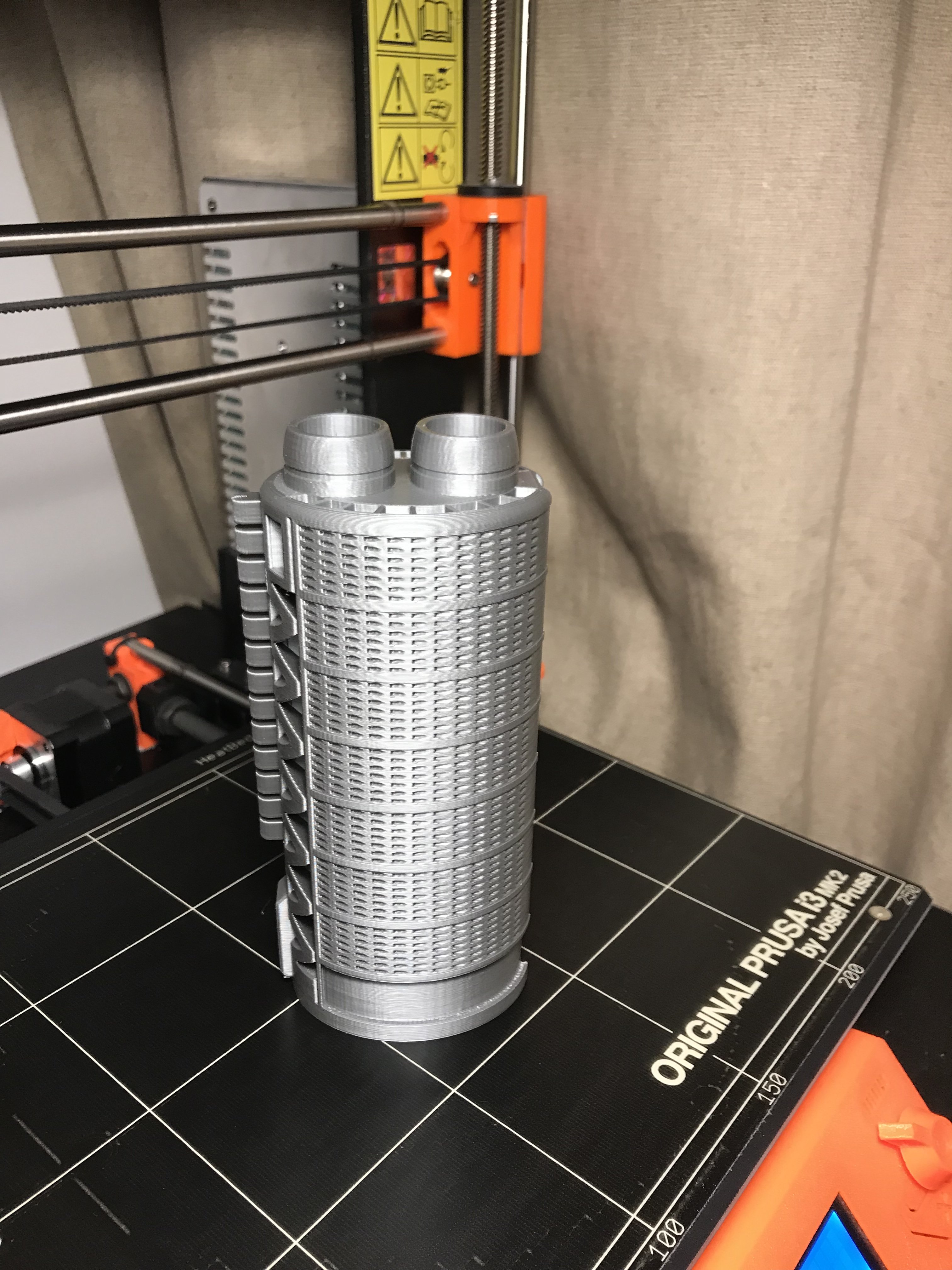

Just finished printing another piece!
Still not quite sure about the texture, I've tried so many different variations on the 3D Model, this looked the most accurate, but still doesn't feel right.

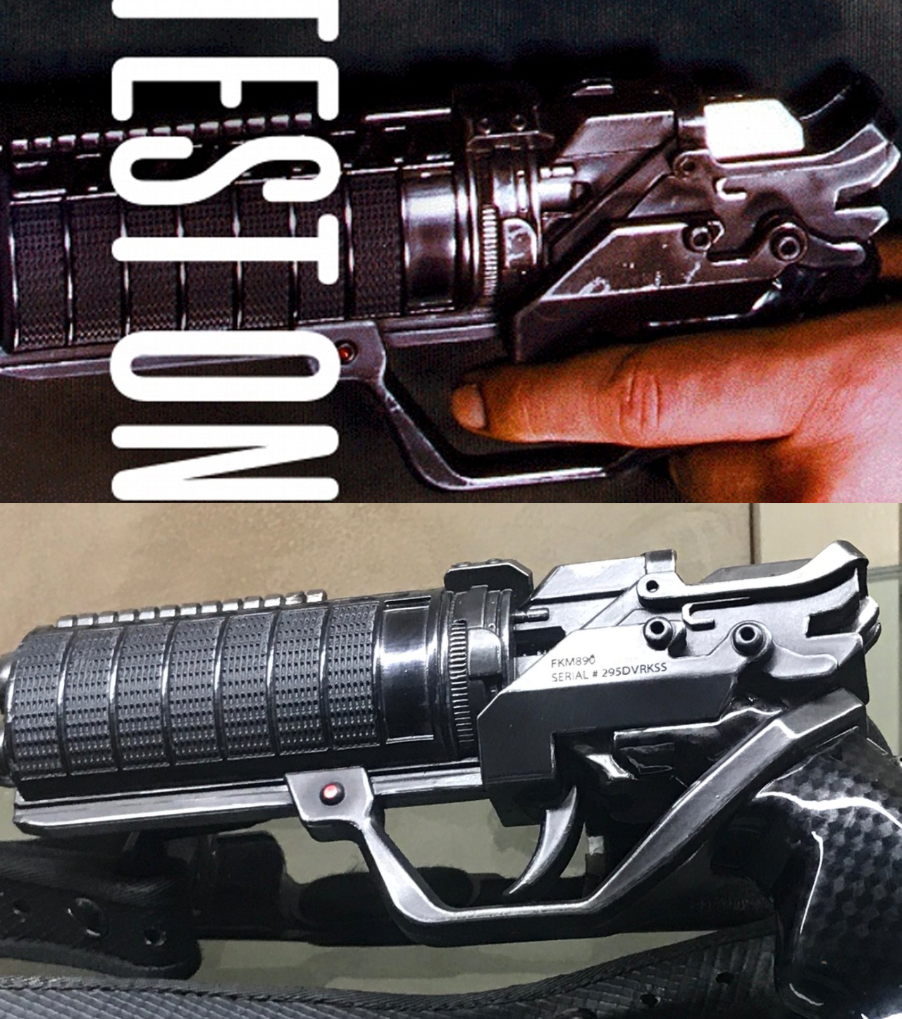

Check out the top image in this jpeg. I think it shows a more grill like feel, could this be the hero on top of a stunt version?.

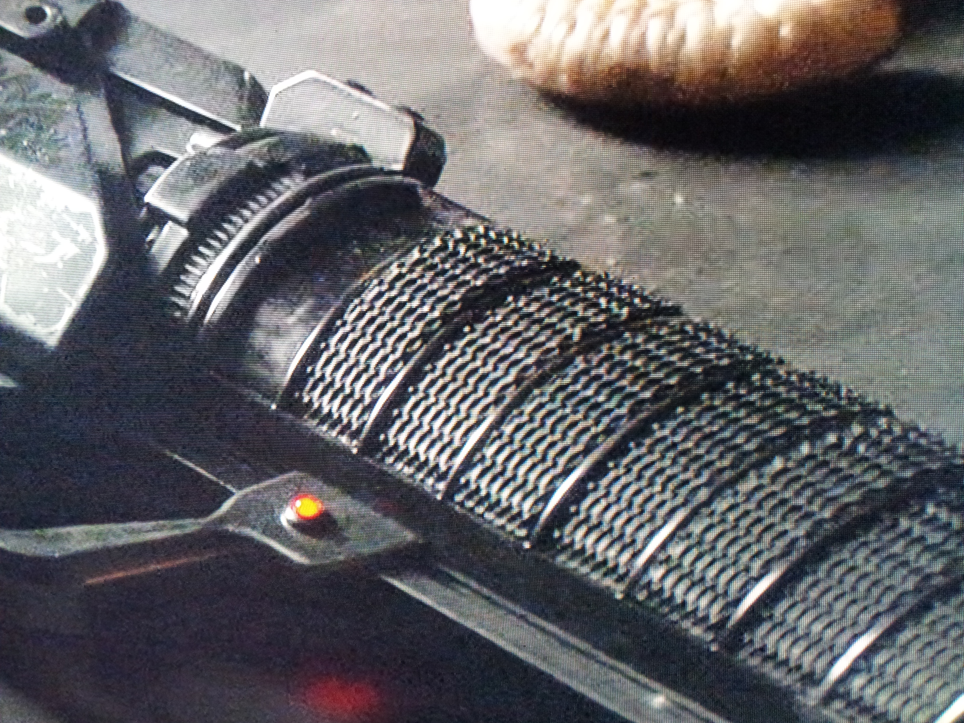

heres a still shot from the blue ray.
personally I prefer the Microphone mesh look. But its up to you. Its your baby.

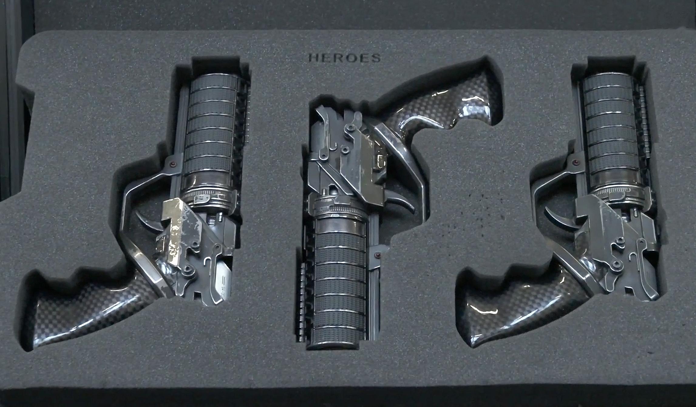

I think it's more a difference between early and late in production. The gun from Sapper's table has clearly got separate mesh pieces glued on (and looks a bit of a mess, to be honest). The hero blasters from late in the film (such as the ones in the Tested video, and the 'fully engraved' one that was displayed at SDCC) are substantially neater, and look like the mesh is integrated into the print of the barrel as it's all perfectly flush and aligned. Here's a picture of 3 hero versions in the tactical case (which I think was taken during the Tested shoot, so presumably after principal photography had ended):
There were rumours about the original blaster props supplied by PropShop not being particularly reliable and lots of rebuilds and replacements being made during production, so the mesh being incorporated into the barrel print may have been part of that (some of the mesh on the Bluray picture looks like it's already fallen off a couple of times)

Very nice work, Buzby! I'm still not sure anyone has gotten the grill work right - in the hero it looks more like interlocking protrusions than recessed cuts, but I have yet to find a high enough visual reference. Let's hope it goes up for auction or on display again soon!
Would you say they are... interlinked?
Test print looks good. I'd be okay with it as-is, but I see what you mean about the texture. I think it's the distance between the holes in the "mesh." Maybe adding more holes would help.

I can definitely see that the mesh has come out of its position on the farthest two sections in the screen grab image . I wonder if this means the first incarnations of the blaster had mesh which you can see details through ? Not a good idea for this 3d print, but just a thought.

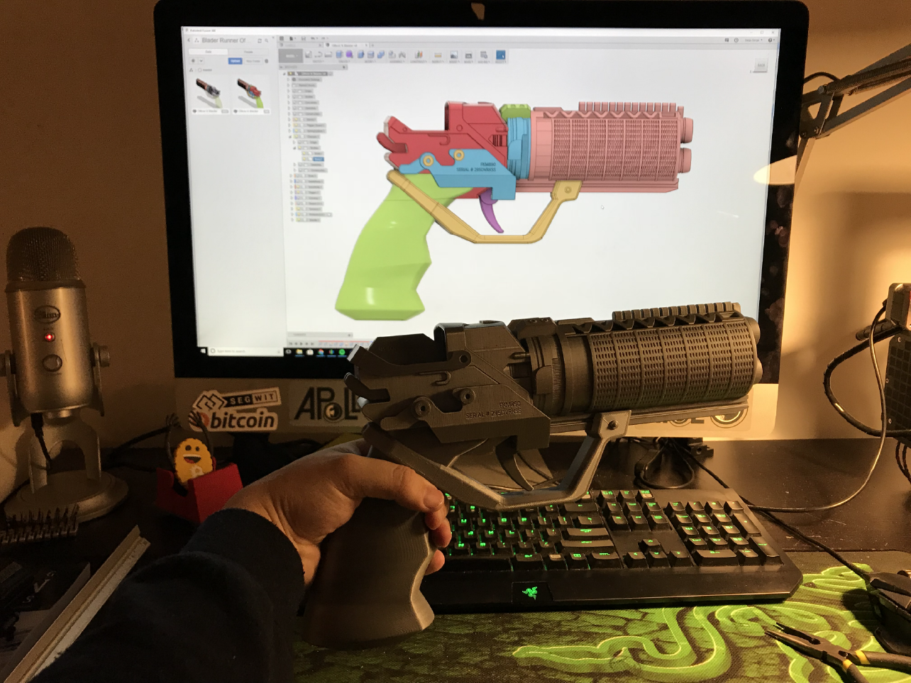

I just noticed my scale was off! (Way to big) I'm finishing printing the last pieces and will put it together and then look at how much I should decrease the size.
I had a quick look through some references from the Tested video when they were holding it, now trying to make something out of it.

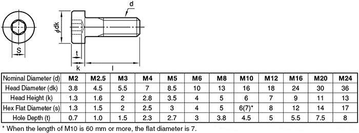

The only 'real' component we know was used on the blaster is the 3mm LEDs and their mounting clips on the front of the trigger guard, but it's going to be tricky to scale an entire model from that. The only other 'real' parts I suspect were used are the bolts on the sides of the receiver - I suspect they are M4 Extra Low Head Cap screws, like these, wih a head diameter of 7mm::
See https://us.misumi-ec.com/vona2/detail/221000551220/?rid=rid3

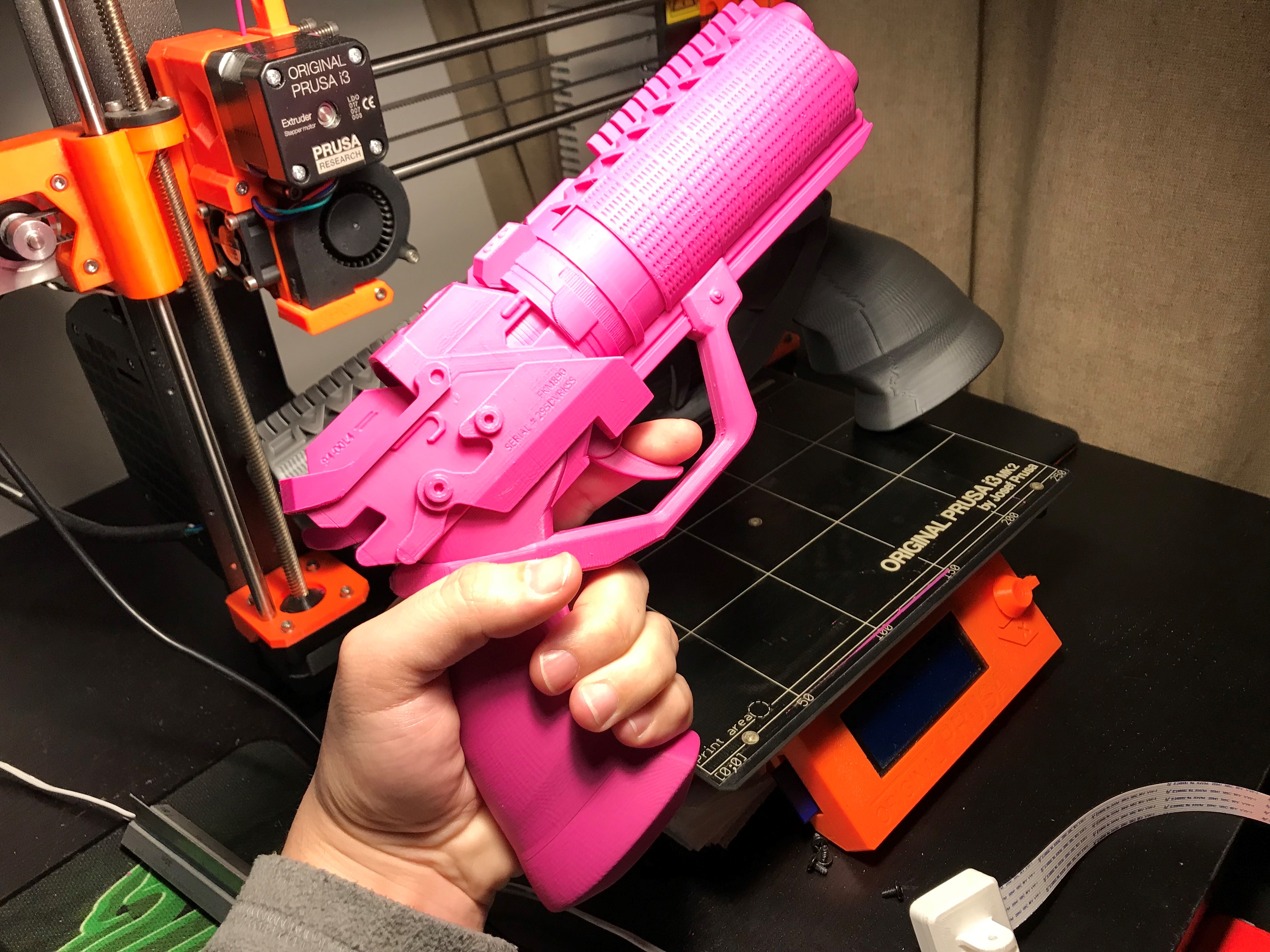

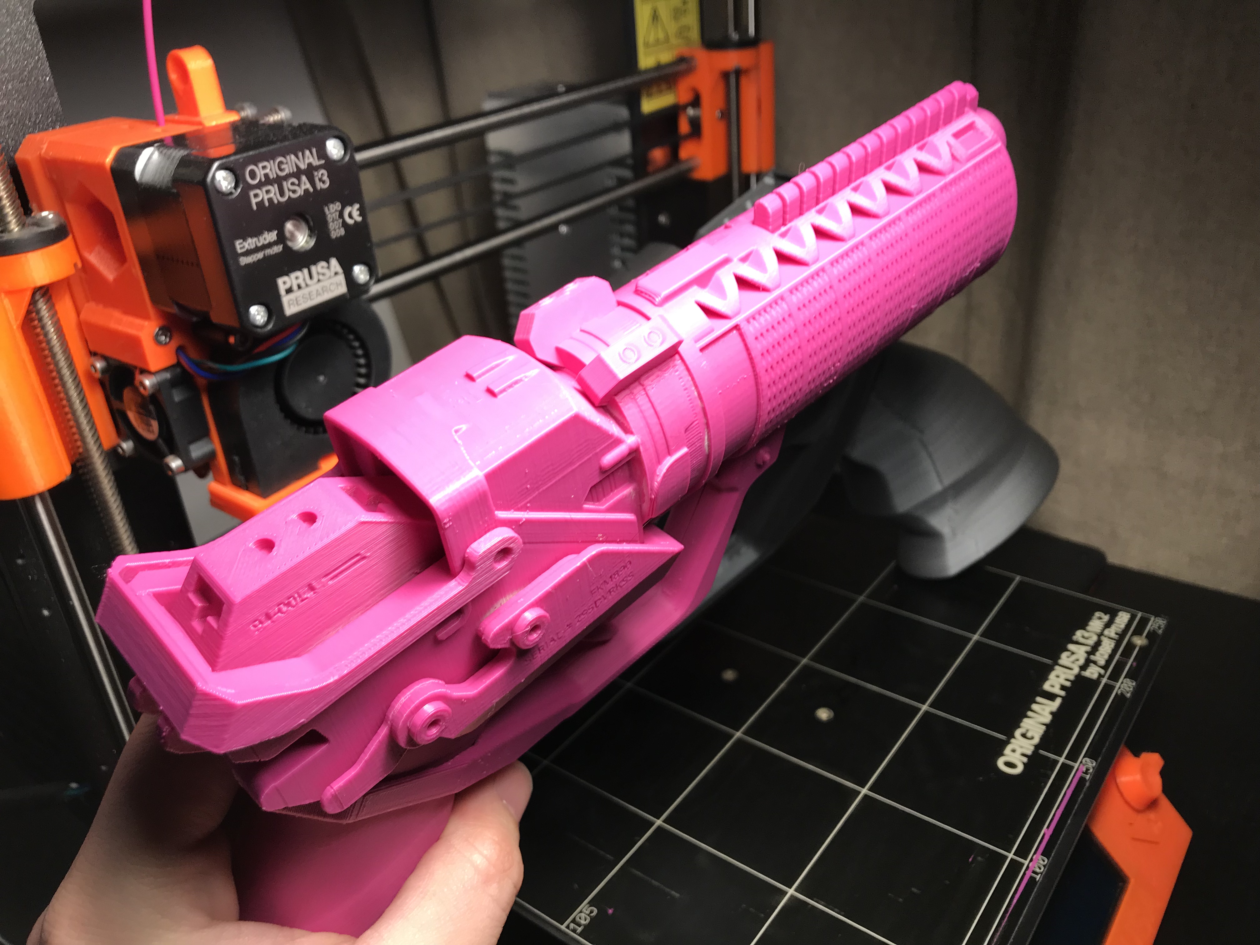

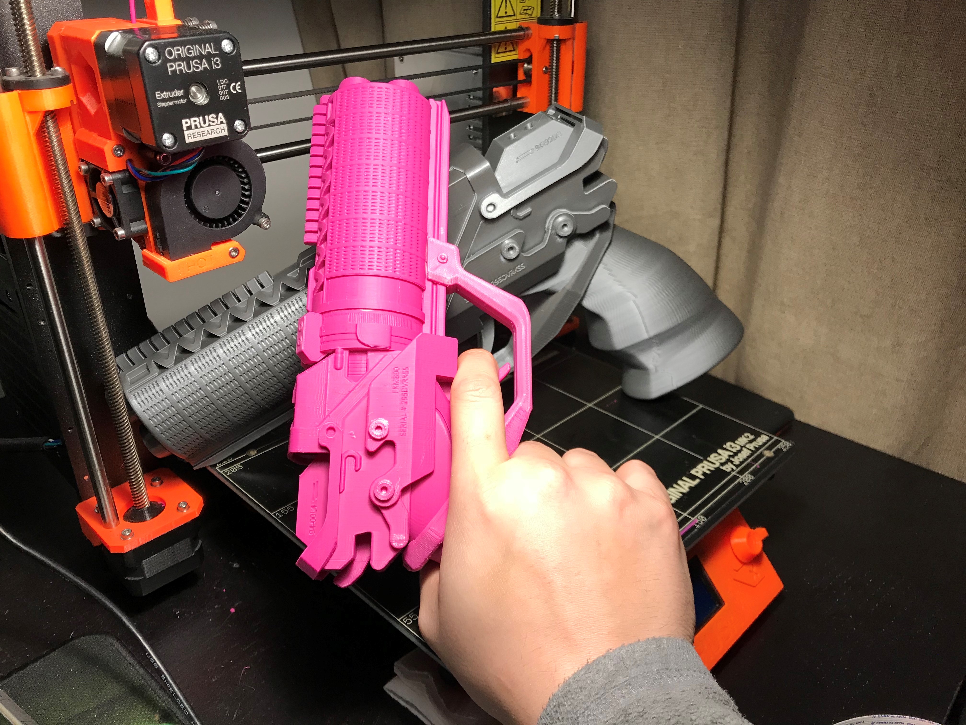

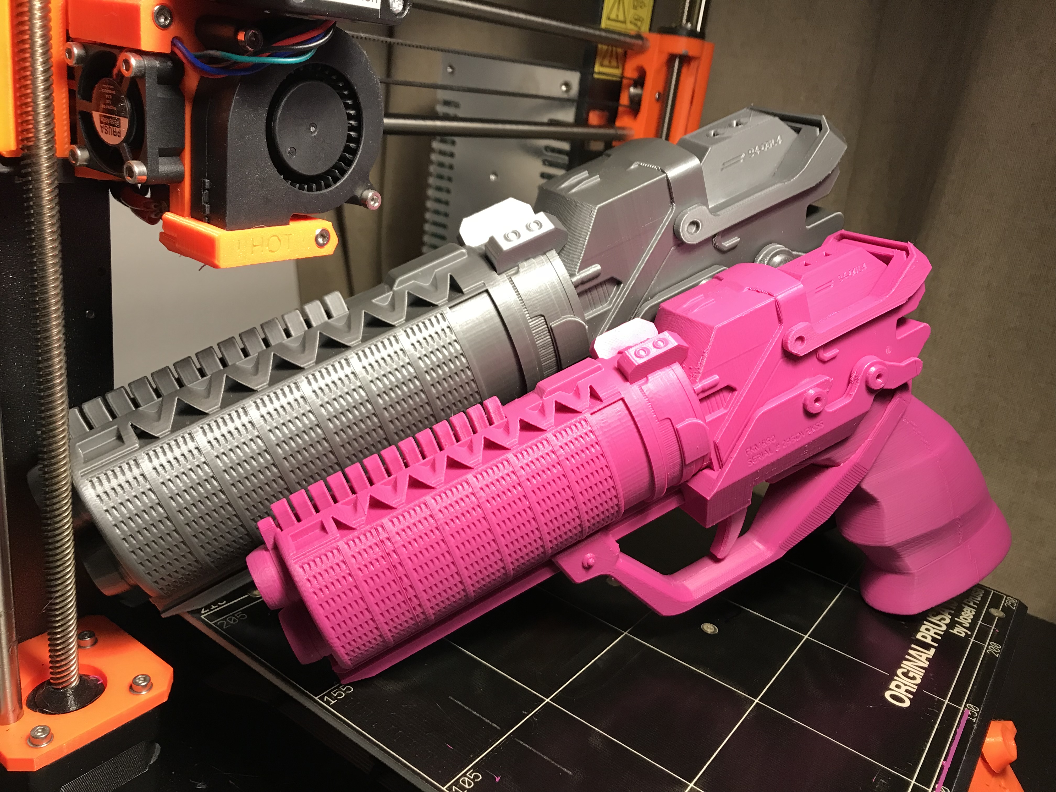

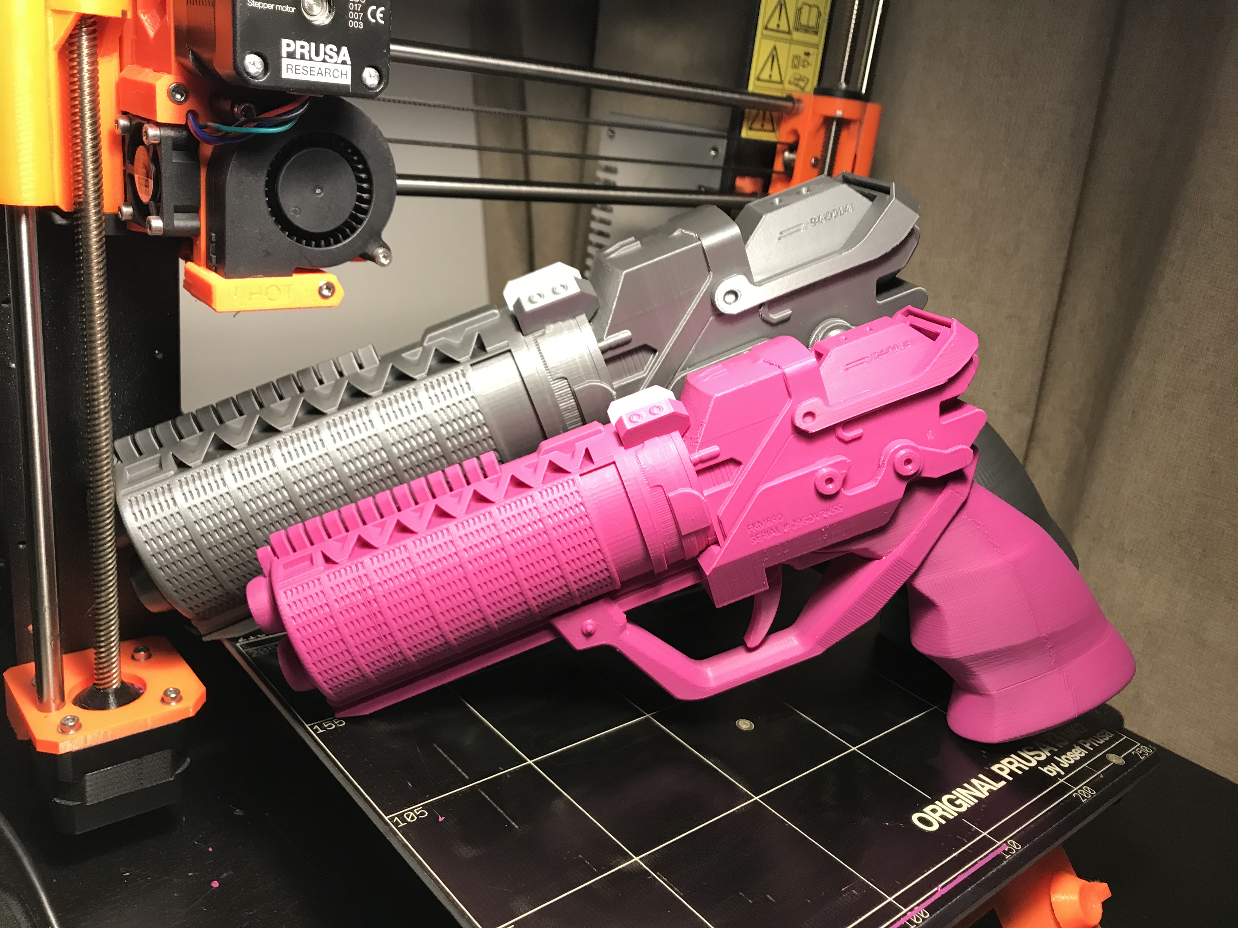

My print cracked me up! It was huge ahahaha.. :lol
I will scale with the 3mm led as reference and see if the screw checks up as well!
If all good I'll print everything again scaled down and see how it looks.
Also had to modify some parts and make adjustments.. i missed some things the first time around!
But so far so good everything fits nicely together. I just wished I had used a variable inside fusion360 for the PLA tolerances.. scaling down I will have to re-adjust those.
I scaled it down to 80% .. just a bit to big still.. going to try 76% :)
The quality is a bit ****e.. did a full plate with all the pieces and increased the speed!
I already know I'll need to adjust some pieces thickness and size.. but hopefully will have something for you guys before the weekend!
Here are some pictures... had to print In pink xD the only pla roll I had that wouldn't run out with all the pieces at the same time.
