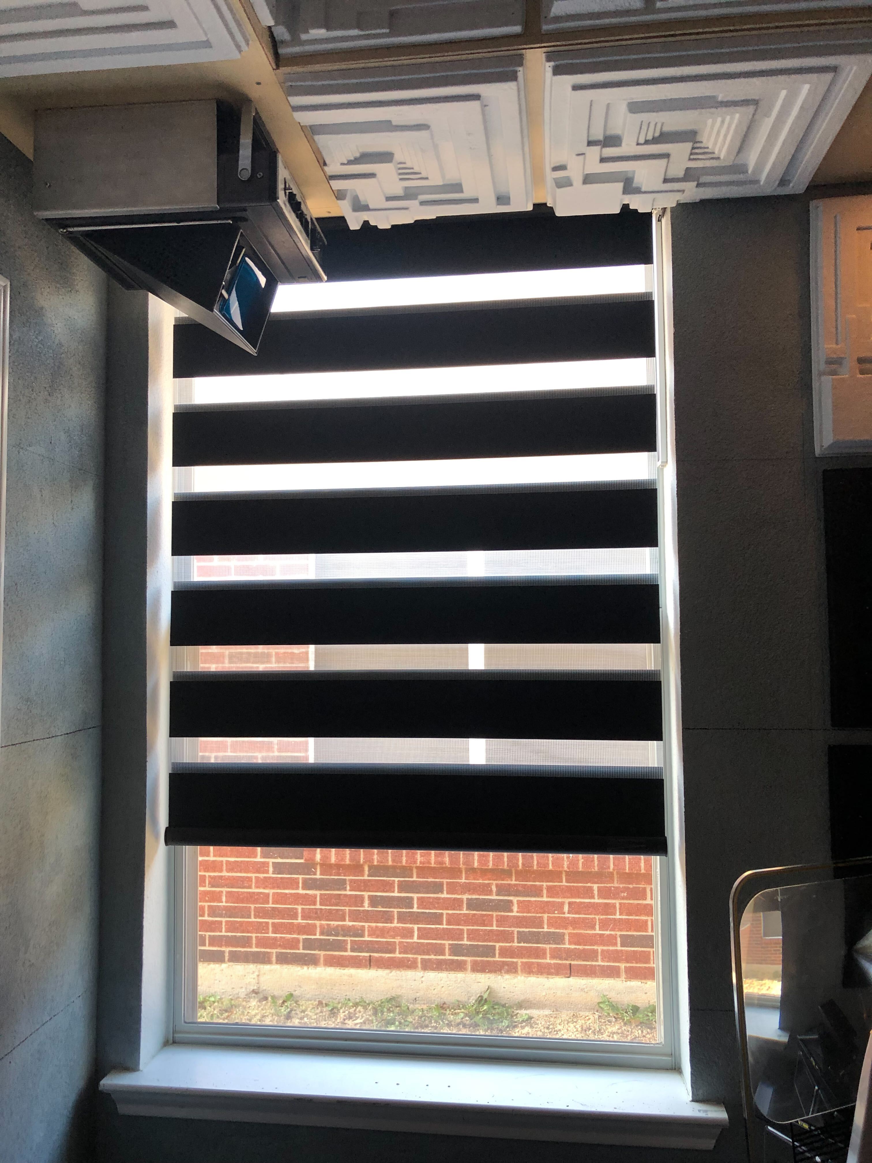

For the window, I removed the wood shutters that I had in my office, as I wanted something more futuristic that fit the aesthetic, and I also wanted them motorized and connected to Alexa so I could automate them.
In my head I was going for the feeling of the "It's too bright in here" scene where the window slowly tints from the top down.

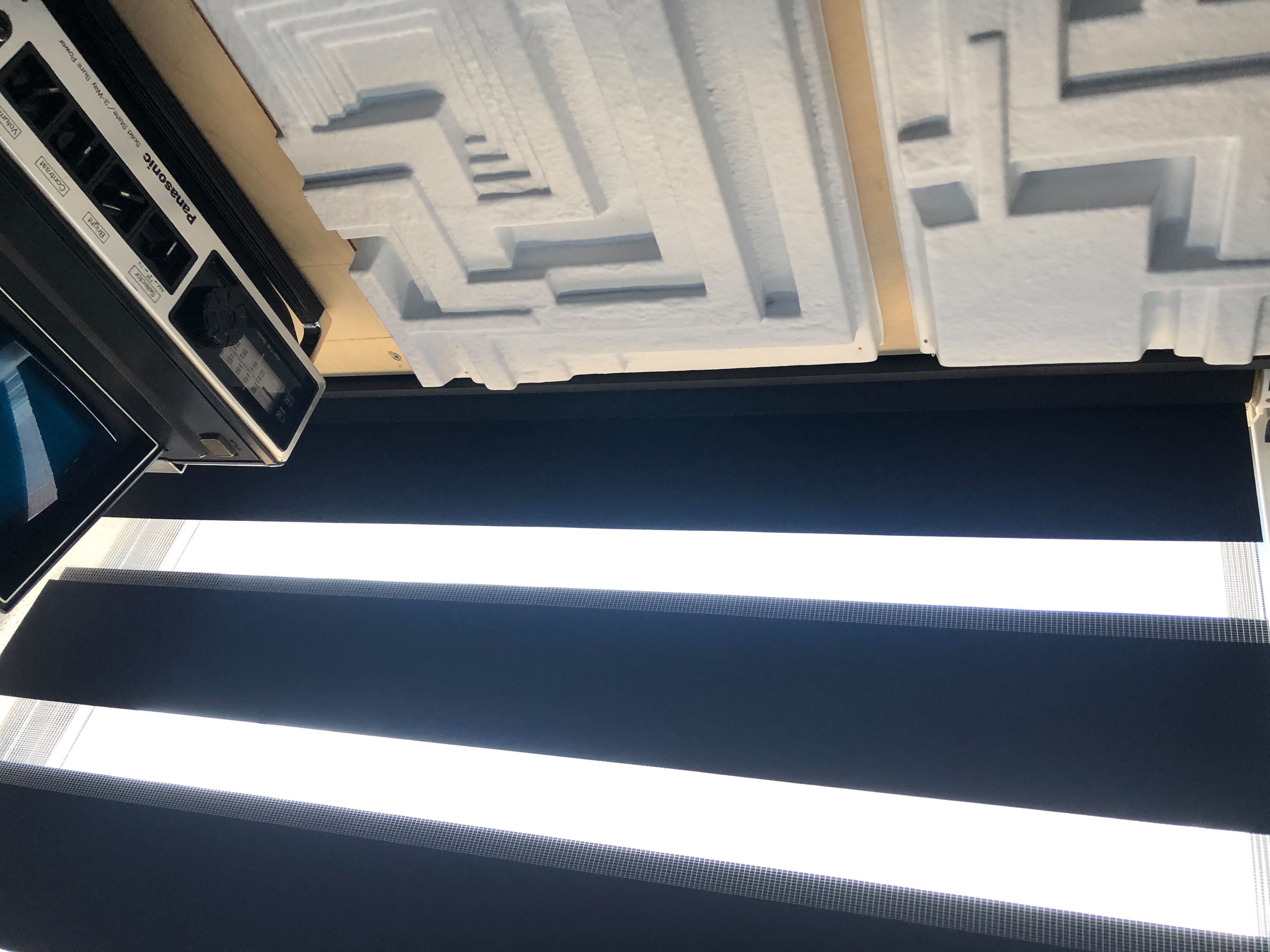

I found something called "zebra" blinds that I had never seen before, and ordered some on amazon. This style of roller shade produces a cool effect when opening and closing as the stripes overlap each other. And the benefit to these is that you can role them all the way up, or all the way down, but you can also just offset the stripes to let in however much light you want without opening them up all the way.
I installed these before I did the soffit, because the frame of the soffit actually hangs down an inch or 2 lower than the top of my window. It actually worked perfectly because the blinds housing is recessed up into the space behind the soffit and completely hidden.
They're also solar powered so I never have to charge the batteries or run a wire anywhere to plug them in.
End result (I'm still planning to paint the side walls of the window black to decrease the light coming through)

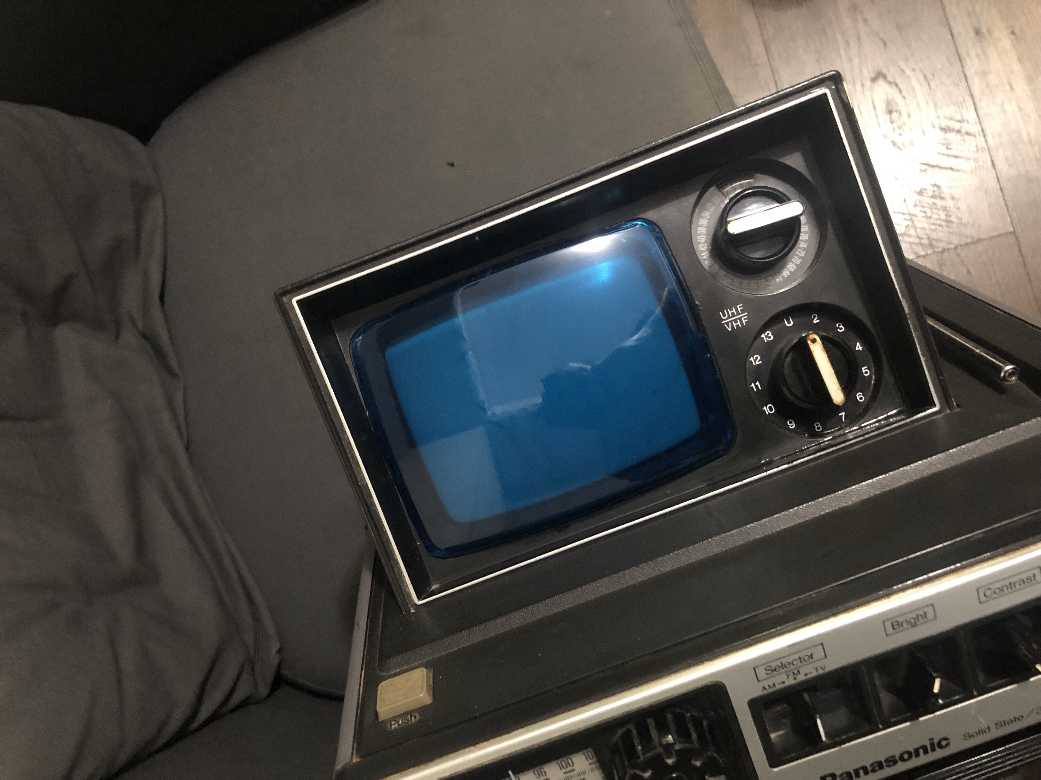

Here's a little more detail on another item I wanted to feature in my build; this monitor that is seen in a couple of different places around Deckard's apartment.
It is just a small item in the background but adds so much to the 80's future noir aesthetic and mood. Dimly lit rooms and hallways with an eerie blue glow of a screen that is only displaying static. I don't know if these were intended to just be small televisions throughout the apartment, or if they were supposed to be some kind of security system. Either way, the hanging monitor has such a distinct look that I knew I wanted to include one.
Surprisingly, the prop department simply used an unmodified 70's Panasonic portable tv/radio, model TR-535. They just mounted it upside down so that the tv screen hangs down.
I found one on ebay for a great deal and it still works perfectly.
I removed the old batteries to decrease the overall weight (this thing is heavy!) for mounting.
When building the frame for the soffit, I made sure to include joists 12" apart at the location I knew I wanted it mounted so I could mount it directly into the studs.
The only thing I did to modify mine was add a blue tint to the tv screen. It's black and white so the tv static isn't blue in real life. I don't know if the blue glow was achieved with lighting, color correction in post-production, or just due to the nature of the celluloid itself, or if they intentionally tinted the screen for filming.
Either way I wanted mine to accurately mimic that eerie blue hue, so I found some self-adhesive headlight film on amazon that was the perfect color.

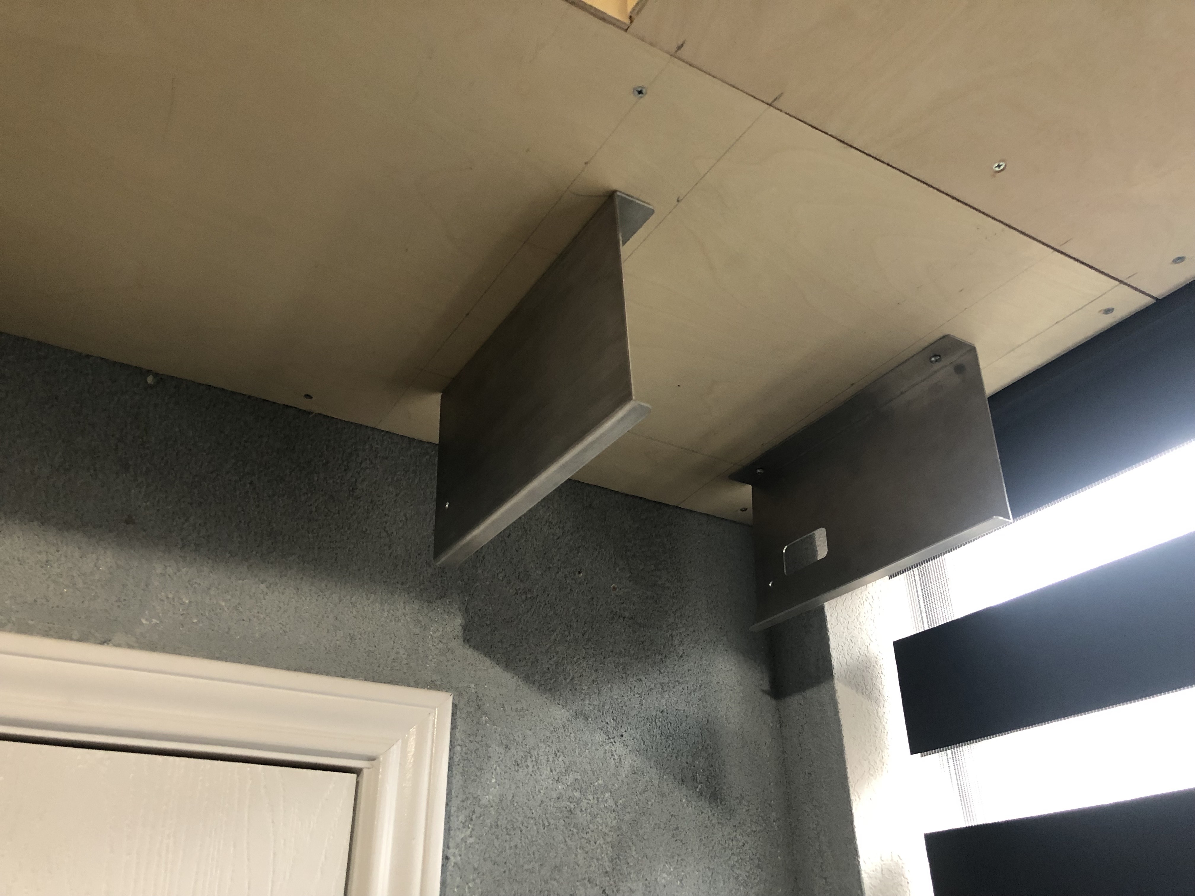

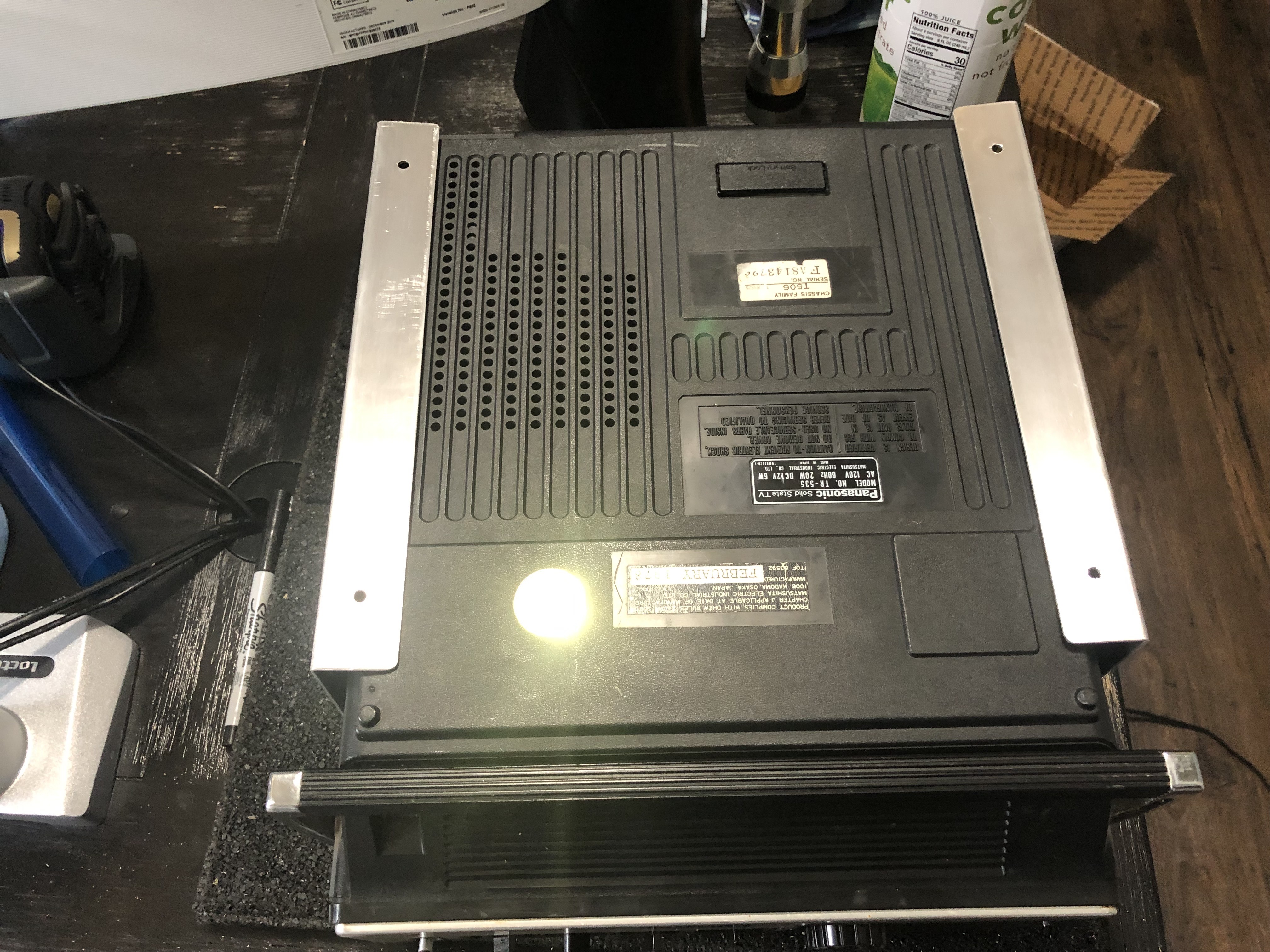

When it came time to mount it, I struggled with a solution. I didn't want to drill into the casing of the unit and risk destroying it, and I also wanted to be very secure and easily removeable if needed.
I reached out to my homie Halliwax for advice because he's a fantastic carpenter/builder/fabricator by trade and always has the most genius solutions to things like this. a quick 5 minute video call later and he already perfectly understood my needs, the measurements, how it would mount and be secure, and how the power cable should be run so that it would be hidden. The very next day he sent me pics of these amazing side brackets that he built by hand out of aluminum.
I was so stoked to get these in the mail and confirm that they fit absolutely perfectly! After measuring and mounting them, the tv unit slid into the grooves and settled into place with a very satisfying *click*. I used the existing housing screws on each side, per Danny's recommendation to attach the mounting plates to the unit itself without any modification so there's no way it can move or slip out of the grooves. I could not be happier with this solution! The power cable feeds through the slot Danny milled and runs right up into the soffit behind the unit, completely out of site. It's stable, secure, and it totally fits the design and aesthetic of the unit itself. Thank you so much for helping me with this, Danny!
