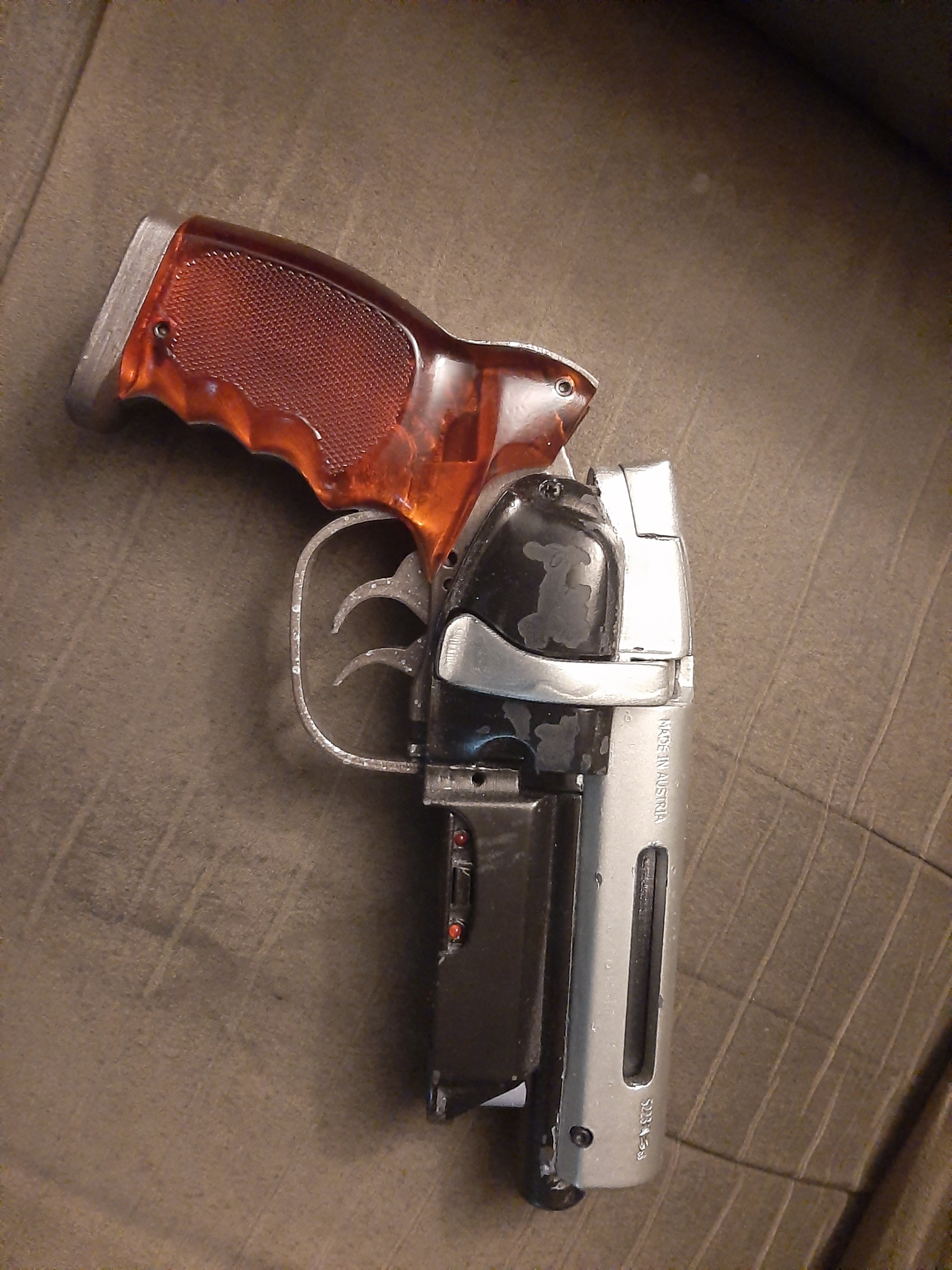

rgriesbeck Deckard Blaster Vers. 2.... with Soulinertia Grip mod. Original Deckard Blaster on left, rgriesbecks Deckard Blaster Vers. 2 on right. ;p Awesome fun doing rgriesbecks Blaster vers. 2.

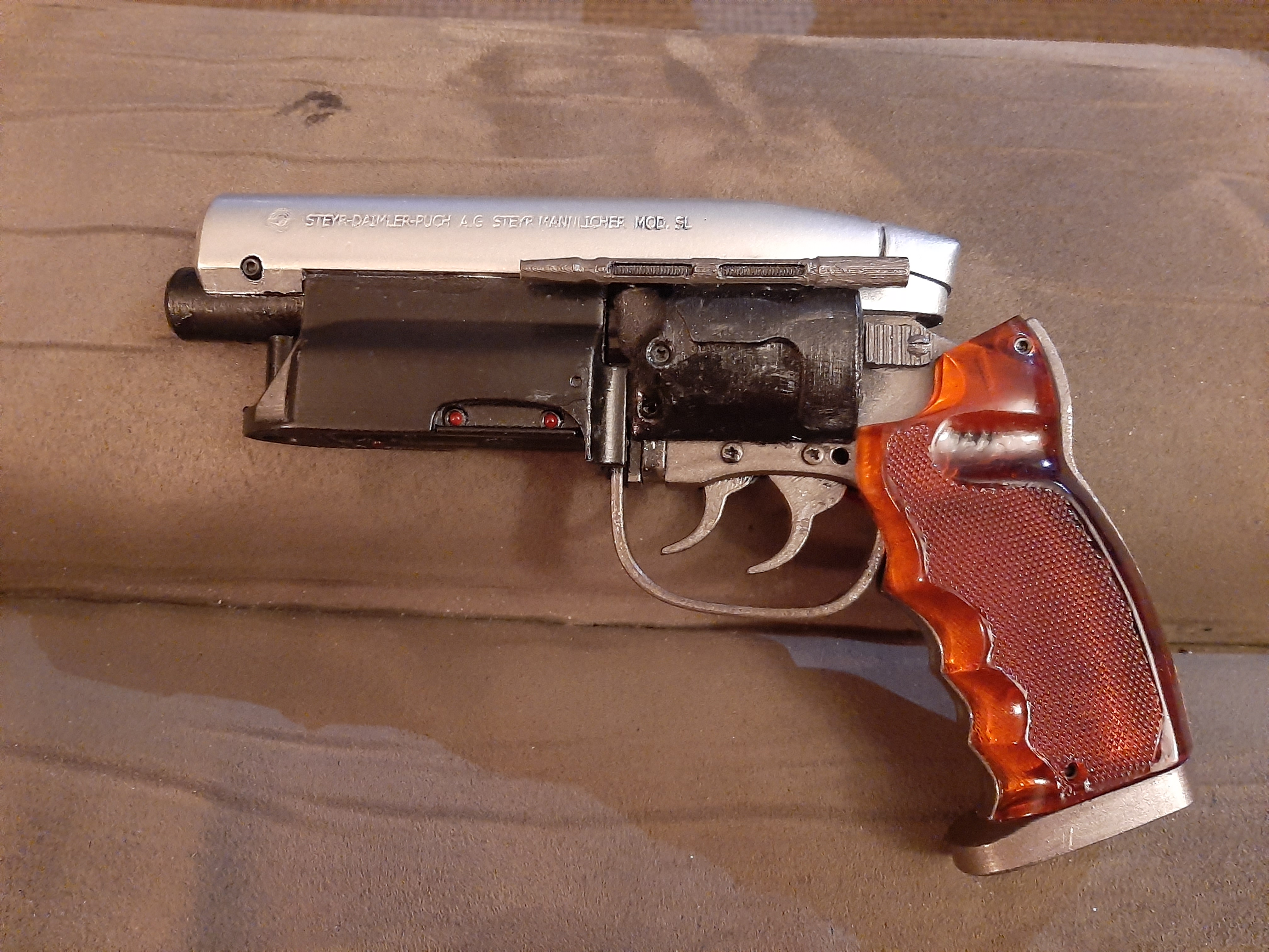

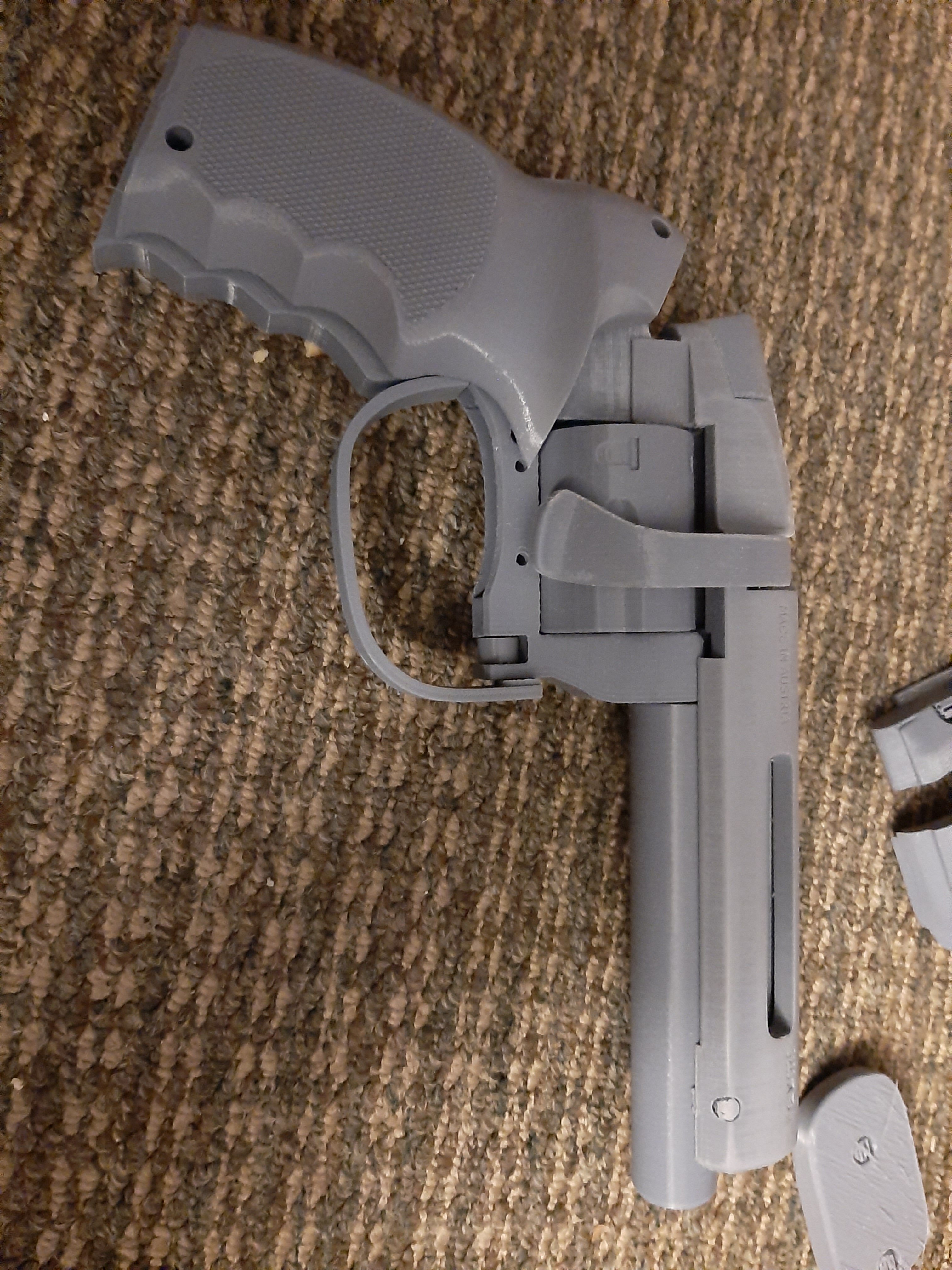

only a couple parts actually glued. some screws. big parts pretty much fitted. now to disassemble finish sand , paint and reassemble and wire up. may use one trigger to activate lites. very nice kit

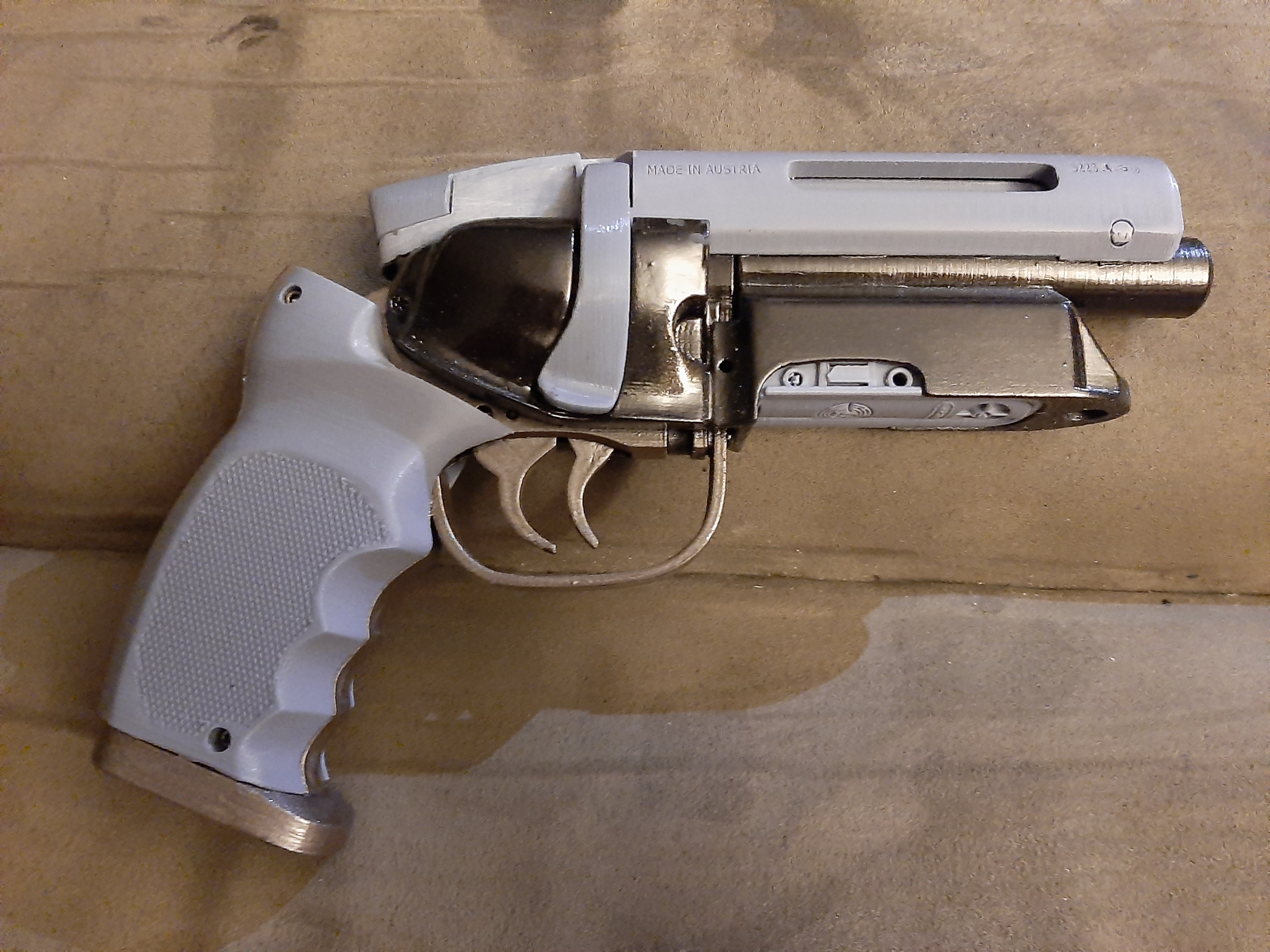

more painting and small parts and lighting to do.

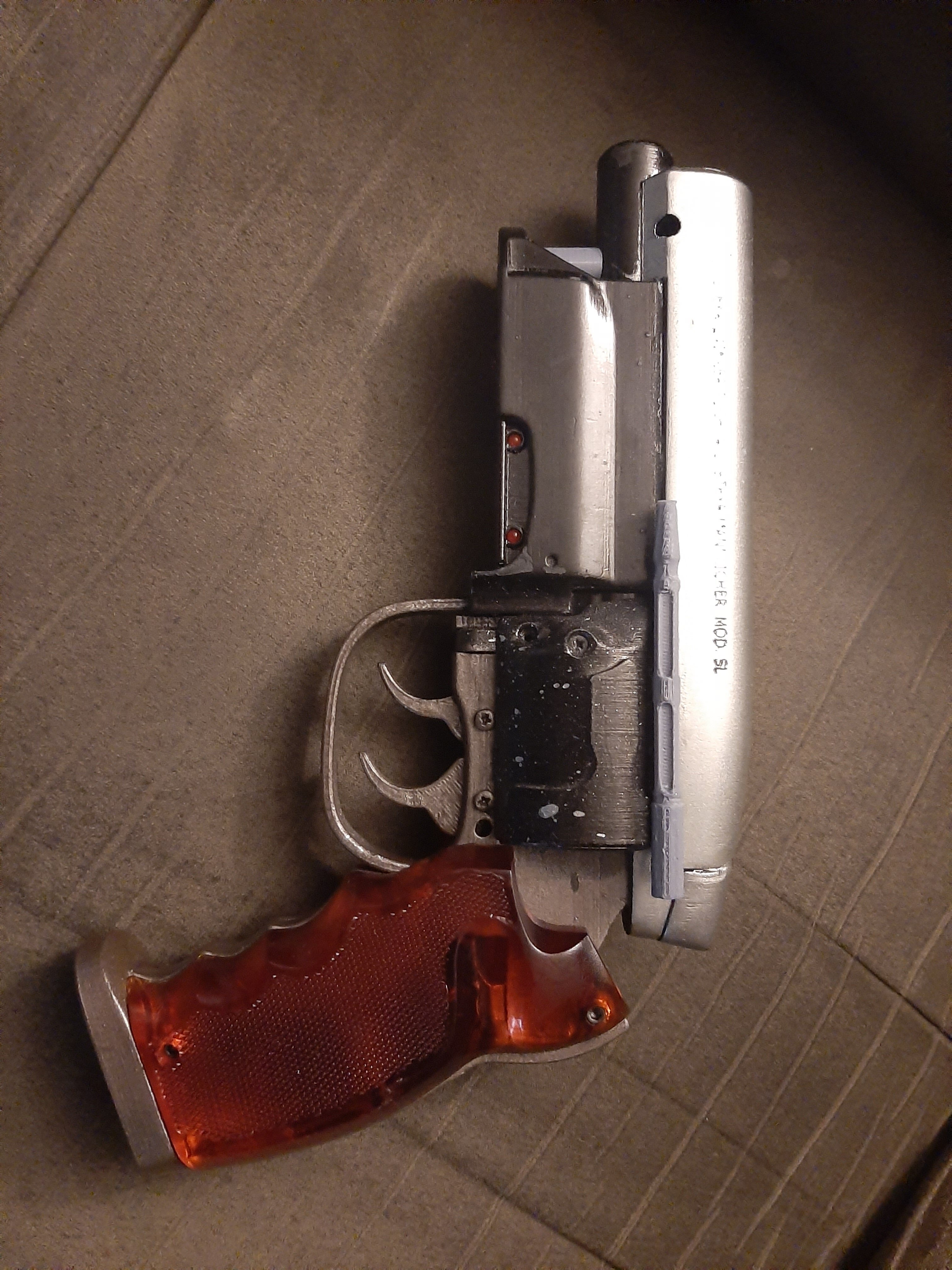

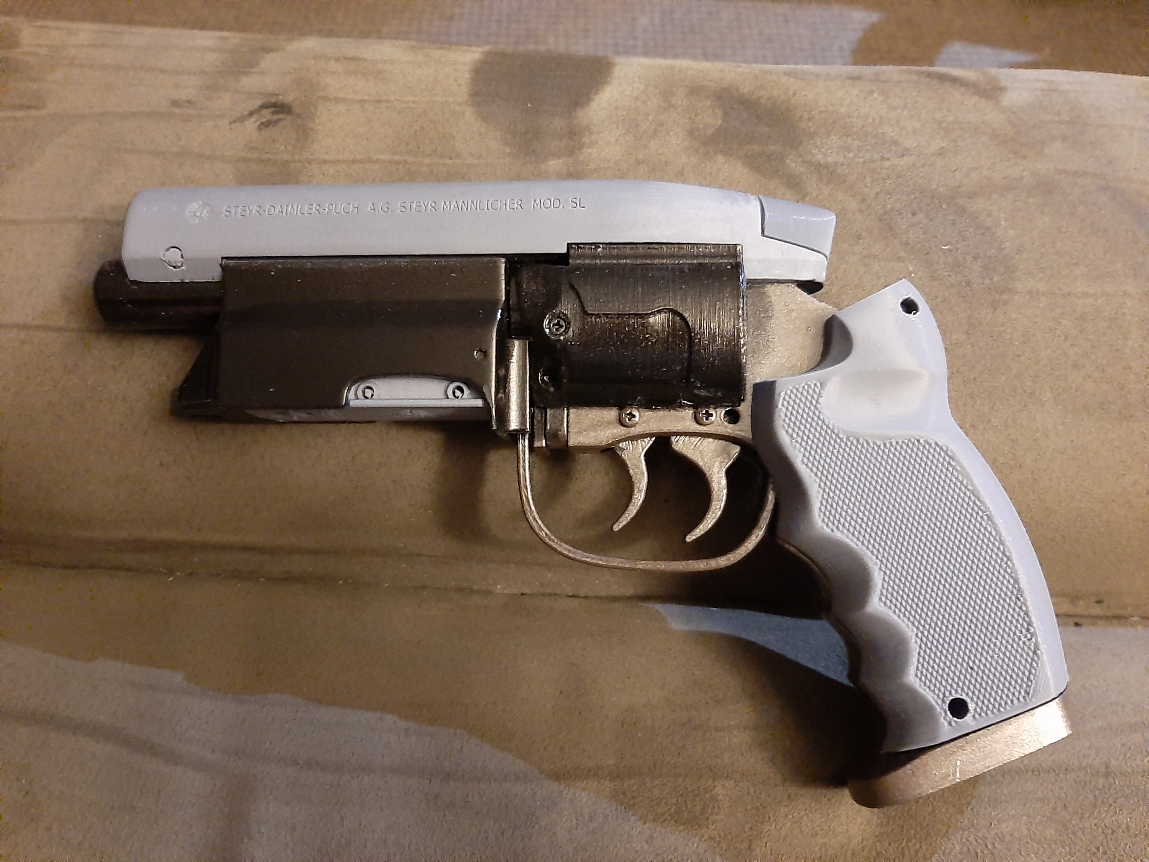

just need to touchup the paint a put some small parts on andwire it up now.

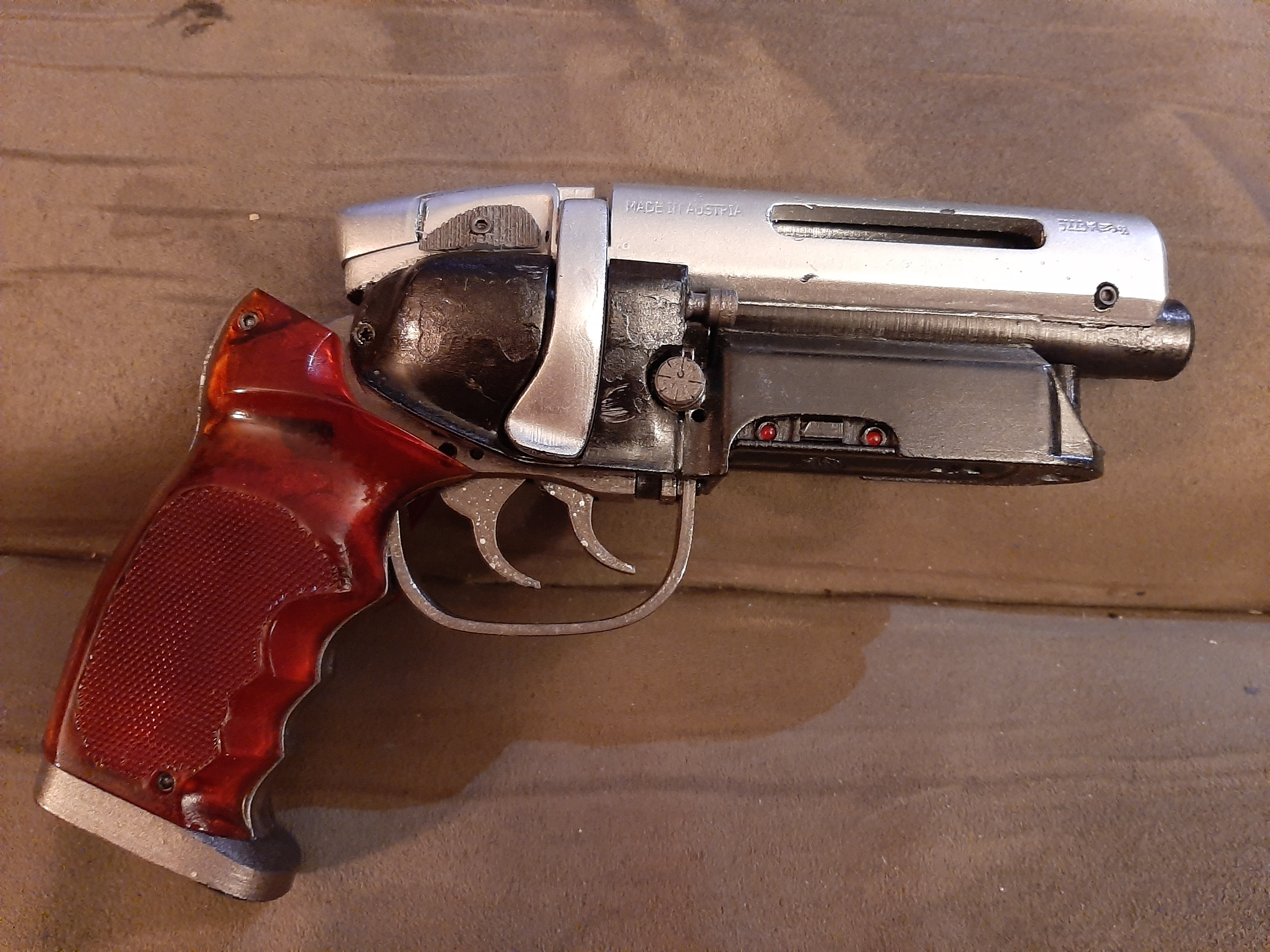

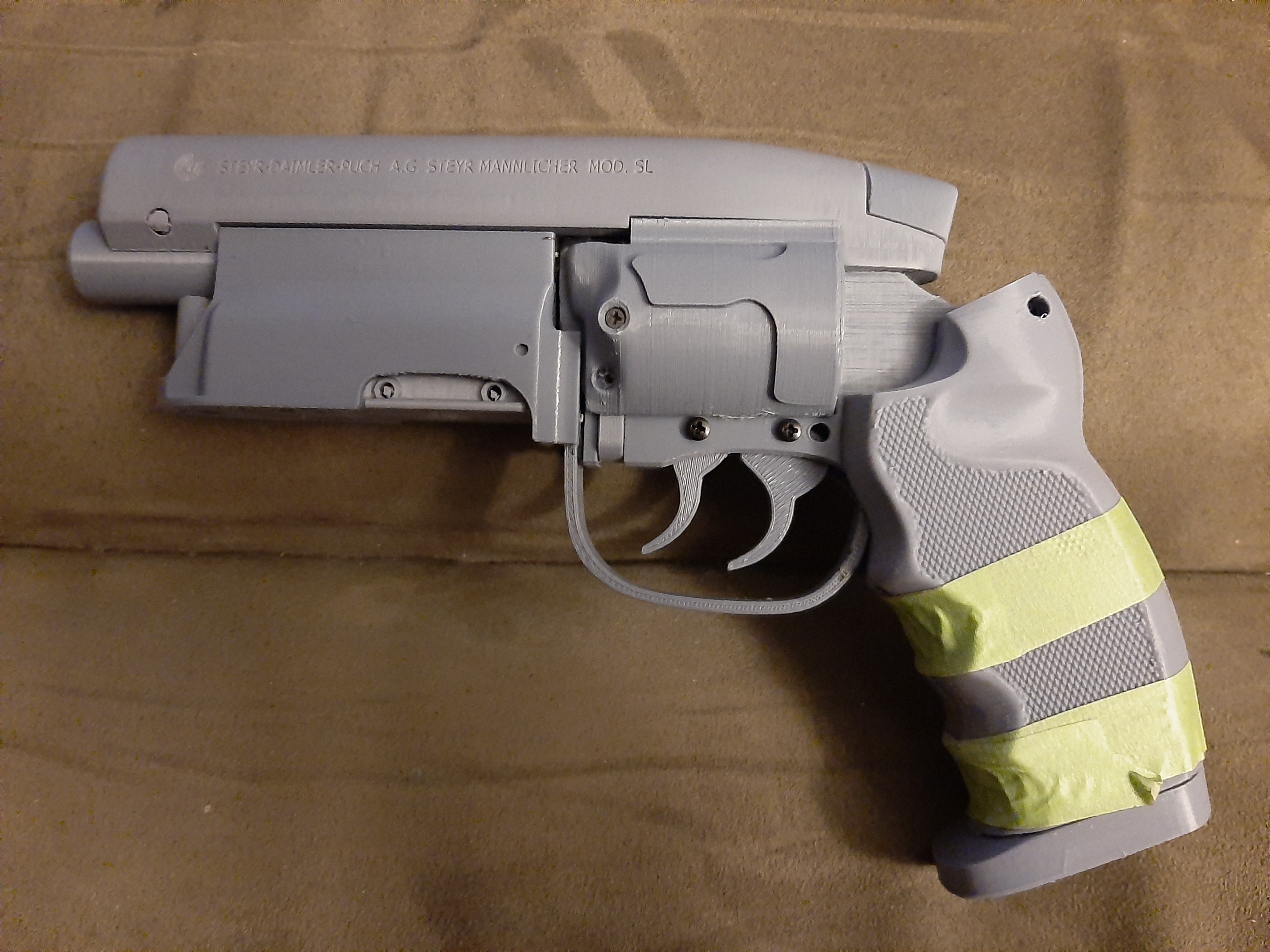

just some wiring and a couple more small parts to go

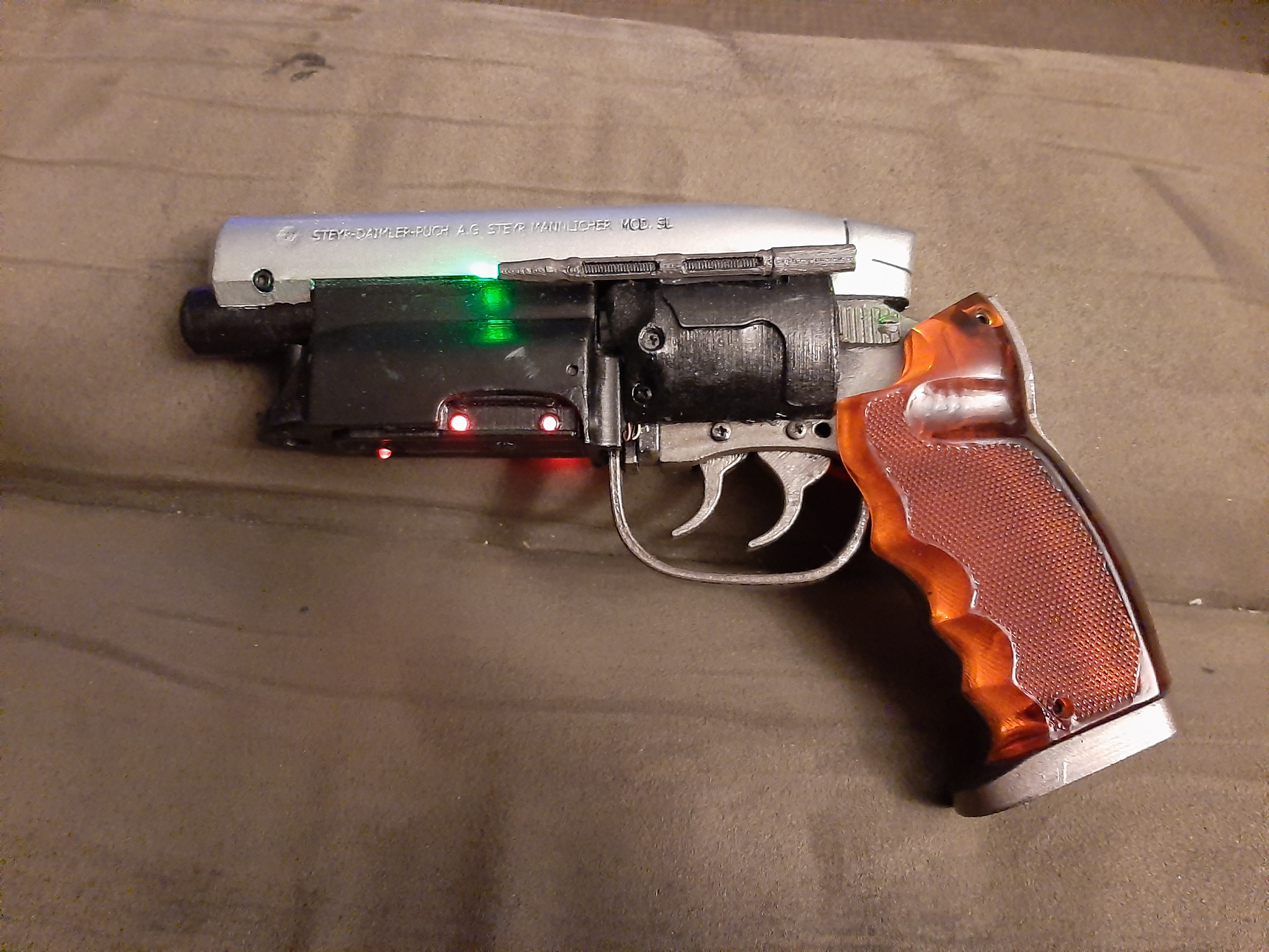

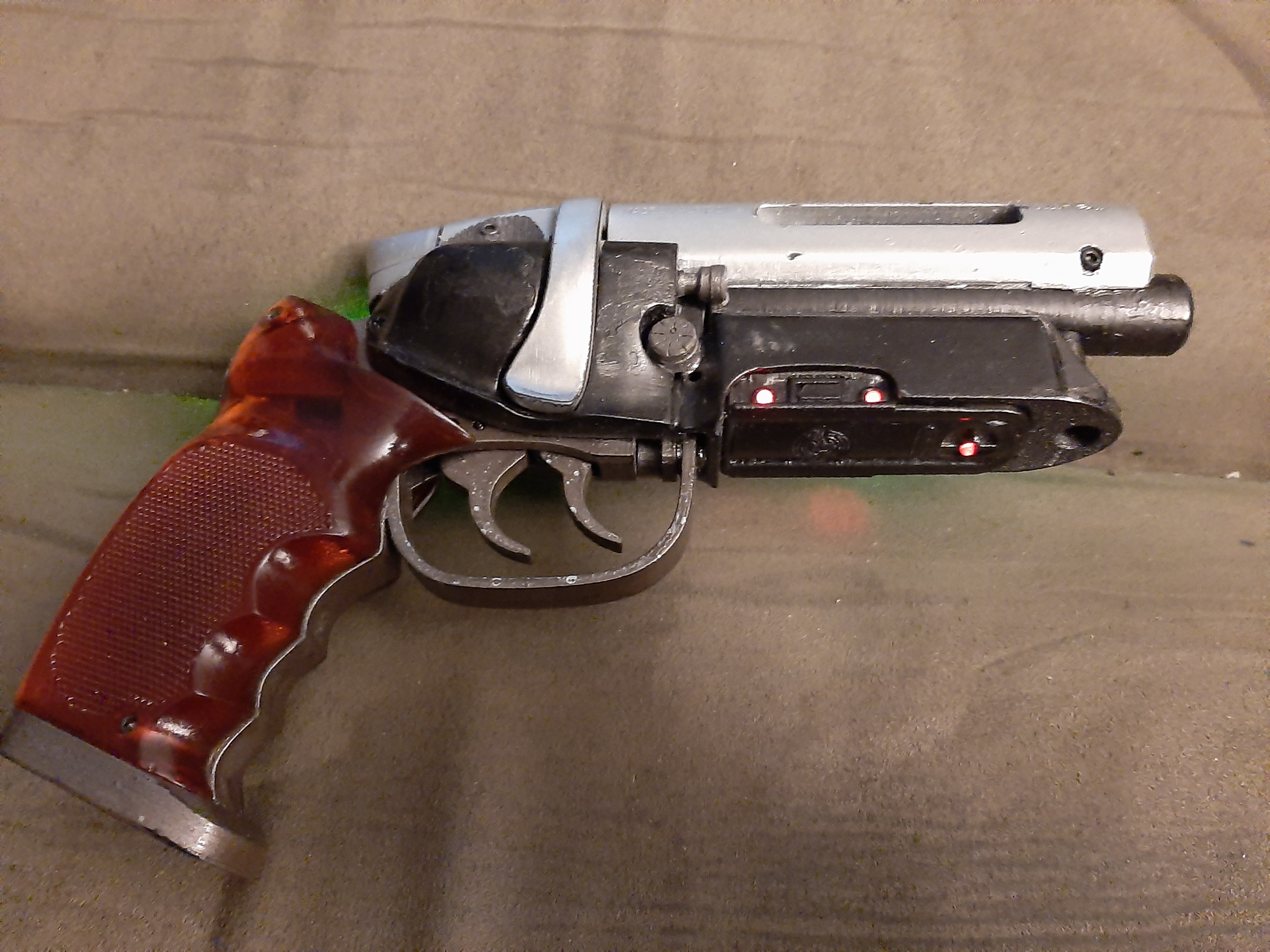

partially wired. gonna make or find a switch that will turn on lights when mag is inserted

Want to add a bit more authenticity to,your rgriesbeck Vers. 3 Deckard? Go pick yourself up a good round file from your local Hardware Store. Carefully ream off the print lines inside the Tumbler Bullet chambers. Then pop down to your Local Firing Range. They prolly sell 44. Magnum spent casings. Try 1 in a chamber. It should slide in a bit. Then continue carefully reaming equally on the inner circular chamber wall until your 44. Magnum round drops in smoothly. This will take awhile cause you want to take off ONLY what you need to get the 44. Magnum shell to drop in. Lastly, you need to add the 3D printed Bullet Lead ends to your spent casings. There is a trick I use to keep the Lead end leveled and positioned. pm me if you want to know how I did this, if you are having issues. ;p I`ve pre primed mine. Then I mask off the brass 44. Magnum casings, and paint the primered printed Lead ends using Humbrol Metalcote Polished Aluminum. I added a pic to show what rgriesbecks printed Lead end looks like grafted into the real 44. Magnum brass casing. Hope you dig. ;p ;p
I did this with rgriesbecks Vers. 2 Deckard. And it`s a very cool mod. ;p
