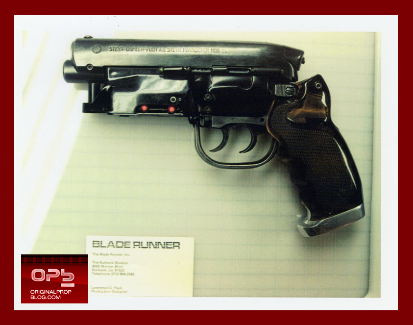

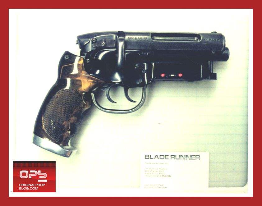

I'm sure you've seen these before but if not, they are pictures of the blaster when it was delivered to the set and they should help with seeing how the firearm was finished.
Wow! I have never seen these photo's. What an absolutely gorgeous prop. Do we know who it's original creator is?. Did his ideas come from what he had lying around, what he could see?. Just the idea of putting the Steyr reciever on top of .44 revolver. Really, it must have been a fluke. It's just so right, and beautiful in ways I cannot describe. I loved this before I had any ideas what it was. It was a Coyle that I saw first.

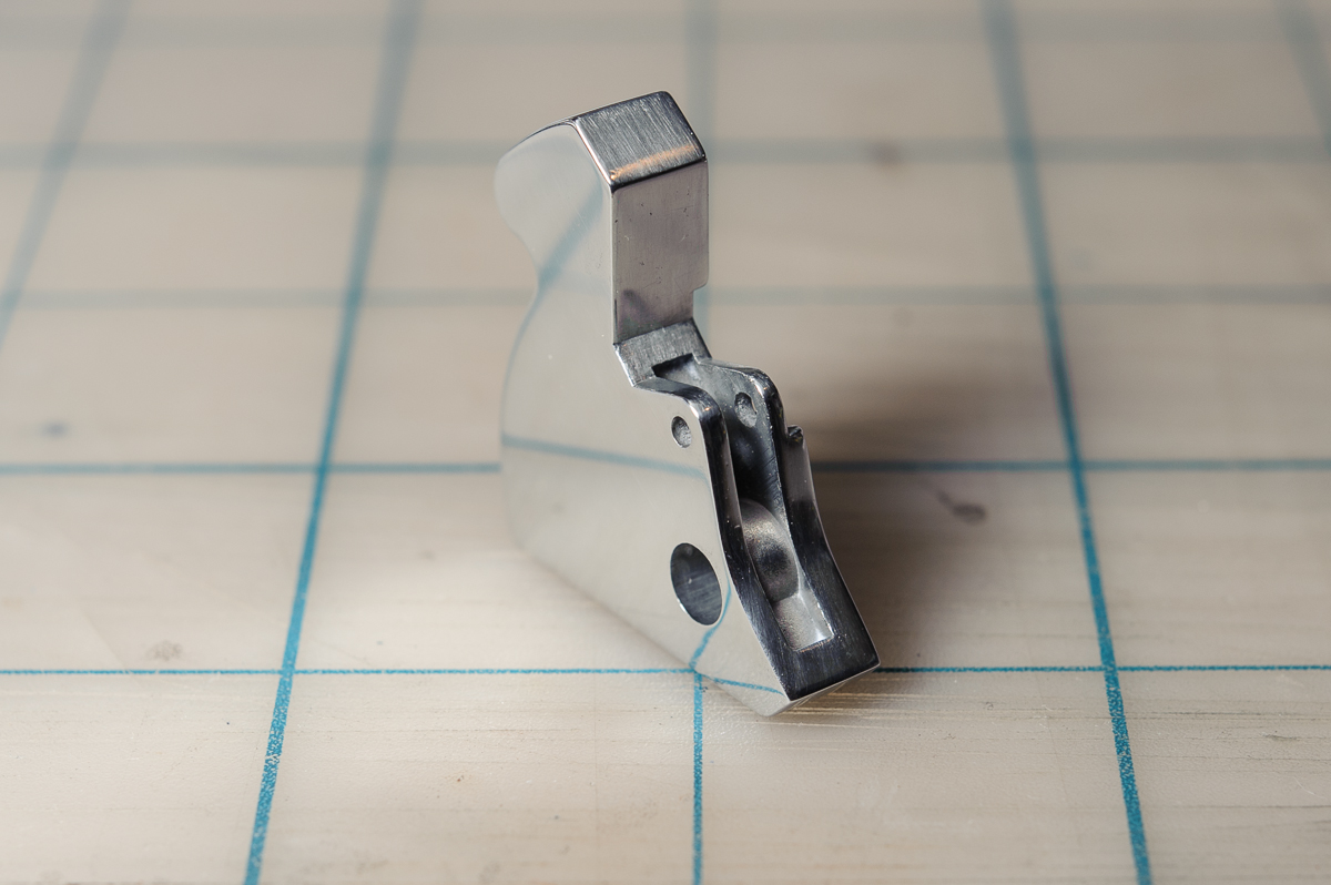

Another question for those who have successfully blued their zinc parts. Which bluing chemical worked best for you and did you dilute it? Here's why I ask:
- I polished the zinc parts to a mirror polish and neither the Casey's Perma Blue or Super Blue affected the metal at all. And I mean zilch.
- Casey's Aluminum Black, on the other hand, turns the part a very dark smoky black right away, like it's working too well. I want to achieve the blue/black look, but I think the chemical is reacting way too fast. I'm using the Casey swabs and wiping the chemical off within about 20 to 30 seconds and then rubbing Barricade into the parts. Still too black. A matte black. Not what I'm looking for.

You can distill aluminum black with water to slow down the blackening of the parts. I believe to get the perfect Blue finish, you need to let the black parts sit overnight to "cure" to some degree and polish the hell out of it (and repeat)

Thanks for the tip, mtrixman. I guess in the polishing process I remove a lot of the oxidized metal to get back to a shiny surface, then repeat, repeat, repeat, and eventually I should get back to a shiny, and hopefully deep, blue. Funny thing is I managed it once with a test piece, and I haven't been able to repeat it since. Eventually I'll learn to write down exactly what works...
There's your problem. Scotchbrite them lightly instead, then blue, THEN polish...polishing first is either putting a barrier of polish on top of the metal or simply removing too much of the grainy microstructure for the blue to bite, or both.

Thanks, Nwerke. I wondered if that might be the problem. Now I'll have to Scotchbrite my beautifully polished parts. Oh well. Interestingly I did get the Perma Blue to work by submerging the polished parts in the undiluted solution. My biggest problem comes when I try to polish after the bluing.
Here's the nice shiny part:
