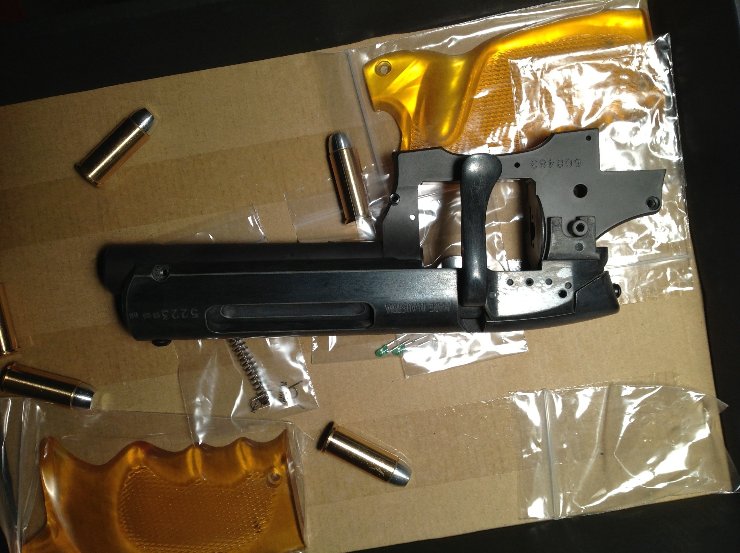

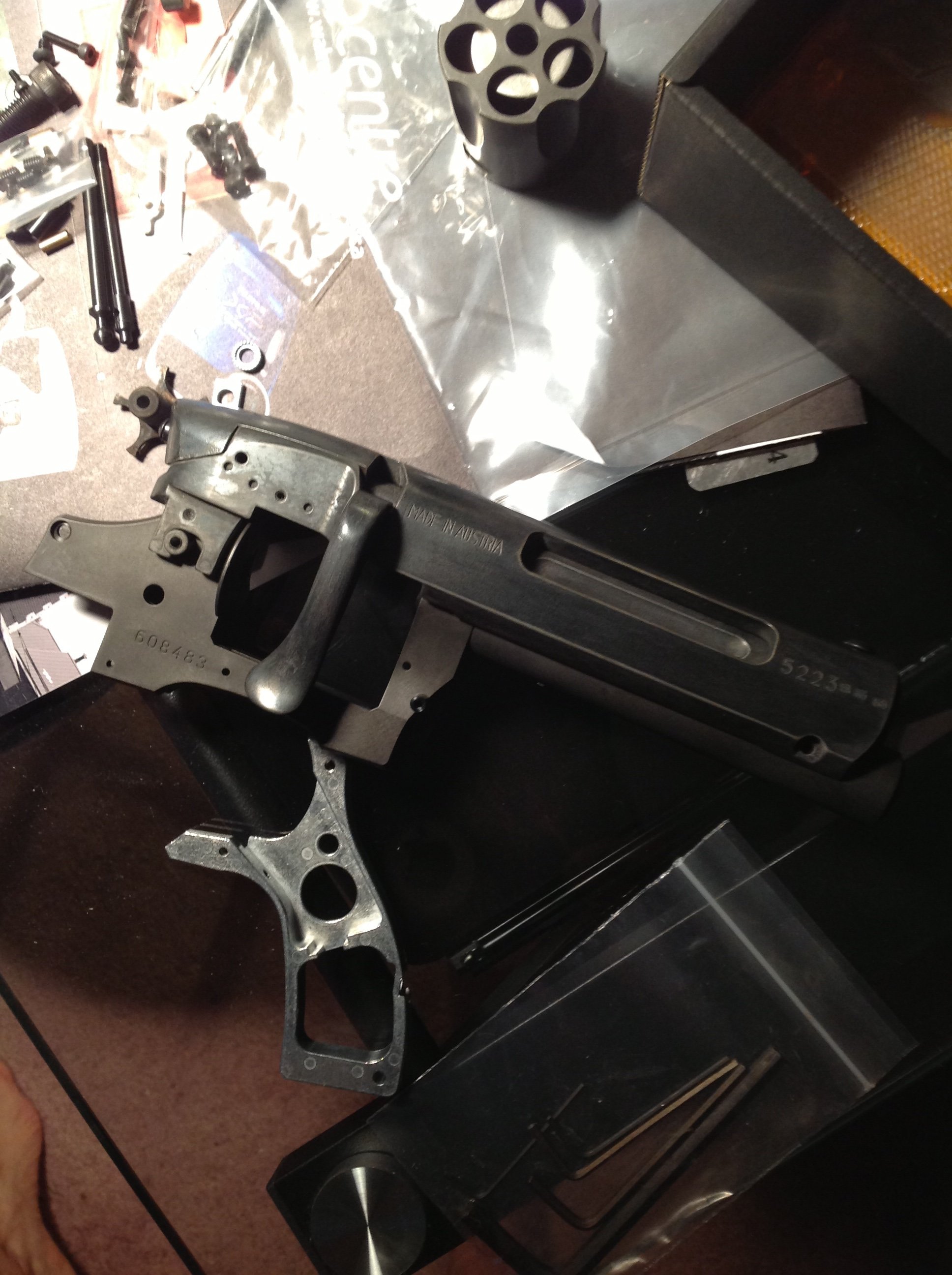

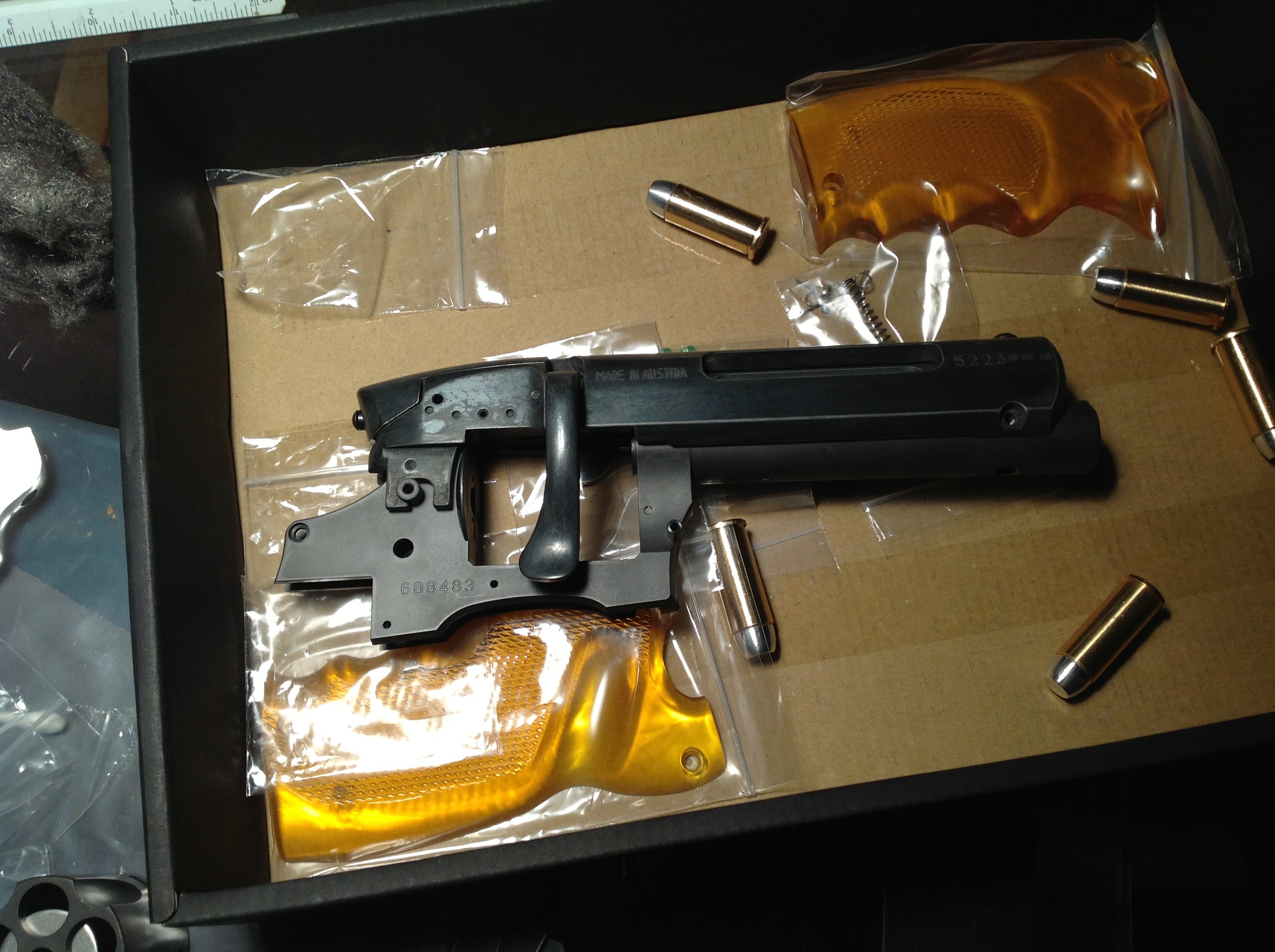

I used both the Casey's perma blue and super blue. I applied likes dozen times. Each time I would steel wool it. Not overly though. Lightly.
I still want to darken a little more but it's getting there.
