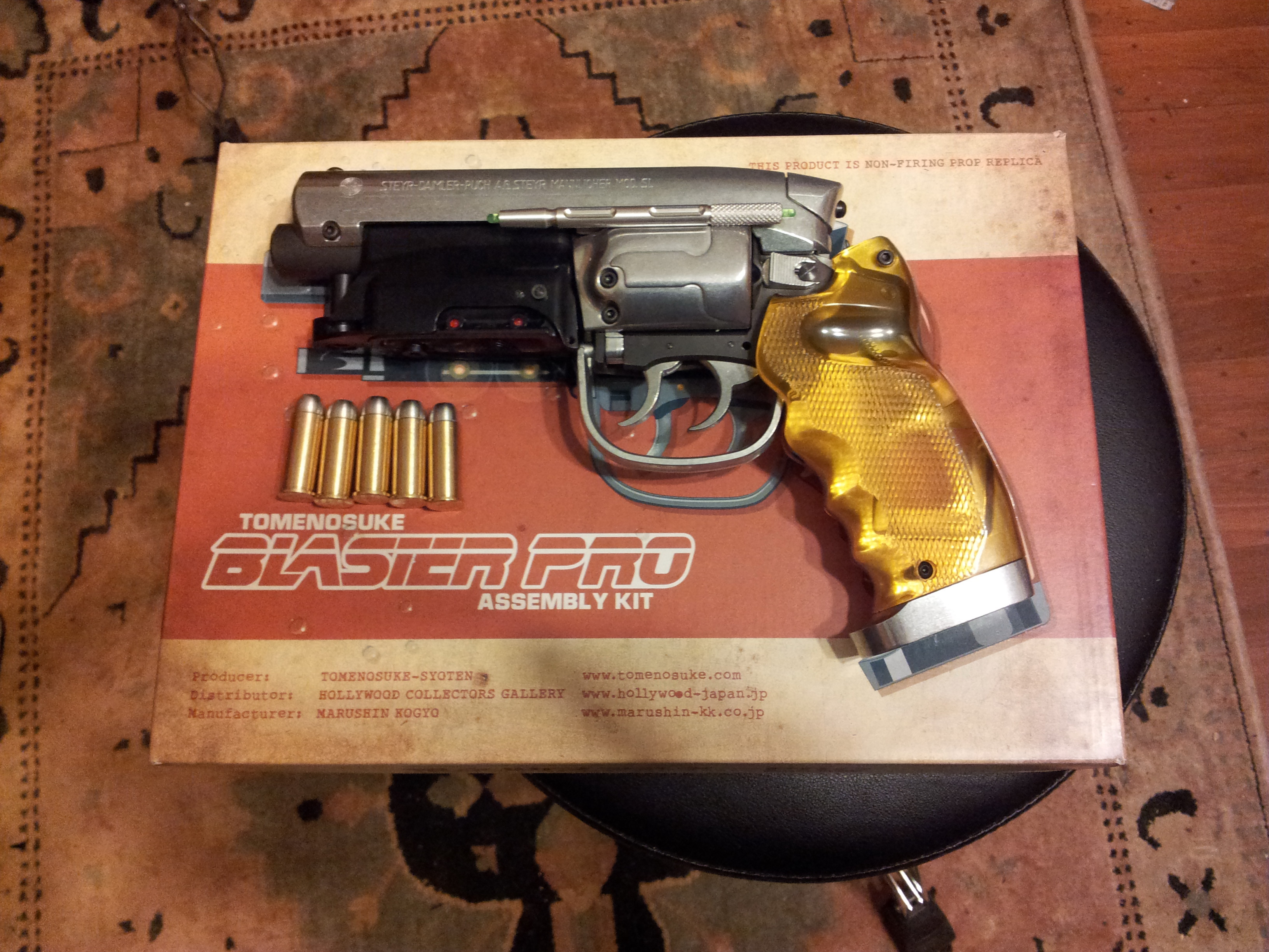

Picked up mine from the post office today, got home and opened it for just a wee look. Next minute, well about four hours later she's all together. Needs bluing but, I'm going to see how others go with that first as it's a bit new to me.
The cylinder is a bit rattly though and the lever could be a bit tighter. Other than that it's an awesome piece, pretty simple to put together, Mune and co' have done all of the hard work for you.

After a few days of handling, my kit as developed a bit of looseness between the grip and bulldog frame. It's quite wobbly actually. Going to have to go back and strengthen it somehow, maybe with a little epoxy or something.

Not just me then. Tightening the screws to the bulldog frame helps as does tightening the M2 at the rear end of the trigger guard. There is still some looseness but very slight only. I was thinking Loctite.

yeah but I think I want to put some glue to bond the two together as well. I don't think the threads can handle too much tightening...

Yeah thinking that too, I might hold of on that till I fix a couple of issues. I may have fitted one of the springs incorrectly, the lever arm isn't pushing the cylinder around consistently.

The two similar springs are arranged as the strong spring for the rear trigger, weaker one for the front. Be sure both were installed facing the right way, with their 'tails' coming out of the trigger and doing the right things. Ditto for the spring for the 'hand' (lever arm) of the rear trigger.

Had this beauty together in a fun filled 3 hours, it is extremely well built and went together perfectly, however, I am left with the little "hand spring" which is numbered 37 on the exploded view in the instructions. I can't find any reference to it in the instructions so not sure where it lives. It's not easy to see from the exploded view how it fits. It seems to work perfectly well without it....is it essential? If so where does it go?

That spring is pushes the lever arm that rotates the cylinder when you pull the trigger loading the next round for firing. That's the one I have to adjust on my gun. Look at the exploded diagram on page two of booklet, then look at instruction 5. fit the spring so the arm is tensioned forwards on the trigger.
