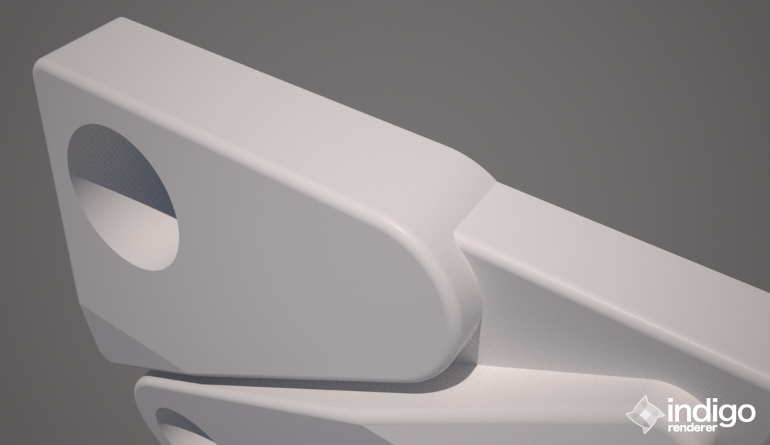

Here's a quick experiment: Both are from the same viewpoint, slightly left of center like the reference photo.
Left is with a 200mm focal length, the right is 35mm. (Like doing a dolly zoom)
View attachment 800278 View attachment 800281
Cool eh? I mean, it could overhang but its possible that it doesn't and still appear that way in a photo.

I thought of the focal length playing a factor, but idk. If you noticed on your 35mm render, the lower triangle and the vertical bar are showing distortions which are not present in the movie screenshot. Also that screenshot is taken from the first baseline scene (link below) which starts off behind goslings head and slowly dollies forward. The shot is not a closeup but a wide, i dont think wide angle lenses cause that kind of distortion on objects farther away?im not camera expert though if we are being honest haha

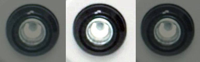

So at the current scale we are working at the clear light cover in the bottom left corner has a diameter of roughly 12.5mm, does anybody know what part that could be? I was originally thinking something like this, but it is too large at 15.8mm
https://www.alliedelec.com/vcc-visual-communications-company-25p-626c/70152560/
this is a little closer at 14.6mm
https://www.alliedelec.com/dialight-177-0937-003/70081542/
The light cover they used is clear and looks to me (granted its very hard to tell) like it has some sort of pattern in the glass/plastic, maybe fluting.
this series is actually the perfect diameter, but they dont seem to be in clear:
https://www.alliedelec.com/indicators-panel-mount/lenses-caps/?a10=Dialight&n8479=101 Series
Im also not entirely sure where the edge of the llens is. The red circle is the 12.5mm diameter, but that could also be a small silver ring and the actual lens could be the green circle

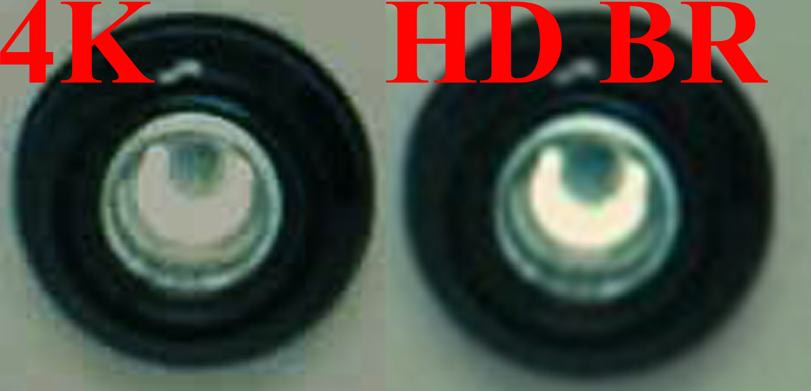

This is an area where a 4k screenshot could actually prove really useful, has anyone made progress on that?
I found these 4k screenshots on this page:
http://lukedowding.com/blade-runner-2049-4k-screen-shots/
but im not sure what process he used to capture the image because the compression artifacts make it less clear than the regular hd version

wow thats actually really good quality, thank you! where did you get these shots? if its from the 4k blu-ray, can you upload a shot of the entire thing in this quality?

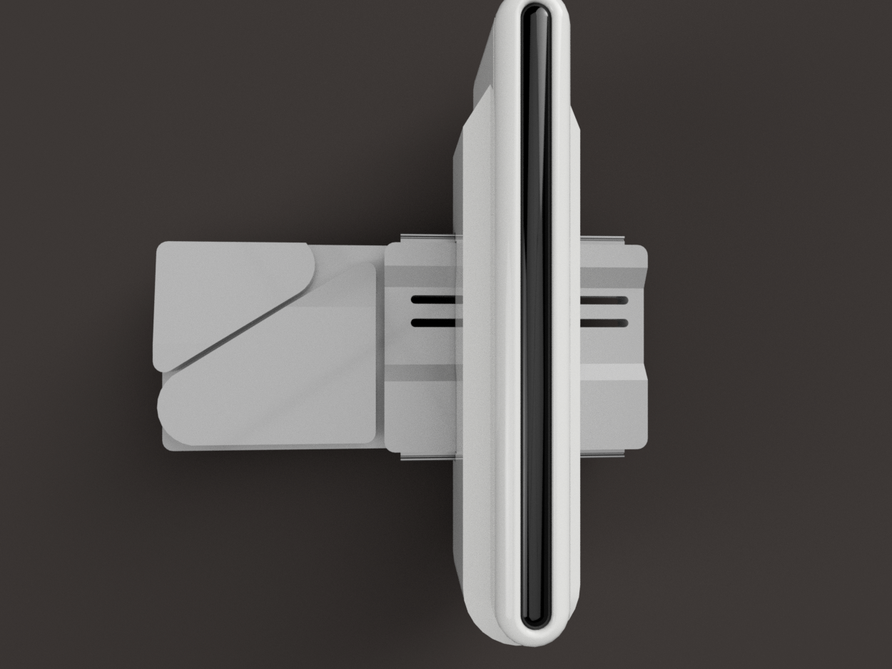

okay, so unless anybody has objections (or new pictures somehow lol) this is the final version of the body.
baseline v11 3.pngbaseline v11 2.pngbaseline v11 1.pngbaseline v11 4.pngbaseline v11 5.pngbaseline v11 6.pngbaseline v11 7.png
there are still details that need to be worked out, this version is one continuous piece but i will probably print the horizontal and vertical panels separately with a small gap between to match the photos. The lens rings and vertical bar i still need to model, and i also need to find an indicator light cap that is the same size. I also need to allocate space in the back for any electronics. all of that should be done within the next few days (though maybe not the light cap, if anyone has a lead on that let me know) so I will keep updating lol

I dont think its another condenser lens, to me it almost looks flat, flush with the black rim surrounding it, maybe fluted on the interior. Of course i could be completely wrong its very hard to tell haha

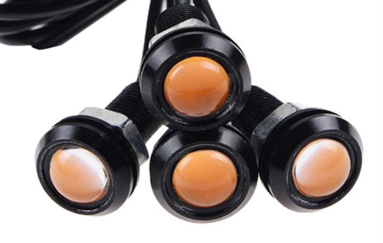

View attachment 800996View attachment 800997
https://www.aliexpress.com/item/32766856366/32766856366.html
Not quite right though.

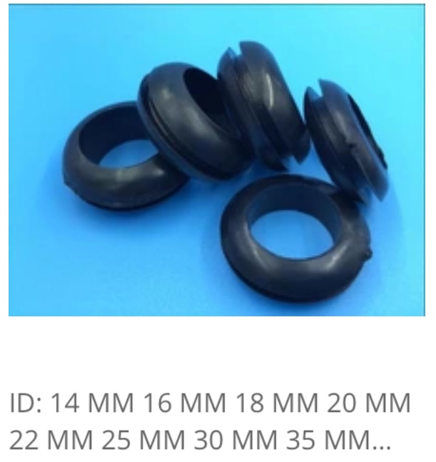

It looks more like a vintage car sidelight or indicator lamp with a Bakelite surround.
Might be closer using a small light source, a lens and grommet
View attachment 801005View attachment 801006
actually comparing this to the 4k image, thats probably not far off. If they had some kind of pdf or schematic sheet that would be useful
